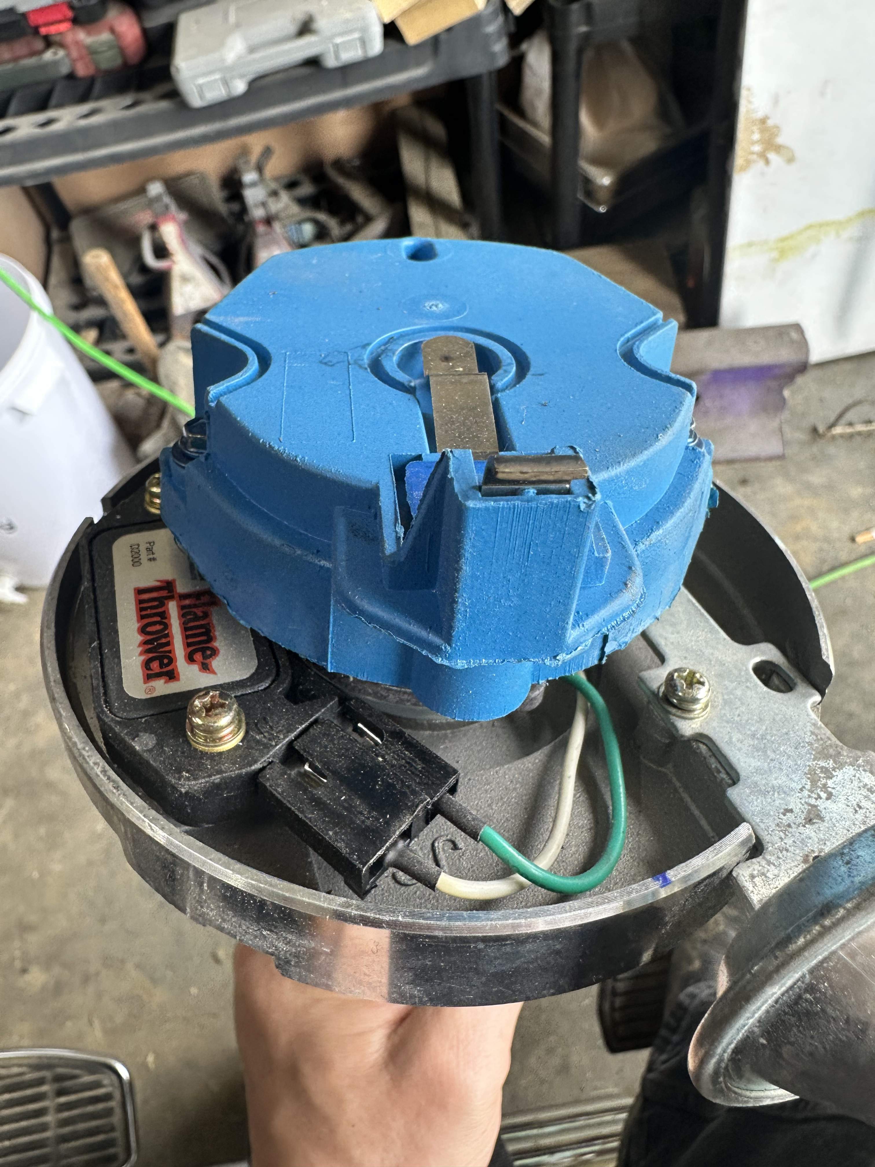

WTF! We went out to start Rosey and she spins fast but took a min to fire up. When she did, she sounded horrible, loud backfires thru the exhaust. After nursing her trying to keep her running she died. Spent the next 30min trying to get her to start. No luck. I have fuel, I can smell it. I pulled the #1 plug and laid it against the master cylinder, the steel alternator bracket then the negative post on the battery. No spark. I repeated with the #3nplug, again no spark!
Well I went to the parts house. They can sell me a new Mallory or another Pertronix distributor. But not the parts to fix this one. I wrote Pertronix an email and explained that I have no spark and asked them if they sell the parts to fix it. Waiting to hear back from them.

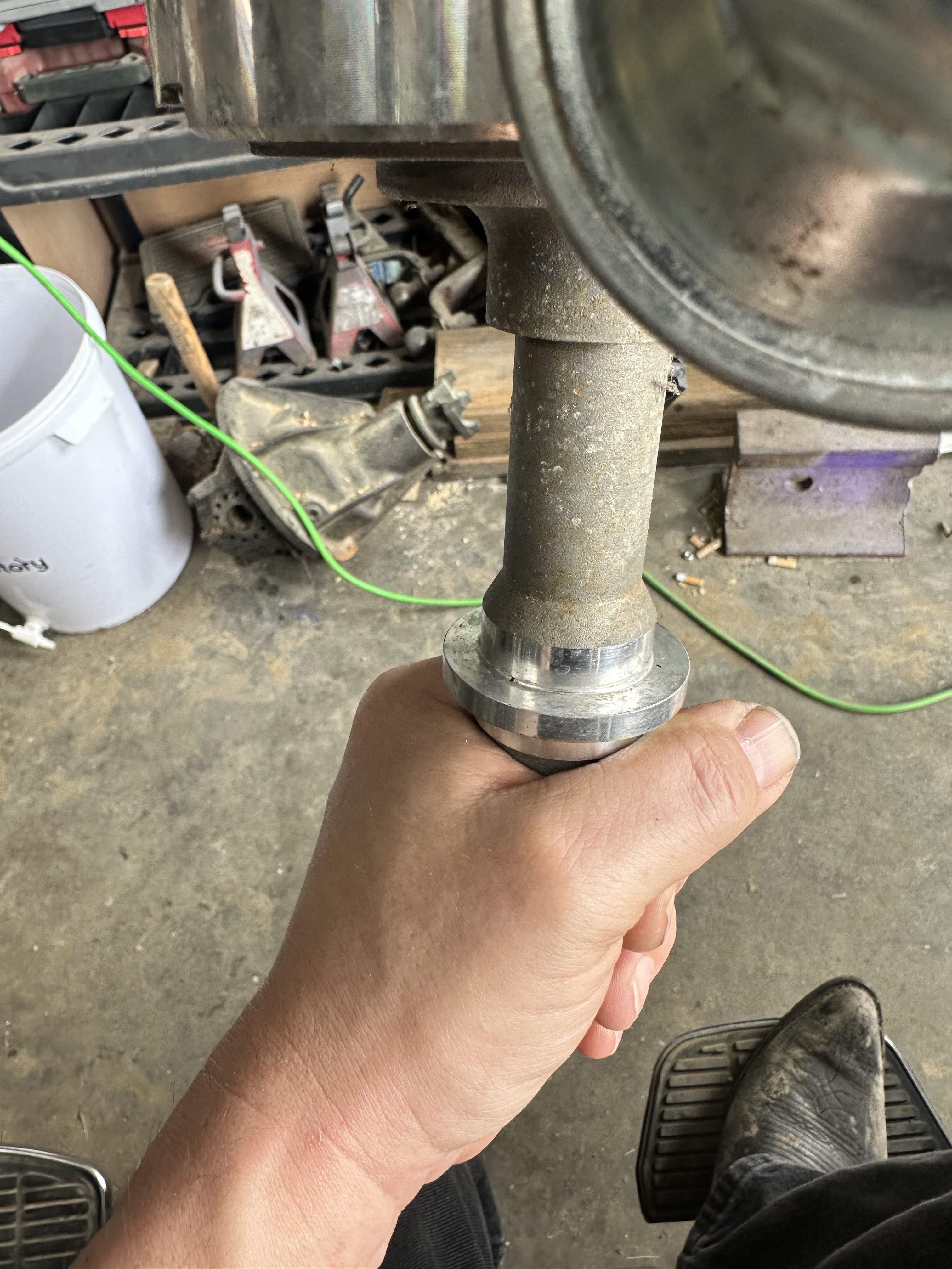

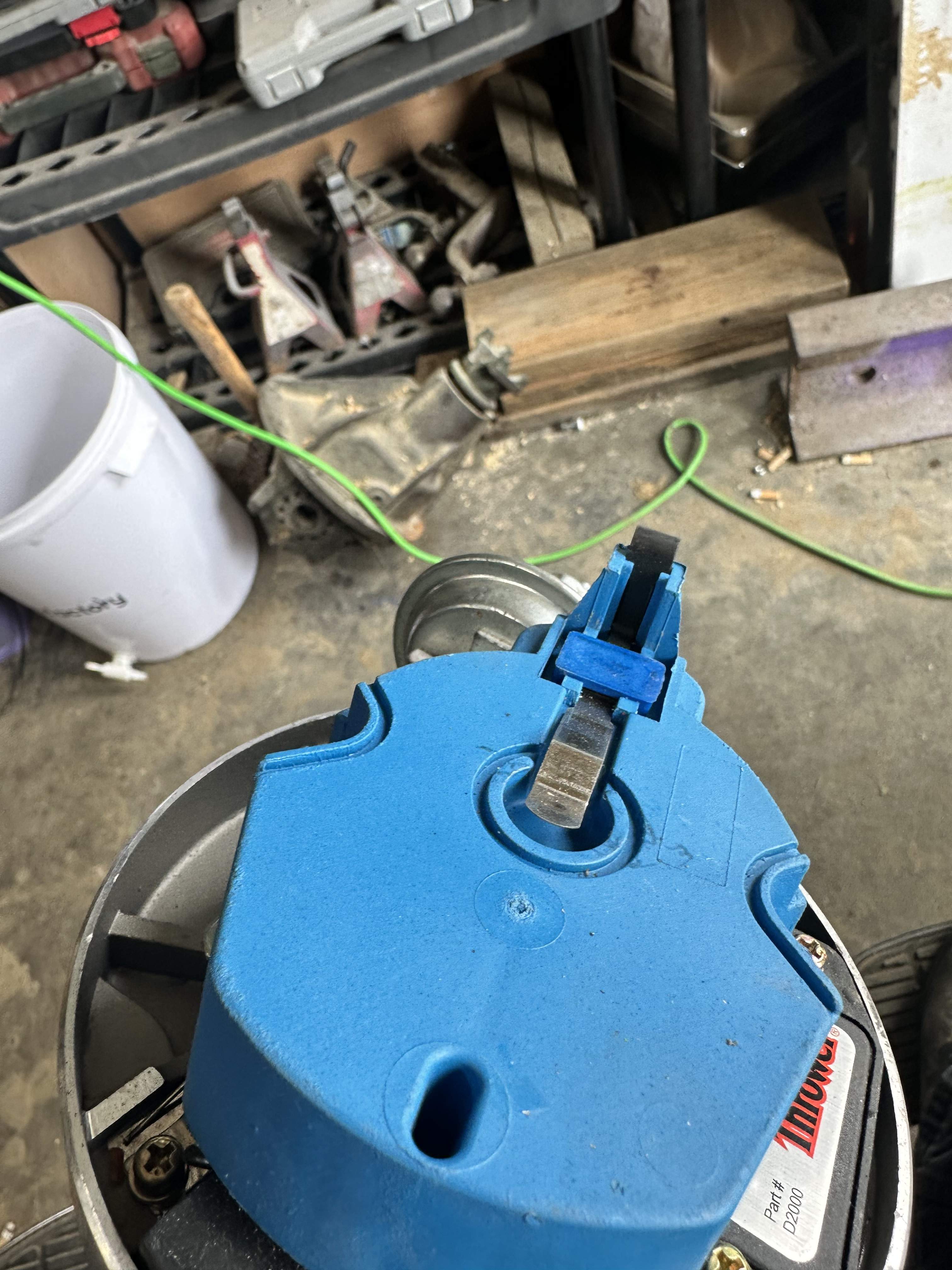

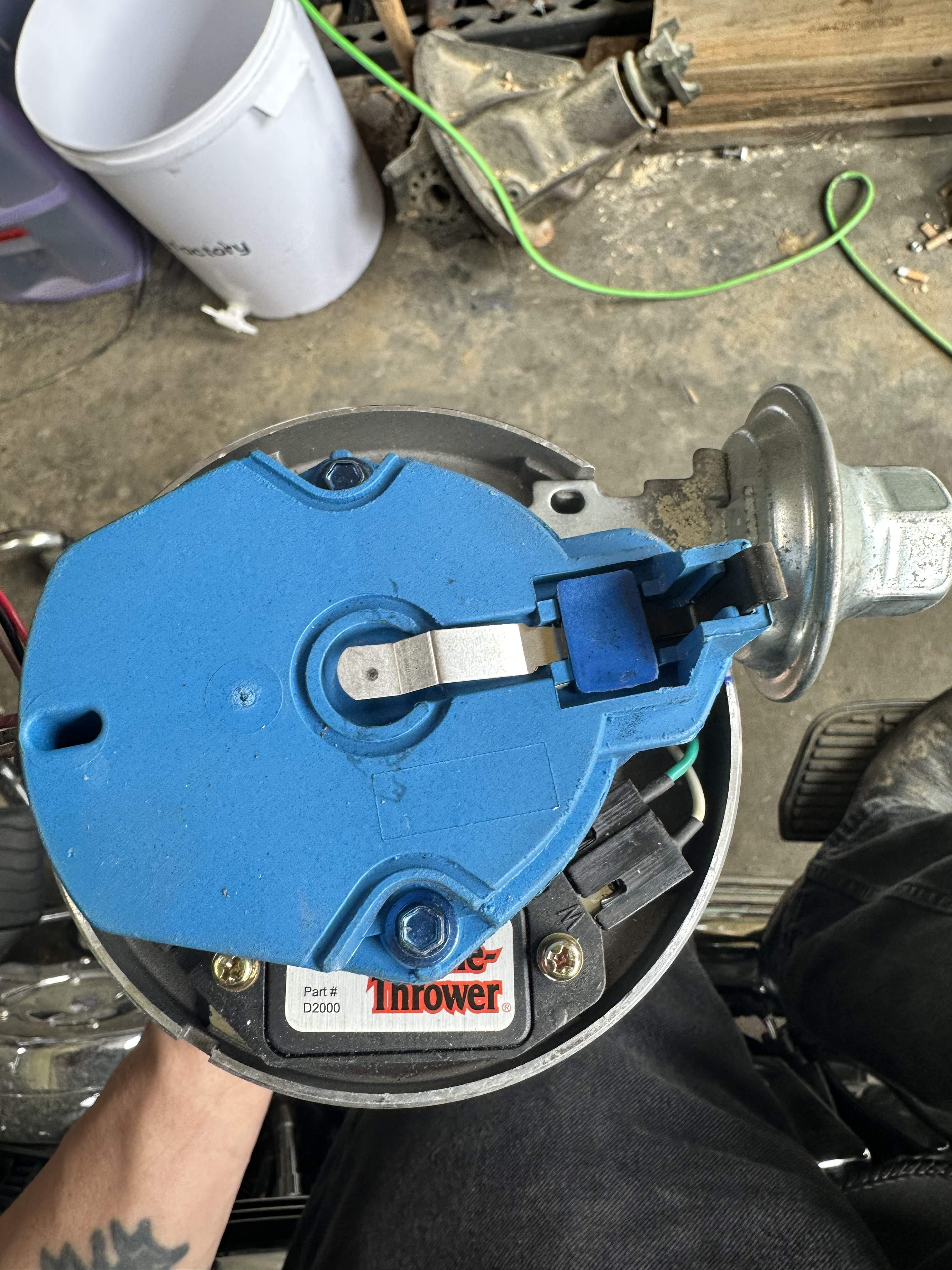

If you don't mind...I have some thoughts and Questions...First off I'm Assuming that you Set the Cam Straight Up and Used a Degree Wheel to insure that everything was in Spec. According to the Cam card ...When Assembling the Engine...
Are you 100% Sure that the Engine is actually at TDC When The timing Mark on the Damper is lined up wth the 0 mark on the Timing Cover...??  Did you Reuse the original or install a New one during the Refresh/Rebuild...Either way Do NOT trust the Timing Mark on Any Damper to Be Correct No matter what Brand it may be or where it came from..As Fitzy indicated earlier...The only reliable way to insure TDC..Is to Remove the drivers side Valve Cover And Physically watch the Valves on #1..While Rolling the engine over by hand though a couple of Revolutions..When both the Intake and exhaust valves are fully Closed and the Stick a Pencil/ Staw..Etc..Through the sparkplug hole until it touches the top of the Piston then Physically have your hands on the pencil and barely Roll the engine over to make sure that the piston is at Its Highest point..Before starting Back down...That is 100% Without any Doubt TDC...If the timing mark on the Damper is Lined Up with the Zero mark on the Cover...That is Great..If Not Put your own mark on the Damper that lines up with the 0 mark on the Cover/timing tab...Then use that mark for any timing Adjustments...
Judging from What I Can see in the Pics..You might be Better off to Rotate the Distributor Body 180 Degrees in order to place the Vacuum Diaphram on the passenger side..As pretty much Every GM HEI car has the Distributor cap plug on the Drivers Side..Opposite of the way of the way yours is installed...With the #1 plug wire on the cap to the Front side of Where the Distributor (Power/Tach) plug in...
While you have the Distributor out of the Car...Install the Cap on the distributor...Then use a fine line Sharpie/Marker...and Mark the distributor body center line of the Metal connector Where the plug wire Attaches...The more Accurately you mark the Centerline of the Contact on the Cap with its position on the base..(Use a 90 degree Tri Square wth the bottom of it on the bottom tight against the base to help obtain a true Centerline mark)..The Easier it will be to put the distributor back in the Engine at the exact point in relation to where it will line up With the # 1 position marked on the distributor base...When Reinstaling the distributor you can position the Vacuum Brake in the center of the Available space between the Intake Manifold and the firewall..While installing Keep the Rotor as close as you can to the mark on the base as possible...Once You get the distributor positioned the way you want..Simply Rotate the base until your mark on the Distributor Body lines up with The Leading Edge of the Contact on the Rotor...That will put you within a Couple of Degrees Advance/Retard..of your Final Timing Setting...
Something else to pay Attention to is the Distributor Hold Down clamp make sure that all the Points of Contact including the bolt Threads/Distributor Base...Etc.. Are good and clean..As it is the hold down clamp is the Main Ground to the distributor itself...If it is Not Grounded good...The ground loop will travel through the Distributor shaft itself/Internally through the parts..and not Effectively ground the body as it should...And potentially cause all kinds of Stupid Chase Your Tail Electrical/Ignition Iisues...
Judging from what I've read...I have a Strong Suspicion that The Electronic Ignition Module in the Distributor has Failed...But Unfortunately there No way that I know of to Check/Test..The Module..Also the Condenser also located in the Distributor Has Absolutely Nothing to do with Ignition/Functionality of the distributor...It is Only there for Noise Suppression to keep the Radio from Picking up any electrical/Signal interference That may by put out by the Plugs/Points/Ignition module...Etc..

Took about 2hrs last night to find the part numbers for the module, coil, cap and rotor. I pulled the cap of this morning and guess what, there was the part number to the module.
Anyways, I pulled the bolt and hold down clamp and cleaned them really well with a wire brush and parts cleaner and then rewiped everything down alcohol. Its clean. I inspected the cap and the leads in it and on it and they all looked good, no cracks not burnt. I checked inside and the rotor tip looked good and no burnt spot on the module or wires. Also pulled the cover off of the coil and checked it, same thing, everything looked good, no burnt spots or burnt wires. Reassembled everything and still no spark. So, I'm guessing module or coil, and I'm inclined to go with Two Lane and will try the module first.

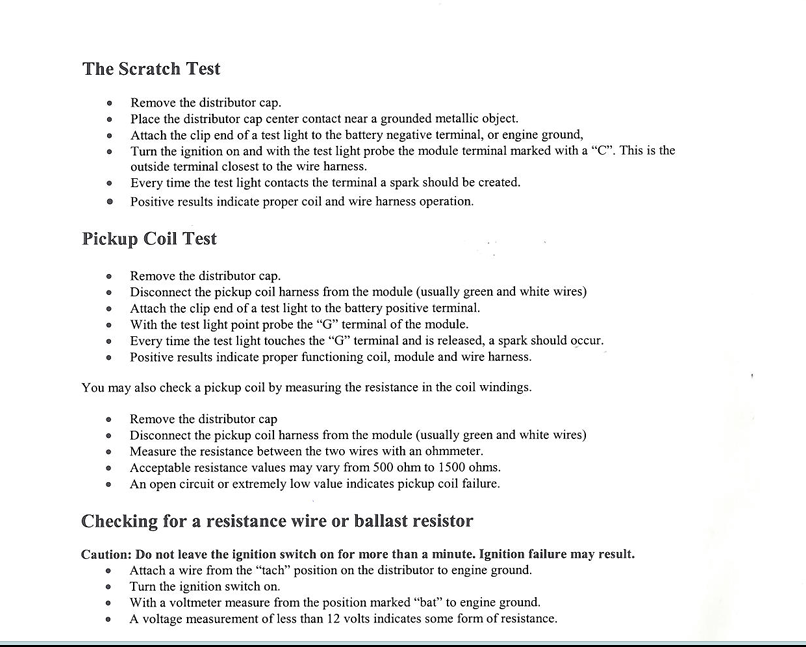

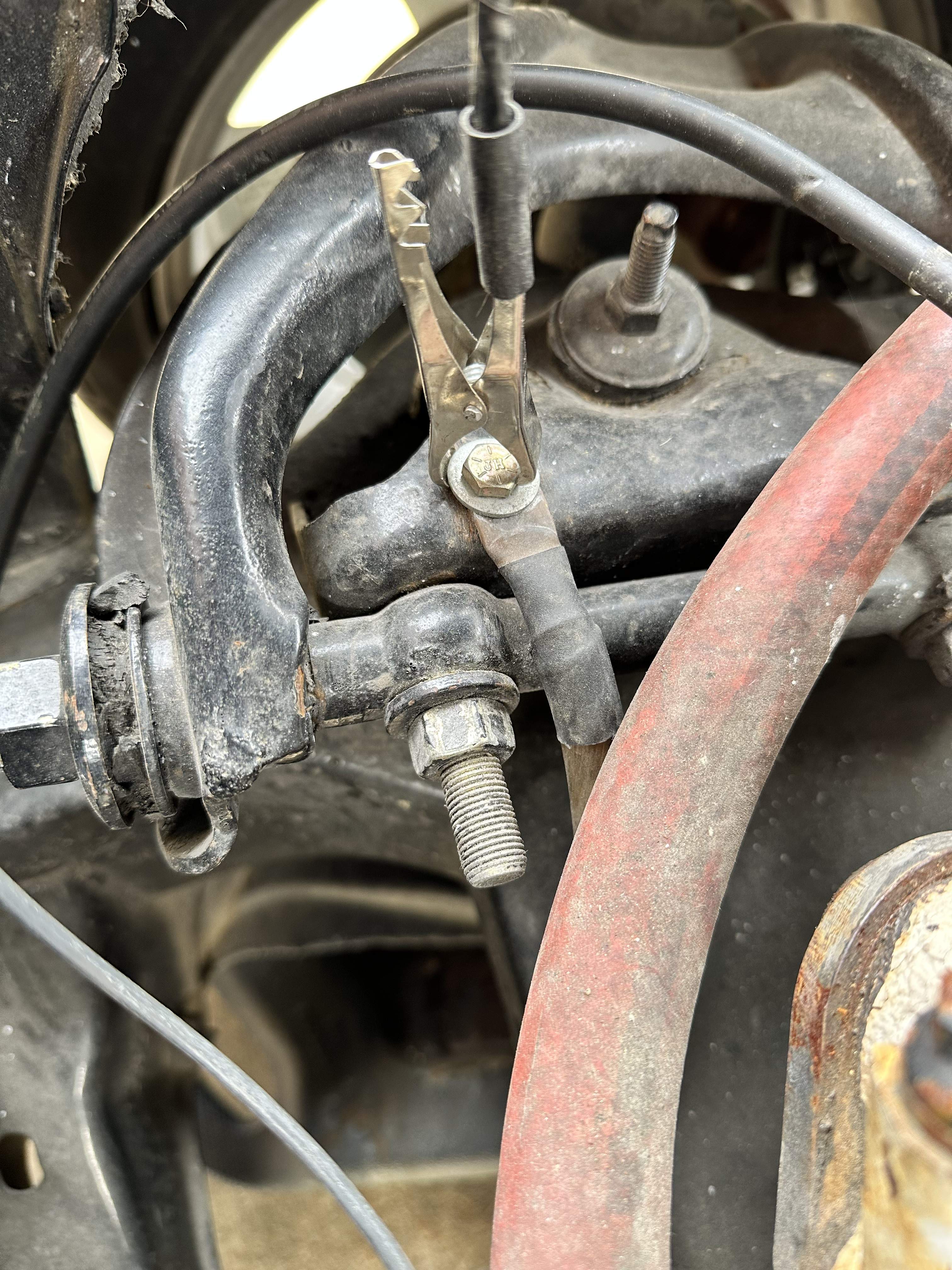

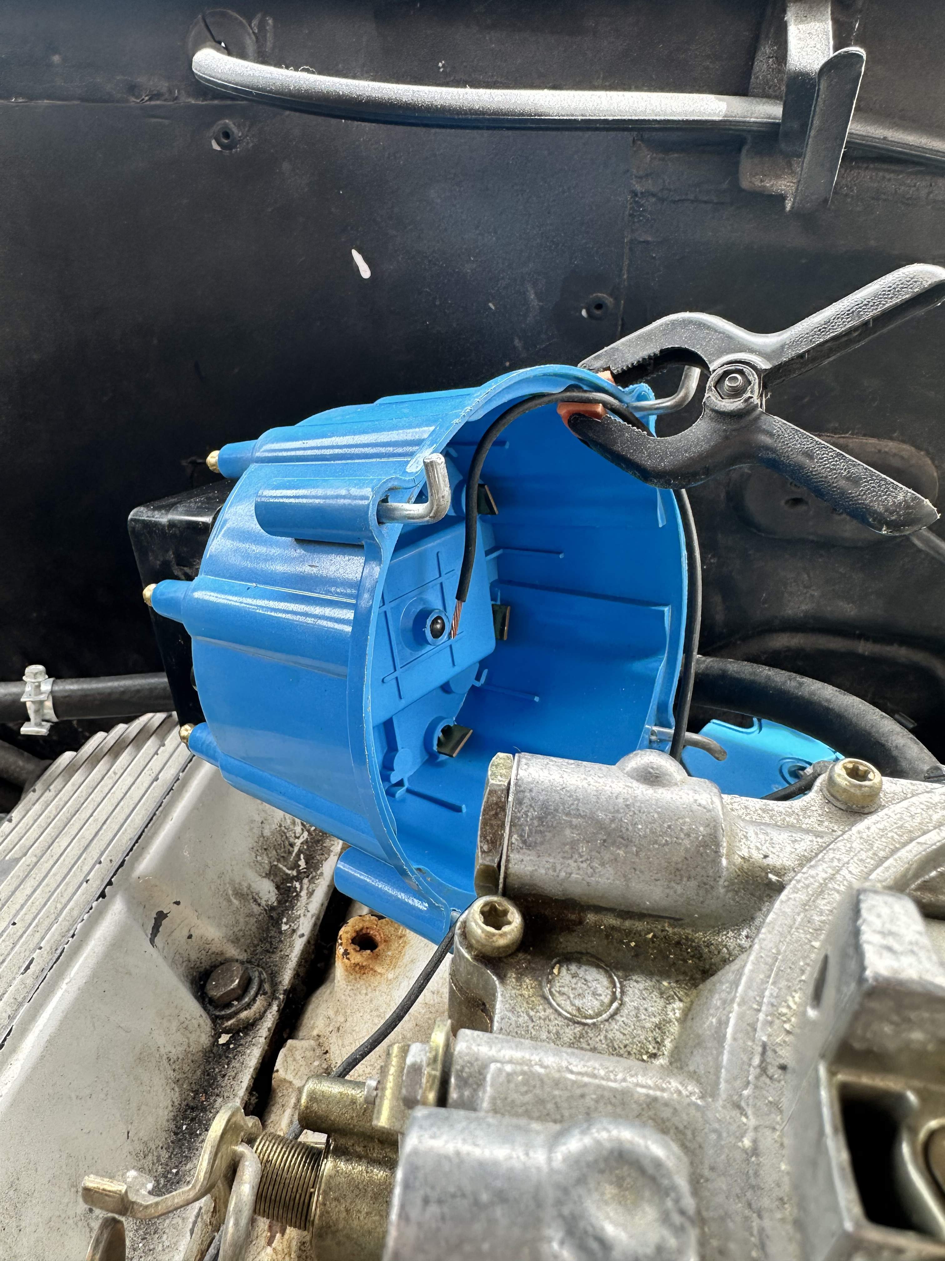

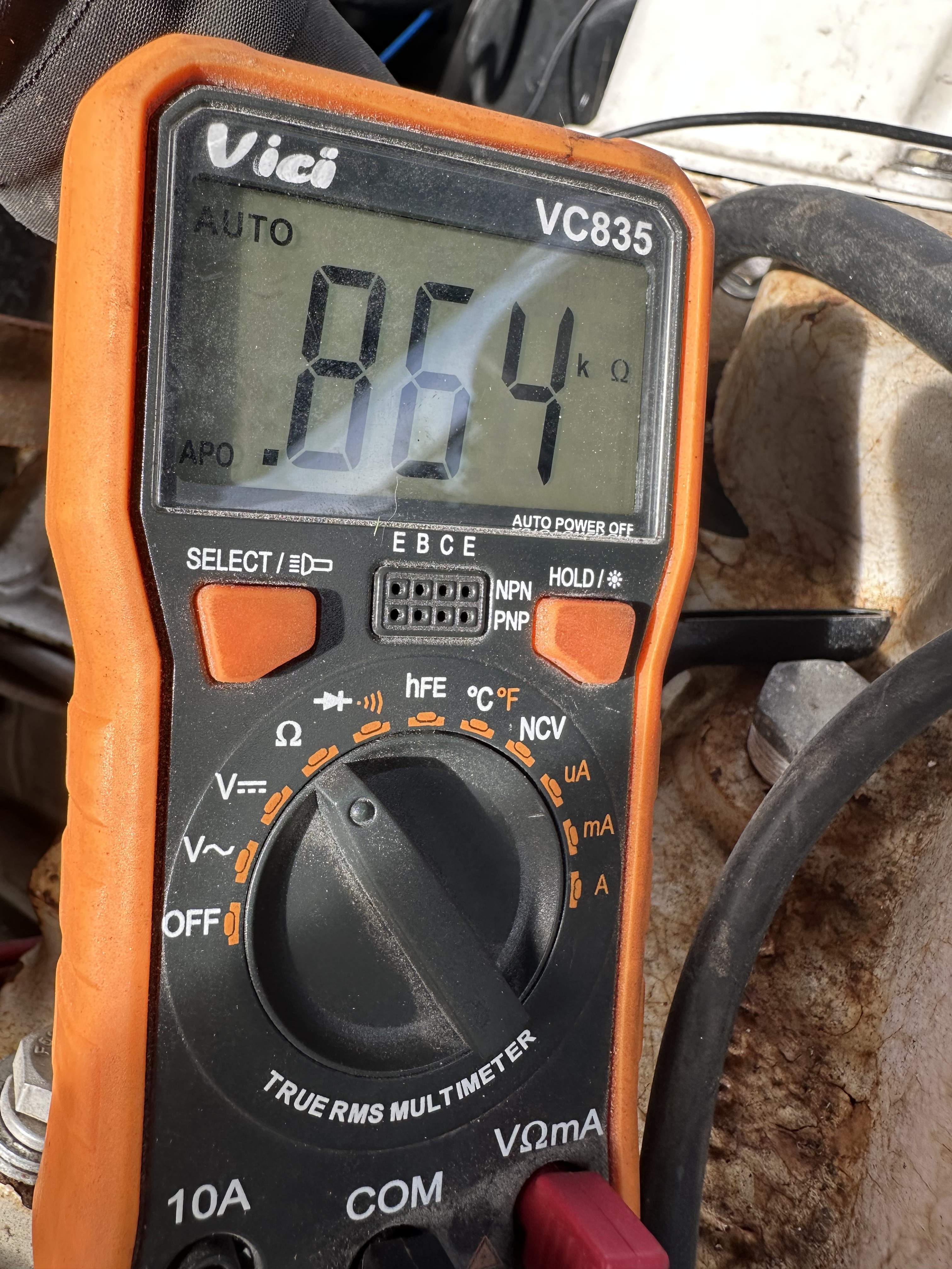

So for those following a long I got an email reply from Pertronix with a list of tests to do and send him back the results, and since I trust y'all more than a salesman at Pertronix here are the results, I will send them to him after. Please tell me what you think or if I did something wrong or if you want me to try something else. Since I didn't know how to place the center contact inside cap near something grounded, I used a ground wire and a clean bolt that grounds engine to frame. Oh, and he stated the ohms should be between 500-1500, I know nothing about ohms, and I got .0864. Maybe he meant .500-.1500? Or I messed up? Also, after test light I did everything with a multimeter.
Power wire going into coil 12.16V
Scratch test 12.23V Yes spark
Pick up coil test 11.09V Yes spark
Ohms .846
Still no spark at #1, #7 or #2 plugs video attached
Wrongway
your pick up has failed the test
like the tests say
you should have 500 to a 1500 ohms of resistance
you have no signal going to your coil
and you have proven the cap mounted coil
is firing thanks to your earth test 👍
Thank you kiwi, I wasn't exactly sure brother but that was what I was thinking.
