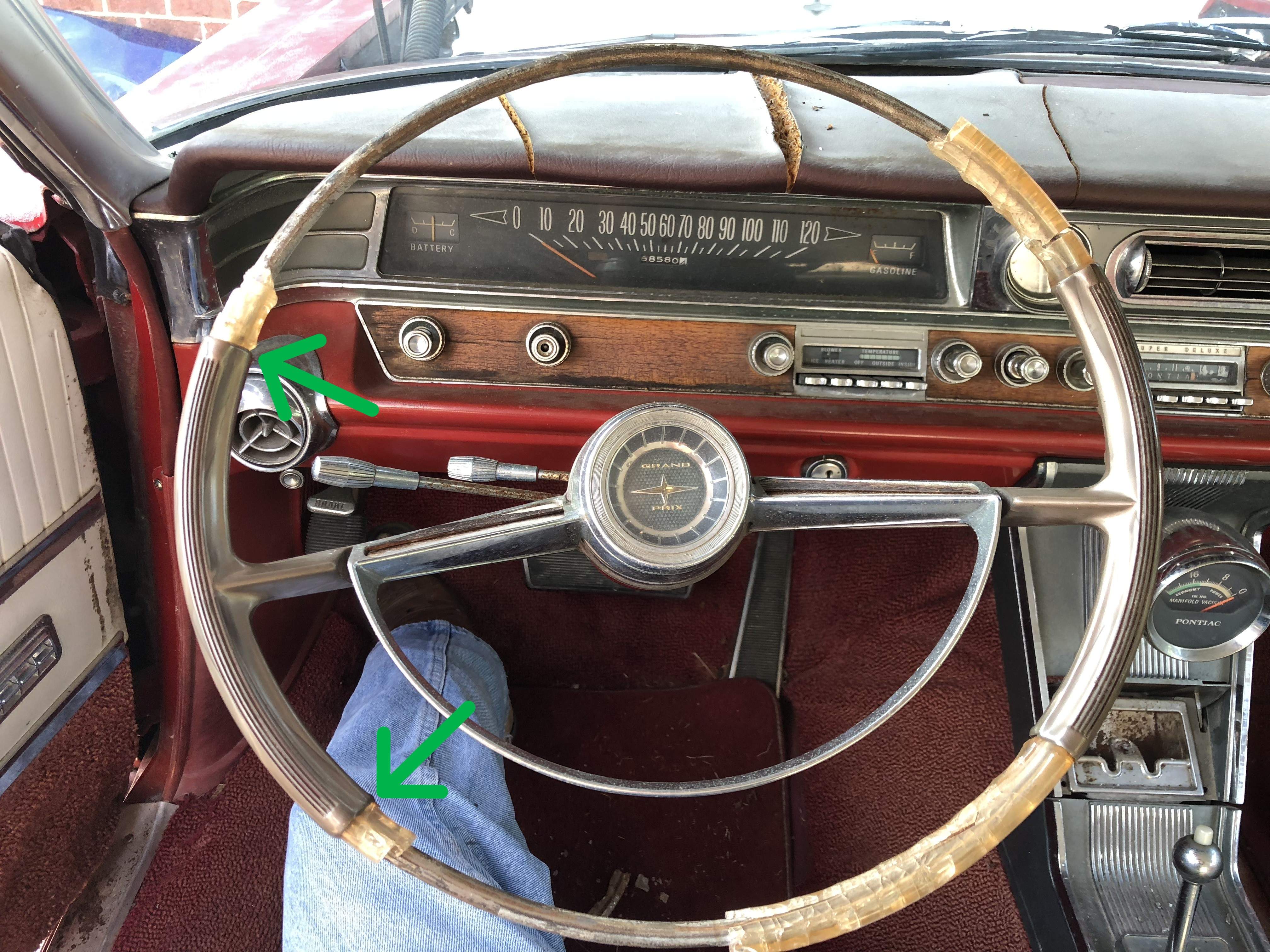

Does anybody know the proper name for the 4 stainless steel rings that go around the grip part of the steering wheel?
They are either called slip rings or steering wheel notches.
If it is used to send electricity from the wheel to some other part of the car (e.g. the horn, cruise control, radio controls, etc.), then it is called a slip ring.
If it used to simply mark the top of the steering wheel that let's the driver center or re-center the wheel, it is called a steering wheel notch.
Otherwise it is just decoration.
Thank you Frosty, the ring in question is a decoration piece. I may be misinformed but I was told that these steering wheels had a silver ring separating the vinyl from the acrylic. If they did not, somebody please let me know so I can stop searching for them :lol2:
No idea what the blue steering wheel is but it has an example of the rings, and again, I'm not positive that the 63' had them. Justa what I was told.

Do you like those rings, Wrongway? I had a good look at those pics and (personally) I reckon they look a bit fussy - you know, extra bling just for the sake of it. If you were to delete them and just had a solid coloured rim it'd still look the goods.
It seems that back when manufacturers were proud of their product, they'd add an extra splash of chrome here or a little stainless trinket there in order to justify whatever price premium they may have been after. I mean, if you chose a Poncho over a Chevy back in the day, you'd want some extra bling to show the neighbours when they asked what you paid for it.
Well, it's not so much that I like them. But I'm still trying to redo the clear acrylic and paint the vinyl part to match the body color. But I couldn't find a pic of a 63 that had them. After being told that they did I figured I would double check with y'all before cutting notches in the steering wheel.

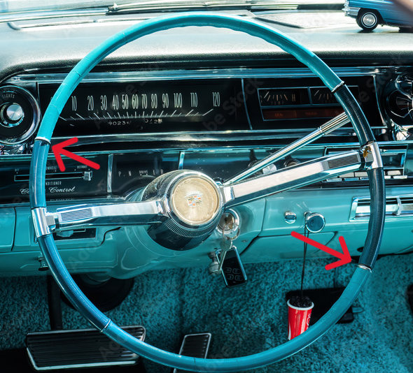

My 64 bonni didn’t have rings in the wheel
Wrongway … that’s a caddy steering wheel
1964 I think
