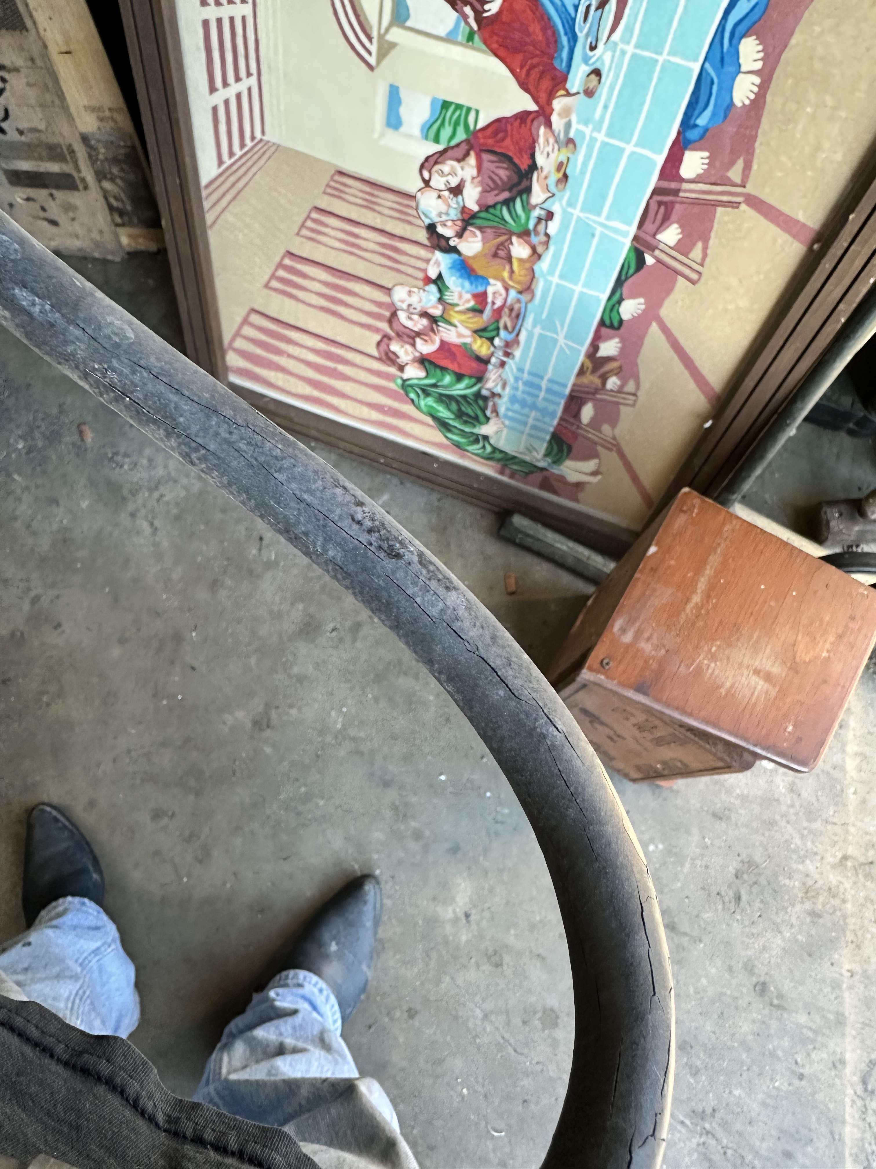

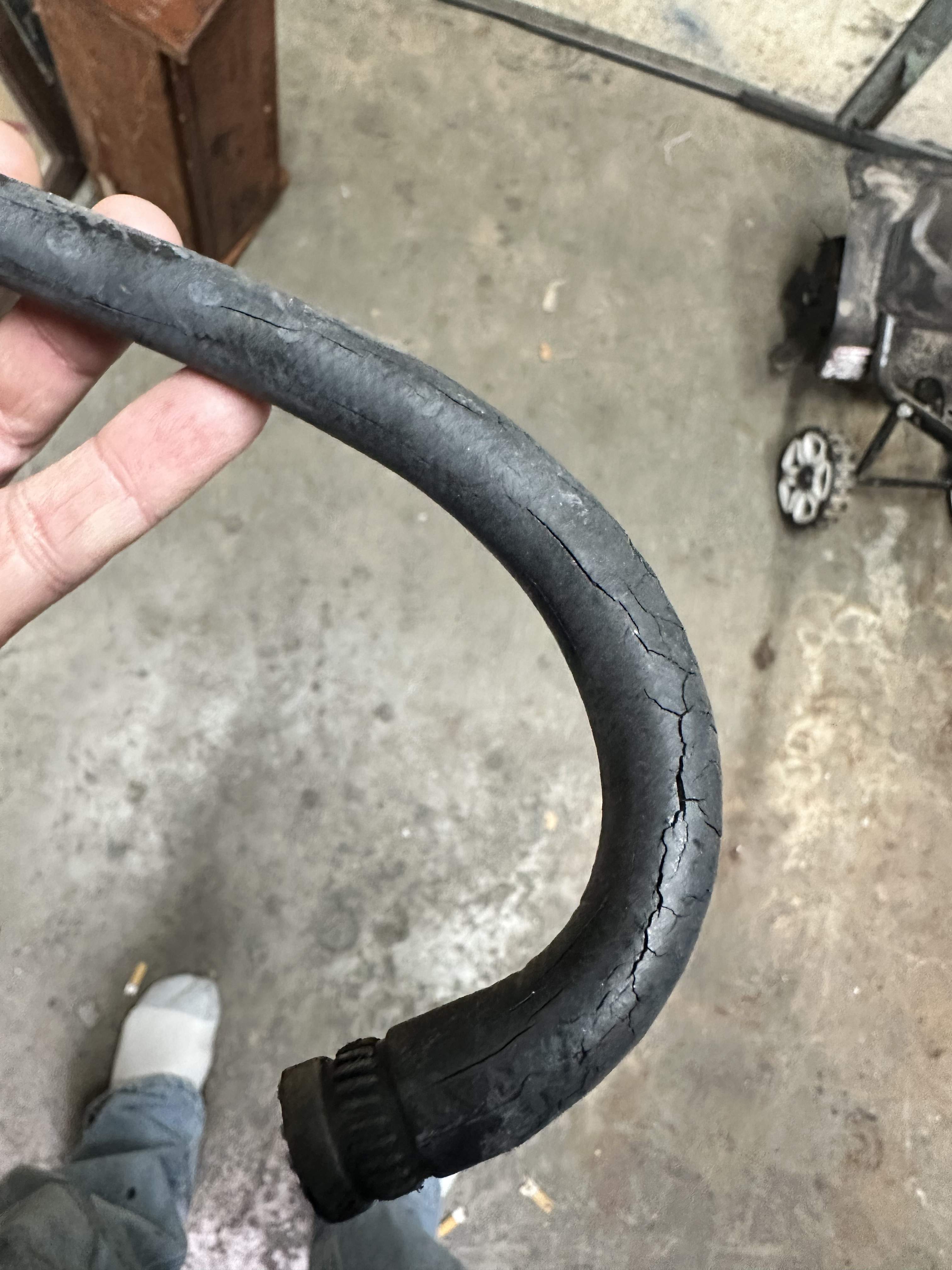

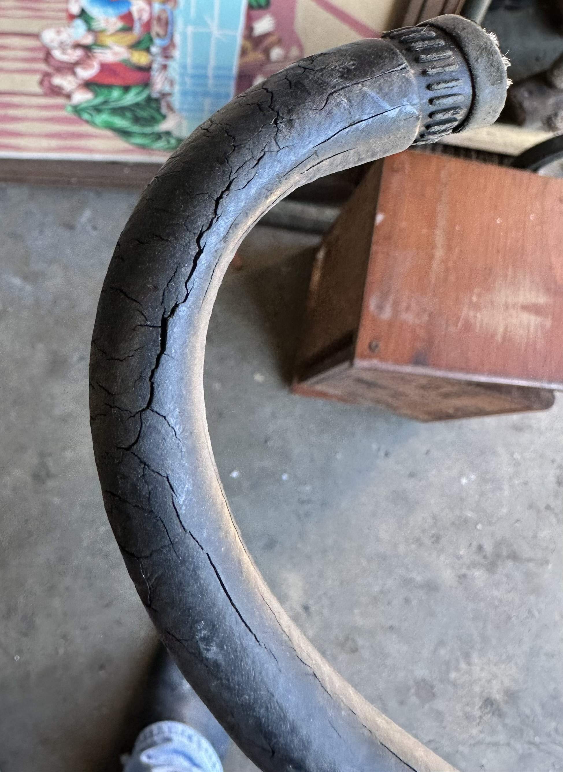

Well, I climbed under to pull the old fuel pump today. Since I finished the under the hood part yesterday, I decided to turn the old pump on before disconnecting it and justa test it one more time and see what the actual pressure is that the old small pump was putting out. Turned the power on and no fuel came into the filter. I figured ok since I can hear the pump I must be out of fuel. I moved on to another project. But something was nagging at me, then it hit me. I had fuel the other day it justa wasn't pushing it hard enough to leave the fuel filter by the carb. It would only fill it halfway. Damn it, fuel doesn't evaporate that fast. So, I climbed back under to disconnect the old pump and hook up and test the new pump when I found what I think could've be the original problem. Look how cracked up these hoses are. I'm thinking they might have been sucking in air! This fuel hose was put on new when I installed the old pump within the last two years. Anyways, picking up more fuel hose this weekend and I'll try to start her again.

how old is that fuel hose mate ? That looks 40 years old !!!!

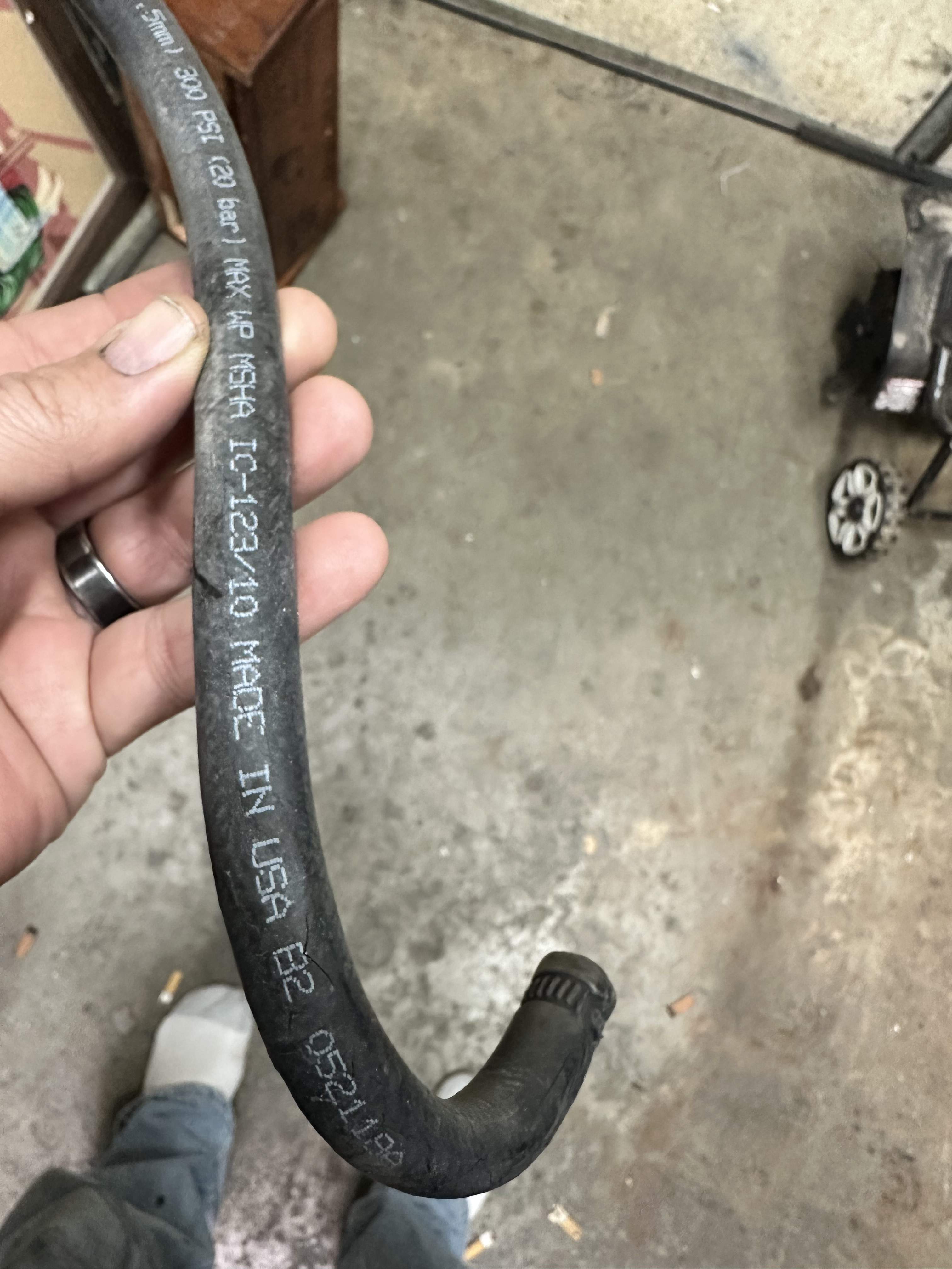

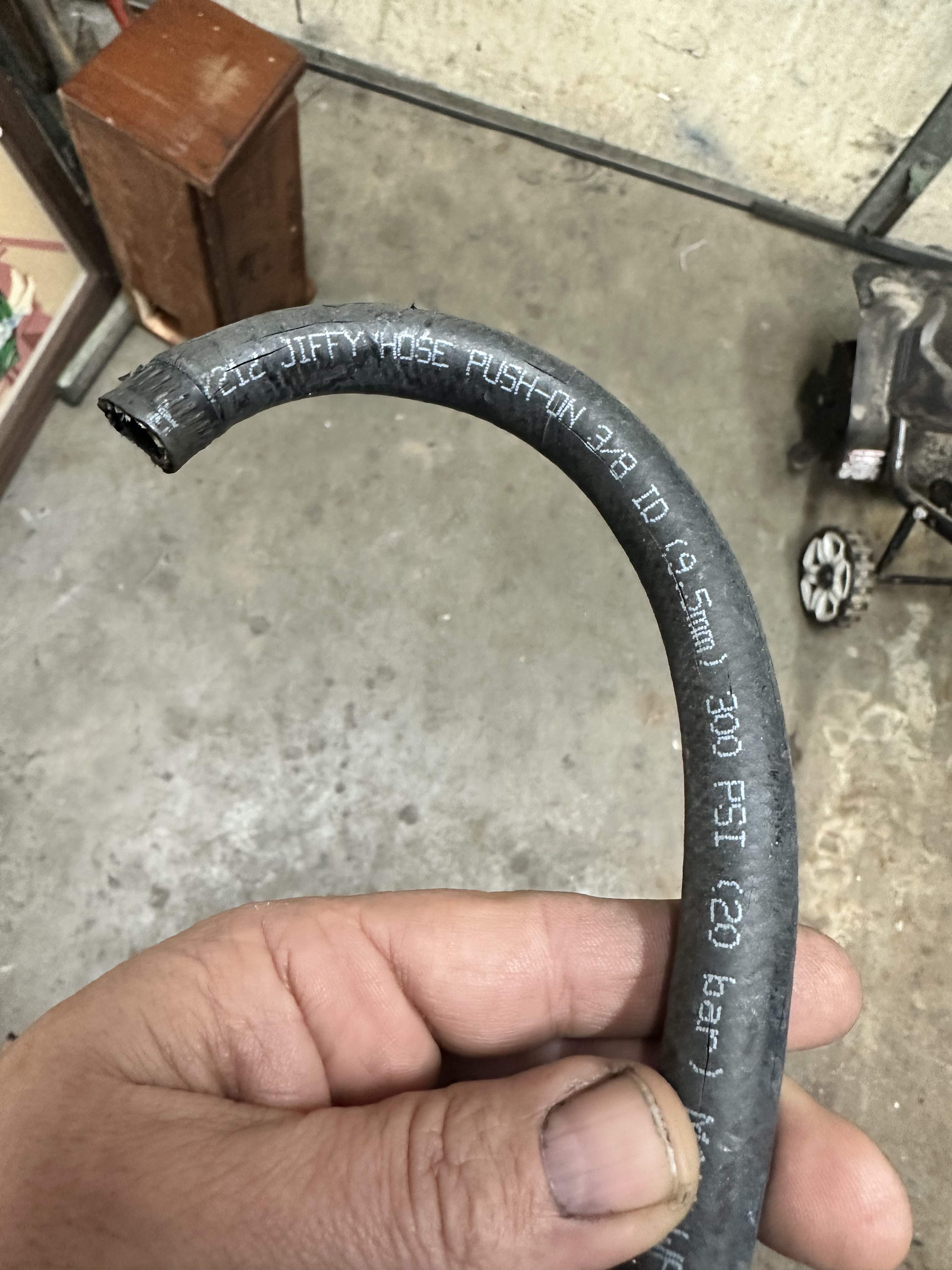

Seriously Kiwi, no more than 2 years old. The guy that was my neighbor up until last year works for a company selling fittings for big trucks and tractors. Thats who I was buying my fittings from. I called him and had him bring me a couple fittings when I put the first pump on. I went hard line from the pump to the carb and rubber from the tank to the pump. When he brought the fittings, he brought home that hose. Its stamped "Jiffy hose" I had never heard of that, so I made sure to ask if it was fuel hose and he said yeah, they sell it all the time for use on tractors. I have about a three foot section left on a shelf, so I pulled it and looked it over. It's even showing wear on it, not near as bad but it's showing age from justa sitting there.
I just walked out and took these. Look at the letters on the hose, those were facing up and you can tell that hose wasn't cleaned. The letters are bright white, its less than two years old bro. It's crazy.
Hmmmm....this disturbs me because that is a fire waiting to happen at the wrong time. I can think of a couple of things.
1. The hose is actually older than 2 years old
2. The hose is NOT rated to handle modern ethanol-based fuels or automotive chemicals
3. Seriously defective manufacturing
The fact that it is cracking like mad gives me the impression that it was left out in the sun, in Death Valley CA, for the last two years. Clearly this is not the case but that poor a hose is definitely defective and not safe. Did you get any other hose from this guy? Have you double checked the rest of your rubber hose to make sure other things aren't breaking down?

No Frosty, the fuel system parts were the only parts I got from him. Being I went hard line for as much as I could and he sells fittings I got them a bit cheaper, and I knew nothing about AN fittings it justa seemed logical at the time. I agree with yall, that hose looks like it's been on the car since 1963. I can't say how old the hose actually is, or how long it was laying in their parts room, but I can say it was installed within the last two years and looked decent when I installed it.

i agree with Frosty, it doesnt say its for gas on the hose ! all the fuel line i have ...and i justA went and looked has ...
"fuel hose" followed by a sae number
