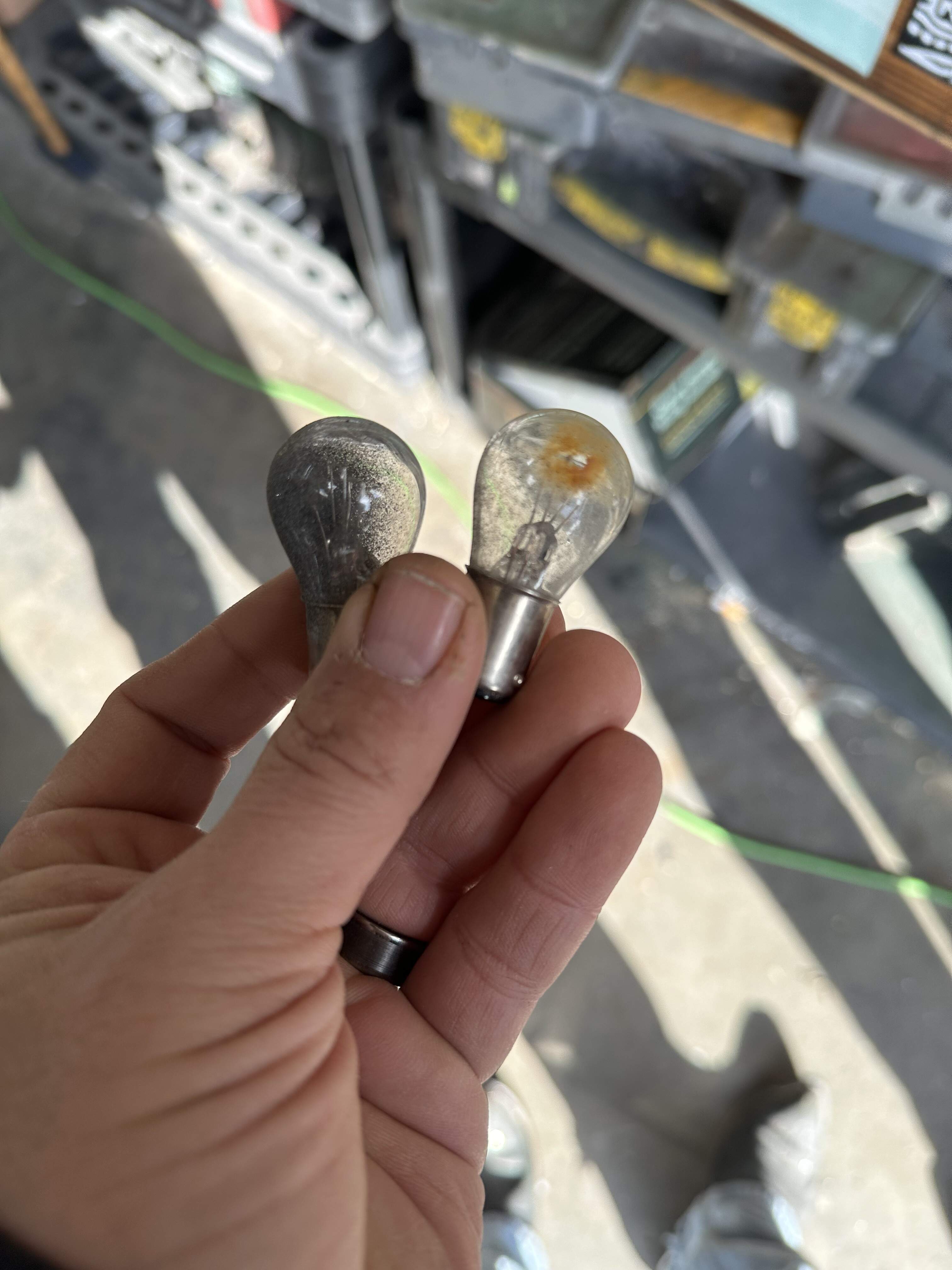

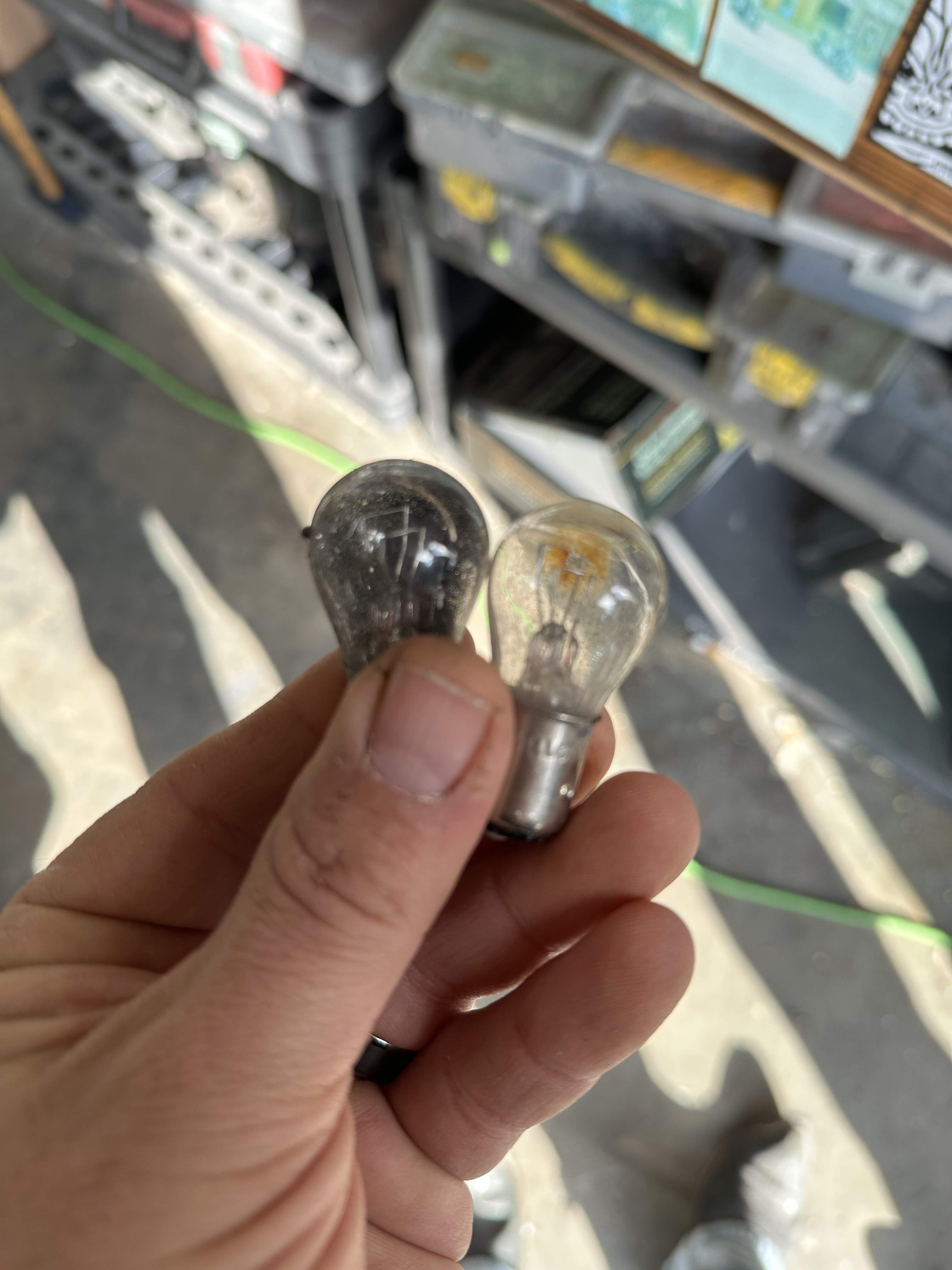

So, I figured I'd start with the easiest solution first, the bulbs and then mess with the wiring if that didn't help. I pulled the driver's side taillight bulb and seen a burnt spot, "shit, these are my painting bulbs"! Pulled the passenger's side and 1 filament was glowing red like a cigarette lighter. Popped in the new bulbs and all gauge and cluster lights shut off. Pull the head light knob and all popped on. Yes, I pulled knob and pushed it in about a hundred times justa to make sure. The pics are of the bulb's I put in while painting so I didn't get paint in the socket. Thanks again guys, I would've never thought a bulb would cause that kind of an issue. Was so busy today I totally forgot to get pics of exhaust tips. I'll try too tomorrow.

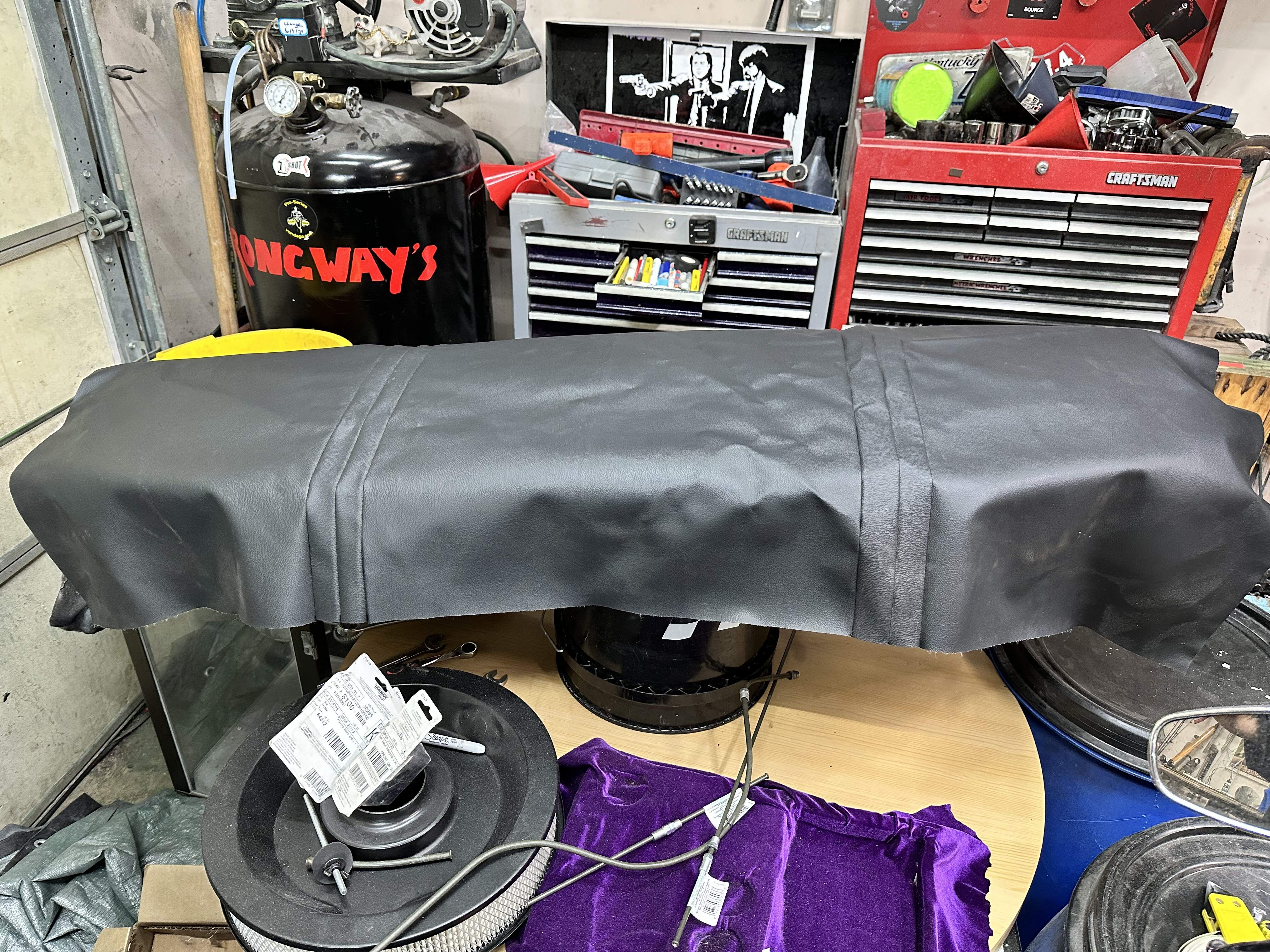

So I told yall about my dash pad getting messed up when the lady next door garage flooded. I have since striped it down and repadded it. I used the air stapler yesterday to attach a copper line to a piece of wood for a coffee pot I built, (long story), and today the damn thing wouldn't work to staple the dash cover onto the dash! Thats how my luck goes.

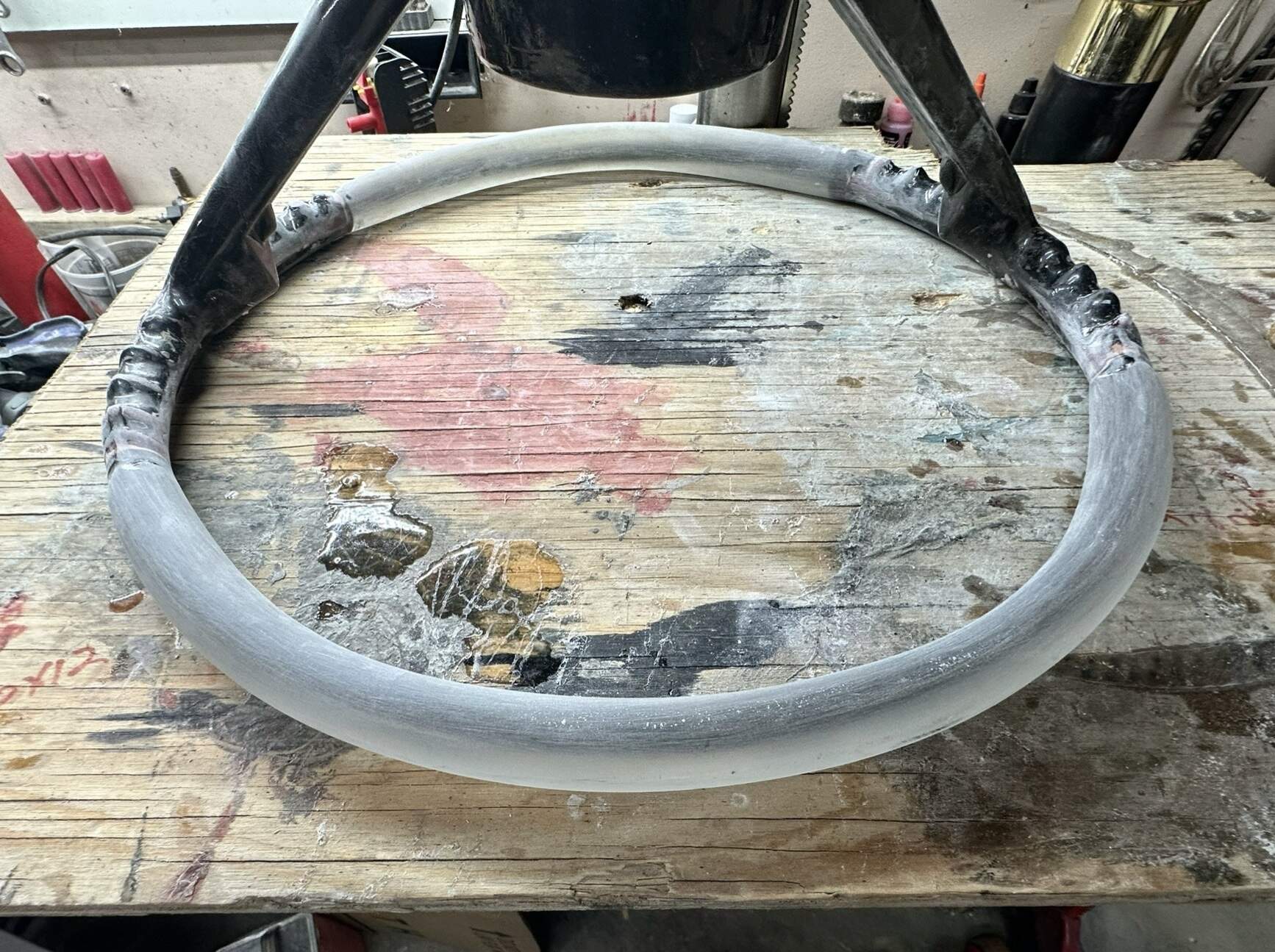

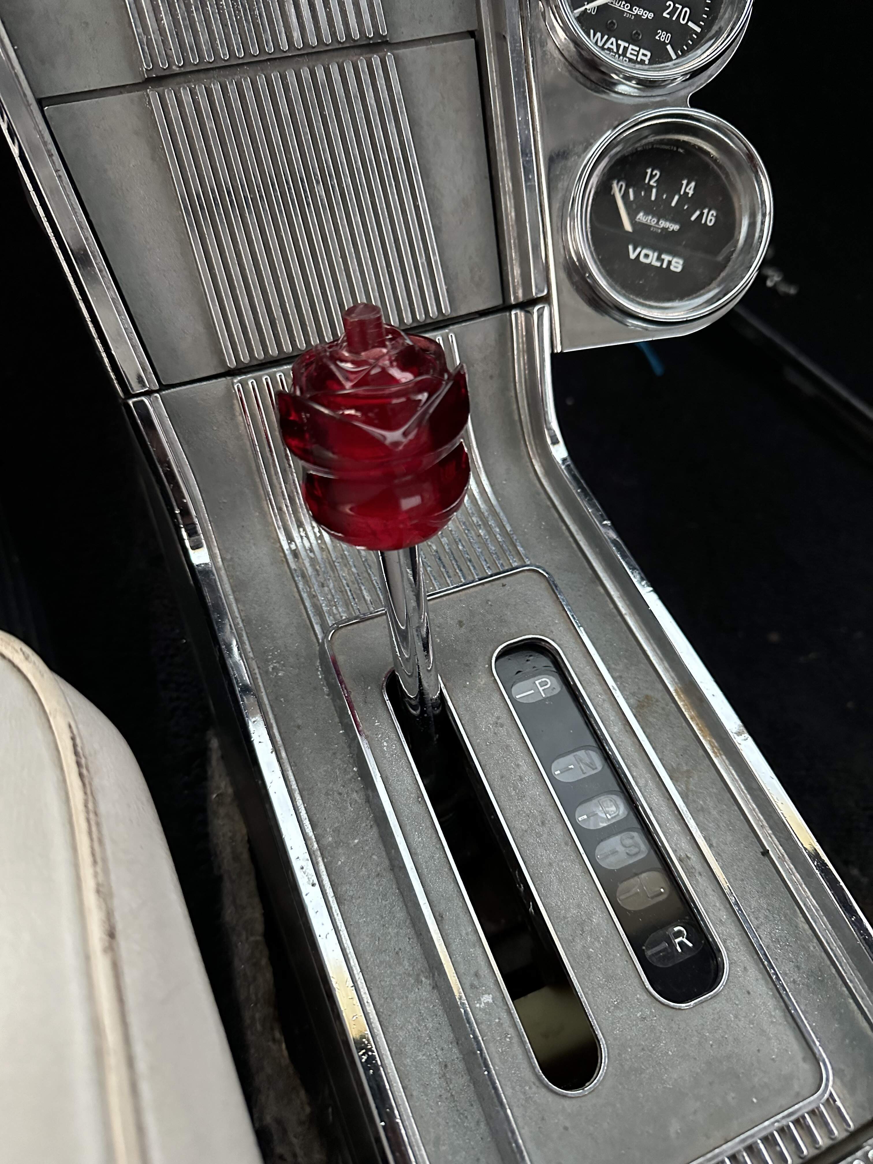

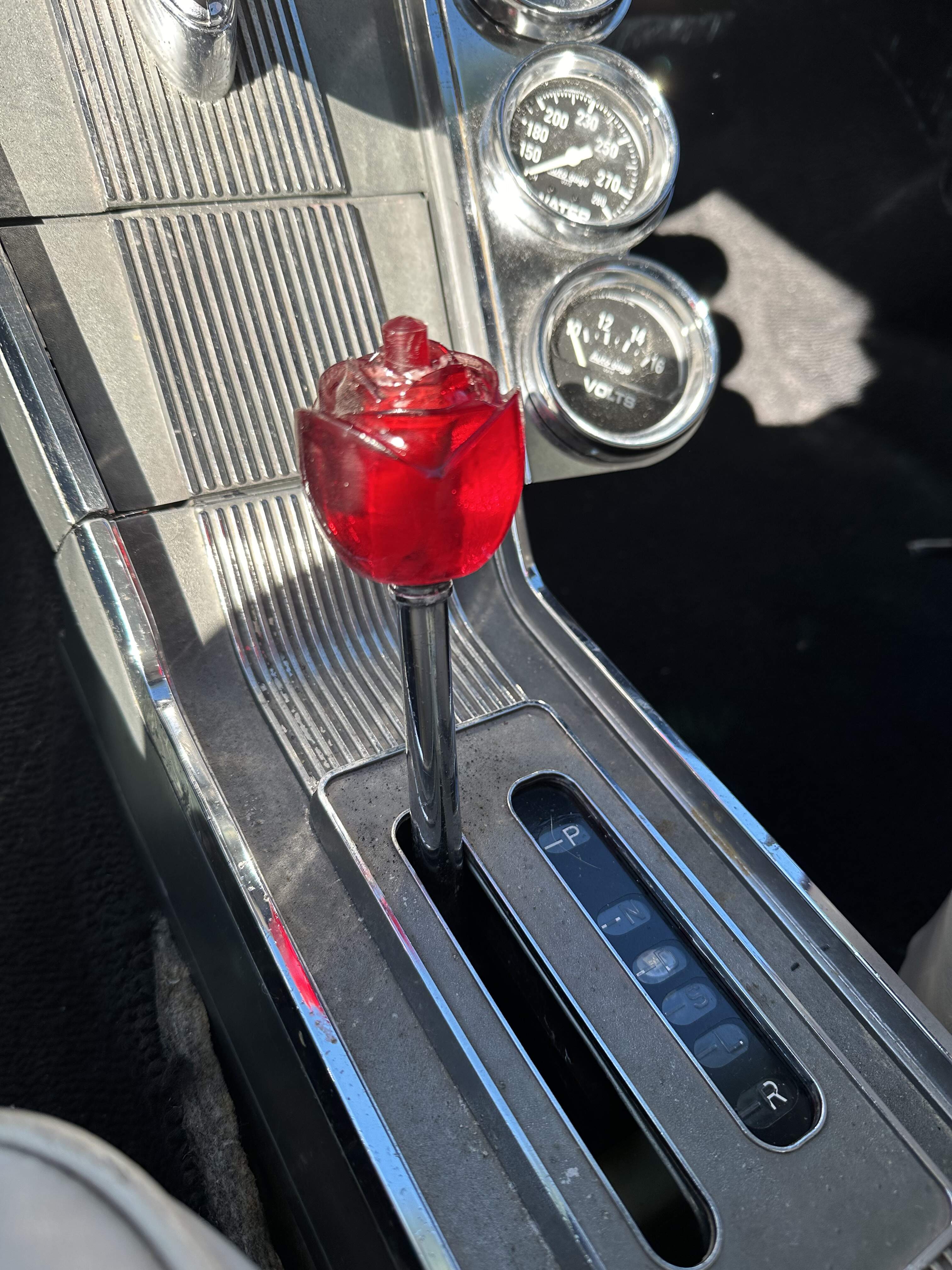

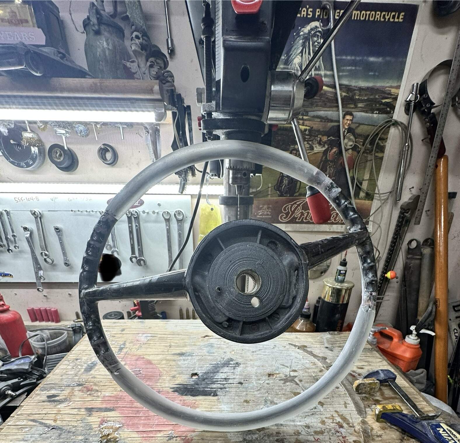

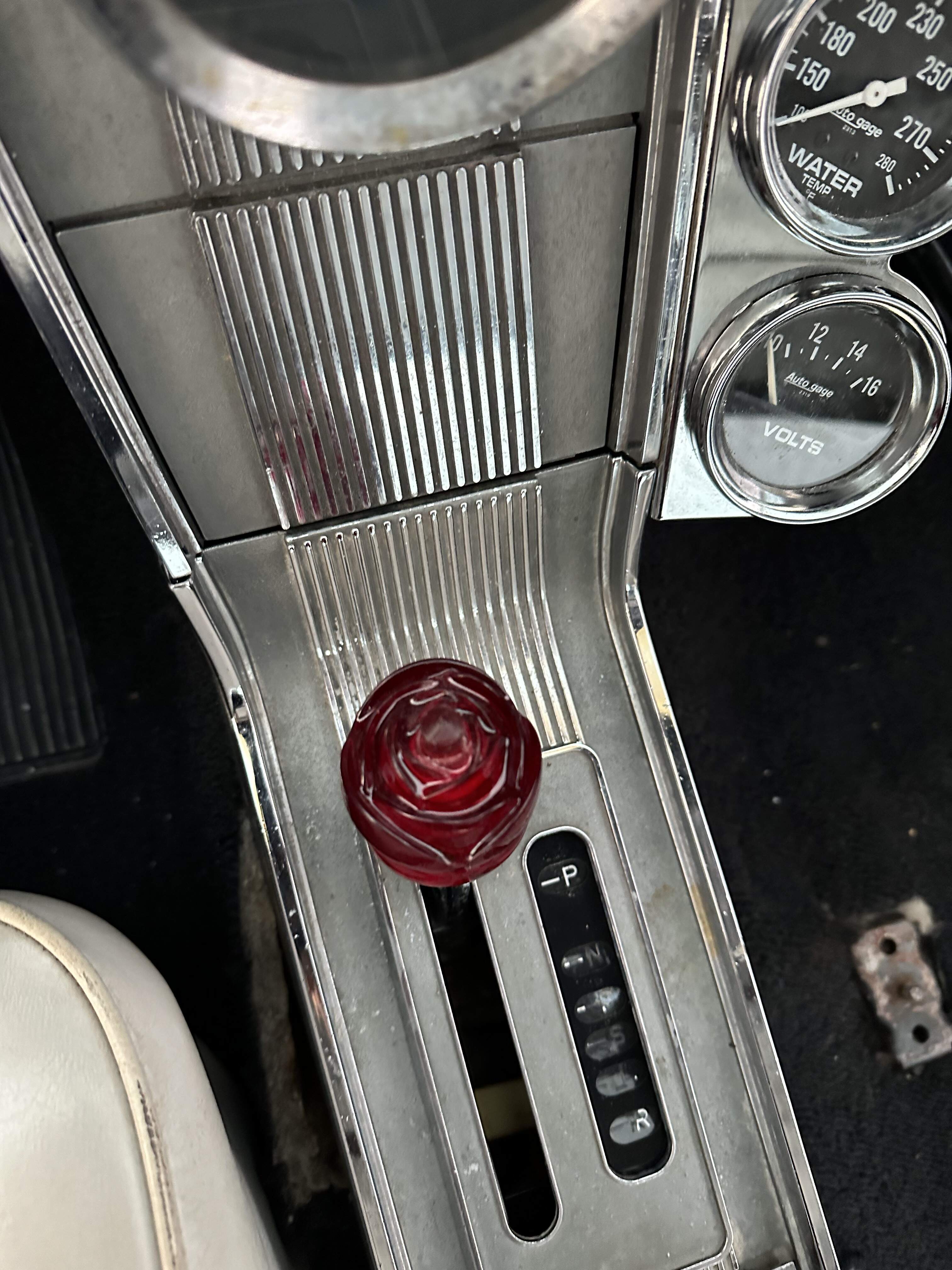

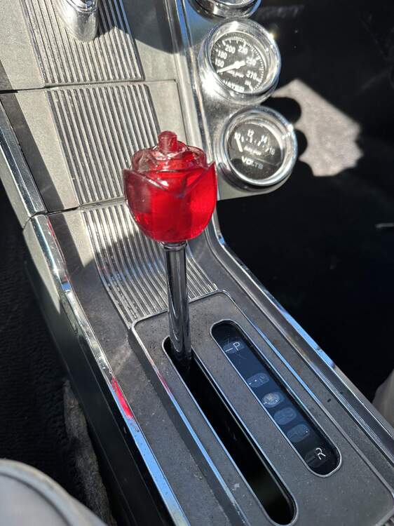

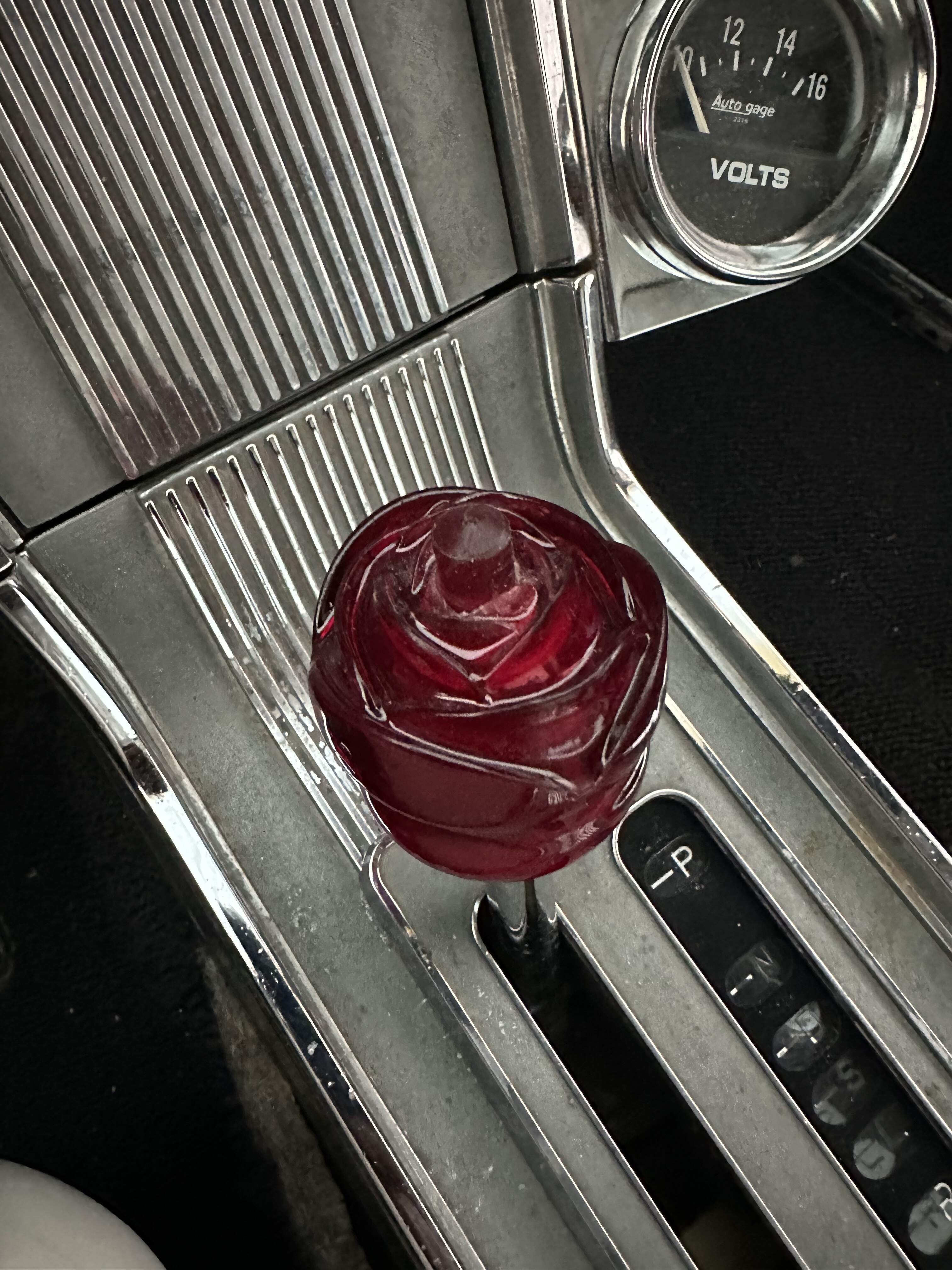

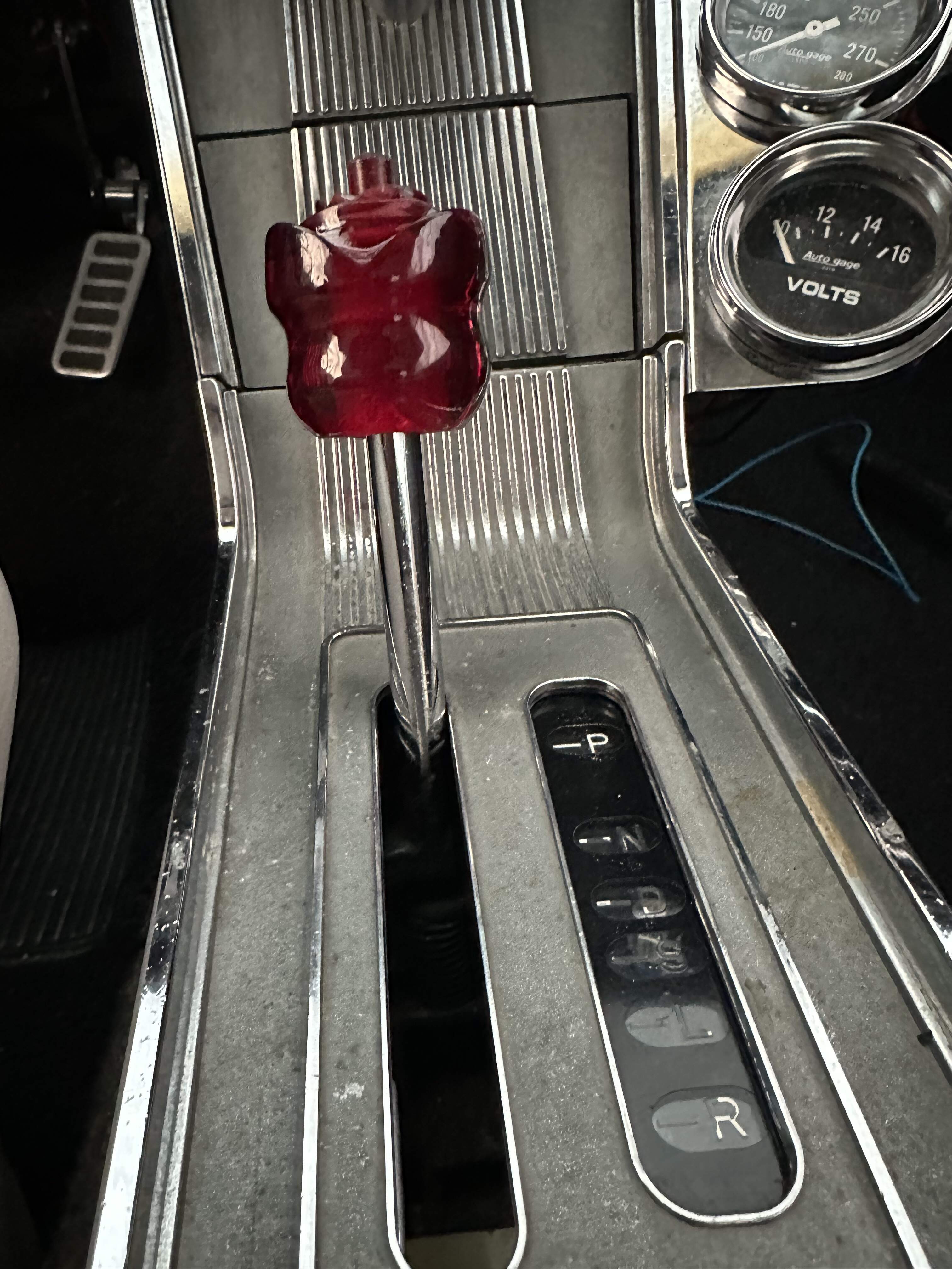

I also showed you the spinner knob I was making, well it's NOT finished yet. I have to wait until the steering wheel is finished to size up the bracket. But I did make a matching shifter knob. Remember, her name is Rose. The first picture was right after I finished it, but it felt too wide and uncomfortable. The last pictures were after I cut a finger grove and tapered down the bottom. Much more comfortable.

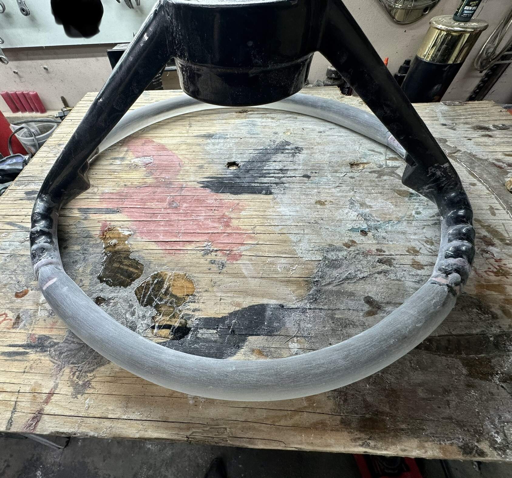

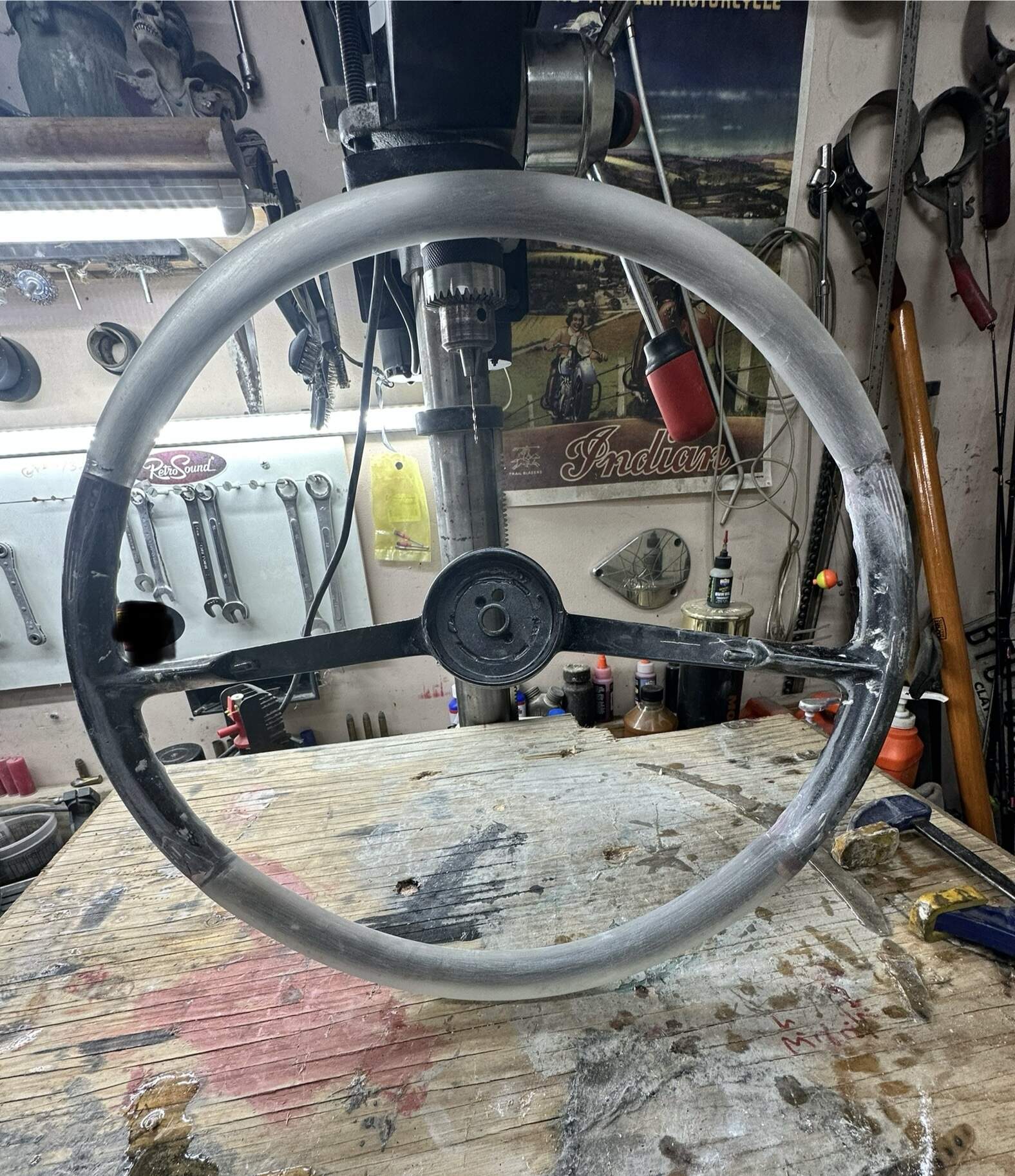

I am back to work on the steering wheel. I've got it down to a "good" size and justa need to apply another coat of acrylic to make it clear again. Hopefully that will be the last coat and then clean it up and repaint it.

Shifter is very cool.  Is the button for ROSE flavored NOS? :rofl:   Awesome job buddy thankz for the update and pic's, BUT.... I was looking forward to seeing your exhaust.  :clapping:
