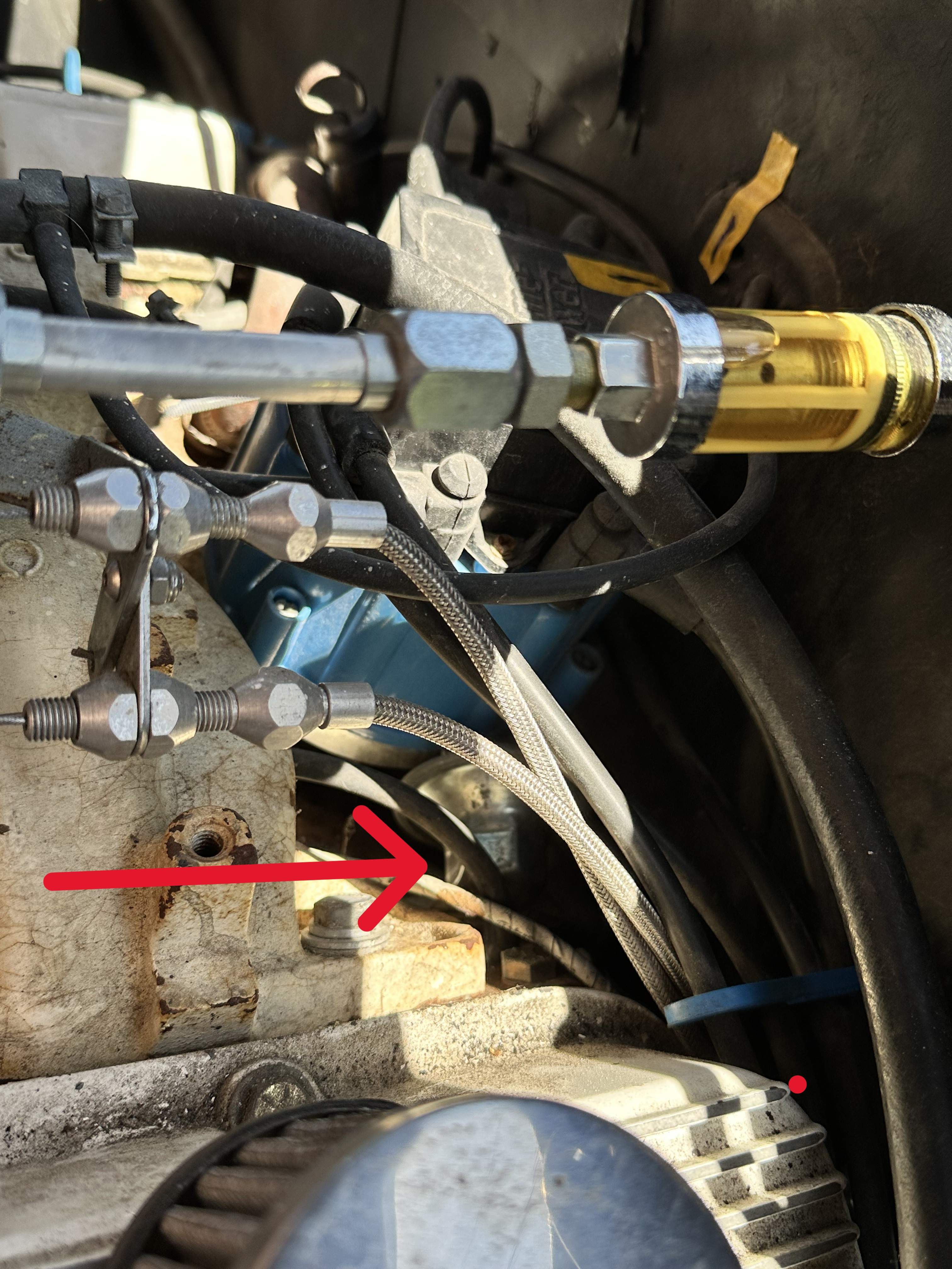

So, the rain finally stopped long enough to get Rosey running today. Shes running a bit rough but I'm guessing it's a combination of last year's gas and the timing being just a bit off. She's real slow to crank, will go about one and a half real slow turns then fires up. The plan was to get her up to temp and adjust but then it started raining again. So, if the rain holds off, I will check and adjust the timing tomorrow or Saturday. The little bit of time she was running I was able to get the fuel pump regulator dialed back to 6psi.
So, I played with the timing a couple days ago. Only got two adjustments before the battery was too low to crank. I've had it on the charger for the last couple of days and decided to try it again today. Only got a couple of starts before the battery was drained again. So, picking up a new battery this weekend. But I have a question, in the picture you can see the bell on the side of the distributor where the vacuum hose hooks up. As I pull it towards the front of the car, she gets a little smoother but still hard to start. I can't go any farther because that bell hits the block. I had a fella tell me last year that I can move all of the plug wires on the cap over one hole and restart with the bell against the firewall and start moving it forward again. Is this correct? If so, exactly how does that work and what do I need to do?  Move them all to the left or?
JustA pull the dizzy mate and rotate it anti clock wise 1 tooth 👍
Or yeah like you said move each wire one spot anti clockwise 👍

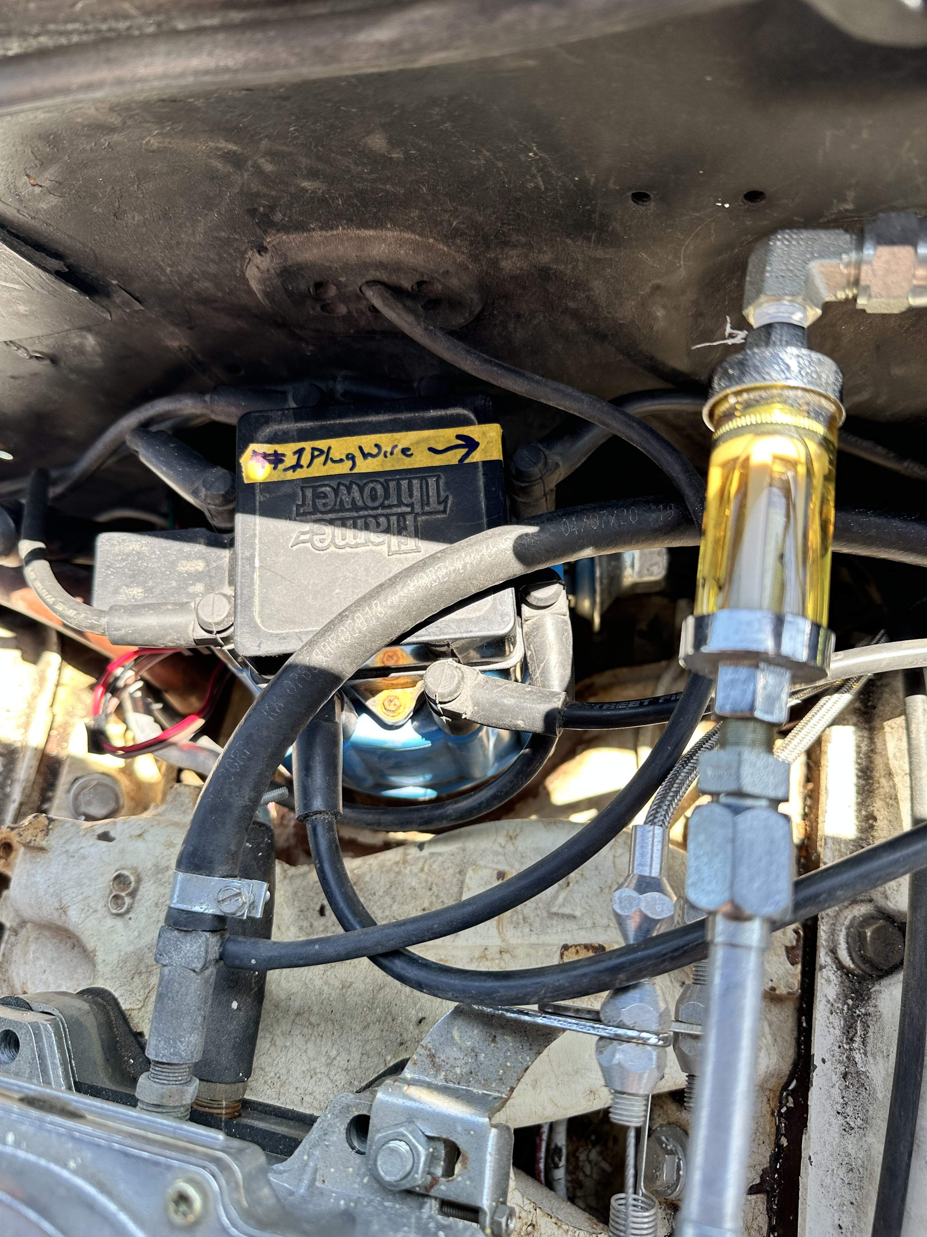

I see with that great big dizy you so don’t have a lot of room to turn aye !!!
I can’t see by the pic mate
but is turning the housing 180 degrees an option to give you more adjustability ?
JustA thinking about it mate
one option is the vacuum canister can be removed. You can then set your timing and then sort fitting it back on
you don’t want it working while your setting timing

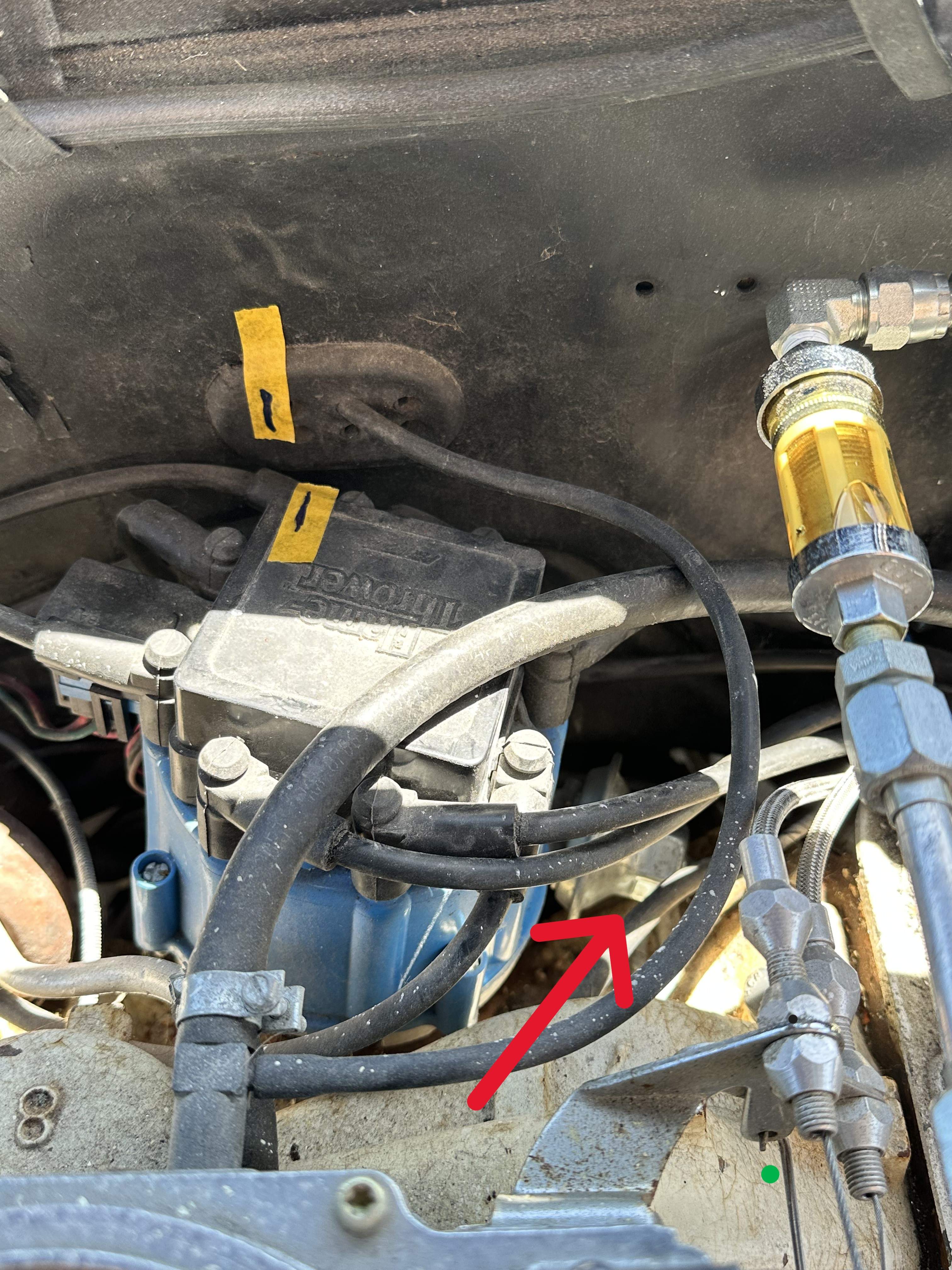

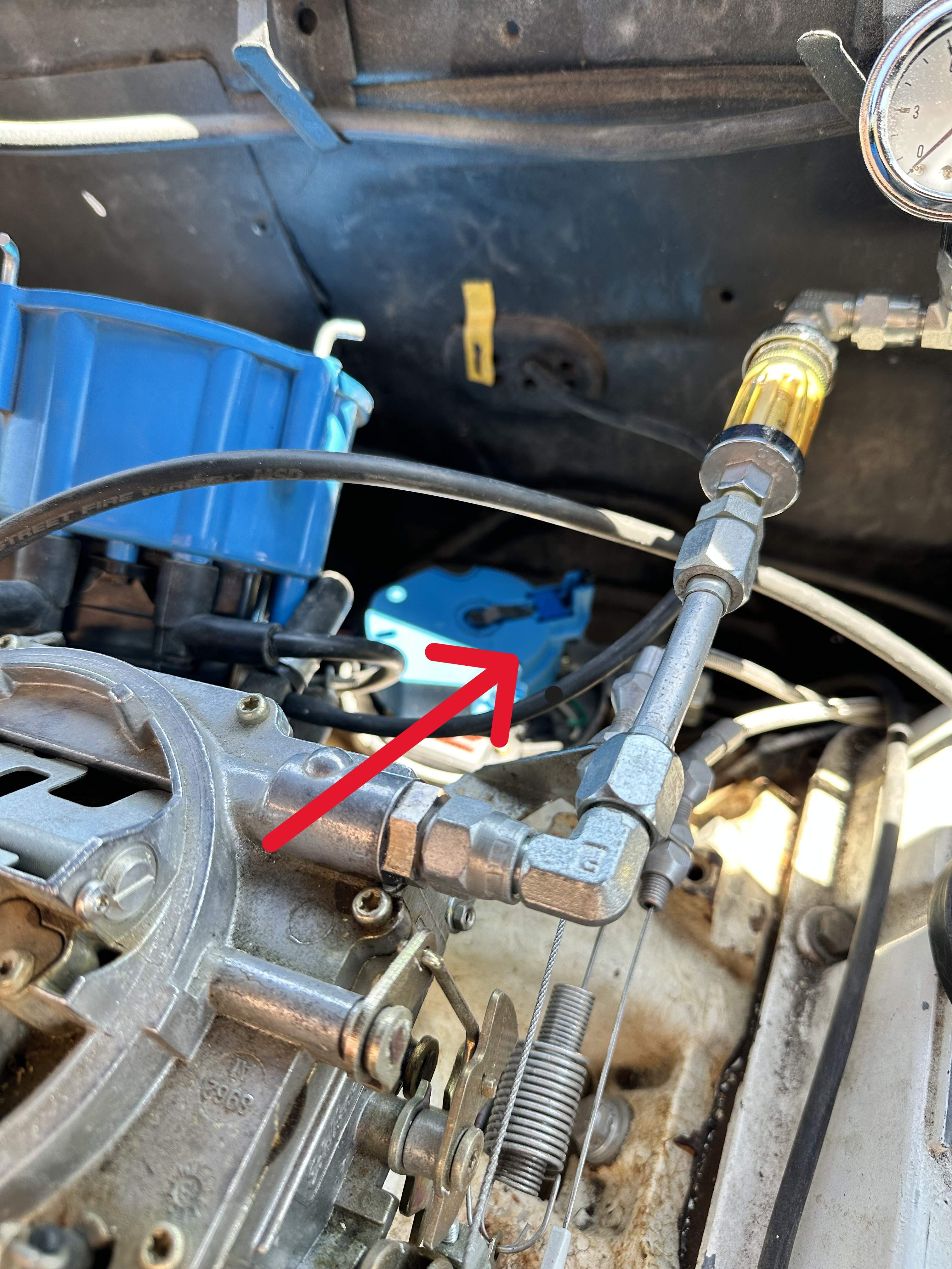

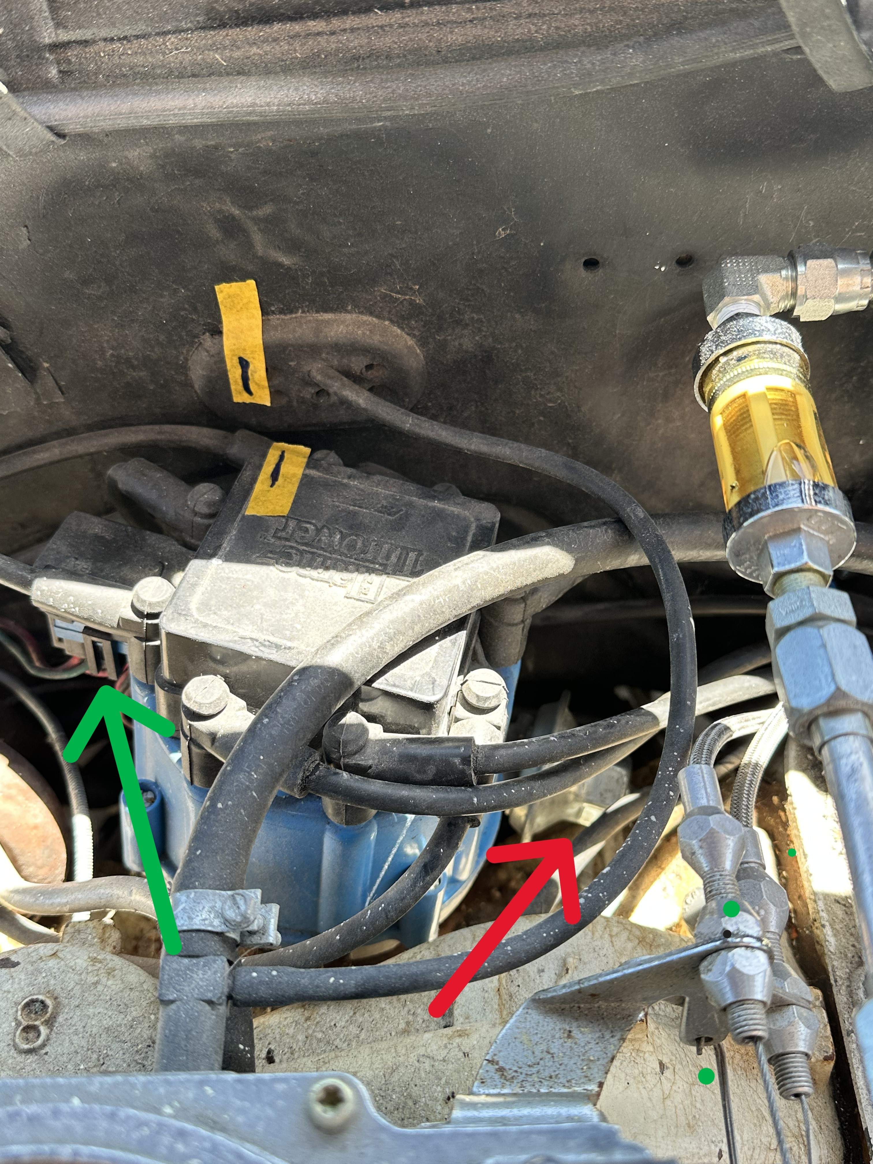

Yeah, its huge bro. I don't think turning the cap would be an option because there are two plugs on the top left of the cap (green arrow) that go to the distributor itself. One powers the HEI I think, and one is for the tach. If I'm wrong, please let me know. I can take better pictures or videos tomorrow if it helps.
The vacuum can CAN be removed??? I wasn't aware of that. How does that work?
This sure would be simpler if GM had justa put the damn distributor in the front of the engine where it belongs! You know, like another unnamed Motor Company did! :rofl:
Fitzy,
So, It's an HEI distributor not an OEM points, but that shouldn't matter if I'm understanding you correctly. I can turn the distributor however I want, as long as all the marks line up, Is that correct? If you look at the picture, I'm not sure there is room to turn it any other direction. Thats part of the reason I think I put it like it is. But hell, I may have put it like it is because that's what the picture it the book looked like :lol:

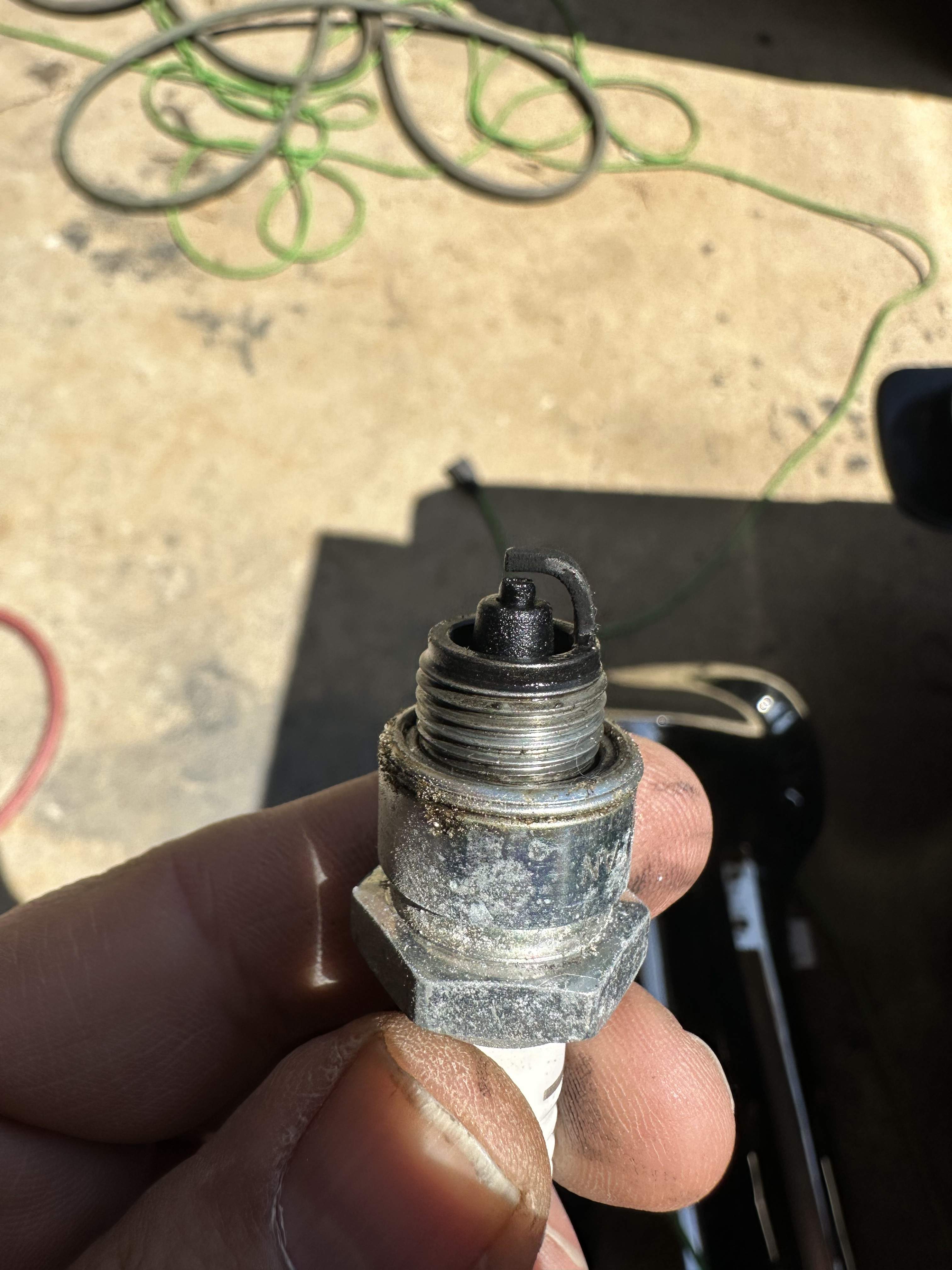

So around 4am I decided to justa start completely over. So after coffee, I pulled all the wires, all the plugs and I checked everything and reset everything back to ground zero. The plugs were still soaked in gas from yesterday when I pulled them so I cleaned and regapped them (NGK XR5) TO .39. I reread what yall said and went from there. I did disconnect the vacuum and plug the carb also. The first try on cold start she backfired through the carb, I pulled the vacuum advance clockwise about a 1/2 inch and she fired up. Pretty easy start. Let her run about 10min and shut her off. Went to restart and slow to start, I believe that's do to battery so she's charging as we speak. I did justa adjust the carb back to factory setting (screw in back out 1 1/2 turns) and when she starts, I will hook up the vacuum hose. Did I miss anything?
