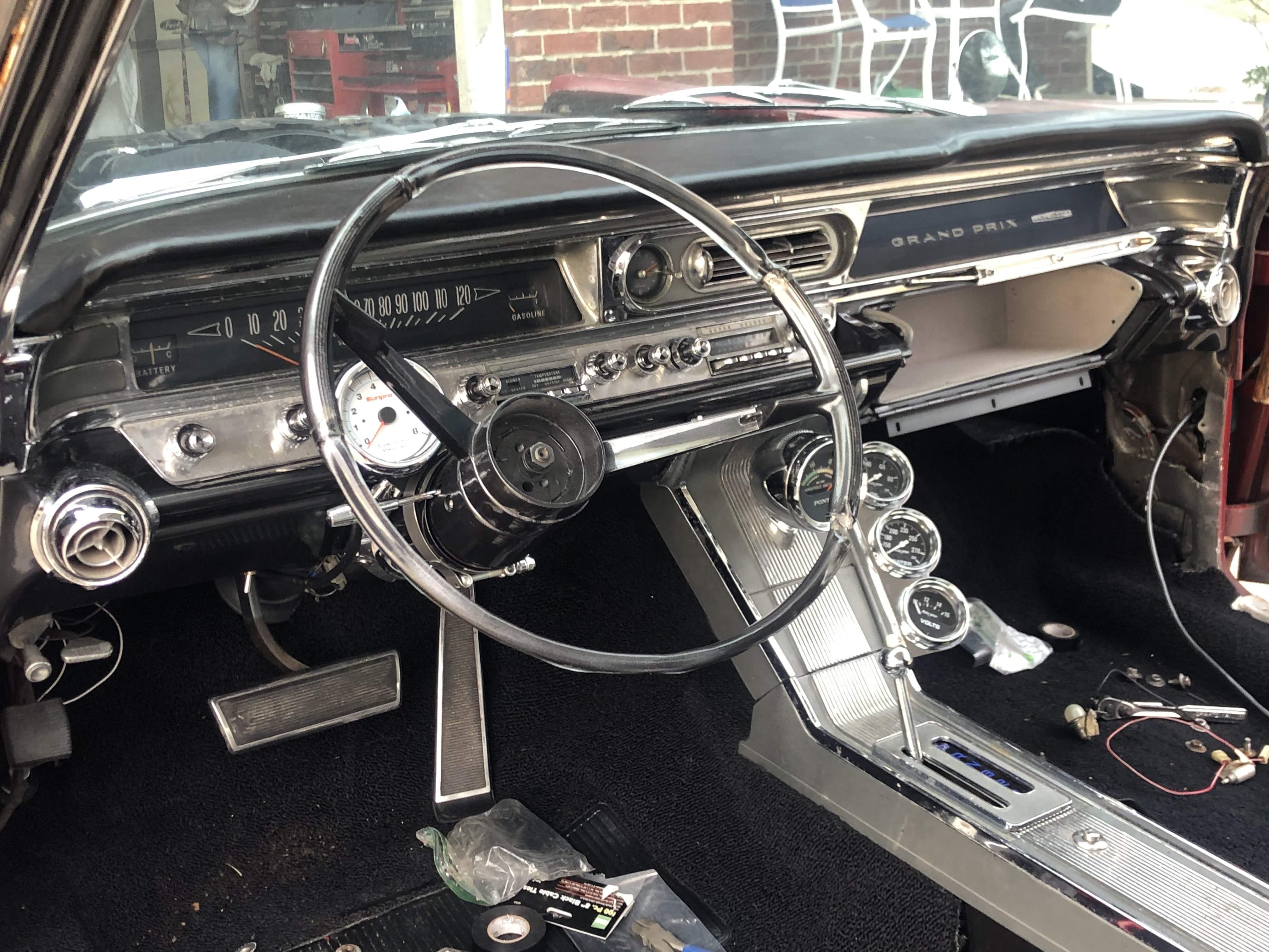

I justa sent them an email bro. I talked to a guy from Ney York a couple of years ago.  He claims to have to original tooling that Pontiac used to male these steering wheels. He can only redo the factory colors and quoted me $1600 to redo my steering wheel. That was way too high for me. Here's where I'm at. It's almost done, but I've a few more things I need to work out before I'm satisfied. I got to this point and got aggravated and hung it on the wall for about 2 years :lol2: now that the engine is running and sounding "right" I figured I'd go back to working on this while waiting for the T block for the brakes.

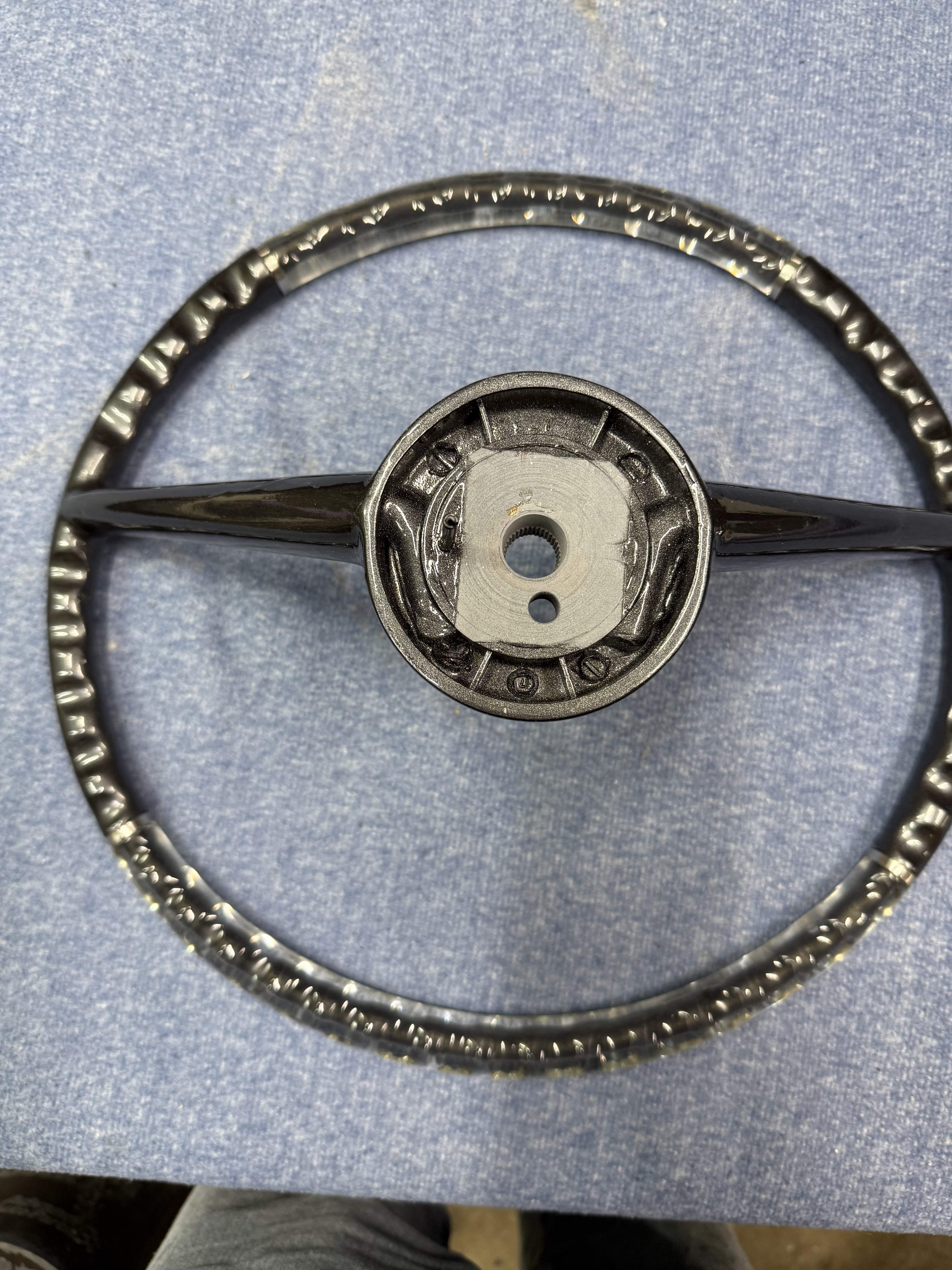

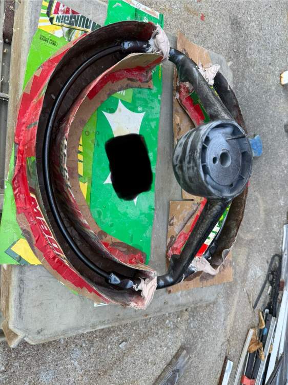

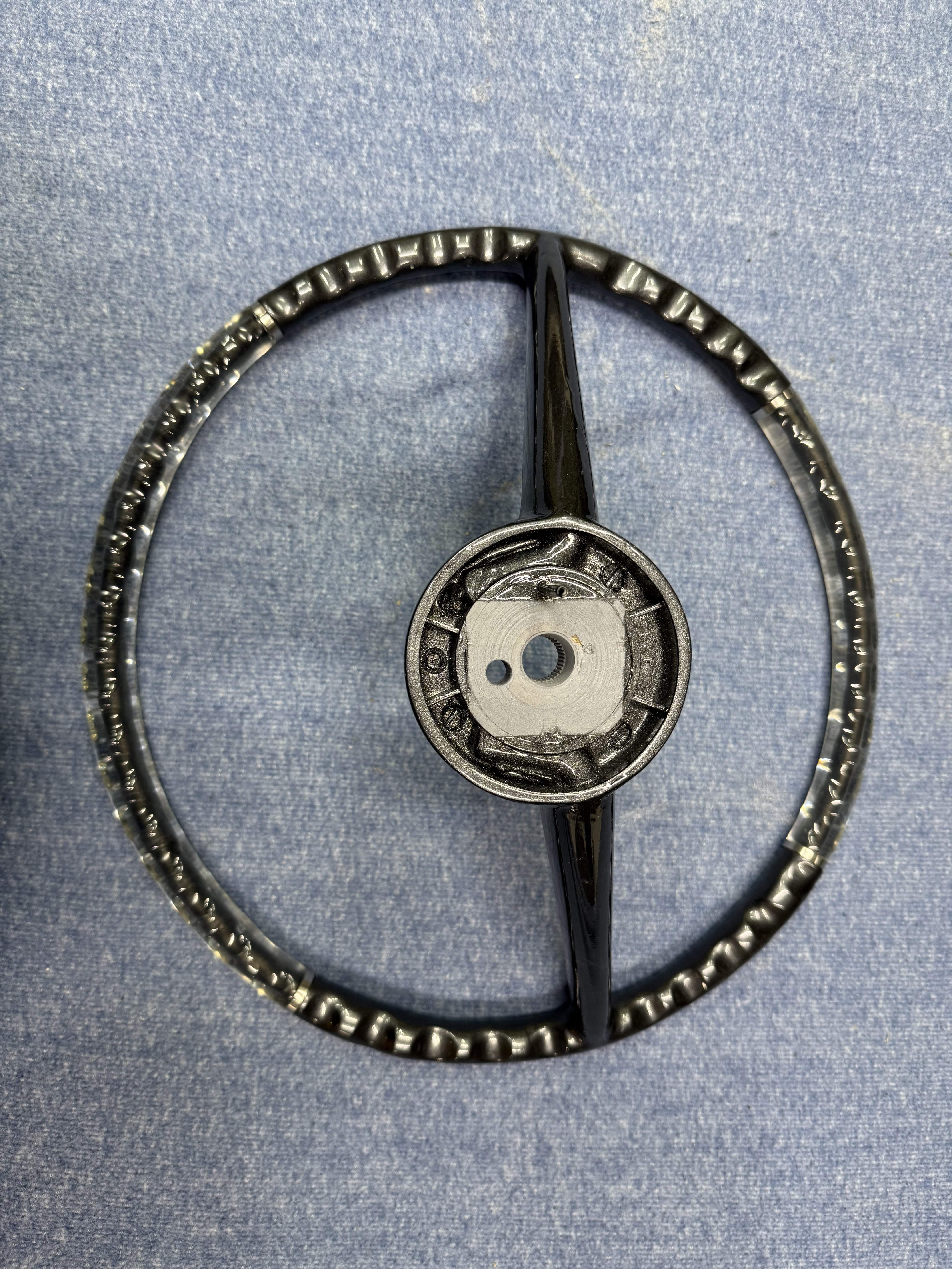

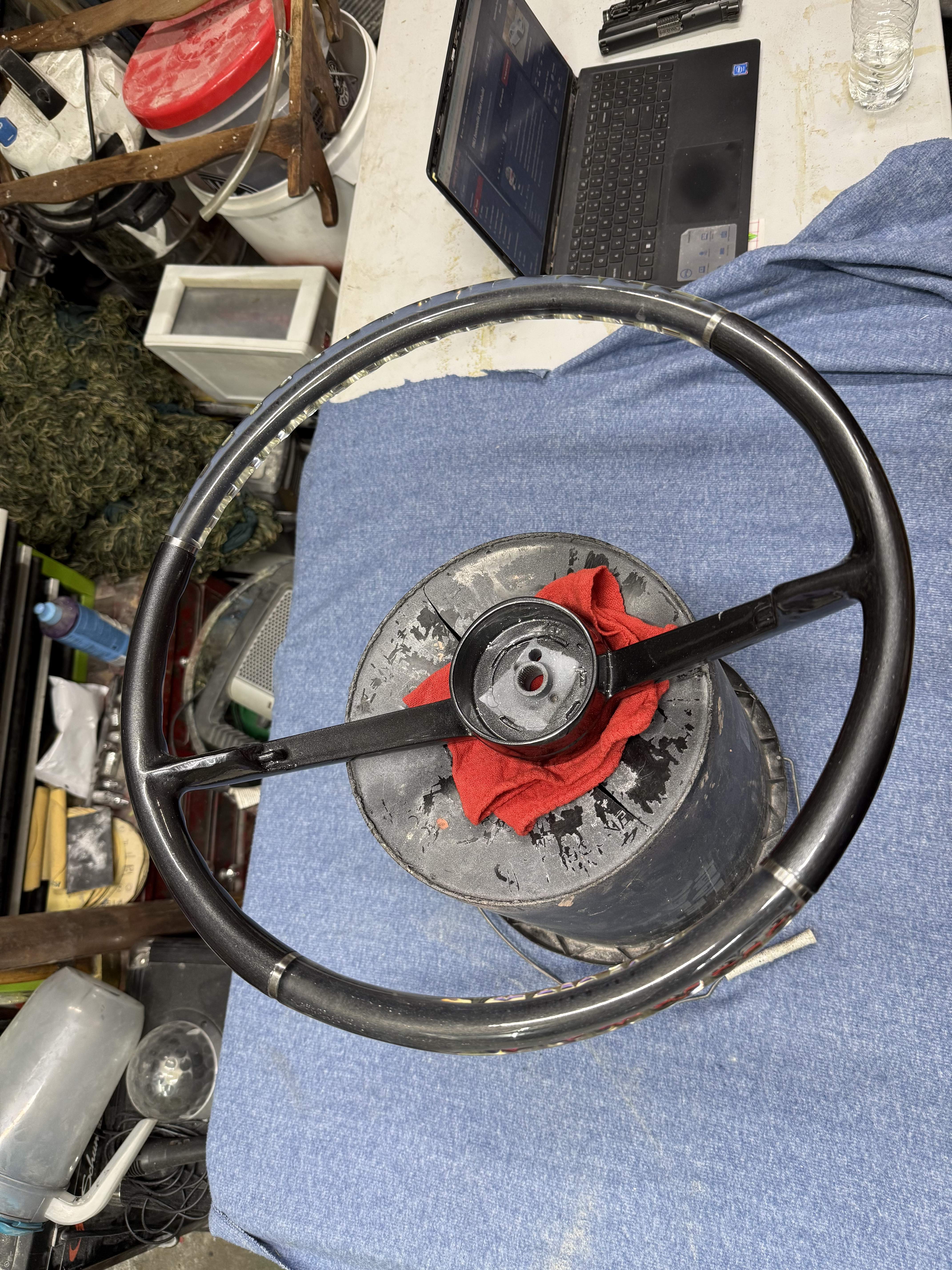

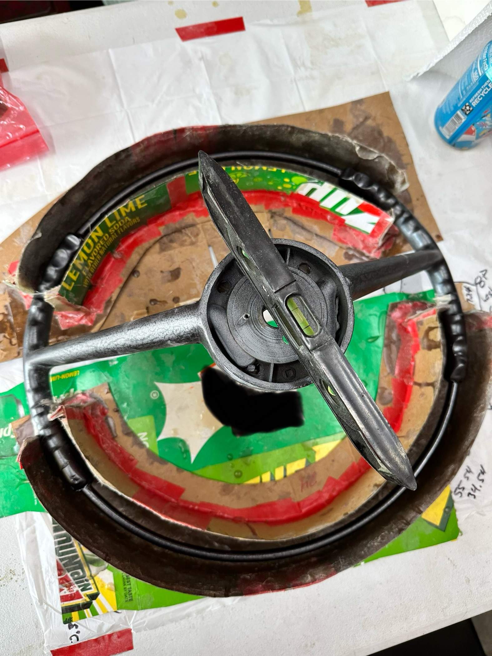

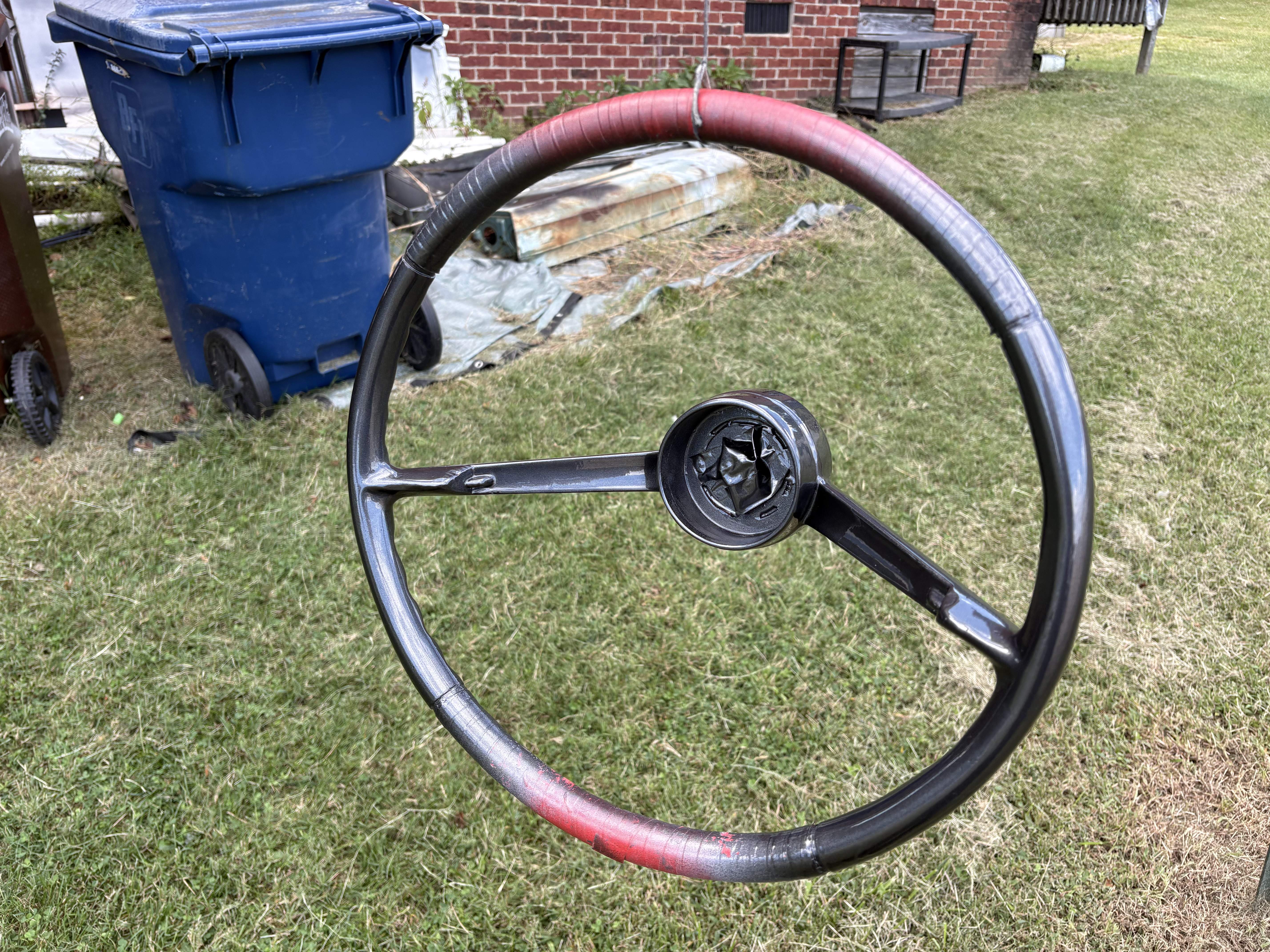

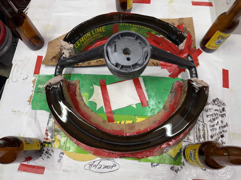

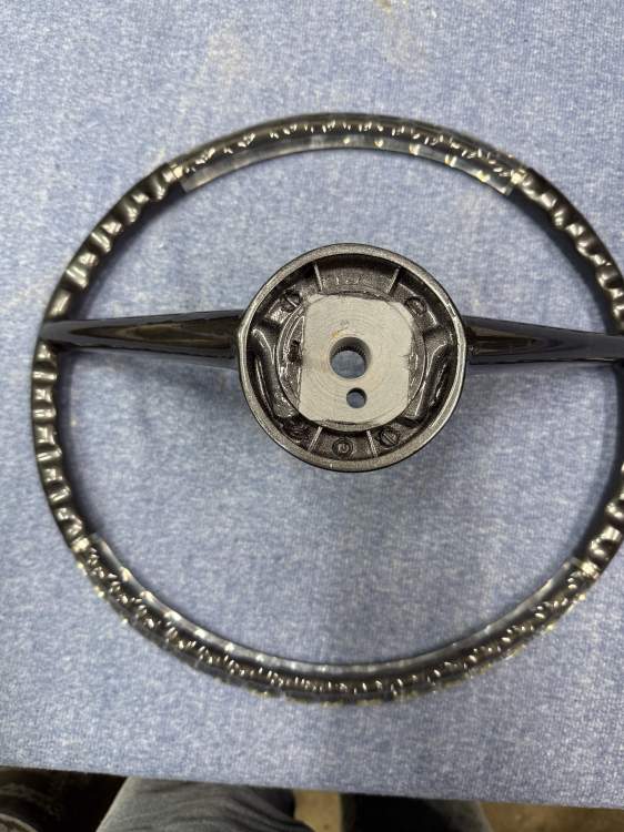

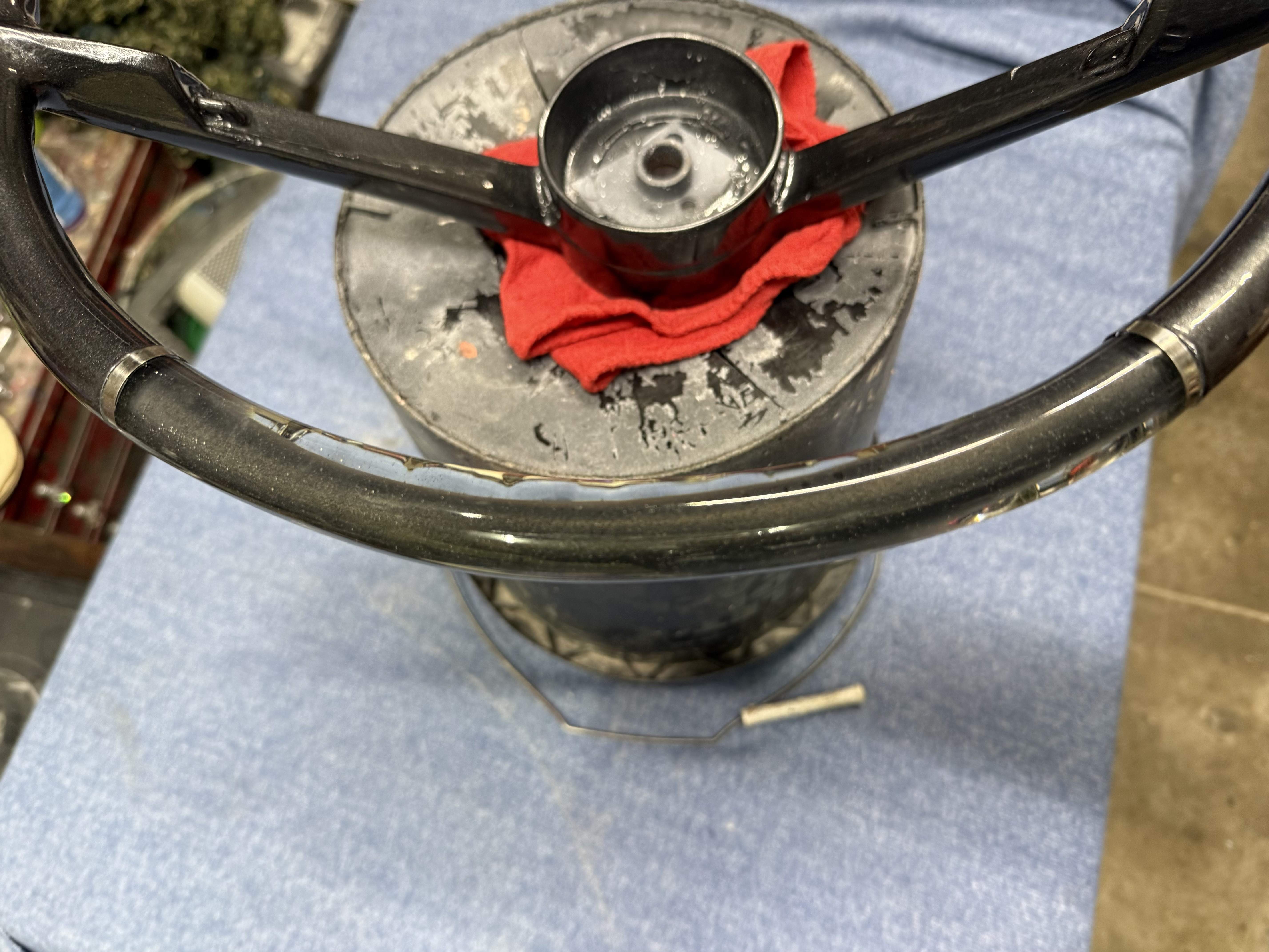

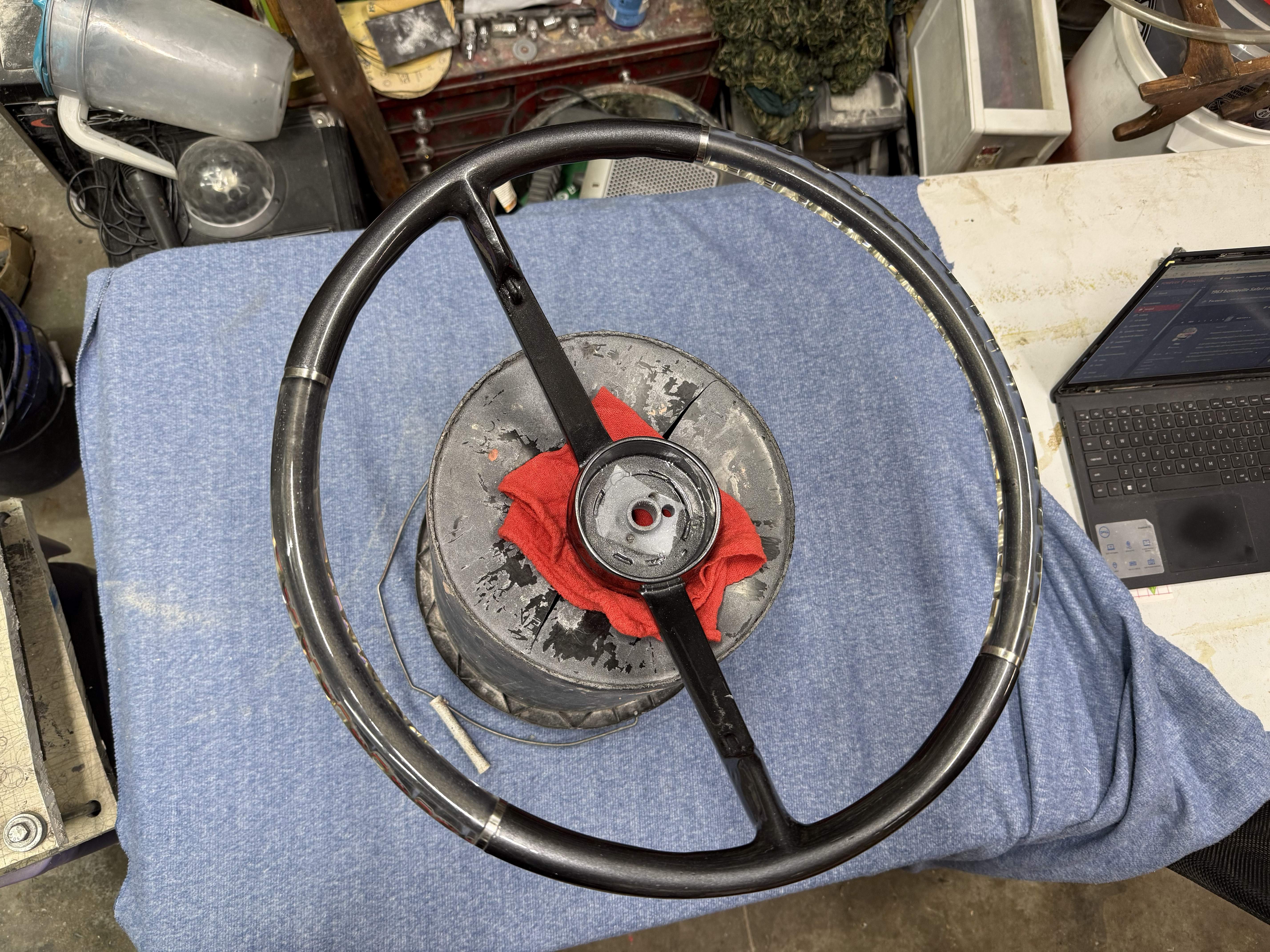

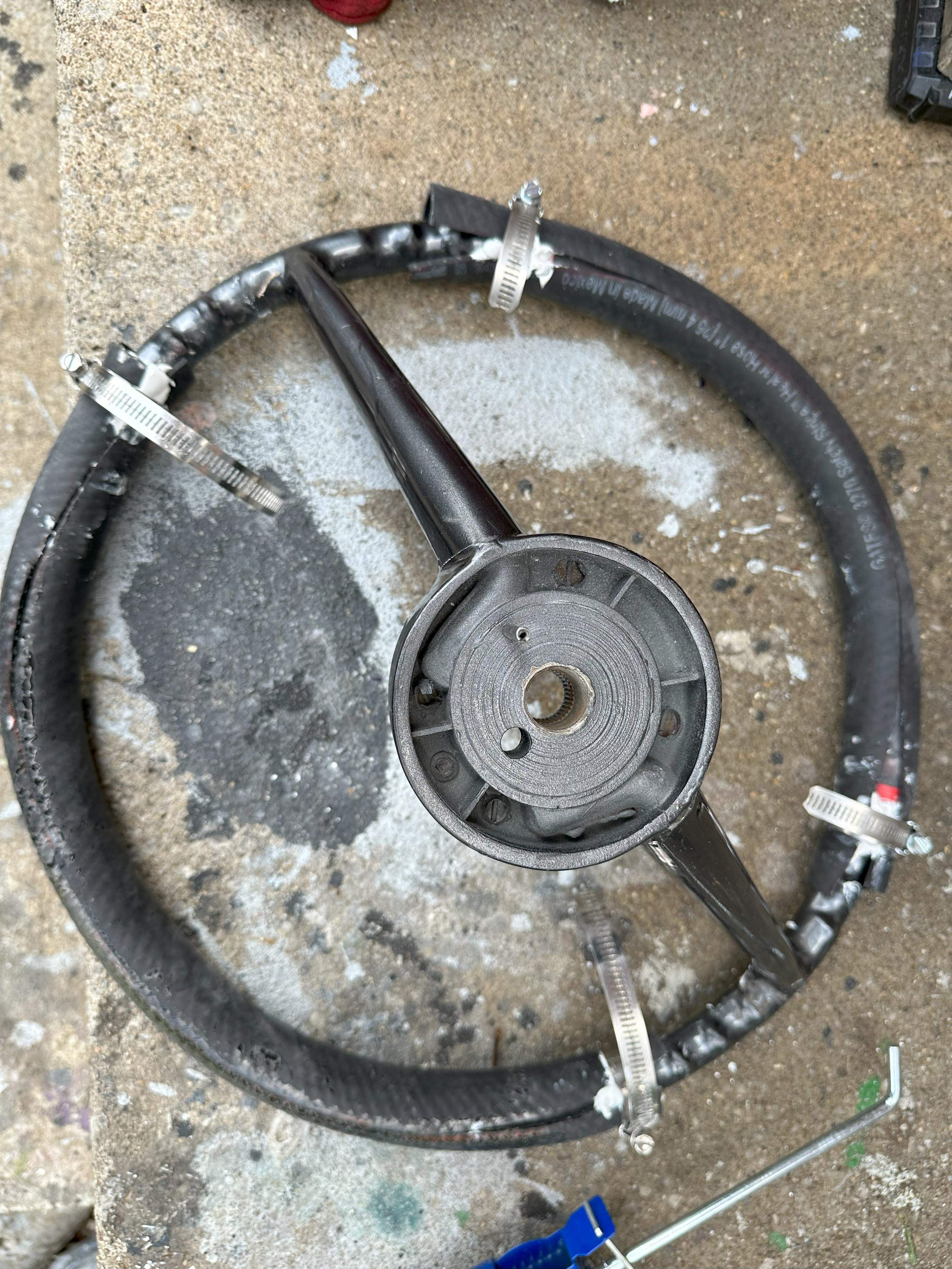

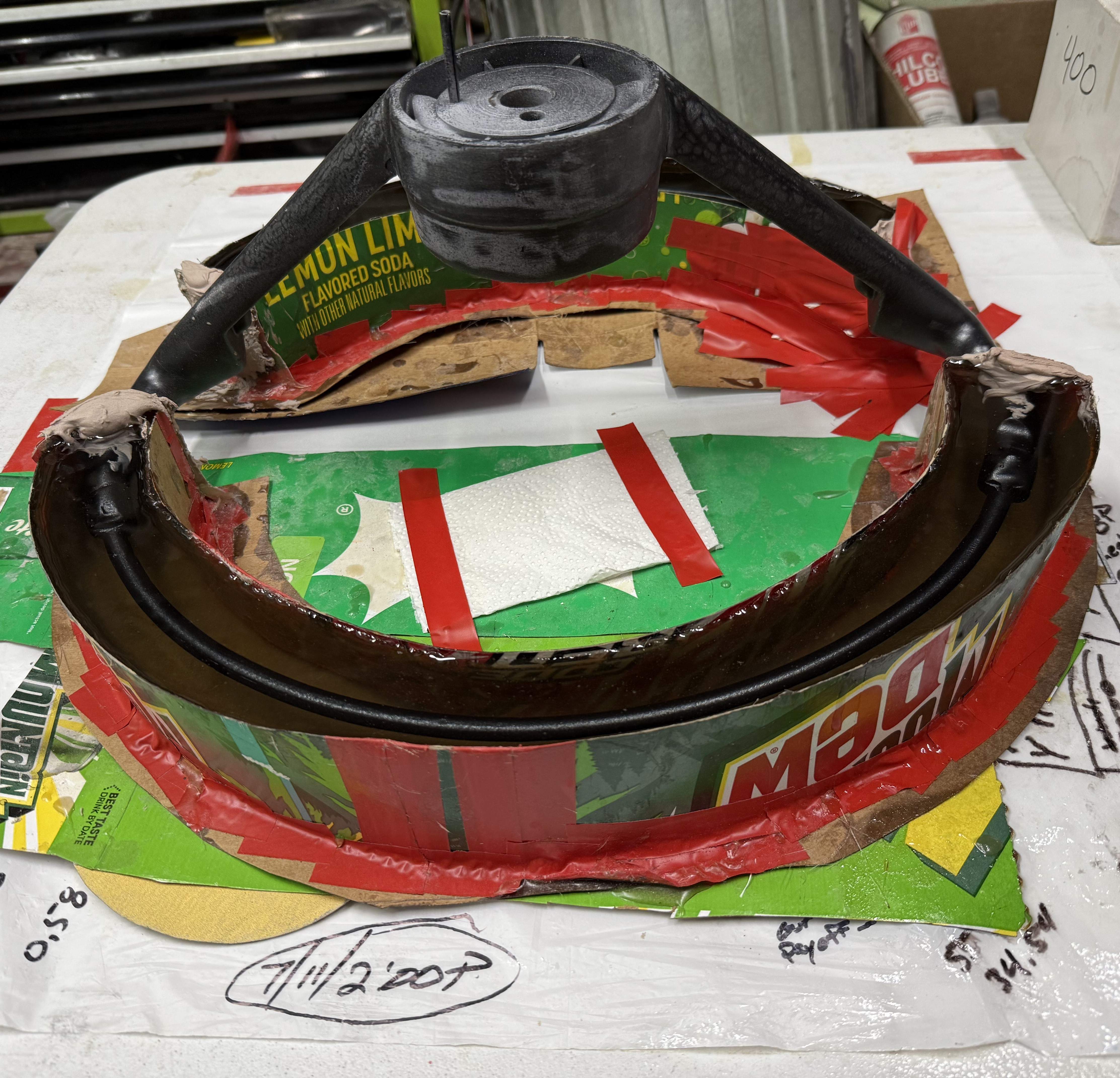

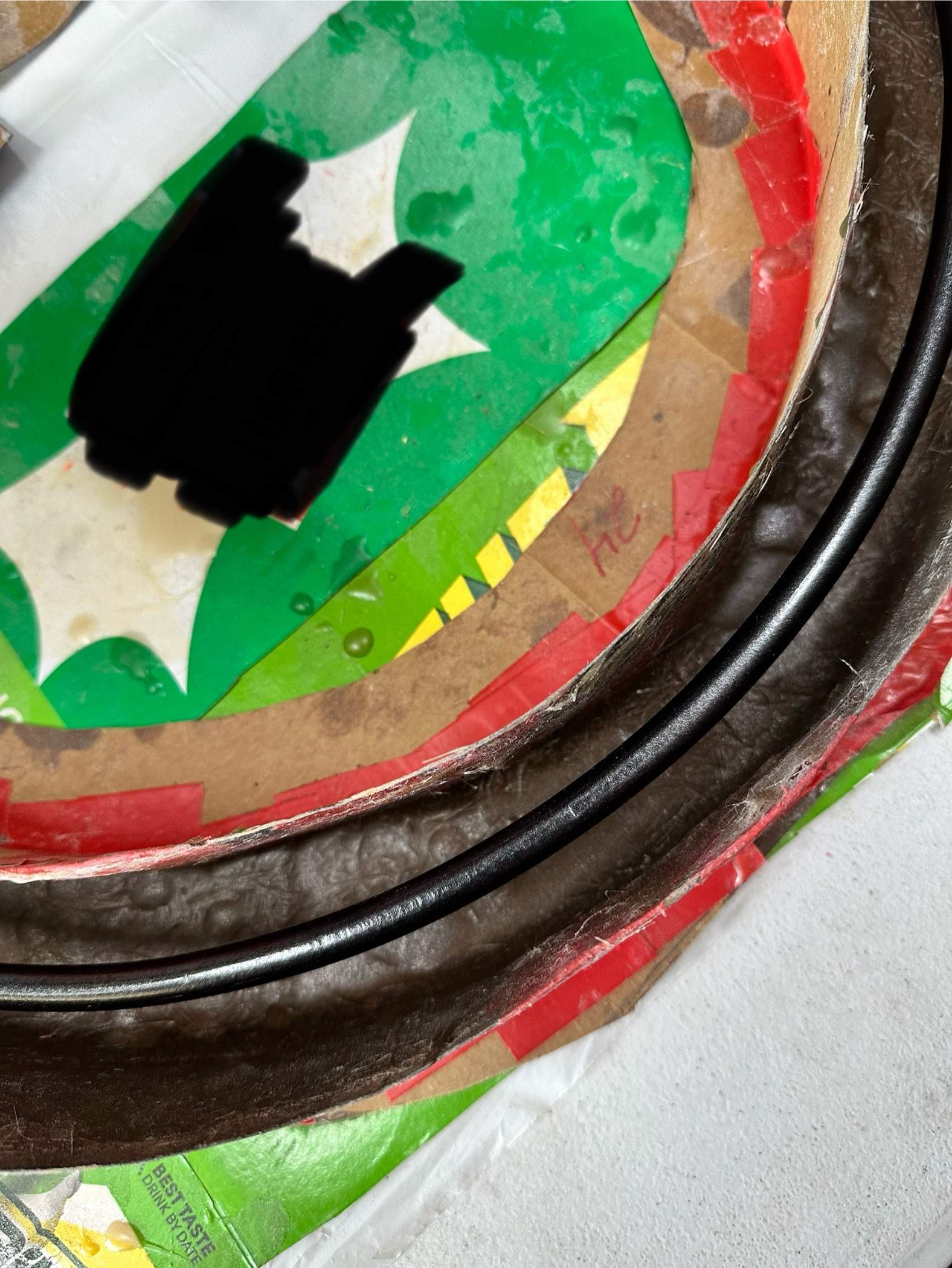

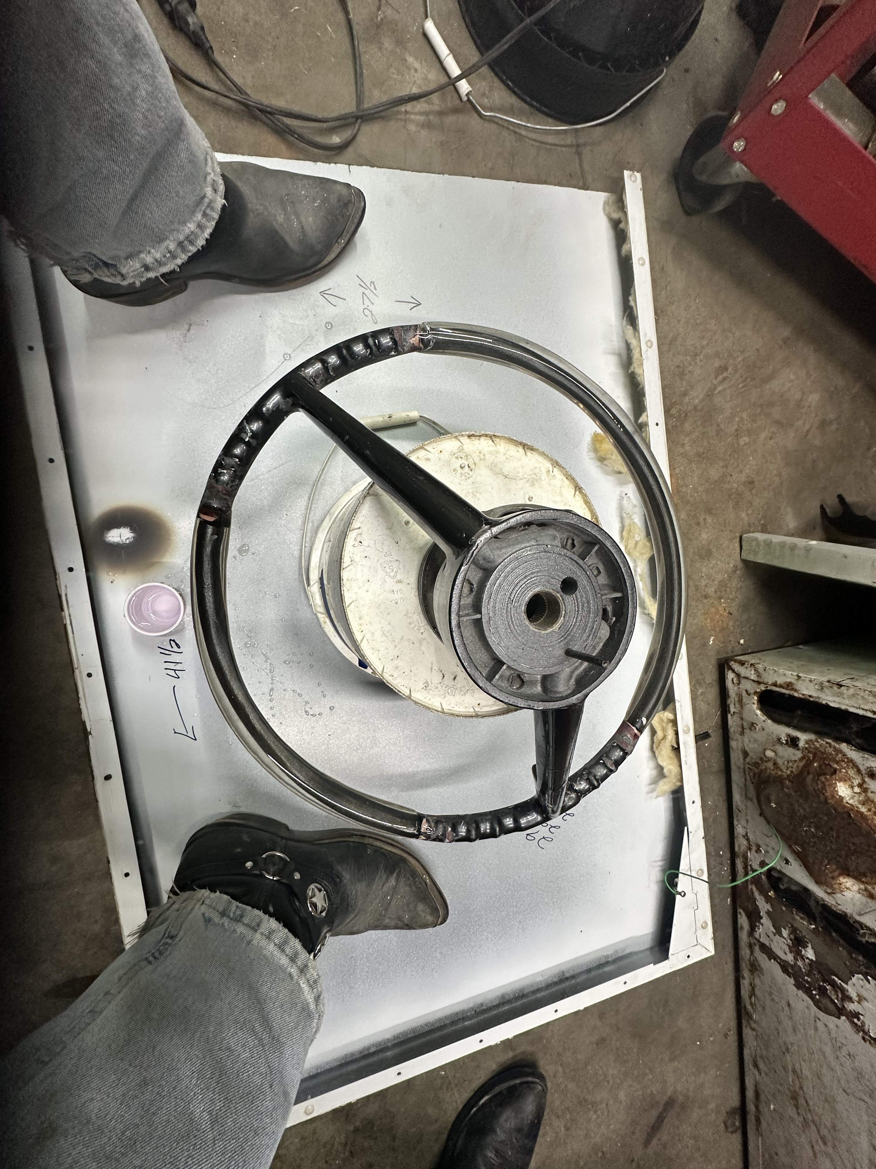

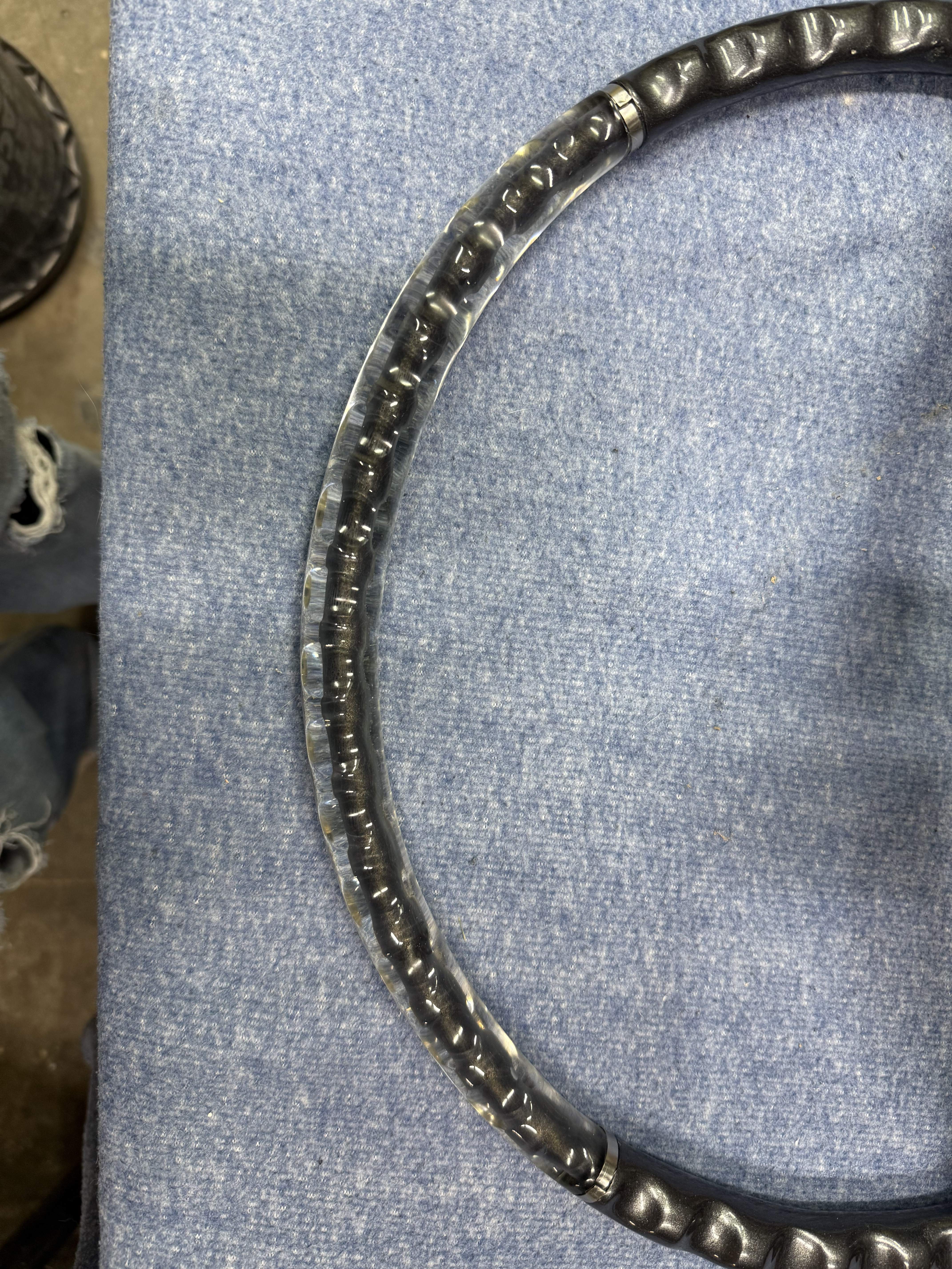

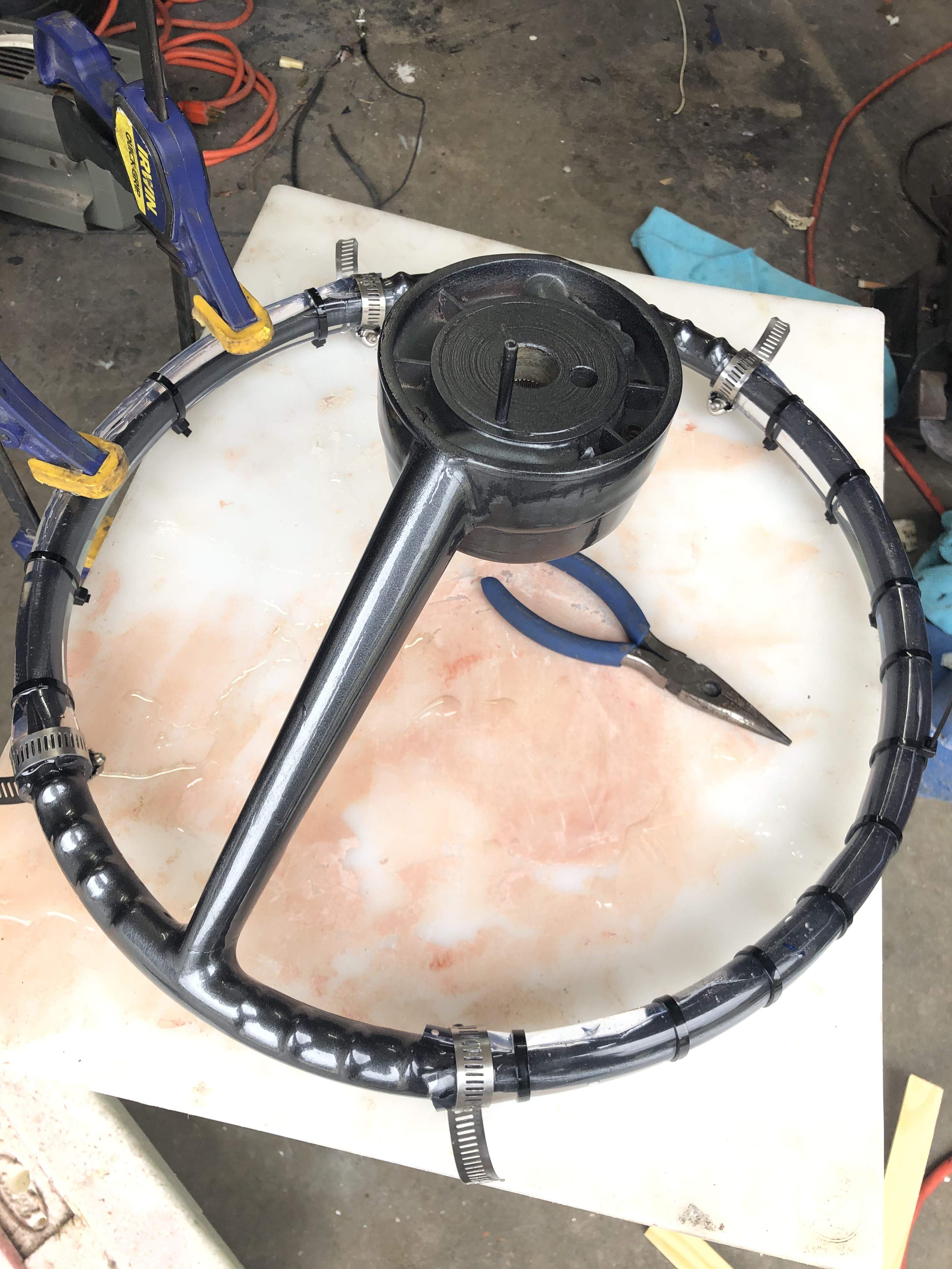

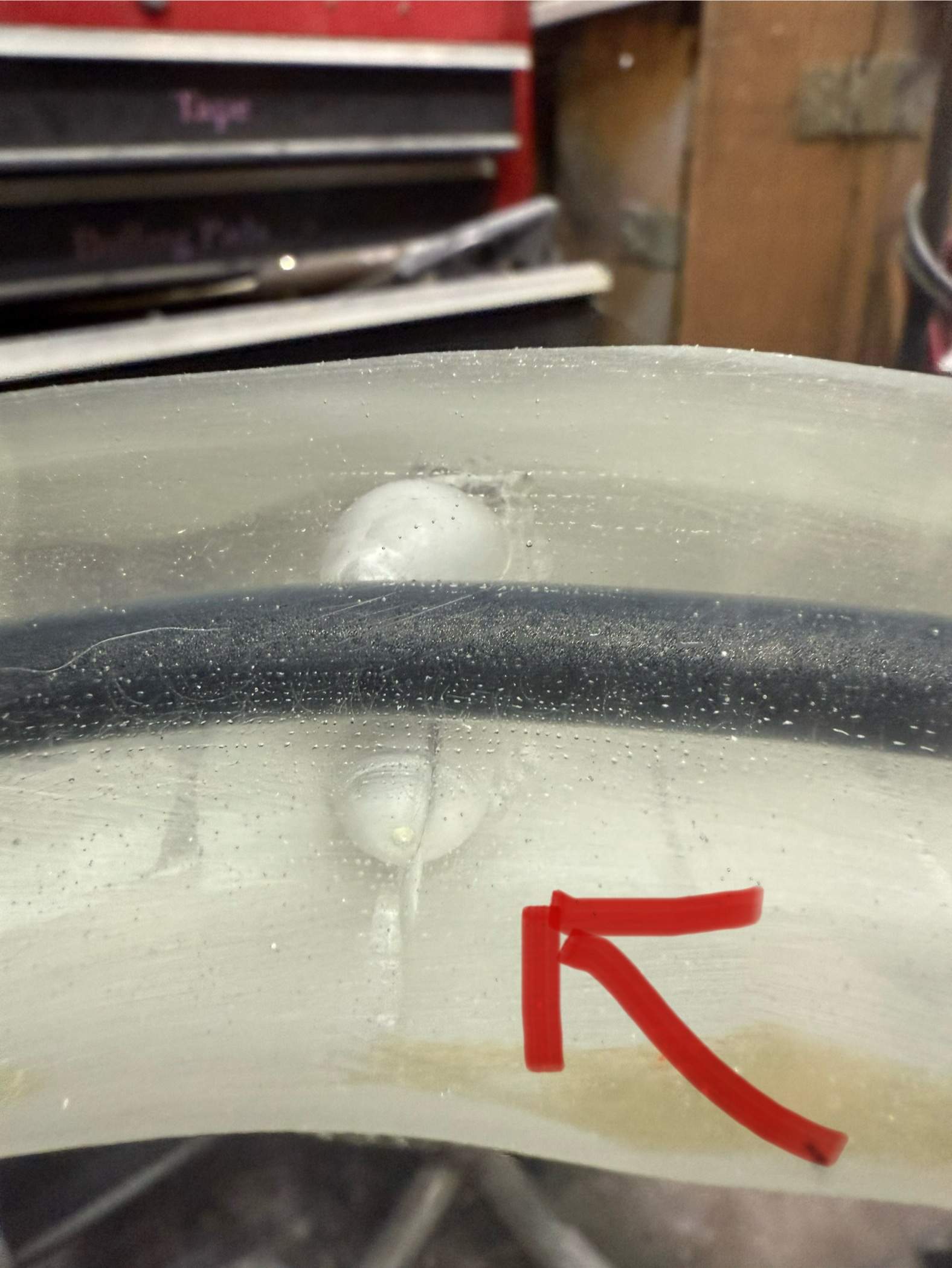

Been a min since I gave y'all an update, since it's been too damn hot to work outside, I have returned to working on my steering wheel. This is seriously like the 6th time I've started over from scratch. I have tried multiple "molds" and various ways to contain the acrylic with no luck until this time. I do have pictures of the other failed attempts and the messes that were made. But this time I decided to justa make the mold out of thin cardboard and double tape all the seams with vinyl tape and then put a light coat of fiberglass over everything. and not use a release agent. The thought was justa sand off the fiberglass and cardboard. I also made it thick enough to have way more material to work with so I could shape it without have to add any later and "touch it up". This stuff is as thin as water when mixed and poured so touching up is almost impossible on any shape that is not completely flat. No doubt this is probably not the correct way to do this, but as I said I have tried multiple other ways, and multiple other acrylics and I was not happy with the results. The bottles were placed there to hold up the "cover" that I laid across it to keep the dust out. I let this cure for 1 week.

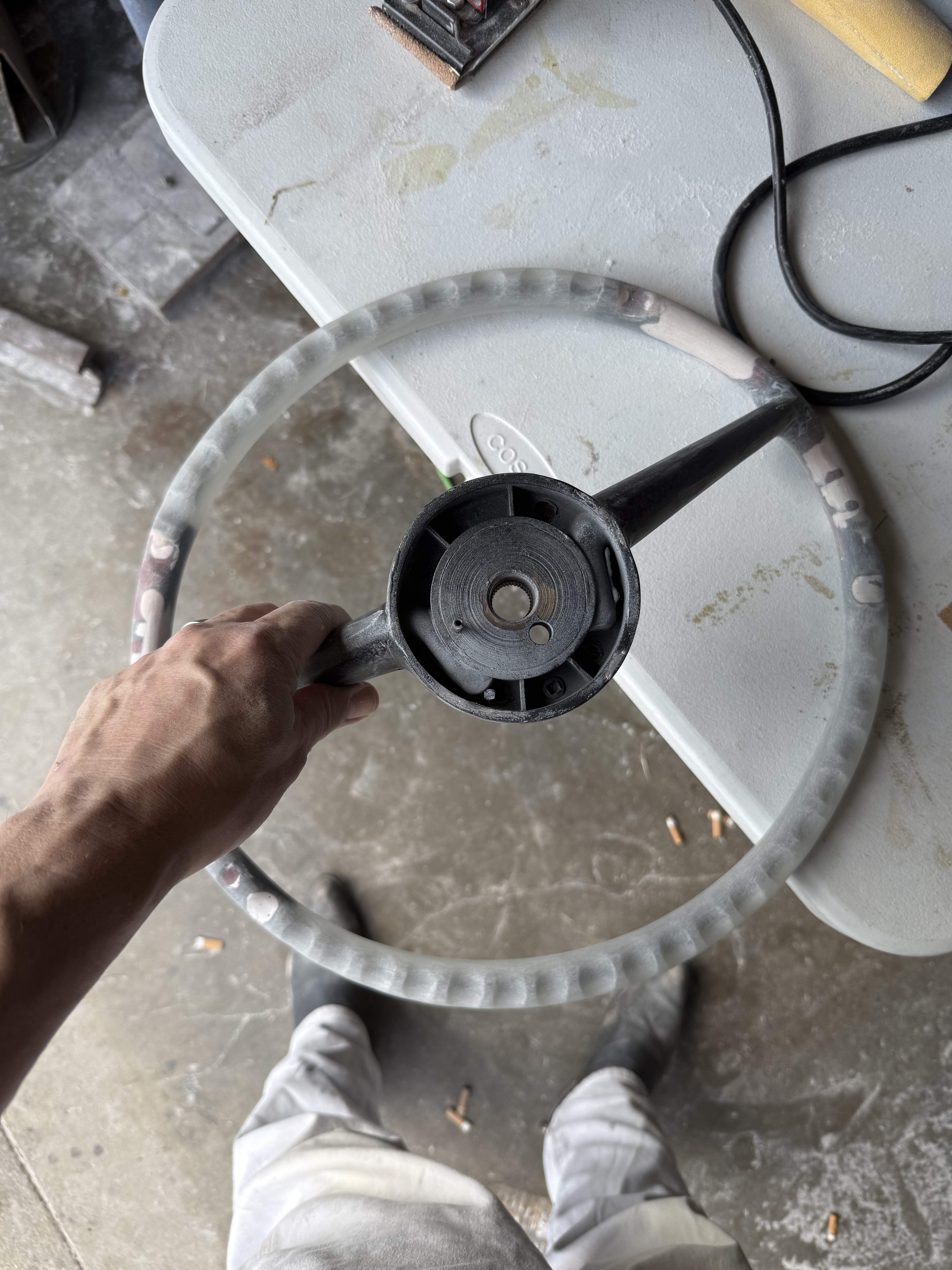

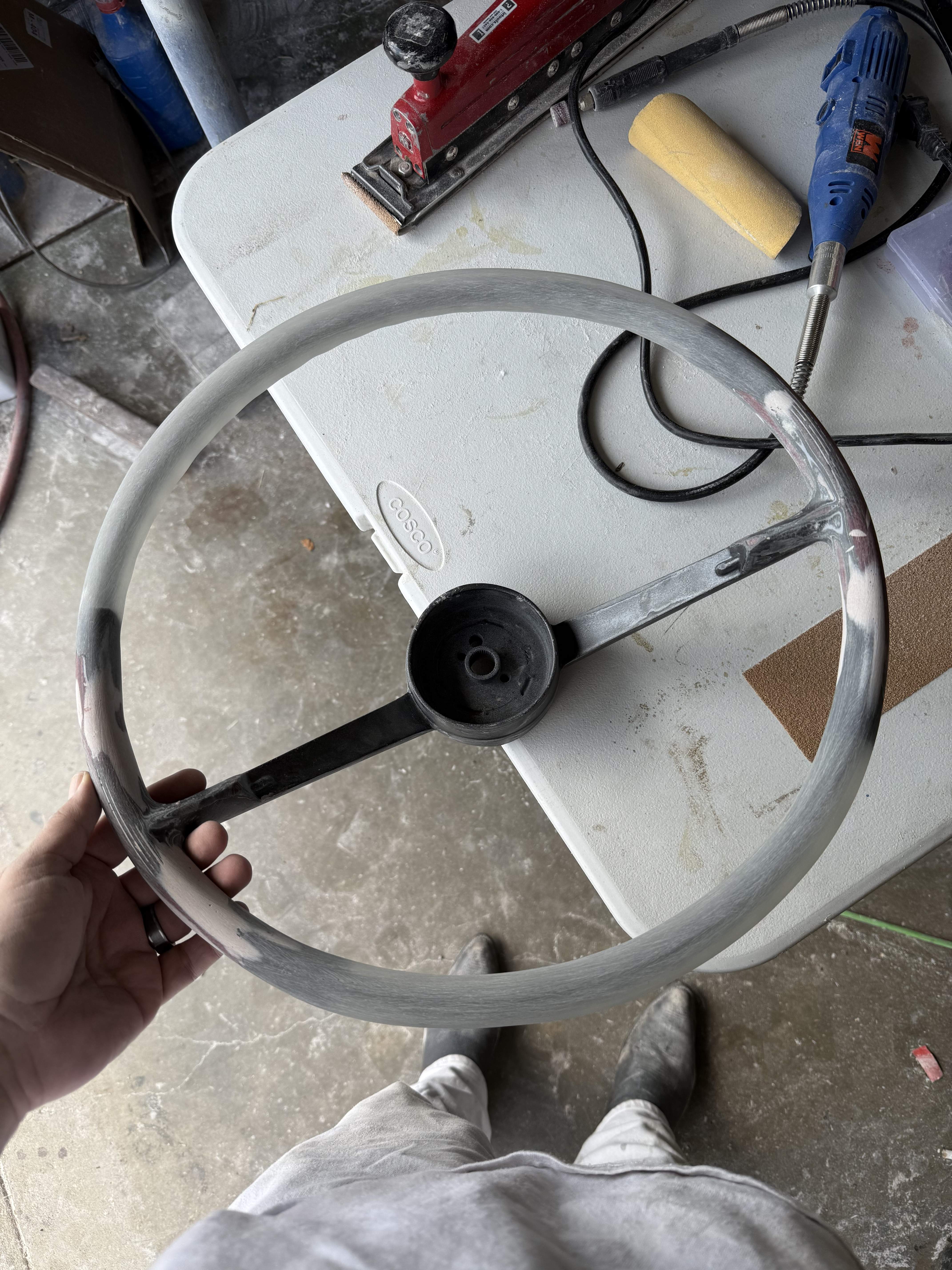

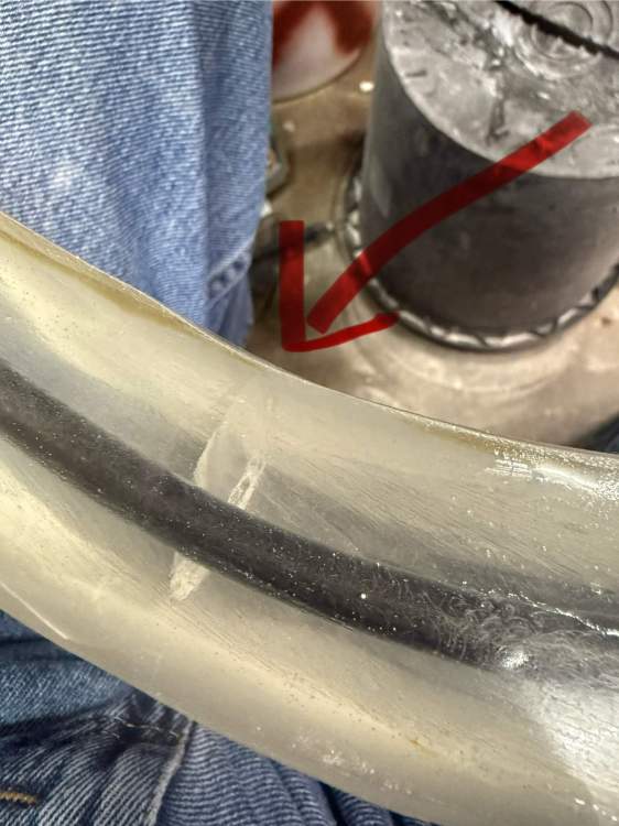

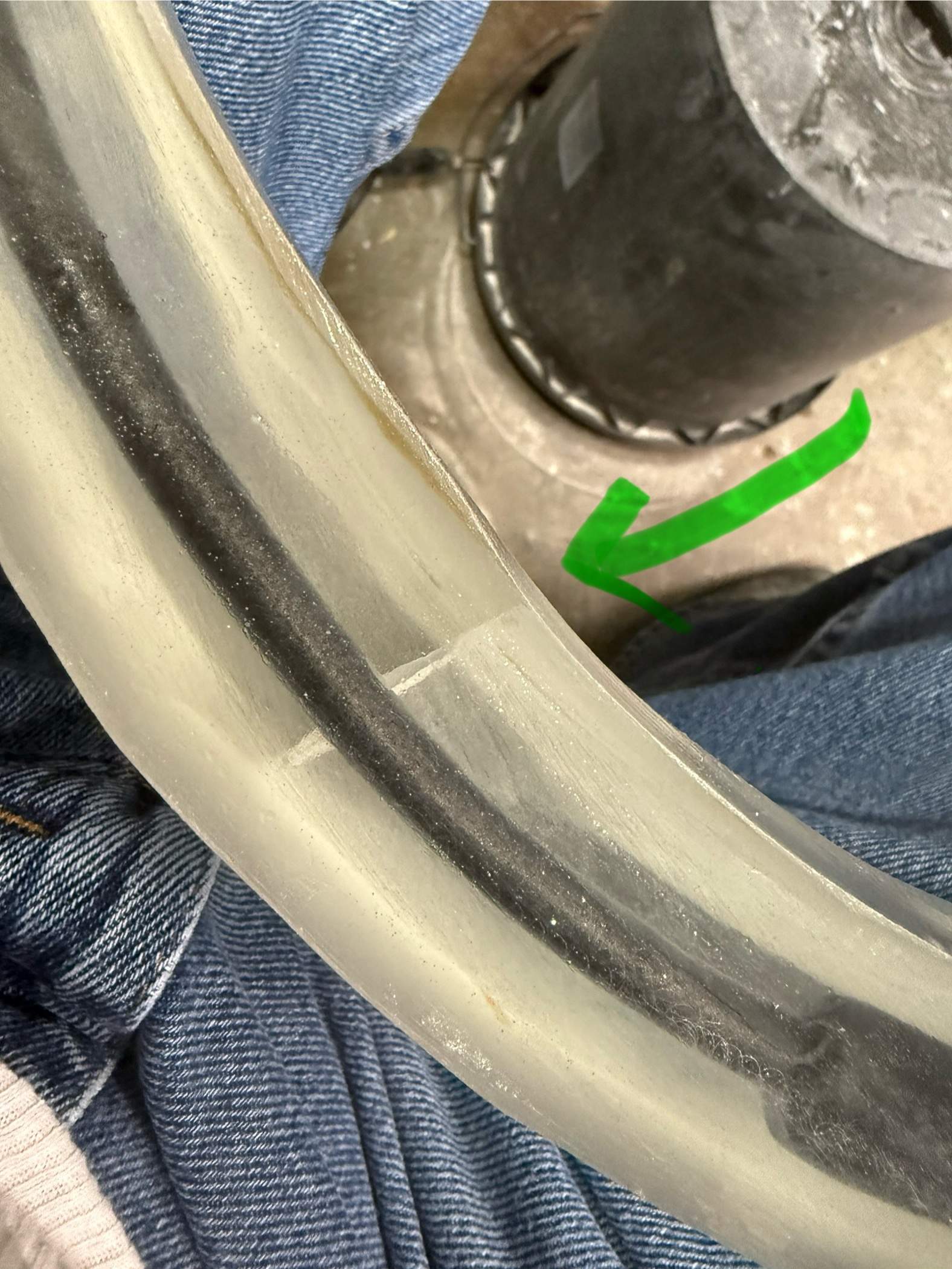

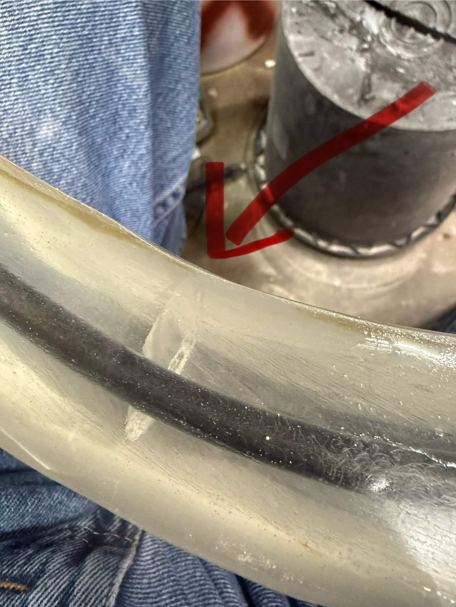

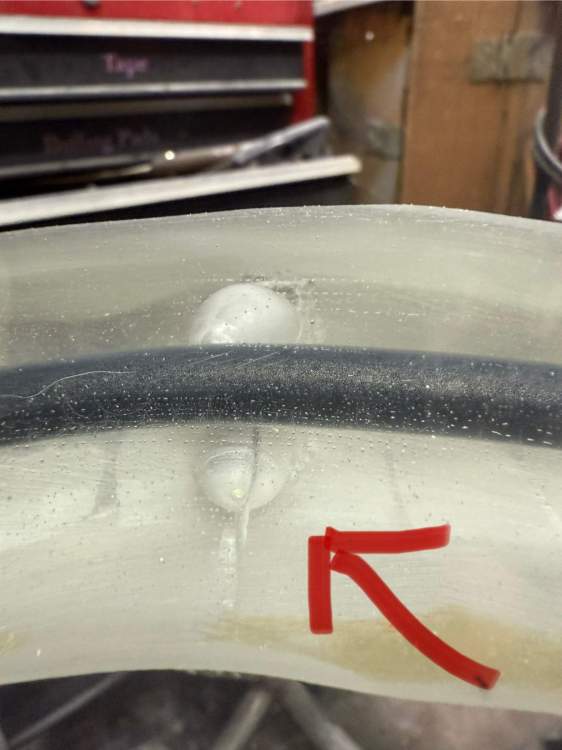

So, I started grinding away material two days ago. I'm happy with the way it looks right now. It's still clear with very little air bubbles. But while I had it in the vise yesterday using my Contour SCT to remove material it slipped out. I'm guessing that the vibration loosened the vice justa enough to let it slip out. It crashed hard. Looking at it I found a crack running threw it over halfway down and past the frame. Time to walk away. I decide last night to go back out and take another look. Rather than cut out that entire section of acrylic and start over again and building another mold, I drilled a tunnel into and around part of the frame so I can pour into the crack and then justa continue removing the rest of the material when it hardens. It will take 72hrs to cure and then I will have to do It again on the back side to repair the rest of the crack. Again, this is also probably not the right way to do this, but I am too damn old to change my name to "Rightway".
Hello Wrongway,
Never done it before but my idea would be to get a copper electrical conduit and use the tool from home depot to bend it to the correct circumference and cut it in half. the upper part of the half drill holes so you can inject the resin. once you do the upper part use the same mold for the lower half of the wheel.
Again I have never done it... I went the easy way out and bought the impala steering wheel from Amazon and made a 3d adapter for the column

I have my old steering wheel but I dont think it would help since most of the clear plastic is missing.

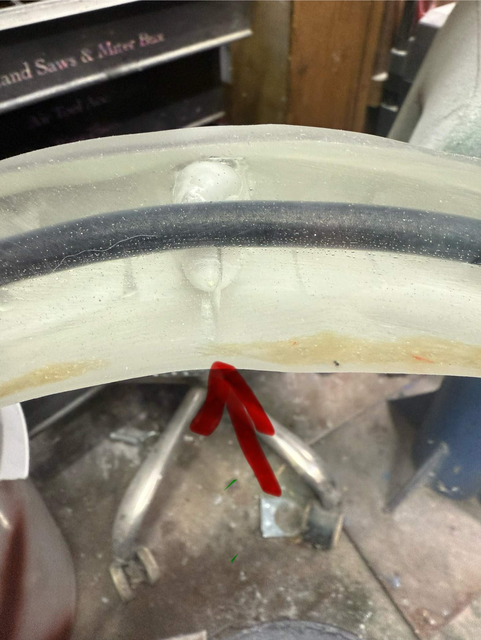

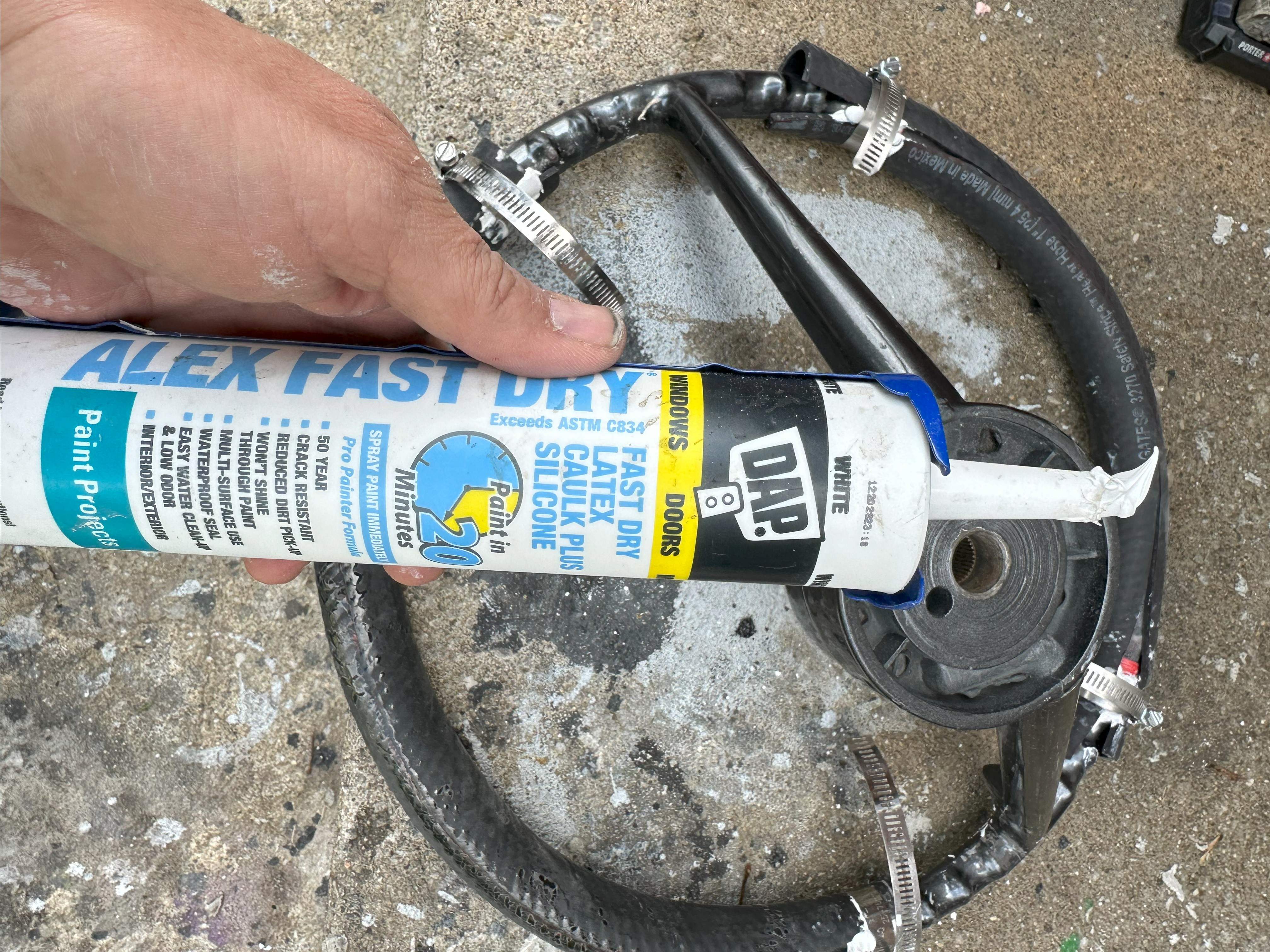

I had actually thought about that, the concern was after bending the pipe and splitting it to fit over the frame that it wouldn't seal up without leaking, I also tried black rubber hose, that was a disaster. Gaps at the top from not being able to see into the hose while pouring. Leaking out the sides, justa mess. I switched to clear hose and was able to get rid of the gaps, but it still leaked out the sides. Couldn't get the sides to stop leaking no matter what I tried. It also didn't help that theses Pontiac steering wheels are not actually round, more of an oval. I finally got one to look good, multiple touch ups and sanding. Put it on my car and realized Pontiac was right, I needed finger groves! So tore it all back down and started again. If I'm not happy this time I'm painting it black and calling it DONE! lol2
Looks good to me... congrats you have way more patience than me.

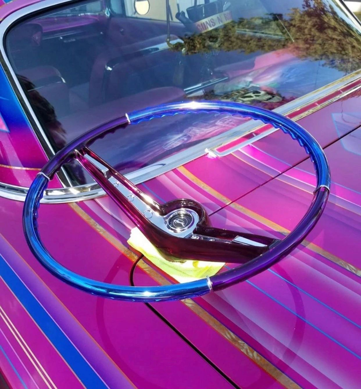

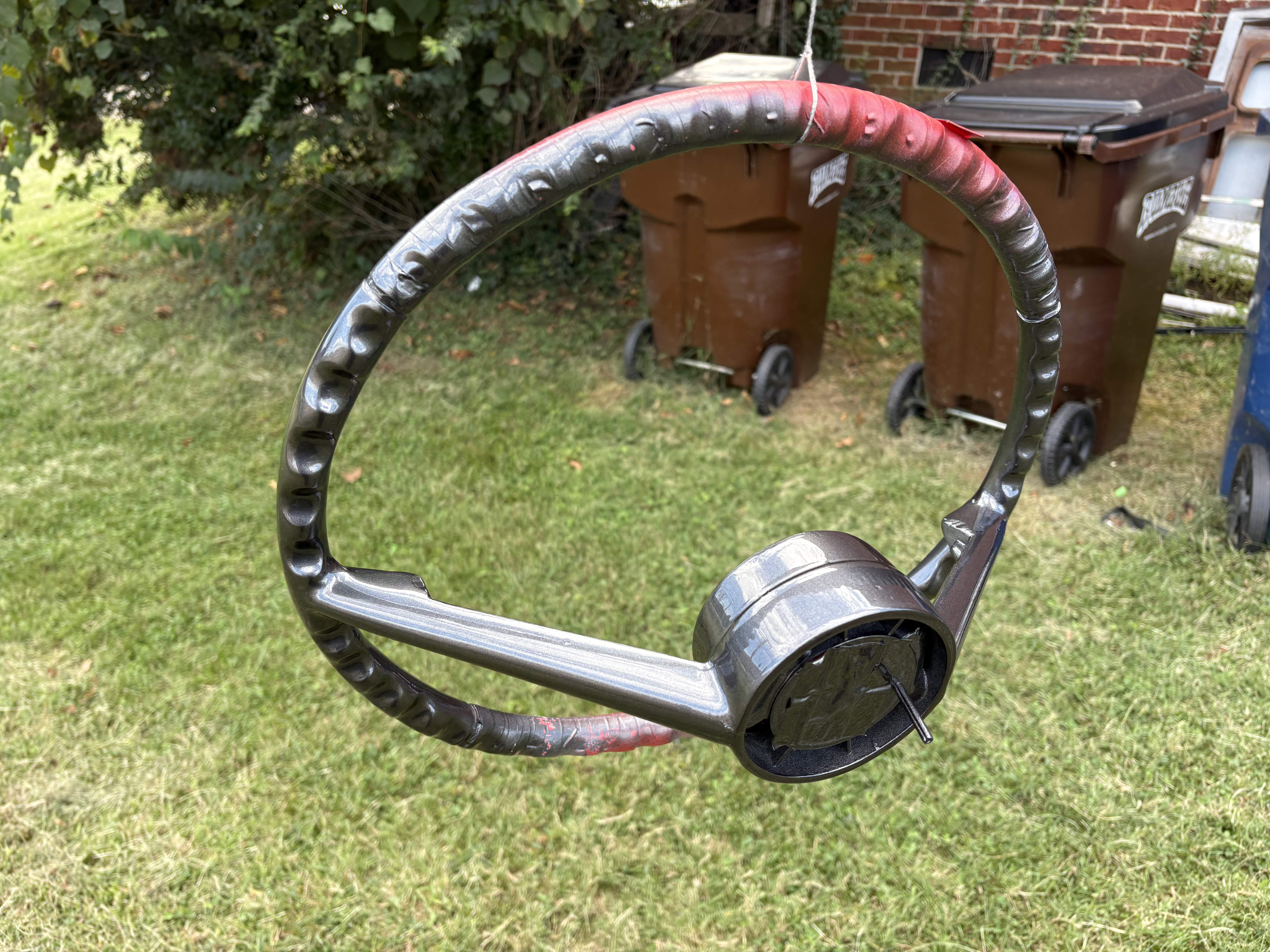

Its done, finally finished the steering wheel guys!
Edited by Wrongway
omg!!!! !!!!!!bowdown
wrongway !!! it looks amazing !!!!!!bowdown
can you make me two , i need one for the 63 wagon and replace my dumb attempt on the 64 ?
and i recon fitzy will want one !!!
