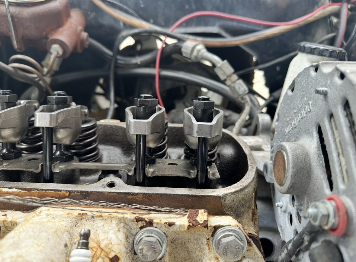

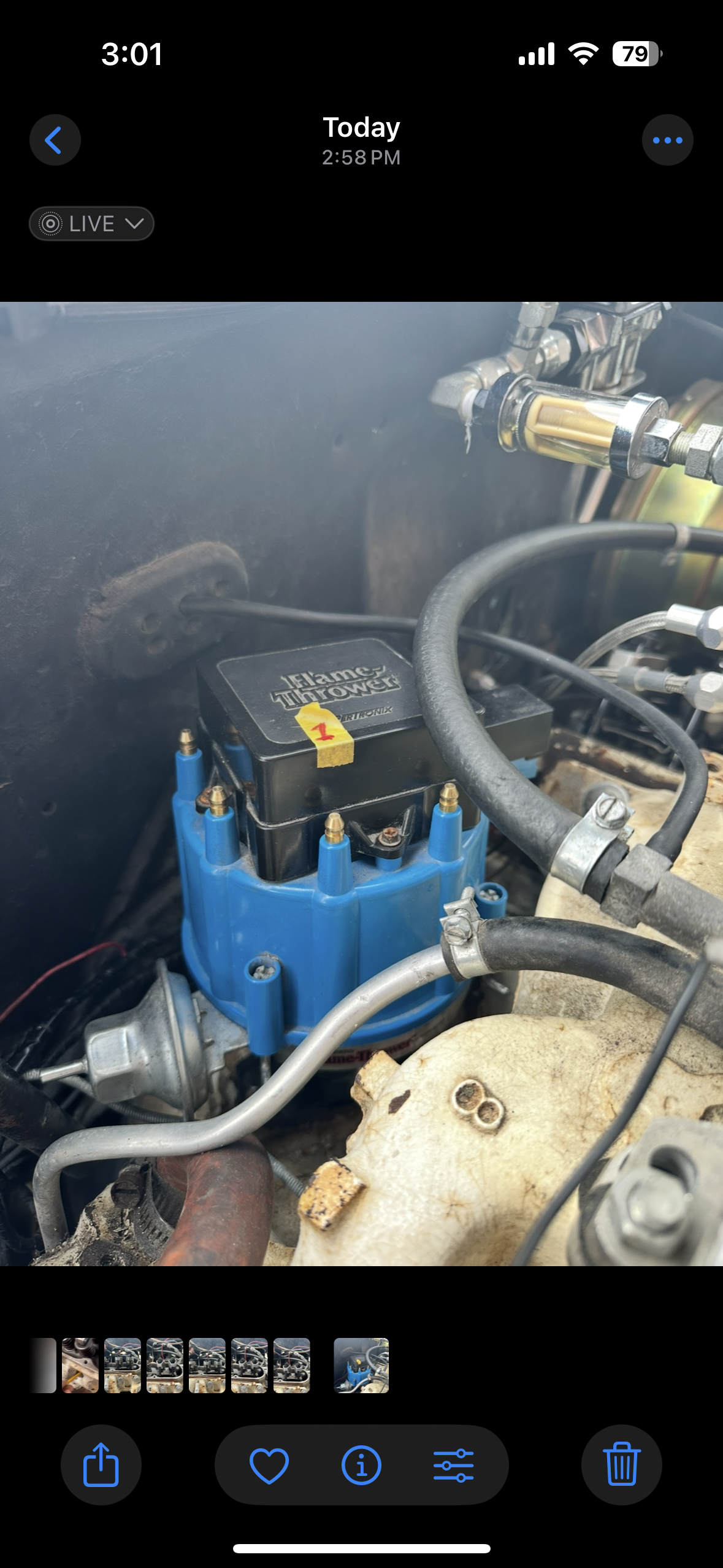

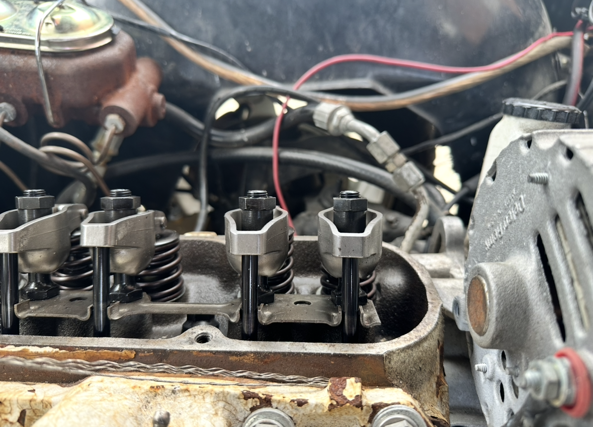

So here's the current video and I stopped at this point for y'all to have a look before I go any farther. To me it looks like both valves are closed. The line on the balancer is above the 0 about a 1/4" and looking at the rotor and cap location it looks to me that the rotor is maybe a tooth forward. But I did not change anything from yesterday's videos as of yet. FYI, it's a 2min video of me getting to TDC. If I need to do something else or you need to see something else justa let me know.
The timing mark looks way off. With #1 near TDC, the crank pulley mark should be on about 12° BTDC.
That is, #12 on the timing cover numbers. From what I can see, your Sharpie mark is a few degrees AFTER TDC. Even so, it should still run at that setting. Actually, because you have measured piston travel right up to TDC the mark may be accurate.

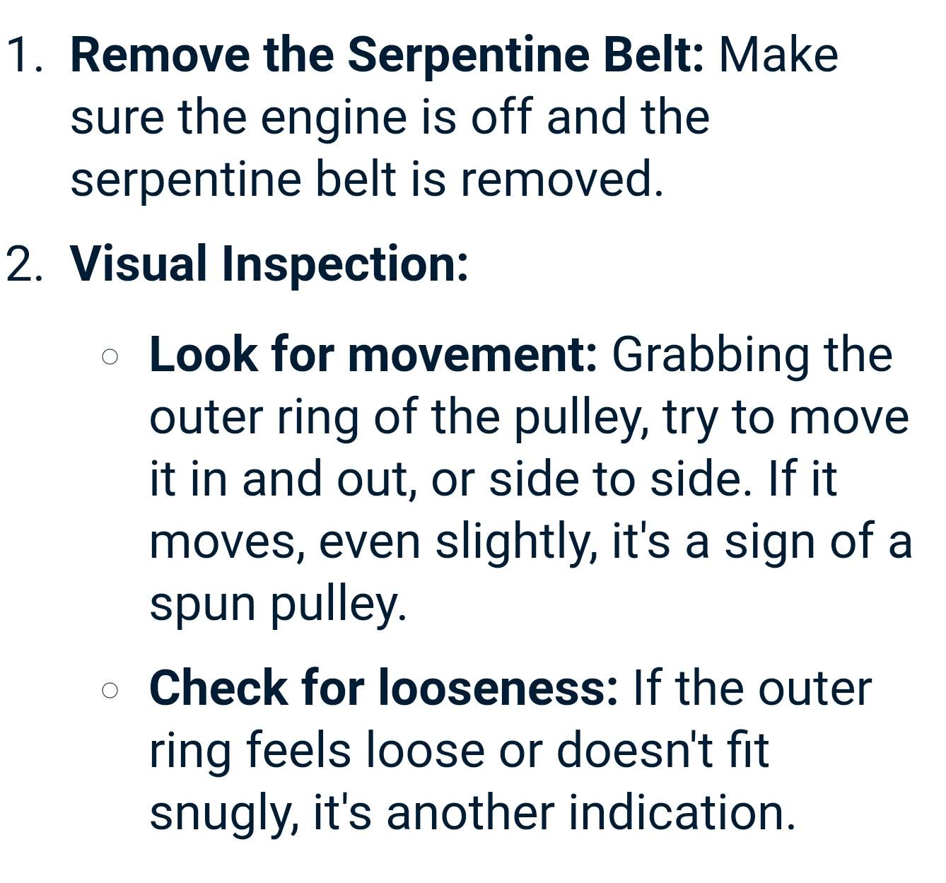

As far as checking for a spun pulley I don't know how one checks. Perhaps if you remove the V belt and check pulley for any movement? Perhaps someone can chime in here?

Just looked up how to check for a spun pulley:
