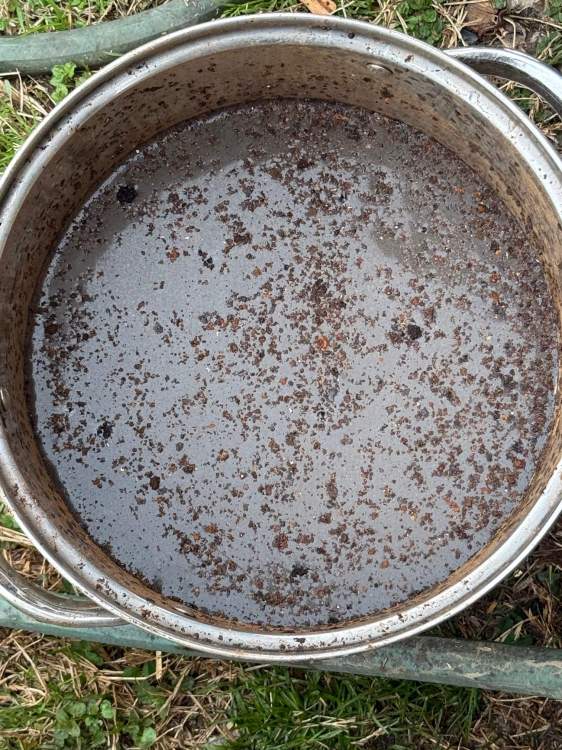

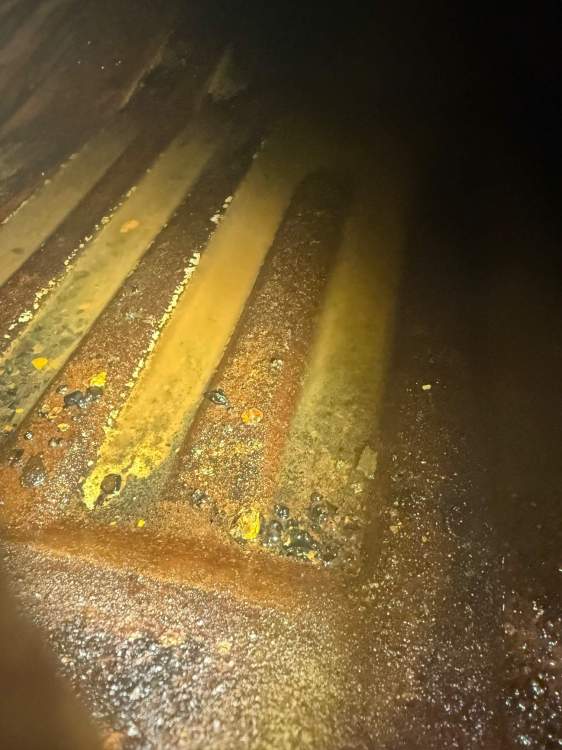

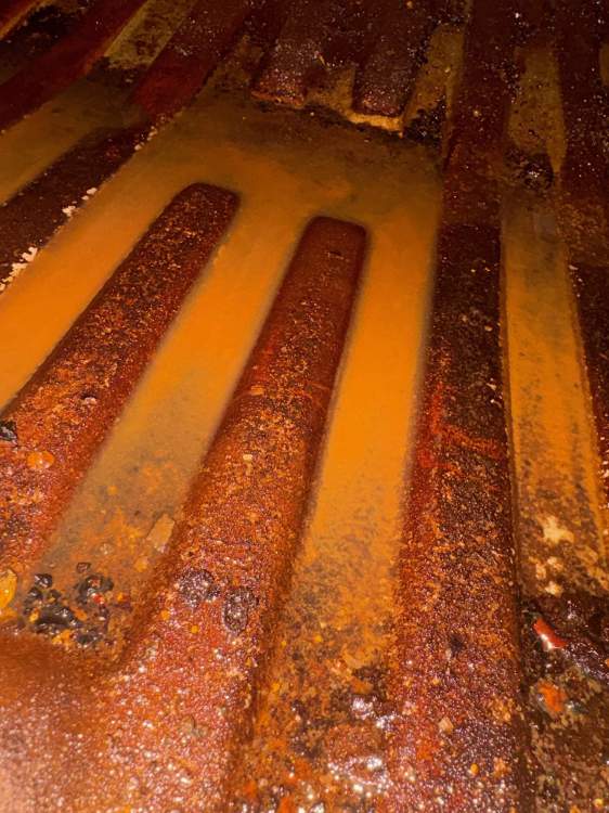

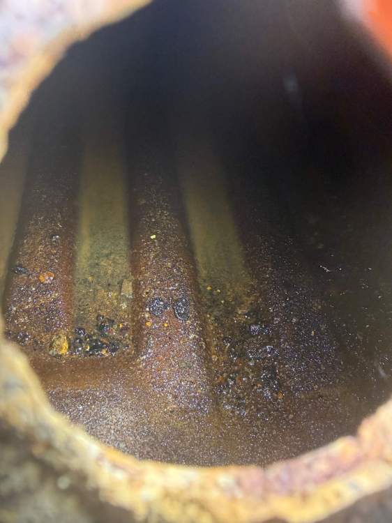

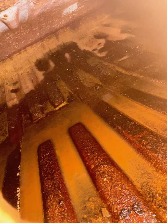

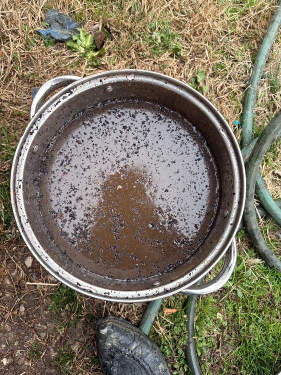

And the award for the dirtiest fuel tank,,,,,,,,,,,,goes to me! Look at these pics y'all! I drained the bucket after each rinse. Think shaking a bunch of nuts will be enough to clean it up before using cleaner and sealer or should I actually sand blast the inside? I think I can make an adaptor for a sandblasting gun to reach in there.

Nasty mate !!!!!
Too far gone for my tastes and I think, for a POR-15 urethane kit. It would take days of tumbling that tank with nuts, bolts, washers, log chain and railroad spikes inside to get it clean. The "Marine Clean" fluid and the phosphoric acid in the POR-15 fuel tank kit would do a remarkable but still incomplete job of cleaning the inside of the tank and the urethane would eventually delaminate.
Your time, money and efforts will be better spent measuring your current tank for height, width and length and for what extra area your car has around it. And what the arrangement is for the tank filler neck. Then go shopping online to see what the Tanks, Inc. people have to offer.
See if the tank below will fit. Its one inch deeper than stock - buy longer straps, very inexpensive. Its also a fuel injection tank but you can buy or make a block off plate for the tank if that does not suit you.
https://www.tanksinc.com/index.cfm/page/ptype=product/product_id=417/category_id=128/mode=prod/prd417.htm
Rick
I hear ya Rick, unfortunately a new tank isn't in the budget right now and the POR15 kit should be here in the next couple days. I loved your idea of tumbling, but I don't have anything big enough to strap this to. I'm thinking sand blasting or media blasting may be the only way to go.
How much are they charging you for the sand blasting? How much does a POR-15 Automotive Tank Cleaning and Urethane Kit cost? The new tank or one similar to it only costs $315.00 at the Tanks Inc site above.

Sand blasting will be done by me, I bought the gun last year and only need the media $25 for 14lb aluminum oxide. The POR15 kit was $115, I ordered it a couple nights ago. It should be here in the morning.

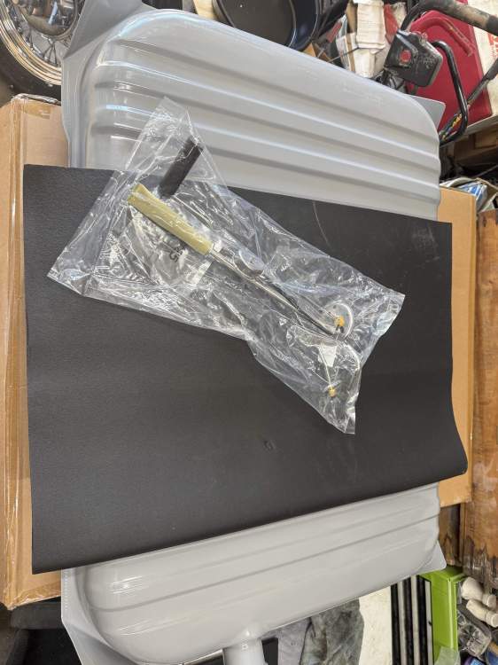

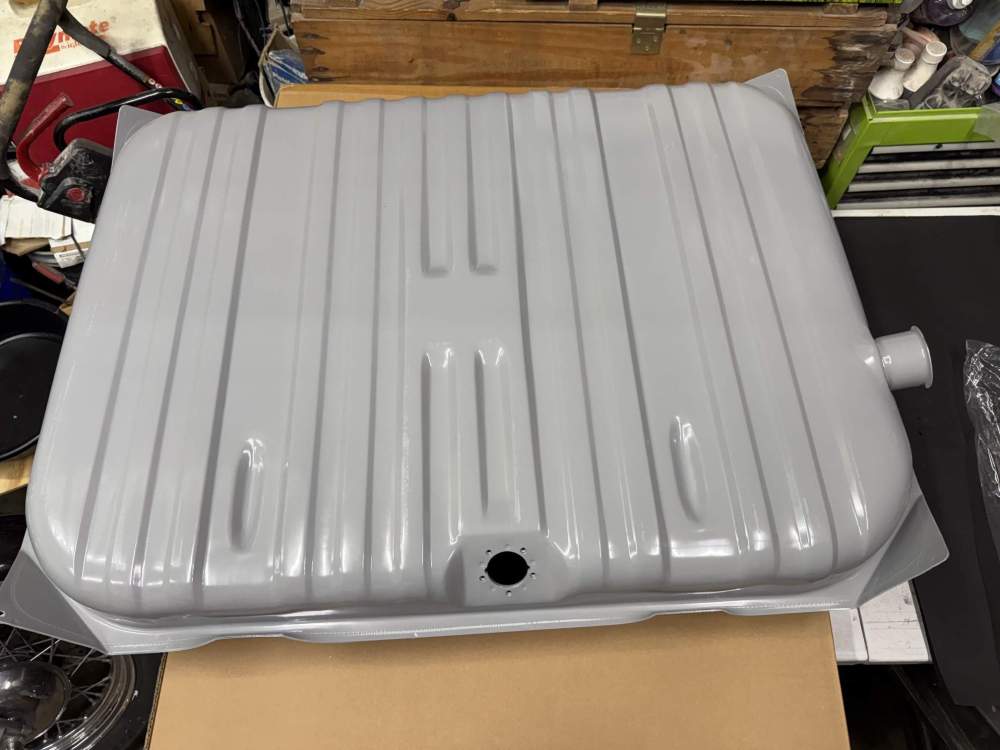

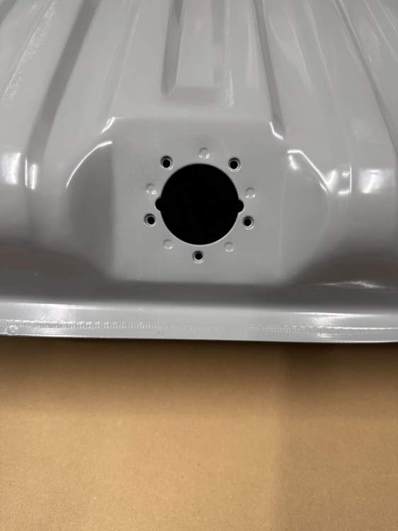

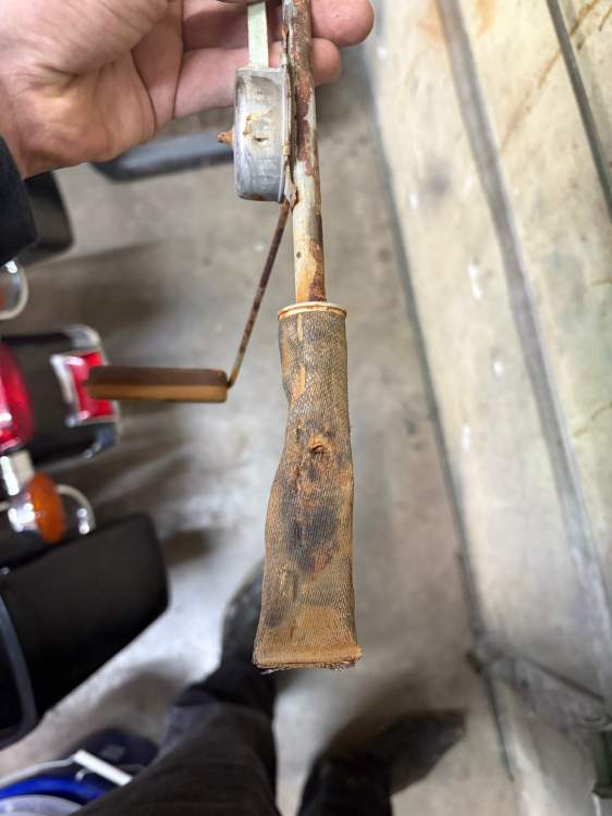

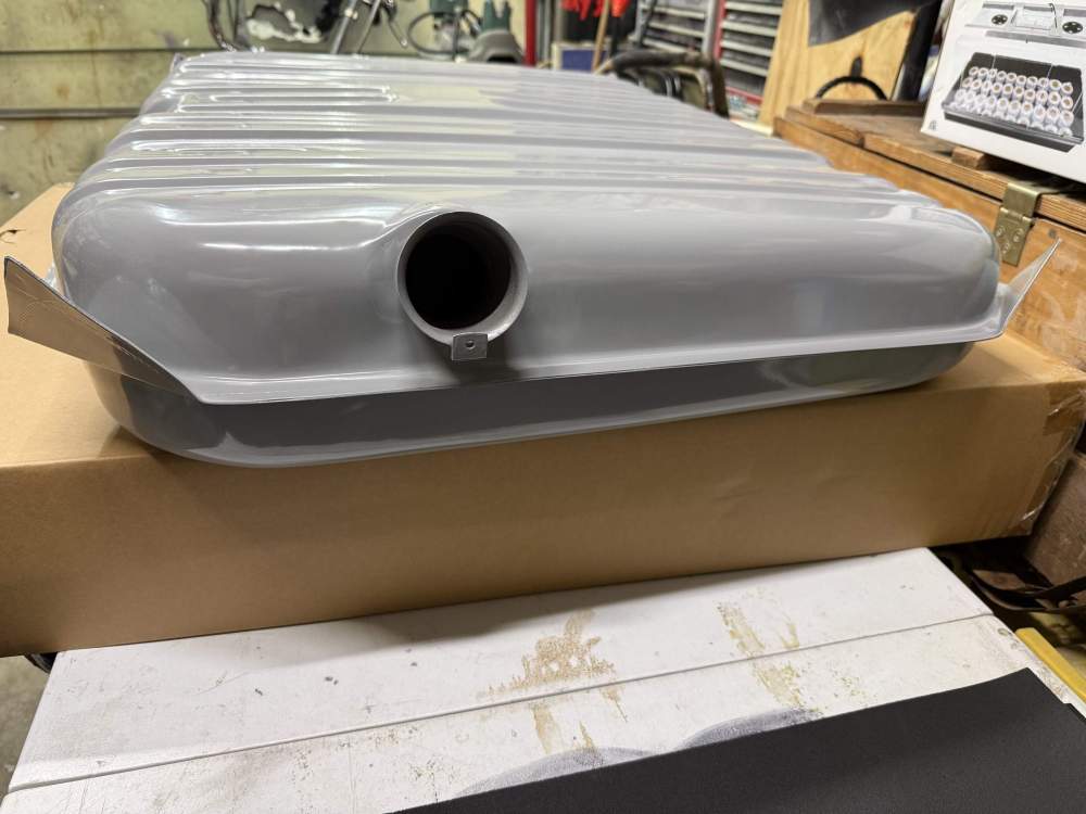

After a conversation about the condition of the tank with my wife she agreed with those of you that said to replace it. Although her "logic" was different, "honey its over 60 years old, I'm sure it's no good, justa buy a new one". If you want to try arguing with that logic go ahead, it's up to you. Myself, rather than argue I ordered a new gas tank from Auto City Classics, which of course needed the new gas tank pad and fuel sending unit, the rubbers for the straps and the straps needed new bolts. The tank rubbers came from Amazon a couple days later so no pics of them. Fairly sure we all know what rubbers look like. So everything got installed a couple days ago. The one concern I have is the filler tube was extremely hard to remove from the old tank. The O-ring looked new, so I reused it. Maybe it was so hard because of years of dirt and grim, but I was kind of expecting a pop or something telling me the filler neck was seated in the new tank. There was nothing, even after beating it in with a 2x4 and dead blow hammer. As if right now everything is installed and lined up properly, the set screw that holds the filler neck to the tank lines up and with the seal in place on the filler neck where it passes through to body nothing moves and it's all tight. But if I remove the set screw I can justa slide the filler neck out of the tank with little to no resistance. Is this ok or correct for a Pontiac?

Change that o ring wrongway ! Wayyy easier now than once you fill the tank with gas and find it leaks !
You will know when you fit a new o ring and lube it to slide in , how it has a nice little resistance , then you know it’s doing its job nicely 👍

Thanks bro, that's what I was thinking but wasn't sure. When I was beating on it, it felt like metal on metal. Like the end between the o ring and the end of the filler neck was hitting the last bump in the tanks neck. Like the it couldn't go in far enough for the o ring to get in the groove. I did soak that o ring in oil over night also. I'll take a look tomorrow as long as the rain stops.
Well I pulled the filler neck again to take a closer look at the O-ring. It is flat spotted on one side. Why I didn't think about this before I have no idea. I removed to O-ring and reinstalled the neck and drew a line where the filler neck and gas tank neck come together. Then stuck the filler neck into the old tank. The line on the neck matches up on both tanks. Where the O-ring is touching the side walls on the old tank it is not on the new tank. The only place I could find that O-ring was Ames Performance, but It is ordered. So, at this point every single part in the fuel system has been replaced except the straps hold the tank up and they were cleaned up and painted while they were off.
