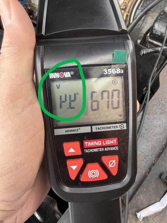

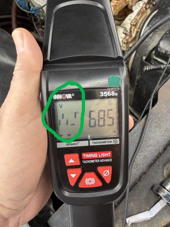

On a side note, does anybody know what these symbols are in the top left corner on the screen. I thought maybe a bad connection, but connections were good. This justa started today and did it two different times. These pics are of the second time. The first pic is when it first did it, the second is what it does a few seconds after. I unplug the cord from the gun and plug it back in and it works fine. Justa curious if my car is getting ready to kill another timing light?

I don’t really know, but maybe related to voltage looking at the V above the erratic figures. Maybe the induction pickup wasn’t making a good connection?
Really not sure either, but with the other timing light issues I thought I would ask. I am looking forward to a test drive tomorrow and reporting back!
