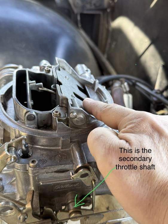

OK so I'm not sure about the secondaries, the only way I know to do that is at the butterfly on top. I pointed to it in the picture. If that is not how you wanted it done, I'll be happy to do it how you want it if you can tell me how. So, I did open the secondary butterfly, door not sure what to call it now and did the same test. Again, it shut off immediately. Two videos included.
See picture below. The top butterfly will open when the secondaries throttle plates below open. Some where on either side of the lower shaft is either a setscrew & a stop that the set screw bumps up against or at least a lever that stops it. Using your paper shim idea, use that of a thickness large enough to hold the secondary plates open a 1/16 or so. You can verify that’s the right shaft by opening the top butterfly & looking down in. With the engine turned of push the throttle linkage full forward the should fully open all 4 barrels. Notice which shaft rotates for the back secondaries.

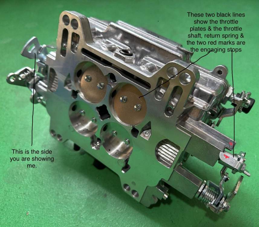

Ok, I’m not sure we are on the same page. So see the attached pic. I think that may explain it better. The top butterfly only opens when the bottom throttle plates open.
Where the two red make areas come together stops the bottom plates from closing all the way. There is undoubtedly an adjustment, but if you just place a shim between the two to hold the plates open about 1/18 to an 1/8 that should work.

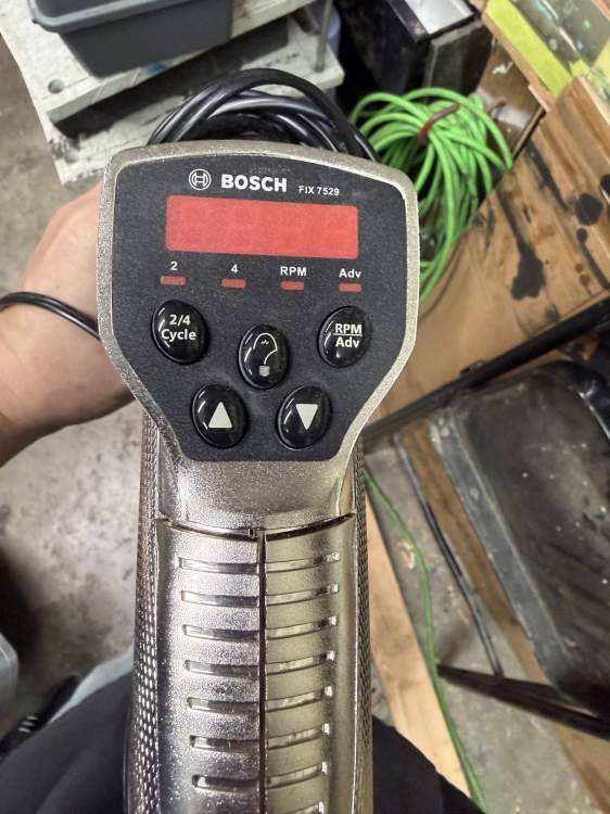

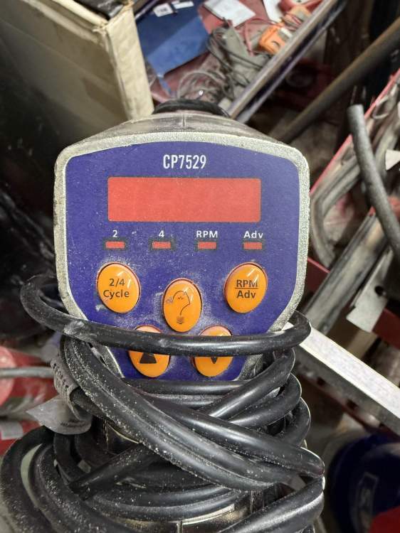

Ok, I'll reach out to Summit first. If they say it will work, we'll get that ordered. These are the two lights I have in house. The first is a Bosch the second is Actron.

I will do that. I also justa got off the phone with summit. I gave them the dist. part number and the module part # I replaced. Grover and his tech both said the only way the Innova light would not work is if the module I put in was a multi spark. Both said the part number I put in was NOT a multi spark and the Innova should work and they didn't understand why the two I have quit working with this dist. So I will pick up some octane booster and get the new light ordered.

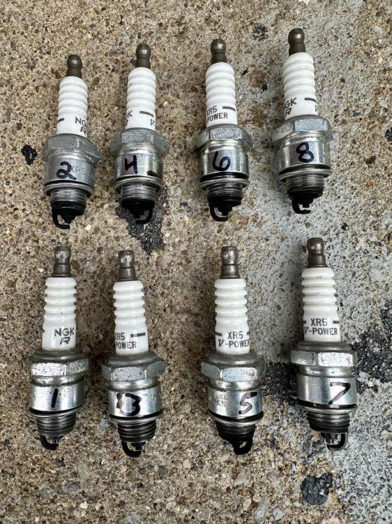

The color of your spark plugs doesn’t concern me. I don’t know what fuel they run in NZ or Australia, but in the US we only have unleaded today. So all you’re going to have on the plug is black carbon or a medium gray color & the medium gray is rare in most carbureted cars today. You only get a tan or brown color with leaded fuel.

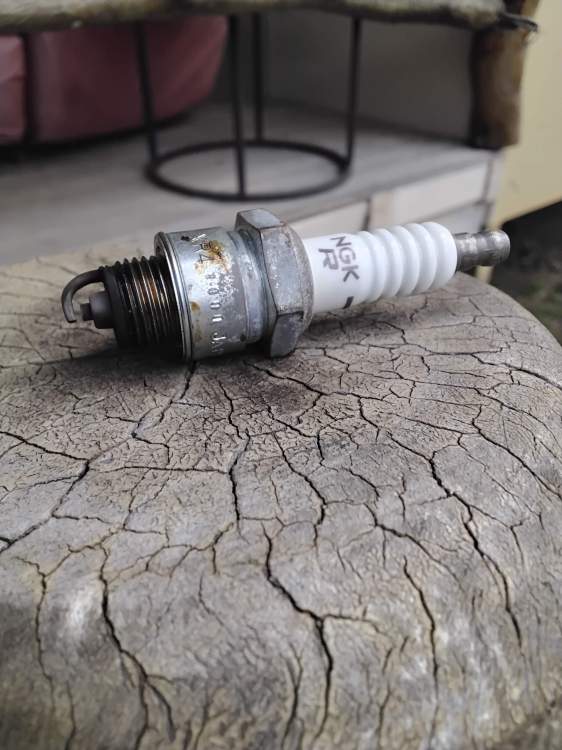

Wrongway - here is a pic of one of my plugs I pulled today specifically to show you. After a total rebuild my engine has done perhaps 8000 miles. This is how your plugs should look.
And for general information for anyone who cares, Australia switched exclusively to unleaded in 1986. I run a minimum of 95 in the GP (98 when I'm flush with cash) because it's 10.25 compression. It even says that in the 1965 owner's manual.
I am not expert enough to diagnose what's going on with your engine, but your plugs are choked with carbon. This tells me you have an excessive rich mixture at the very least. If you can get the damn thing to run, chuck some premium gas along with fuel cleaner in it and give it a good long high speed blast.
If the mixture is rich, after it's warmed up you should be able to either see raw fuel coming out the exhaust or see black smoke or smell fuel. If the fuel pressure, carb adjustments & timing are all good you shouldn't be having a problem.

Thanks for all your suggestions. I do agree that the plugs have excessive carbon build up. I still think it was caused by the Holly fuel pump that was eating its self up and bubbling fuel over the top of the carb and flooding it out. But honestly at this point I'm doubting everything I ever thought I knew about engines. As far as hauling ass down the road to "blow it out", normally I would be all about it, but remember were talking about an untested car, new suspension, rebuilt motor, rebuilt trans, 4 wheel disk conversation and nothing as been over 20-30 MPH. So burning up the road is a little scary at this point.
