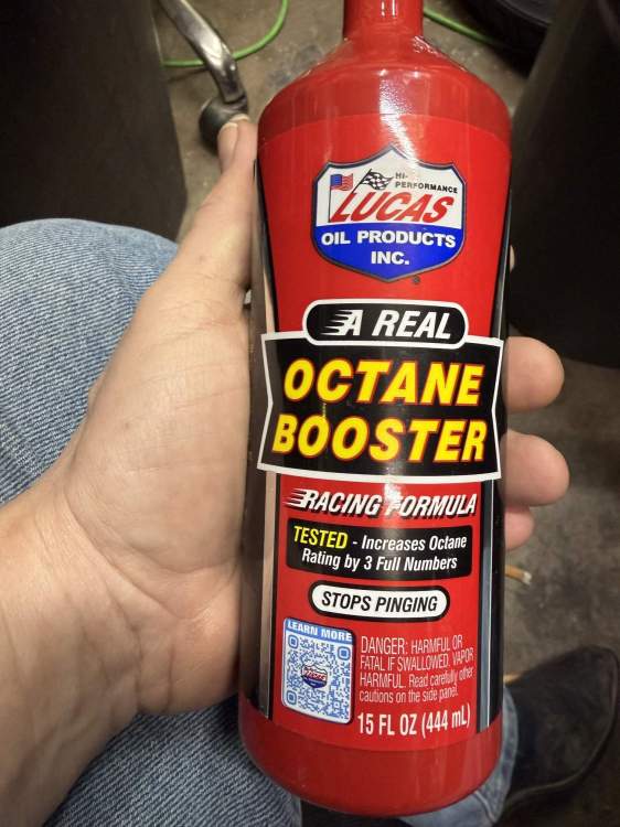

Ok, so octane booster is in the tank. The bottle said it treats 25 gallons. I figure it's got almost half a tank (25 gallon tank) so I only put in half a bottle. I thought about dumping the whole bottle figuring it would help more but I wasn't positive. Timing light should be here tomorrow.
4 hours ago, Wrongway said:
Make no mistake Fitzy, it's not ego. It's only having 16% of my heart function. That caused me to be disabled and on a fixed income, so when I say it's not in the budget, it's not. So I learn, research, and then I do. I build justa bout everything I can from custom 1911's, custom holsters, slings and knife sheaths, paint cars and even made some of the parts on my GP. Justa bout everything I can to save or make extra cash.
That should be ok Wrongway, should at least get you to around 90 octane. Let’s hope the timing light is a go. It’ll be interesting to see where the timing is at.

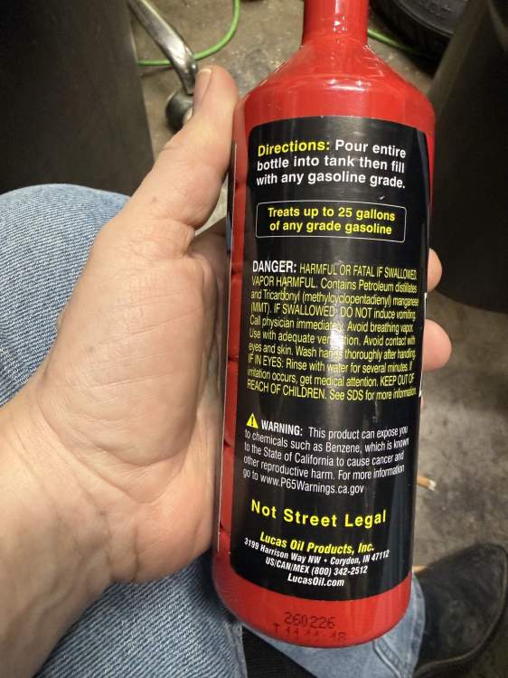

Since we are supposed to be respectful here, it makes it a little hard to get the proper point across about a total arse! A real man doesn’t offer an opinion about something he knows nothing about! By his own admission I might add. A real man doesn’t make statements about things he doesn’t have a clue about, since he knows nothing about the history of whom he speaks! A real man would recognize his own shortcomings & remove the log from his own eye before he tries to pluck the splinter from someone else’s eye!
Wrongway I’m sorry for this intrusion, but there are many of us that are here to support & do what we can to aid you!
If this is wrong to say then I don’t want to be right. Enough!
I like that “ not street legal “ bit !!! rofl
As a famous race car driver once said !
We will keep that on the down low rofldriving

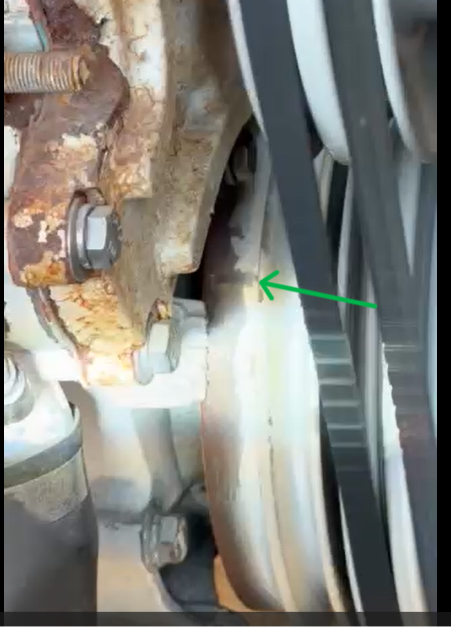

Ok so with the vacuum disconnected, the 1st video. The timing mark is about an inch above the timing marker. I screen shot the video and drew an arrow. The gun was on 1°. When I go too 2° the mark pushed away. When I pushed the down arrow, the gun goes to 90° and the marks gone. The 2nd video is distributor vacuum hooked up and at #6 on the marker.
With distributor vacuum hooked up I got

Here try this. First take a black magic marker & color the TDC line on the harmonic. Then disconnect the vac adv. set the rpm’s at 500-600 in idle if you can. Take a reading. You want somewhere between 6 btdc & 12 btdc @ 500-600. Next hookup the vac adv. start bringing up the rpm’s & topping out at about 2500. You should be getting somewhere around 32-36 total btdc.
OK, yes, the arrow was with vacuum disconnected. The rpm's dropped to about 850. Yeah, I colored it right before I started but I will remark it and report back shortly.

So after letting it warm up again, I unplugged the vacuum and using the tach on the new timing gun I set idle at 500 rpm. With no luck on that timing mark, I plugged the vacuum back in. The engine jumped up to 900 rpm. I used the idle screw up the carb to turn the rpm up too 2500 rpm, again using tach on new gun. With no adjustments to the engine or dist. made I used the arrows on the timing light to walk the mark on the balancer down to the timing tab. with the mark on the balancer dead center of
0 on the tab the gun read 20, using the arrows to move the mark to
6 on the tab, the gun read 18, using the arrows to move the mark to
9 on the tab, the gun read15, using the arrows to move the mark to
12 on the tad, the gun read 13.

What I see your struggling with is that balancer mark needs to be clearly marked !
And so does top dead center on your timing maker tab.
Once you have both Cleary marked
Then ! Disconnect and plug the vacuum line
Set your flash new timing light to 6 this will give you 6 degrees before top dead center
With your timing light set at 6 the balancer mark will line up with zero on the timing tab ok 👌 … like last Indian said you can play with btdc all the way up to 12 degrees but start at 6 and try it there you will know when you have gone to far because the starter will kick back on you.
If you do not want to let the timing light set 6 degrees btdc set that figure on the left of the screen at zero !
Then look and mark 6 btdc on your timing mark tab , vacuum plugged
Run the motor at 500rpm and move the dissy till your mark on the harmonic balancer lines up with that 6 degree mark on the timing tab
