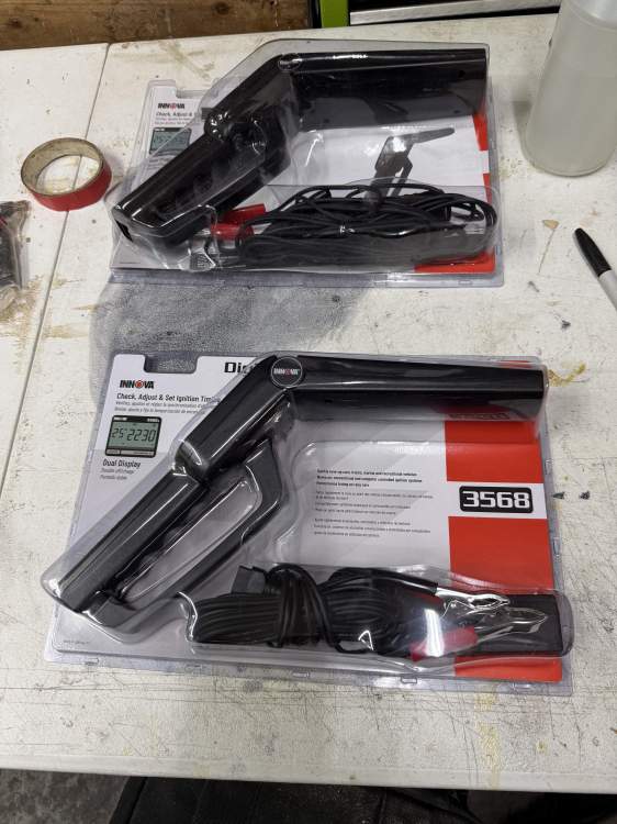

I did reach out to Summit about a replacement timing light. After posting my last message. They are replacing it and said new one should be here tomorrow.
