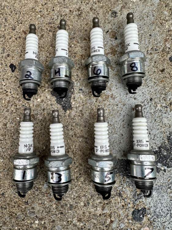

I was surprised at how much carbon was on these. They were new when we started. This was taken a couple weeks ago maybe a month ago.

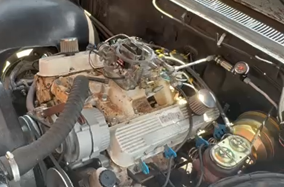

Ok, so 16 oz water bottle poured down the carb and engine still run's. I let the car run for about 5 mins after I finished with the water. Here's the video. My timer said she continued to run for 52 seconds after killing the power and hitting the kill switch. I started her up right after she finally stopped and shut her off again. This time I had my son pull the positive battery cable off while she was dieseling and it did no good. Positive disconnected and she kept running. Also, due to the excessive vibration in the video it put a small bend in the fuel fine just behind the elbow coming off the carb right where the collar is for the compression fitting causing a leak. I didn't have any extra fuel line in house so in the next video you'll see a black rubber line. But you get the point of how violent she gets when she shakes.

So everything is brand new, fuel pump is Edelbrock p/# 1971, carb is Edelbrock AVS 2 800cfm p/# 1913, iv replaced the needles and seats then the floats per Edelbrock tech, new PSI gauge from Marshal Instruments. So, per Edelbrock tech, the fuel pressure at the carb should be 6psi, not to exceed 6.5psi at the carburetor. So, pressure was adjusted at the pump. The gauge is mounted to the firewall just ahead of the carburetor. The aluminum fuel line that got bent due to dieseling is the line coming off the firewall to the elbow on the carburetor. The last video I posted shows the engine dieseling for 52 seconds after being shut off. And again, it only does this if the engine is warmed up.

When I put the carb back together, I turned air/fuel ratio screws all the way in and backed out 1 1/2 turns. The plugs were what NGK website recommended. Not saying ANY of this is correct, its justa the only info I had available.
Your spark plugs were filthy. They should be a nice tan or light grey colour when the mixture is right. Less than 50 miles after rebuild? The look of the plugs suggests lotsa carbon to me - when that stuff gets hot your engine will run on. Any chance of getting a camera (one a mechanic uses) down thru the plug hole?
You can check if your ignition wiring is wrong by removing a plug and leaning it connected onto the engine so it grounds. Fire it up and then switch it off whilst an observer watches that exposed plug. If it's still sparking whilst engine is running on, your wiring needs repair. If not, you got internal hot spots.

Reading those plugs , you have a carbon build up .

Ok, a little engine dieseling 101. Dieseling pretty much only happens in carbureted engines. This happens for a couple reasons. First & absolutely first is a fuel supply! No fuel no fire! Second is spark! Be it electric or a hot ember somewhere. Third is obviously air, but that only enables the dieseling to occur by completing the triangle.
The color of your spark plugs doesn’t concern me. I don’t know what fuel they run in NZ or Australia, but in the US we only have unleaded today. So all you’re going to have on the plug is black carbon or a medium gray color & the medium gray is rare in most carbureted cars today. You only get a tan or brown color with leaded fuel.
I suspect your issues is the carb & possibly some timing, but mostly carb. I would do this to verify that to be the case. You say it occurs when the engine gets hot! That is typical of fuel leakage of a carb. So whether you install a shutoff on the inlet line or choose some other way, get the engine hot. Cutoff the fuel supply to the carb & let it run out of fuel. If it stops smooth its a good indicator of carb issues. The other choice is put a different carb on which would actually be my first recommendation, but that’s expensive unless you have one lying around.
Carbs, unless you are very proficient at them are not easy to access. Too many things to be bad & cause fuel leakage. Worn throttle bushing, worn power jets, bad or incorrect gaskets, etc..

Ok, before you jump through those hoops try this as it may answer the question quicker. Your carb is a 4 barrel right? If so adjust both front & rear throttle plates so they are completely closed when no throttle is applied. Next find some shim stock you can place between the screw & the stop to bring it back to where it’s in idle. Do what you need to do to get the engine hot. Then when you shutoff the engine remove the shim stock & hold the throttle levers securely closed. That may well be enough to stop any siphoning action. If that proves successful, you have your answer.
Edited by Last Indian
Ok, so not sure if this is the same thing or not, but the last time I shut her off and she started dieseling I used a shop rag and put it over the carb to suffocate it. It worked and she stopped instantly.
Sorry I didn't think about including that earlier. I did it as an afterthought. I was fed up and ready to go inside for the night and never even thought about doing that until now.

It’s similar, but not quite the same. You need air, aka oxygen, to complete the triangle as well as siphon the fuel, Venturi effect. Yet that doesn’t prove the carb to be the issue. What you want is to eliminate the ability to siphon or drain fuel into the manifold if the carb is not functioning right. Making sure the throttle plates are completely closed does that while not choking the engine for air, per se, even though closing the plates does stop the air as well.
When you rebuilt the carb did you set the throttle plate adjustment both front & back?
I did not adjust the throttle plates. Being it was a brand-new carb all I did was replace all the gaskets and repaired a float that had a hole in it, then the needle and seats and gaskets, then replaced the floats and gaskets the last too per Edelbrock tech. The only adjustments I made were to the air/fuel ratio screws per Edelbrock tech which were to bottom them out and back off 1 1/2 turns and the float adjustment at 7\16 and 15/16 on float drop.
Alright. When you adjusted the throttle plates, were they closed as much as possible, but not to the point where they actually rested on the bores of the carb body? Likewise how strong is your return spring? That can also make a difference! Try the throttle plate suggestion I advised & even before that, get the car hot. Before you turn it off take the air cleaner off if it’s on Than have your son turn the car off. As he does that put your finger over the carb air vent tube & make sure it seals the tube tight. If the siphoning if somewhat mild that may be enough to stop the fuel from leaking. Worth a shot to answer a question.
Ok, so if I did what you asked correctly, then it was a success. If I didn't then at least what I did was successful. So I backed out the idle screw to where it wasn't touching the throttle after taking a measurement to make sure the shim was big enough to still idle. Then justa using a piece of paper folded to size stuck that in between the idle screw and throttle lever. Had my son turn her off and I removed the shim and pushed the throttle linkage to make sure she closed. She stopped immediately. As I tell my son, once doesn't make a pattern so I repeated that test 3 times with the same results. Here are the videos. So your thoughts?
I would feel encouraged that fuel is the issue. Why? Because of the way a carburetor works. As long as there is air flowing through the Venturi’s then fuel flows into the manifold. It per se sits there until a cylinder sucks it in. So turning off the engine, if it were hot carbon it would still want to pull that fuel in & then fire.
So try this. Do the same thing again, but this time leave the engine run. Pull out the shim & see if the engine dies or try’s to keep running. If it keeps running, don’t turn it off, but push on the throttle lever to put a little more pressure on it to close the plates & see if it dies.
If that proves out, I.E. keeps running till you push on the lever. Than try it again & close off the air vent as I had described.
There may still be some timing issues, but one thing at a time.
