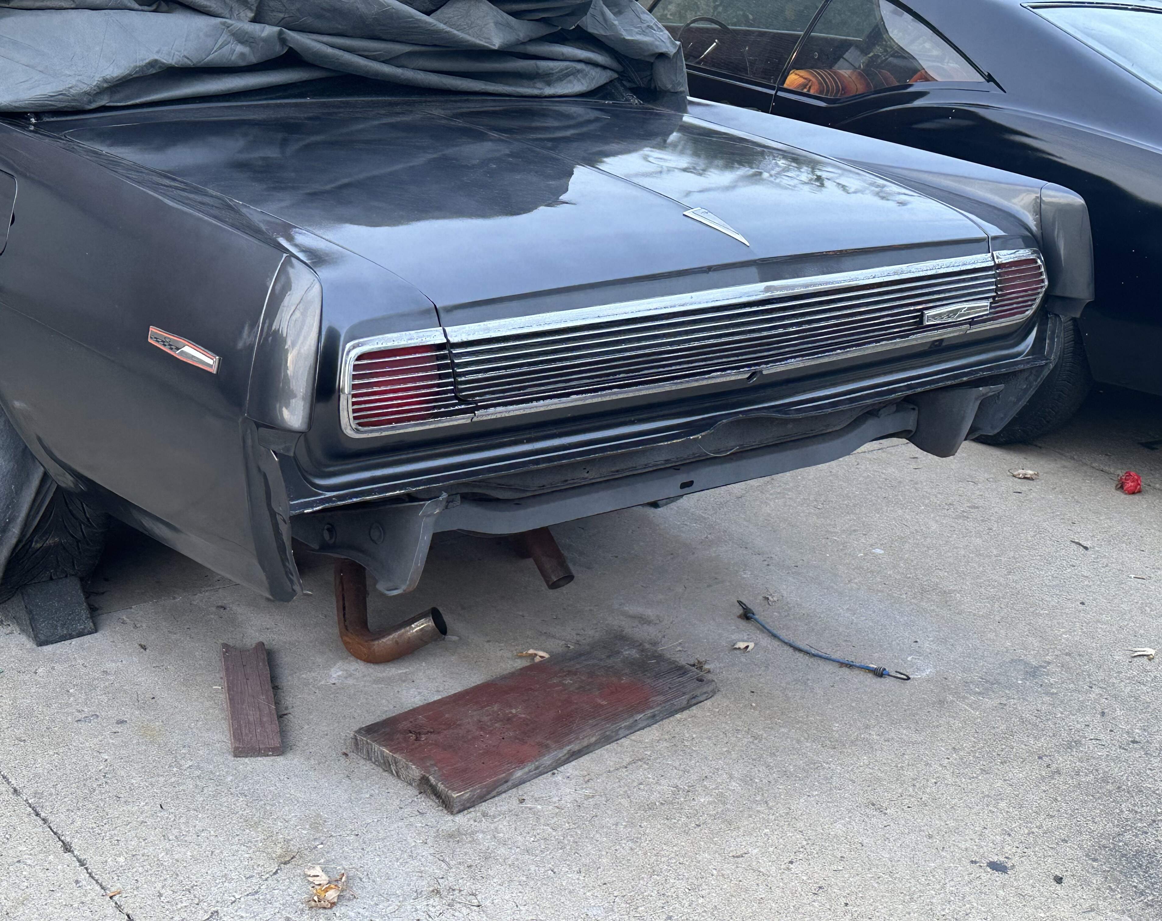

Well, the trunk lid, emblem and quarter panel badges are on! The rear carpet, top & bottom of back seat, arm rests and filler panels went in today! Rain all day tomorrow so I guess we'll see if the new windshield seals do what their supposed to. :lol:
Oh yeah, the stealth panel & taillights also got installed.

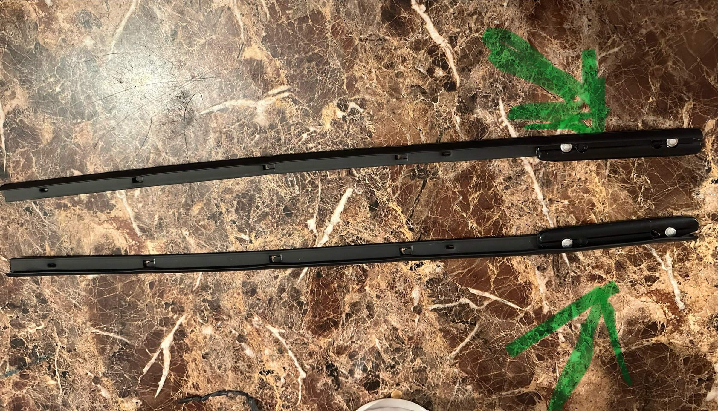

So, these are the outside felts for the back windows. The fronts look the same justa longer. Can somebody tell me if that little metal piece goes towards the front of the car or towards the trunk. I need to know for both the felts on the door and the one on the back window. Thanks

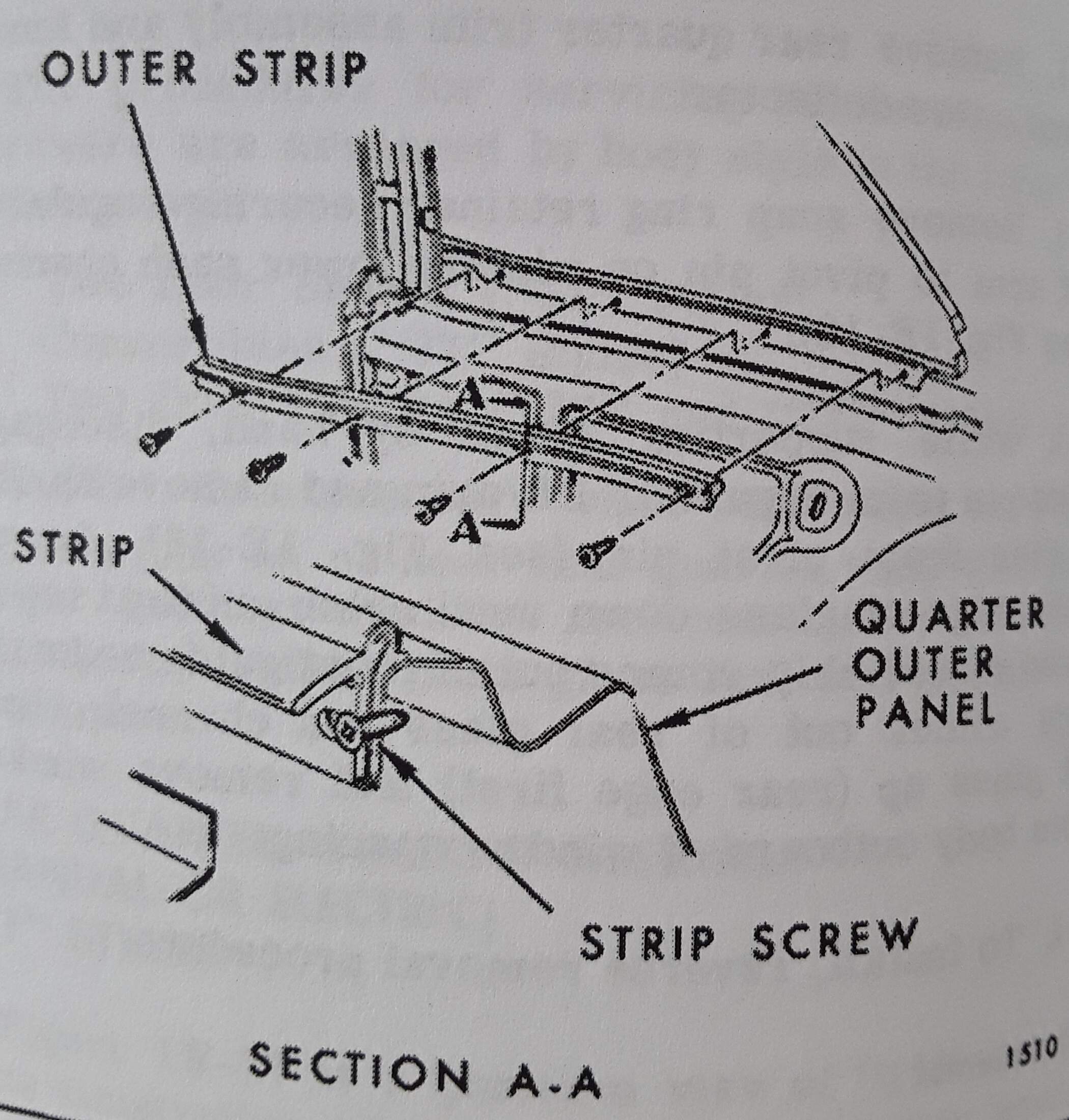

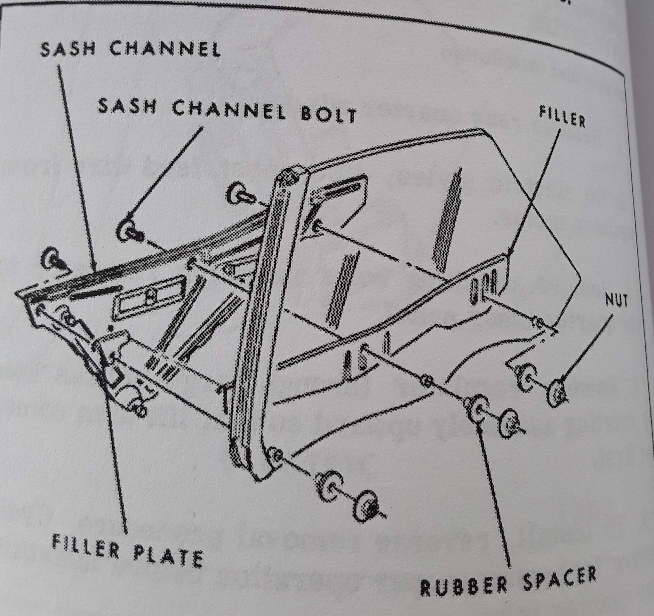

These illustrations are from the factory Body manual. Unfortunately, I read through the text and there is no mention of how they are installed and the pics are pretty basic but I THINK the metal piece goes to the front - it looks like it might be an attachment point.
Thanks Fitzy, I can try that tomorrow. So on the doors would they also go towards the fronts then? Like by the vent window or towards the back where it would be next to the metal piece for the rear felt? You would think that they would come with a picture book for guys like me! :rofl:

No sir Justa, Thats the first I've heard of it :rofl: The pitting on the stealth panel is pretty bad but I can't really do anything about it until I figure out a way to fix the chrome.

Hey Wrongway, I looked through my factory BODY manual and there are no clear illustrations nor directions on what to do with your weatherstrips. It outlines how to remove them, then says to reverse the order to install. Well, duh.
Our respective cars are 26657 styles. You're sure you have the correct strips? Do the old ones have the metal bits on the end?

Wrongway . I will check my 64 when I get a moment . And report back to ya
Ok, so per Kiwi's advice I uploaded that by phone. Only took me about 10 minutes to figure out how to do that. :lol:
