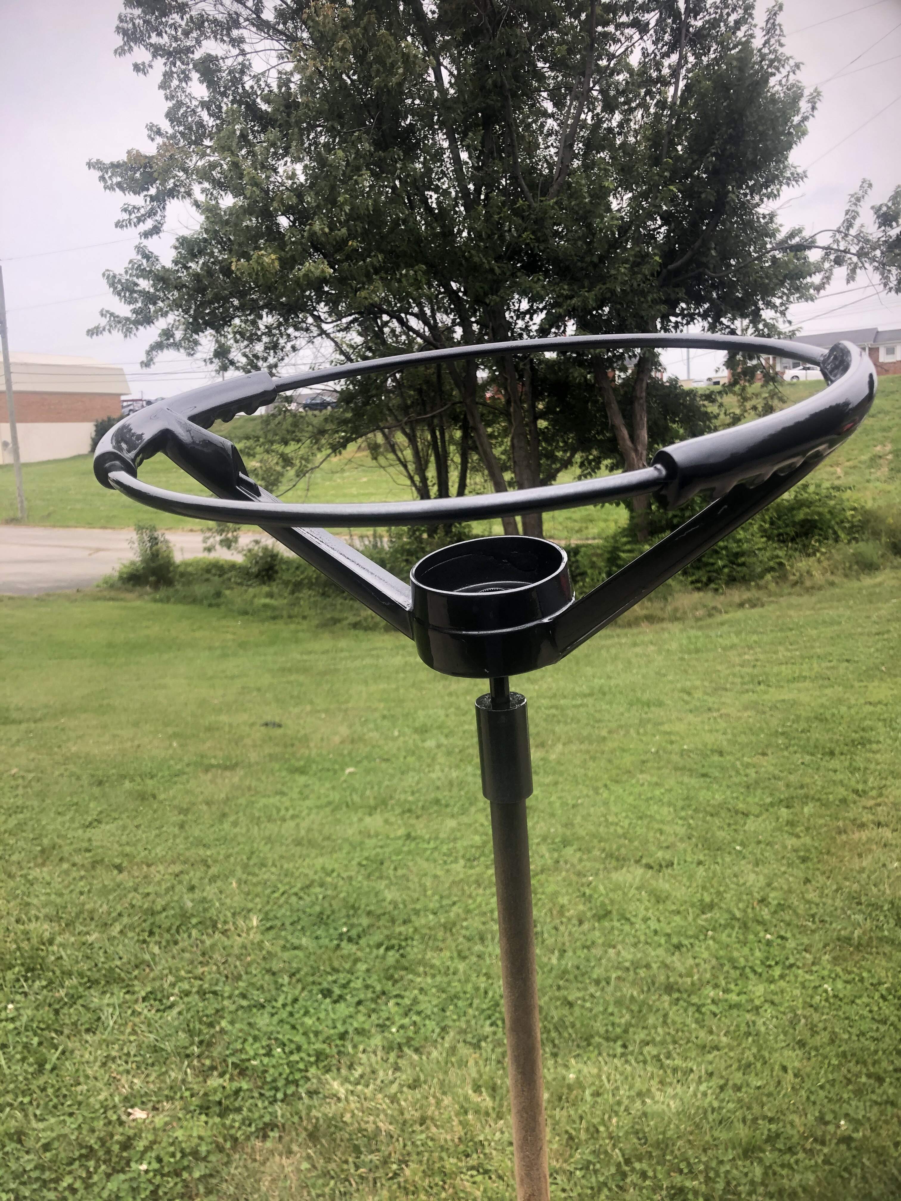

  • Its done, finally finished the steering wheel guys!

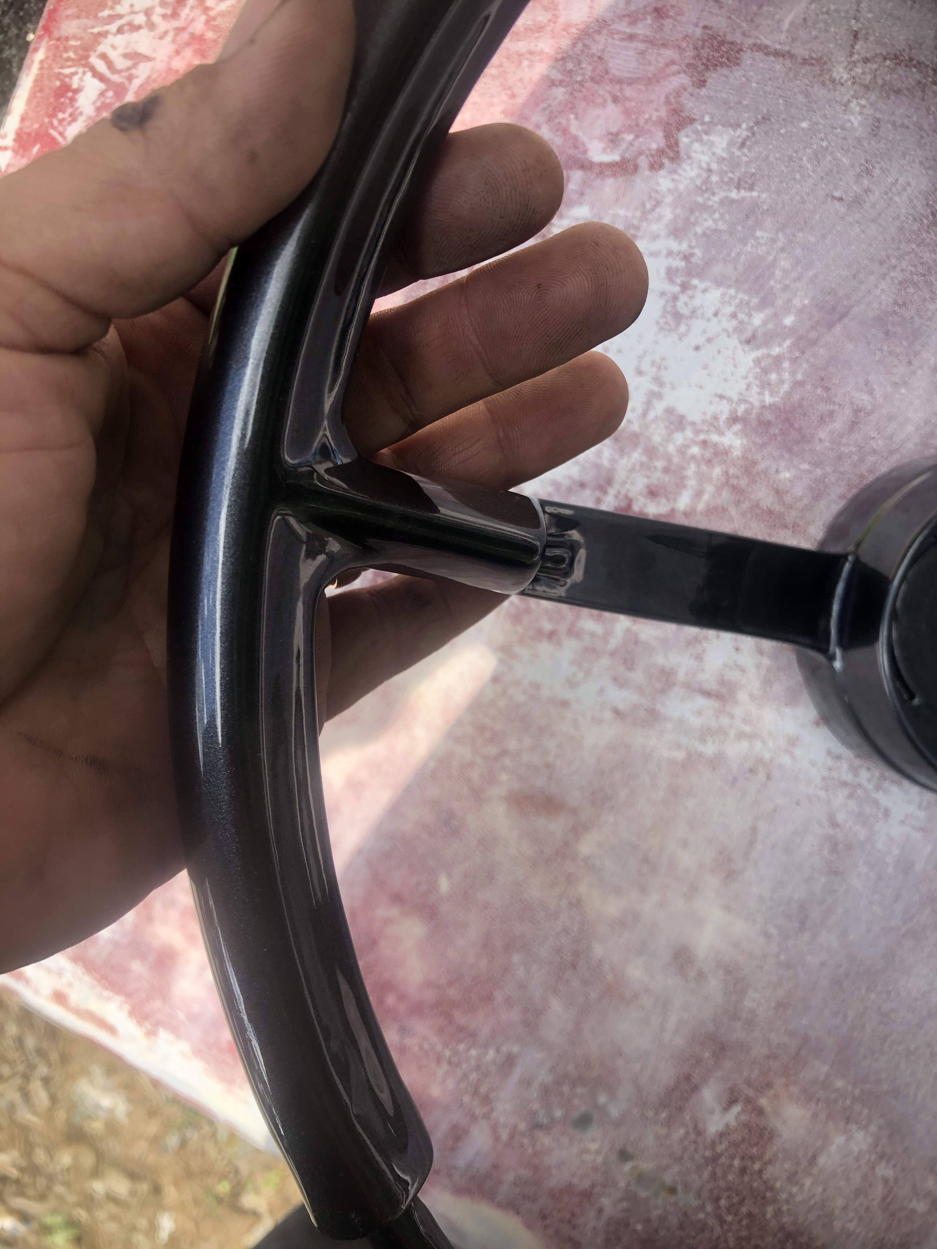

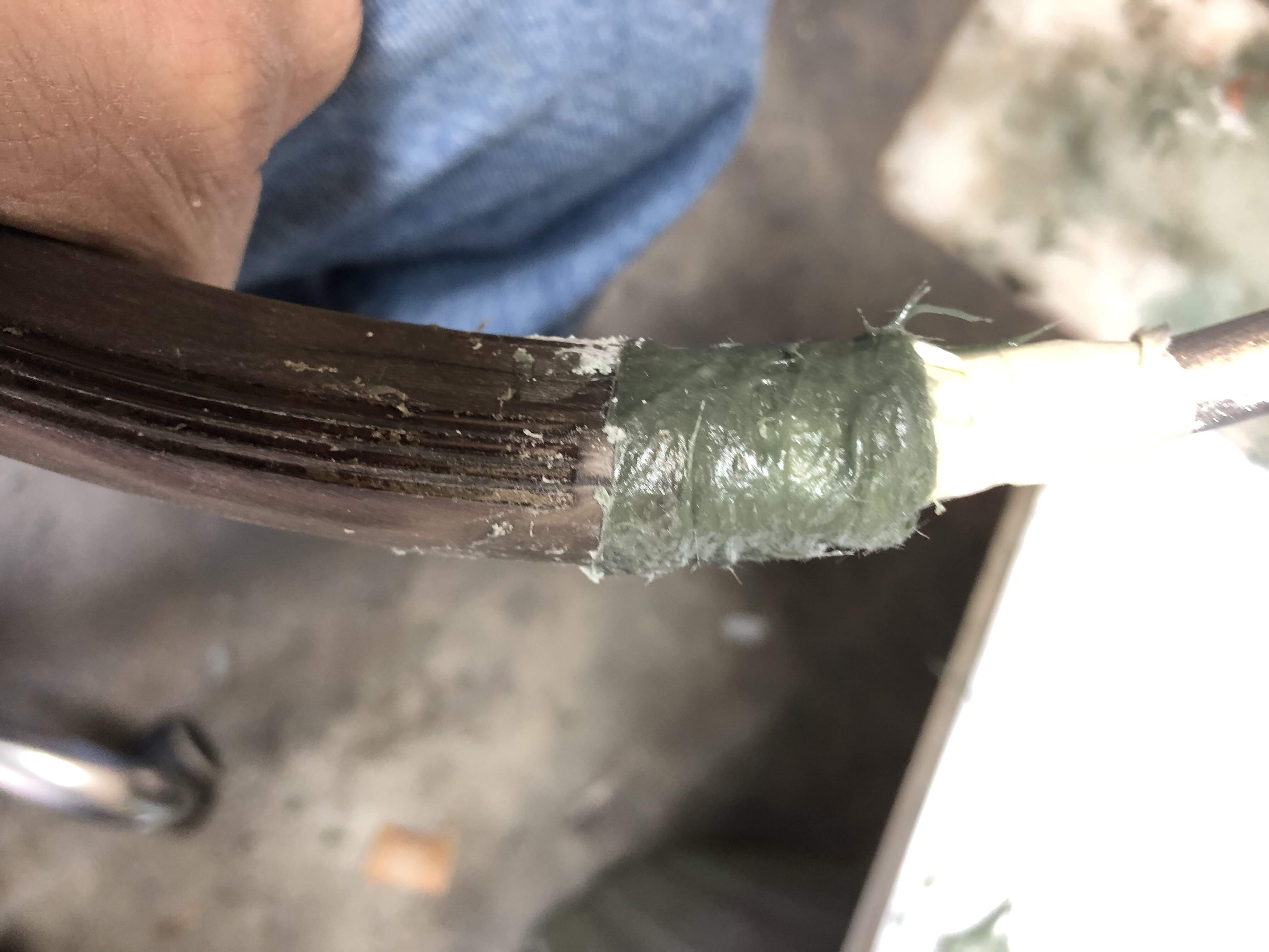

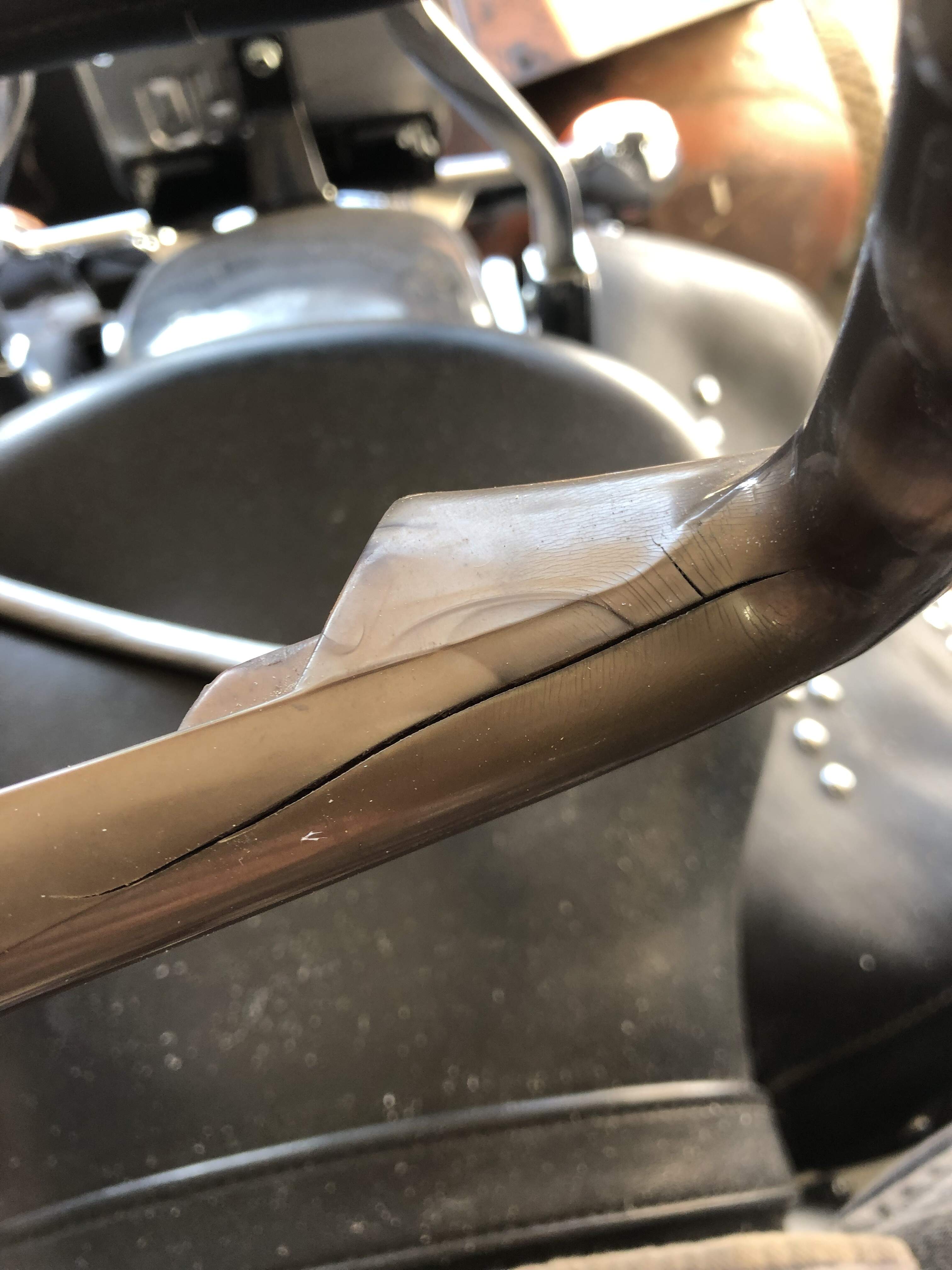

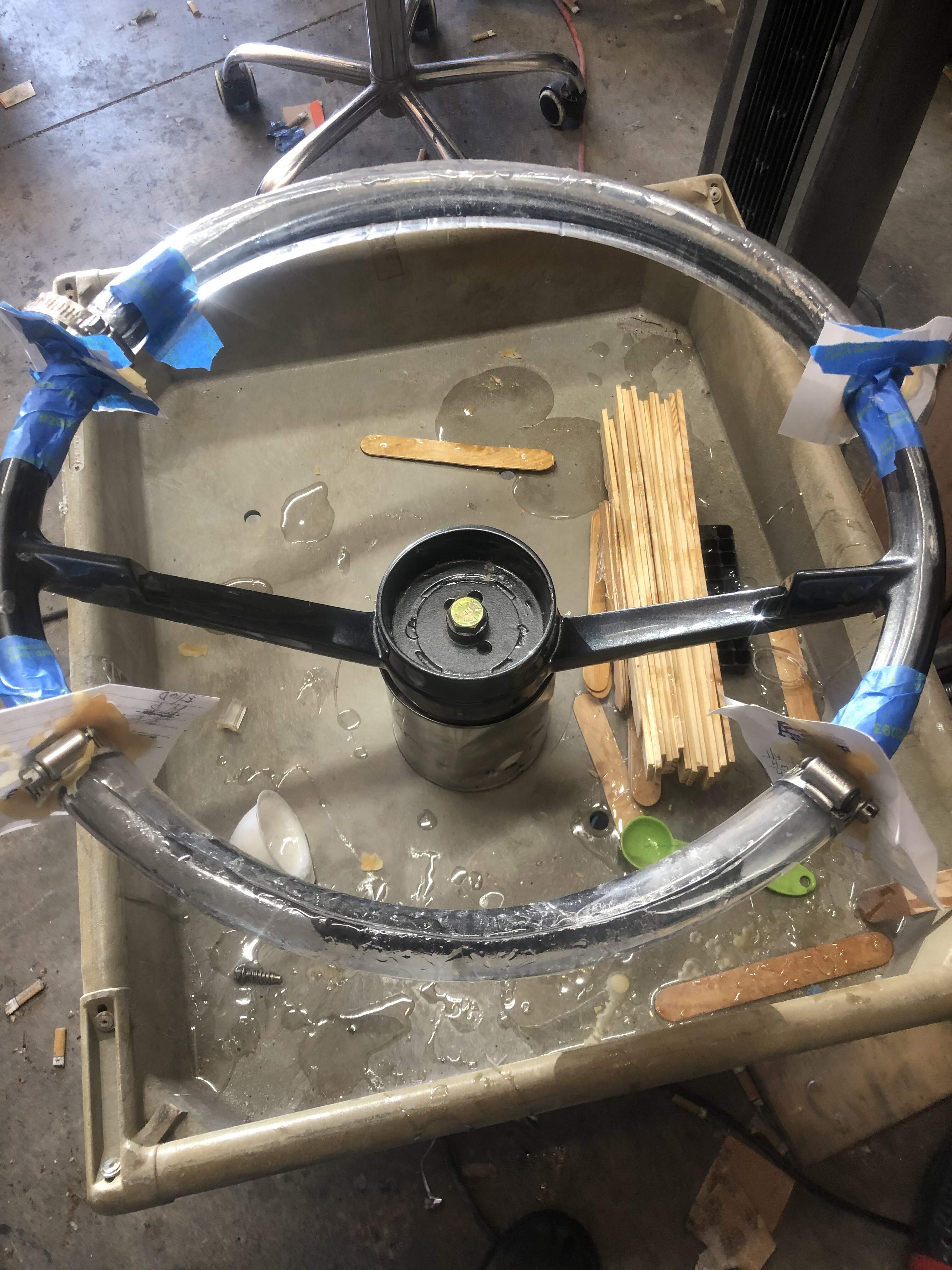

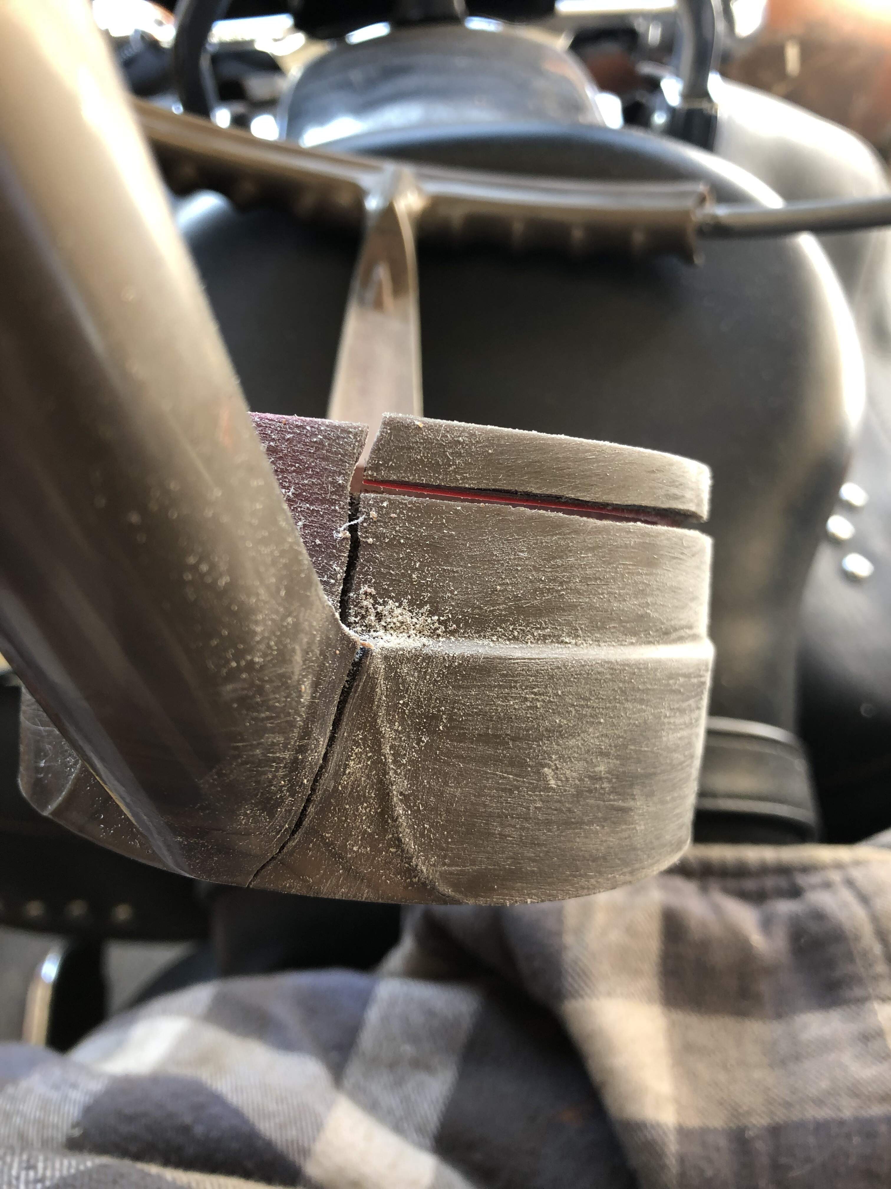

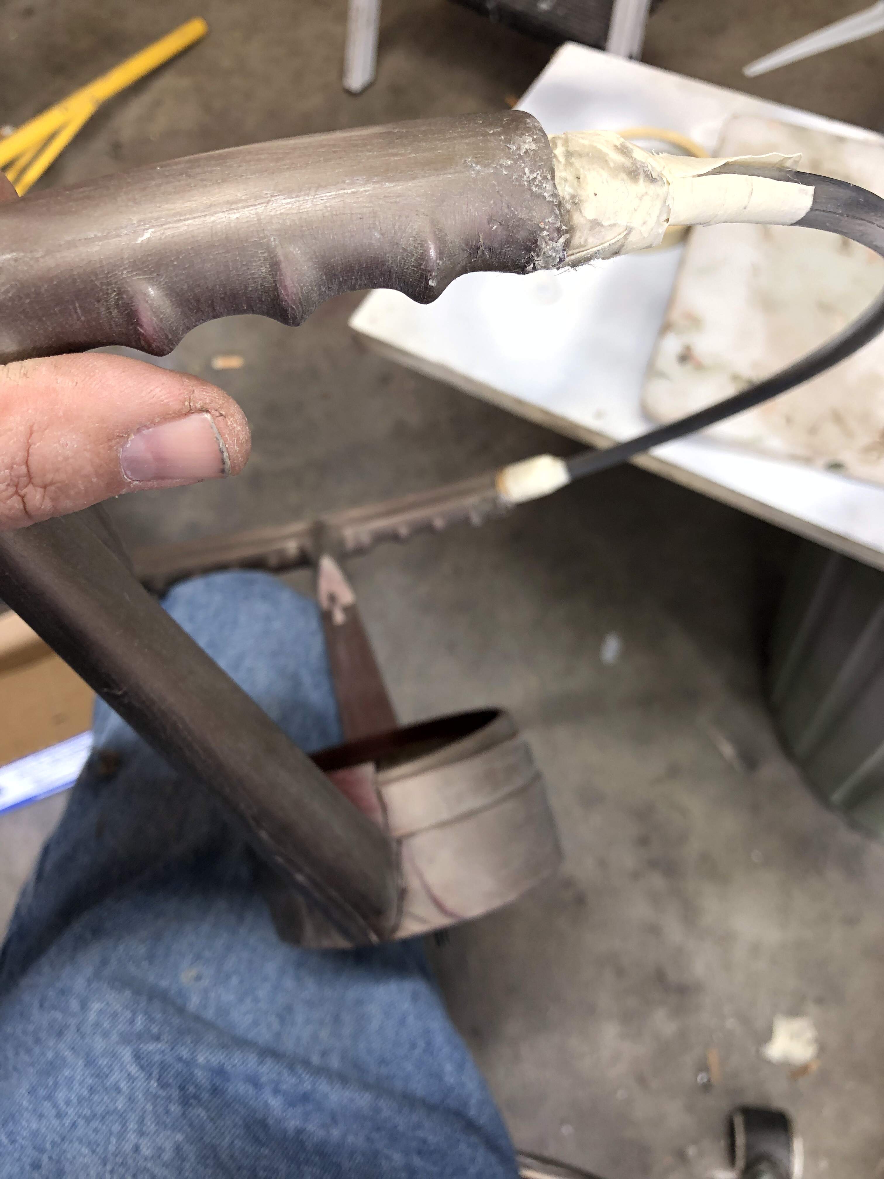

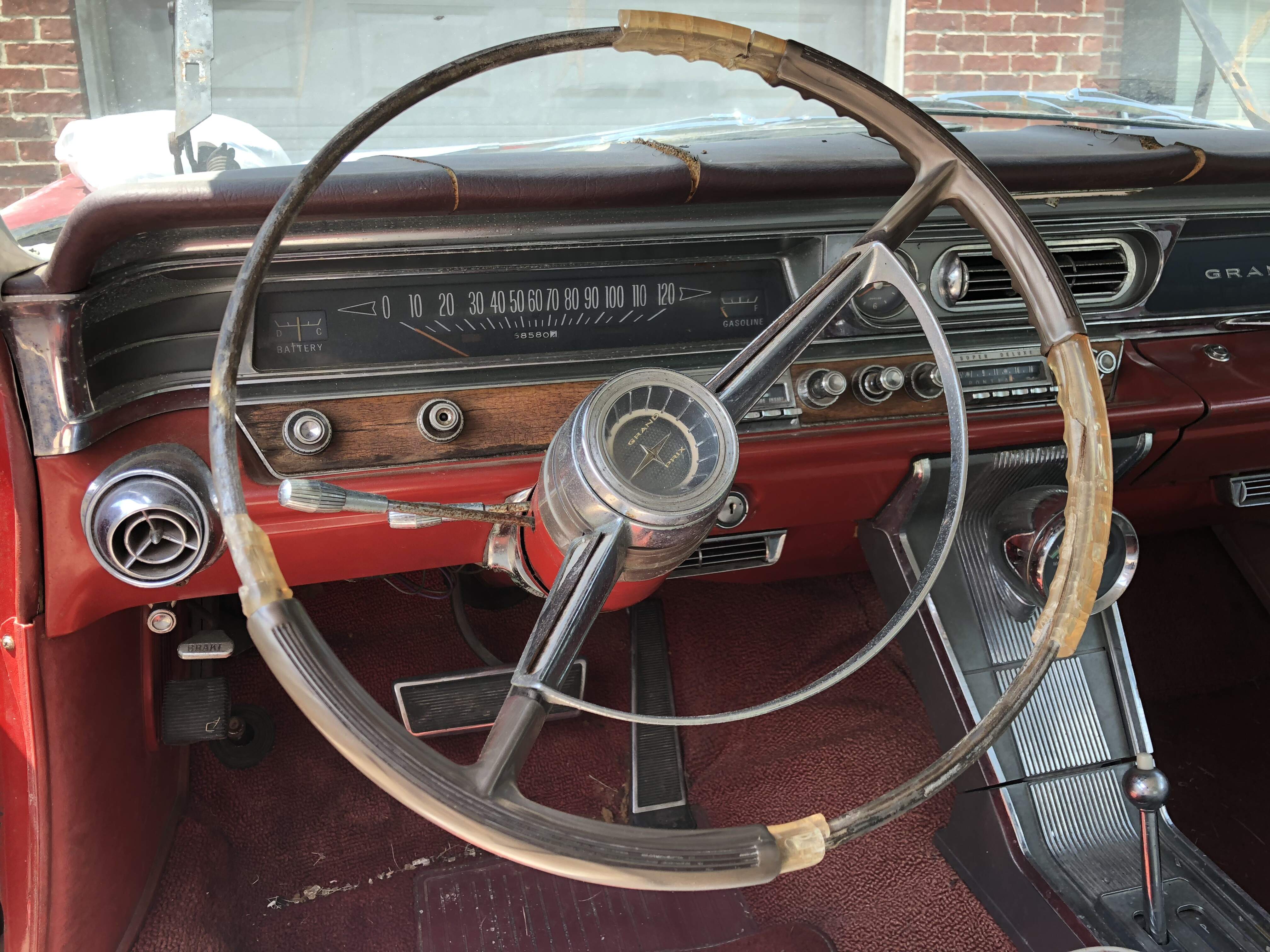

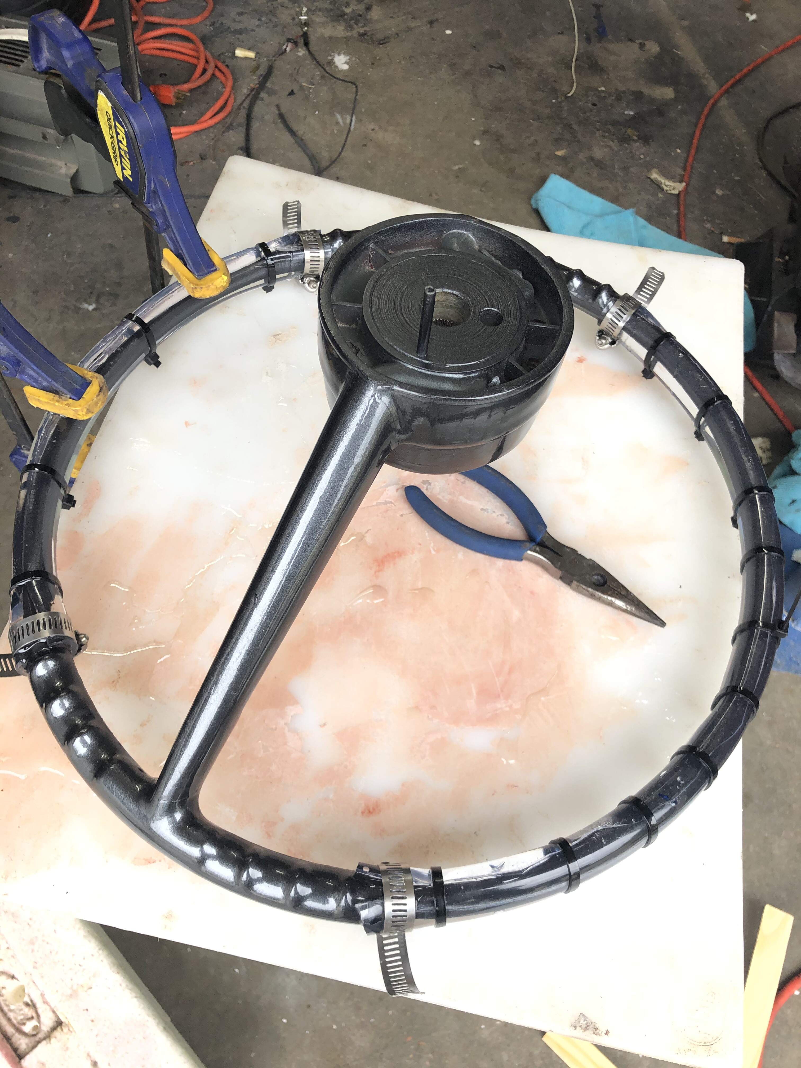

Justa an update, I've got the stuff to do the conversion to disk brakes now and I am getting ready to start the paint job on the roof. More on that to come. But since we've been getting rain justa' bout every day I decided to go back to a project that I started a couple winters ago. Rebuilding the steering wheel. So you can see almost all of the acrylic or plastic is gone and some major cracks in the vinyl not to mention where the acrylic meets the vinyl its chipped and jagged.

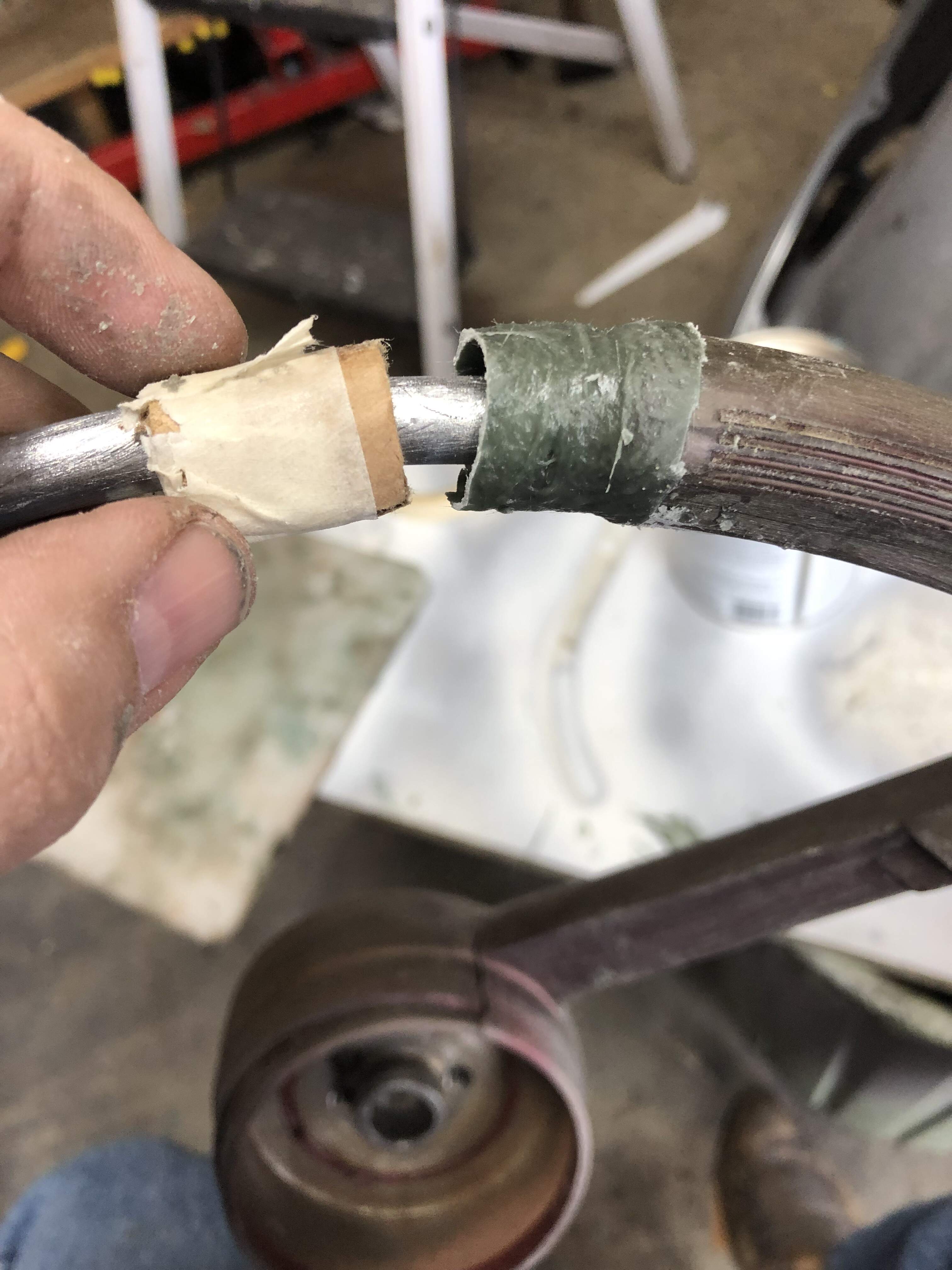

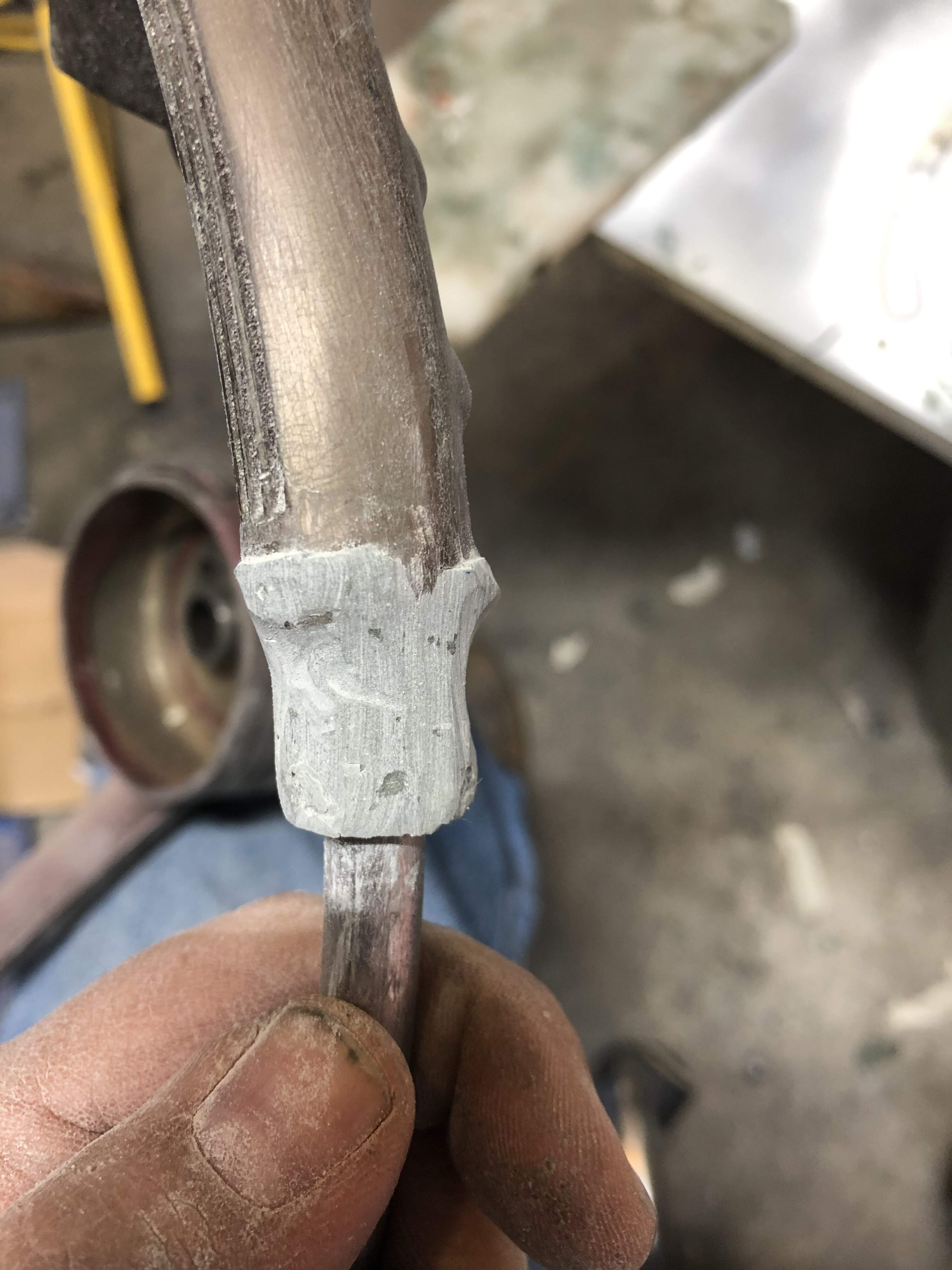

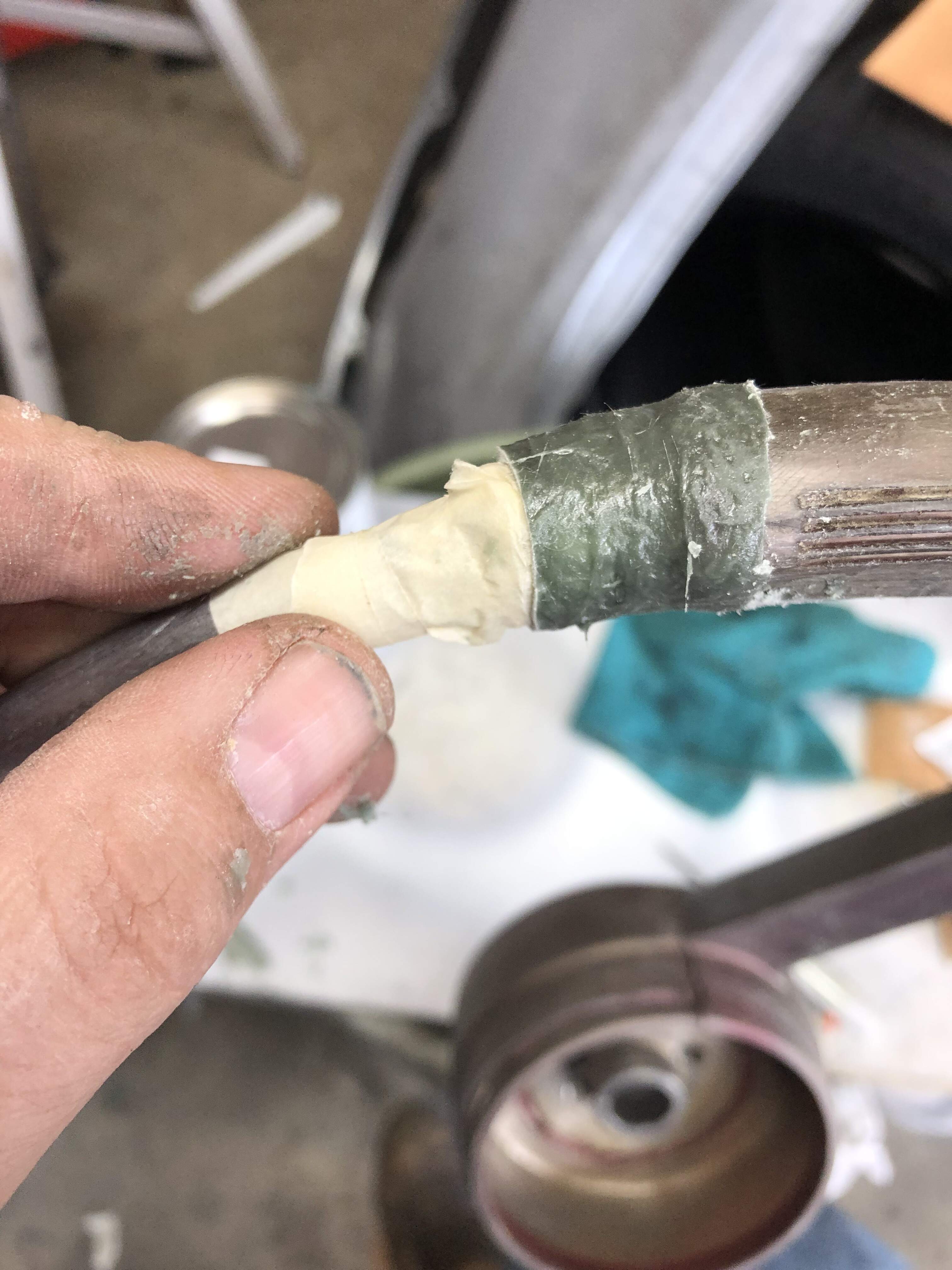

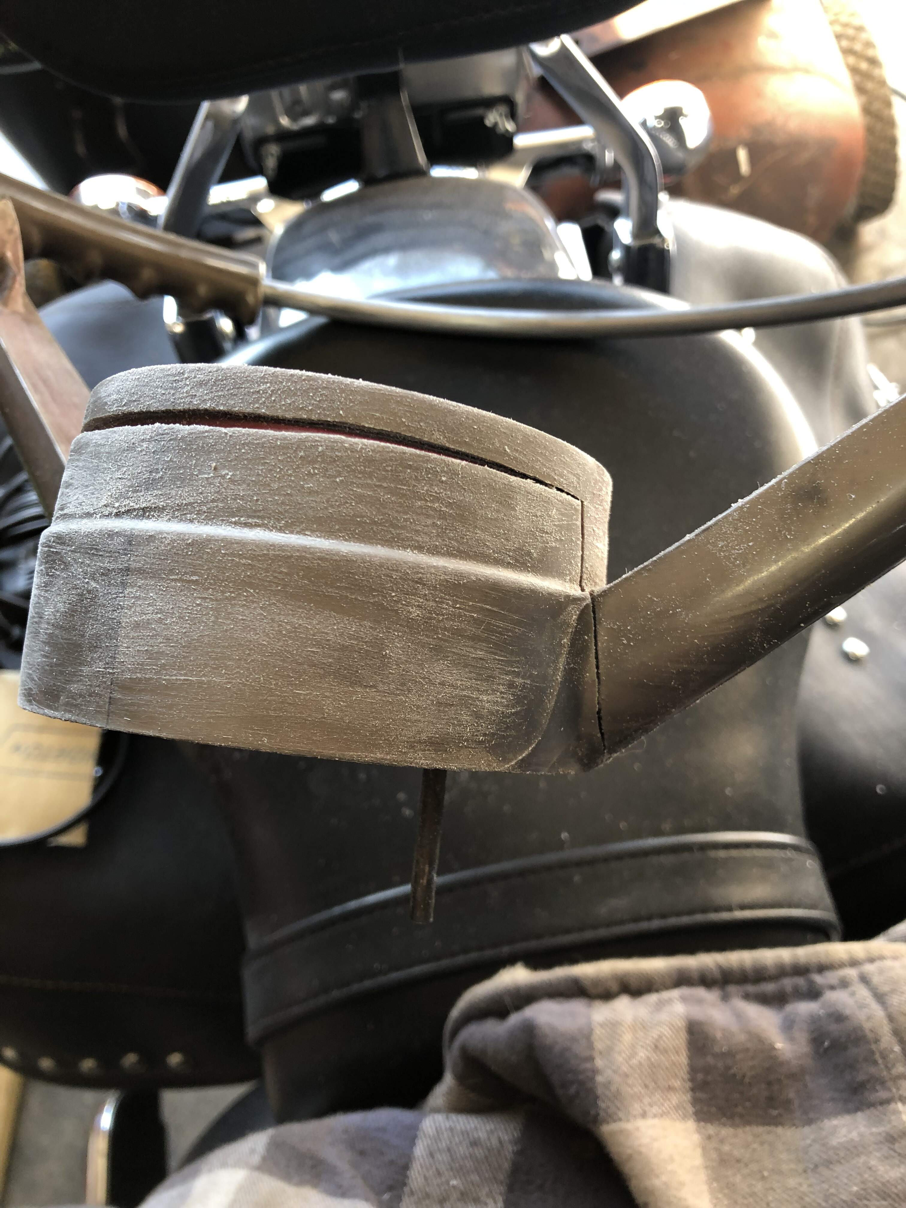

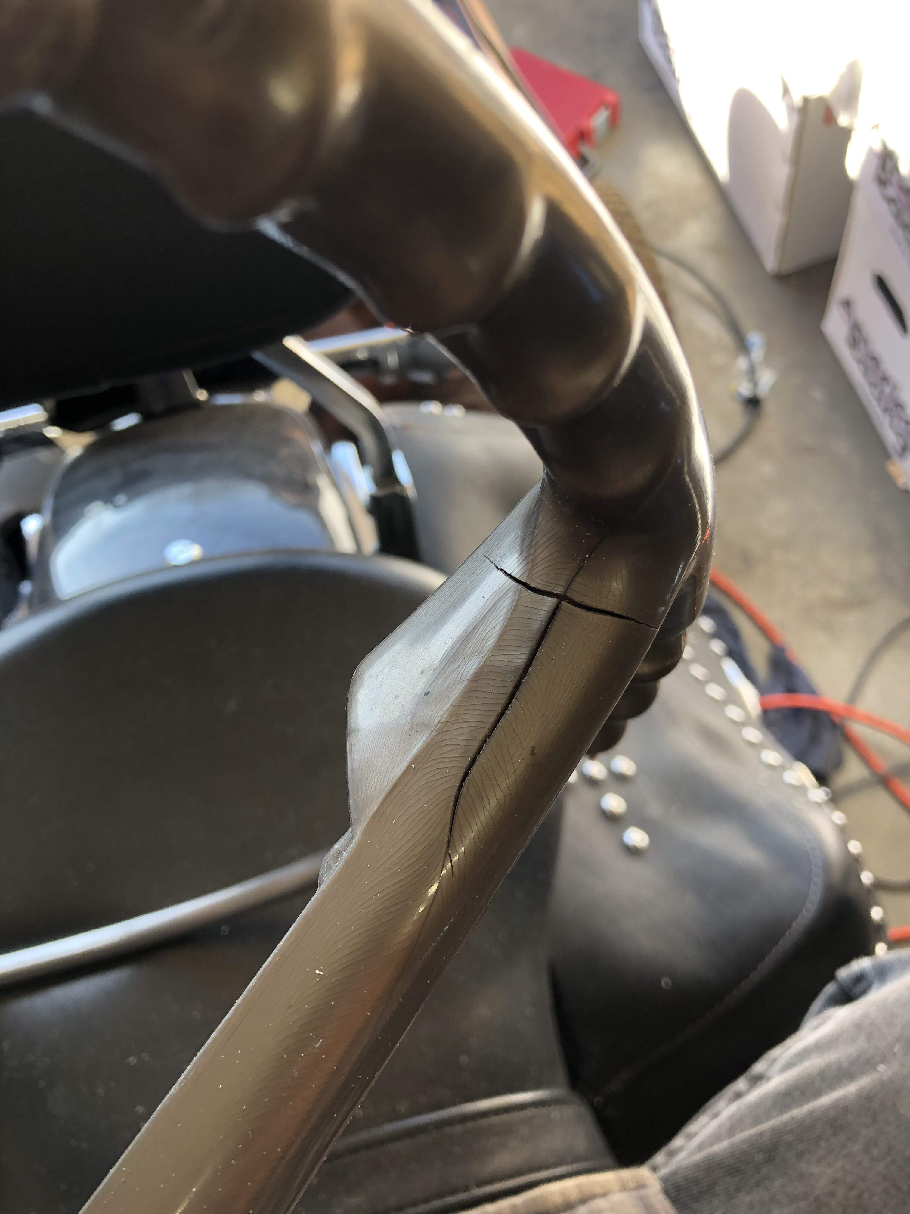

After sanding everything down and cleaning it up I slide a small tube inside the vinyl to allow the new acrylic to flow inside the vinyl a little ways. Then I build it up and extended the ends about 1/2" with long hair fiberglass. Once cured I removed the tube and tape and trimmed it back. Added a bit of body filler to smooth and smoothed it out and shot it with self etching primer.

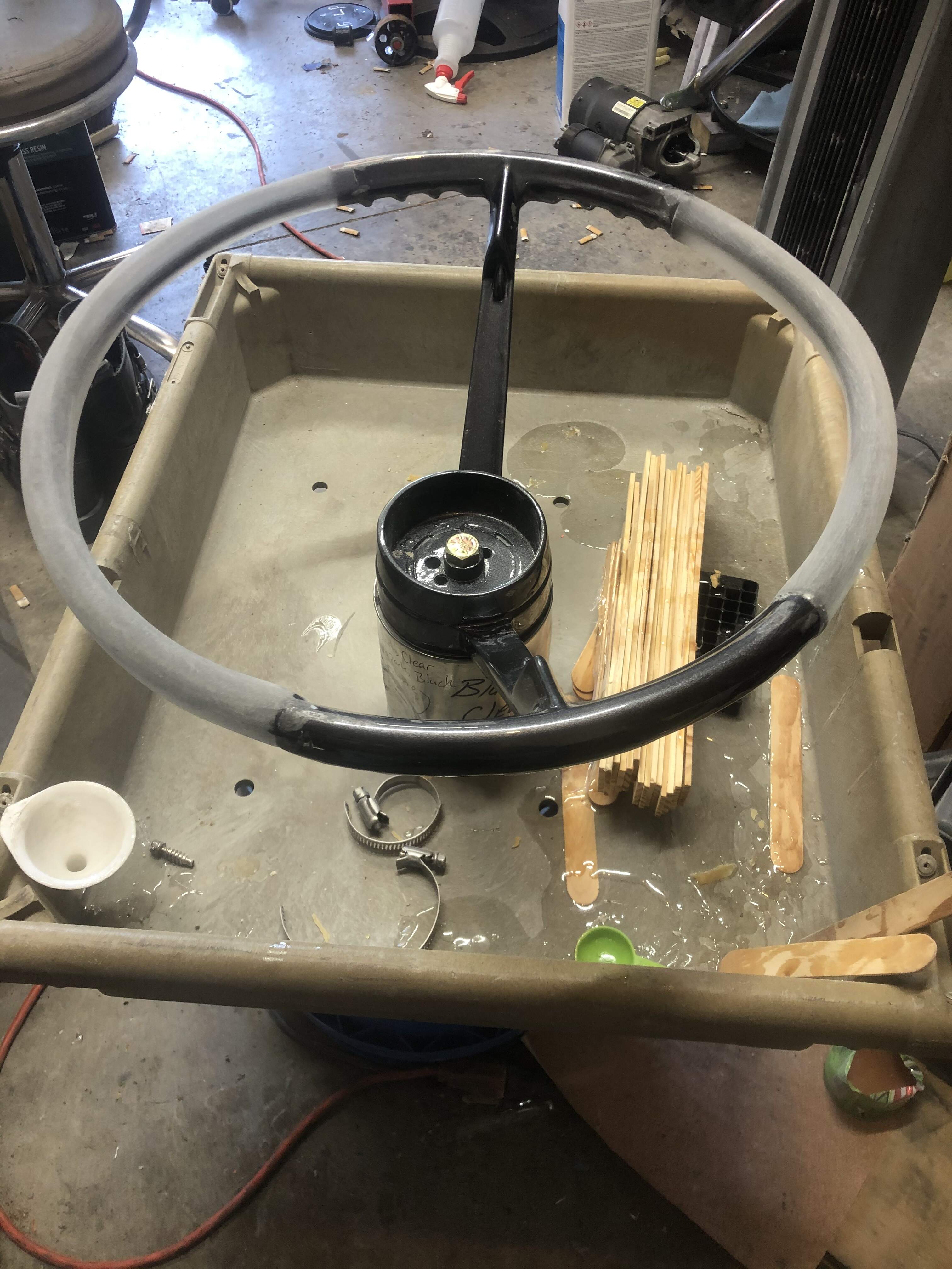

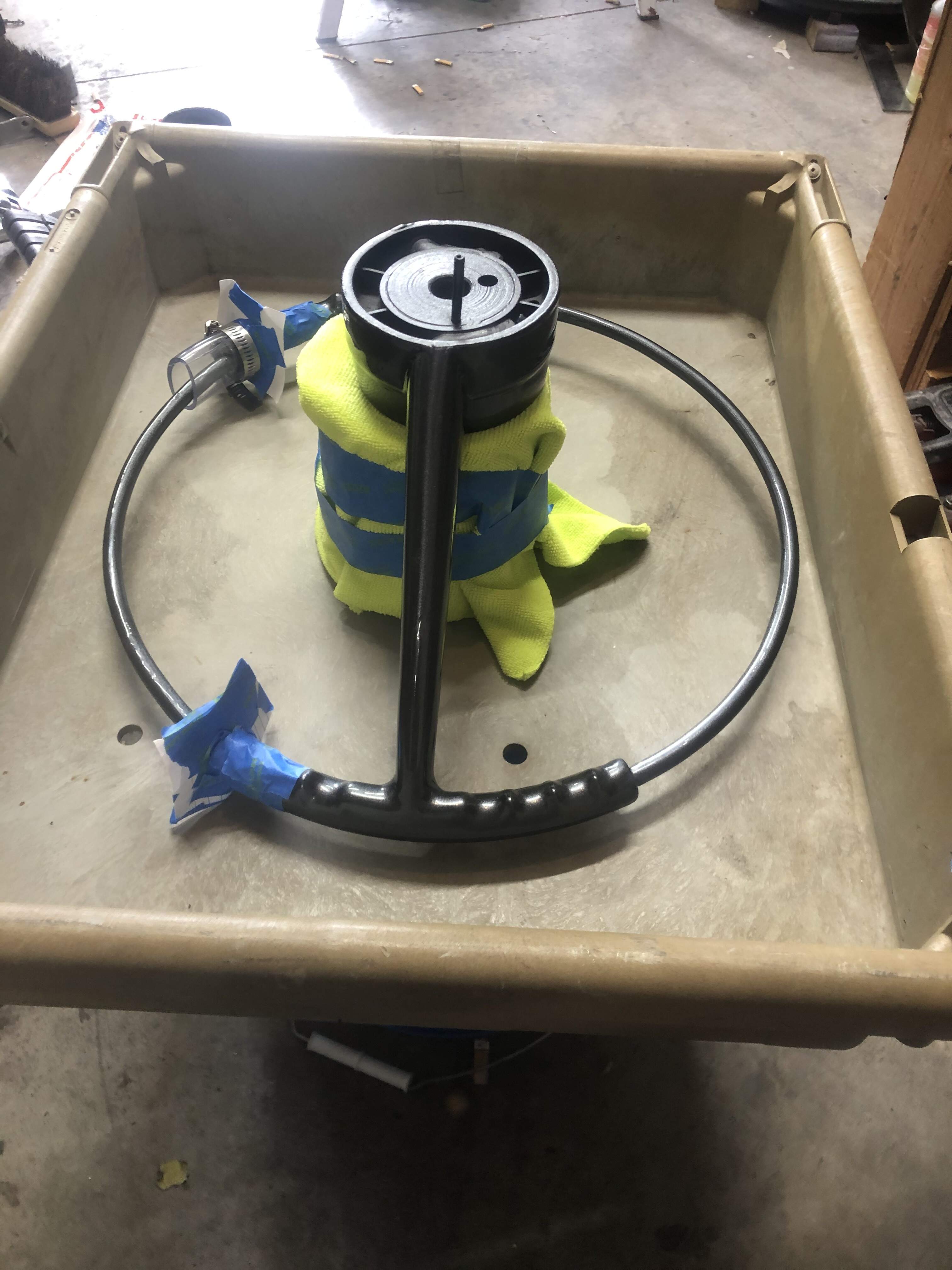

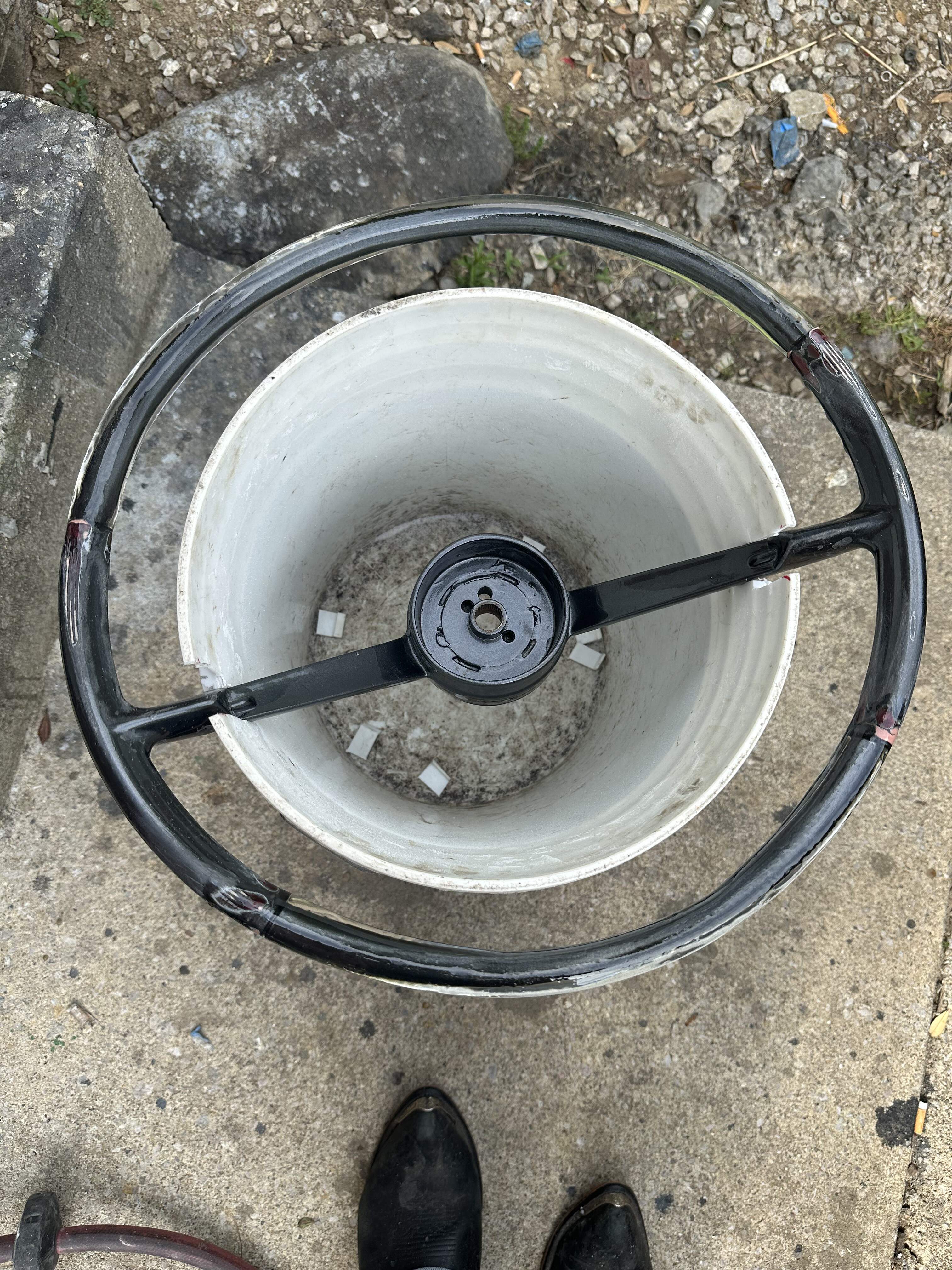

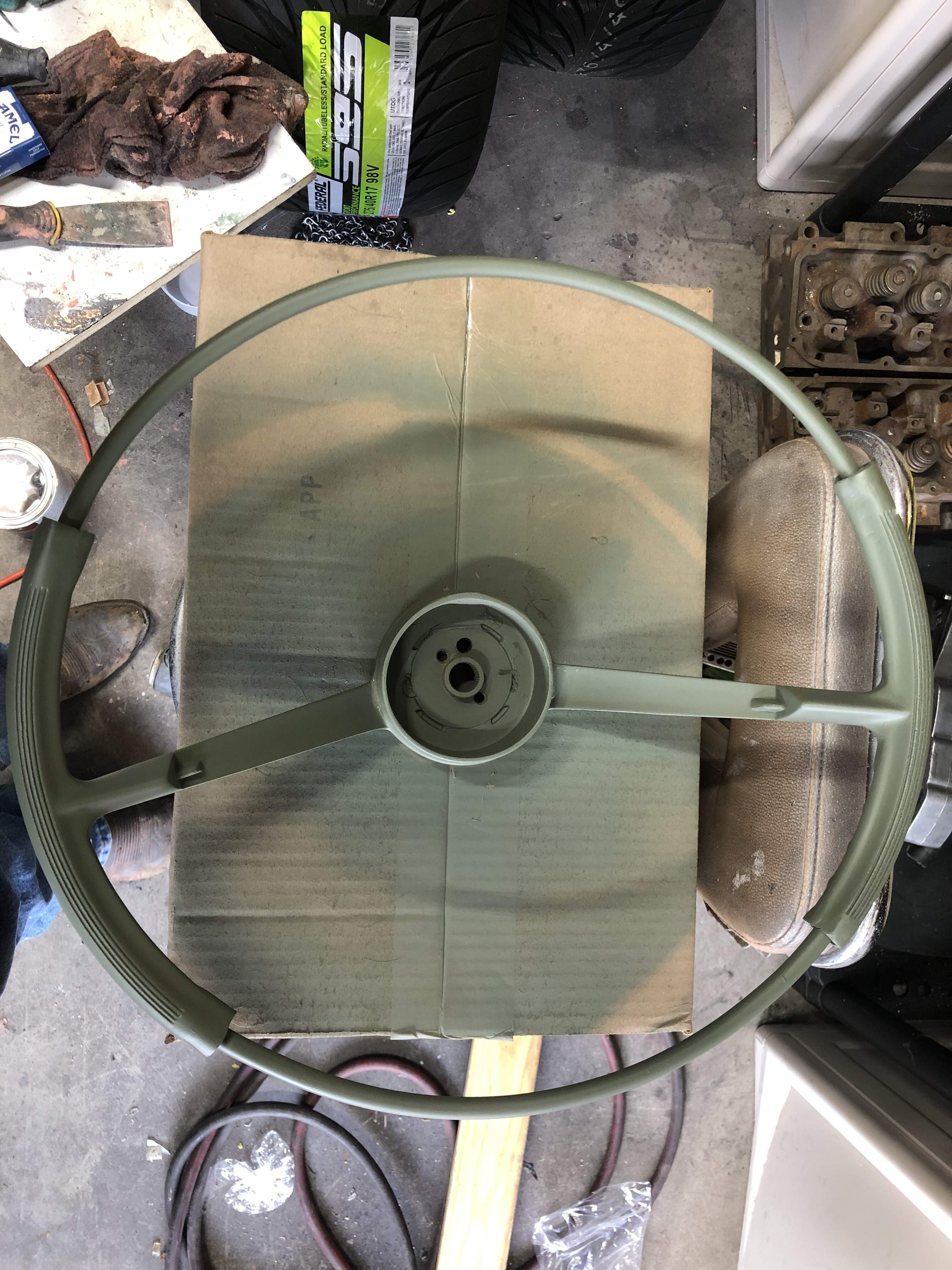

And she's painted! So, I let the paint sit for a few days to make sure it was good and hard. Time to add the acrylic.

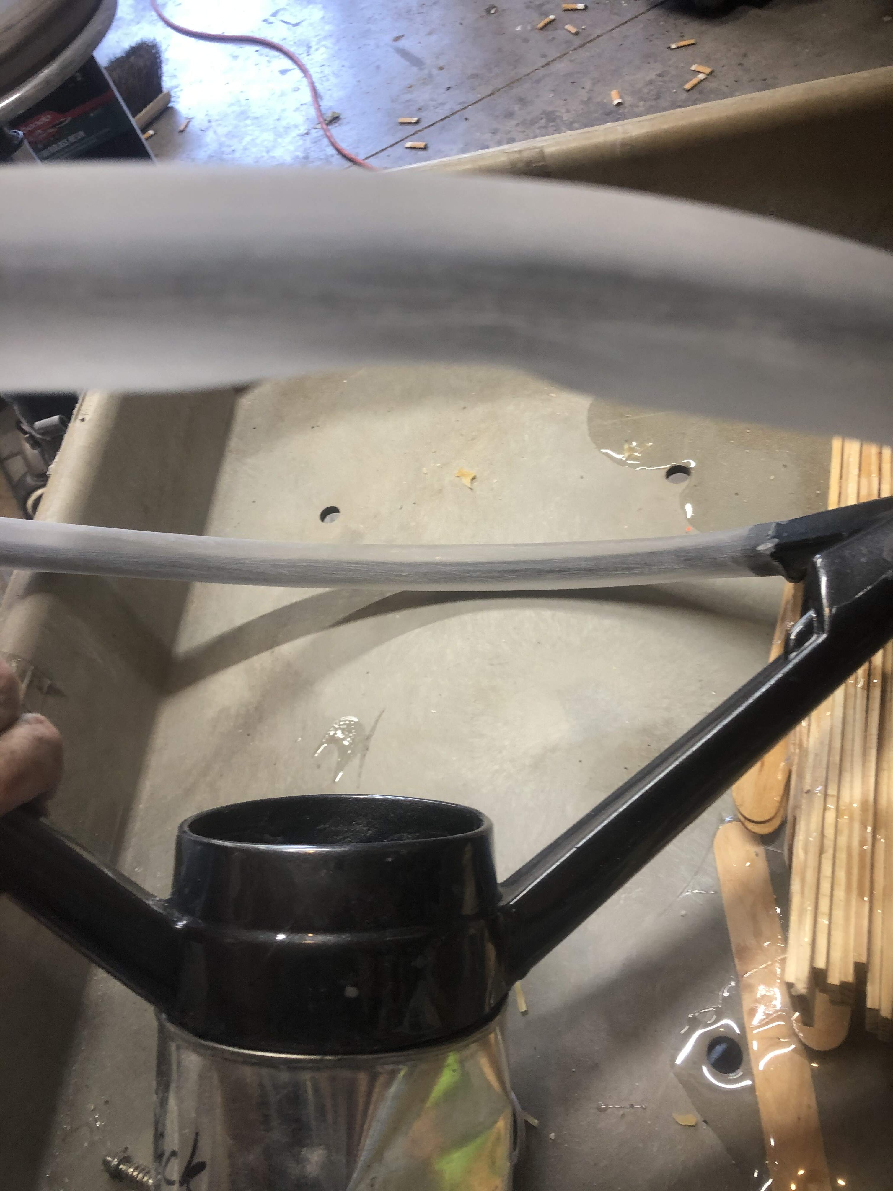

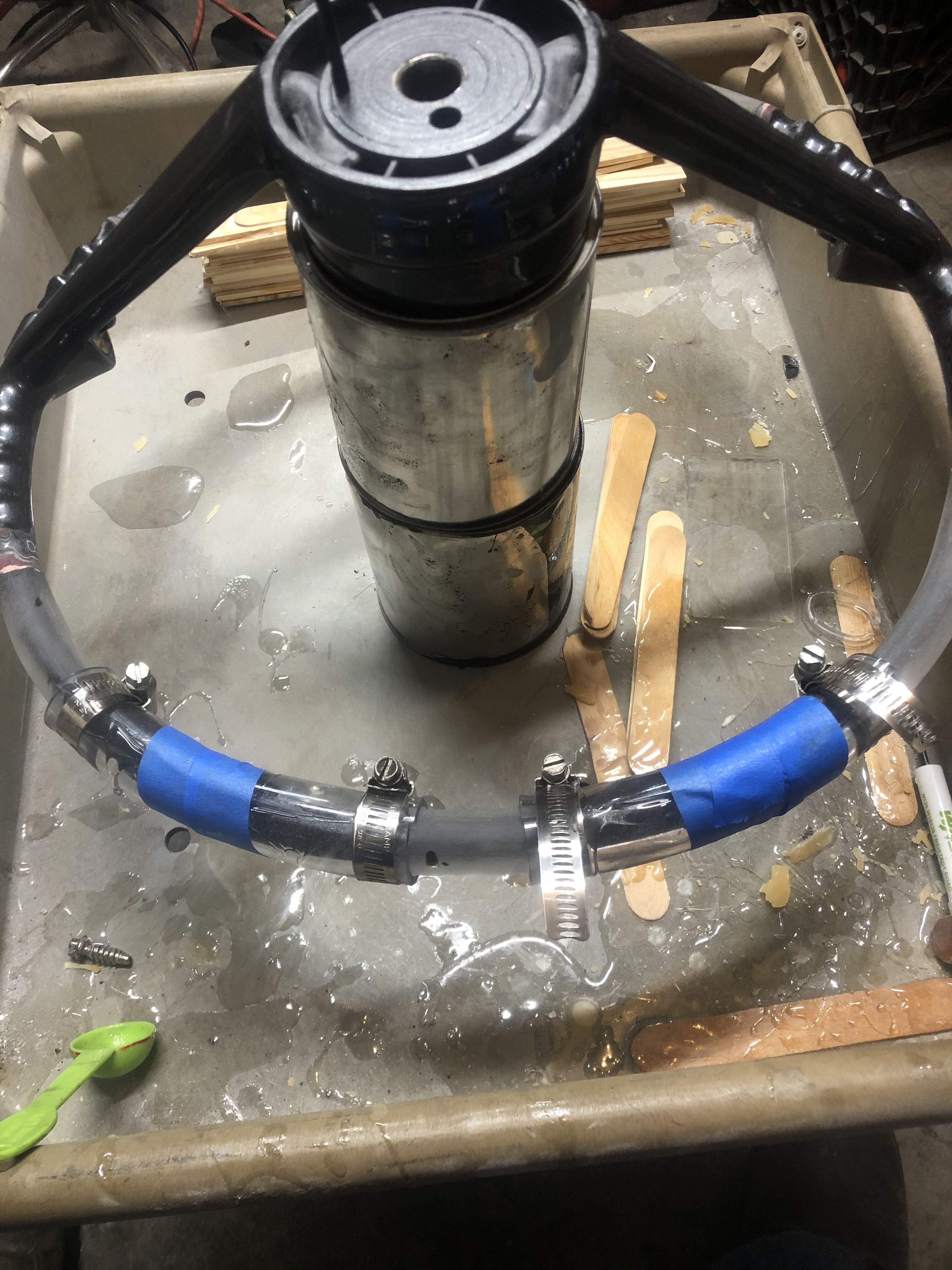

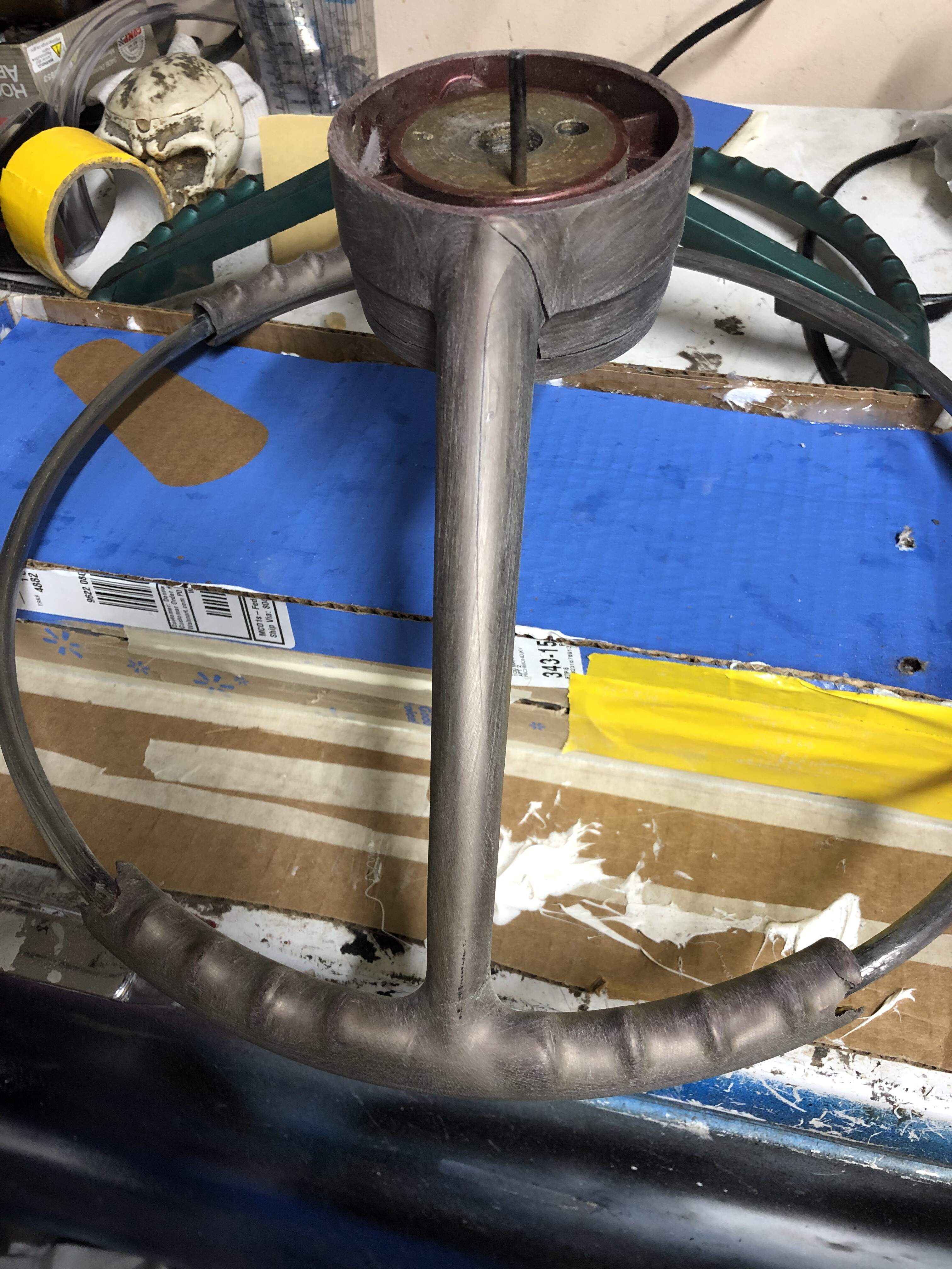

So, keep in mind that I have NEVER worked with acrylic before. What a damn mess!!! I figured that I could use a hose to contain the acrylic. WRONG! I use a 1" piece of black hose I had leftover laying in the shop. Upon opening the hose, I realized it only filled up about halfway after it all leaved out. Second try, clear hose. I still couldn't contain the acrylic in the hose, its seriously thin as water and takes 24hrs to cure. It stops leaking around 10-11hrs into the cure. I tried multiple ways to keep it from leaking with no success. I finally justa started checking it and topping it off once every hour. Once cured and the hose off I could see that there's highs and lows and the distance between the frame and acrylic is way off. I spent a few days sanding by hand because I couldn't find a way to sand it easily. I finally hand enough of the sanding, stilled pissed at all the leaks and wasted acrylic I set it on shelf and moved on figuring Id justa buy one.

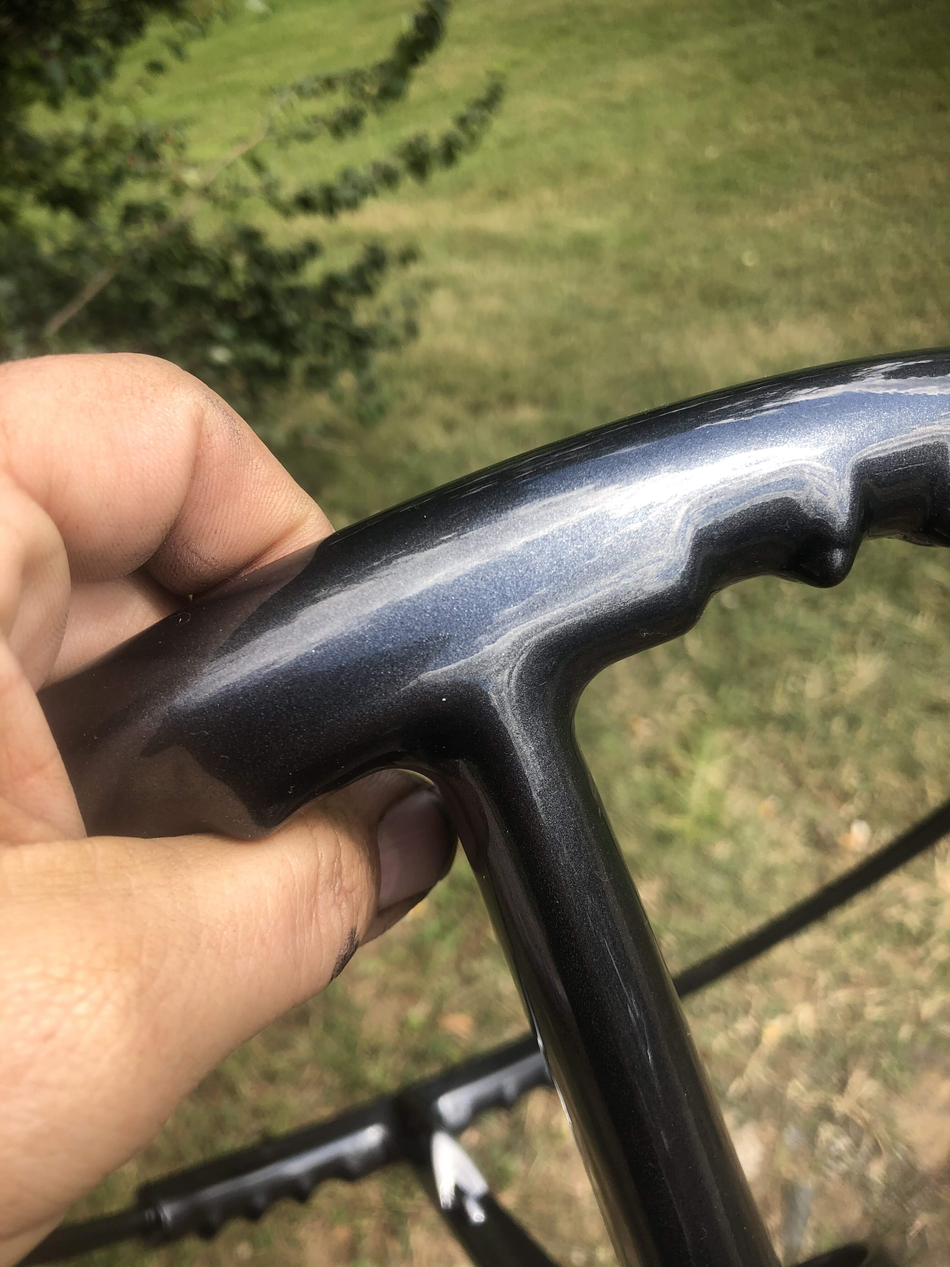

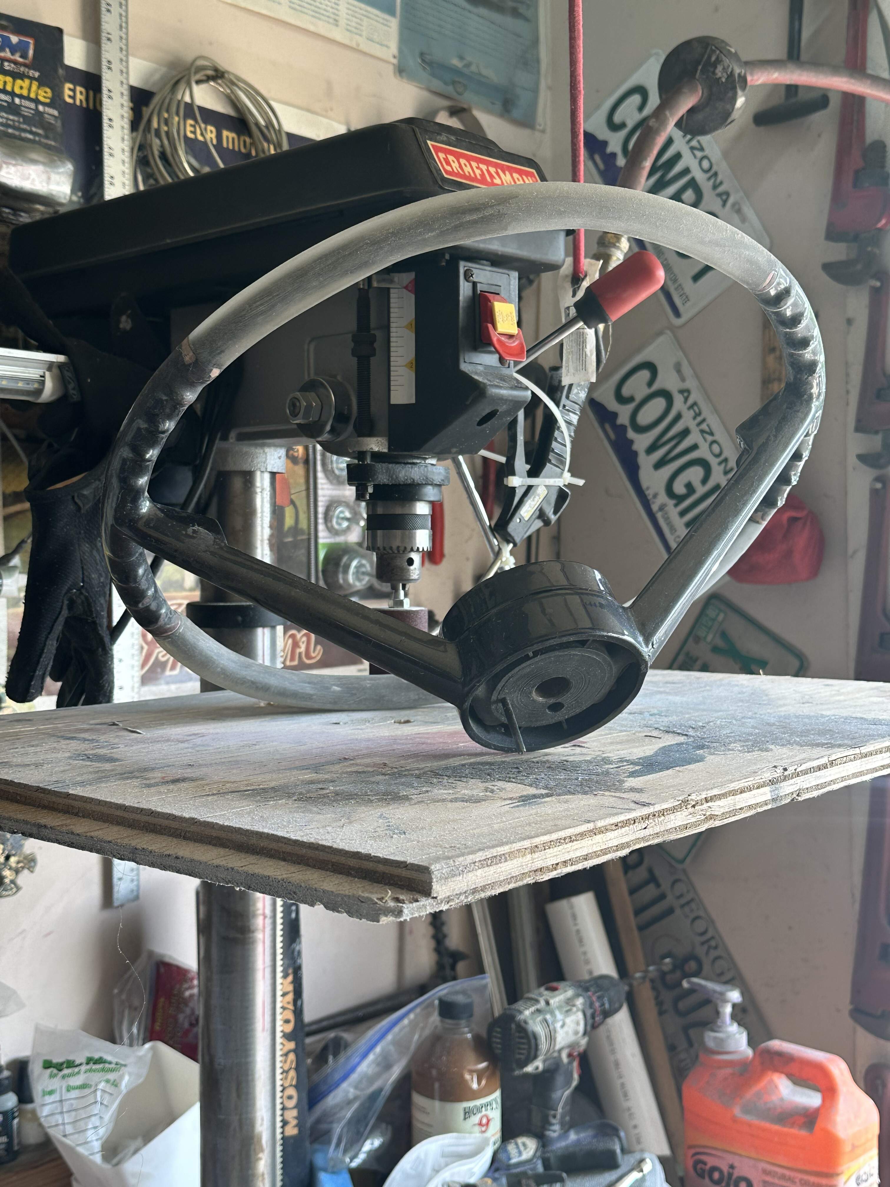

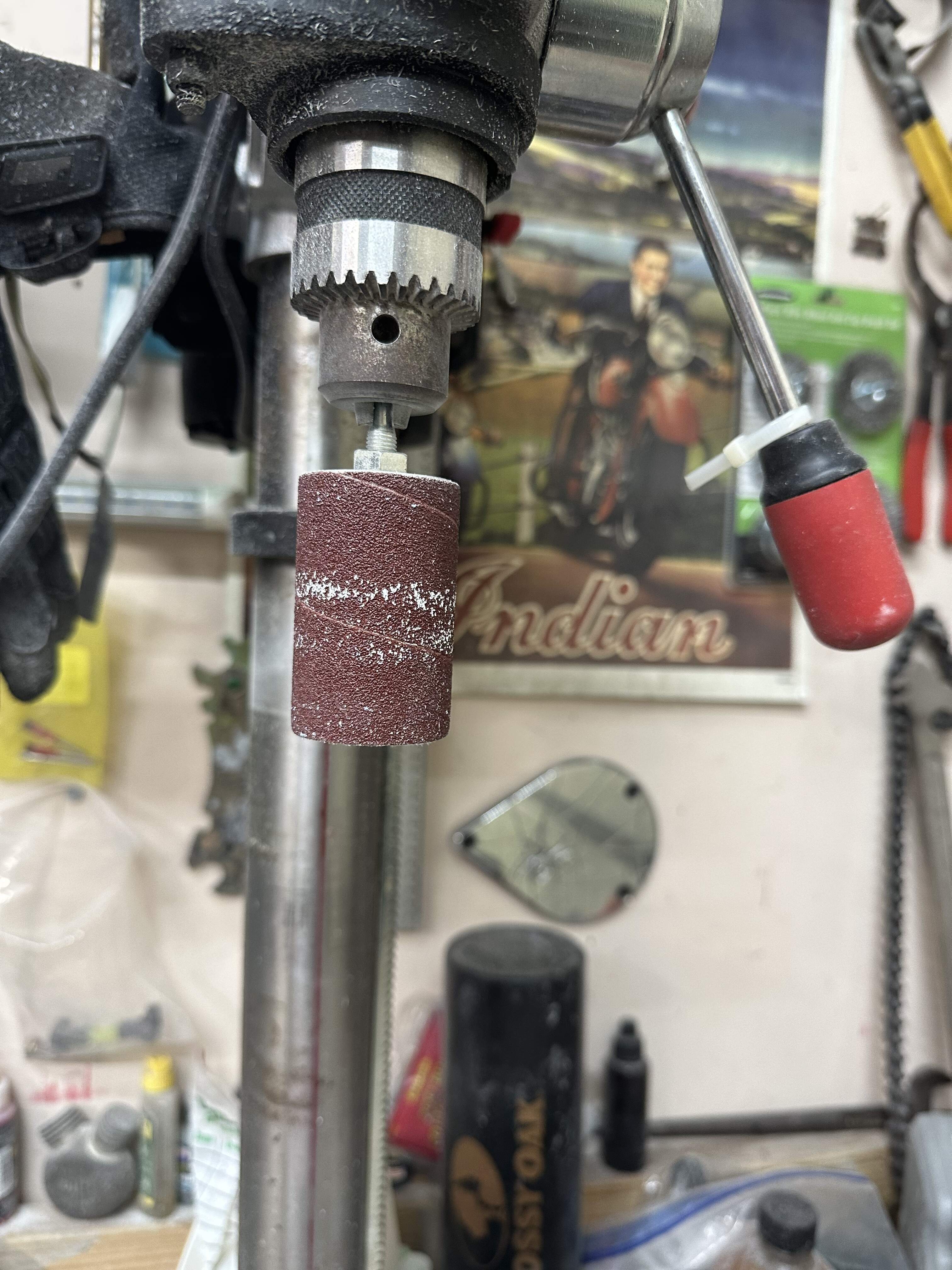

Justa the other day I came across a drum sander and thought hey that might work. So I order a set which allowed me to use the drill press to sand down the parts that were 1/2"-3/4" to thick. It took me about 2 1/2hrs to sand everything down. Still have some low spots that I'm working to get up to level but it's getting there. Only problem now is that each coat takes 24hrs to dry and its super thin and runny so no think coats. But here's what it looks like today. It did also get scratched up do to all the hand sanding and will have to be repainted.

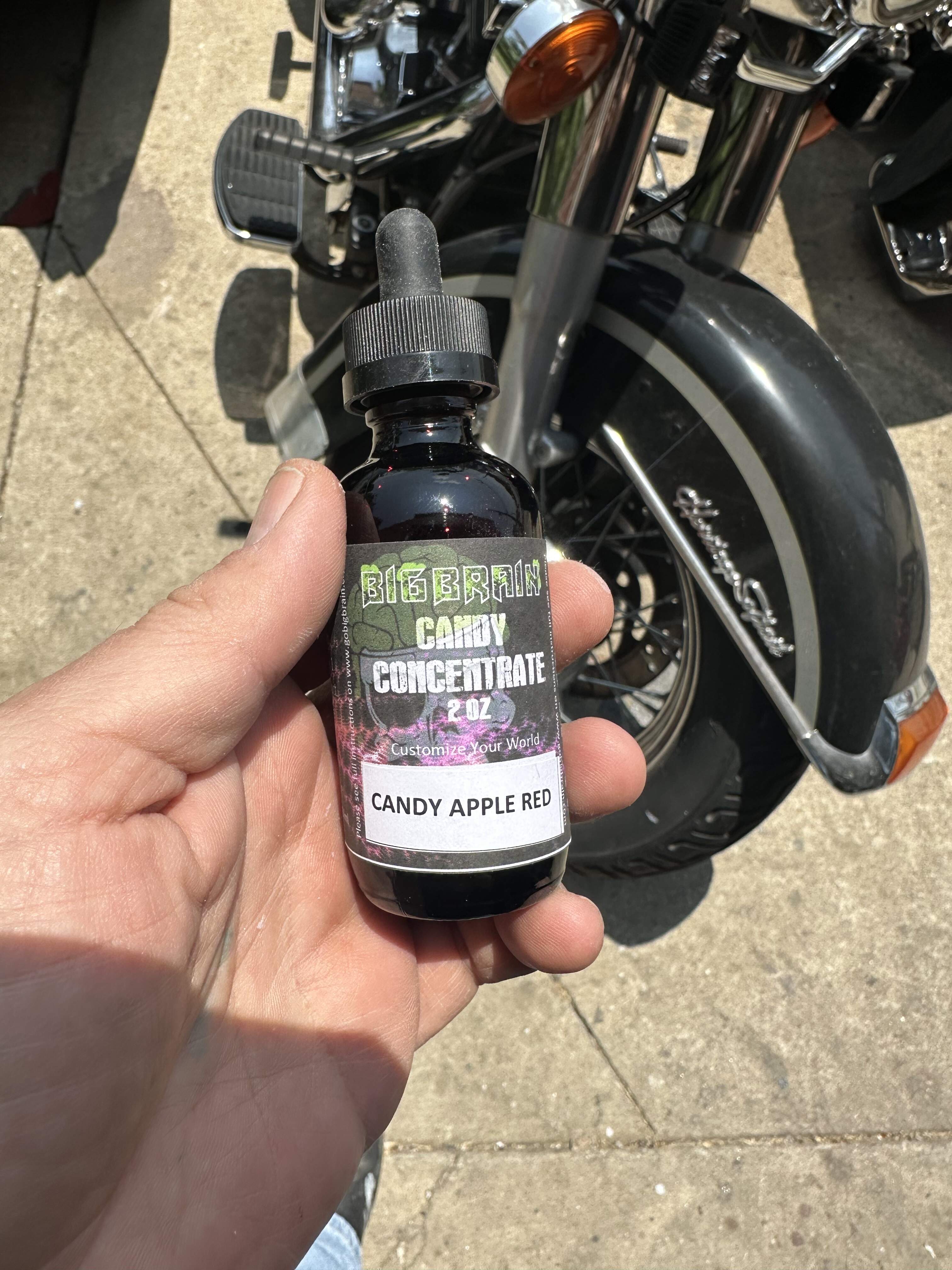

The last picture is the acrylic that I decided to use. Its supposed to be UV resistant.

holey cow mate !!! thats sooo clever!!!
As you know both me and fitzy have been there done that but not to the level yiu have gone too !!!:cheers:
well done mate !!!
it looks really good !
You are Da man!  Excellent job, lotta time work and $$$, but you should be very proud of the outcome.

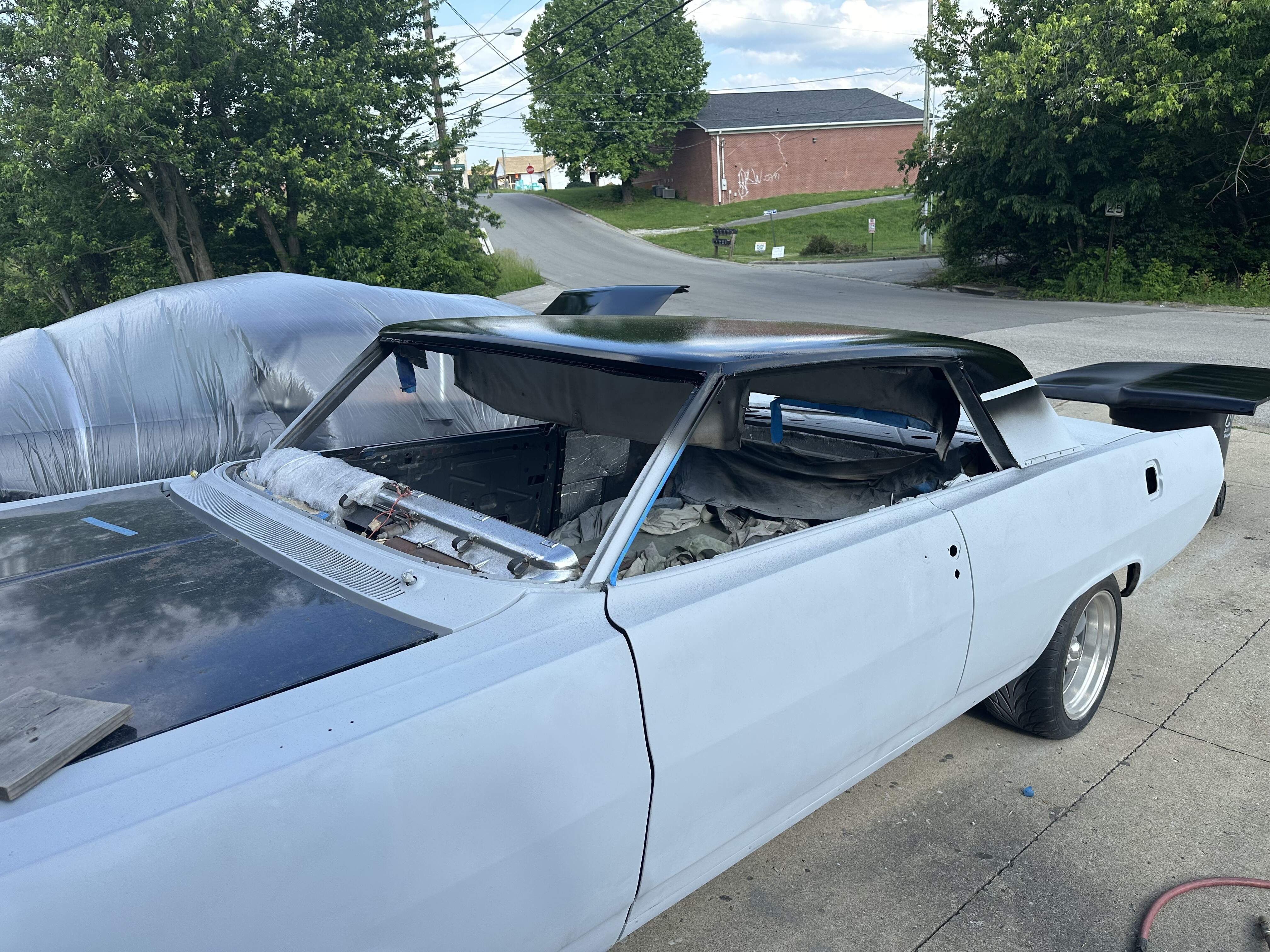

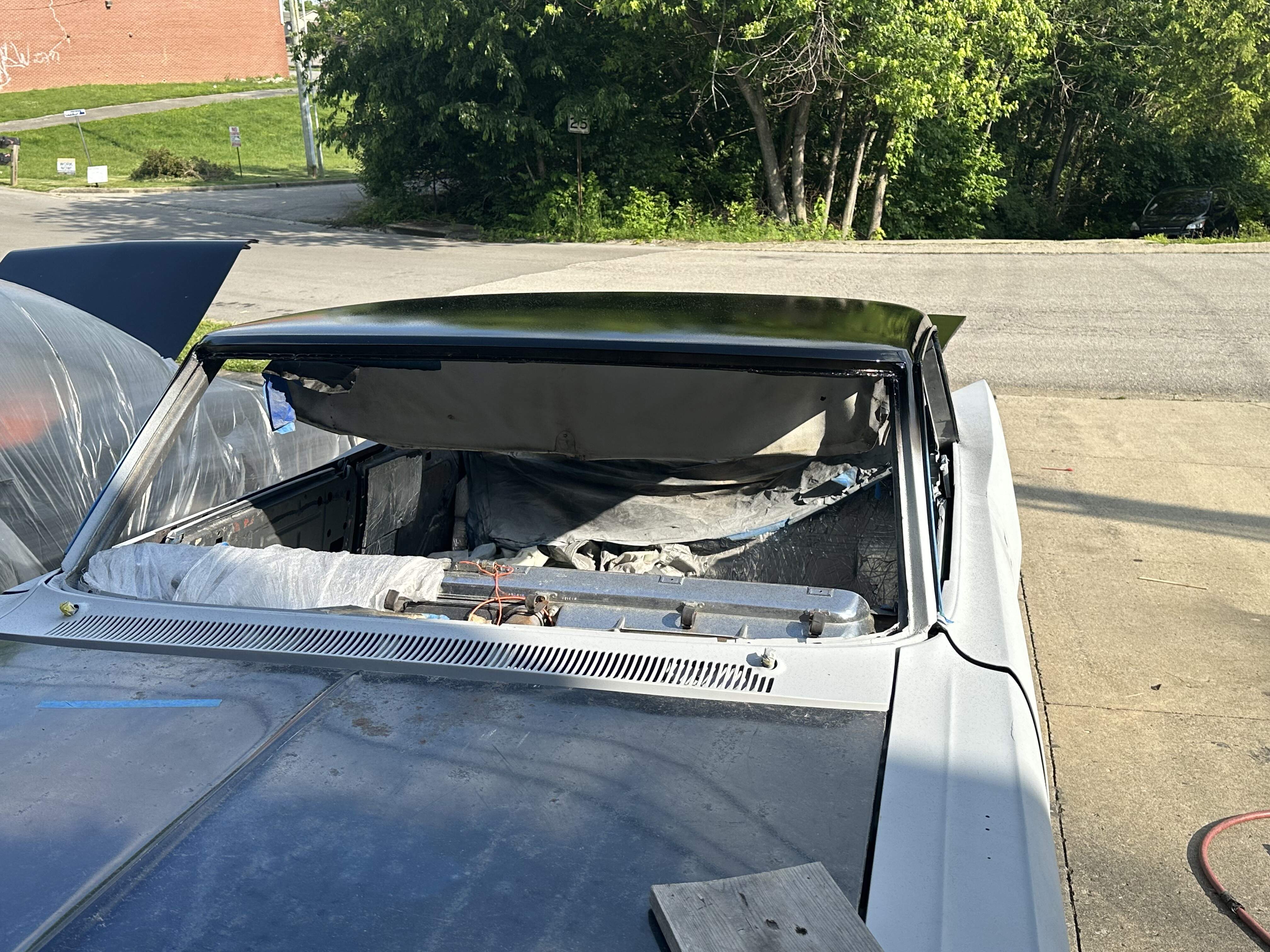

Well, I got the roof shot today. I needed to shoot it first because I wanted to let it sit in the sun and bake for a couple of weeks. In the meantime, I can start the brakes. Then hopefully go back and finish painting the roof and the rest of the car. It looks like a dirt road right now, that's a metric ton of metal flake NOT orange peel or trash in the paint. It'll all be flat after wet sanding. So here's a sneak preview.
super hard to see the flake from the pics mate but.... so excited to see your progress...the weather must be getting better for you to be spraying !!!:cheers:
what paint system are you using ?
whats the hood off in the back ground that you have painted ?
Now I justA looked again. At your post Mate and there was a video !!!
wow! That flake is sooo cool 🍻🍻🍻🍻
The sparkle from the flake will be a lot brighter once it all wet sanded, flattened out and polished.

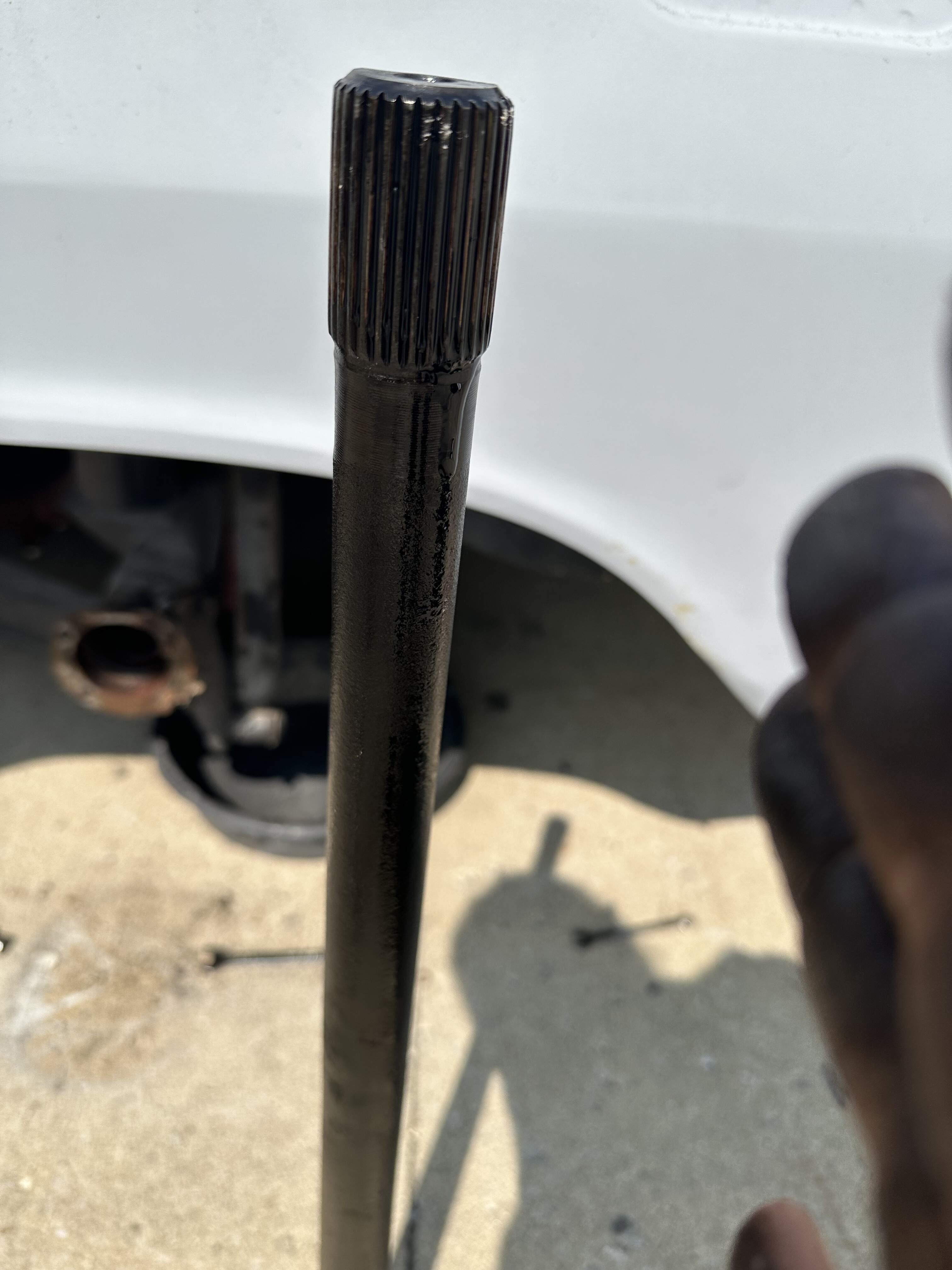

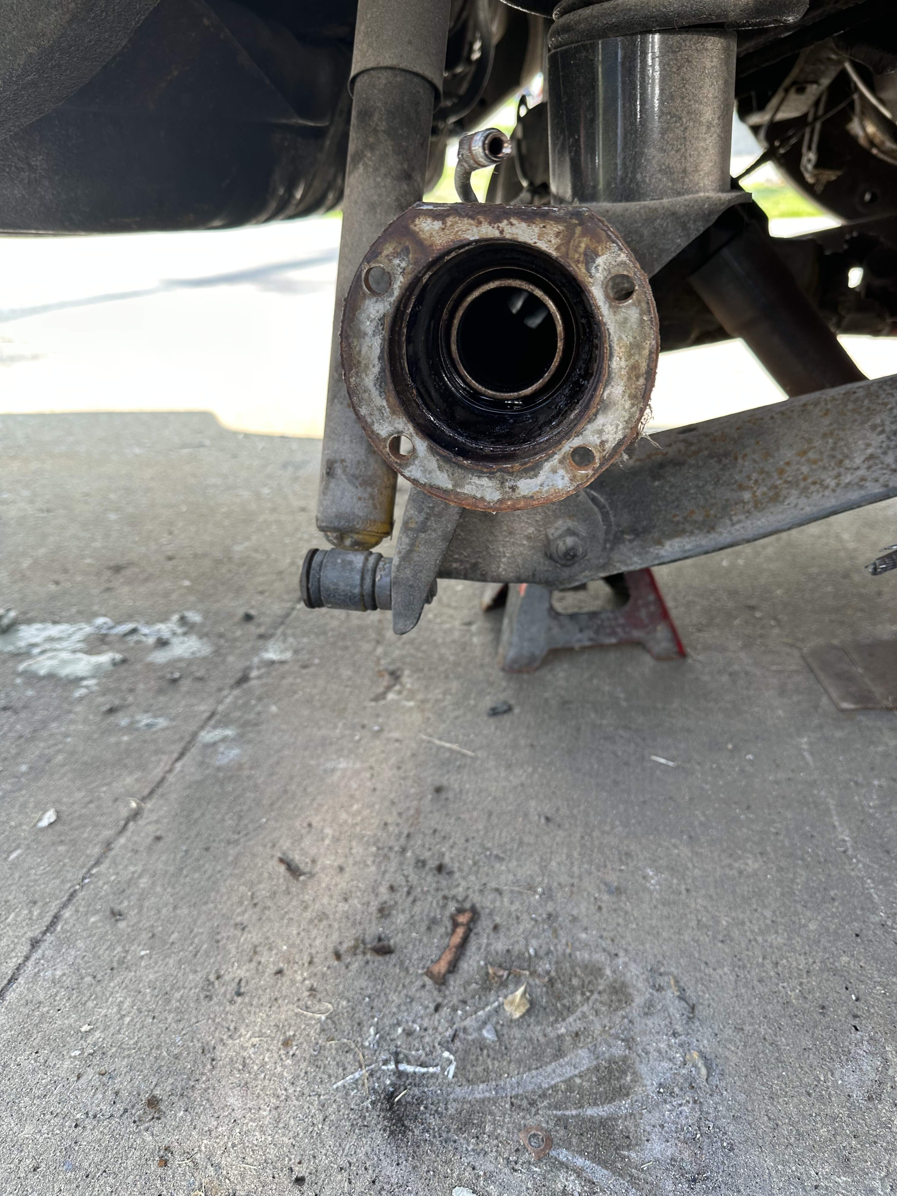

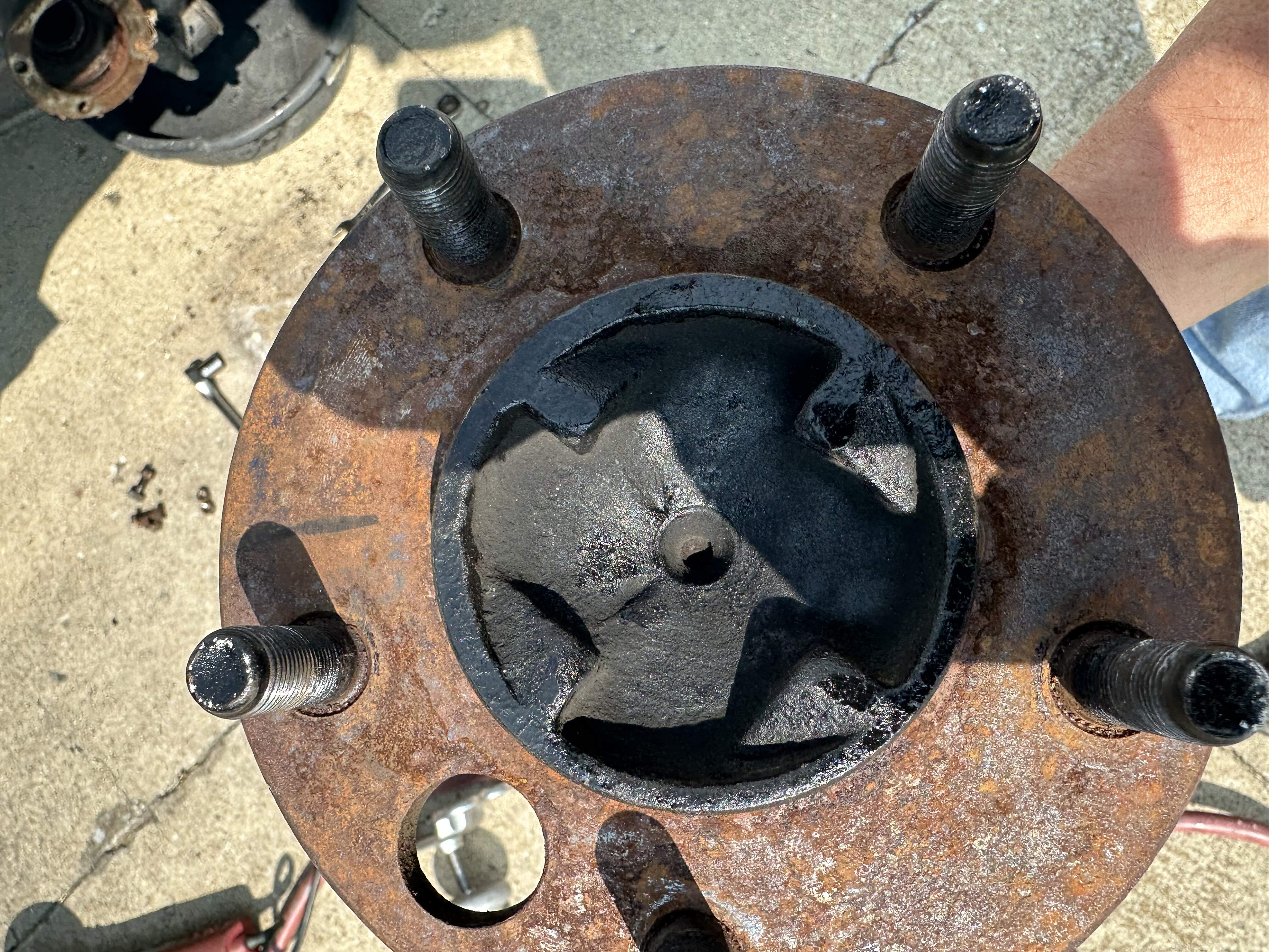

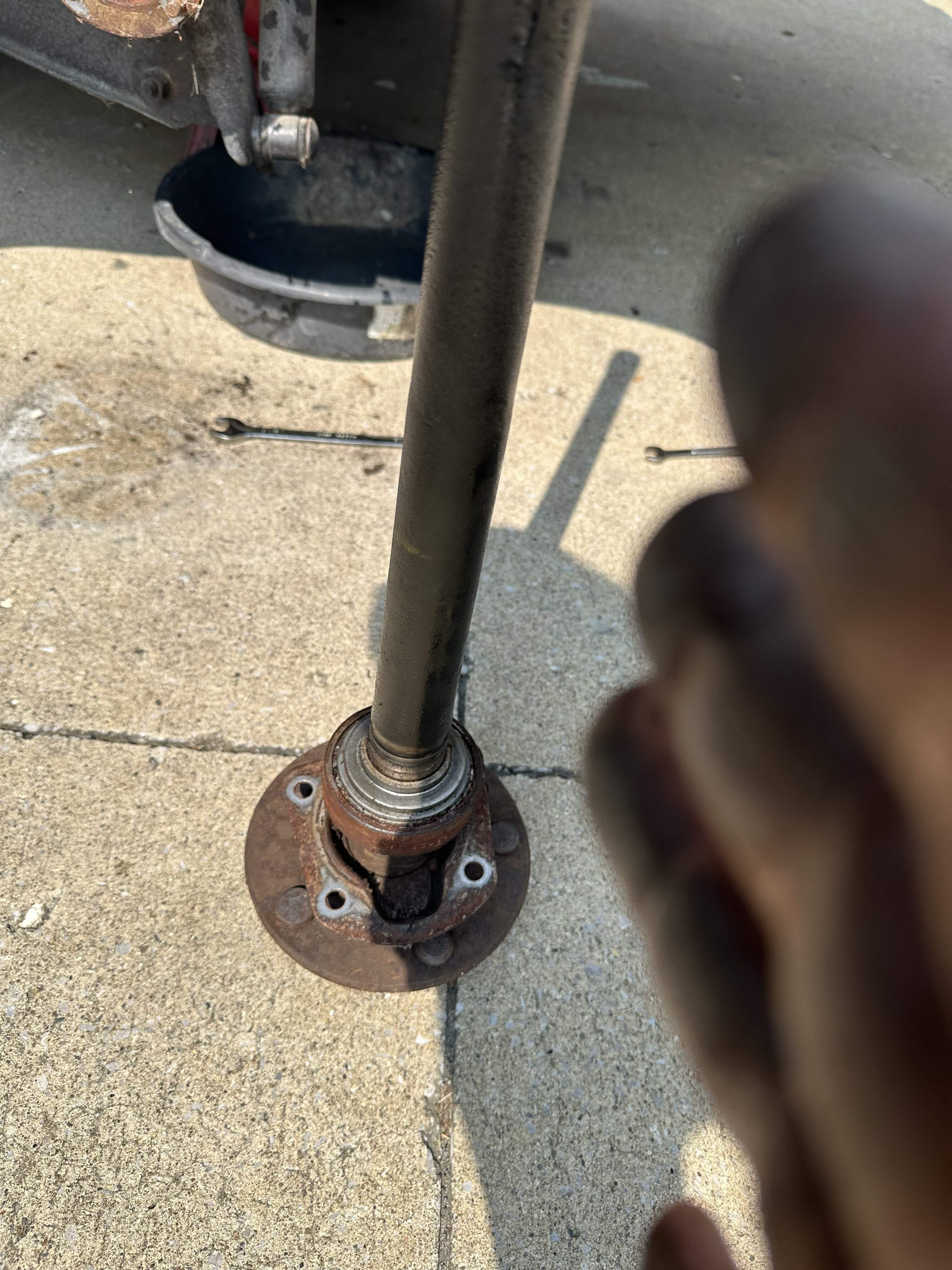

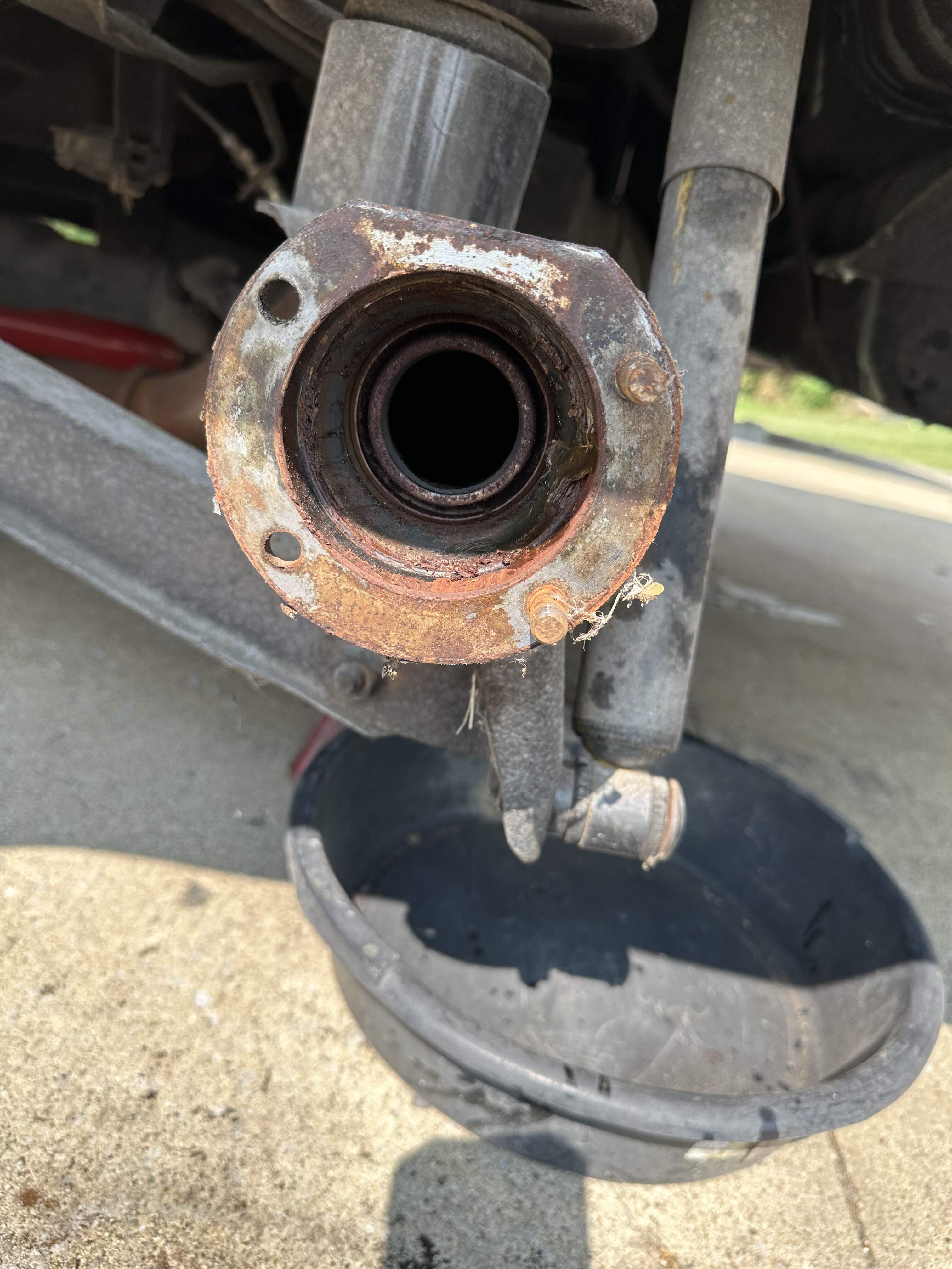

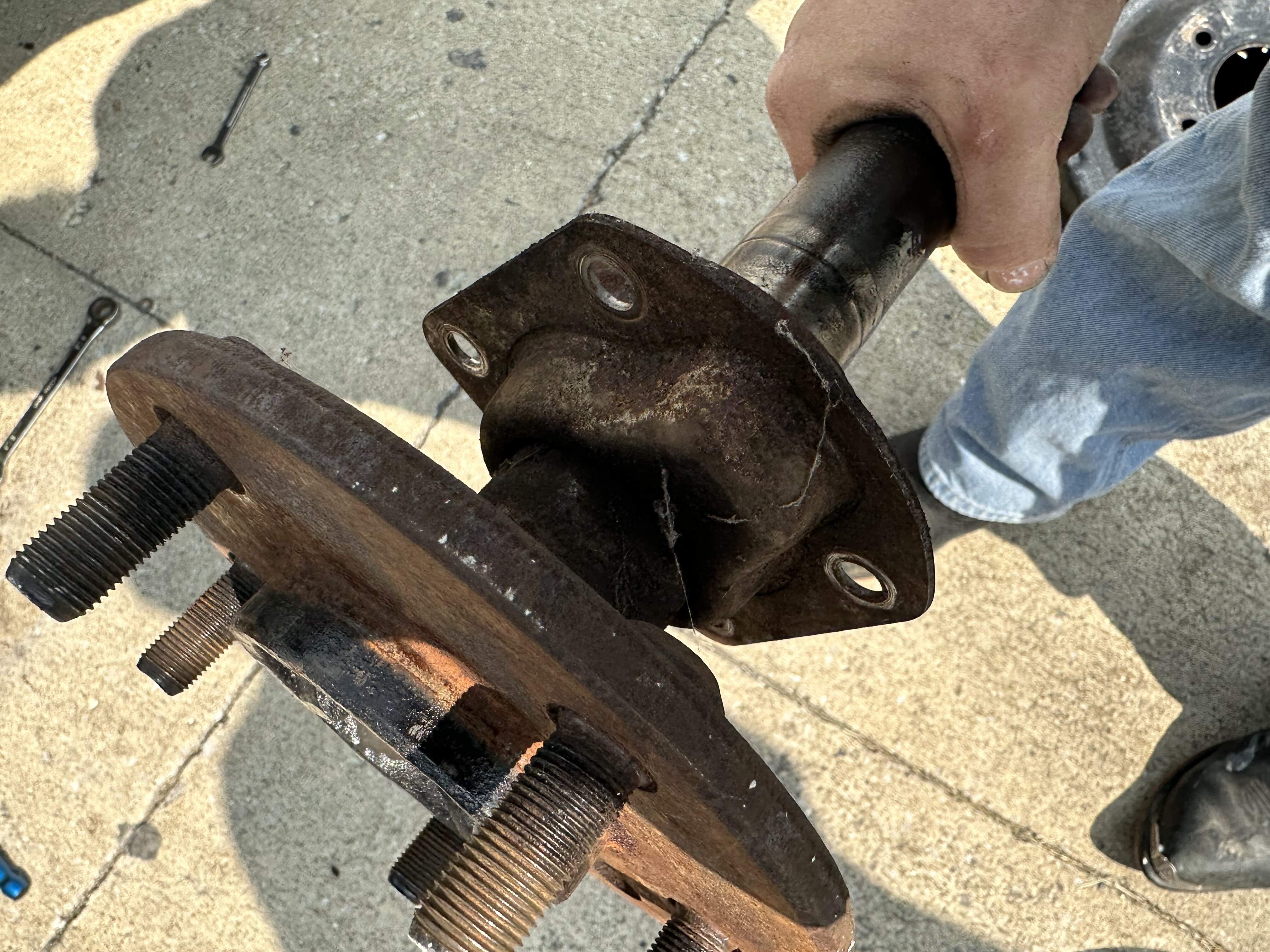

Only had a couple of hours to work on the GP today but I did get the rear axels pulled!

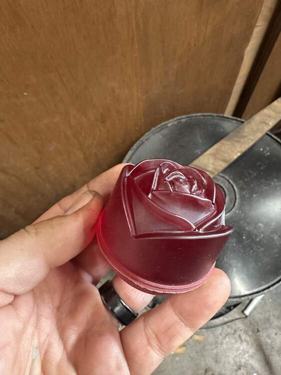

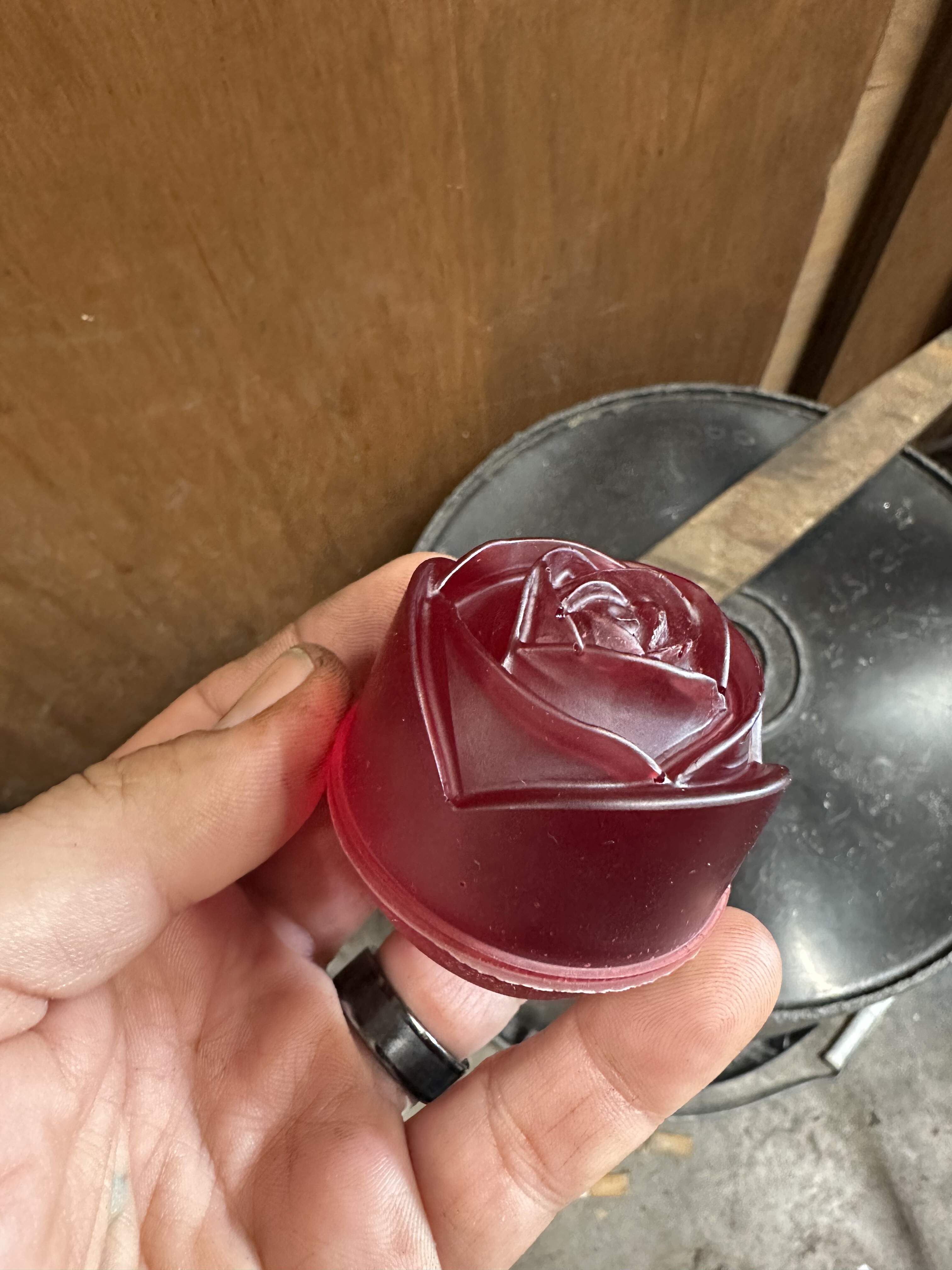

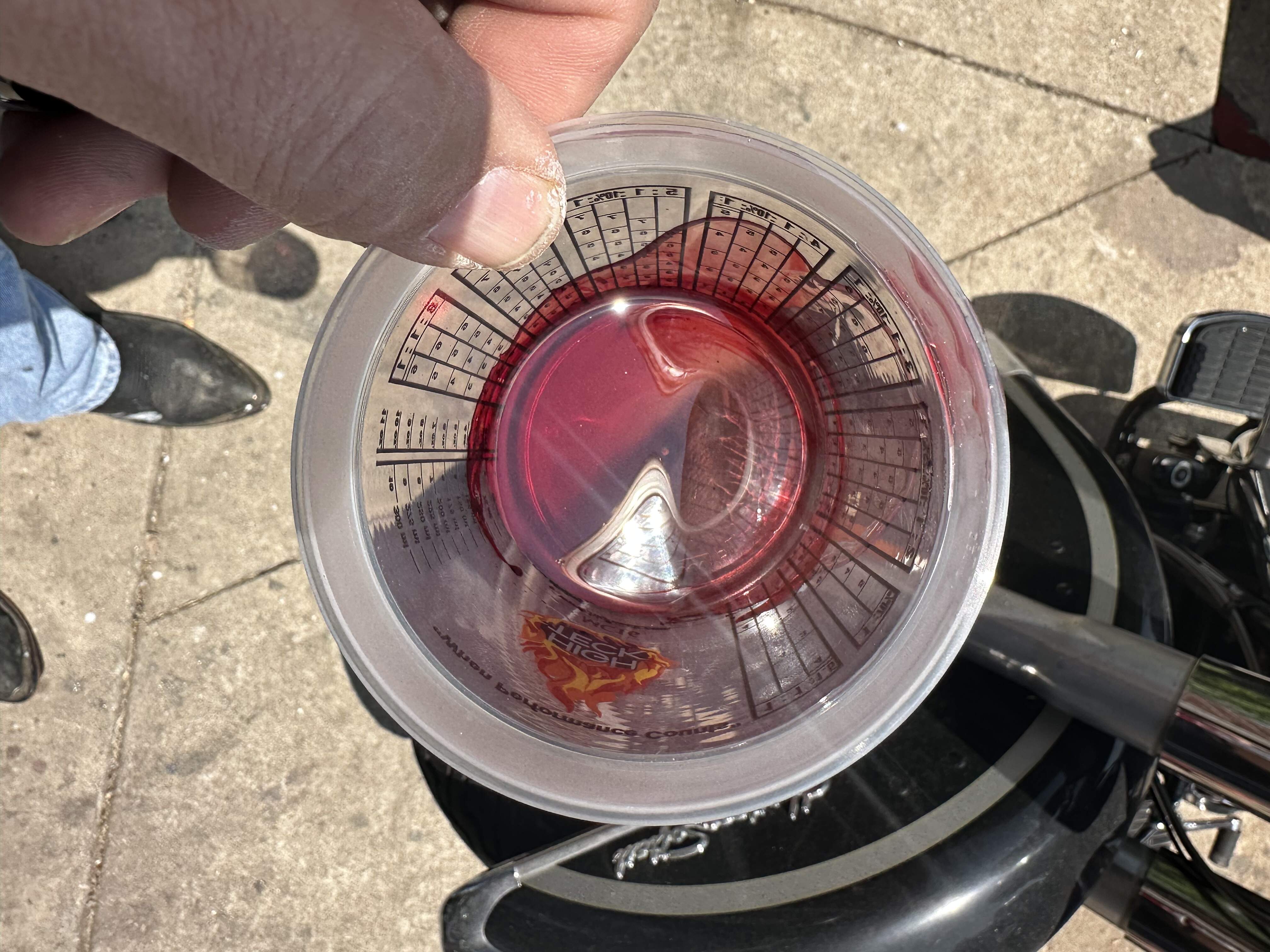

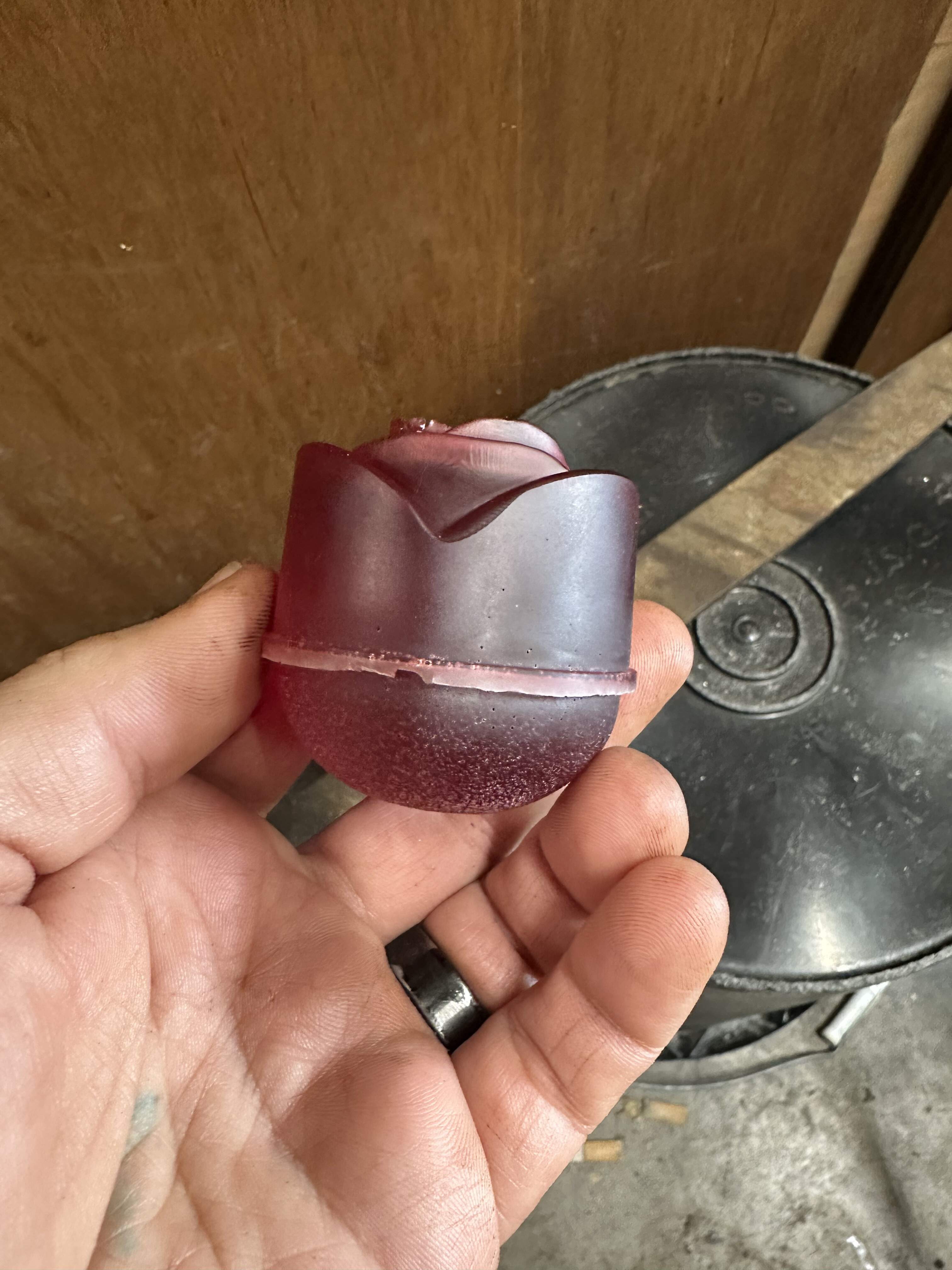

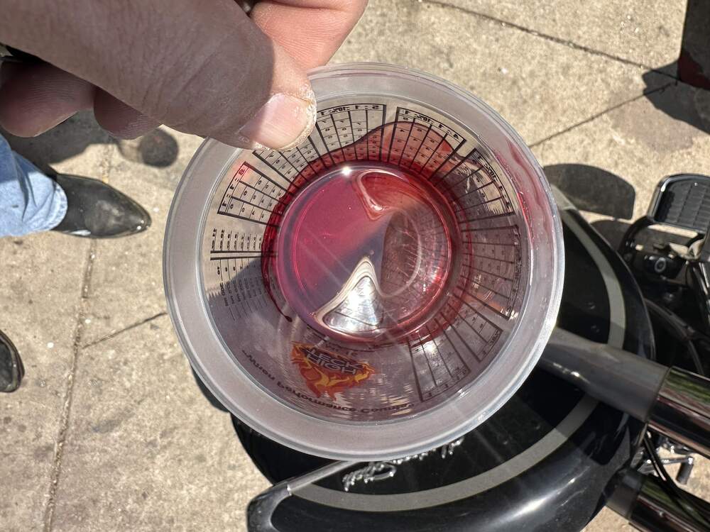

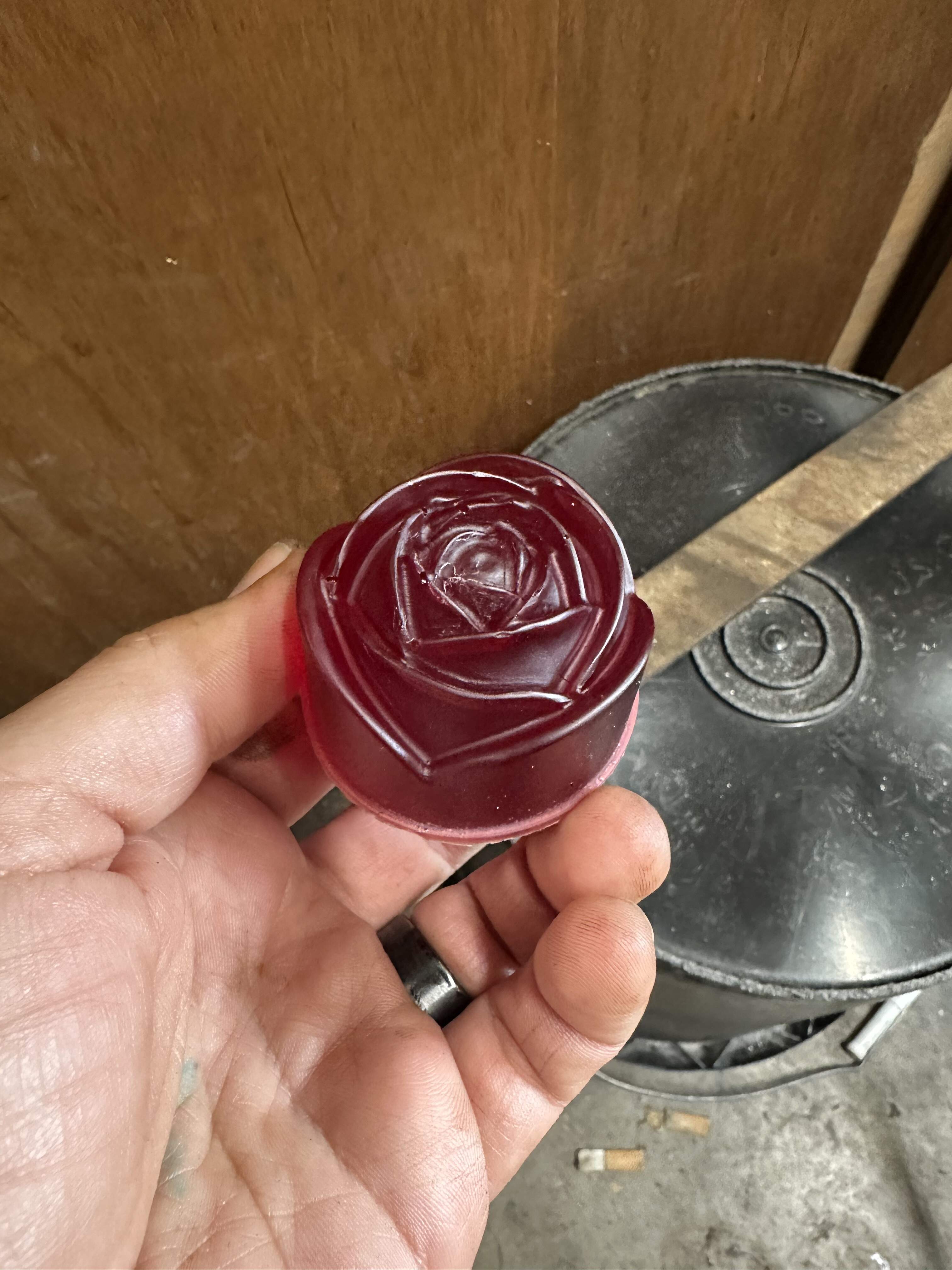

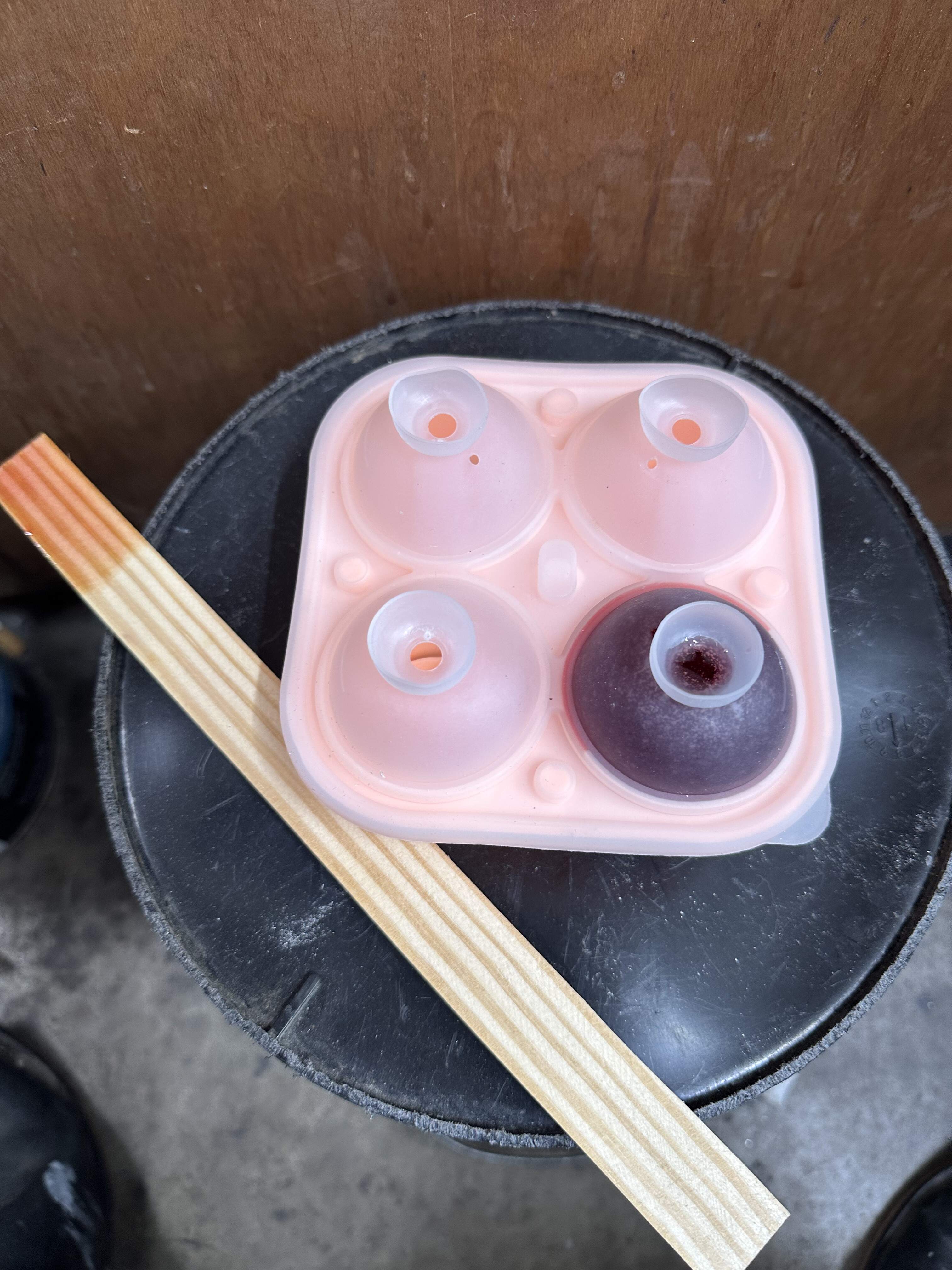

Well, the new bearings should be here tomorrow, and I was bored so I decided to try and make my own spinner knob for the steering wheel. So, this was the first test, and since the GP's name will be Rosey once she's done, I thought it was fitting. I used the same acrylic that I'm using on the steering wheel mixed with the candy apple red kandy that I'll be using on the sides of the GP mixed at a ratio of 1 drop per ounce of acrylic. The ridge around the middle still has to be sanded and it all has to be cleared but I thought it came out pretty cool.
