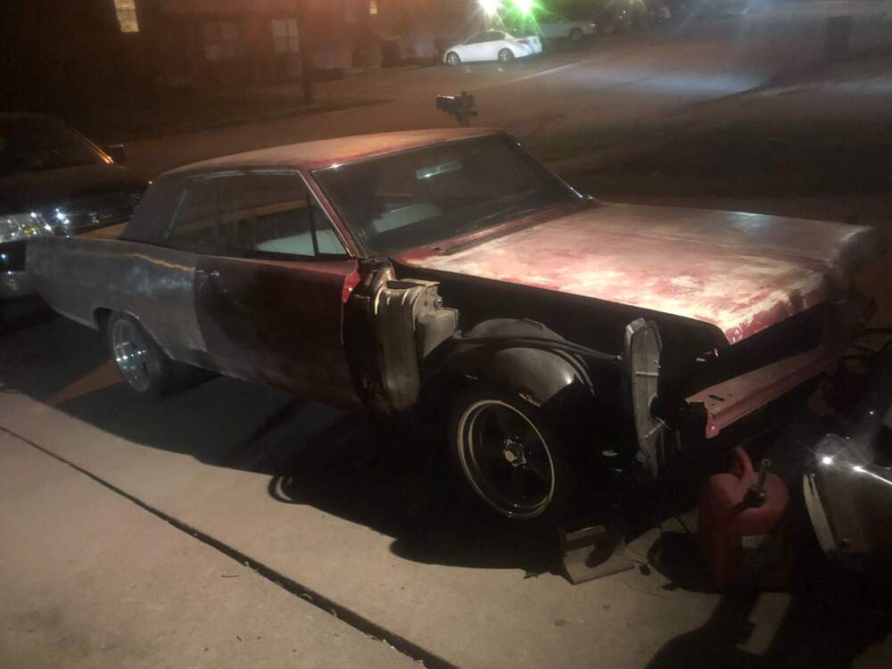

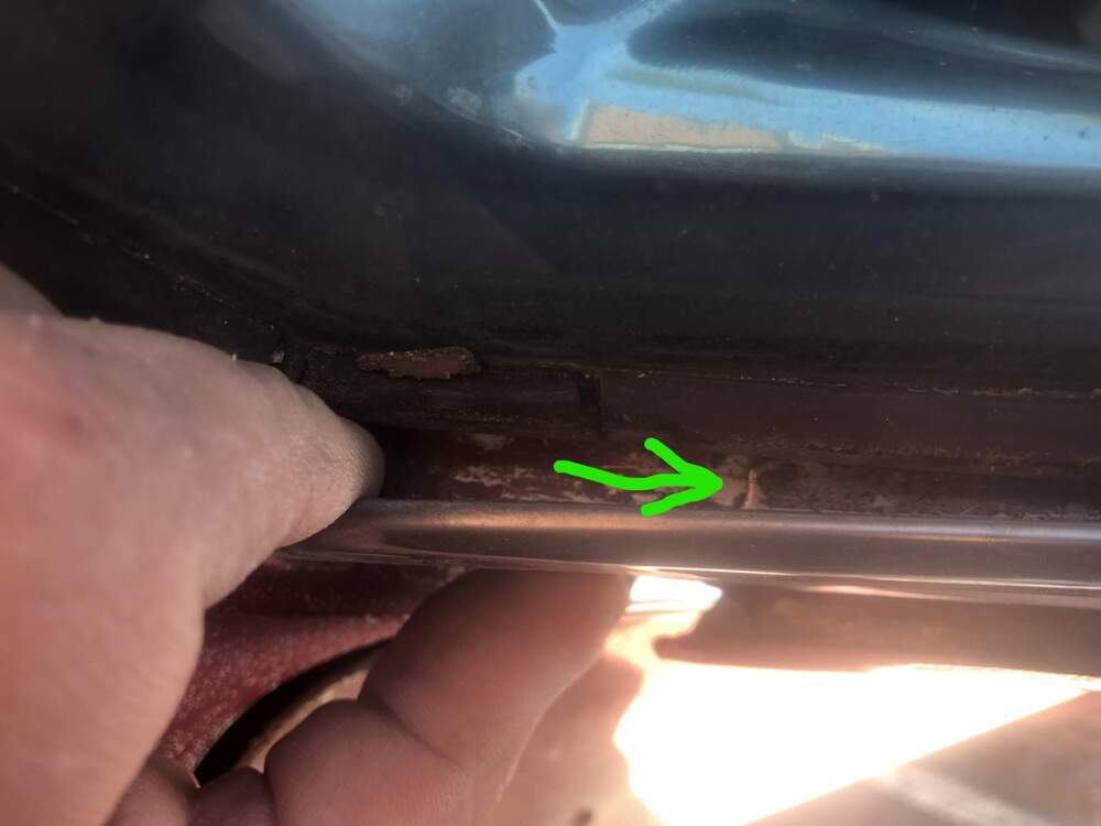

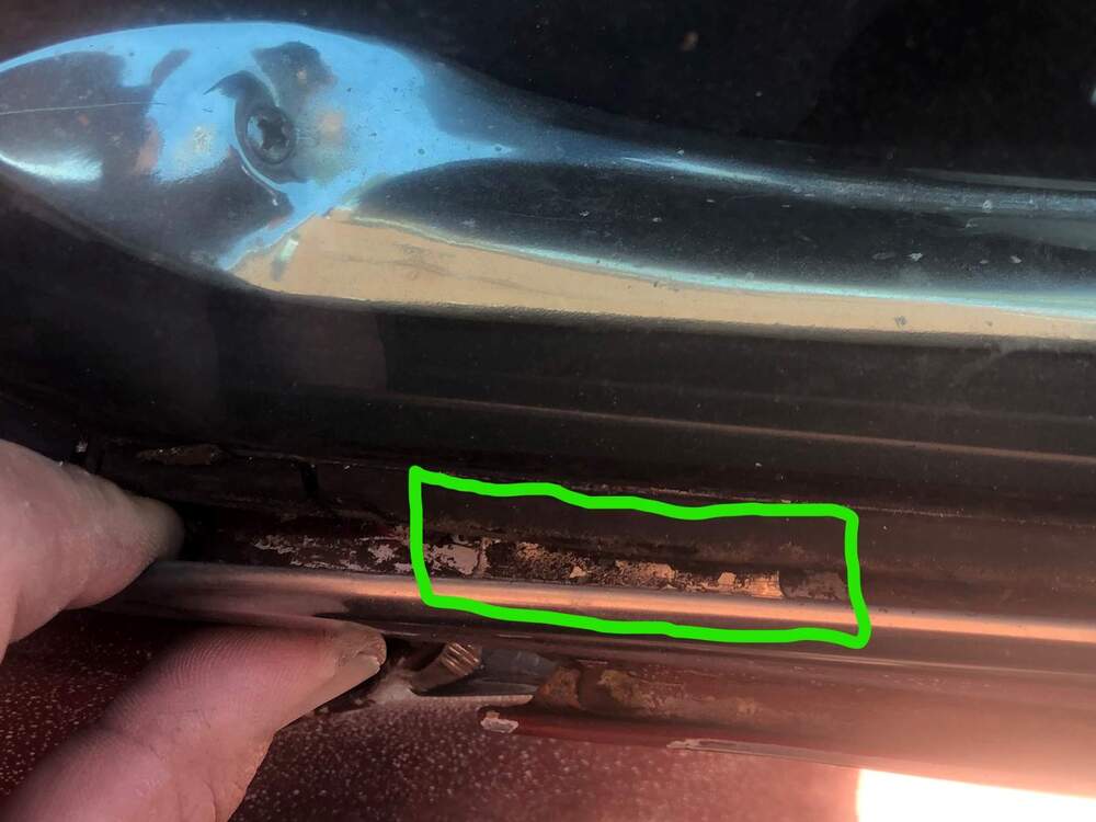

Yeah I've got a few spots that will need attention for sure. So I found that they had post's going thru here and had to remove the sail panels to remove that piece of chrome. Your thinking there was a post on the front windshield chrome also? I also confirmed that the red paint was not the original color of the car. You can see the white paint in spots where the chrome came off. I figured the safest thing to do is justa take it down to bare metal at this point. Even bought a new tool for the job. The Contour SCT from Eastwood. THEY say that I can strip this entire car (or a car this size), up to 6 coats of paint, body filler, surface rest and condition the metal for primer in 6-8 hour. I say B.S but I'll give it try :rofl: But the tool is better then sanding or chemical striping. I've done both and they both suck so we'll see.

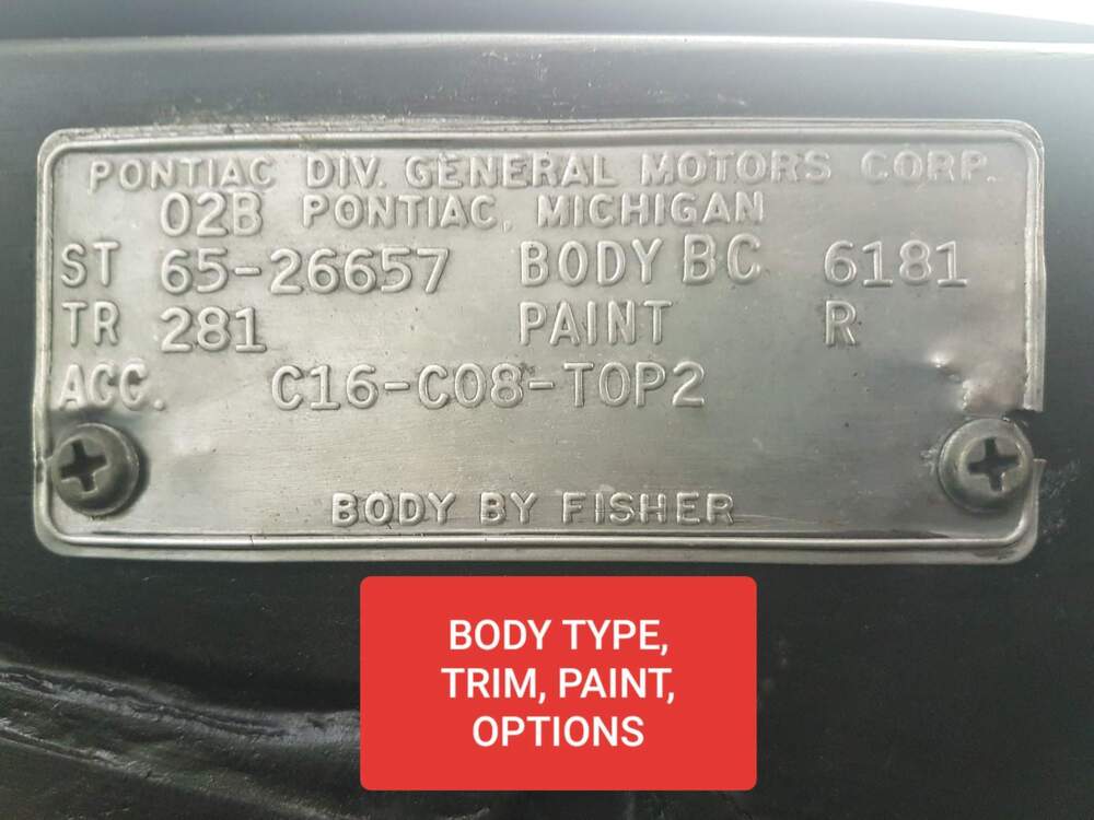

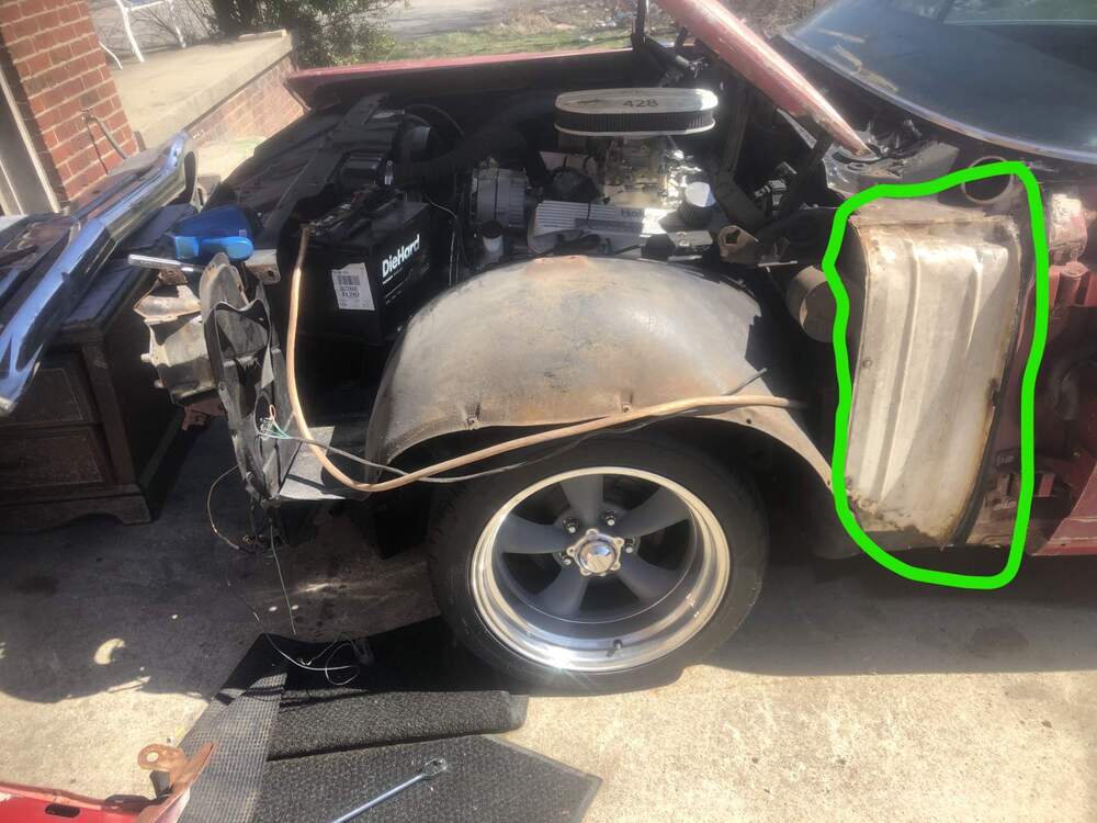

On the car's build plate, is the paint code R? Your paint looks identical to mine, which is Montero Red. Do you really think someone would have repainted EVERYTHING? Inside engine bay, trunk & door jambs - are they red too? Anyway, it doesn't matter anymore coz you're doing a bare metal.

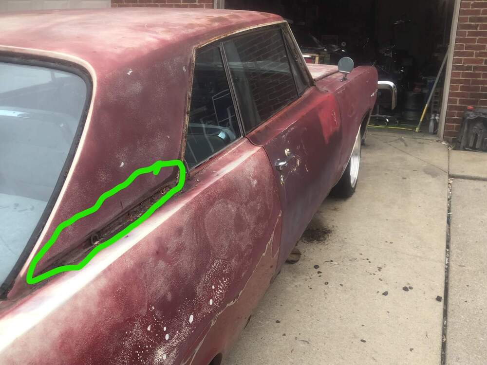

Those little posts I was talking about are a screw in job with the head almost of a tack. They are tiny and there are quite a few that surround both screens. You'll know when you come across an invisible one as it slices you open during some vigorous procedure. Ask me how I know...

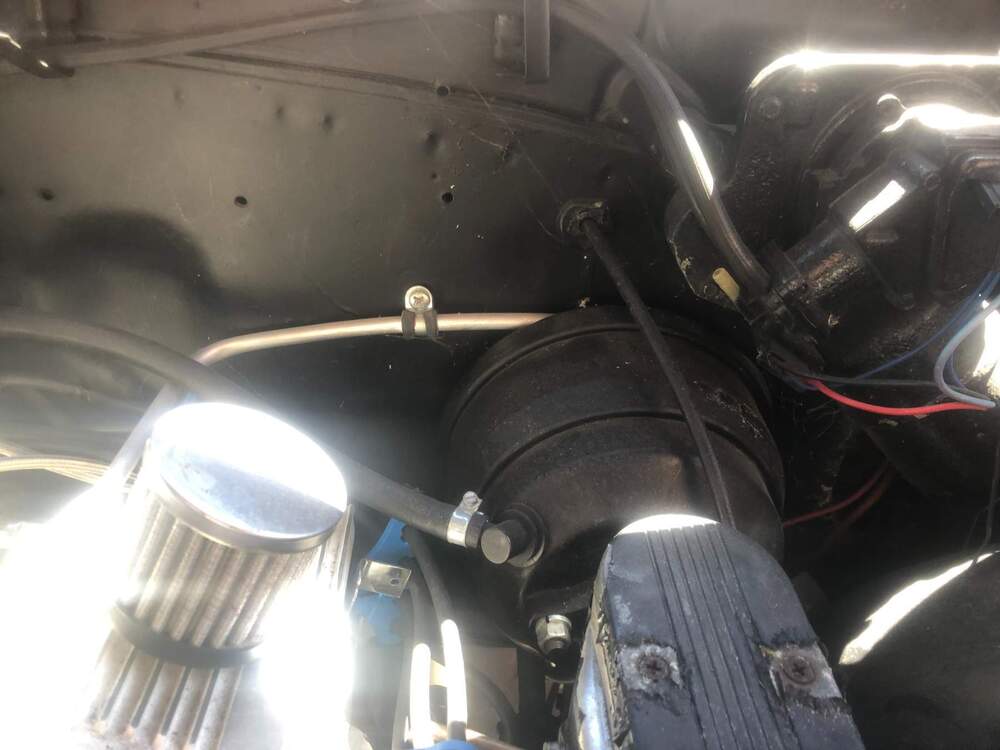

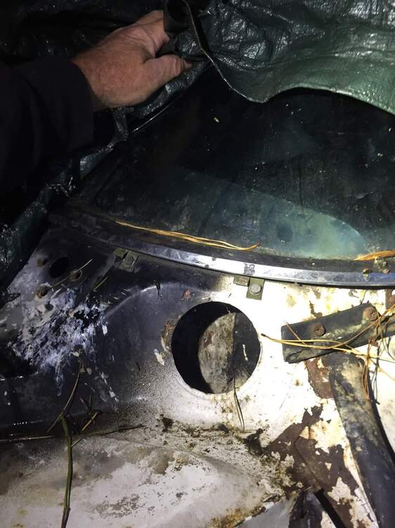

The only plate I've seen so far is the vin plate in the door. Where's the build plate located? Yeah Fitzy, I do bud. The firewall was old dirty whitish color when I got her. When I had the engine out I justa rattle canned it black until I could decide what I was doing with her. Now I've found a bit of white under chrome and when I pulled the outer fender the other day I found this panel was painted white and it looks original to me. But she's 59 years old, who knows how many times she's had her hair dyed :rofl:

Okay - I see what you mean. The build plate is on the driver's side of the firewall adjacent to the master cylinder. It displays body style, trim, paint & option codes.
Have a look at mine.
Ok cool. I'll have to look and see if mine is still there.
That bloody plate just about fell off the firewall some time ago and I affixed it with those 2 ugly looking screws. Don't worry - I'll dream up a solution later.
Well mine either fell off or was removed bro. No sign of it at all.

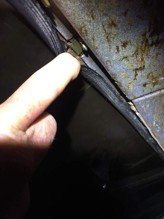

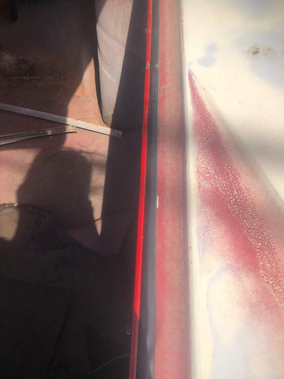

So no progress on the windshield chrome. I watched 5 or 6 YouTube videos, but they were all of 63-64 Chevy's. I looked them up in my 63 manual and the clips are different. These clips look like they are built into the chrome. By that I mean there is no step up or down as there should be when 2 pieces come in contact with each other. So I worked on and wiggled the chrome and the clip for a few hours and decided to call it quits when I caught myself reaching for the pry bar to rip it off. It almost looks like that metal piece goes under the windshield seal. So I'm thinking that when I pull the windshield I'll keep my fingers crossed and hope I can pry the chrome off at the same time.

I wonder if a supplier of classic auto glass can help you? I can't even begin to imagine how chrome trim is attached to one of those big perimeter rubber seals that you appear to have.
i think your front screen trim is pressed into the rubber window seal and it comes out with the screen.
try working your screen out from the inside and you will soon see if thats the case.
 our 63-64 are all chev above the belt line and the trim clips are the same!!!
i would expect the lower chrome on the screen to be held by clips and you will see them when you remove the cowl panel.:cheers:

Yeah I was able to remove the bottom. It was held on by screws. I found clips like the ones in your bottom pic Kiwi, there on the inside of inside of the car under the seal. Yours look like there is a screw? Mine didn't have a screw. I did play with that clip to, but when I pried on it the chrome on the outside didn't move. Any idea how that unclips?

its got to pop out of the clips mate, unless some one has glued the trim on in a past life
use a wide plastic trim lever and justA go slow is what i would do...... run a knife under there too justA in case it is glued down too
 you will know really quickly if the trim moves or not !...

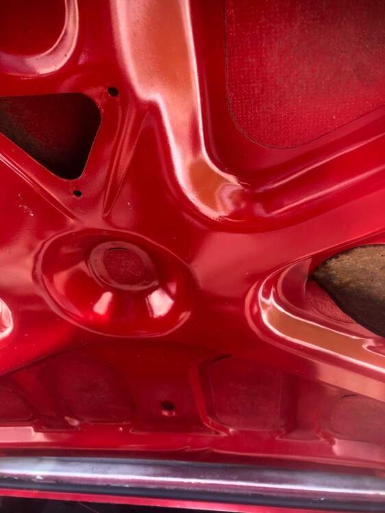

We were talking about the current paint on the car Fitzy, look how bright the paint in the trunk is bro, and the trunk seal looks almost new.
Wow - that's in good nick. I can't wait to see your new paint job. It may inspire me to do the same.

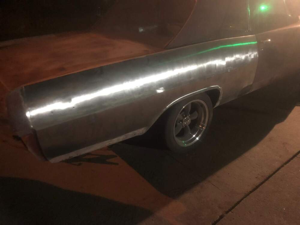

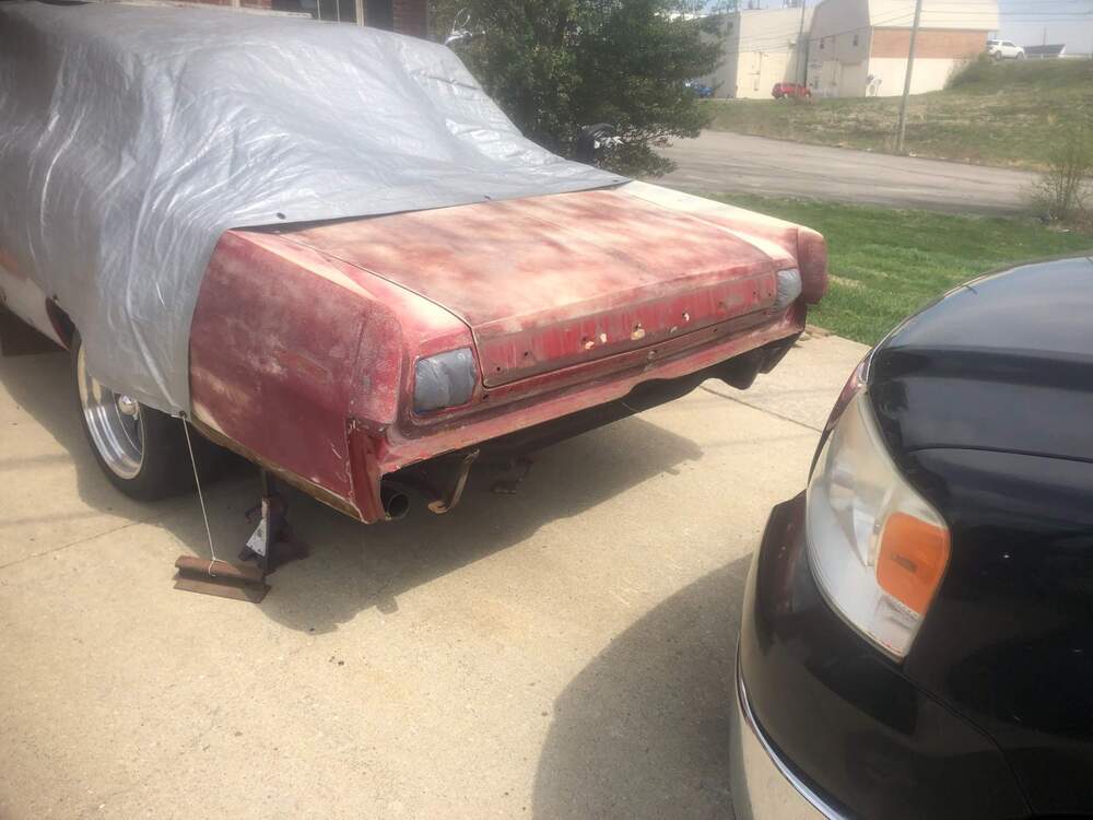

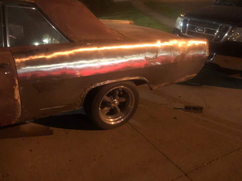

Well both rear quarters got stripped today and the front fender's got it yesterday. I forgot to get pics of the front fender's but I will get them for you tomorrow. Going have to be some metal work done but damn she looks sexy!
Back to bare metal, eh? Lookin' good. I wish I had that sort of commitment but will be happy to simply overcoat mine - after appropriate prep, of course.
Yeah I wish I could've justa resprayed her. But after seeing the rust in the quarter panel I had to see how bad it was.

Me to bro, but I bought a new tool to help out and I love it! Its from Eastwood and its called a Contour SCT. Here's a short video my son shot for me to send to another friend. I did a time test and it took 10min with the SCT to do what I spent 1 hour doing with the air sander. It strips the paint, body filler, primer AND conditions the metal so its ready for your epoxy or self etching primer. Real time saver. Your welcome to come by and borrow it Kiwi :rofl:
