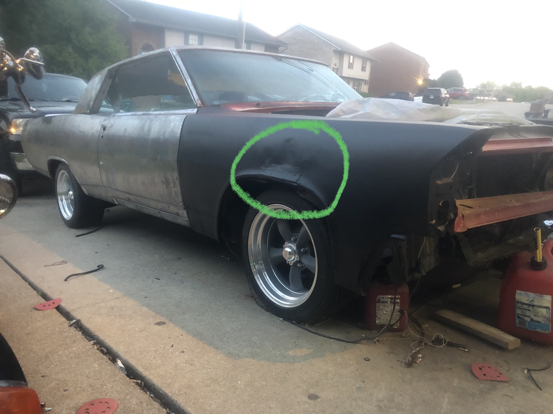

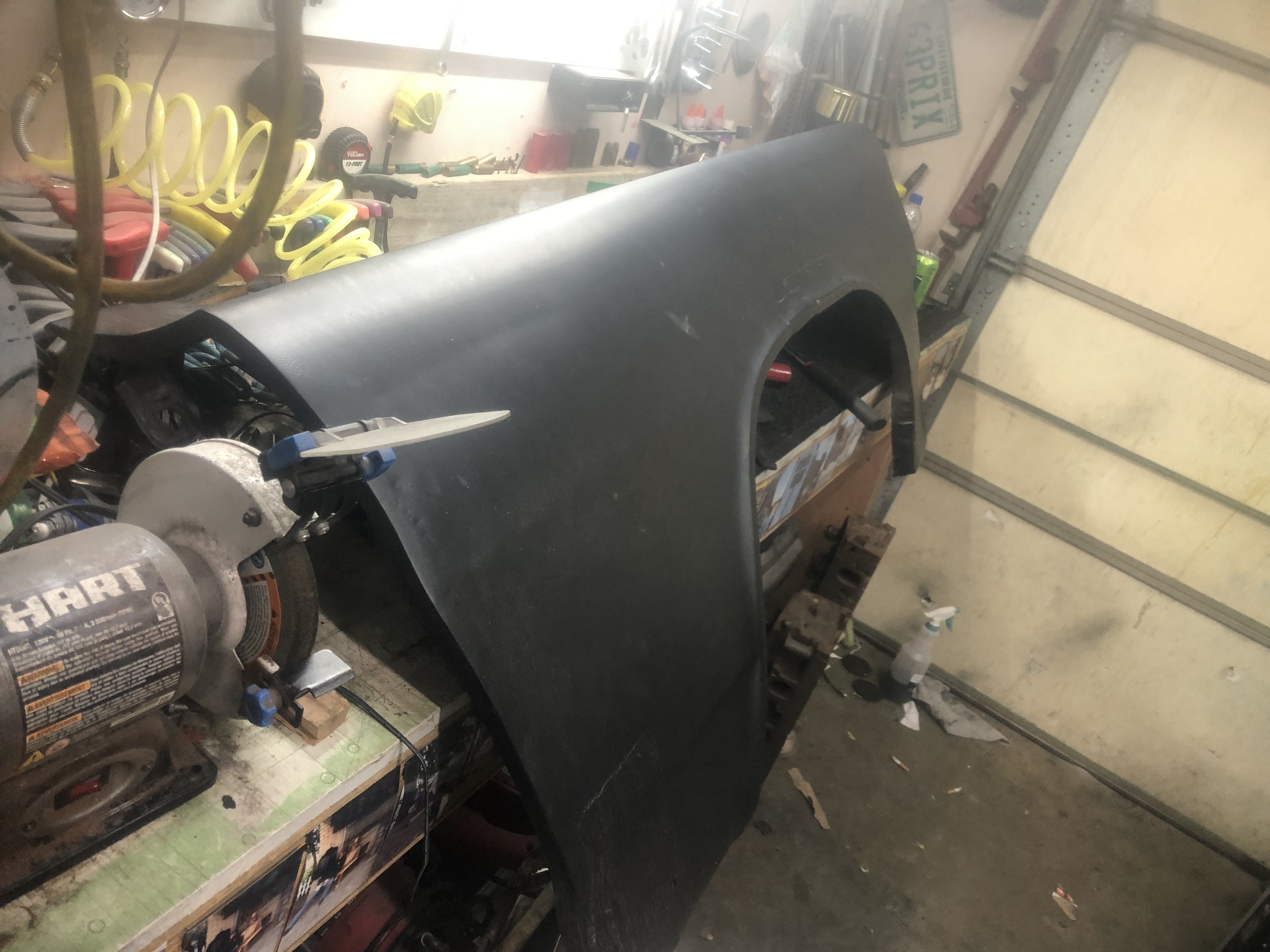

Well I did get the dent worked out of the passenger fender today.
nice work mate !! if its anything like 64 steel, its really nice to work with !!:cheers:
 and as i find with theses big girls, you justA sort one dent at a time. little bit by little bit :dancingpontiac:
oh and yes ! white roof on the 57 !..... with some pearl in it !!! hahha :rofl:
Yes sir, one bump at a time. :cheers:

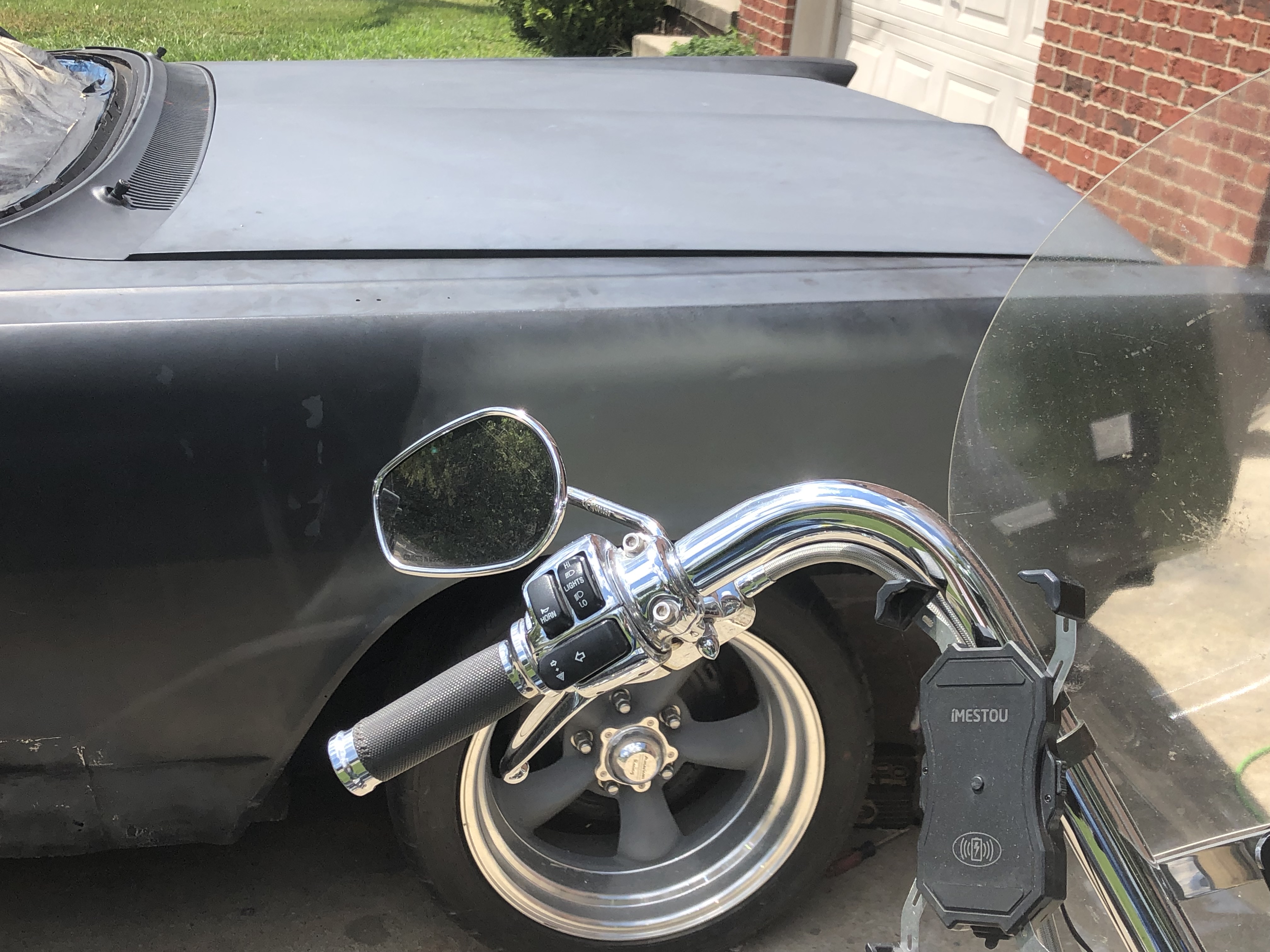

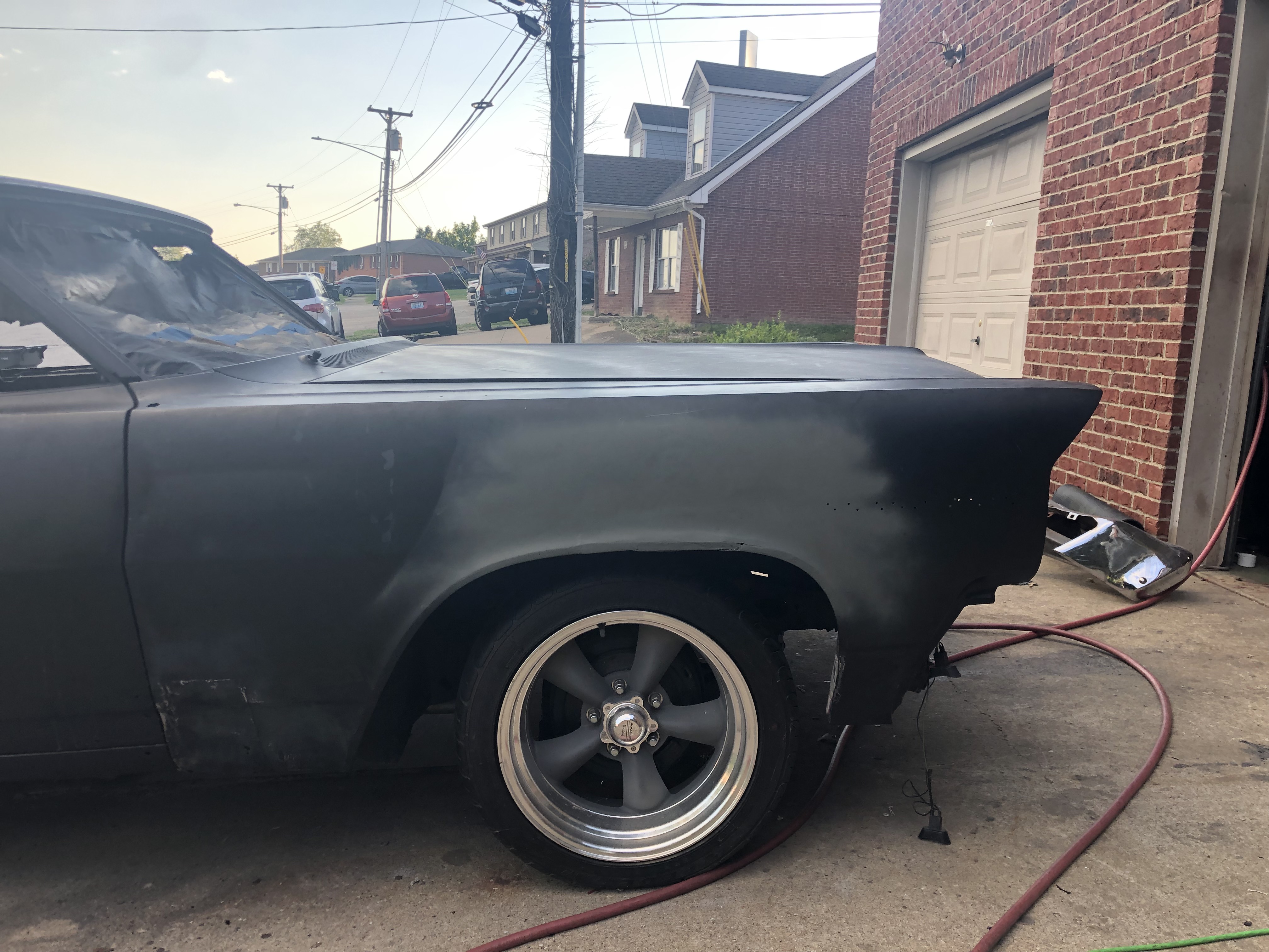

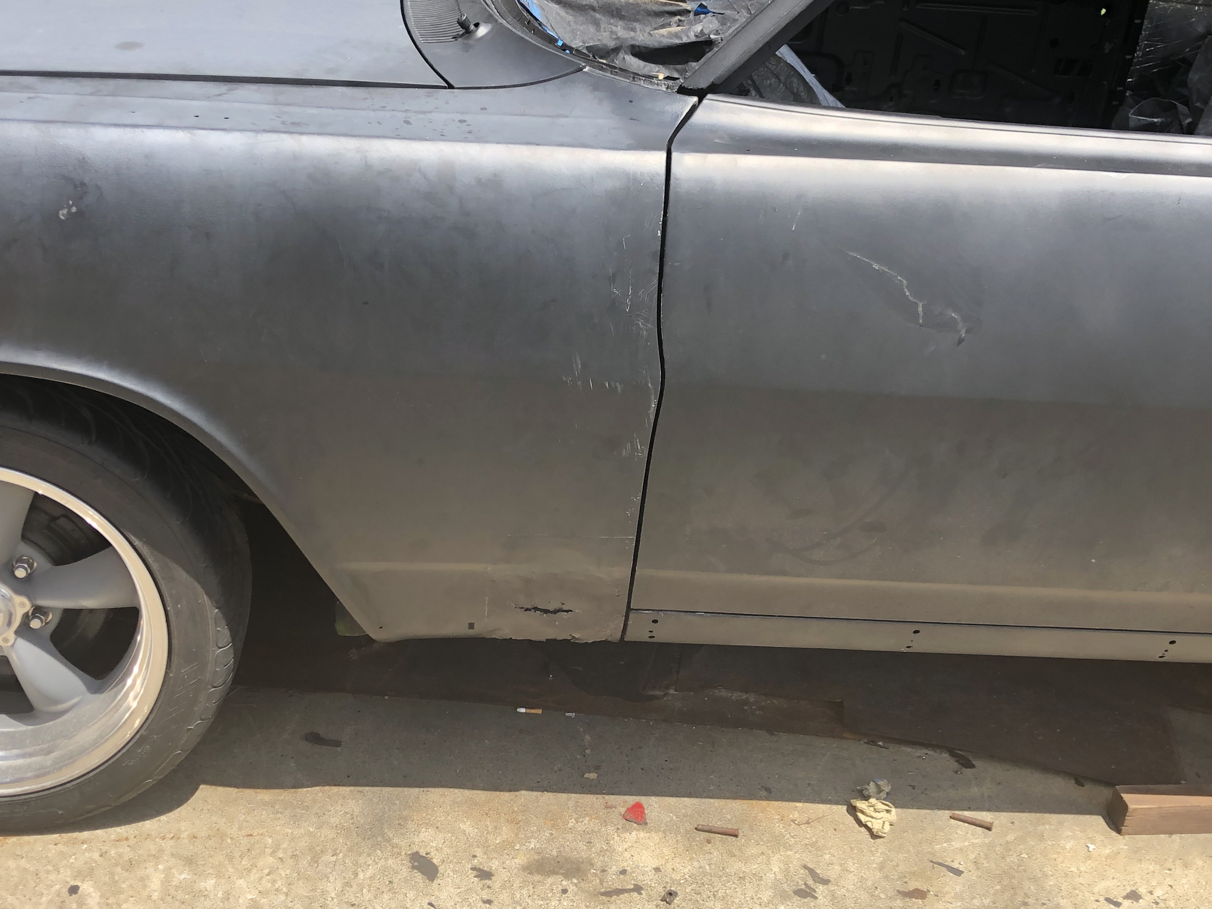

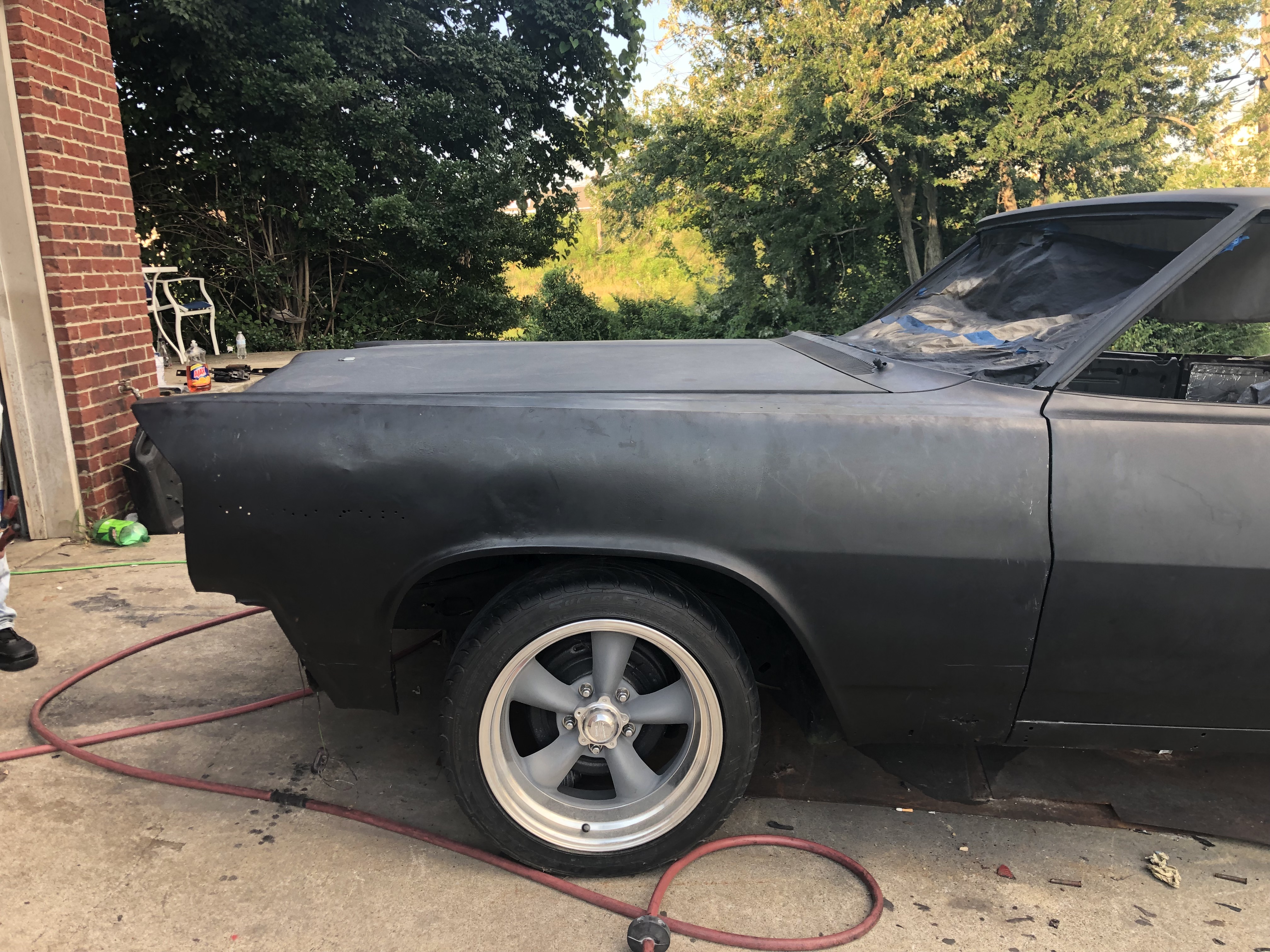

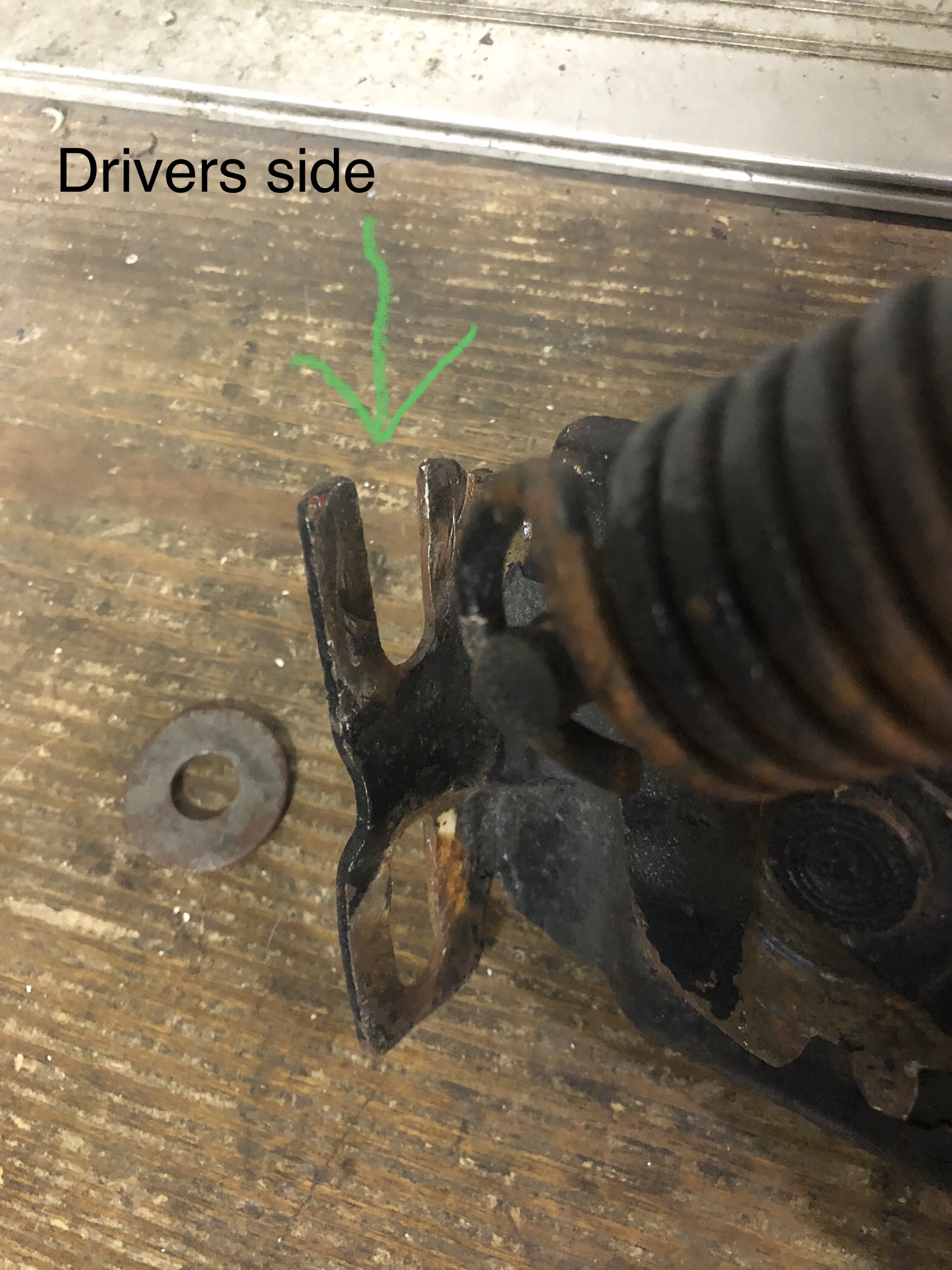

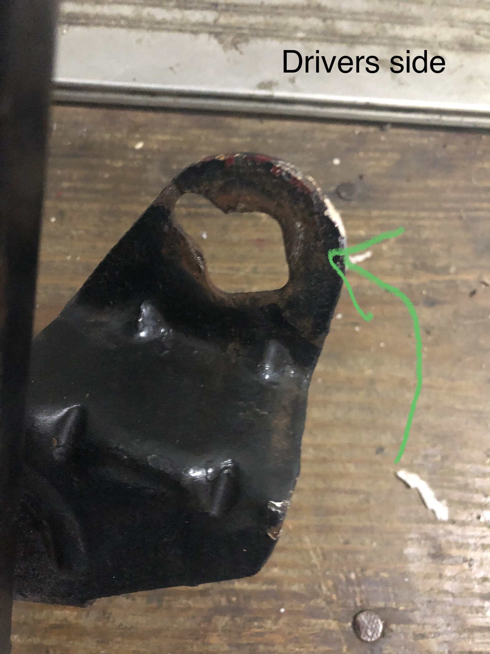

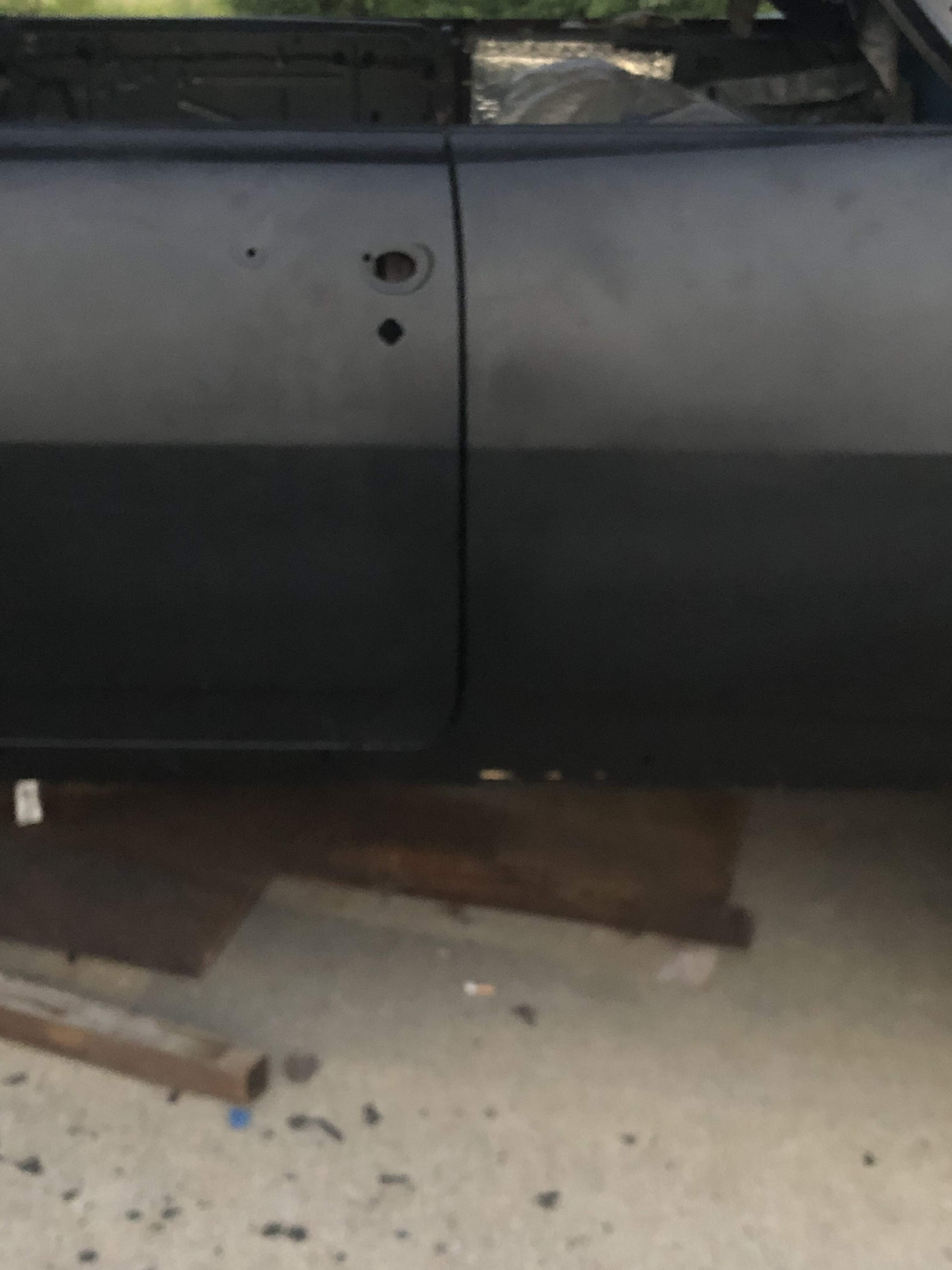

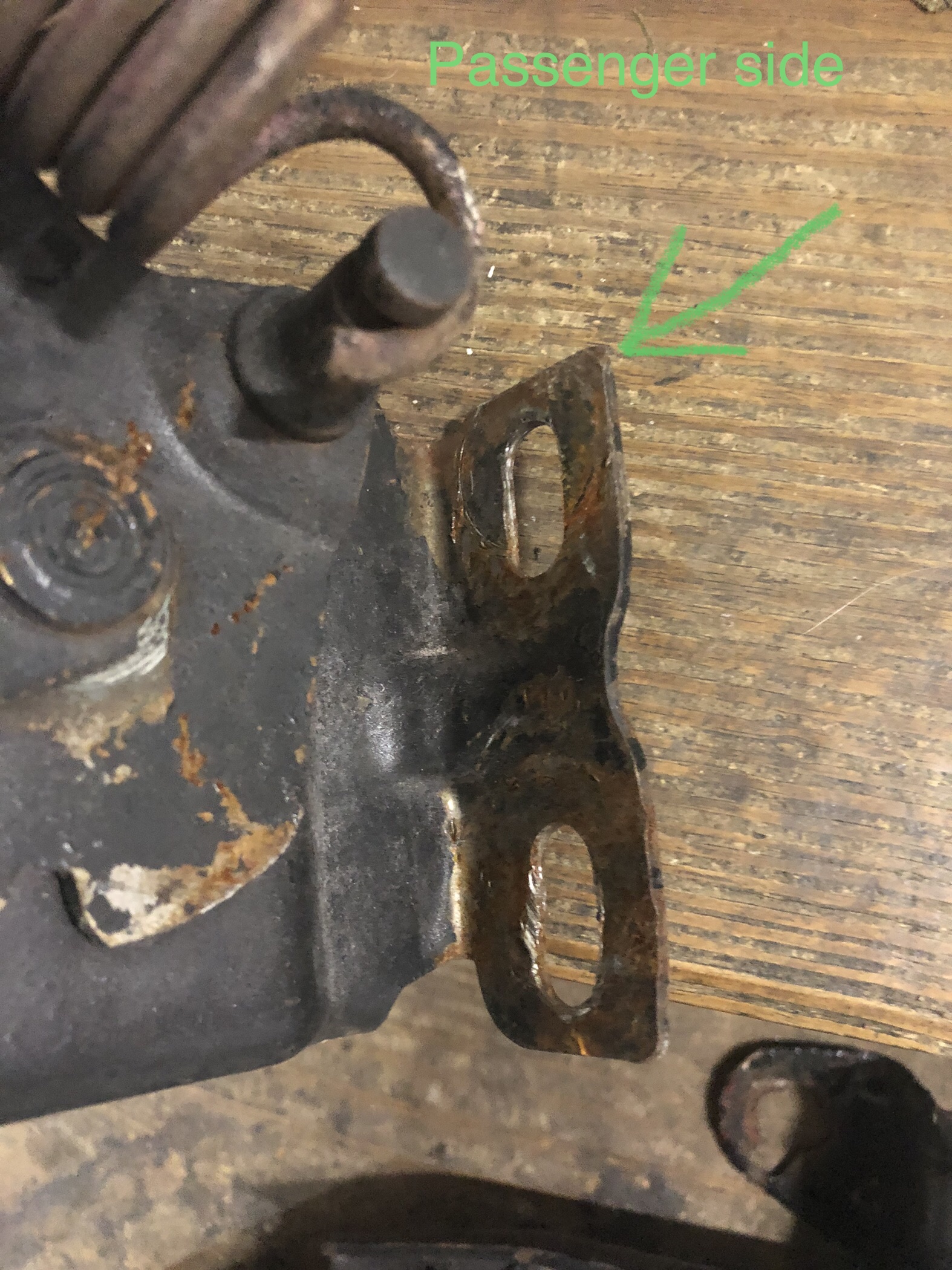

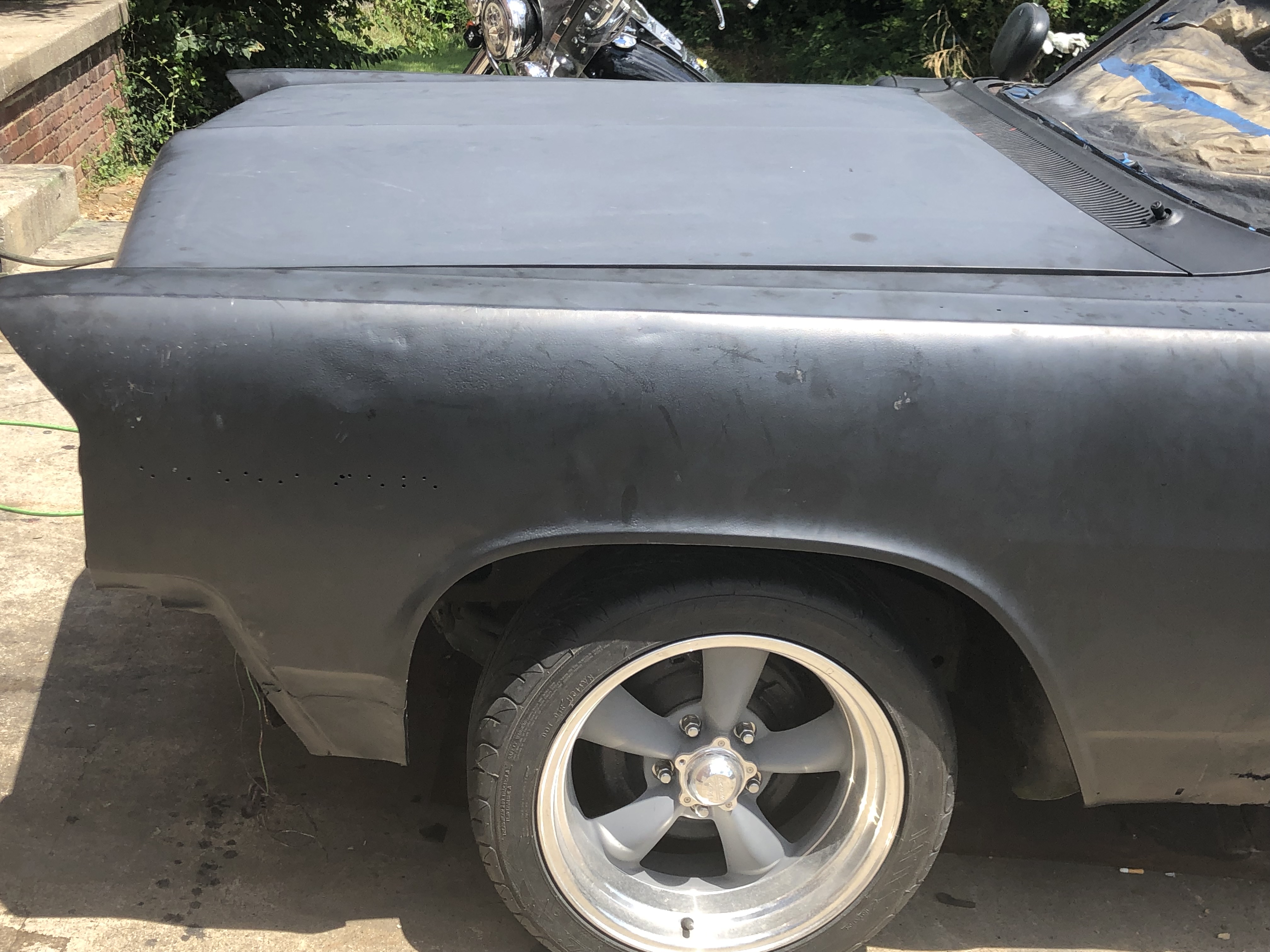

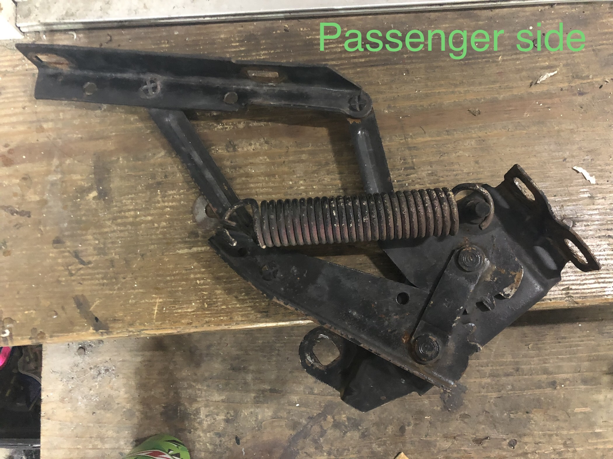

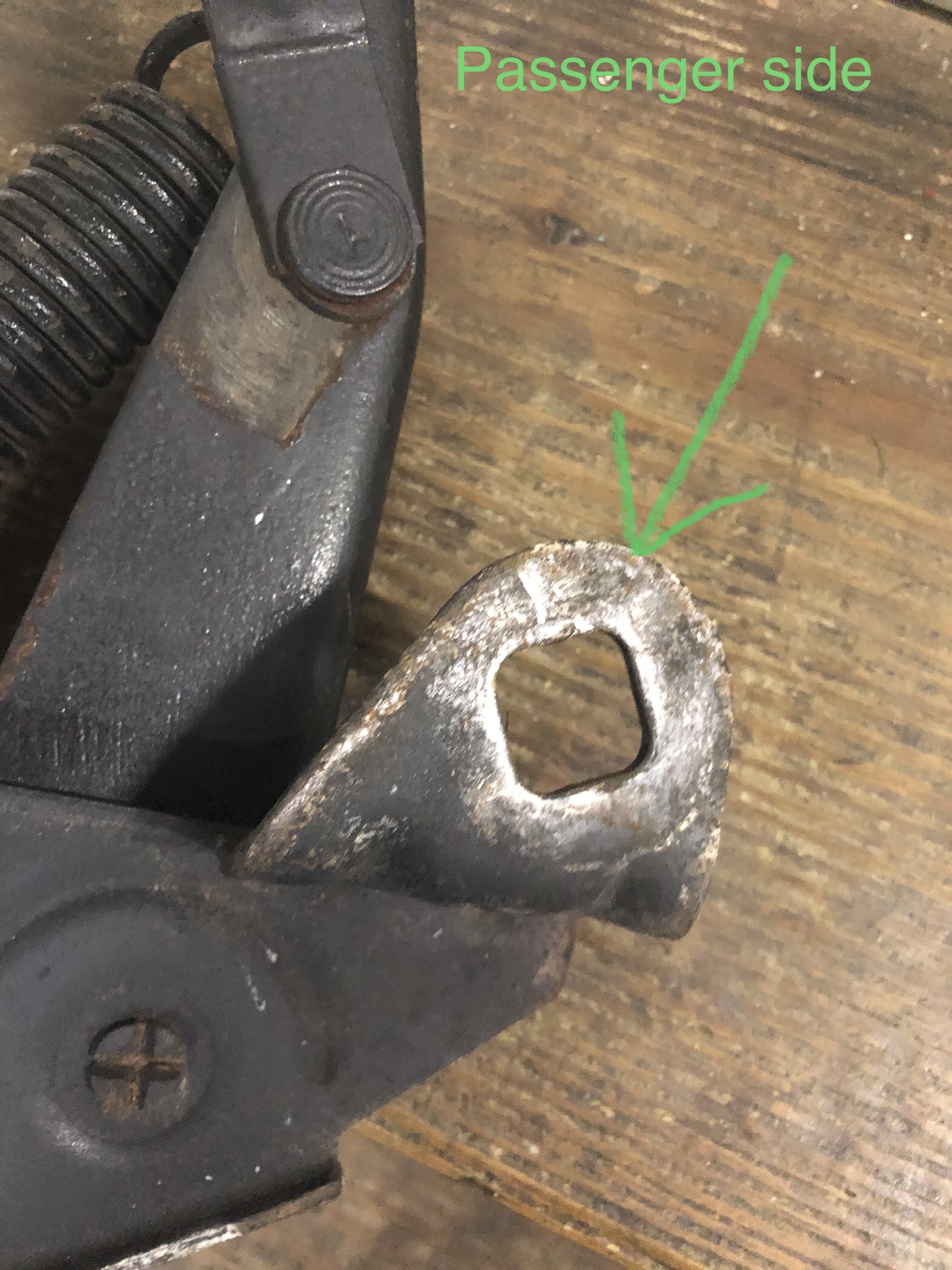

So, I've replaced and patched the little bit of metal on the quarters and decided to set the gaps before finishing the front fenders because I need to figure out the hood issues. In case I have not mentioned this, I HATE SETING GAPS! So I've got the door to quarter panels set where I think they need to be. The drivers front fender to door looks good today, I think. I'm still trying to get the passengers fender bottom to move forward a couple of millimeters. BUT the hood is killing me! I have tried every hood hinge adjustment I can. After close inspection it looks like the driver's side hinge top bolt hole is either open from the factory or has been cut at some point in the shape of a U. I'm guessing it was cut to try and get a lower adjustment. The lower hole is still an oblong hole with about an inch of up & down adjustment. The passenger's side hinge bolts on top and bottom are both oblong holes with about an inch of adjustment. Bothe sides of the hood rear corners are still up. I did double check that nothing is hitting the hood when I close it like the carb. Any thought's??? My thoughts are replacing the hood hinges.

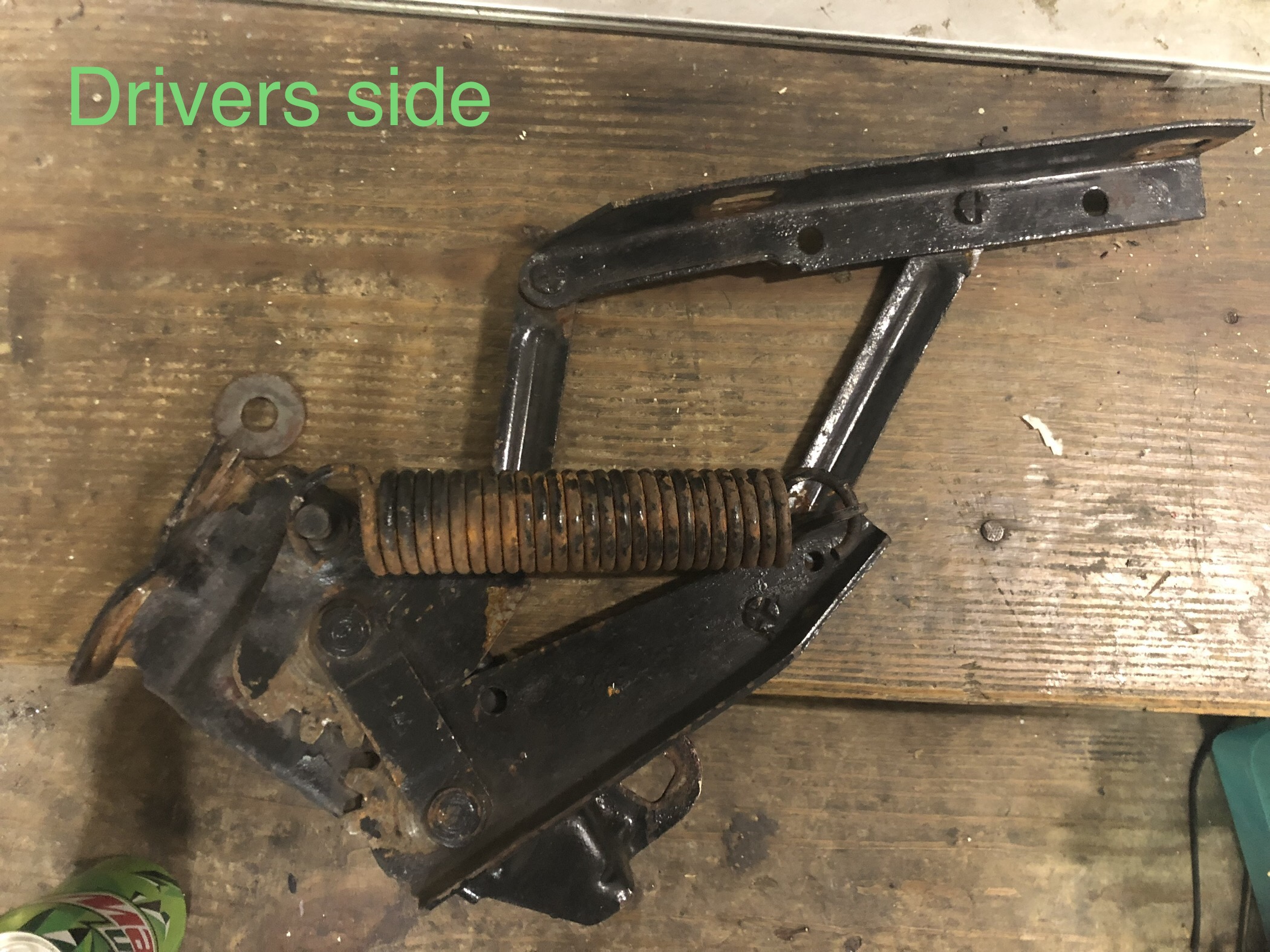

Ok, so since the last post I have discovered somethings. I went and removed the hinges completely. The first 2 pics are with the hood back on with no hinges. The hood still sits up. You can see there are differences in the hinges also. Now, with that said, the hood has always been really hard to pull down and close. I mean really hard. I justa figured the hinges were old and hard. Is it possible that all the excessive pulling on the hood actually warped/bent it in the middle and that with the different hinges are actually causing the problem?
Dr side doesn't look bad on the hood.  But the hinge looks bent at the hood mounting point, almost curved.  The pass side of the hood is waay up.  Looking at the hinge, the mounting point for the hood does NOT look like a good 90 degree bend.  May Justa be the pic's.
So you're thinking replace or try to straighten the hinges? The driver's side is lower today. Normally both sides of the hood sit up about 1/2". I was able to push it down today to where the opening in the top hole was even with the bolt. So, if the hinges are bad wouldn't the hood sit flat on the car if the hinges are taken off?
mate, to me it looks as if they have been stuffed with... hunt down a pair of replacements
 Your hood should not be hard to pull down, mine isnt, now that i have straight hinges on her !!:rofl:, the bent ones where shocking !!! haha
i can also see what your seeing ! justA past the hinge mount points on the hood the skin is bent..
i suggest a little manipulation is required to flatten it out again .... 👍
Ok, thanks guys. I'll try to locate another set of hinges and take a look at the hood skin. I'm not sure if it can be flattened out again. There's no gaps between the outer skin and inner hood panel. But I will take a look in the morning.

it justA looked to me from your picture mate that the corners by the window screen where flush, then the panel climbs as it goes towards the front. am i right ???.... i will look again .
 but if that the case, i bet you could carefully flatten it .
yeah it looks curved to me.

What also gets me, is why have they cut out the hinge mounts? those holes are not factory aye? on that driver side one... the same side you have a caged nut missing  to the fire wall mount of the hinge.
Yeah bro, the only thing I can figure is they cut that hole to try and adjust the hood lower. But I don't know. The hinge to fender hole on the passenger is cut or modified also. I don't understand why its cut that way.

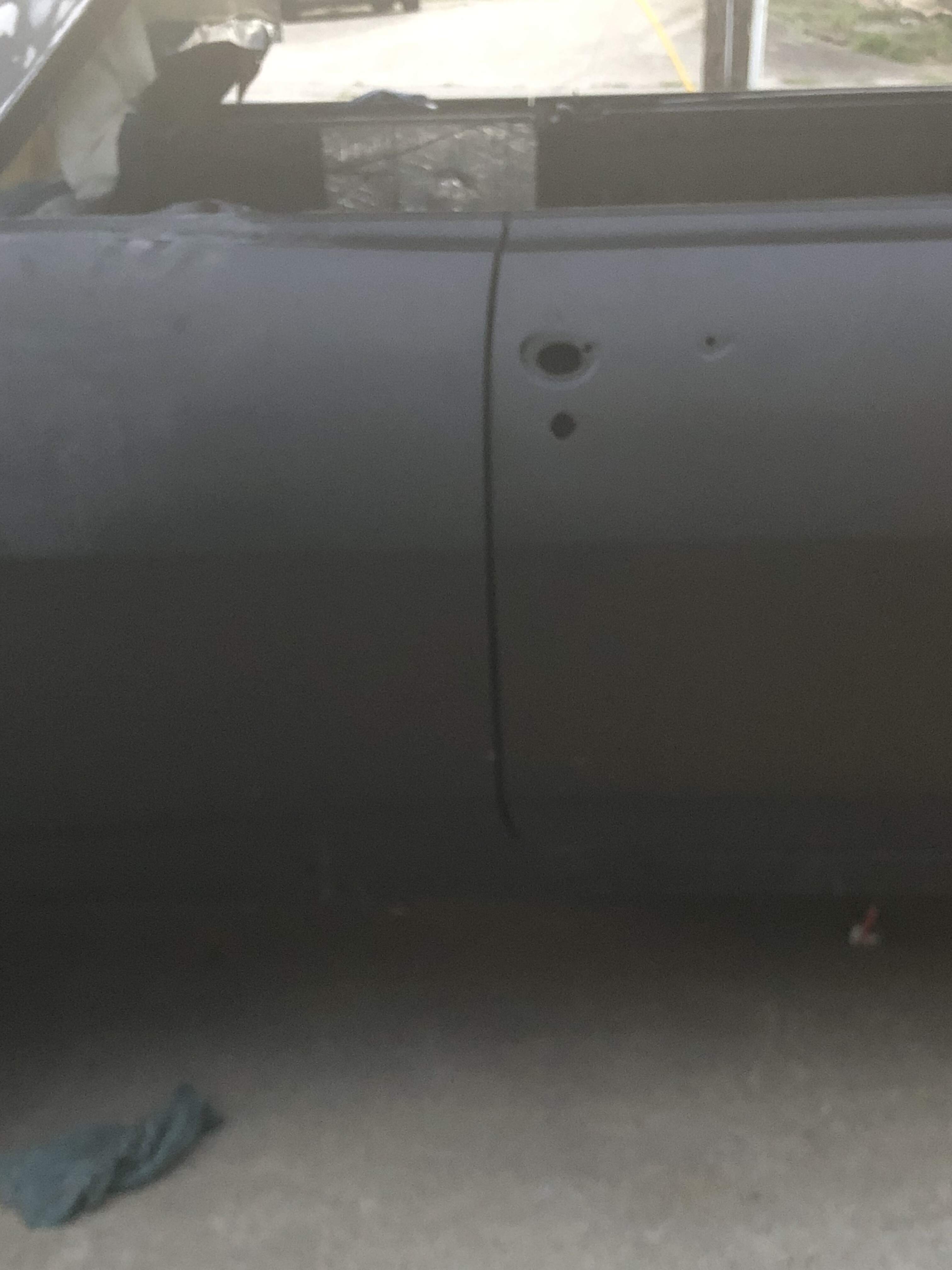

Mate how is your door gap to fender ?
it’s justA thought that maybe your front fender to chassis bushings, are packed too high
