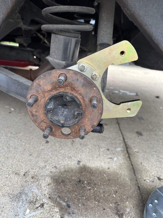

Got the bearings and seals today. Had the old bearings pressed off and new ones pressed on. I did get the grease seals installed in the axel housing also. Plan on getting the axels installed tomorrow along with the new calipers and disks. I'm guessing there is no way of flushing out the rearend or is there a need to?

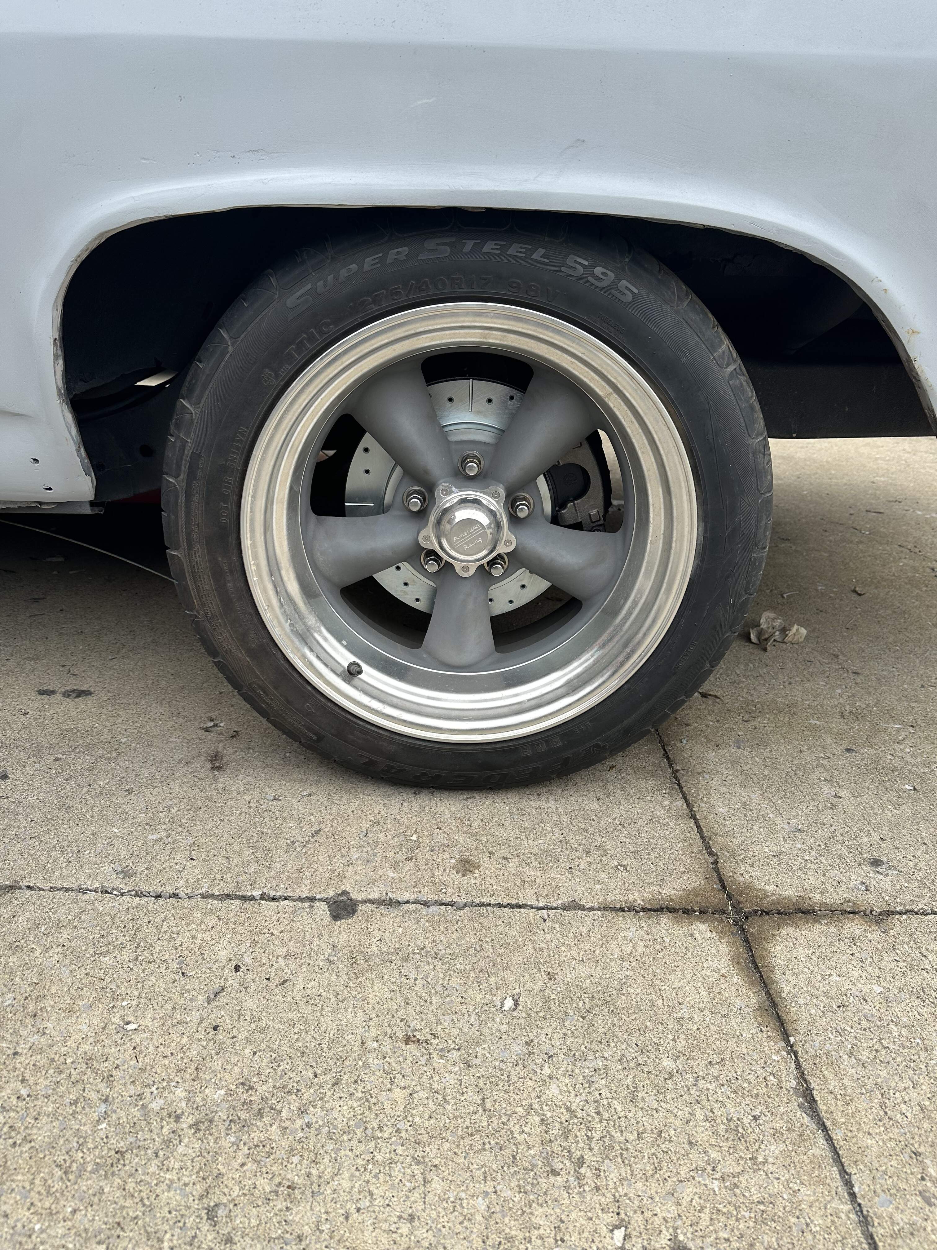

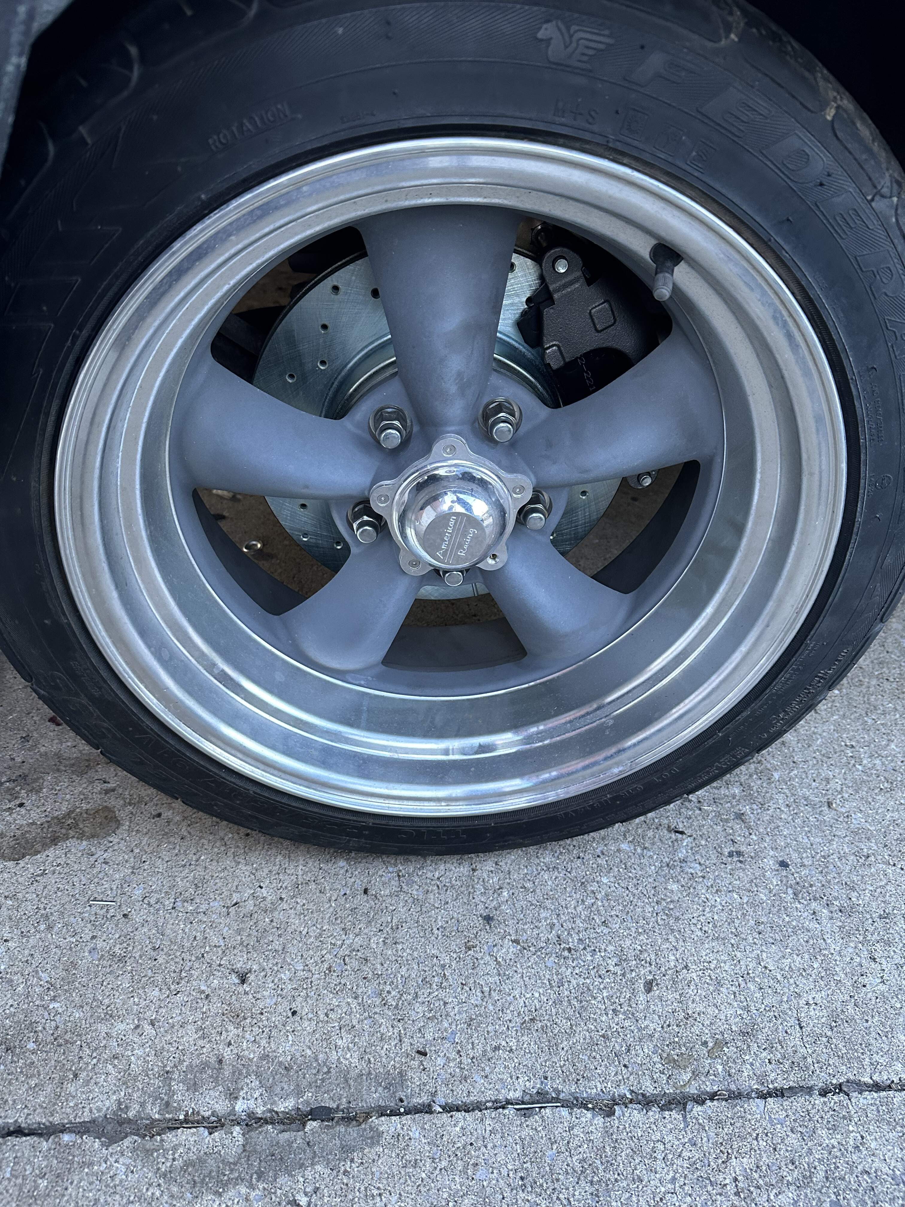

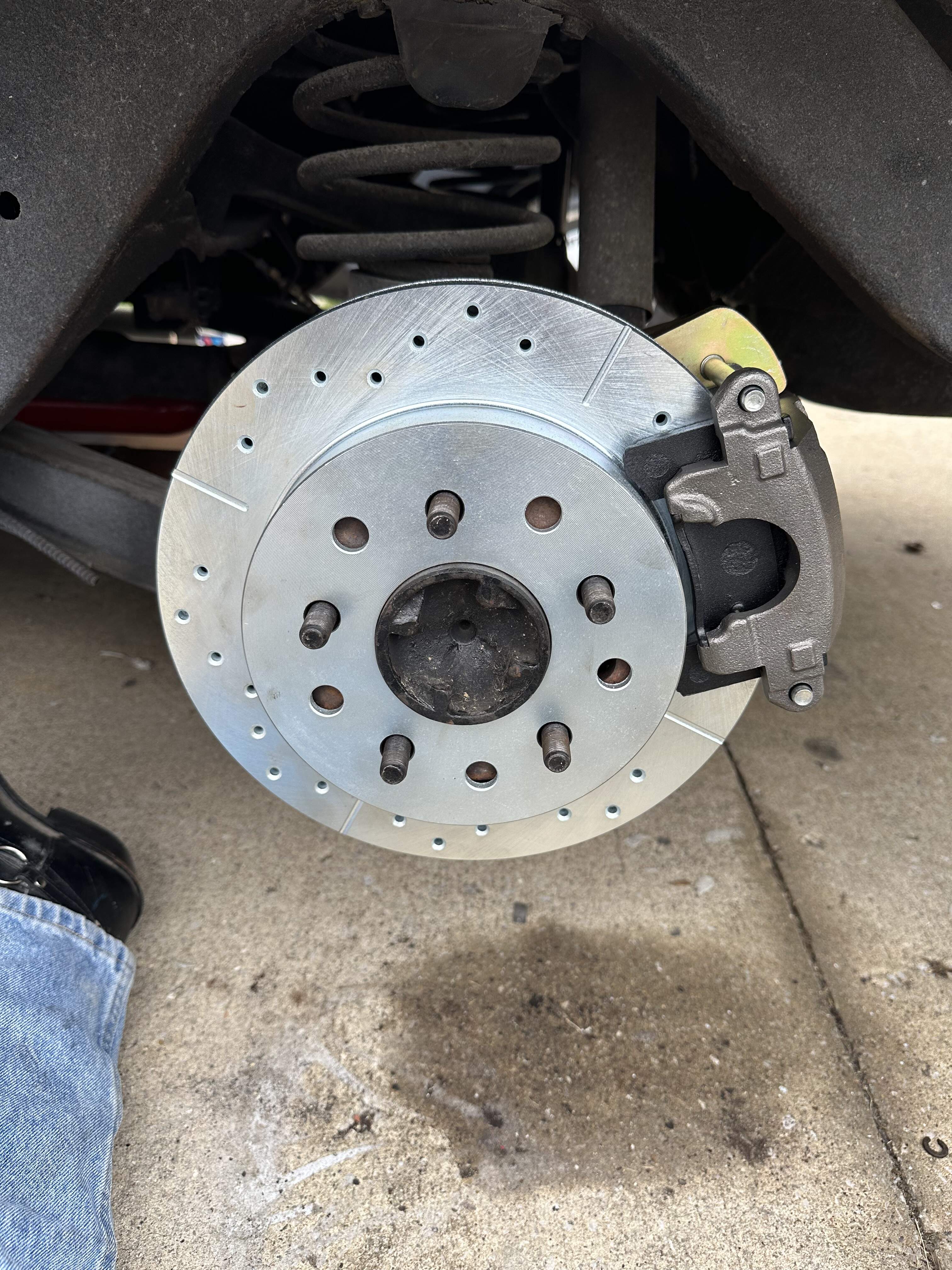

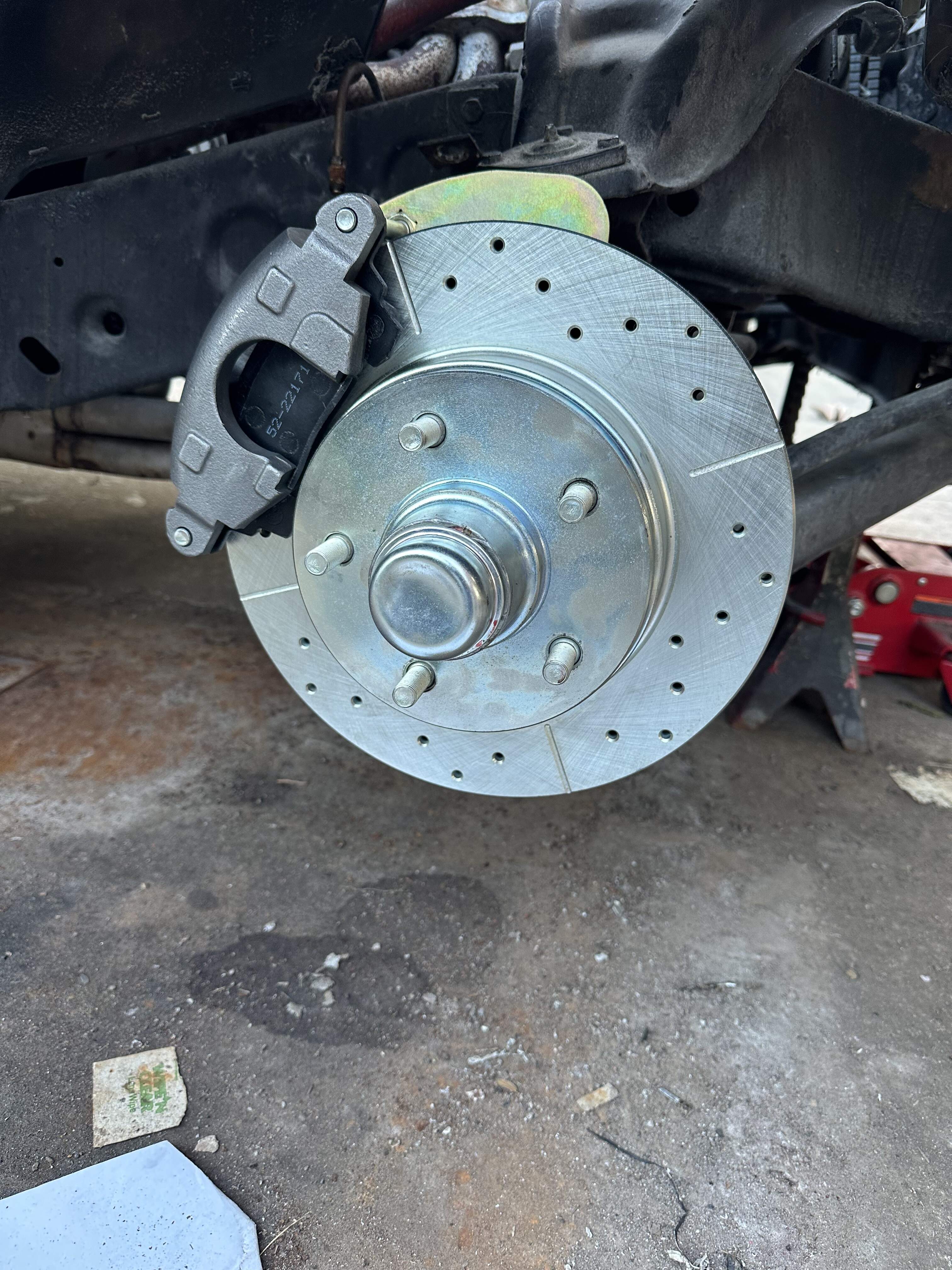

Well, I got the rear disk's installed yesterday, raining again today so no fronts yet. I do love the way they look!
wow!!! that looks sooo clean mate:cheers: what brand are you using ? and are you changing the master cylinder too ?
hay!, do i see a 2 inch spacer under your spring ? are you using factory springs ??
Thank you, and yes sir, new master and booster. I've already got new lines ran from when I redid the drum brake system. Most of the parts are Car Quest brand from the local parts store. I found a list a while back of compatible parts to use for a conversion and started ordering them and setting them a side over the winter.
Yes, that is a spacer bro, 3" if I remember correctly and yes factory springs for now. I put that in back before I found you guys and was trying to figure things out on my own. I want a nice "hotrod" stance. I couldn't find info on the size spring I would need for the stance I wanted so I bought 2",3" and 4" blocks to try and see what I liked. I loved the way the car rode, so I didn't want to change the feel. Only drove it less then 20mi and the trans went out so that got pulled and rebuilt. After the brakes and paint is done hoping to actually be able to start putting miles on her. It's funny, I've had her about 5yrs and only put about 20mi on her.

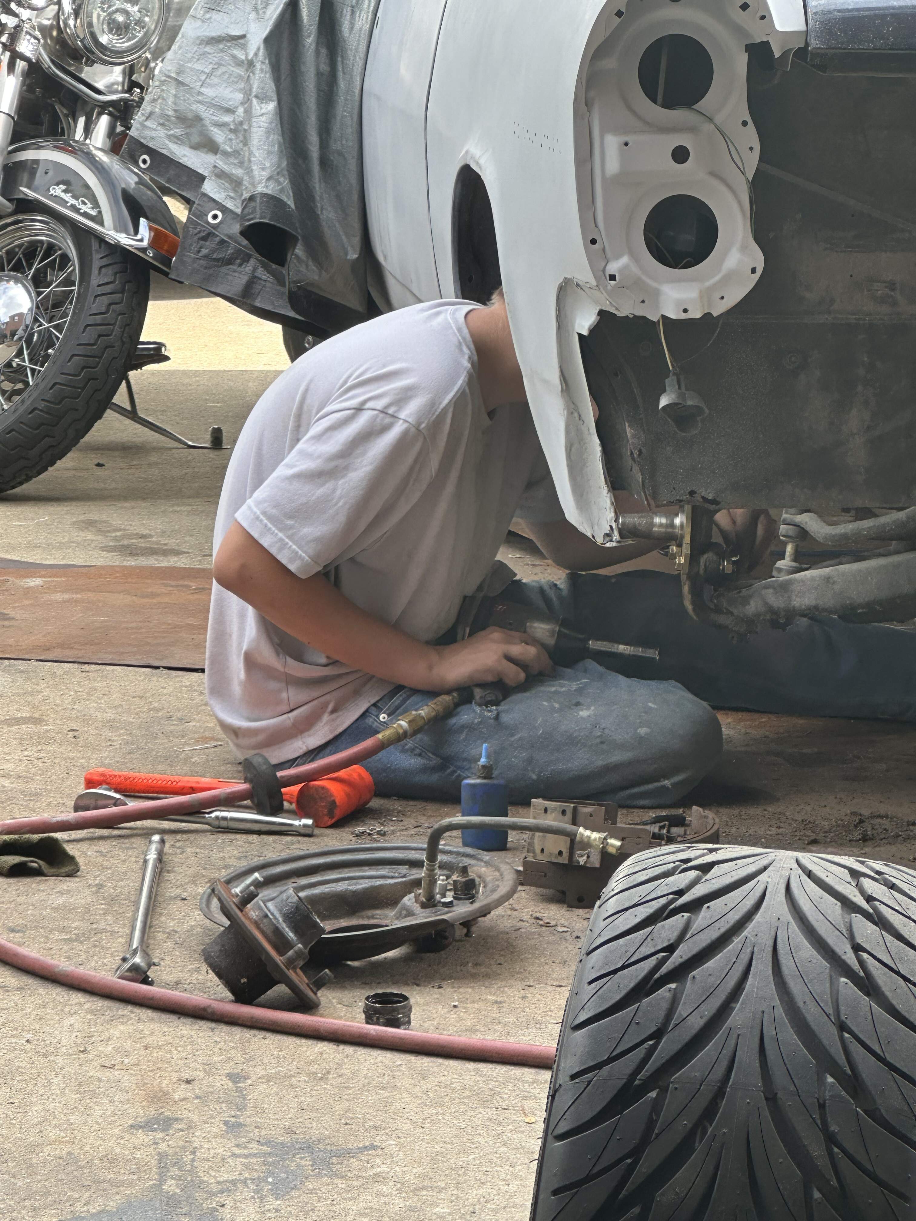

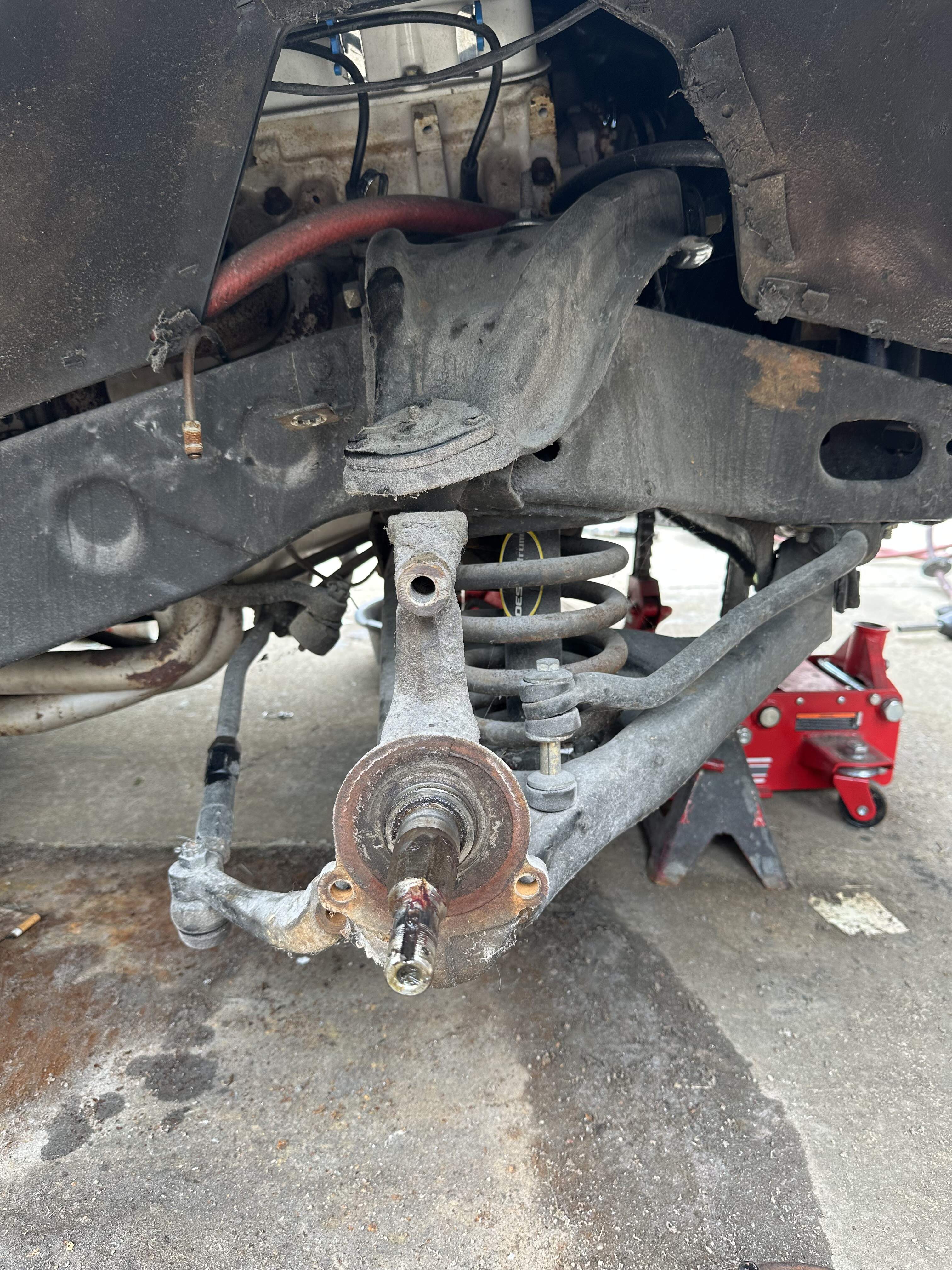

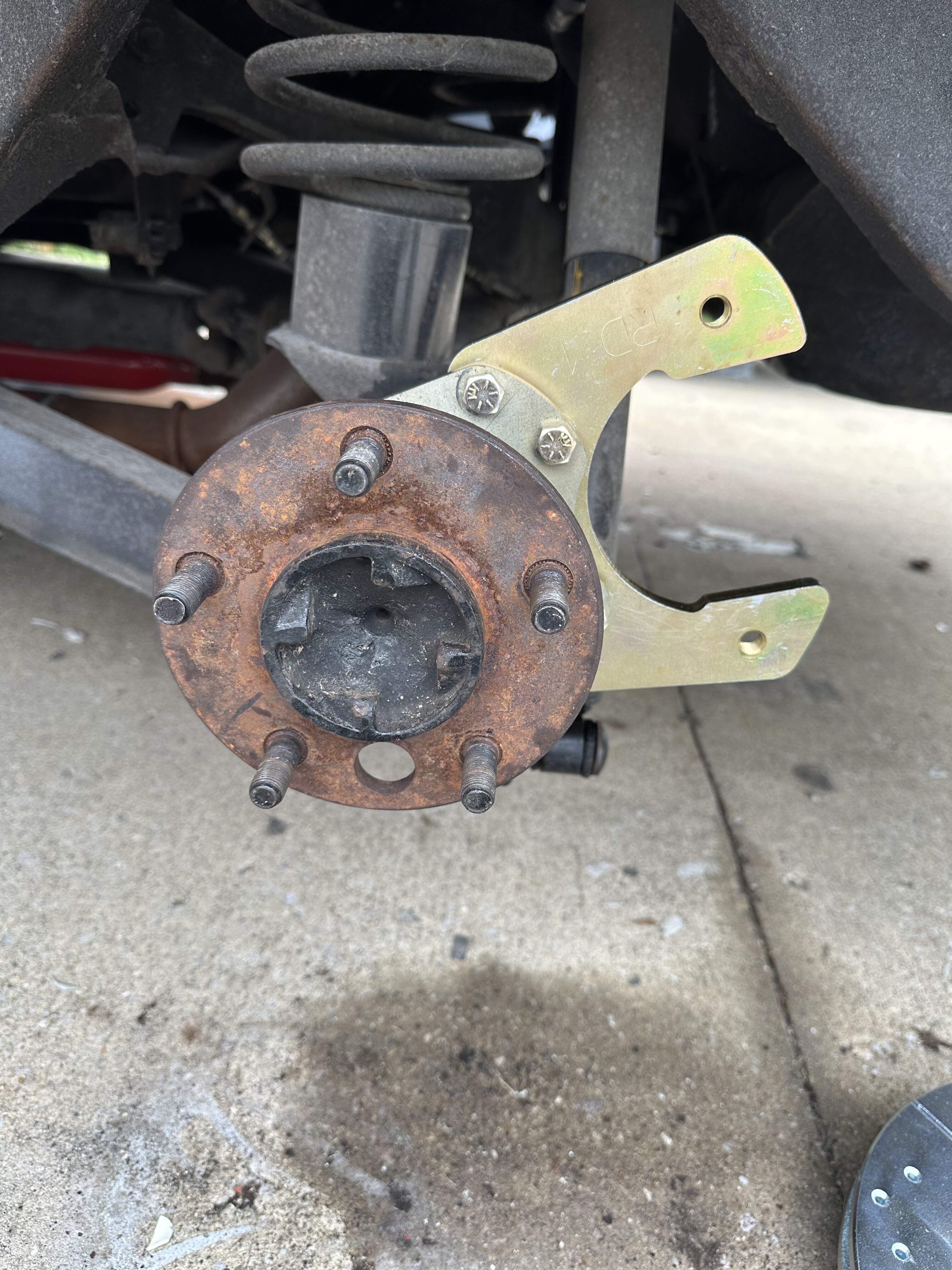

Well I got the front disk's installed today. I need to change the brake line fittings to match the fittings on the new rubber hose's still. Tomorrow depending on rain will be the new master and booster. Here's the pics and a proud papa pic of my 14yr old son. He normally helps out working and learning about the cars and bikes and whatever I'm wrenching on. So, while doing the driver's side rear last week he asked if he could do the passenger's side. Sure. So, he watched me then did the passenger's side by himself with me watching. Today was the same, watched me and he installed the passenger's side. He had 1 question about how the pads laid in caliper, but he did 100% of the front and rear passenger side.

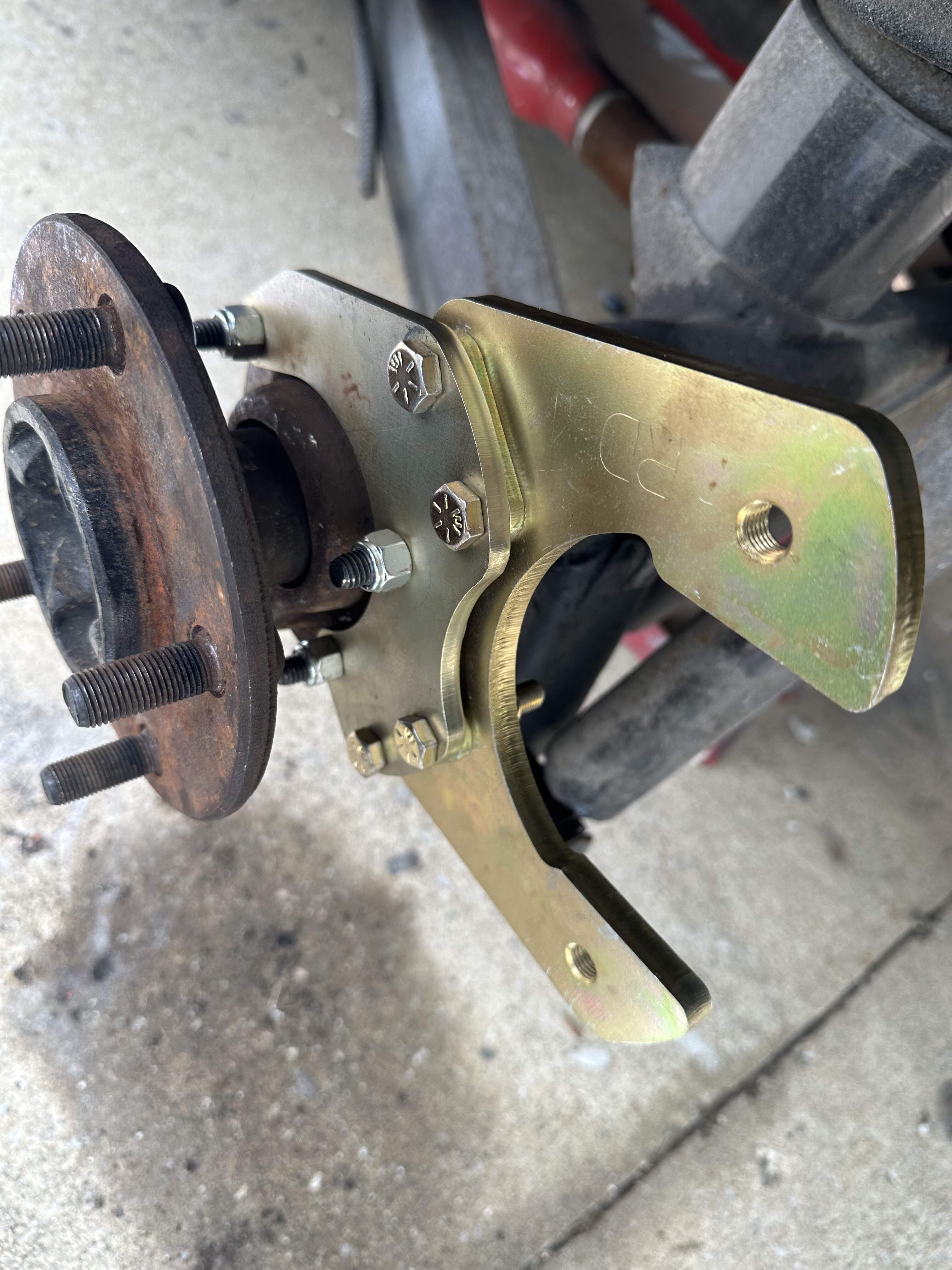

Wrongway … I see you have used the auto city brackets … and even the discs look like theirs… what calipers have you used .. that eBay deal is really good
but I am wondering if I can do it cheaper …
The calipers are from a 1985 Cadillac El Dorado my parts guy ordered me. I believe they were CarQuest premium. The brake lines and most of the hardware are also whatever brand Advanced Auto stocks. The brackets and axel adaptor came from Toms Classics in white boxes with no writing so I'm not sure of the brand on those. The rotors were sourced from eBay since Advanced Auto didn't stock drilled and slotted for anything on my list. Normally they would 3rd party the parts from someplace like Summit, but eBay was cheaper. According to the list I have it says we can source parts from:
1978-1983 Chevelle, Monte Carlo, El Camino, Malibu, Tempest, Cutlass, F-85, Pontiac Grand Prix, Le Mans, GTO, Grand Am or Bonneville.
1979-1985 El Dorado, Riviera and Toronado
1980-1985 Seville with emergency brake on the caliper.
My parts guy is a personal friend of mine so it's not abnormal for us to hang out and have a drink. I give him a list of parts, he orders what he can, and we find the rest of the parts thru other vendors like Summit, Jeg's, Speedway Motors and even eBay.
Hope that helps.
