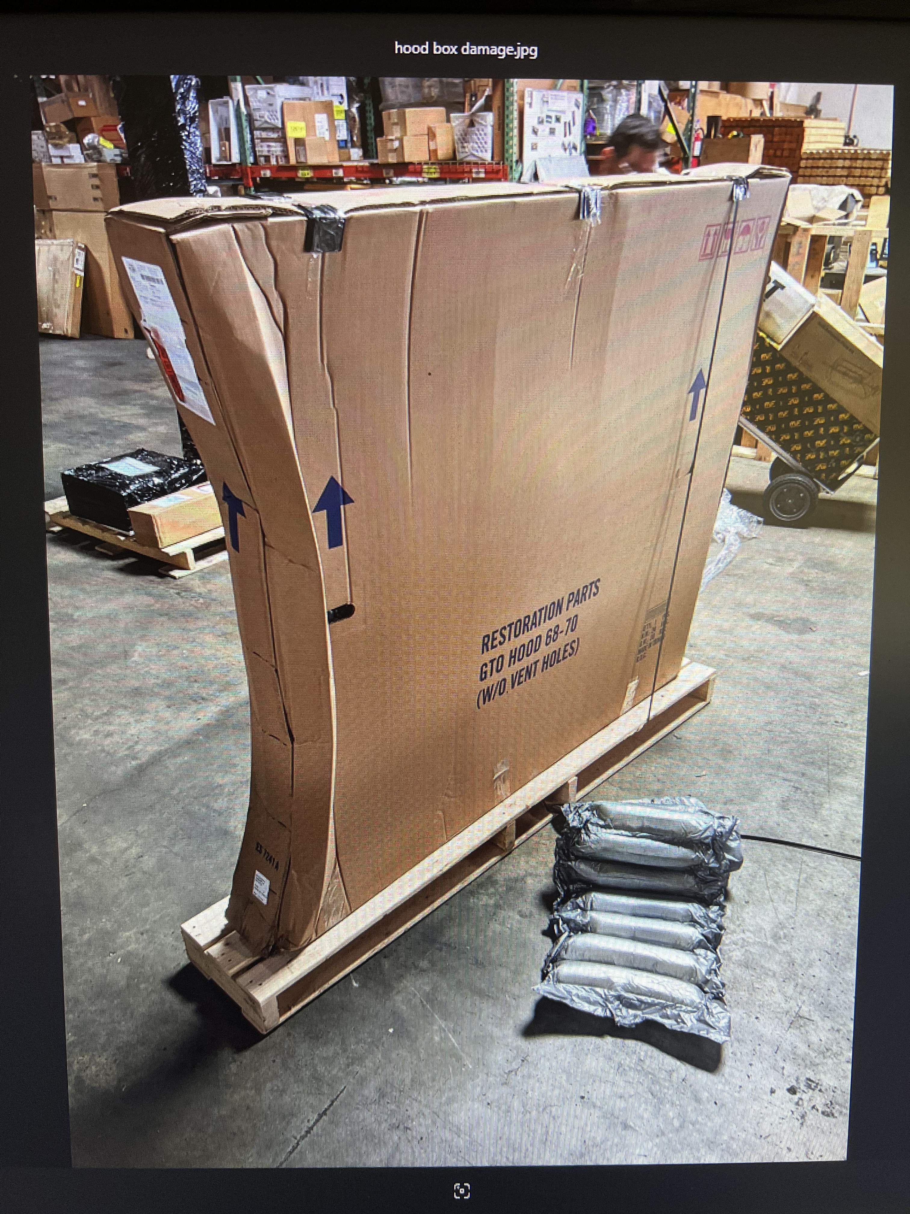

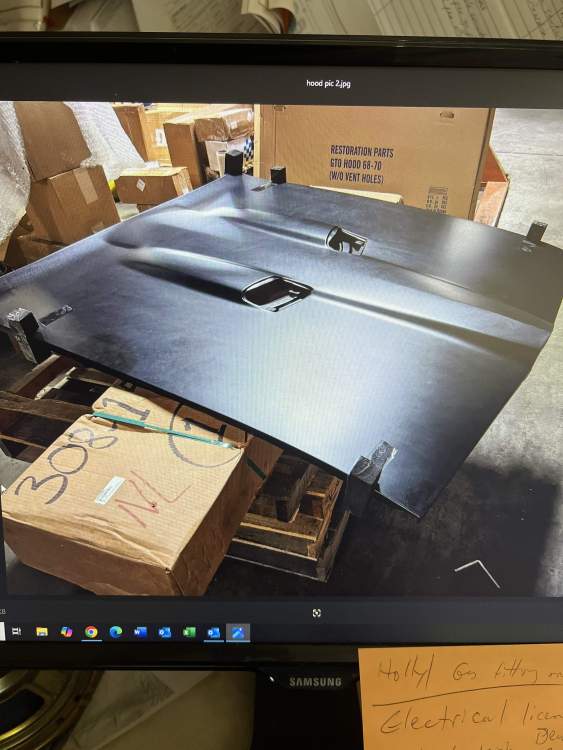

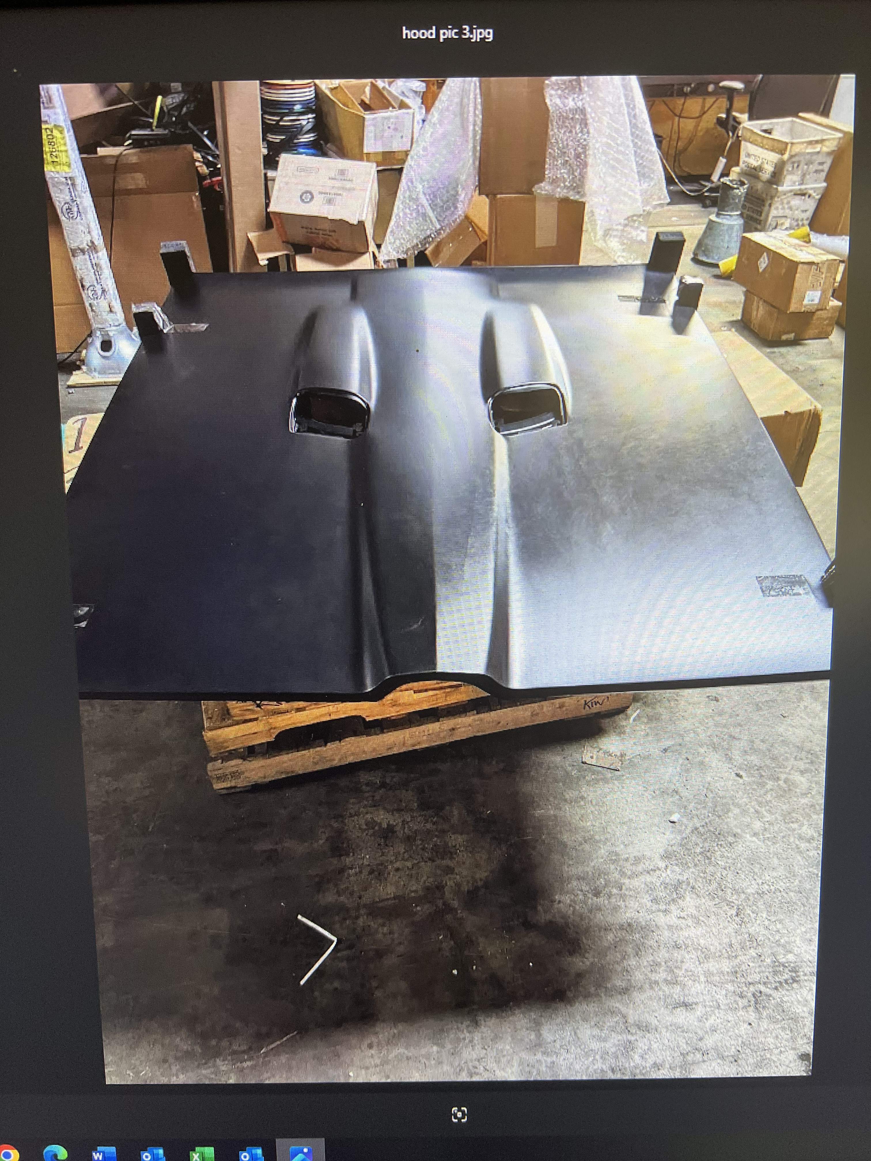

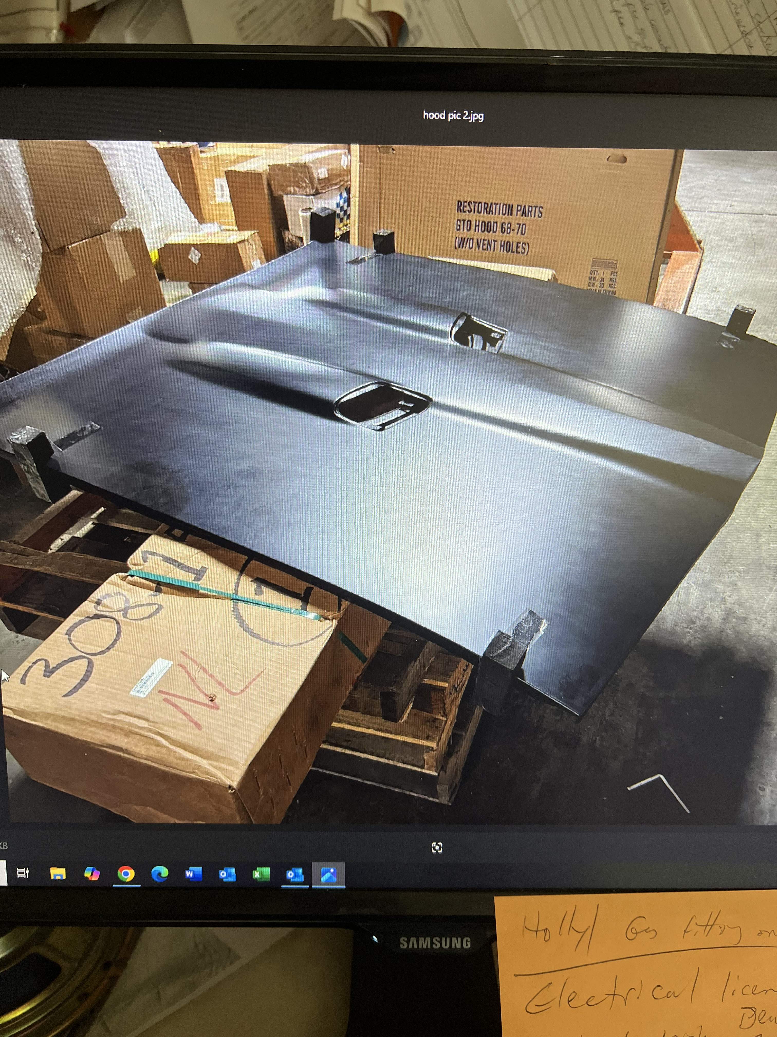

Back at the beginning of January i pulled the trigger on a new hood , vent inserts, 2 fender patch panels and a new hood latch for the 68  from opg.... the very first week the inserts where sent to my shipping company  in california, with none of the rest of my order !!!
so i contacted opg ....this is my very first order with them and i am very disapointed in the fact that they can sell you stuff and not tell you they actually dont have it in stock !!!!
today the hood arrived at my shipping company !!! its the middle of March now !!!
check out how the box arrived !!!
thank fully the team at Kiwi shipping opened the box and inspected it and they are happy that its not damaged !!
and now i am still waiting for the fender patch panels and latch, very very dissapointed opg !!
every other company i have delt with will tell me its on back order and give an eta , like when i ordered the long branch headers for the 64 , they where happy to tell me and i was happy to wait knowing they where onto it ... not this company !...
i will get down off my soap box now and go watch the letter box and wait for my parts to arrive ......
