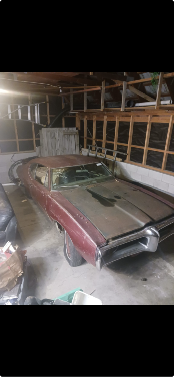

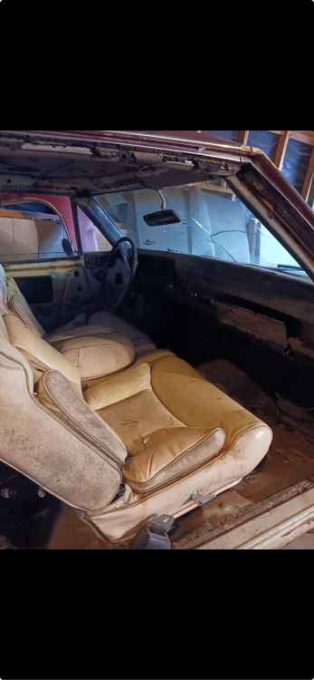

I have a guy who wants to swap one of my Holden crewman utes for a 1968 Lemans
I have only seen pictures and can see it’s missing interior door cards and trim
seat are there but rough as
body looks to be good except for lower back window panel , missing rear screen
Plain Jane wheels , 350 engine not running but I was told it was a good runner .
remebering I already have the 57 and 63 to build …. Are these a good car to have ?

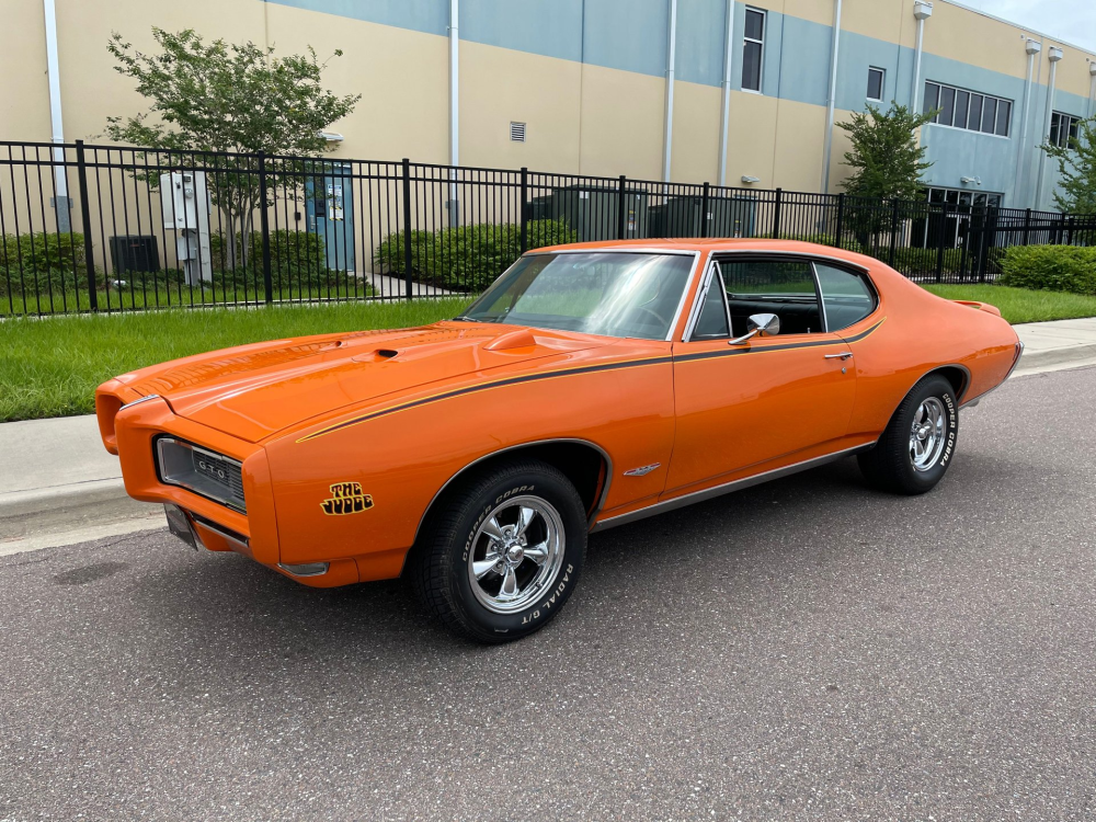

It could be a clone like this sexy little number !!!!!
And !!! I still have my plates from my 2007 gto !!!!
Essentially the right grille and interior parts separates a GTO from a Lemans. Anyone who knows Pontiacs knows a real GTO of that era starts with the VIN # 242 and not 237. The other give away is the 350.All GTOs came with 400s.
That said, nothing is preventing you from building a GTO clone or tribute car. The only other thing to remember in ‘68 is that there was no Judge or carousel red (orange) paint available that year.

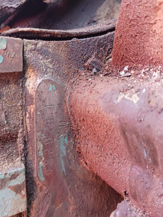

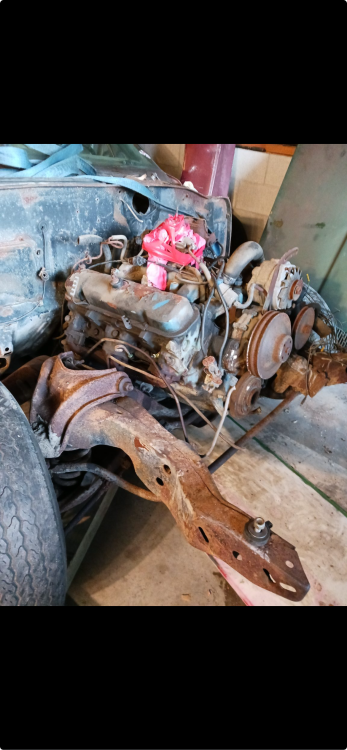

here is the motor number on the 68 ... i will need a hand finding what it is ?

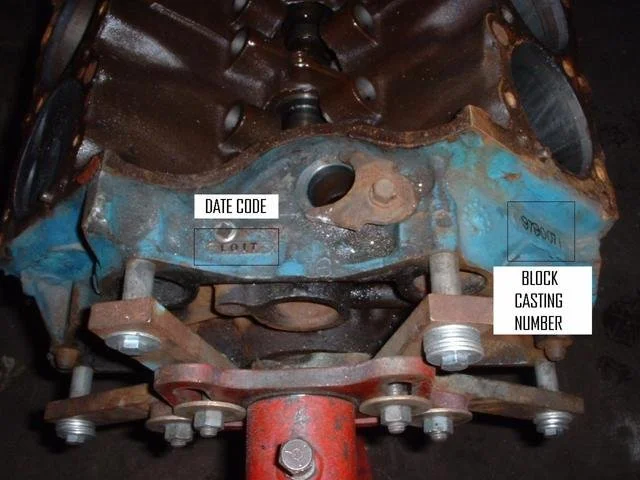

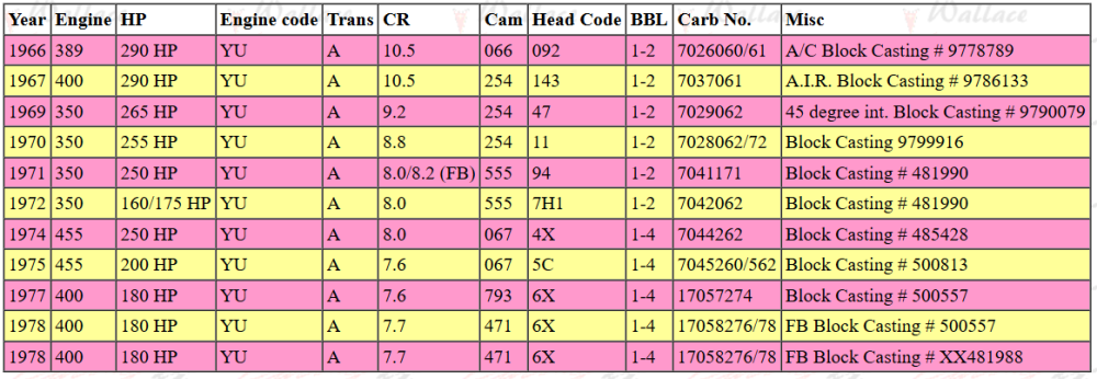

Kiwi - I need the casting date near the distributor to know more. for sure. Possible YU block codes are listed below. Also if the displacement is cast into the side of the block, that will help too. Yes it is possible that a '67 engine could have been installed in a '68 car, depending on the casting date of the engine.
Thanks frosty
the guy I am doing the deal with sent me that picture
so I will need to ask him to look for the casting number 👍
Yeah - so there are a few things to look for.
1. Near the distributor hole is the casting date of the block. This tells us when the block was cast. It gives us a rough idea when this engine was assembled (after the casting date).
2. The cast number - this is a six digit number. This will tell us what the displacement and the model year(s) this engine was made for.
3. In the latter part of the 60s and in the 70s, Pontiac put the engine displacement on the block in bold numbers, you can't miss it.

roughly where on the block mate ?
As for displacement (assuming it is stamped on the block in the first place),.On 1968–69 428 blocks you will find “428” stamped between the freeze plugs. On blocks produced in 1970 and after, you will find 350, 400, or 455 stamped towards the left side of the front of the block. There is no displacement stamp for 421, 389 or 326 blocks, hence the need to know the casting number.
