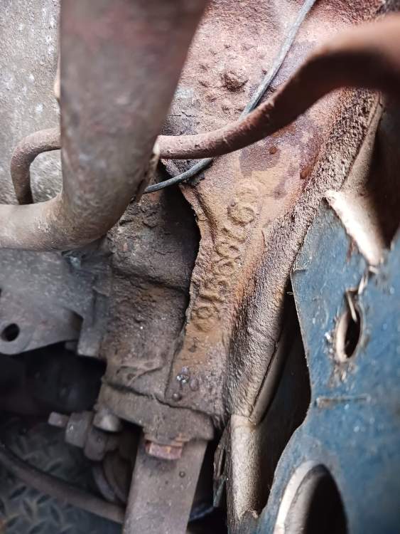

got this sent this morning .... frosty it looks to read 9799916
Hmmmm… I don’t see a casting with those numbers, if I am reading it right. 9790916.
i don’t see any casting numbers with that combination. However I did find a 1970 350 YU engine code with a casting number of 9799916. It’s a 255 HP motor. 8.8 compression ratio. Automatic transmission car. #11 heads. Two barrel carb. #11 heads have a 1.96 intake and 1.66 exhaust valves.
350 2-barrels were the base engine in the Tempest and Lemans. However, this does not appear to be the numbers matching engine if it is a 1970 engine in a 1968 Lemans.

i agree with you !!!
 recon its a 1970 350 motor based on what this guy has sent me
that means it will be a turbo 350 trans ???
I 100% agree with Frosty...That the engine is Not original to the car..The Number that is stamped on the the pad located on the front Right hand Bank of the engine block...Will be what tells the history...The last 4 digits of that number (9284..??) Will match the last 4 digits of The VIN # of the car it was originally installed in...Back in 1970/71...I would bet that the last 4 digits stamped on the Engine...Don't match the the last 4 digits of the VIn # of the car you're looking at...100% Guaranteeing that the engine is Not Original to the car..
It is more than likely (but not 100%) That the transmission is a Turbo 350..An easy way to identify a Turbo 350 Transmission...
The Turbo 350 will have a Manual Kick down cable that is attached to the transmission Via a 1/8 allen head bolt through a plastic O ring fitting that is located about an inch or so in front of the Dipstick Tube Where it goes into the Transmission Case...On the passenger side...Depending on the application the other end attaches to the side of the carburetor inconjuntion with the throttle cable...Although in certain instances the Kick down cable will run through the Firewall directly to the top of the gas pedal Assembly...

To Two Lanes point, the 350TH was the standard automatic transmission for the 350 V8 along with a 10-bolt rear end. The diff would be open unless it was optionally ordered with a posi. I also suspect the car has no factory rear sway bar.

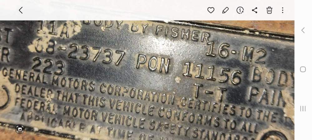

two lane , here is what he sent me .....

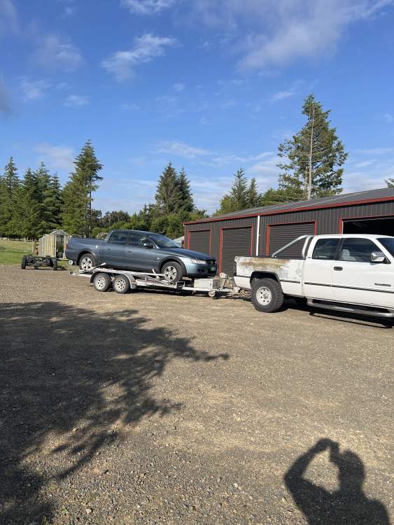

Here is the carrot I will dangle to the guy
and see if I can do a deal !!!!
One 2006 Holden crewman cross 6

The VIN # Is on top of the dash board...Visible through the lower left corner of The Windshield...
This is the Firewall Tag it has the paint/interior colors...Have decoded it as best as I can..
68-237= Time and date built..
37 = (body type) Lemans..
PON 11156 =(assy plant) Pontiac MI.
223 (interior trim code) = Black Vinyl..(bench seat)
T-T (paint code) = Primavera Beige...(solid color)

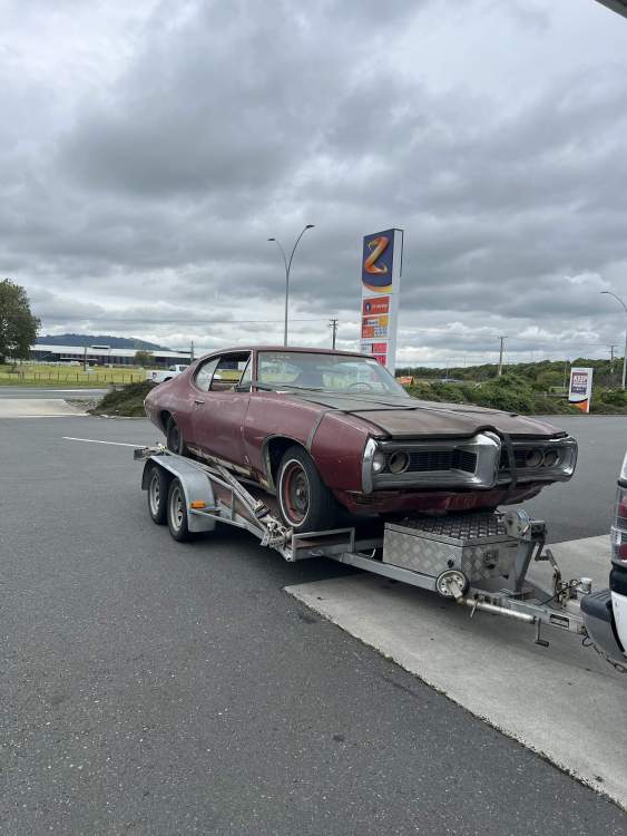

sorry for the delay !! it was a long weekend !!! trip to Auckland to grab the 68 then xmas parade and pub yesterday !!!:cheers:

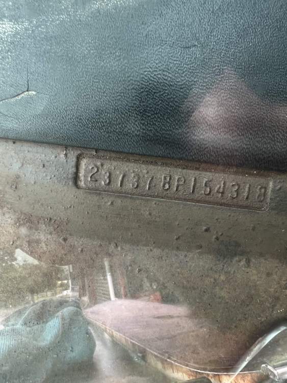

here is the vin Two lane

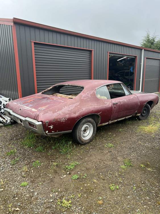

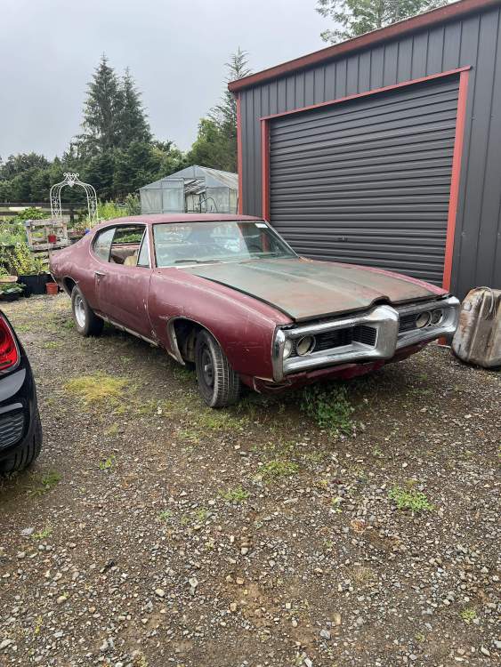

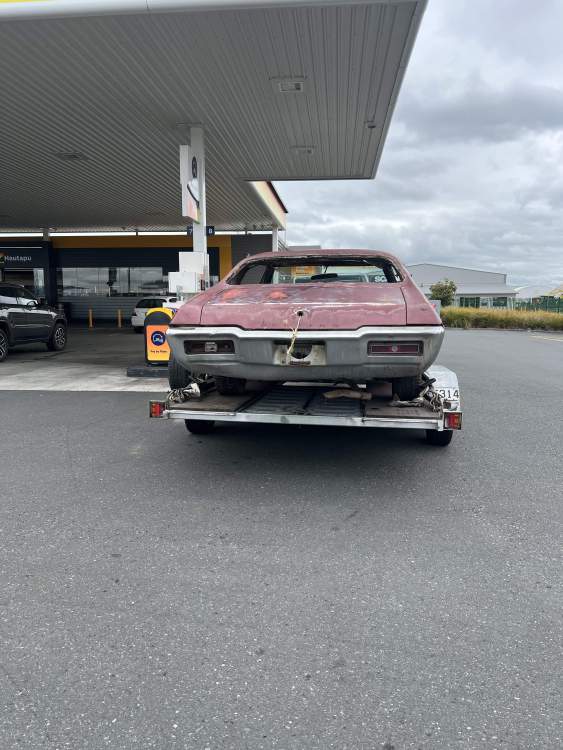

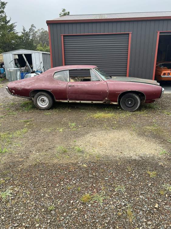

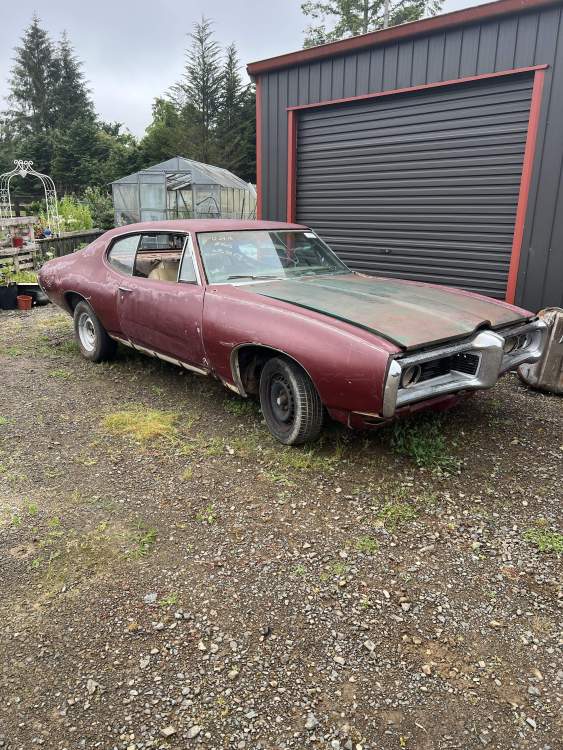

And some new picture ……
it has rust around the bottom oif the back window, and both lower front fenders, floors are solid as well as the trunk floor
interior is wrongway ! it caddy stuff, the door cards are missing , dash is a mess , engine is a 1970 350 and turbo 350 trans
motor isnt running but i can turn is and has compression , starter is missing ! drive shaft is in the Trunk, power steer isnt hooked  brake are manual with drum front .........
rear bumper is toast, front is only tidy but straight...
my first thought is to get it running and moving under its own steam !
oh ! hood is toast too ! lowwer sill trim is missing !!!!
Here is your break down for the vin…
2 = Pontiac Motor Division
37 = Lemans, GTO=42, Custom S=35, Tempest=33
37 = 2-door coupe, 67=convertible
8 = 1968 model year
P = Pontiac Michigan assembly plant
154318  = the 154318th car produced at Pontiac assembly for 1968. Some plants only produced a single body style, while some made multiple cars such as A and B bodies at the same plant.
Other assembly plant codes are:
K - Kansas City Missouri
Z - Fremont California
B - Baltimore Maryland
G - Framington Massachusetts
R - Arlington Texas
