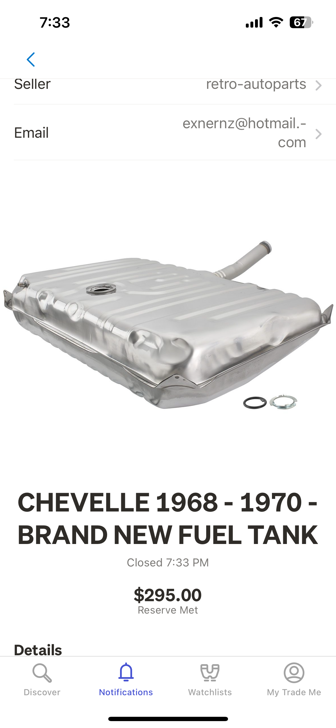

Frosty, do you know if a 68 chevelle gas tank fits the gto ?
i have been offerd a brand new one for 300 nzd ! which is cheap
I would say it should fit, the same frame, both have the neck behind the L plate.
Kiwi - the short answer is yes. It should fit. JUSTA is correct.
I have heard that you need to check two things. First is the length of the filler neck of both tanks. I’ve heard some guys complain that the ‘68 filler neck is 2-3 inches shorter than the ‘69-72.
I have also heard that the filer neck angle on a Chevelle is slightly less than a Pontiac. You can bend it to fit but you want to make sure you don’t crack it and cause a leak in the process.
I’d spend my money on the Chevelle tank too! Good luck! Let us know how it goes.
Thanks guys. $300 nzd is very much what I would pay the likes of opg or Ames
but less the 300-400 nzd in freight !
I know this as I have ordered a new gas tank for my 72 Camaro and it’s on its way down under
and I am paying $650 for it !!

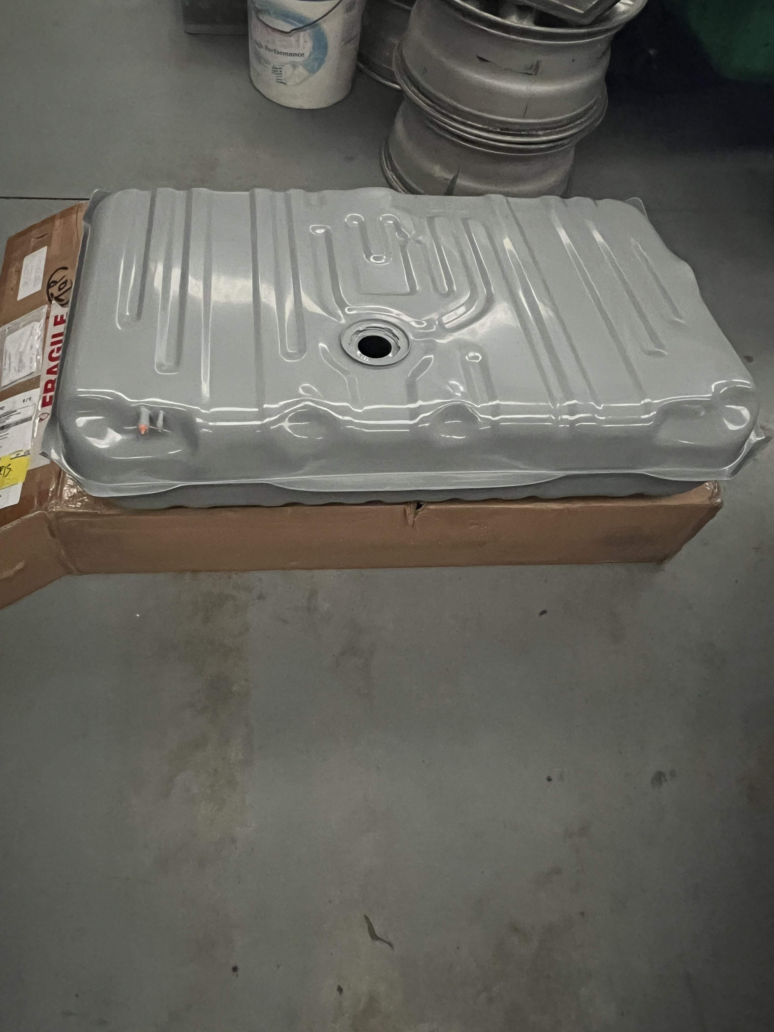

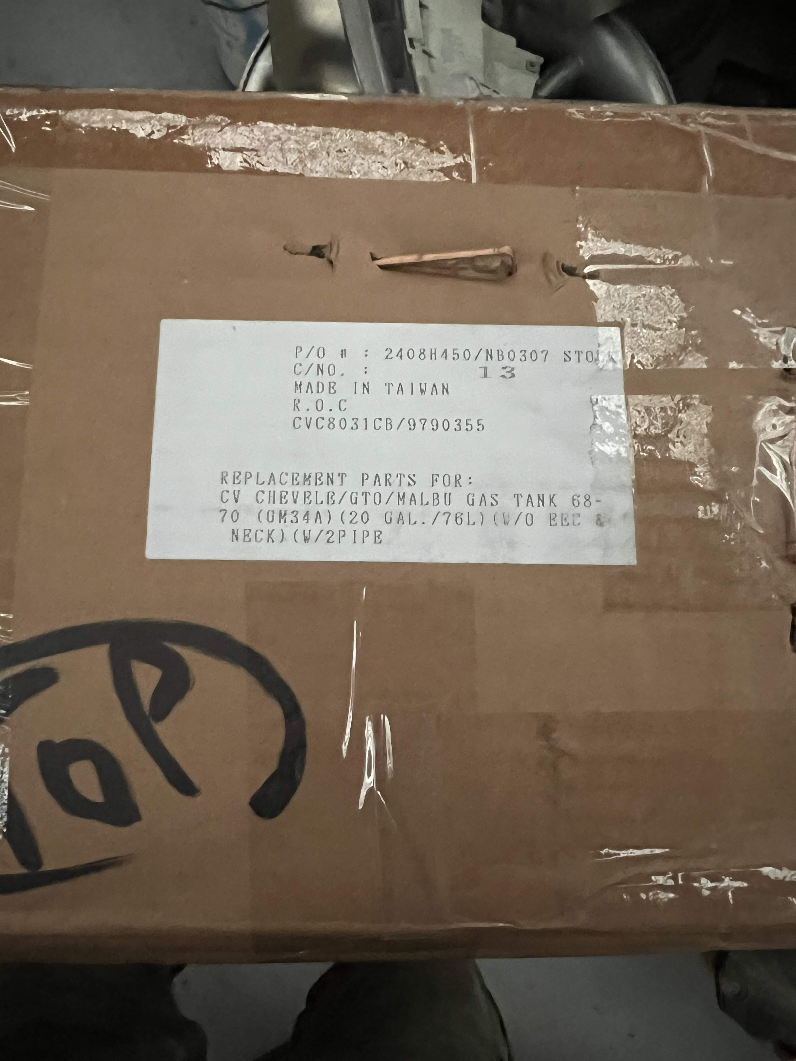

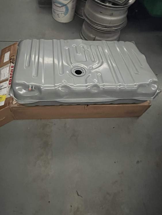

New gas tank arrived today ….
And on the label ….it says chevelle gto Malibu…. And spelt wrong !!!
Hopefully I will get time on the weekend to pull the bent tank from the 68 and compare them

At least they spelled GTO right! :picard:   Guessing it wasn't made in USA. :pop_corn:
Taiwan ! Like a lot of rockauto stuff is these days !!!!!:rofl:
