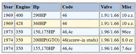

Kiwi - 46 cast heads were used on several engines. Here is the known applications I found. So you may well have a '69 400 or 428 head.
The 400 or 428s with 46 heads were designated to go in the B-body full size cars or G-body cars (the GP). The GP as well as the B-bodies could have either the 400 or 428.
J338 and J348 are your casting dates.
A-L = January to December  (J = October)
33/34 is suppose to be the day it was cast - although 33 and 34 are not valid dates in any given month.
8 = calendar year - in this case 1968.
Therefore it stands to reason that these are '69 model year heads since these were cast in October 1968, which would be the '69 model year.

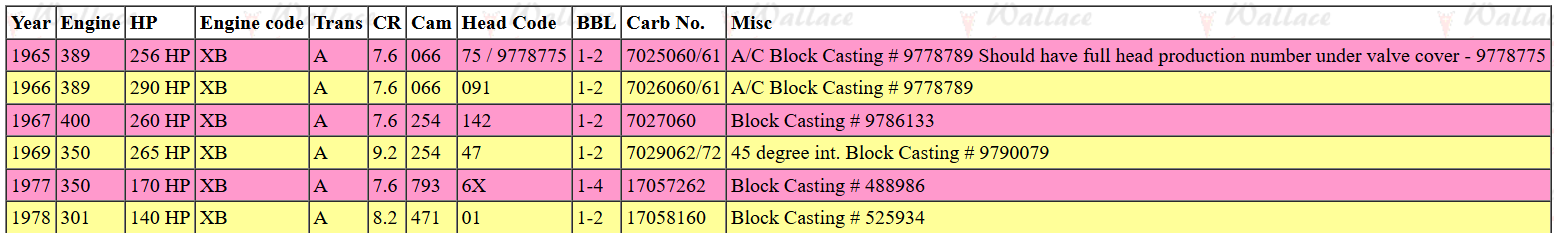

Frosty what’s with that chart of yours regarding compression ratio ?
am I reading it right when it says 10.1 cr for the 69 heads ?
guess I should try and work out their volume some how ?
That’s the info that came with the Wallace Racing data table I used. Sometimes it gives me the compression ratio, some times I get the number of head’s cc’s.

but is 10cr to high for pump gas ? I am guessing they could be 78 cc ? But I am not sure , it’s justA what I have been finding on the forums when I search Pontiac’s 64 heads
I will defer to Two Lane’s expertise but 10:1 is near normal for modern performance cars. Your Hellcat motor is 9.5:1. My 392 NA Hemi is rated at 10.9:1. So your pump gas can handle 10:1.

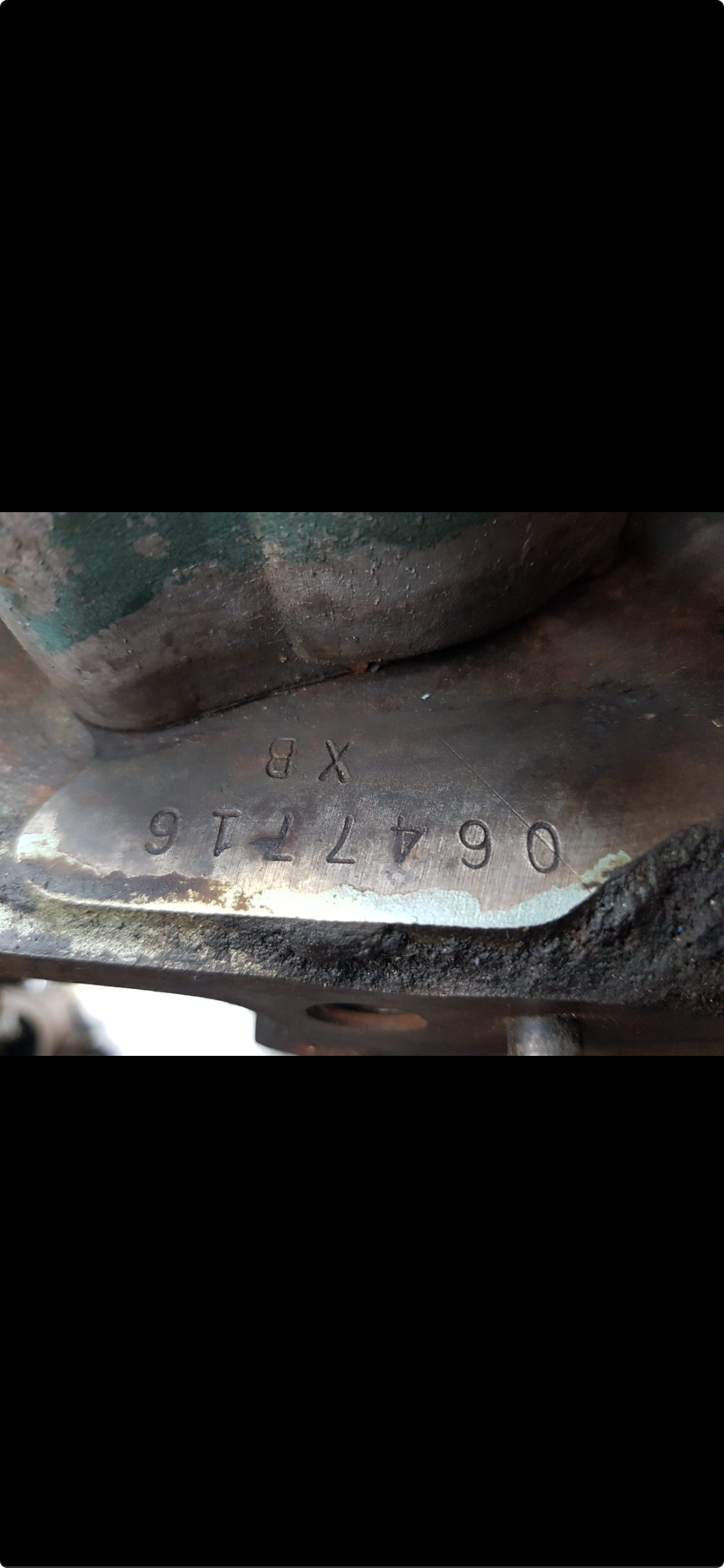

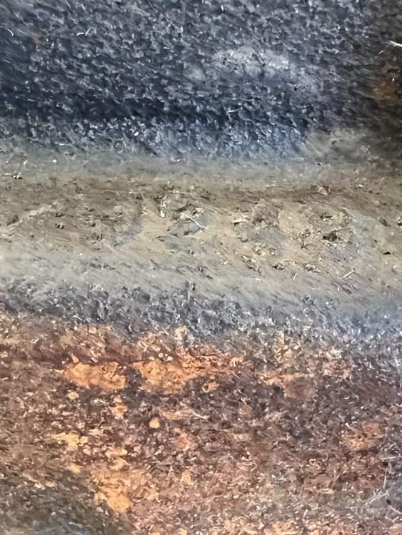

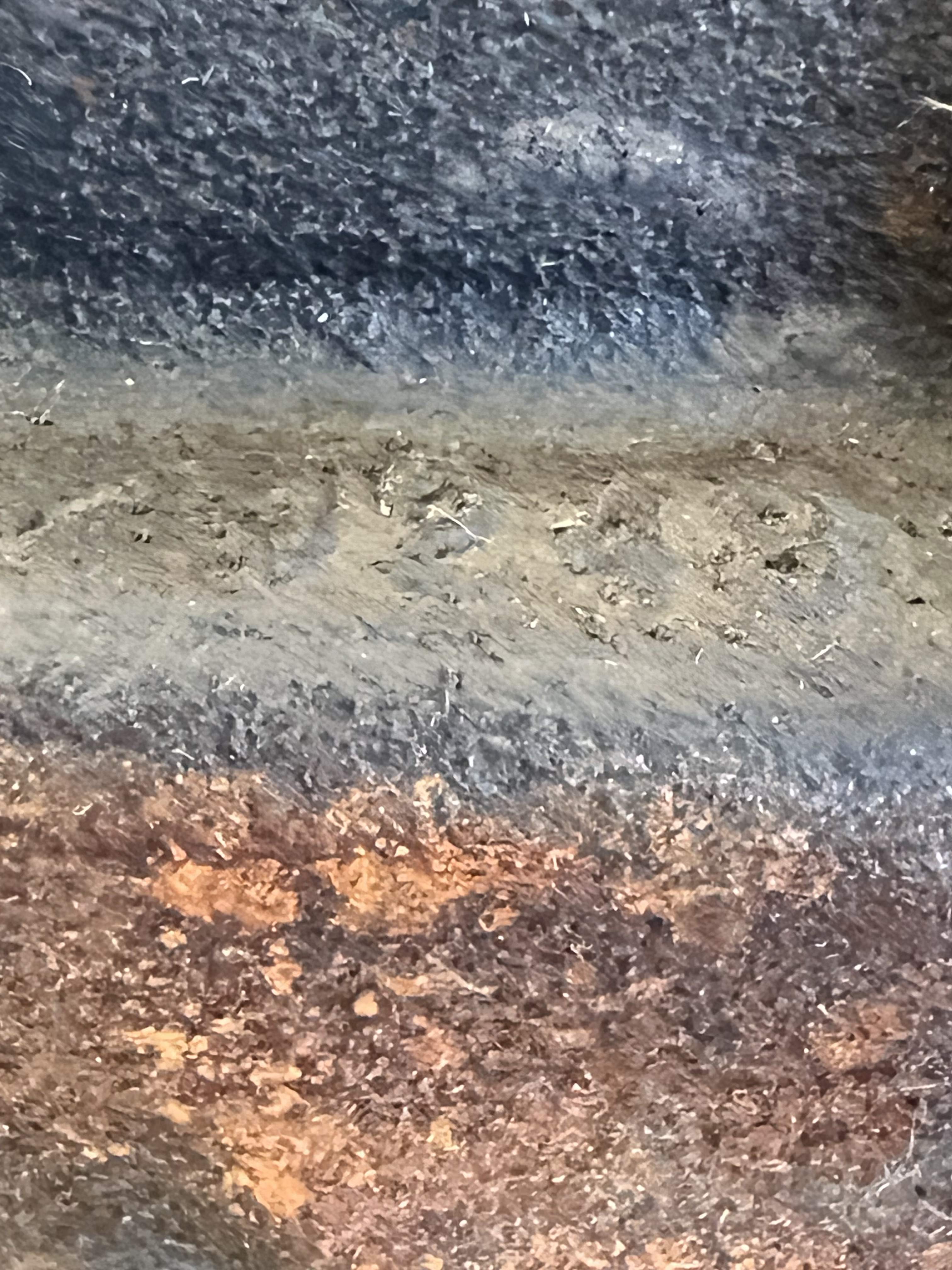

I came across this block today !!!
xb
does it tell you it’s a 1967 400 motor ? image.thumb.png.a564344ae5345973749c699bea15a712.png
Sorry Kiwi, it does not. Pontiac used the XB code six times between 1965 and 1978. It was used in 389s, 400s, 350s, and the 301.
Your block’s casting date code should be by the distributor hole.
Your six or seven digit block casting code will tell us which engine and model year. It will start with 9, 4, or 5.
Ah!!!!!
thank you 🙏
never trust the internet aye !!!
a little more research and the owner tells me it’s out of his 69 firebird !!!
so I will be looking for a 9 by the dizzy
which means it’s a 350
The casting date is by the dizzy. The block cast code should be elsewhere .
