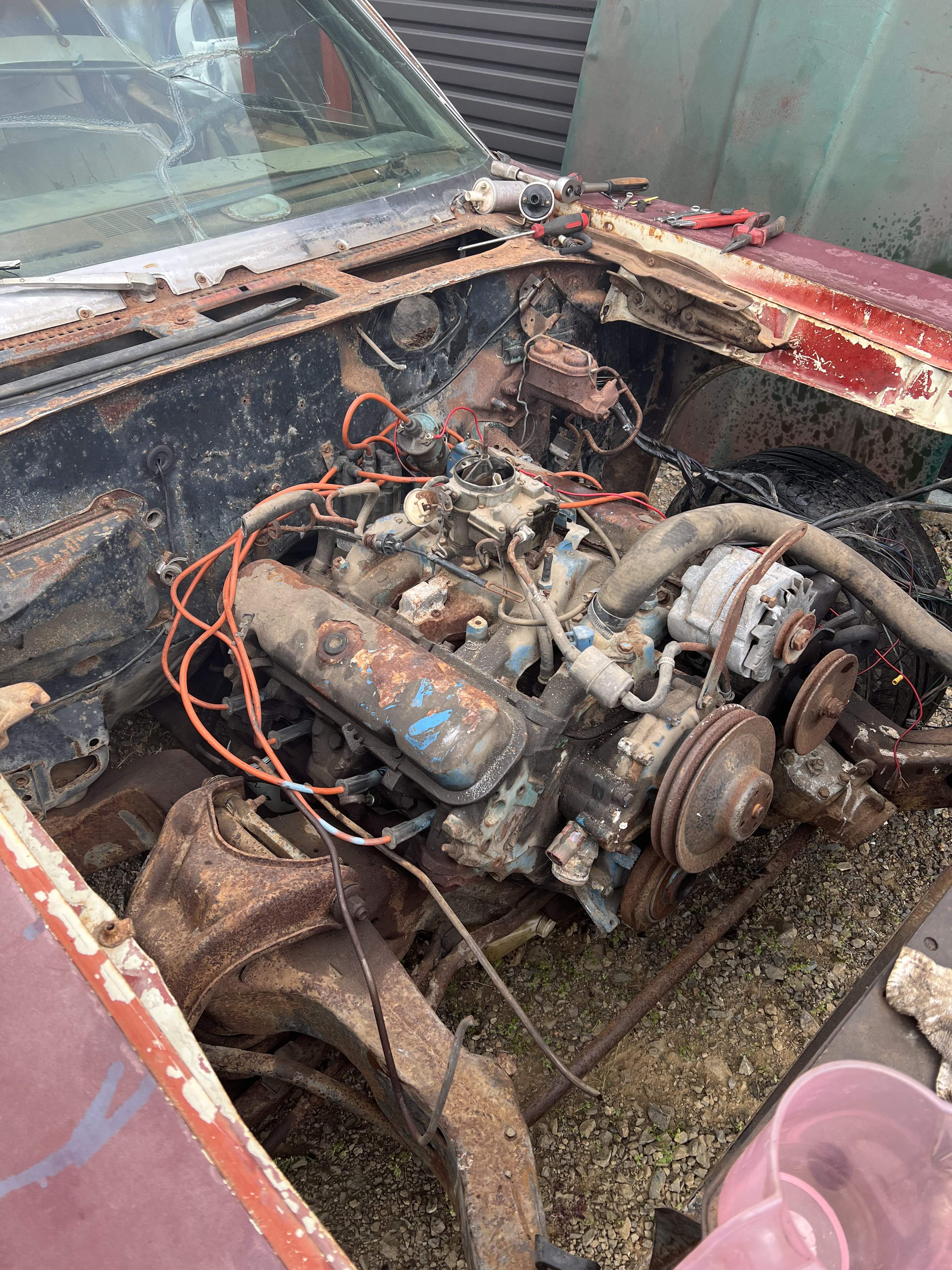

i had a play with the motor today ..... it was missing lots of parts,,, starter motor for one !
in the boot was a ponti starter snout so i grabed a chevy starter motor out of my parts department , riped it apart, stuck the ponti snout on it , bolted in and it worked !!! shock horror ! gota love delco remy !!!
any who , next was a set of points ... ( had a brand new set on my office desk for the 64 ) a cap and leads... plugs.... fresh oil and filter ..... and a quick bit of wiring and a coil .... pffft i need a beer just talking about all the parts i needed to get this 350 to go bang !!!
And it went bang on all 8 cylinders !! i was impressed considering the mud that ozzzzed out of the sump !!!
next will be to add a fuel supply, a radiator ( i have a 69 camaro cross flow that will fit perfectly )
and bolt in the drive shaft, loop the heater hoses, loop the trans cooler lines and see if i can make it move !!!
if i can get to that stage i can drive it into the hoist and see whats what under side
 i am not keen on this 350 , i would really fancy a 400 and go the butler stoker kit path !!

The 350 is a fine engine. It suffers from a lack of some key aftermarket support, like rods and pistons. It sorta became the red headed step child of the Pontiac V8 family, after the 301 and 265. The availability of 389+ cubic inch engines and parts made the 350 the least popular, even though it was one of the most installed engines.
Since we all ready know this is not a numbers matching engine, is another 400 or better readily available?
You could bore and stroke it. I will defer to Two Lane on what you can do and can’t do with a 350 block, and any other considerations he might have.
Frosty, it would be good if the 350 block can be bored !
Kiwi...
The Pontiac 350 engine...3.875 (3 7/8 inch) Bore × 3.750 (3 3/4 inch) Stroke...For a total of 354 CID...Even if bored .060 over...It Will only yield 365 CID..(3.935 bore × 3.750 stroke)...The small bore...Long stroke...Will Not like High RPMs...Anything Over 5000/5500 RPMs...Will Create Hyper Piston speeds and the engine will more than likely Not survive for any extended period of time at higher RPMs...
The 350 Pontiac is designed as an Economical low compression engine...With flat top Pistons with a divet in the center of them...The size of the divet that is in the center of the pistons is How Pontiac controlled the Compression Ratio..The larger the divet...The Lower the compression...The Smaller the divet...The Higher the Compression ratio...That is the main difference between Standard 350 and the Higher compression 350 (HO) engine...
Installing larger valve cylinder heads on a Small bore..Pontiac 350 engine creates its own set of unique issues...Such as Flame shrouding...Causing inefficient Combustion in the Cylinders...Leading to a power loss...The larger valves will also slow down the velocity (airspeed) of the air flowing into the cylinders...And will Not fill the cylinders nearly as Completely/efficiently as it should...Again it is a significant power loss...The larger valve Cylinder heads will also cause clearance issues with the small cylinder bores..Pontiac 400/455s.. have significantly larger 4+ inch bores...As the top of the cylinders in the 350 Pontiac engine block would probably have to have a radius cut in them to have enough clearance for the for the valves..( Think 409 CID. Chevrolet engine)...The Pontiac 350 is a good reliable engine that can make lots of Low end torque...But for a serious performance Build (The kind that sends Children/Greenies running to hide behind their Mamas Skirts when you drive by) A 400/455 engine is really the only way to go...
Justa my two cents...
TLBT...
PS..I will try to accurately answer any other Questions that you may have...

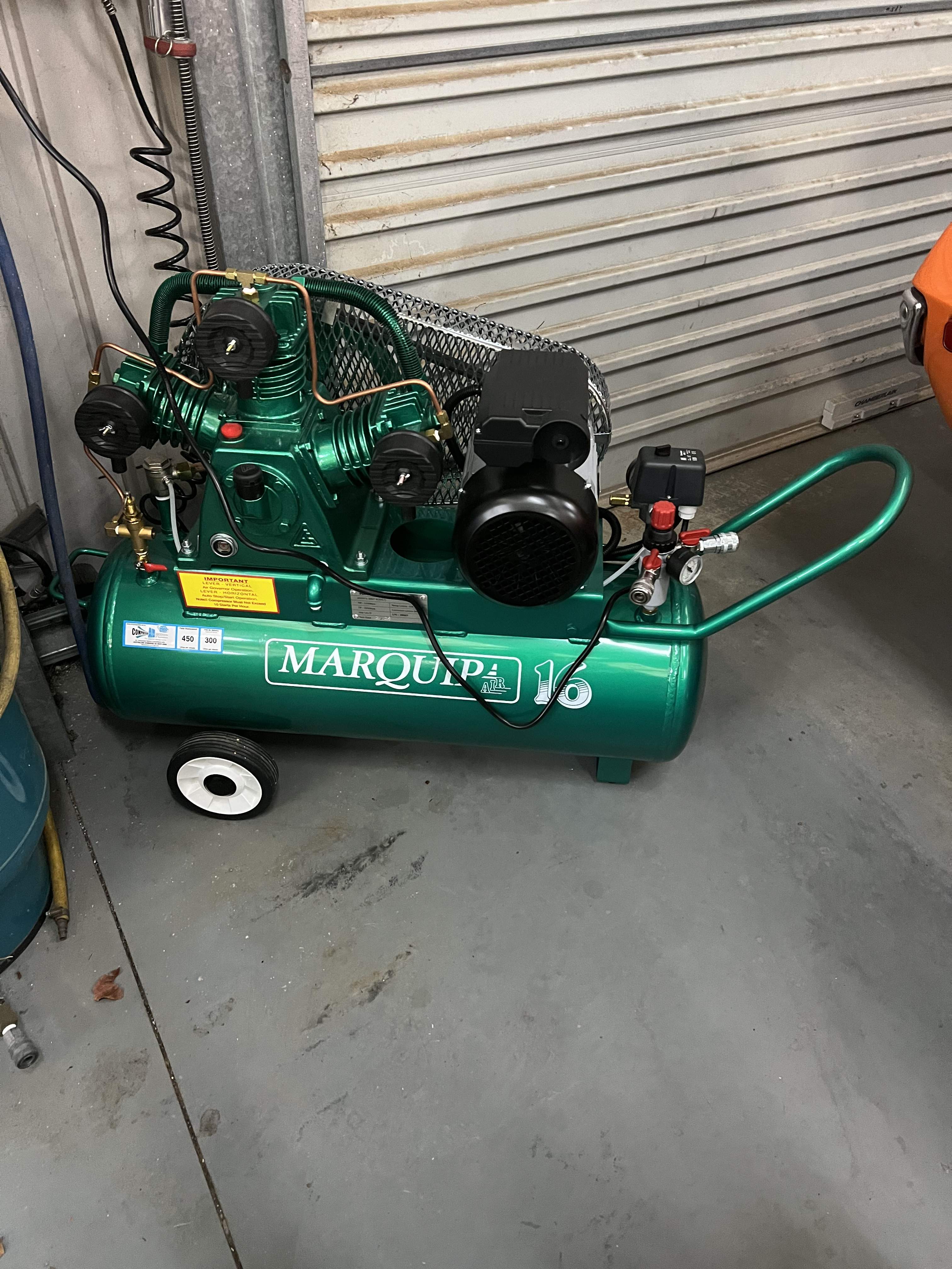

Nice shop bling..that's purdy.
It is justA !!! Kinda like the green along with polished copper tubes !!! And it does 16 cfm ! Which will keep up with my da sander  and my sand blasting kit

Men are funny. A new compressor and everybody goes gooey. Mind you, it's a good looking unit. I'm only jelly because my Ying Tong toy compressor is about half that size but keeps working.
your sounding like my wife mate ! slap yourself and go grab a beer
You do know that a man must have good tools if he is to acheive his goals :rofl:
