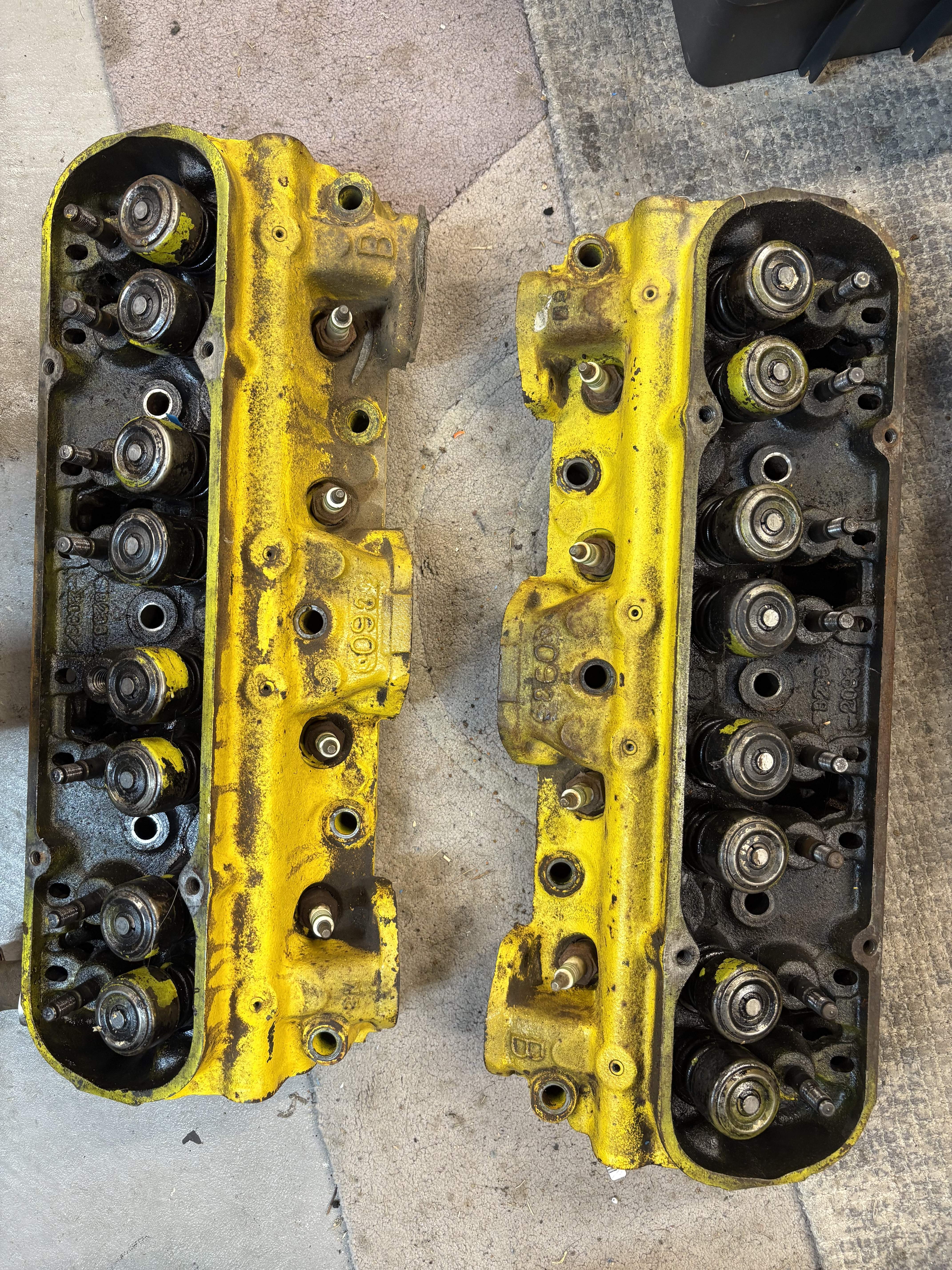

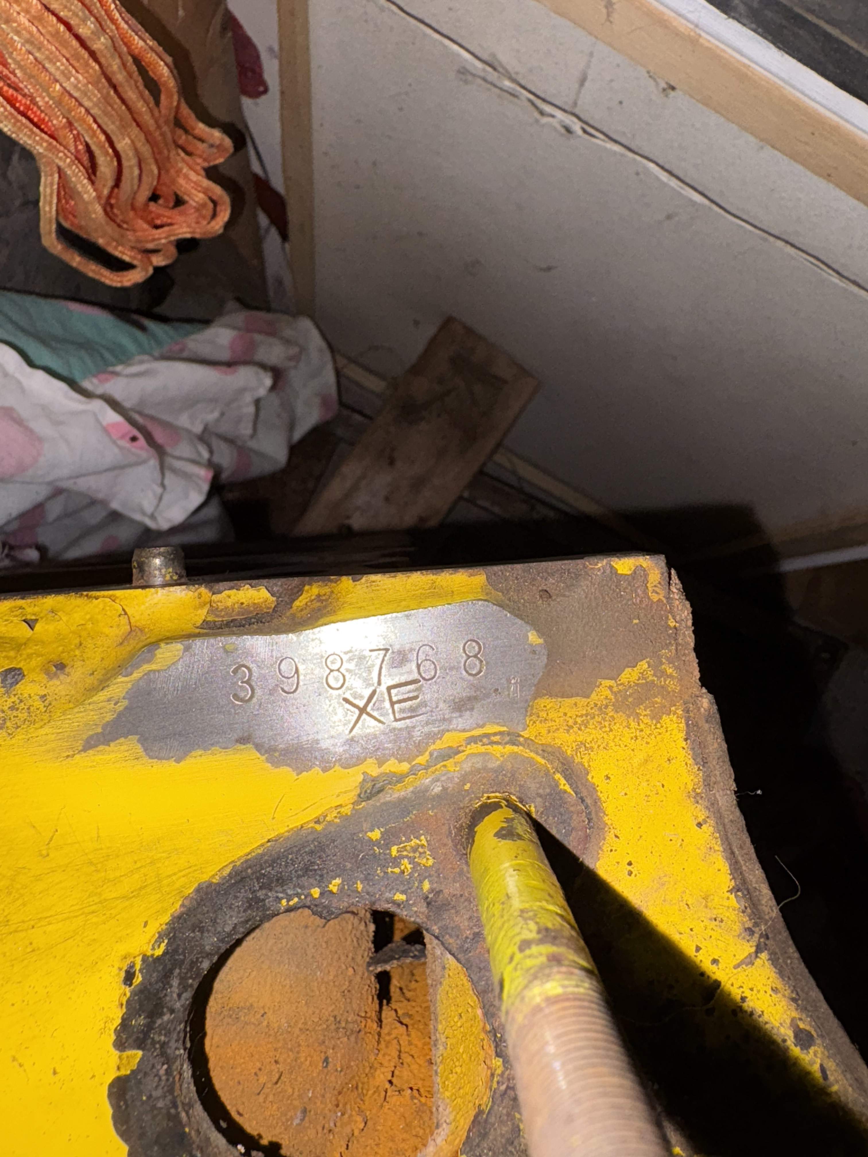

as a guy does … I scored a edelbrock dual  plane of the net … and I get talking to this guy from my old home town of Feilding… he’s got a 66 gto engine in bits for sale ….
a 389 xe block ….
with its factory heads ….
093 closed chamber 68 cc with 1.9 and 1.6
is it worth considering ?
Well those heads were used on both the 389 and 421 in 1966. So the 389 was rated at 360 HP and the 421 was rated at 376 HP. Compression was 10.5:1 for the 389 and 10.75:1 for the 421. SO these are decent heads. Perhaps you will punch that 389 out to a 421 or 428?
Also think about how cool it would be to say you have a 421/428 in your Lemans? You could also follow Justa's example and run tri-power on it too.
the guy wants 900 notes for the block, heads n crank. which i thought was fair considering they will need to be fully rebuilt/ bored.
I would agree with you on that mate! It sounds like a fair price to me.

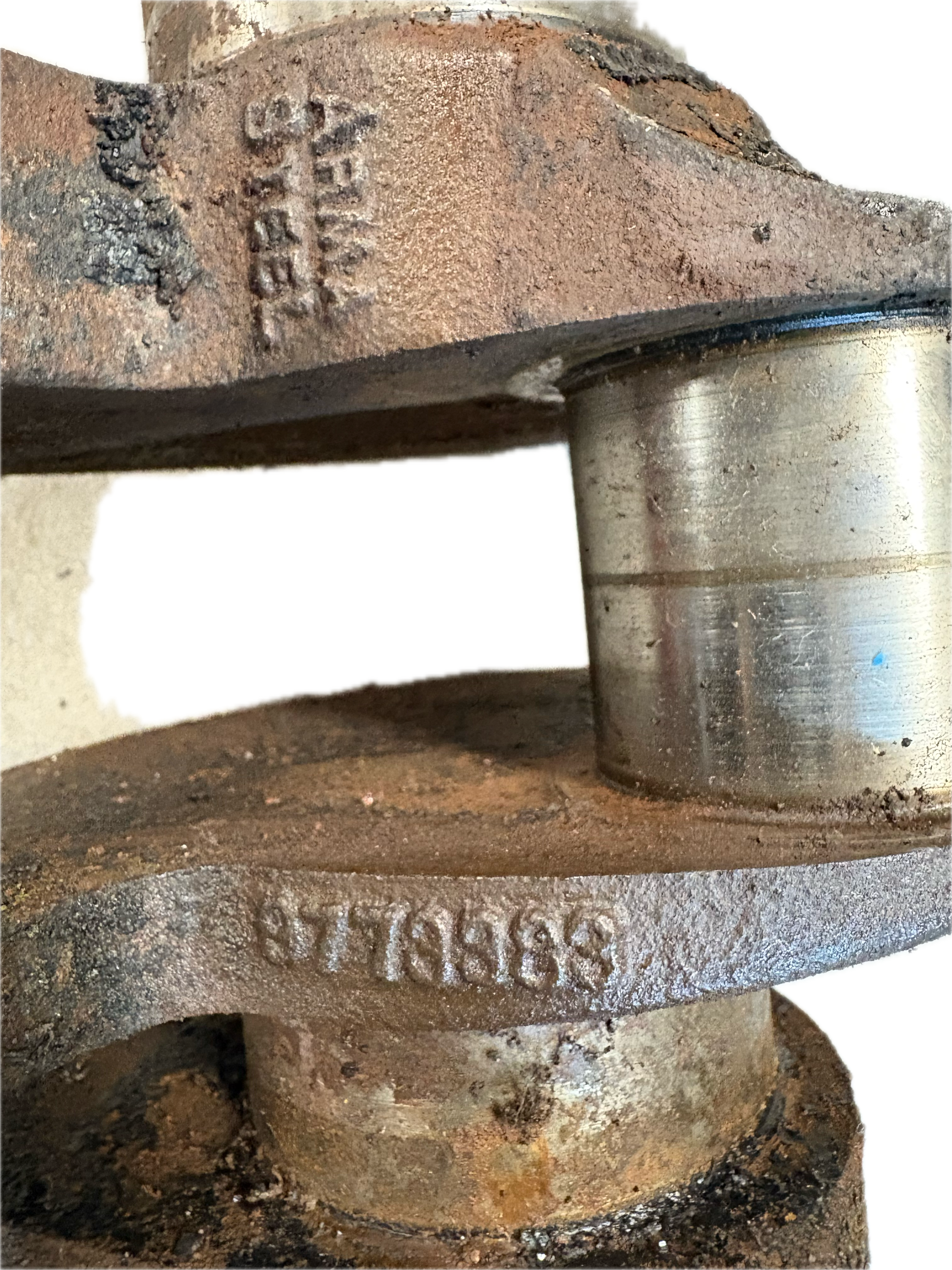

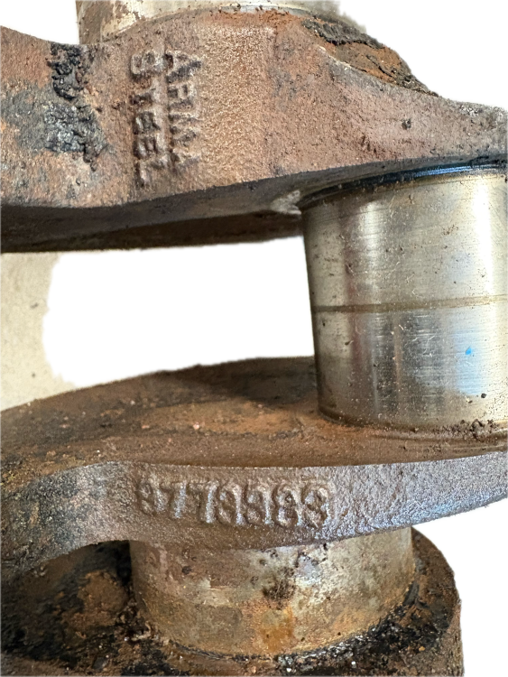

Lookin at the crank, it needs to be cut down, ALOT, as twolane questioned, has it been turned down before?  Magnaflux would be my next move on the heads at least.  What does the cylinders look like?  Any ridge at the top?

1 block is standard and requires boring to 40 thou
2 stock untouched heads
3 he has offered to give me my money back if any of it is cracked and cant be used.... which is kind of him
4 he cliams the motor is un touched, but doesnt know its history, he bought it complete with a 400 trans ... which is also for sale.... he wants $800 for it

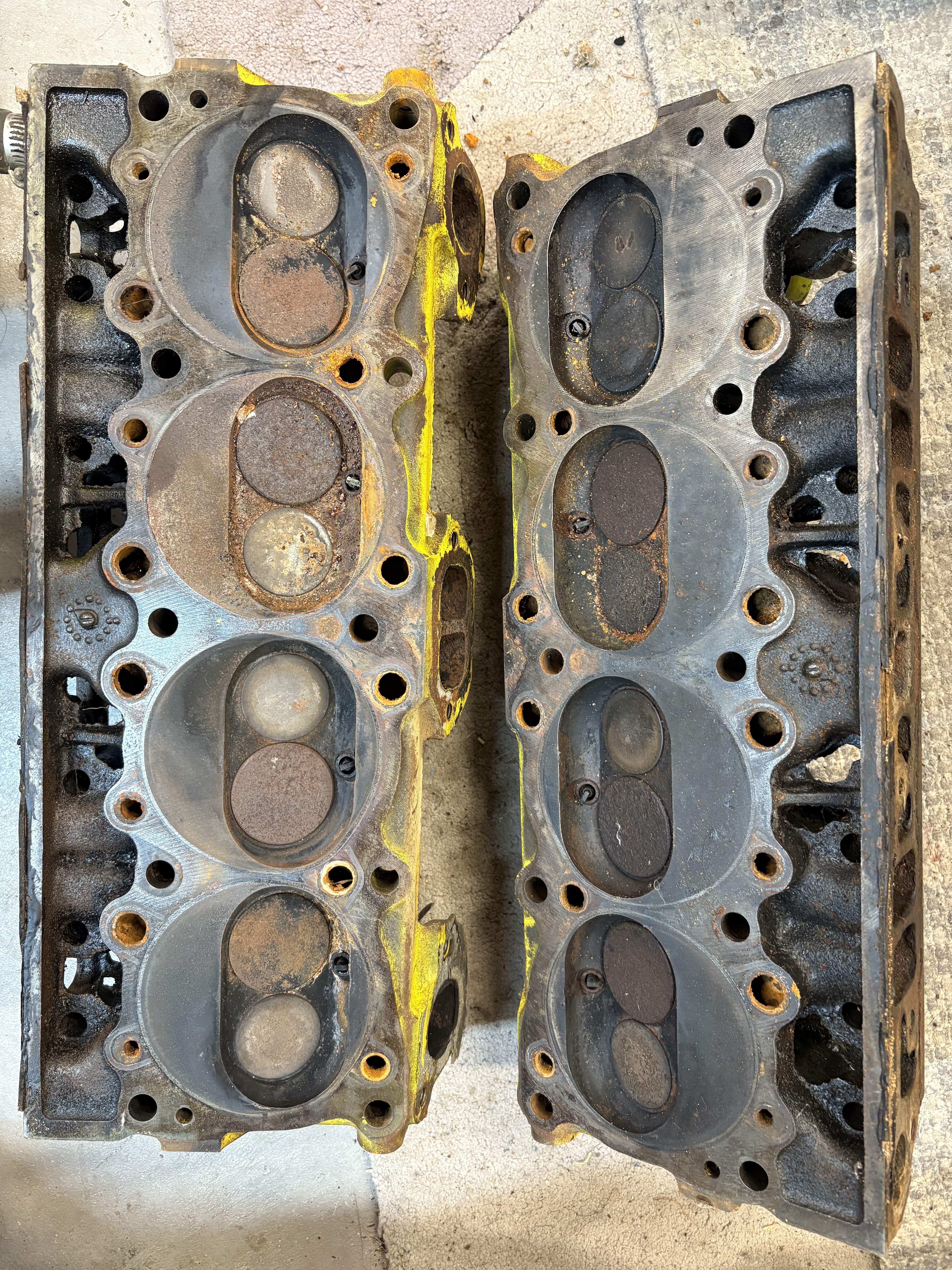

a pair of 4x 3H heads  popped up today for $250 nzd ... so what did i do :rofl:
A man can never have enough heads
Up to you but you might want to grab them.
4X 3H heads were on 73-74 400s, 2.11/1.96 intake/exhaust valves, 98.21 cc chambers.

i have mate :cheers:
i note they have screw in studs too !
