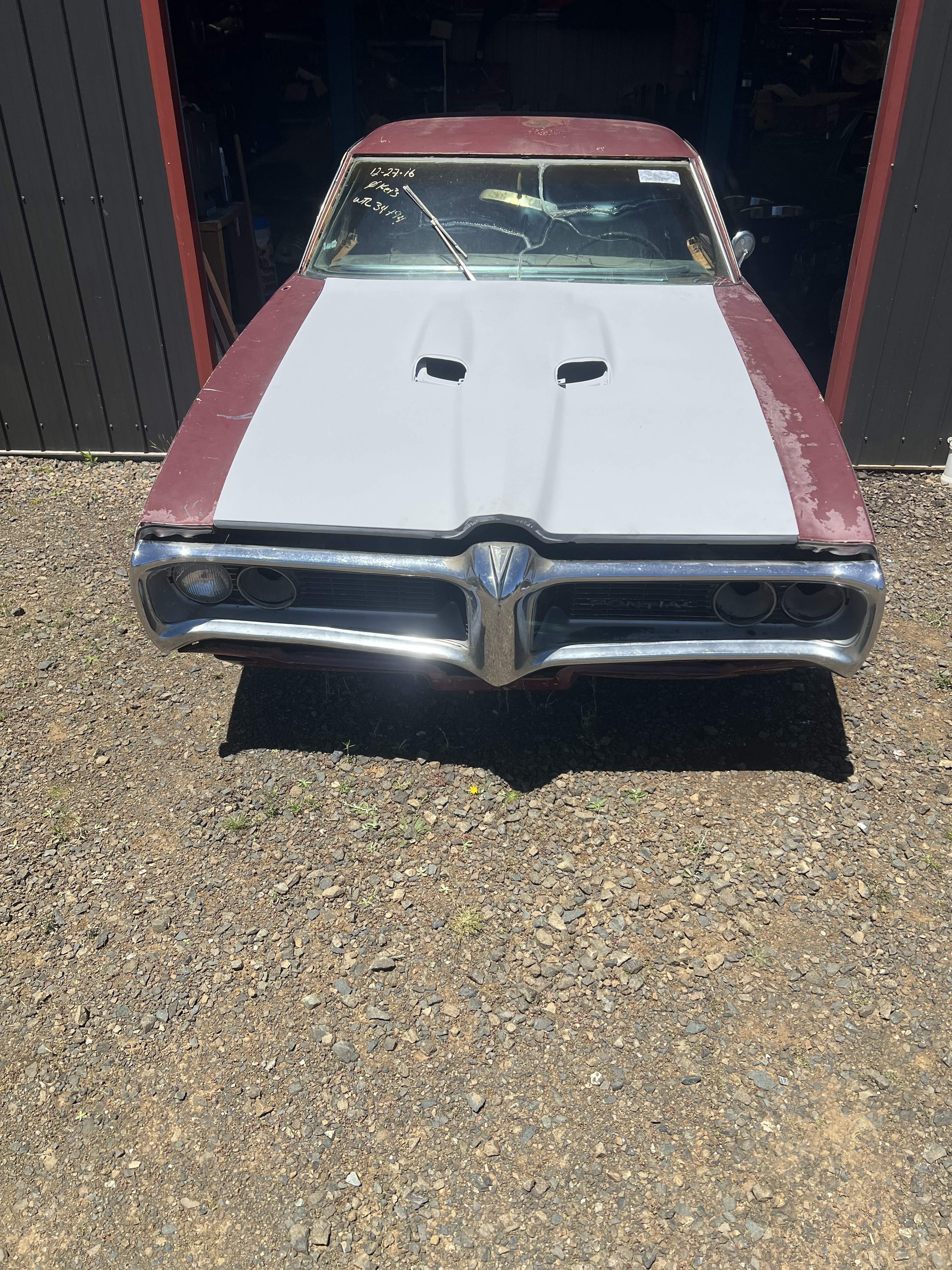

And it’s.Sunday !!! I managed to get 4 hours on the 68 !!!

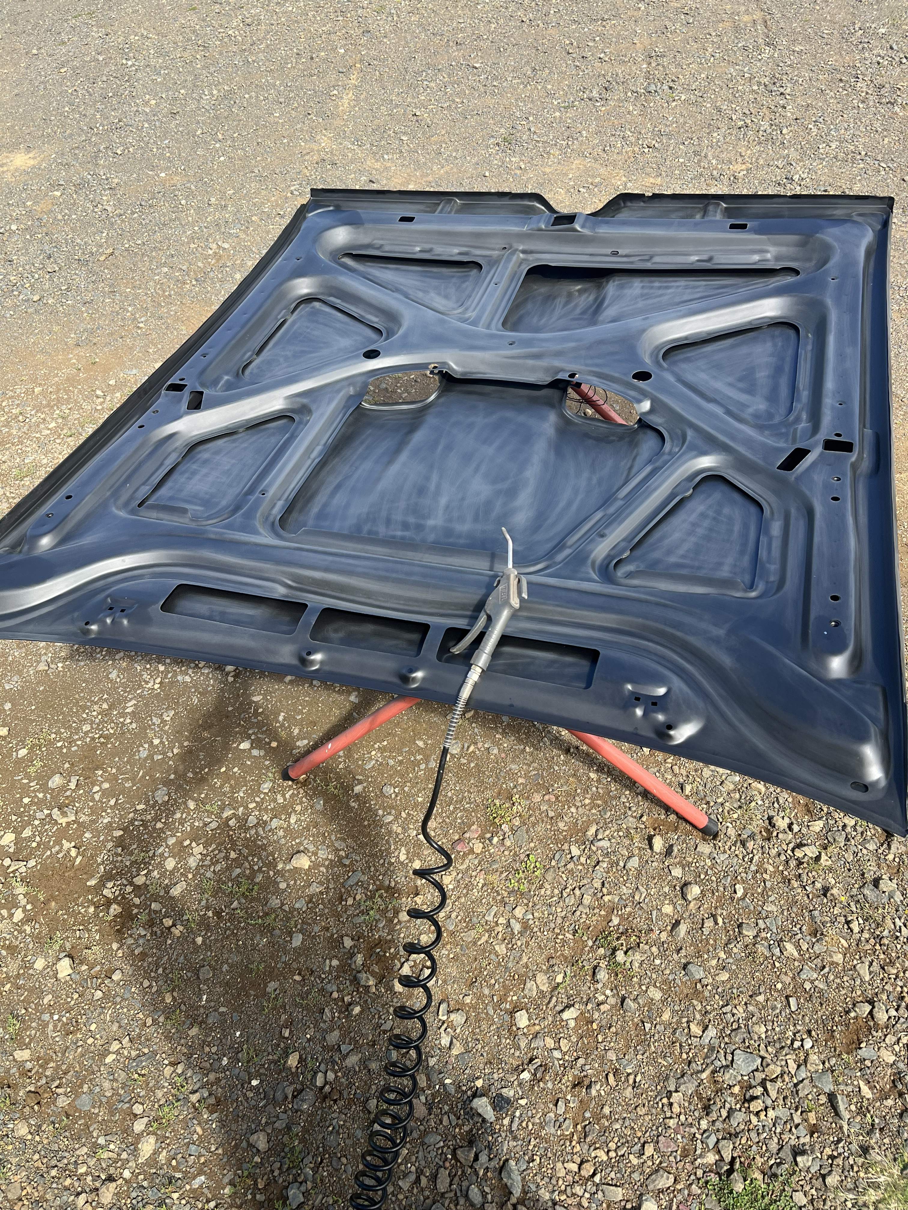

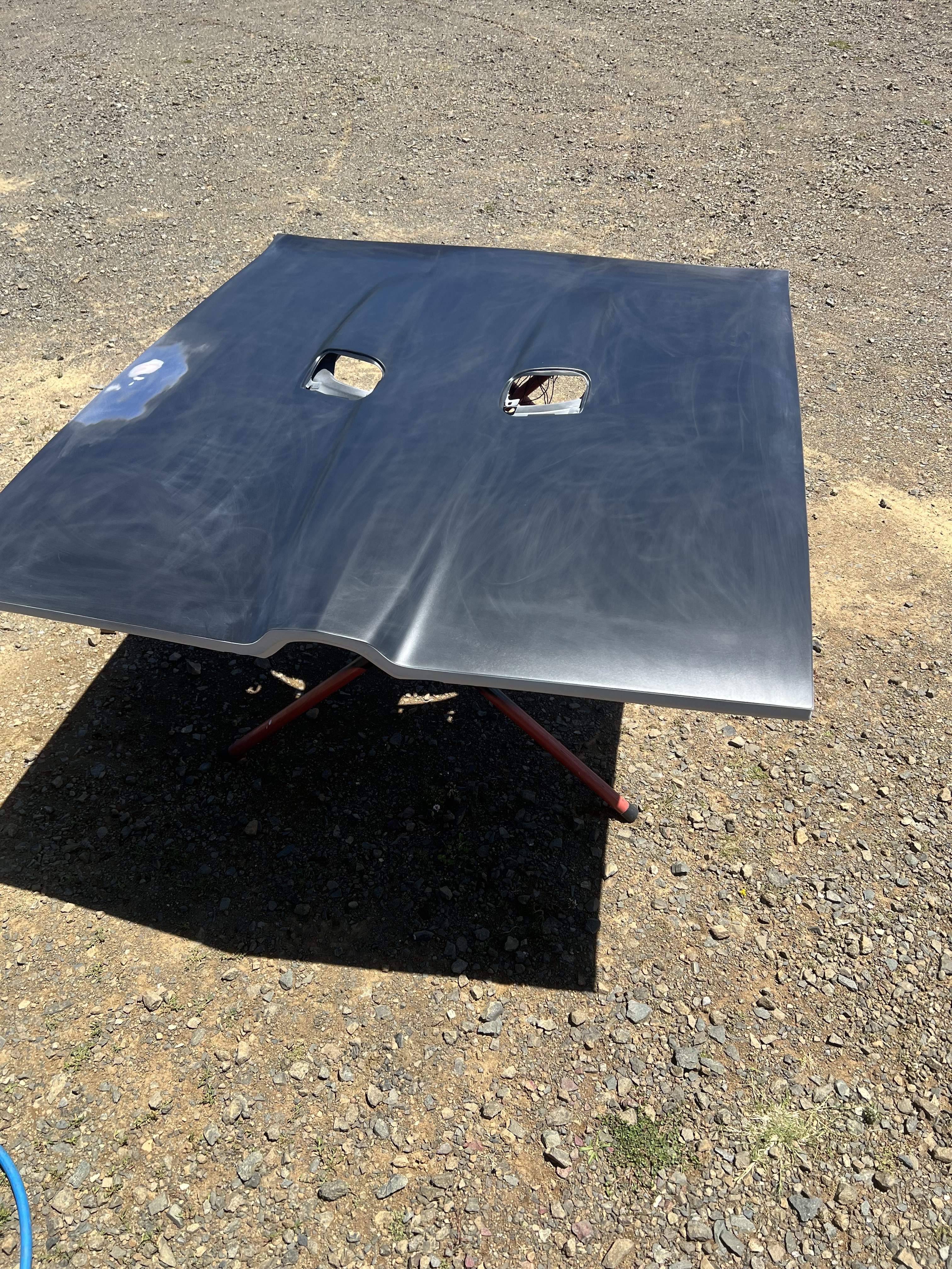

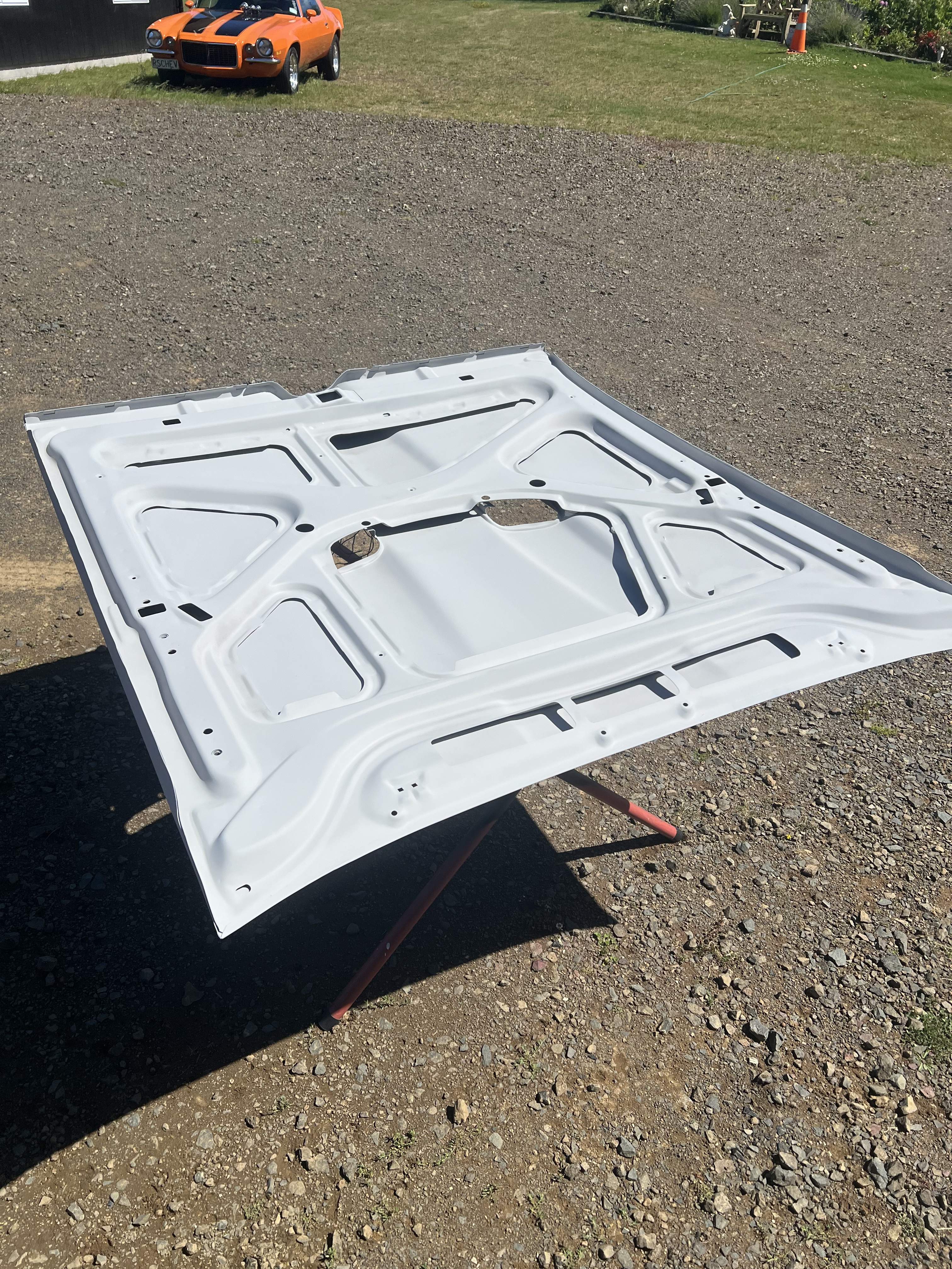

So I prepped and primed the bonnet

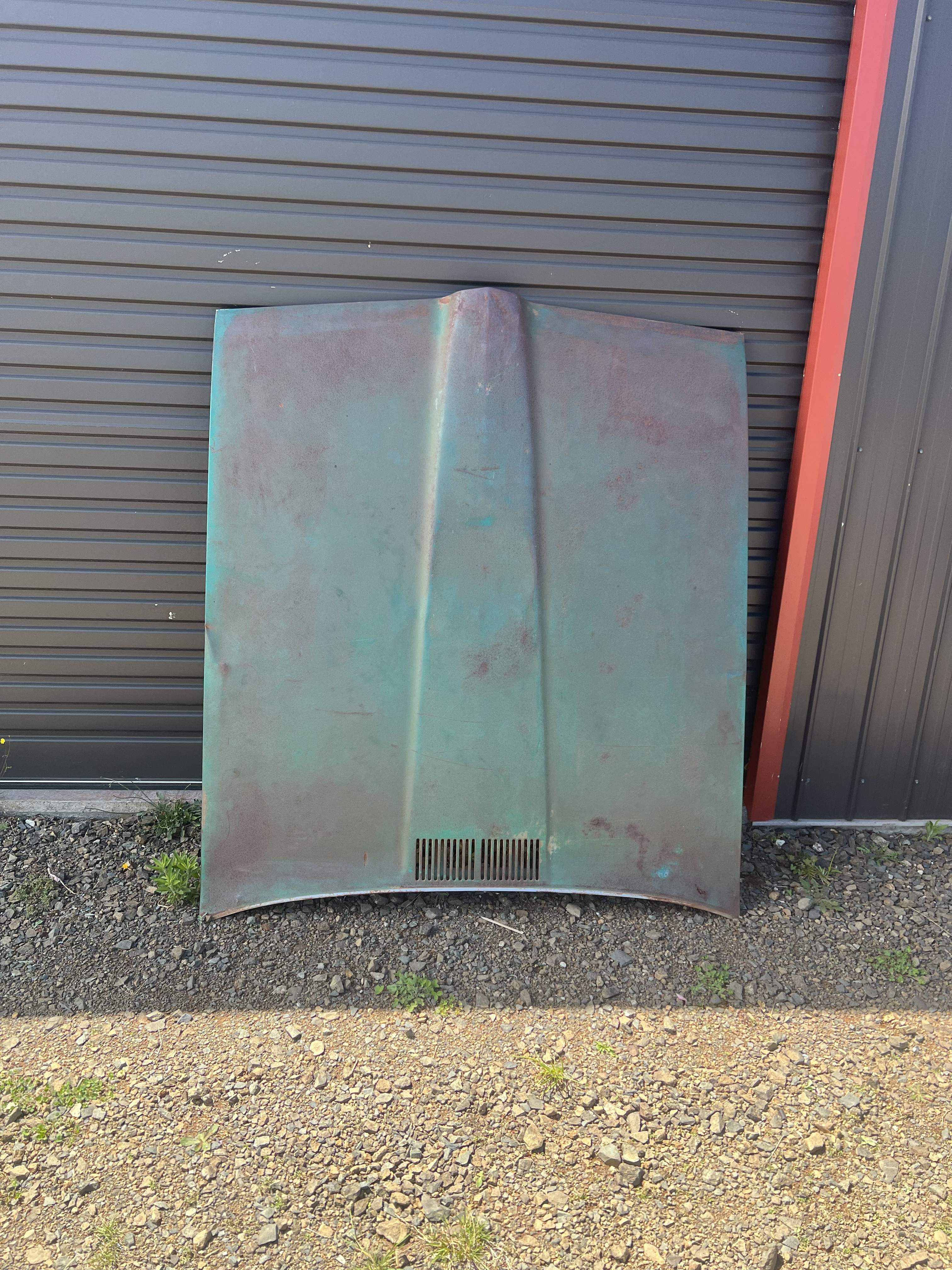

One lady owner lemans bonnet, rusty bent , perfect garden art !!!
I justA don’t have the heart to biff it to scrap !!!!
