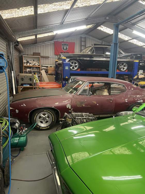

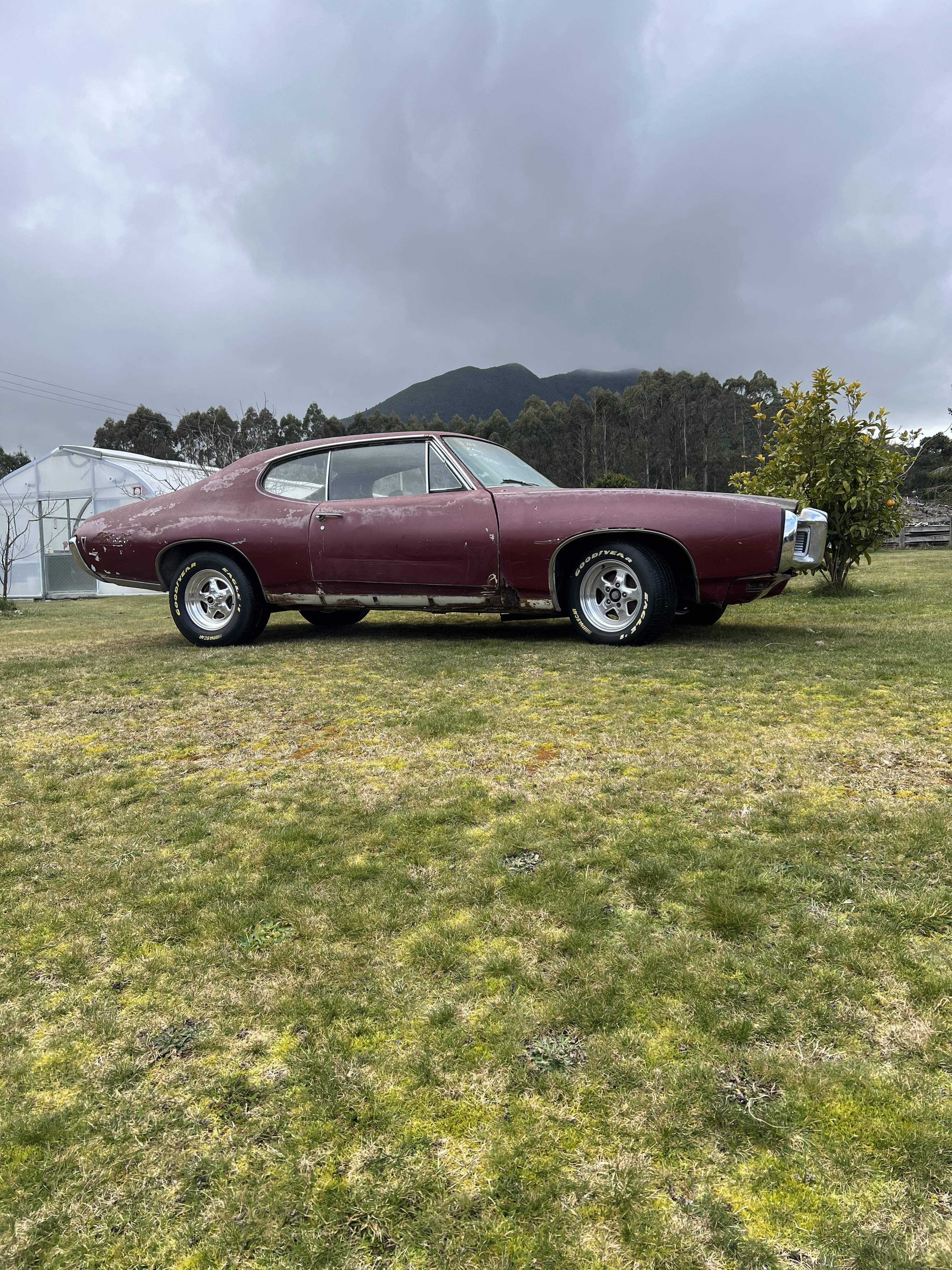

took the 68 for a spin today.... i had to move it to get the caddy out !
Damn I like the way show looks bro

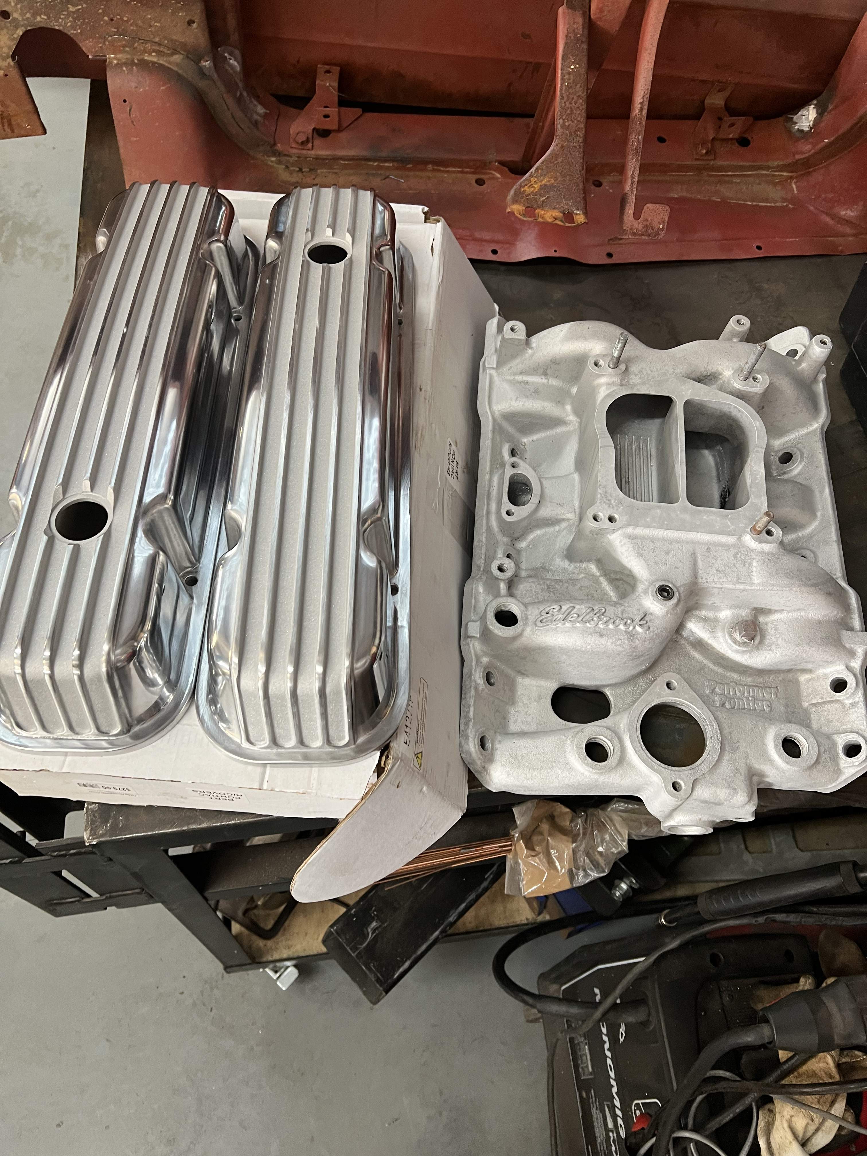

Today’s scores !!!!

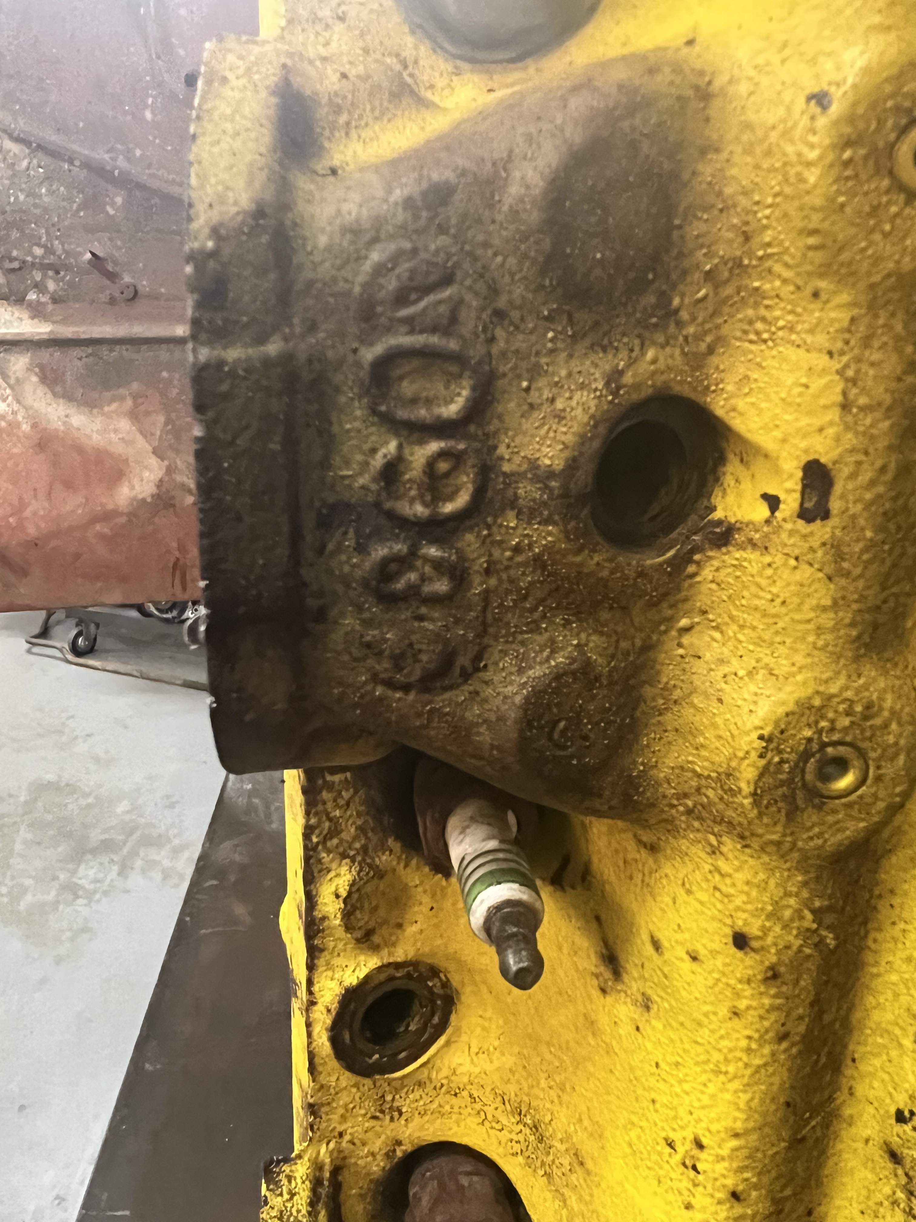

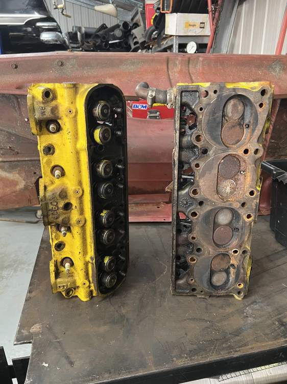

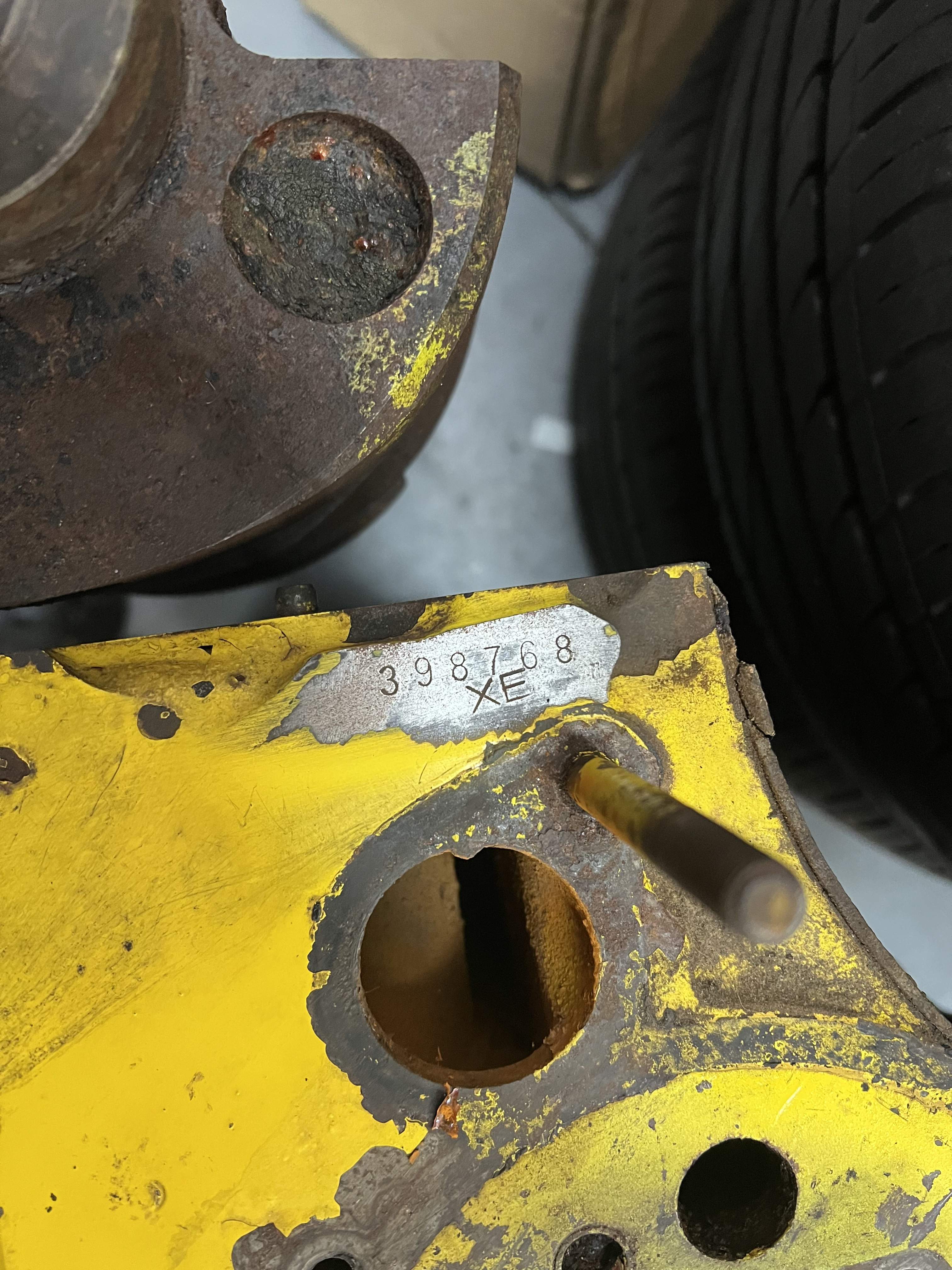

i found this performer manifold for sale and then the very nice guy had a few more parts i fancied dancingpontiac

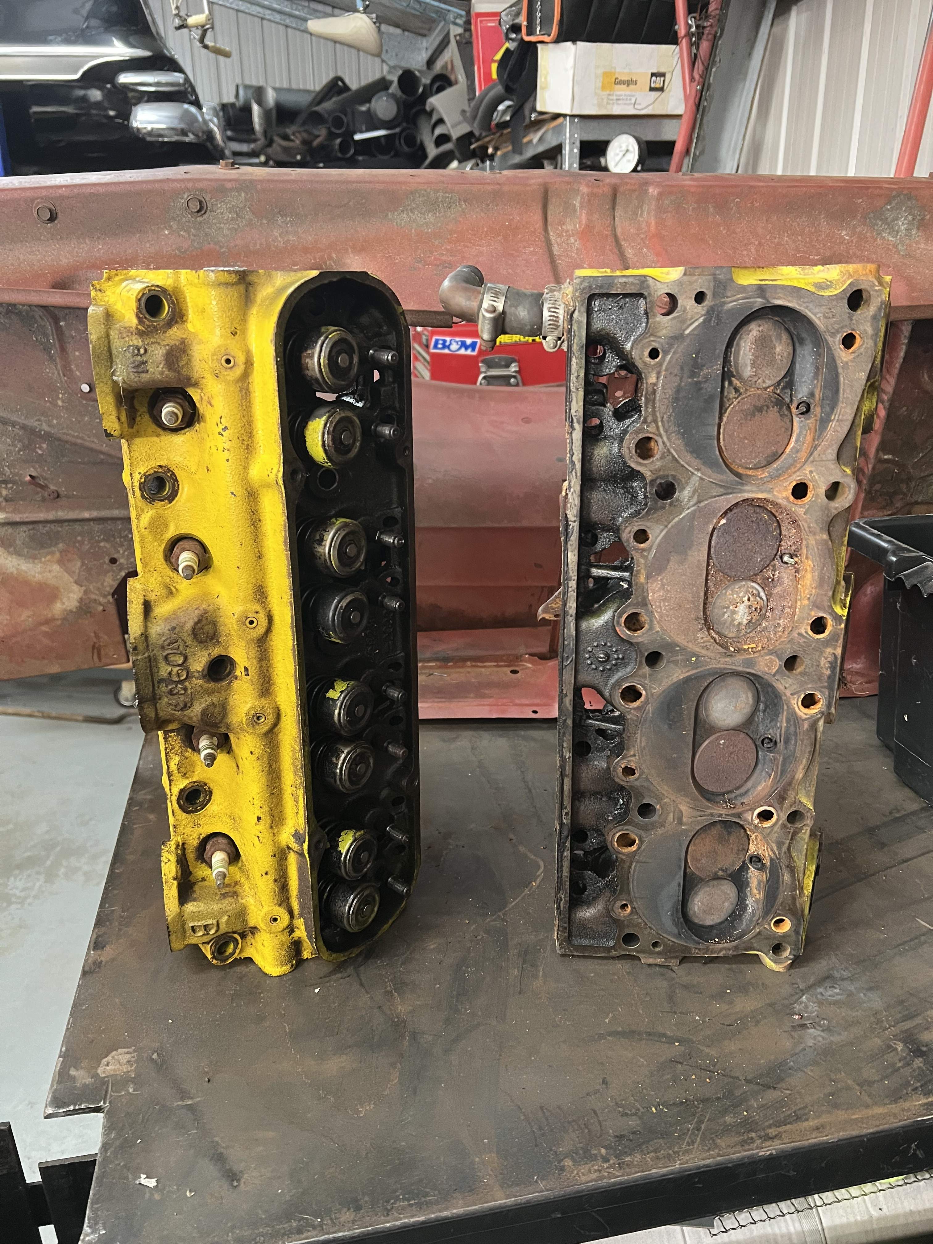

the heads are
"093" which correct me if i am wrongway are 1966 68cc closed chamber

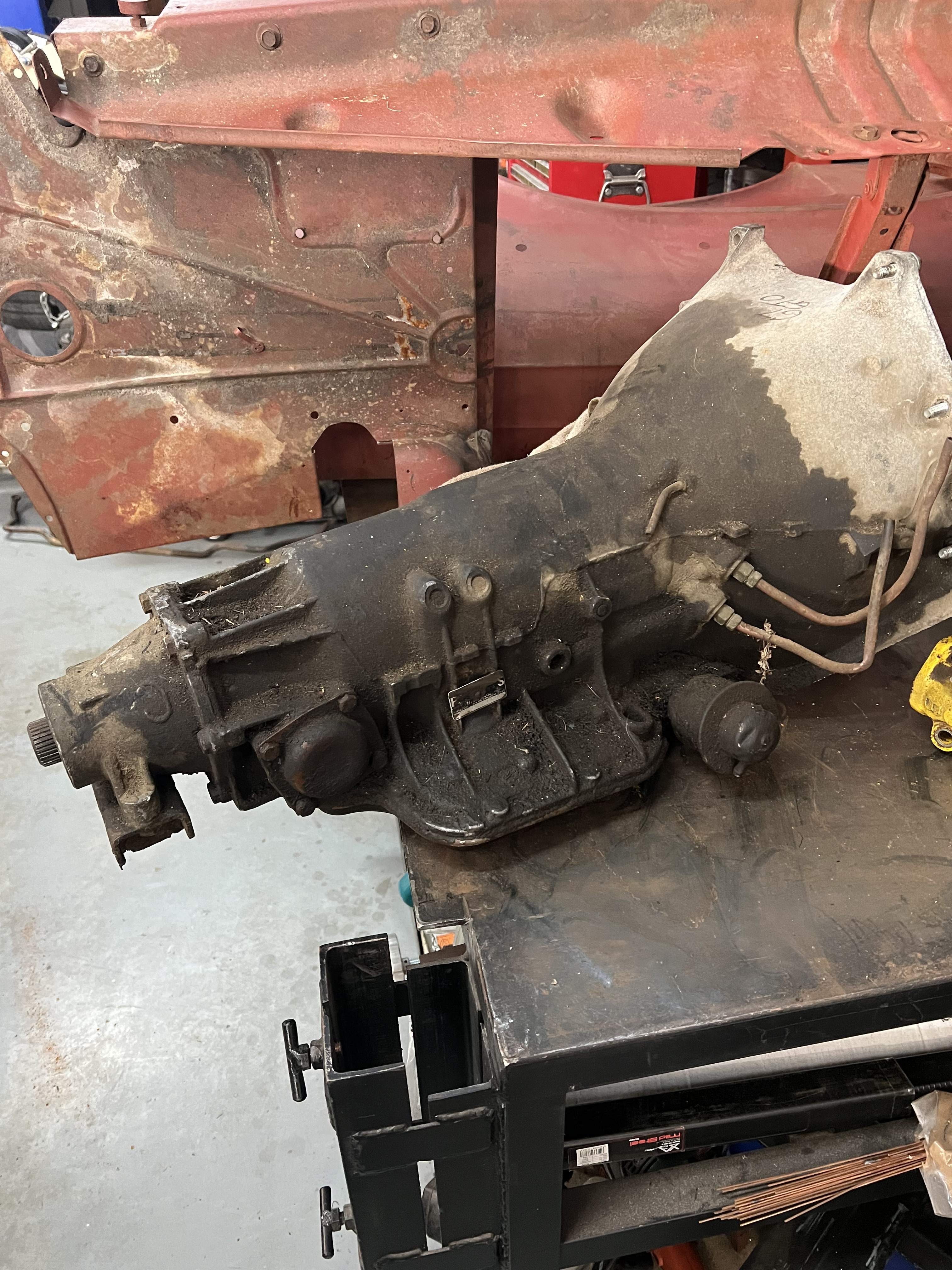

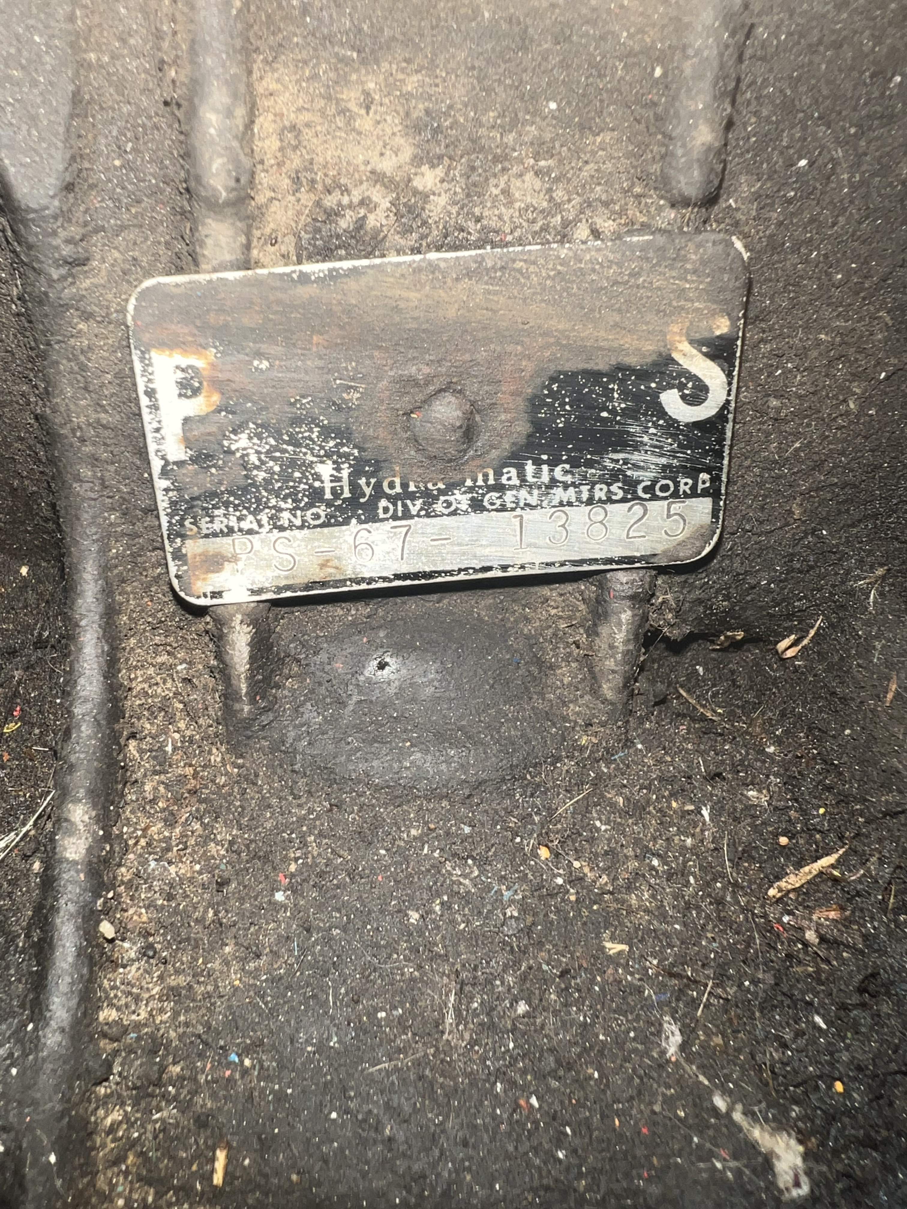

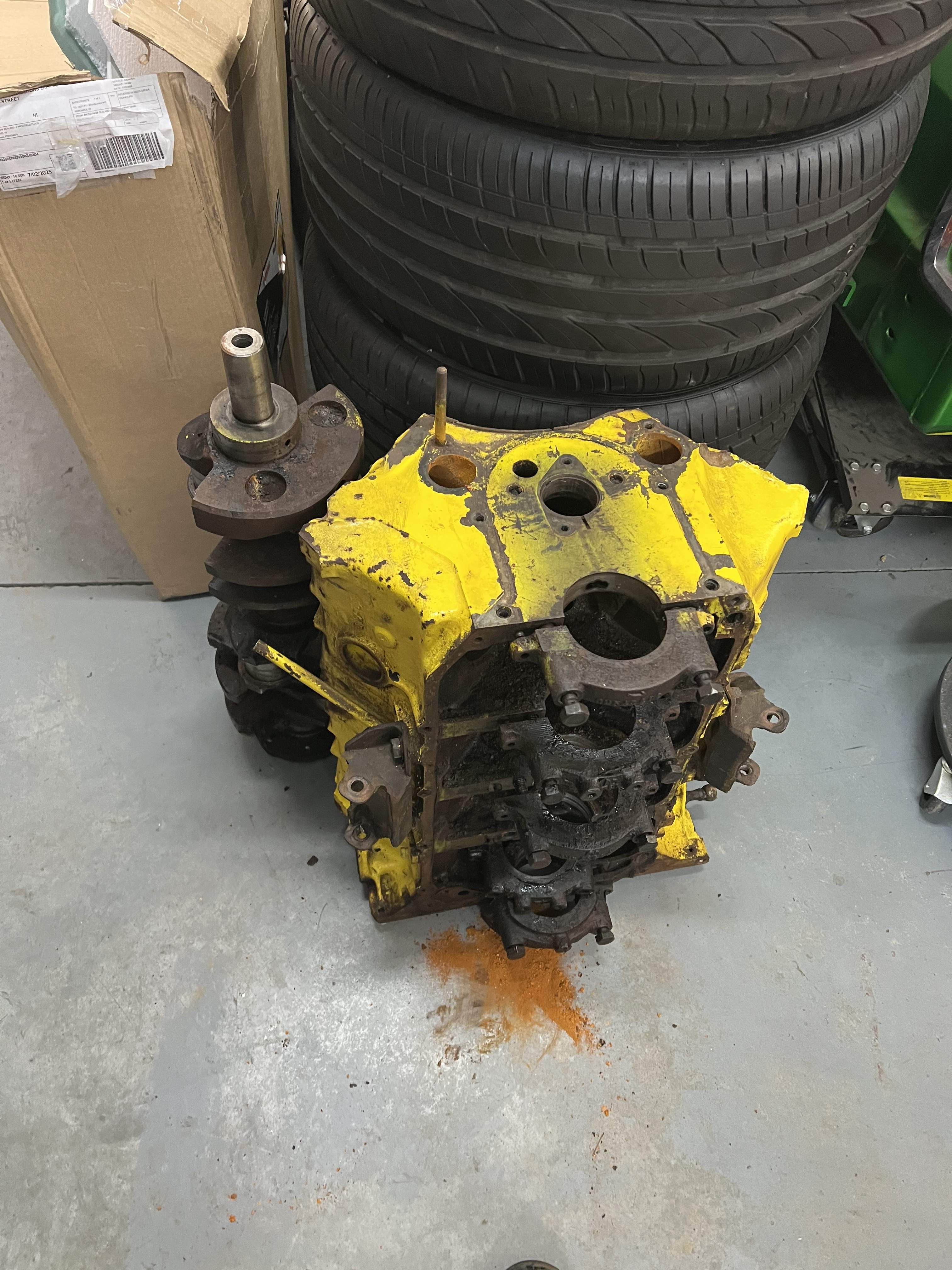

and the heads came with this "xe" block which looks to be a 1966 389- 339hp out of a A body, which had a power glide behind it ... i am thinking it was in a gto !
the trans came with it and it looks to be a turbo 400 of the 1967 year

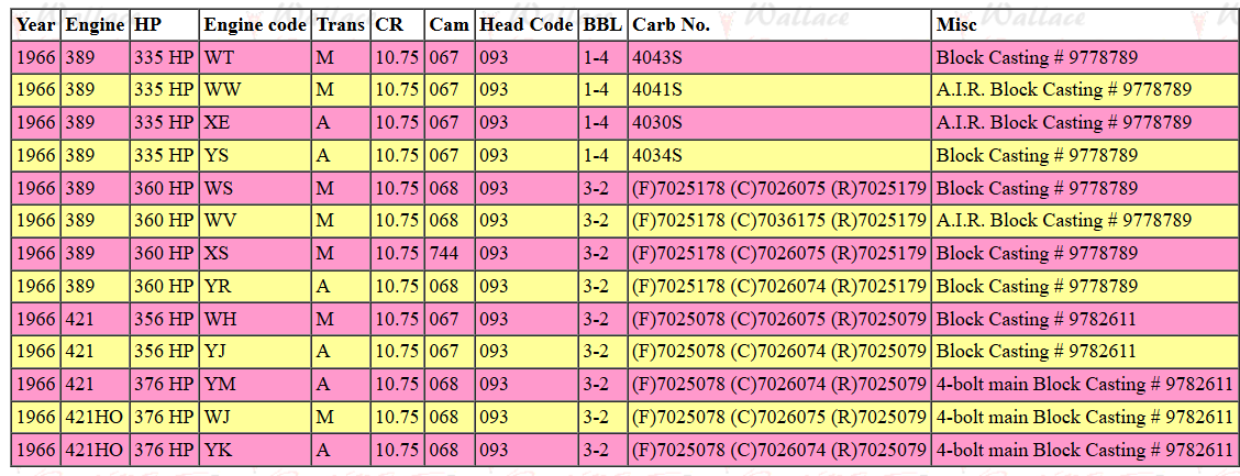

Here you go Kiwi - info on the use of the 093 head.
Today’s scores !!!!
the heads are
Good deal.
Speaking from my own experiences,make sure you cc those heads if you are going to use them so you don't end up with a compression you don't want. I found out when looking for my heads a lot of lists with head # aren't correct and heads may have been cut.
thanks Frosty cheers great info !!! i see line 3 is what i have, justa have to check that casting number ... but 10.75;1 wow !!! thats interesting !!
4 hours ago, Andy H said:
Good deal.
Yes Andy i found when i cc'd the other heads i bought, that they didnt match up to the list cc capacity,,, i will certianly cc these heads too

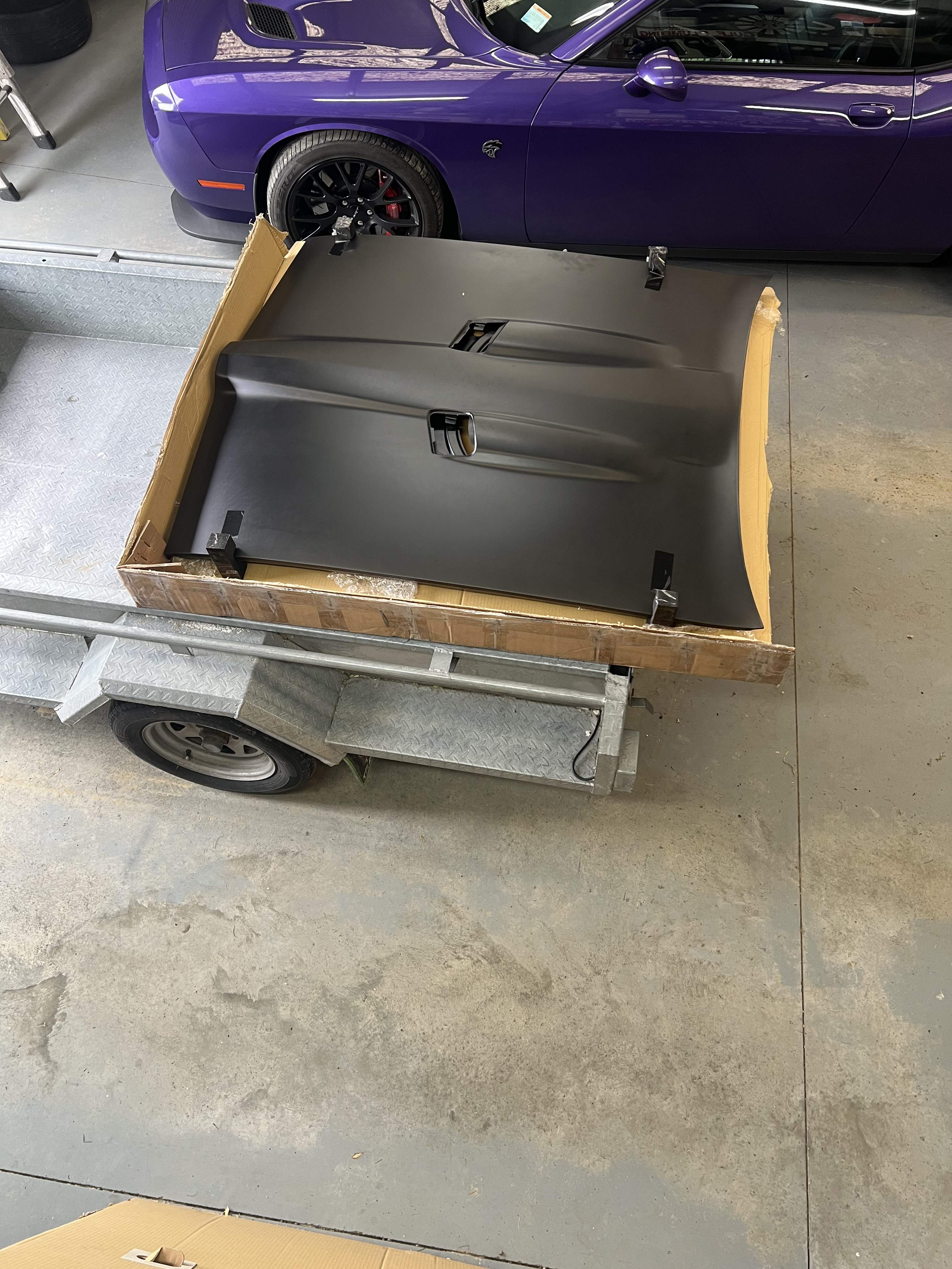

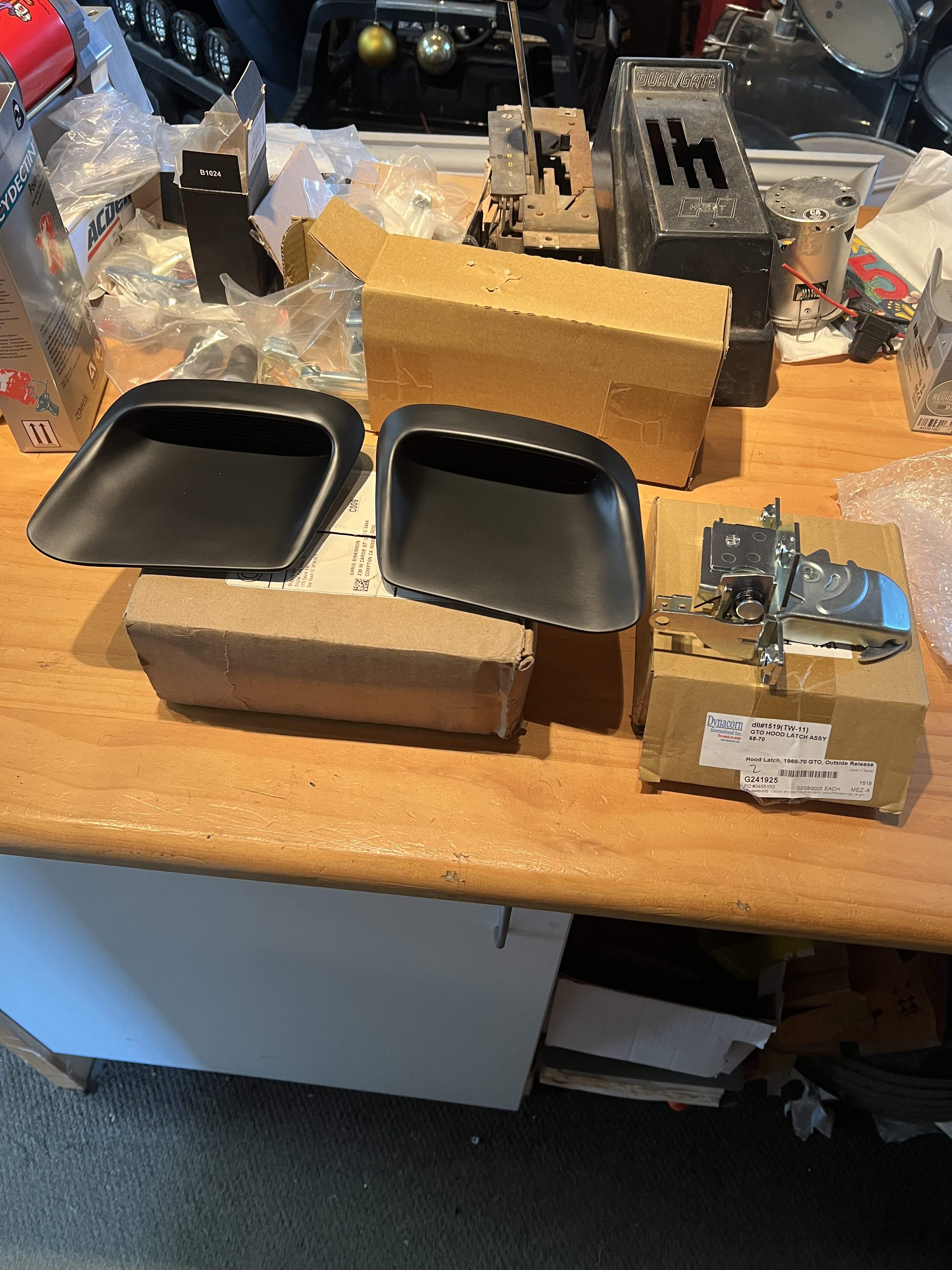

News flash !!! A little birdy tells me my gto hood is in nz !!!! the same one that i ordered back in january !!!!!... watch this space !!! driving
That little bird is telling me the hoods in Taupo !!!! .... guess what my first job is today !!!!! stuff work !!! hahaha !!
I am glad you have your priorities straight Kiwi!
It’s here !!!!! Woop woop

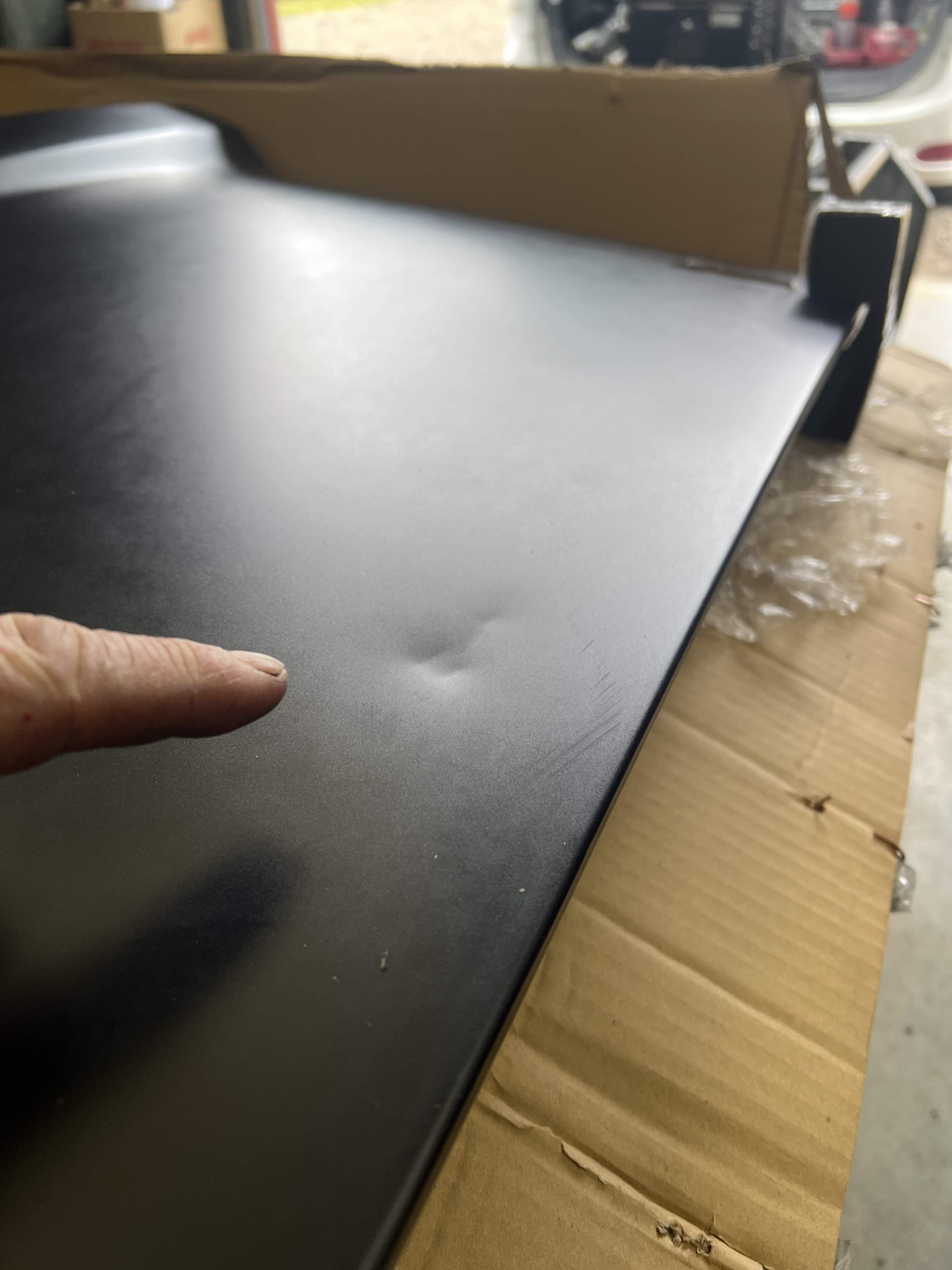

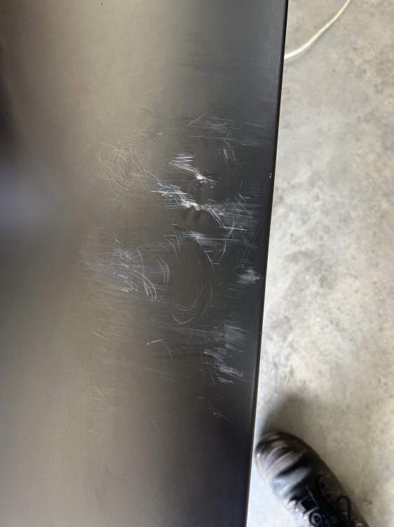

And even added extras !!!!! Like this dent !!!! 🤬🤬🤬
But that’s all !!! And a easy fix
Kiwi shipping had tucked my latch and inserts in the box too …
So with only 2 days left of holidays … it’s my time !!!!!!

No wife … oops ok , wife yes … but you get my point !!!… I sooo wanted to get something done on the 68 !!!! So today I hit the bonnet that arrived with a small dent ,,,, this thing had cost me way more than it should !!! I paid opg $390 usd … by the time I got it here in Taupo nz … I had no change out of $2700 nzd !!!! No joke !!!
Am I pisted !!!! Yeah ! I won’t be doing that again . Opg wacked me with over $300 usd justA to ship it to ca to kiwi shipping yard , Matt did a great job of shipping even though it took 8 months !!!!
Then I got wacked with tax , and a whole bunch of bs fees . And then more shipping to get it from Wellington to Taupo …. What a saga !!!

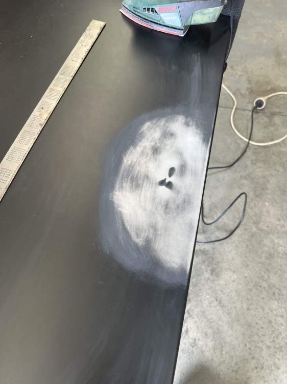

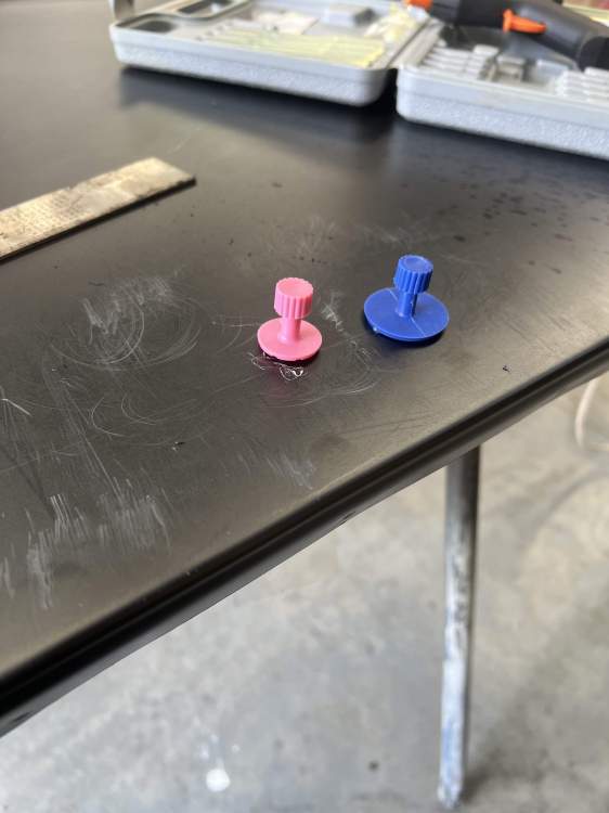

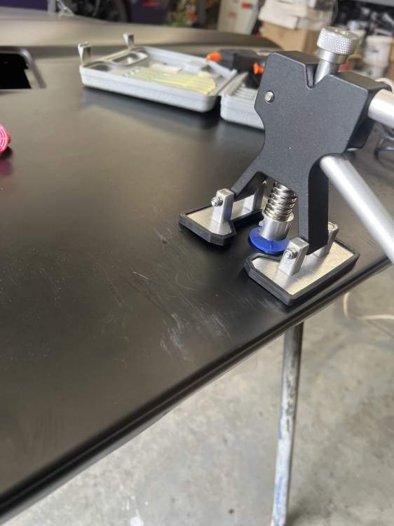

Any who !!!! It’s here with a dent and today I fixed it !
I bought myself a glue on dent puller and it actually worked !!!!

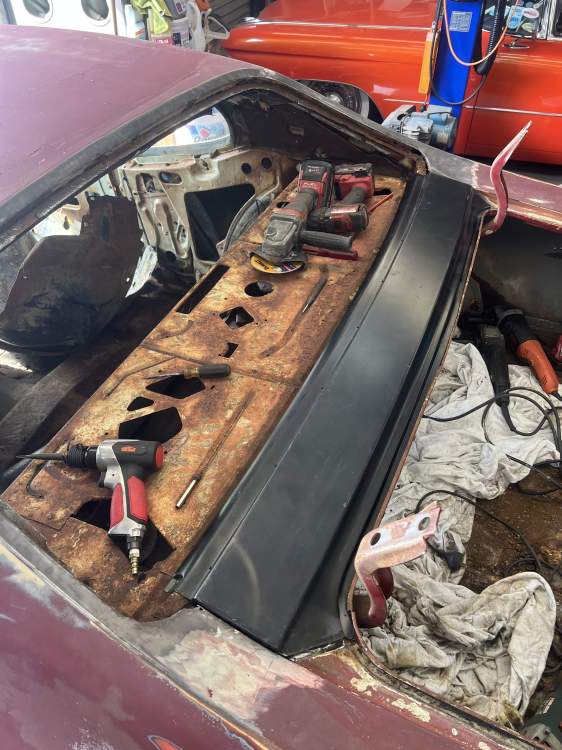

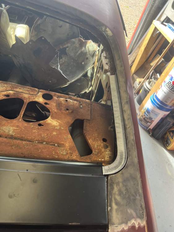

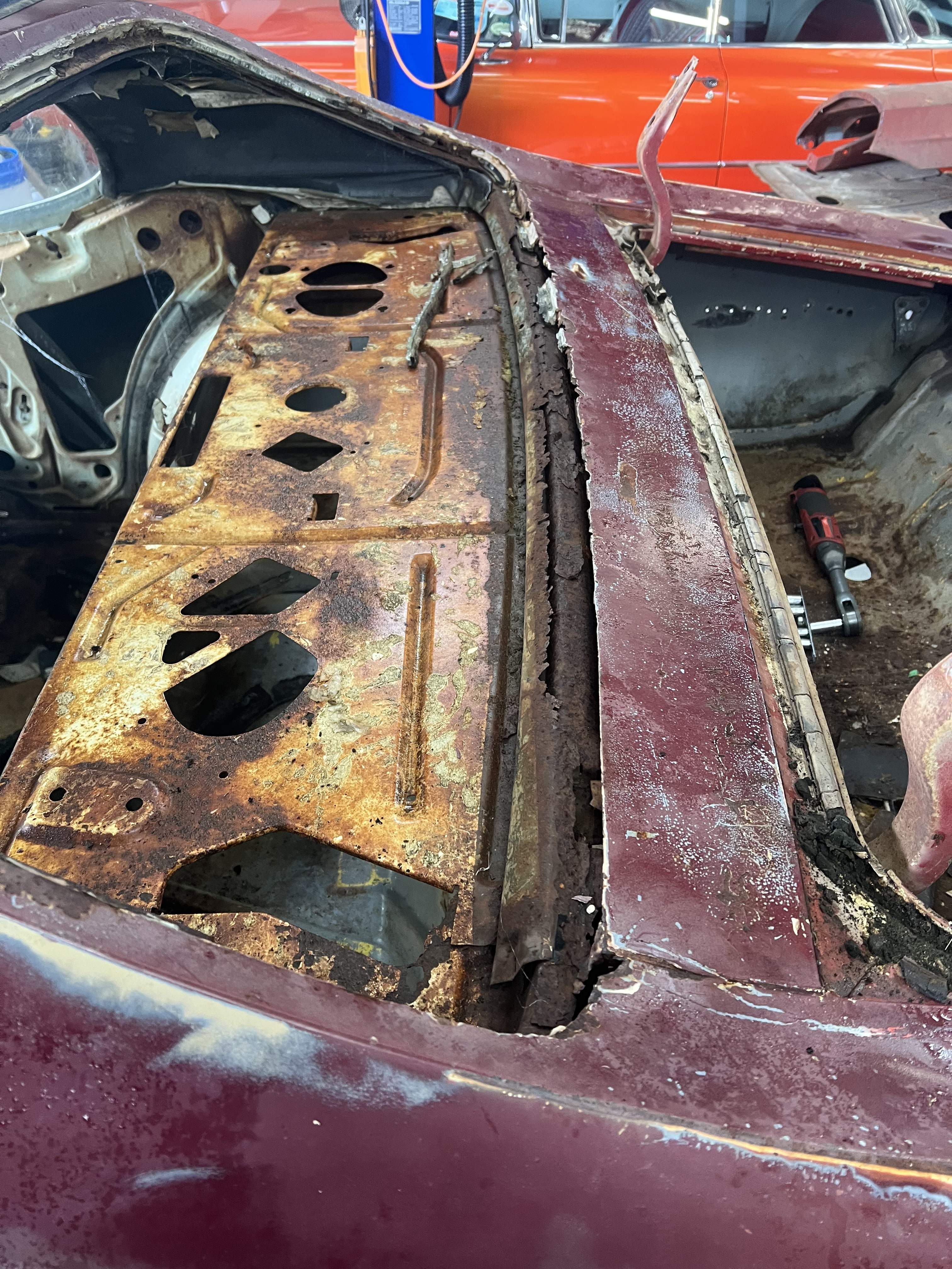

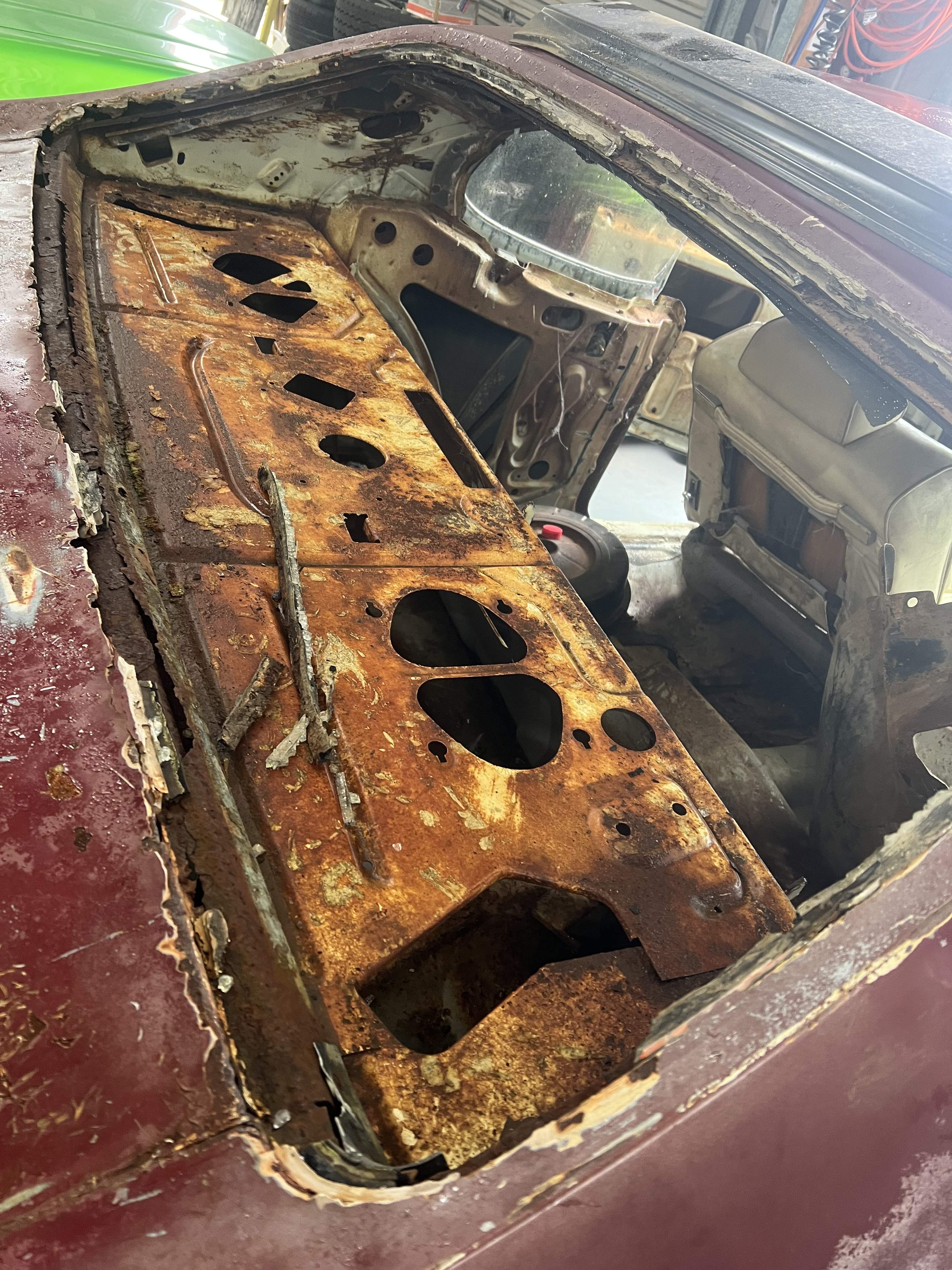

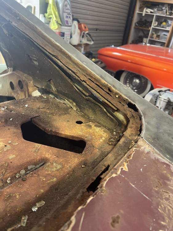

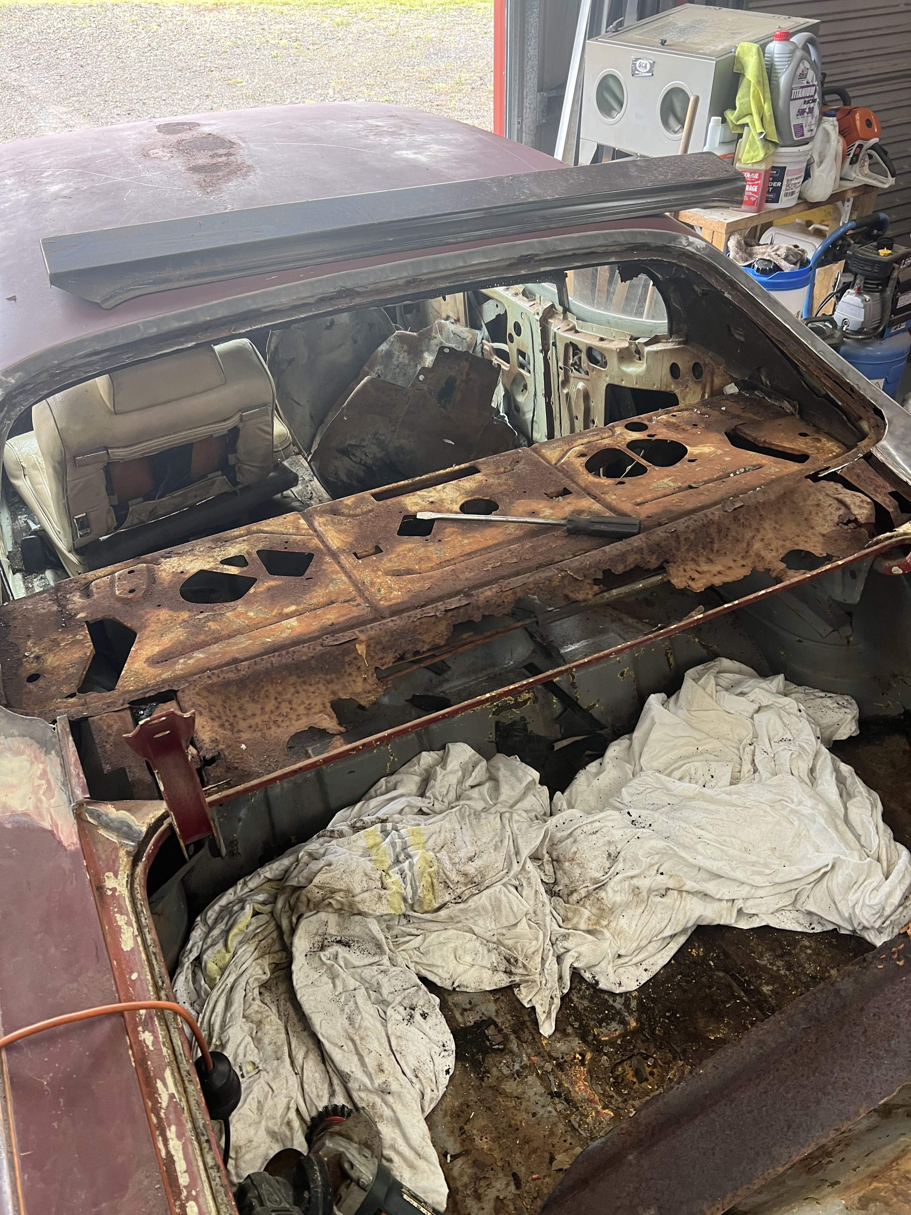

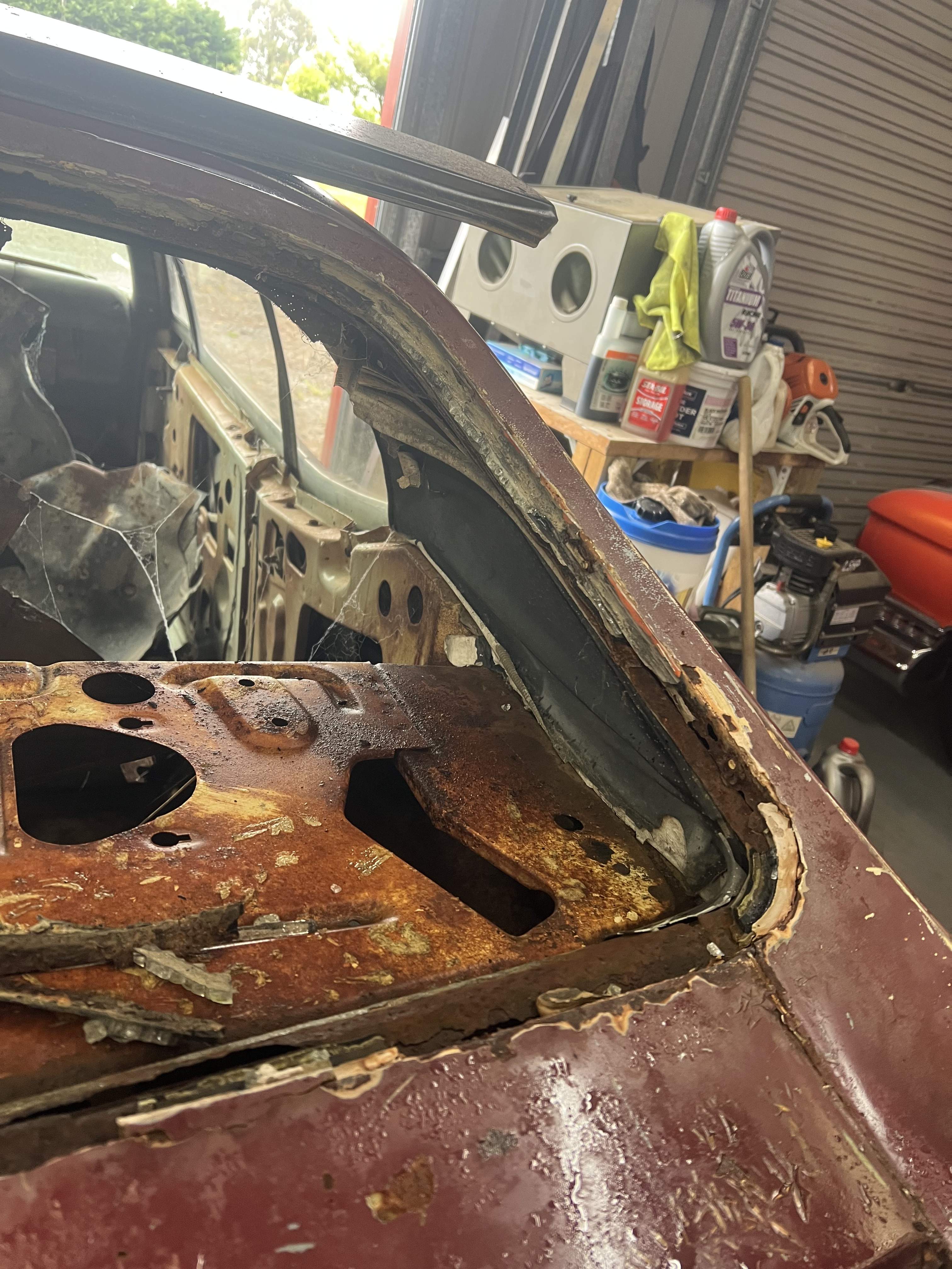

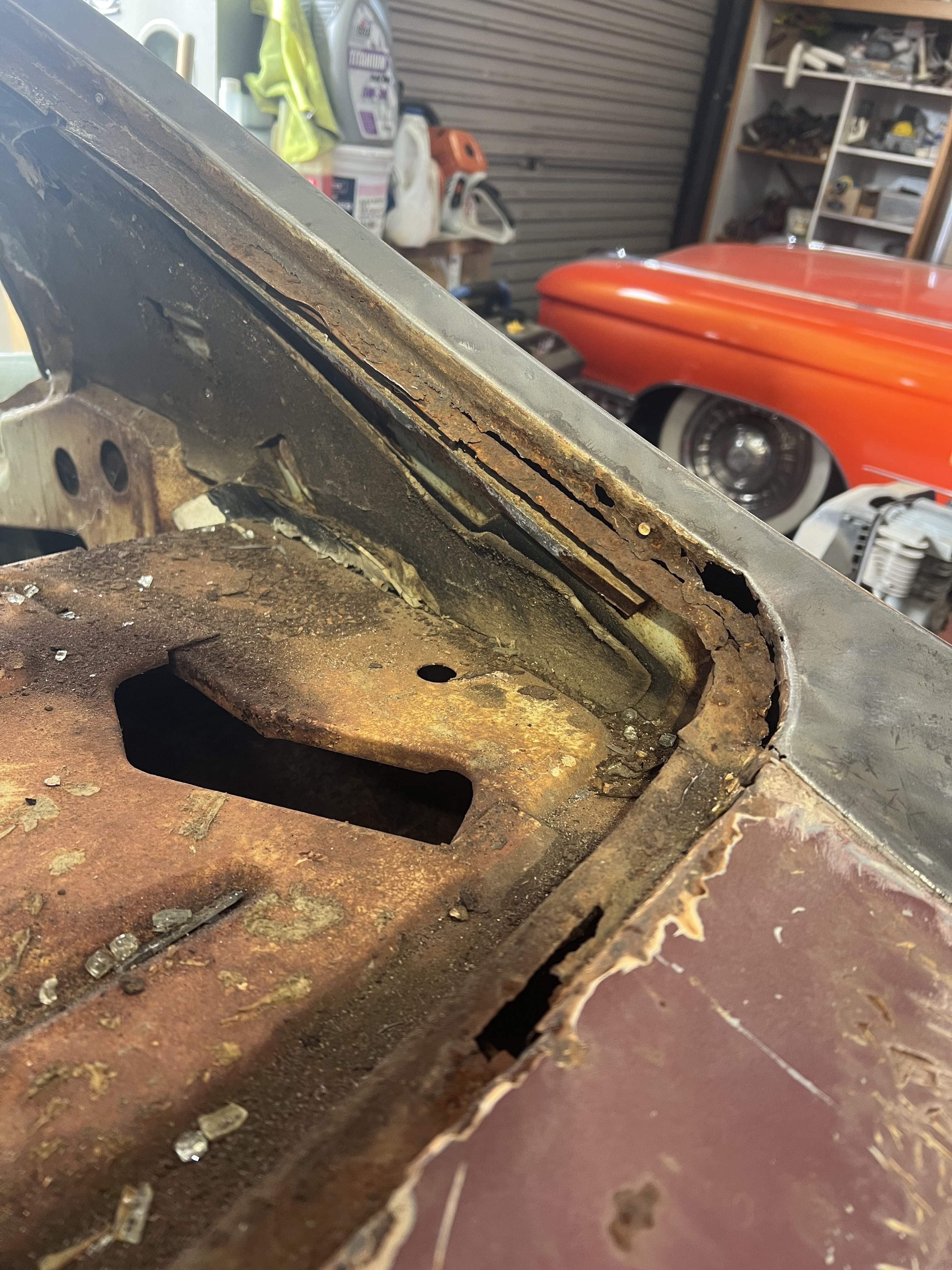

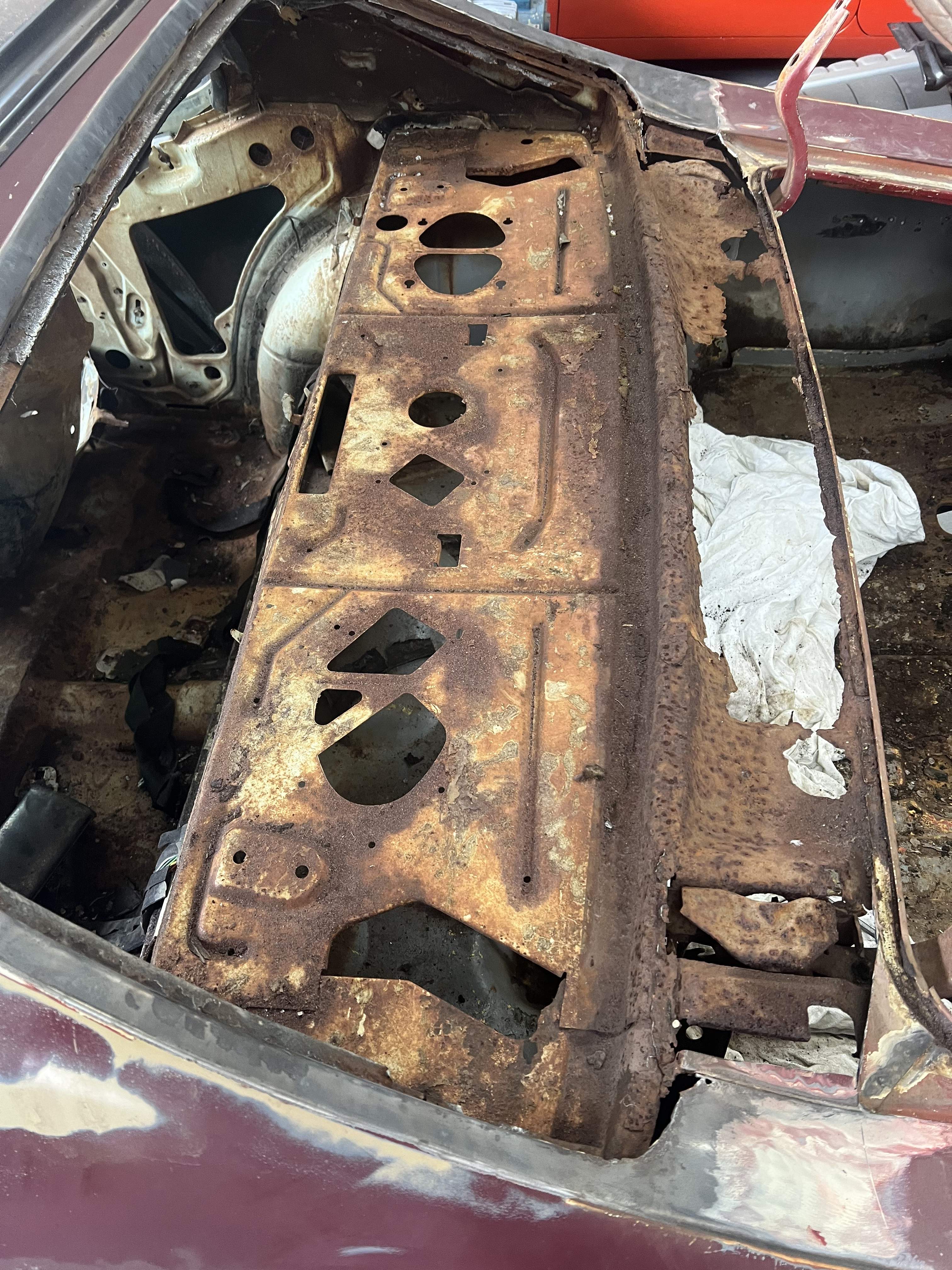

I have rust around the rear window and the car came with the window to trunk patch panel …..

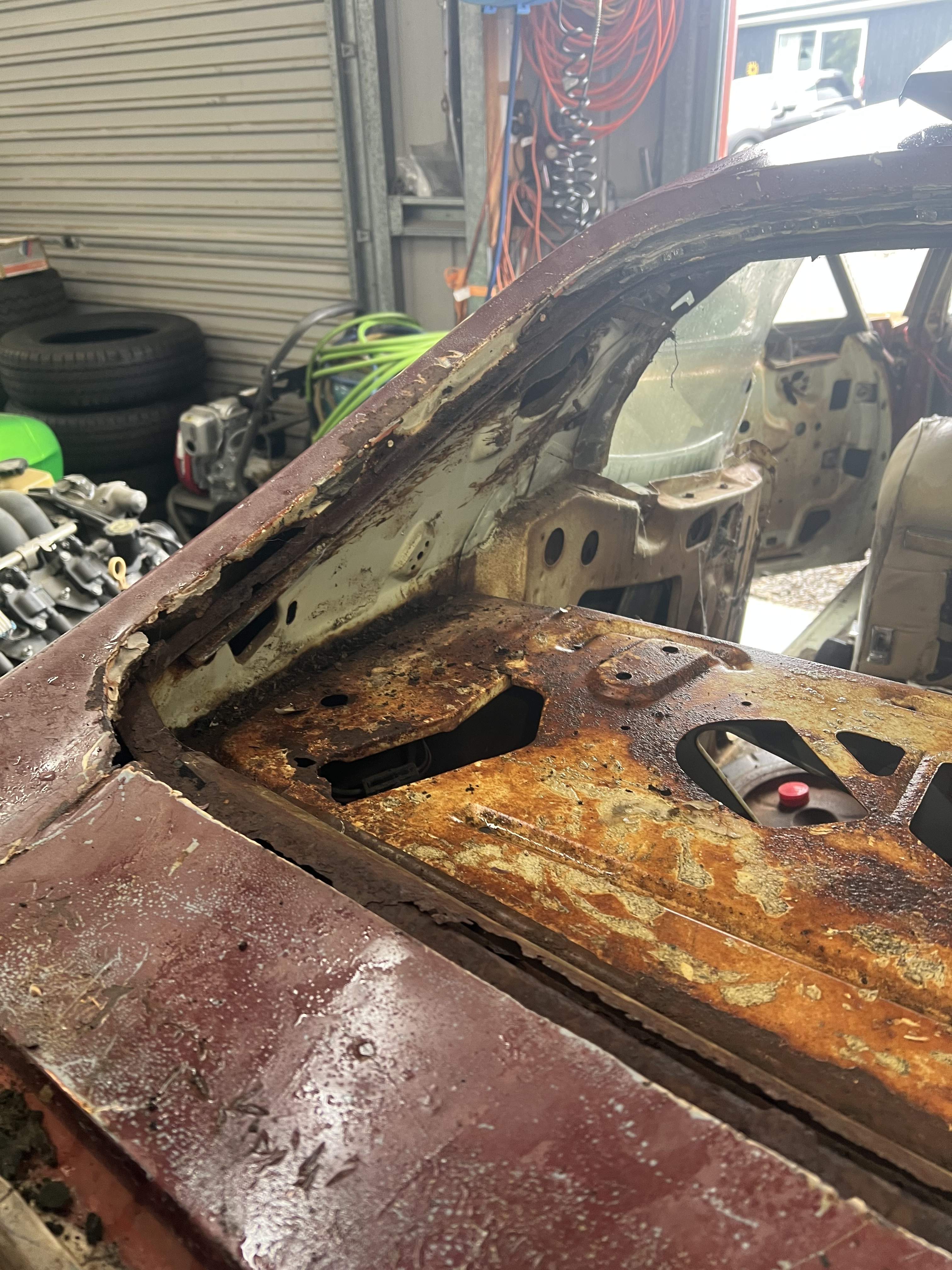

the mess was wayyyy more than justA top panel …….
So off with the rusted out window to trunk panel . So I could see how bad the underside panel was ….. and it was completely missing !!!

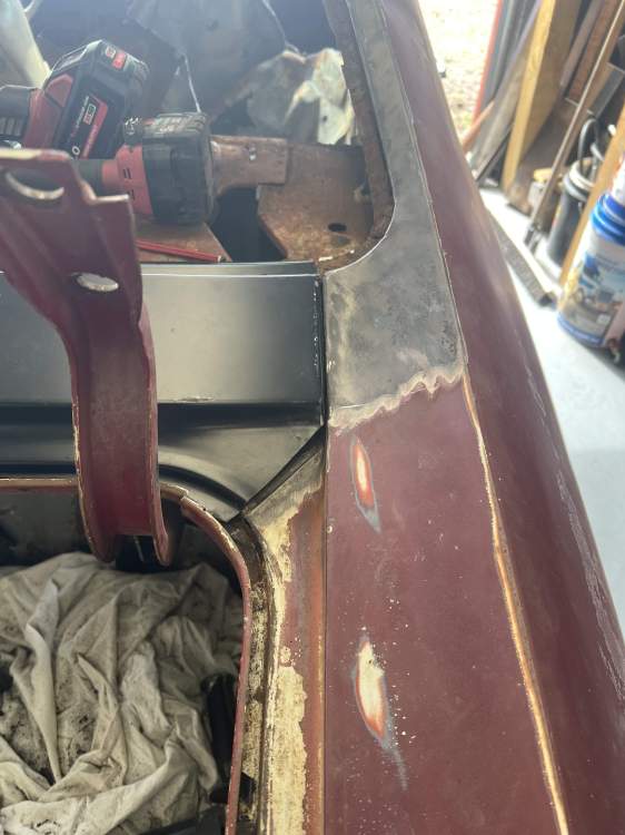

I then trial fitted the window to trunk panel , and it didn’t fit ! Both ends needed a bit of massaging and that’s as far as I will go with that panel until I source a New package tray panel , hopefully they are the same as chevelle

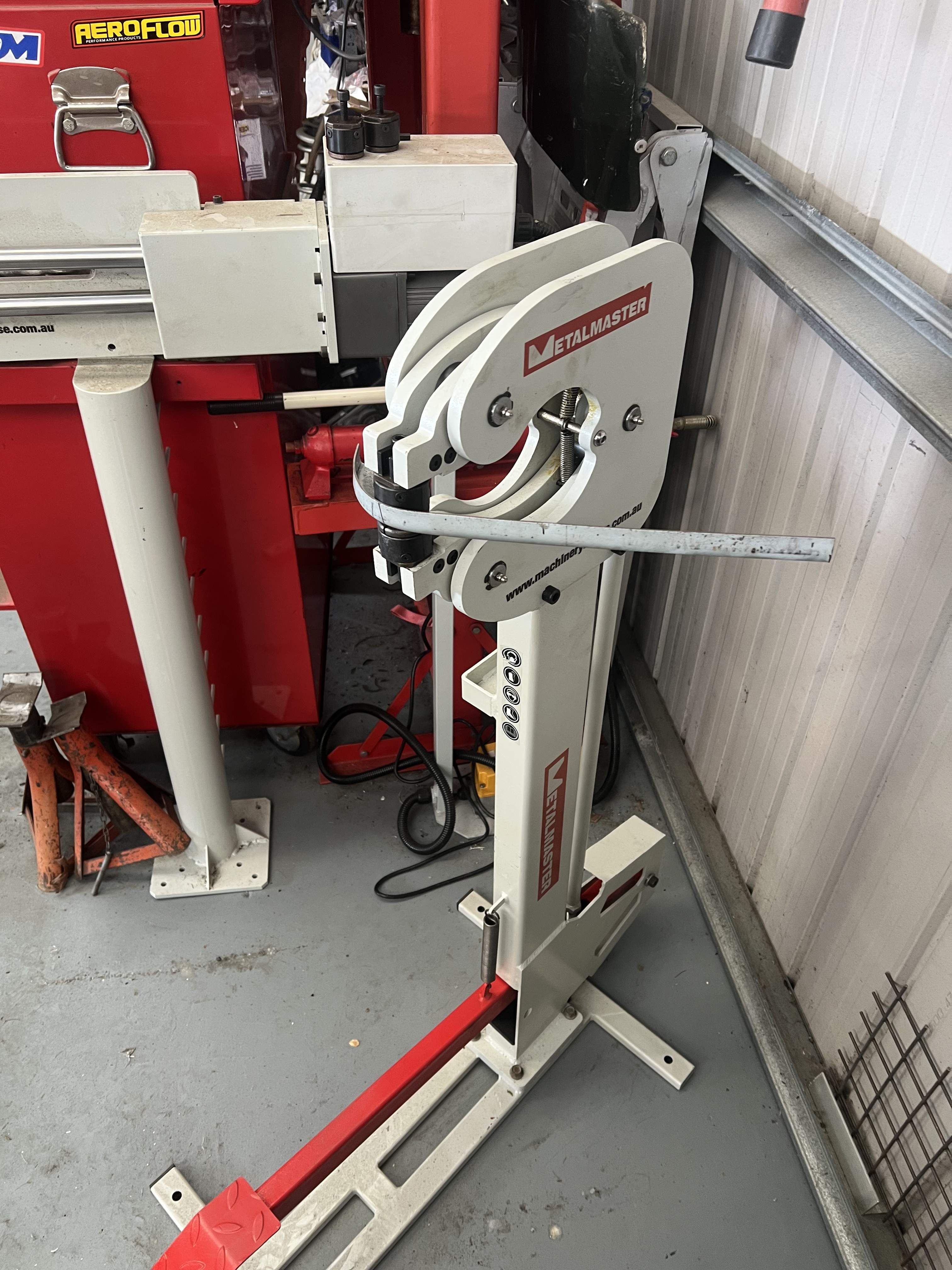

An with a couple of hour left in the day I started on the replacement patch panels for around the sides and top of the rear screen ,,, I am going to have to remove the lot and remake new ones, this is made oh soooo much easier with a shrinking machine !!!!
And the 68 gets to spend the night inside so I can continue work tomorrow !!!
Hello Chris,
I love your level of enthusiasm!! Any thoughts to getting the car media blasted or dipped before diving in any deeper to reveal the tin worm damage?
Rick
Those iron moths did a number on the package tray!
You should be able to use a package tray from any GM A-body Kiwi. Chevrlle, Skylark, Cutlass/442, or GTO/Lemans/Tempest/Custom S.
