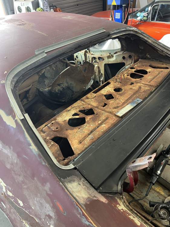

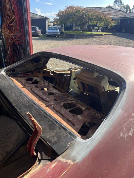

I got a day to play on the 68 again ..

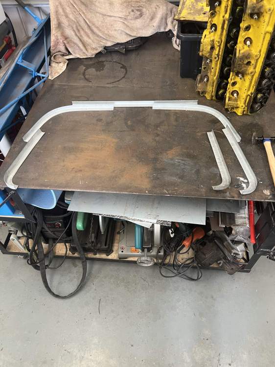

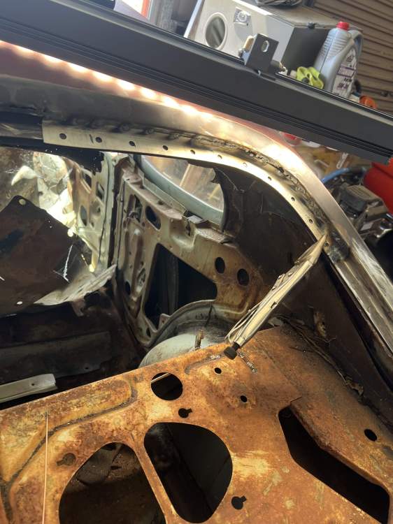

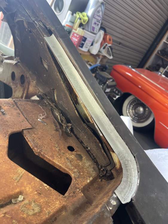

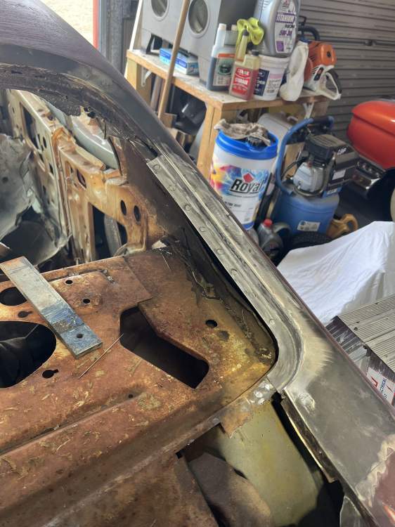

I had made one corner section for the back screen , then clicked I had used 1.6mm sheet steel !!! Fail !!!
So I made it again out of 1.2 mm

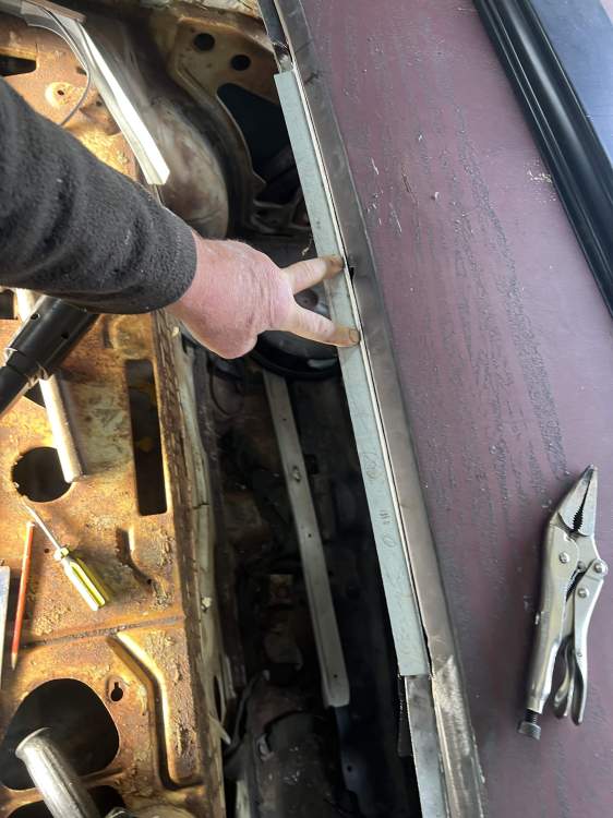

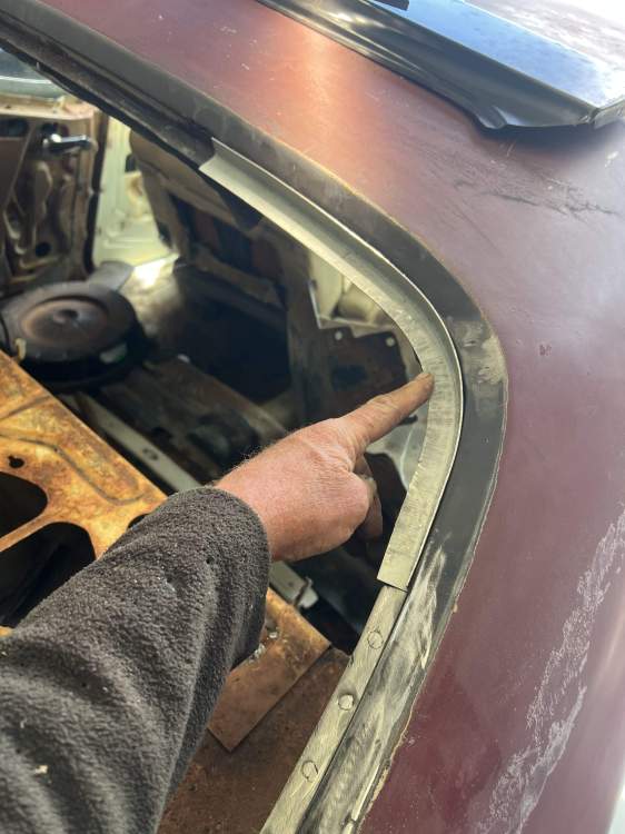

And while I was making the passenger side , I went ahead and made the rest of the surround ….

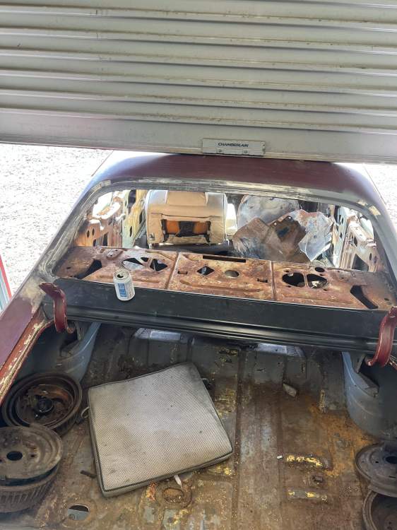

I have rust alllll the way around that rear screen , so I am replacing the lot !

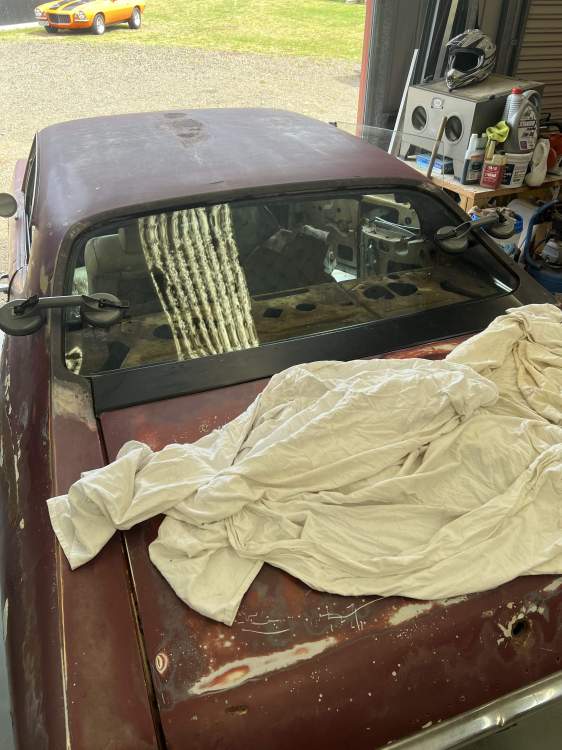

I have new glass so I used it to see how all the sections would sit
And went to replacing each section at a time ,,,,,,

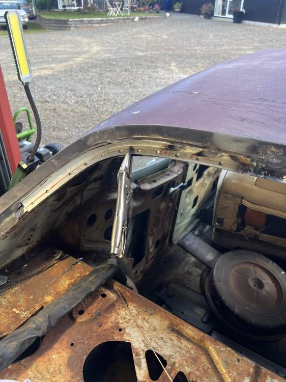

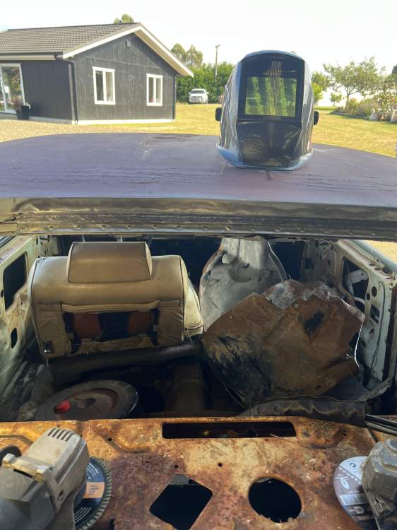

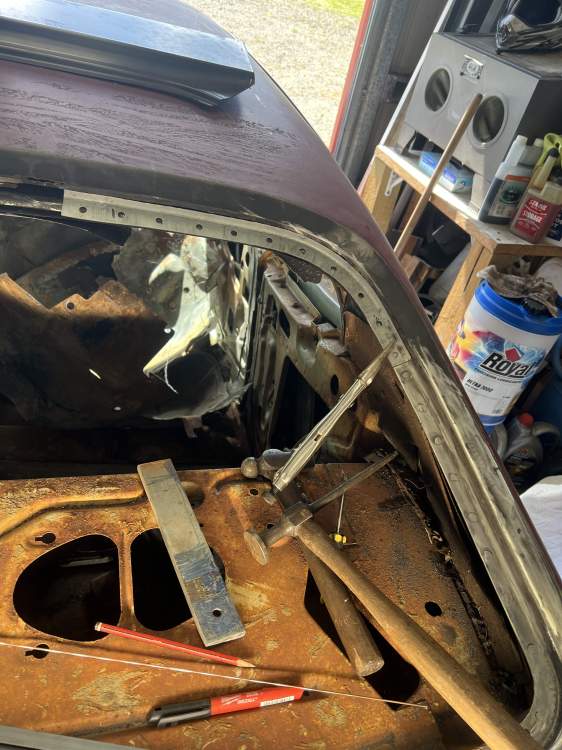

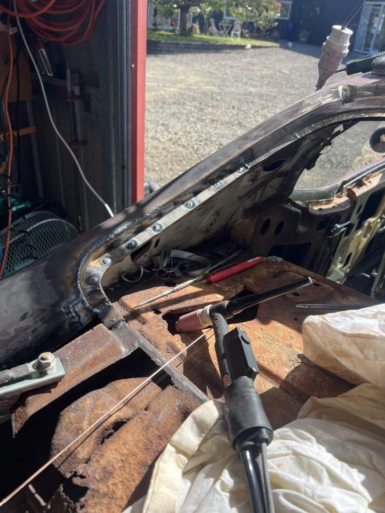

I completed half with a combination of tig and mig welding
And I so enjoyed my day !!!
I so enjoy panel work !!!

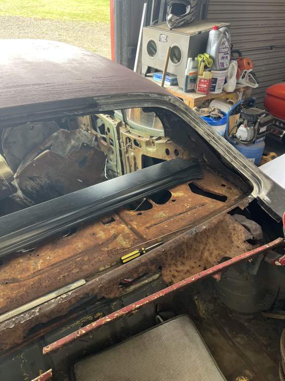

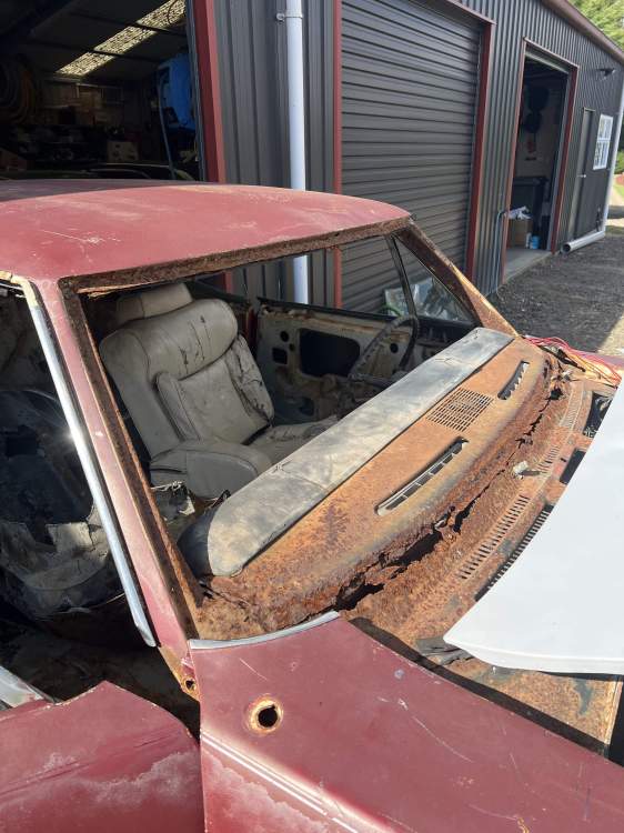

I managed to get some time on the 68 this weekend and got the rear window steel finished 🍻
Then I attacked the front screen!!!!
I was not happy !!!! It’s a mess ! And clearly a A body issue !!! Where they all rust !!!!
Having other chores that the boss was banging on about … I got the top sections bent and ready to cut/weld in
I will need to buy the cowl panel and the top dash panel

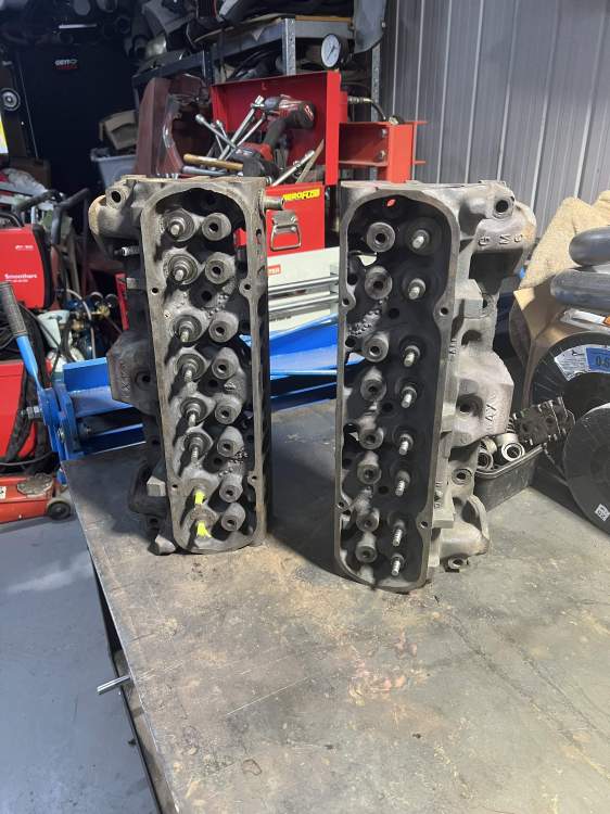

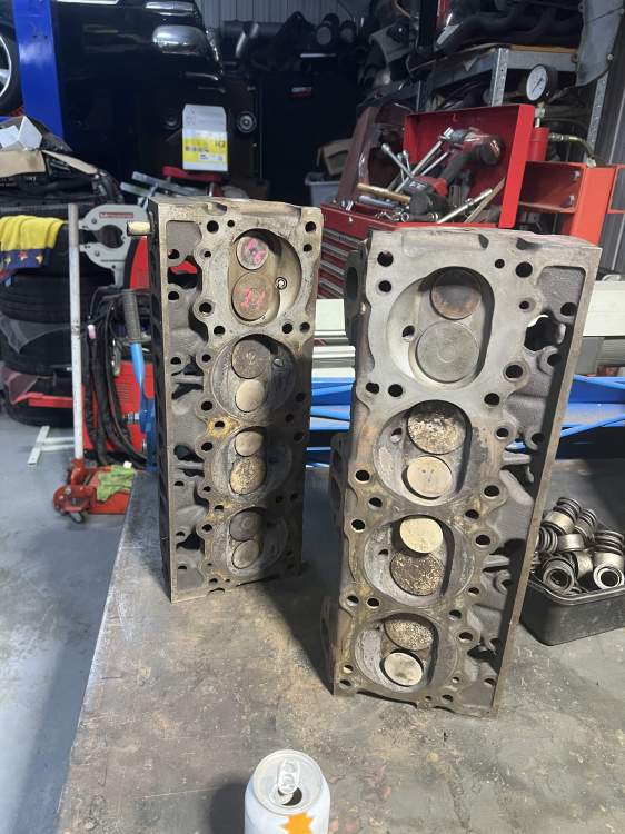

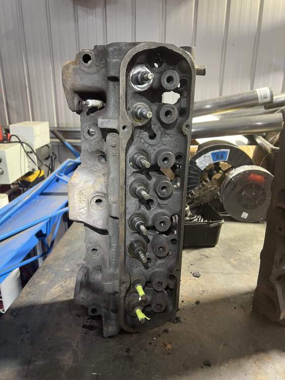

I am about to pull the trigger on my stoker crank and rods for my 400 Build
I am going with an Eagle 4.5 crank and some 6.800 bb chev rods , but no pistons at this stage . I am getting my 4x heads crack tested and ccd , before I set what dish I need in the pistons
I did my own ccd and I recon these 4x are 98 cc
But I want the machine shop to con firm that and crack test them before I go any further .
They seam to be in good condition .
And if all is good , I can get them to work out what custom pistons will suit .
Watch this space !
4x
Has screw in studs 1.6 ex and 2.1 intakes
Magnaflux or dye penetrant for your crack testing?
Rick
Rick
I would expect Maganaflux Rick, i will ask the machine shop when they get dropped off

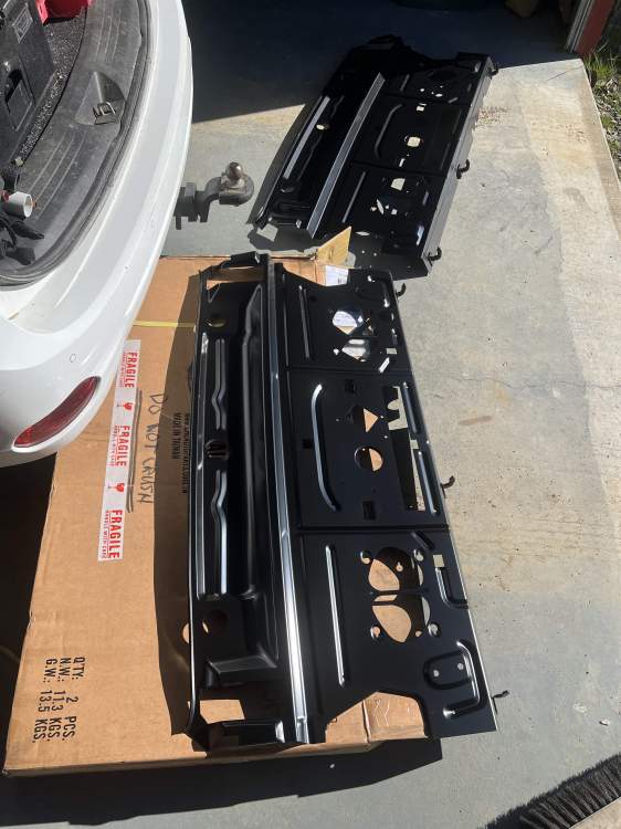

I found a nz importer who imported the rear metal parcel shelf for me at a very fair price !!!! Way cheaper than me buying off the likes of summit or jegs !
But I open the box and ………….
They must sell them as a pair !!!!!rofl or maybe they think i will stuff up installing the first one !!! rofl
either way, i only paid for 1 !!!!
sooooo watch this space !!!! frosty and i both think this chevelle rear parcel tray/ trunk gutter will fit the 68 Ponti !!!

They don't appear to be the same. Hope 1 works.
