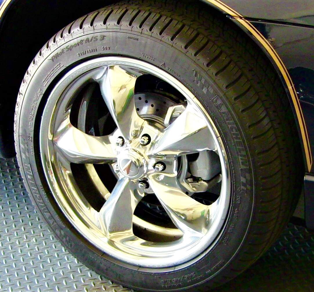

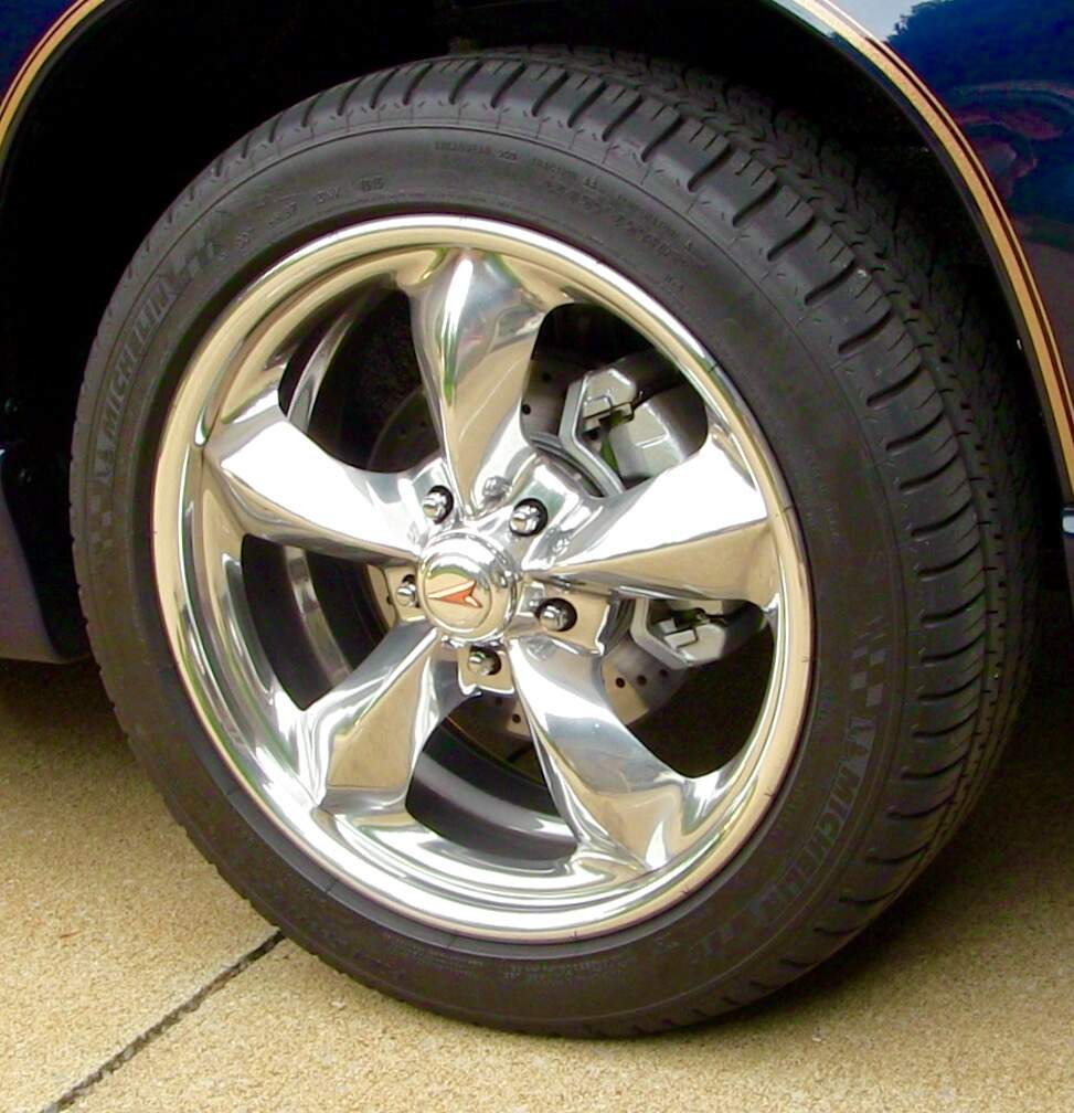

DO NOT get me wrong! I am not knocking Foose wheels, not in the least, but you in general are paying a higher price for a name as well as a smaller volume product. So if that is your absolute heart’s desire, than wait till you can get there. In the meantime you can consider what I said sometime back. Take the chrome rally ll’s & do what you can. And as I said back then was take wheel to a shop where they can remove the welded center from the outer ring. Reset the backspace you want & reweld the center to the ring. Depending on how much the heat impact the chrome on the front of the wheel you may be able to polish it out if not you can find a PVD company in your area an have the wheels rechromed with the PVD process.
But, before you did all of that you might look at American Racing’s Torq Thrust SL wheels. These are what are on the Indian. They look similar to the Foose wheel & less than half the cost. They are a two piece custom welded wheel. They would give you what you need for back spacing & the look would be close until you could get the Foose wheel.
One thing that is unique with this wheel is its built backwards! The step down portion of the rim where the tire falls into when mounting or removing a tire from the rim, which actually reduces the diameter of the rim where the center fits always is on the front side of the rim, which is where the center fits for that configuration. But on this wheel it’s on the backside & so where the center sits on this wheel is the larger diameter of the ring, which gives the appearance of a bigger rim.
Additionally these actually are a quality wheel, well made & when I had mine made even though I ordered them through a distributor I talked directly to the supervisor that was in charge of the area where they made these Torq Thrust wheels, so I could get exactly what I wanted done.

Frosty, be aware that you may need to call & speak to someone who knows that wheel. When I originally thought of getting mine their site said I couldn’t get the backspace I wanted & they weren’t an option for my car. I don’t know why, but it did. Upon talking to the supervisor that ran that area & discussing what I wanted  he said in wasn’t a problem & told me haw we could do it. Hindsight I wish I had done more backspace. I could have had an 1” deeper dish on both front & back.

Frosty, look at this word doc. This shows how the center hub can be moved back, it also shows how the wheel is backwards as I said & why it would appear larger. It also shows that I used a SS wheel adaptor I made to move the front wheels out an additional 3/4 “. Which I could have put more backspace in & not used the adaptors.

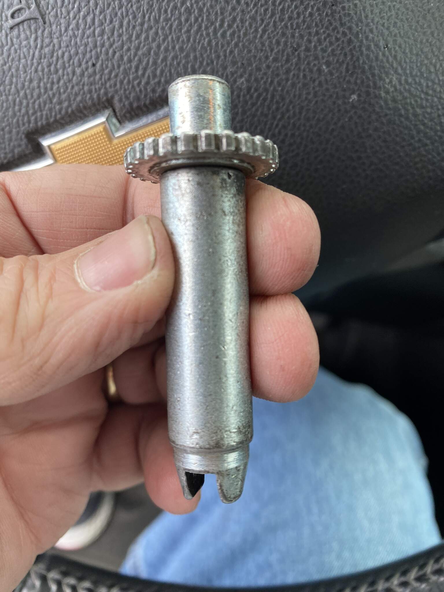

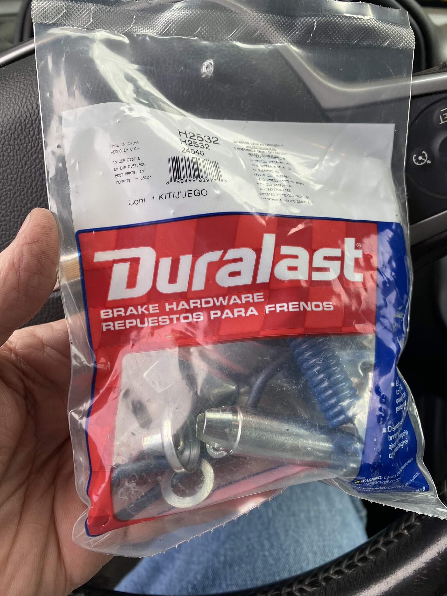

This weekend I took out my Percy Tire tool to try to determine how big a tire I can run under the stock rear fenders without tire rub. As I took the rear driver's tire off, the brake drum was loose and partial came off. After removing the tire and rolling it out of the may, something fell out of the drum assembly. I pulled the drum all the way off, and the star wheel and a spring fell out. Only it was half of the star wheel. the other half was lodged between the shoe and the backing plate. Thank god for extending magnets to fish it out.
Then I notice a problem....can you guess what it is? Here is the star wheel.
Look at the top and the bottom of the star wheel. See how the locating socket that goes between the lower brake show is there at the bottom, but the top is missing?

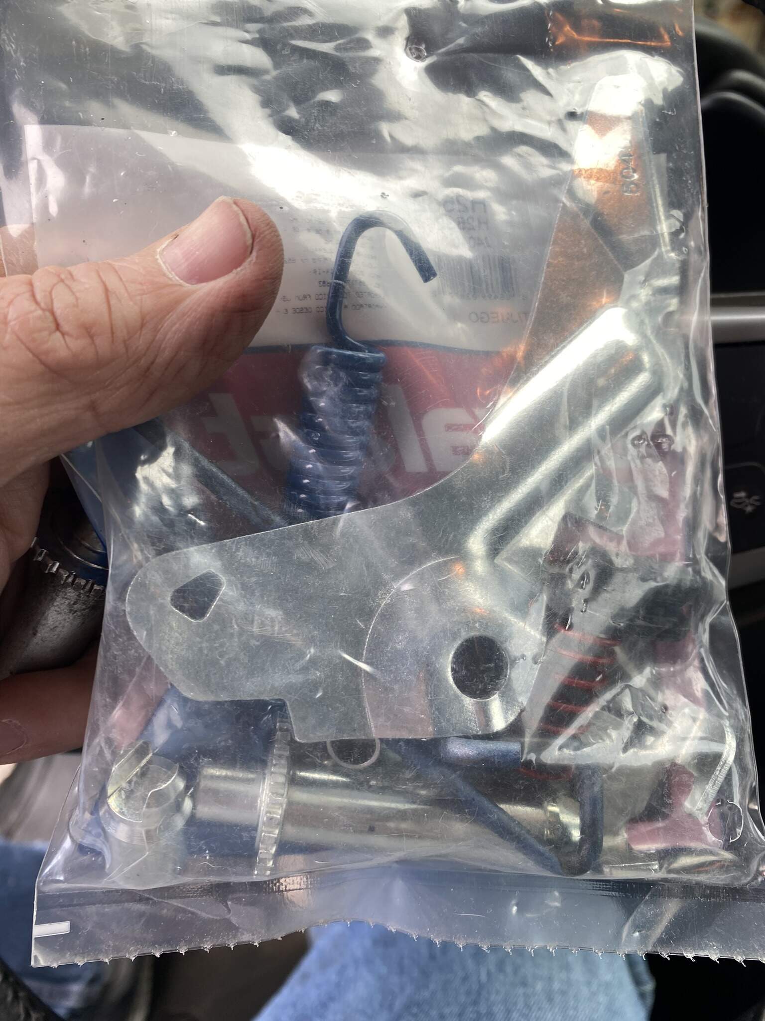

I realized that this was why the drum was so loose and I probably didn't have any left rear brakes either. I ran down to my local AutoZone parts store and asked for a self-adjuster kit for a '72 Chevelle. No one stocks "Pontiac" parts anymore. I actually had to spell Chevelle for the kid at the counter. Sheesh! Turns out they didn't have it but another AutoZone about 4 miles away did. So I ended up driving those 4 miles and spent $18.00 for a new self-adjusting kit.
The part I need is at the lower left, next to the star wheel. I will most likely use the entire new star wheel.
I ran out of time to fix it (the wife called and said it was dinner time). So that is my mission this week and then get back to tire measuring.
You didn't give me time to guess! Damn it, I actually knew this one, so not fair Frosty. :rofl:
Glad you found that and it was an easy fix bro.
Adjuster is brand new.  Why are you not all over your mechanic?  The missing end HAS to be in the drum.  What about the other side?  Guess I've never had both sides off at the same time while doing brakes.  Seems like the adjuster is side correct?  If they are backwards, they would we loosening instead of tightening up the brake shoes.   But, that would be the only way the loose (missing) end would be able to slip off.  Justa guess and I could be wrong, but bettin the adjusters got mixed up somehow.
I agree with justA .. best question everthing in both drums !!! No way should the adjuster fall apart !!! Check everthing frosty ! Was the spring pulling the bottom of both brake shoes still in place ? Or has it broken a hook end off ? That’s the only way that adjuster came fall apart !

I did take the passenger side tire and brake drum off. That side appears to be fine. I thought the same as Justa and Kiwi. Therefore I did inspect it. I am happy that it was only on one side.
As for chewing out my mechanic, I don't remember who did the brakes the last time. The guy I had put in the steering column last summer didn't touch the brakes. Those brakes have been on the car for at least 7-10 years. Lucy has been sidelined with heater core and steering column issues since 2019. This will be the first time in 5 years she has been road worthy.
