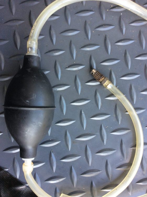

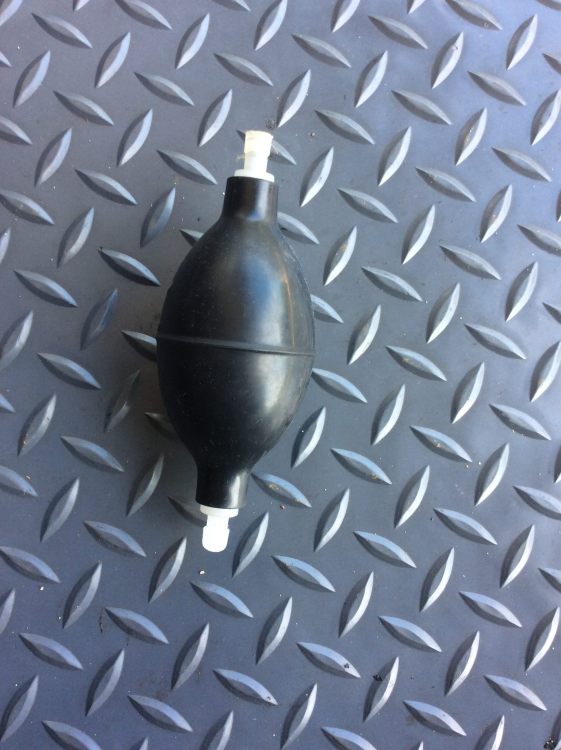

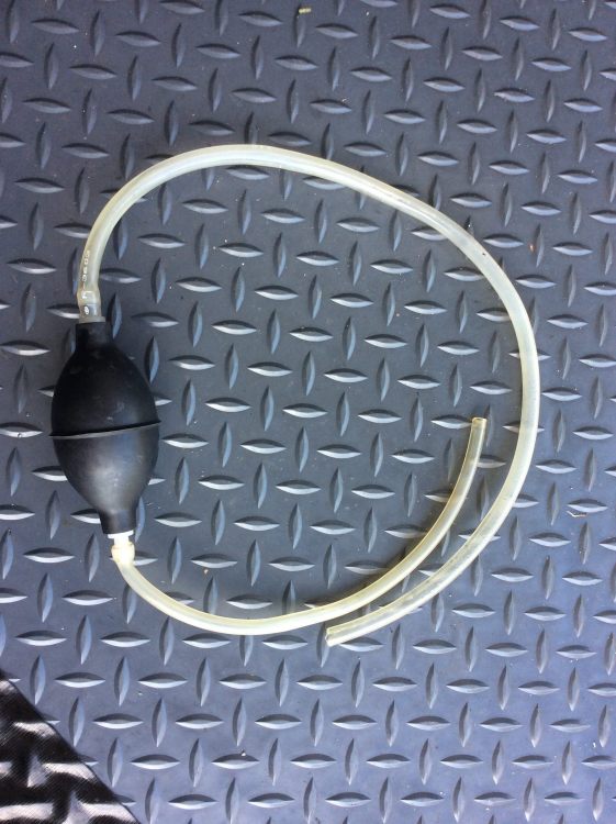

What is this vac ball of which you speak? Personally I'm not a fan of vacuum bleeding.  When you lower the pressure on a fluid, any dissolved gas can boil out.  This can lead to more gas pockets in the lines than you started with.  Shouldn't really be a problem unless you're dealing with the worst case scenarios, but my gut won't let me take that chance.
Pro, I couldn't agree more! Basically it's similar to gravity bleeding, but way faster or more like siphoning, but much better. When I ran pure silicone in my Z brake system the silicone was very high end, used in the MK46 torpedo built in Cleveland and used by the US Navy which tested it in the Mariana trench off Seattle. This fluid was horrible to bleed, infinite for air.
Anyway this was the only way I could bleed that fluid. See attached photos. Once you fill the master cylinder you leave the cap just sitting over the opening and you must obviously keep it filled so the bottom outlets don't come uncovered. You simply squeeze the vac ball and release. It then sucks fluid from the master cylinder, fills the ball, squeeze again the check valve closes preventing fluid from going backwards, but pushes the fluid in the ball out into the container. When you release the ball again it sucks more fluid! The bleeder valve just needs cracked a little, but the threads should be coated with anti-seize to prevent air from coming in around the treads.

Ah ... I've always heard that called a siphon bulb.  Wouldn't want to put one up against regular dot 3. Neat idea tho ... definitely avoids the issue of pushing the brake pedal too far and tearing a seal in the MC.
Pro, it will work with Dot 3 fluid or even acidic fluids, gas etc. https://www.thomassci.com/Laboratory-Supplies/Pipet-Bulbs/_/8AFF0743-D0A6-421B-A8B2-85EFD4A9E64C?q=Rubber Bulb
I've used it with dot 3, 4, 5.1 and 5 as well as battery acid, gas, stoddard, textile spirits and lacquer thinner.
If you what to try one and can't get one or get it easily let me know. I'll get you one!
Yeah, one from a lab supply house would be a lot more resistant than one from Home Despot.
Well I did work for a chemical additive company for 39 years!:D perks,You know!

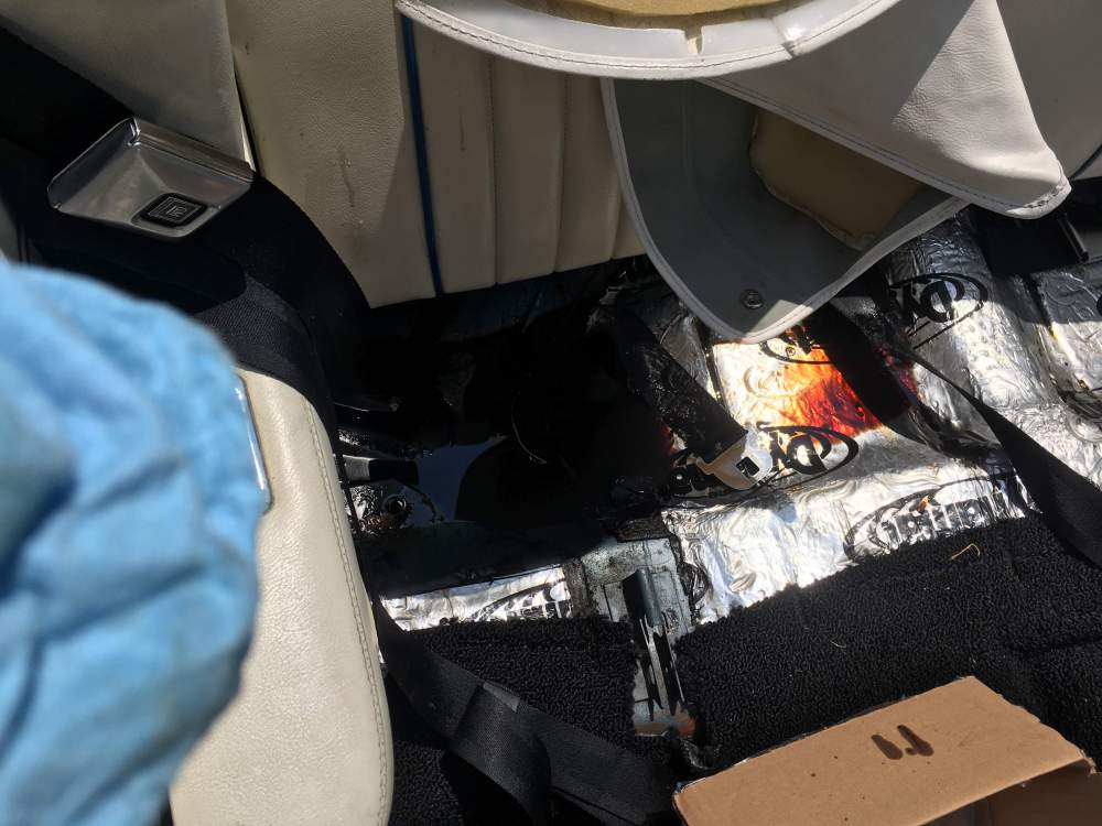

Lucy is still giving me fits. I need to stop going to the Bowman show with Indyman Joe and JUSTA6. Both times have uncovered issues with my power convertible top. Last year was a leaking hydraulic line. I replaced both lines and both rams just to be sure. This year is a leaking hydraulic line. Grrr....1831016389_IMG_30061.thumb.JPG.4d42a03c6c8ef62304179f8055054864.JPG
I have a 4th of July parade to be in. So I've disconnected the rams from the top. The top is now a manual drop top - for the time being. I had to remove the rear seat beats because some of them got wet with transmission fluid. I will wash them out this week but I won't re-install them until I have the top permanently fixed. I had to cut out more of the DynoMat too. It was saturated with oil.

Basically the top hydraulic line is leaking on the passenger side ram. I suspect that the threads are not seating all the way in, like they are either galled or cross threaded. I am reluctant to force the threads any tighter. I don't wish to damage the rams or the line if I can help. The lines are $100 each and the rams are over $200. I have an extra line and I still have the original rams. I replace the rams because the new lines didn't fit will into the top connections of the old ram. The top of the old rams are plastic and the new ones are made of metal.
