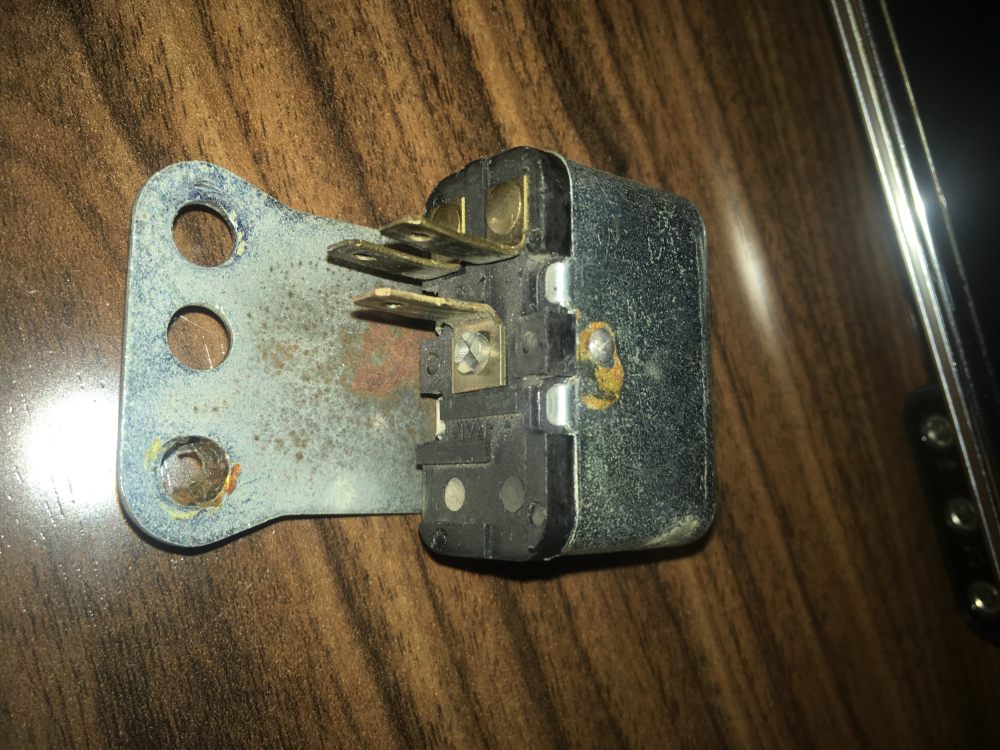

Now the top is up, I go to roll up the windows and she's a no go. No sound of any of the window motors, nothing - dead quiet. I think I have a blown fuse but I can't find one. Finally at 1 am, I had to put the car away and get some sleep so I can drive 7-8 hours to Charleston.
Now let me give you some history about Lucy. I've owned her 22 years now (since 1995). In most of that time, its had the unique ability to power cycle the power top and power windows with the ignition off and keys out of the ignition. I just figured the previous owner jumpered something to do that. I know this is not the norm but hey it was very convienent.
Well I ended up having to drive Lucy with the top up and windows down all the way to Charleston today. I didn't escape having to drive thru some rain along the way. Fortunately for me it was not gushing!
Once I got to the cruise-in event tonight here in South Charleston, I asked one of my buddies if he had an 12V electrical guru that I could get in touch with to look at Lucy while I am here. Turns out he did and the guru was standing 10 feet away from us. His name is Kevin. Kevin teaches auto mechanics and works on British cars mostly. Kevin was kind enough to look at my car.
He and I both learned something. He learned that GM A-body cars have power relays between the fuse block and the master window switch (I learned this last night surfing online before going to bed). The power relay (for cars built with power windows) is located behind the driver's side kick panel. He quickly determined with his voltmeter that the power relay was the problem.
I was lucky enough to stop at National Parts Depot in Canton MI on my way down to Charleston and I had enough forethought to  purchase a new master switch and power relay. So once he plugged the new relay in and he hit the master switch, nothing happened. Then he turned the key into the "on" position, and viola, the windows worked again. Kevin said that the power relay actually failed all those years ago and allowed direct battery current to let the top work and the windows roll up and down bypassing the ignition. It just took all these years for the relay to completely fail.
Failed Power Relay

Glad you got er figured out.  Now Lucy, continue your winning ways.
Okay no talk of power relays they are an occuring nightmare of mine right now.
Sitting in line to go back home from Michigan in the Truck.  Look over and the temp gauge is going up.  Holy Stuff.  So I leave the line up hit the highway to get some cooling and make it to O'reillys.  Fire in a new relay.  Works good go home.  6 weeks later exact same scenario.  On the bridge and cannot leave.  Holy Stuff.  I got through just in time.  Now I carry a thirty amp relay with me at all times in the truck.

Are you using power relays or solid state power relays? Different beasts (and reliability) but I don't know what the truck takes. The Envoy has power relays and one solid state power relay - just for the low beams.

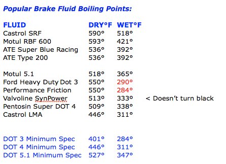

Frosty, when you redo the brake lines I presume you will change the fluid? So food for thought, the best non silicone fluid I ever use was valvolines SynPower 5.1, but it's not available any longer, but this past winter I redid the Indians brakes because I replaced all the lines in the car. Which didn't make me happy because the SynPower was in the car. So the search was on. What I found was pretty close to SynPower. It's Bosch ESI6 and Autozone carries it. You might take a look at it.

Quick question, how well does SynPower or Bosch resist absorbing moisture compared to normal DOT3 or higher standard, off-the-shelf brake fluids? I know most are good for about three years before they absorb enough moisture that warrant the system being flushed. Just curious.

Actually my question had more to do with any actual or perceived superiority of the SynPower/Bousch products vs. the rest.

Frosty, SynPower was the better product in my opinion. It was a full synthetic, but not silicone. Unfortunately Valvoline stopped making it at least three or four years ago.
For current day I would use the Bosch if you’re not going to use silicone. The Bosch ESI 6 is a synthetic, but I don’t believe it’s a full synthetic, but again they don’t say. Chemical companies are very protective of what they tell about a product for several reasons, so sometimes I can only look at the specs of a product and make a calculated guess based on what I know.
The Bosch product says it surpasses 5.1 brake fluid and it does! It’s even comparable to Dot 5 (silicone) for wet and dry boiling point, and compared to some Dot 5, its better in that regard.
