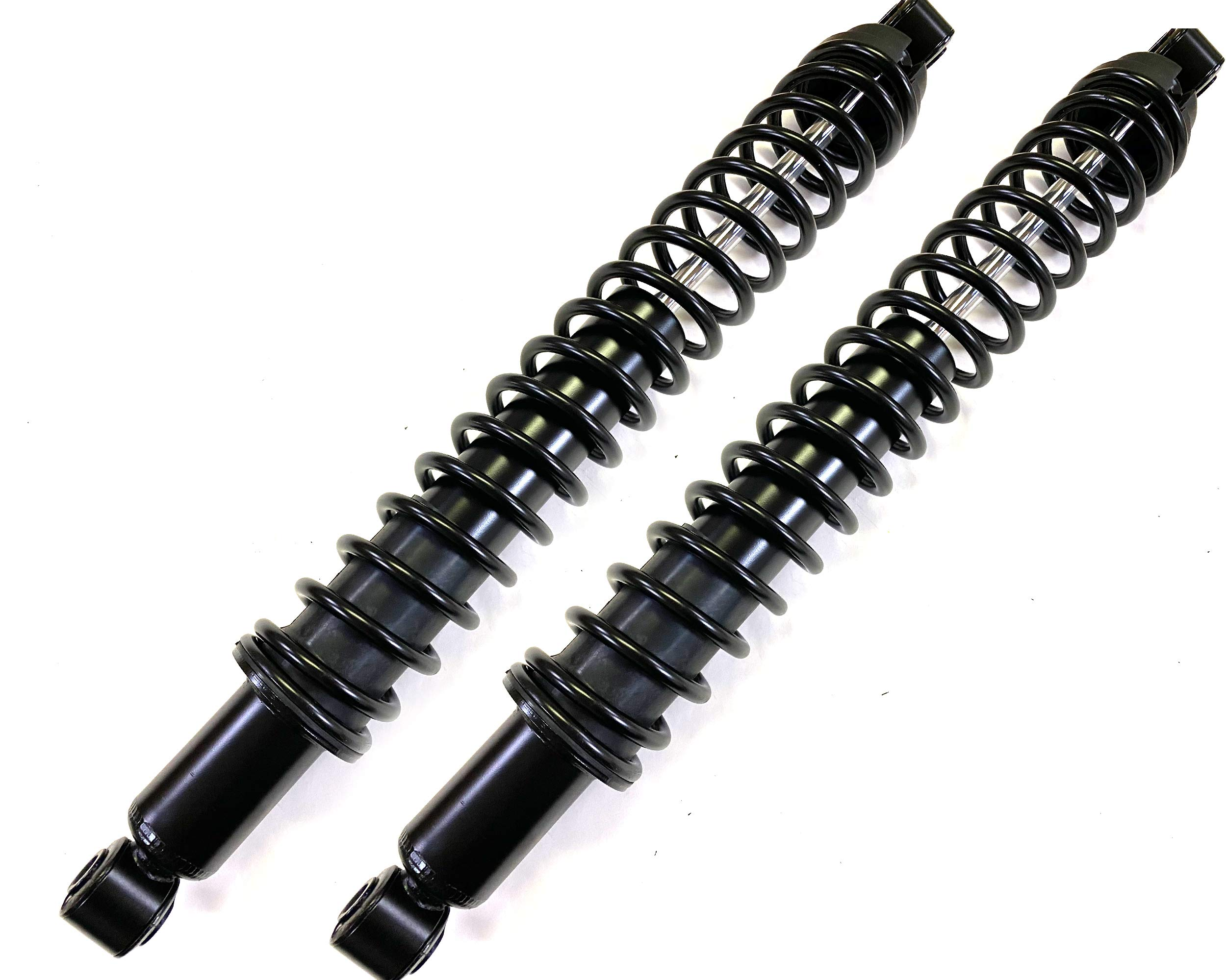

Actually I have a set of Loadmaster shocks (combined shock and mini-coil over) in back to help support the added weight during parades and such. Still , even without the added weight, the rear tires are still very close to the inner lip of the fender and I am fearful of it cutting the tire. No I don't want to roll the inner fender either. If I do that, then I have loose the stainless trim around the fender.
