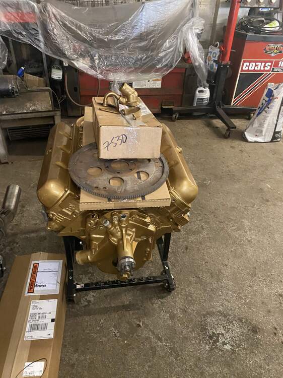

please tell me your not using nuts and bolts on a flex plate that should have welded threads in its self ?
Wasn't gonna say anything, but thinkin the same on both topics.  Messed up U bolts?  They would have been left loose to begin with as there is really no way for the nuts to back off.  The bearing caps are firmly held in their pockets. If they were loose you would have to feel or at least hear it.  I've had many more stick than auto trans, but nut N bolts seems waaay wrongway?    Could very well be wrong, I've messed more with auto trans workin on the GTO's 350 N 200R4 then my entire life. I'm assuming they got the interior back together OK?  That alone is huge.

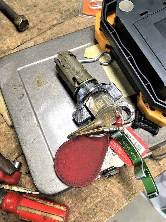

Now this can go into the new tilt column and I don't have to re-key the car. It's beer me time!
As this point, I am not sure what I am going to do with the remains of the old column. Do I pitch it? Save it for parts? Send it off to be rebuilt?
I found the vent last night. I am also taking all the spare parts from the old column with me.
According to the mechanic, there is something that attached between the tumbler and the column that is missing.

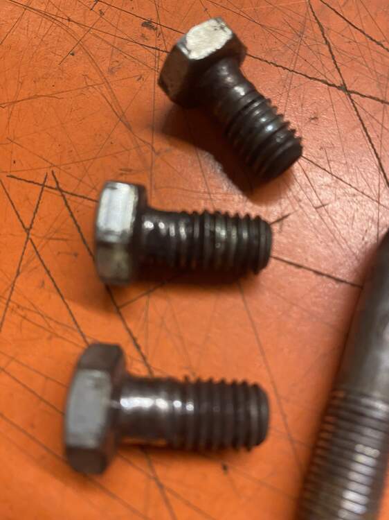

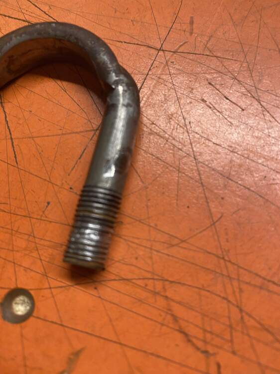

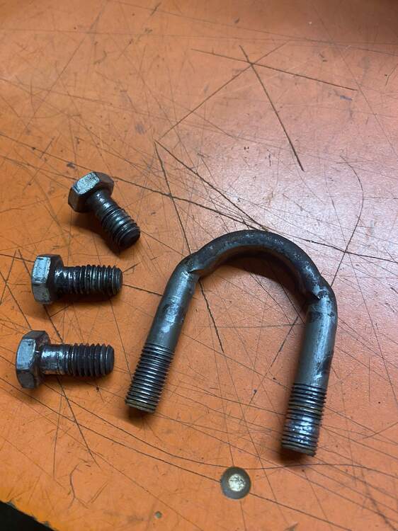

Here are the defective torque converter bolts and the bad U-bolt.
E8011DE1-0F0E-4281-8CC0-7BF7B649FB6D.thumb.jpeg.4551db97508b9c5f9370fc1cac229807.jpeg57DFCCC5-7237-4DA1-B3CE-2AE3783807FE.thumb.jpeg.07a1527273cff4cf30fbcc3978365aab.jpegGrade 8 bolts have now been used on the torque converter.

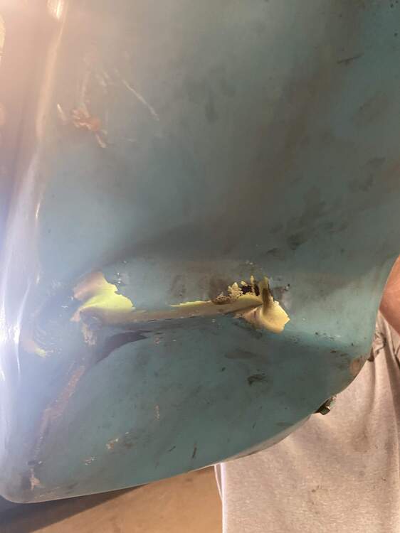

Now for the Wall of Shame is the dented oil pan.
F40F7339-0C81-4191-872E-D30CC64F555F.thumb.jpeg.d101e950814d82b48a2af6dc7b2f7080.jpeg0C15D570-FA0F-476C-9D76-C17D4F1DC22E.thumb.jpeg.cc4dc0bfaea264495fddb6ac5e8f8910.jpeg

and the bolts where not grade 8 ?
dont appear  to have any lock tight on the either ?
The u bolt looks likes to have been cross threaded ? That’s a installation fault
Thats a hell of a dent Snowman. To me looks like the nut may have backed off a hair and the pushing and pulling on the u bolt due to torque flattened and trashed the threads. But that may justa be on my screen :lol:. Super glad she'll be home soon bro.

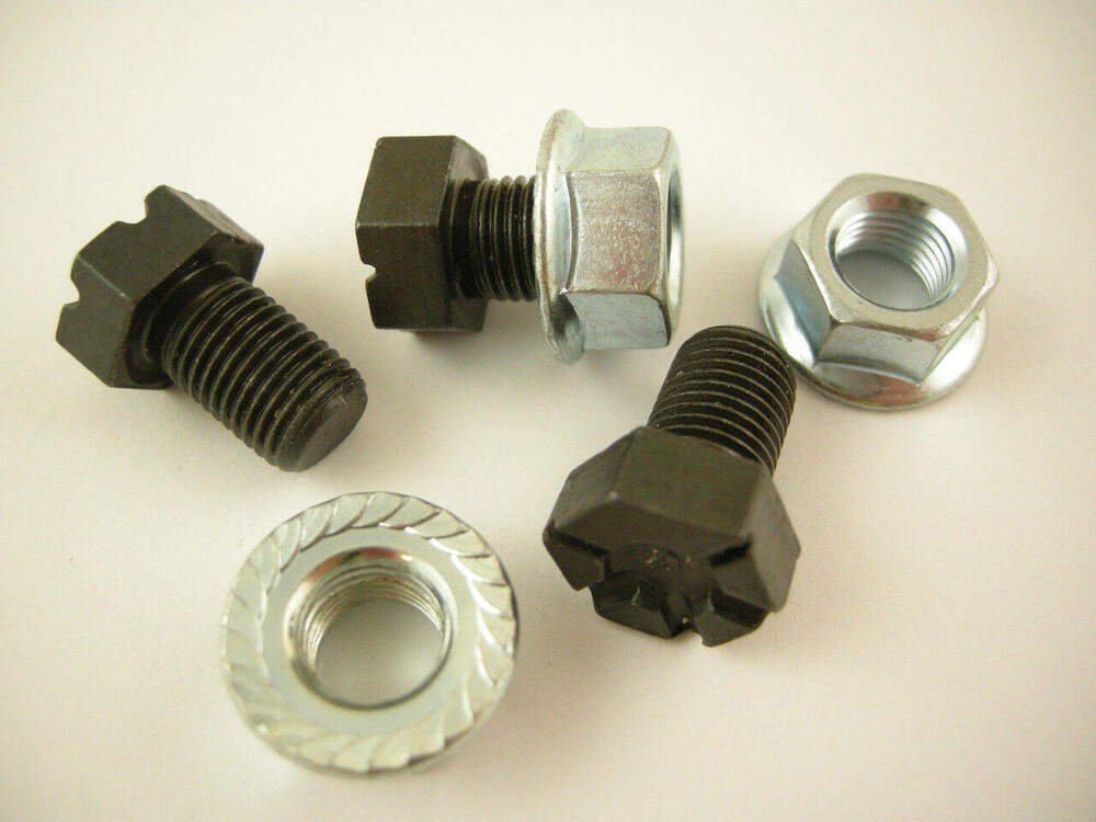

Yeah those are not GM torque converter bolts! These are.
the ubolts are a story as I don’t see the nuts, but GM always ran grade 8 nuts with grade 8 lock washers on their driveshaft ubolts. One thing that does come to mind for the ubolts though, because I have seen it more than once, is upon installation of the universal joint caps into the of the cradle they will move out slightly because of the grease. Then they are not trapped between the two tabs that retain them in their pockets. The ubolt will still install, but over time the nuts will loosen & the cap will either move back into the pocket, leaving the bolt even looser or cause rapid degradation of the U joint. My two cents.

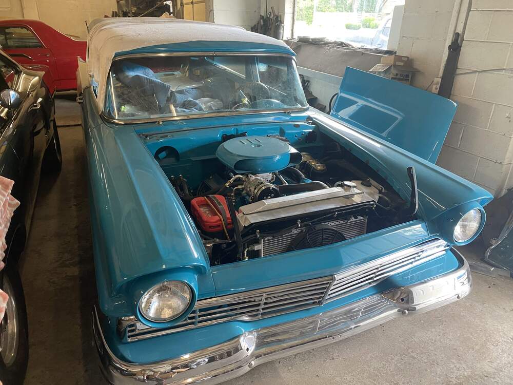

I did notice some engines lying around the shop while I was there. Some definite eye candy.
IMG_0118.thumb.jpeg.ec87279f14e85a2ad4755360508c9974.jpegIMG_0119.thumb.jpeg.6210479798a9fc22eda7d7dde4daefb0.jpeg
‘57 Ford wagon.
IMG_0117.thumb.jpeg.95f999dddca2421f3901617ad8122587.jpegIMG_0120.thumb.jpeg.07a4e367835231adeec1d5d74c343a03.jpeg
Pair of Oldsmobile motors

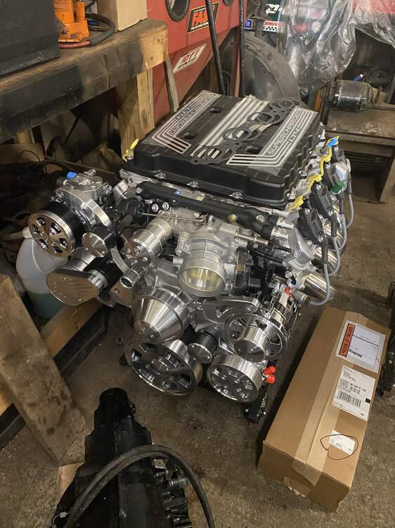

Your basic superchargerd LT-4 crate motor with a $3k pulley system and custom headers. This baby is going into a ‘68 Camaro with a Detroit Speed and Engineering front subframe. This is $20k worth of motor right here. He has a second identical motor for the same customer to put into an El Camino. Must be nice to have money.

The torque converter bolts were finger tight and was not grade 8 bolts. So I could have had serious issues down the line. Threadlocker and grade 8 bolts are now in place and torqued. See the pics above for the old hardware.

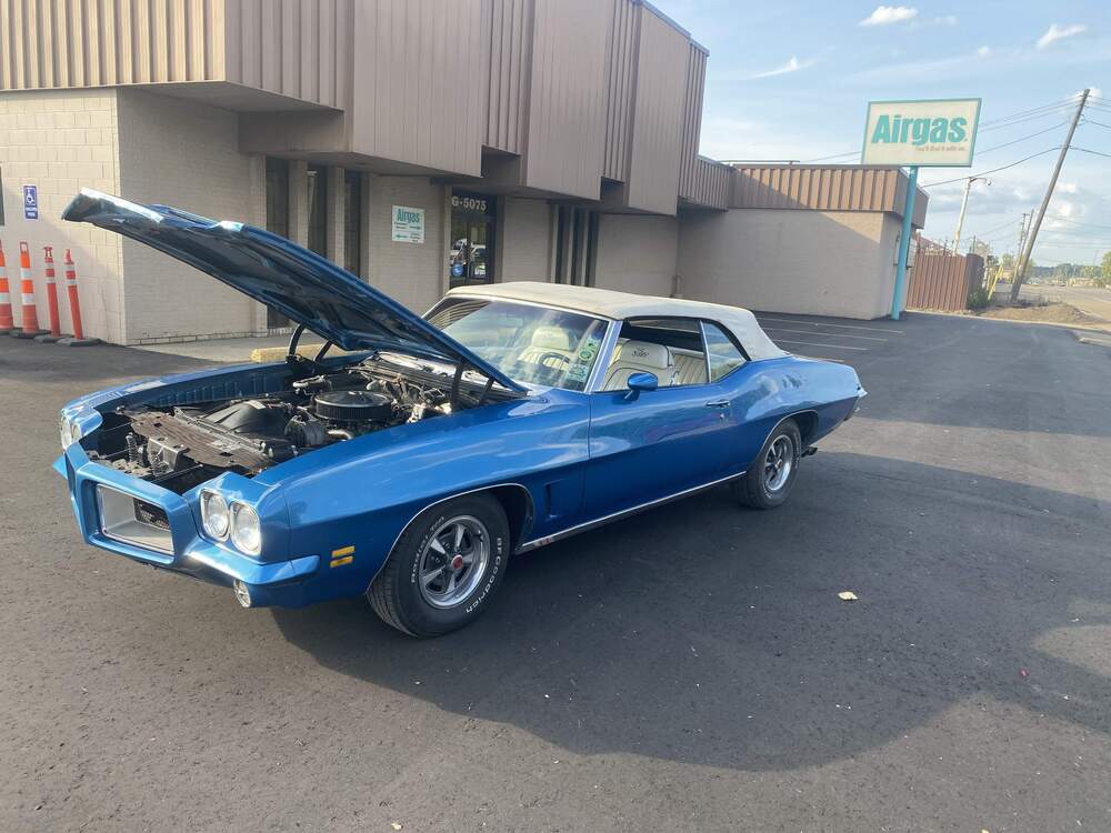

 Lucy - Dead as a door nail without any gas.
I got her home. She needs a thorough cleaning from top to bottom, inside and out. Perhaps even a clay bar cleaning too.
I hope to do a fall color tour in her in a couple of weeks. I need to test her our under some longer driving conditions before I commit Lucy to next year's Hot Rod Power Tour. I want to have some faith in her since it was the broken belt in 2019 that led to the car overheating and blowing up the heater core in the first place.
As the sign say's....Your at the wrong GAS station, Lucy doesn't run on AIRgas. :slap: :rofl:  Glad she's finally back on the road for ya. If ya figure out how to run er on AIRgas  Lemmme know.
Edited by JUSTA6
Yeah well there weren't exactly any PUMPS out there either to even try to fill 'er up.
No! But there was a lot of air; which is a gas you know!
So are farts, doesn’t mean I’m going to collect the methane gas and convert Lucy to run methane!
