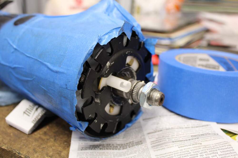

  • I have started replacing Lucy’s battery cables. i started with the easier negative cable. Here is the DEI wrapped starter i now have to remove to replace the positive cable. I will finish the job
  • I worked on Lucy a little last night. I have a car show on Sunday, so I am trying to get some last minute stuff done. Here is the shifter when I started the night. Here it is after I f

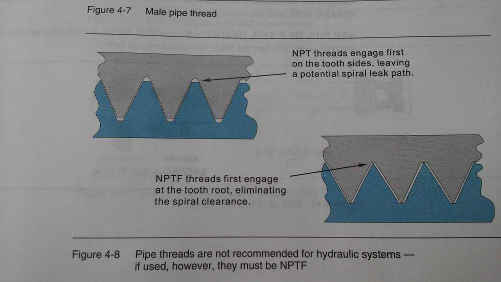

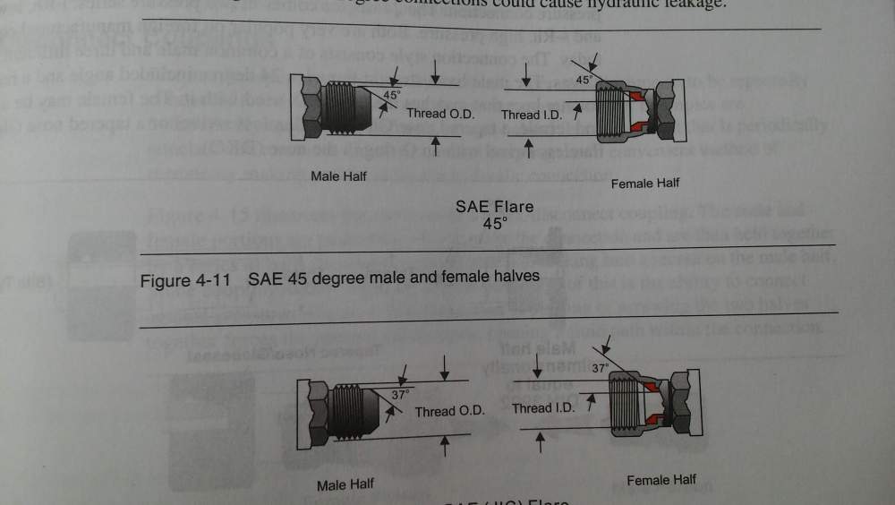

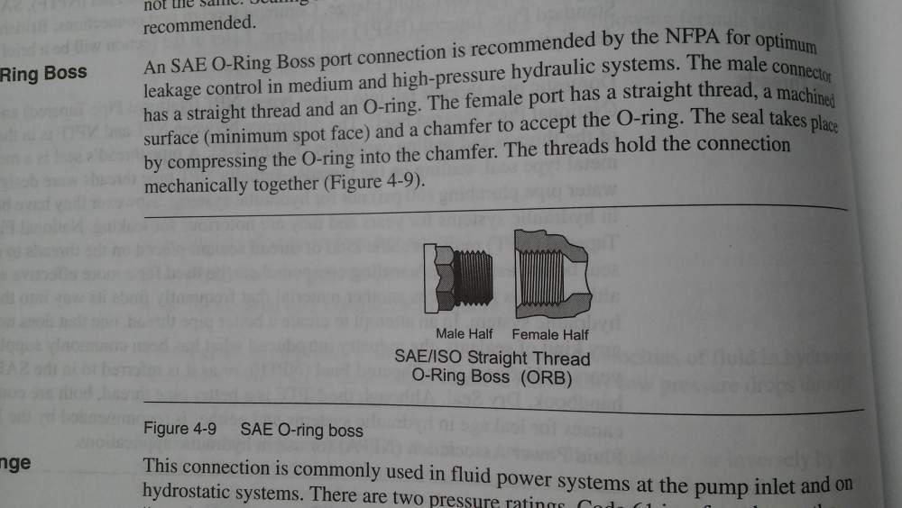

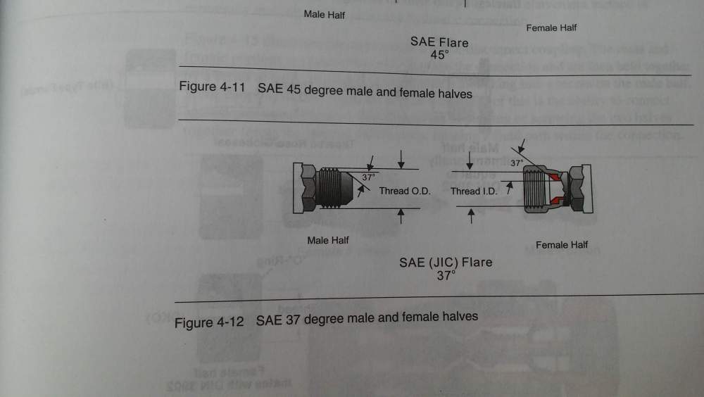

Here is some info on hydraulic fittings....Thought It might be of some help....
Thanks for the tips Two Lane. I appreciate the info from Last Indian as well.

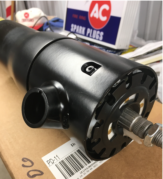

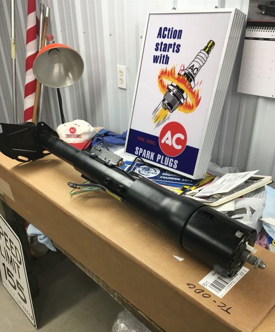

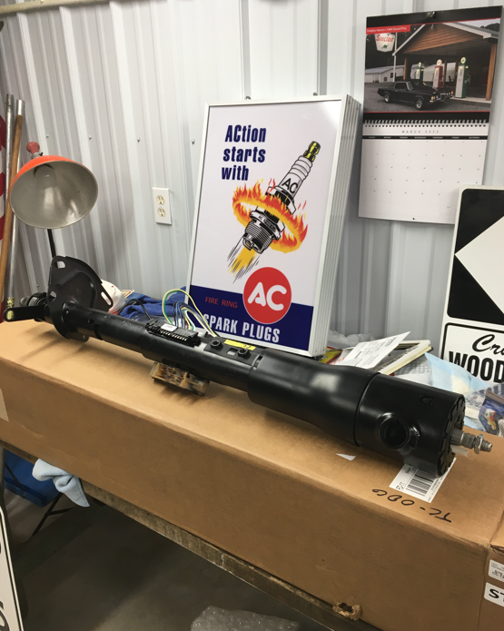

I haven't posted in my Lucy thread in quite some time. I just purchased a rebuilt GM tilt floor shift column to replace the gacked up original column I somehow managed to pull of last fall. Weather has turned cold again, so I won't be installing it right away. I ordered it from Firebird Central. I understand that A-body and F-body columns are the same. I will validate that soon enough.
I will have to transfer my lock tumbler/key and turn signal/cruise control lever over to the new column. I had to purchase a Pontiac correct tilt lever for $12. No big. All wiring and electronics are suppose to be new. Heck I even got a Firebird Central 2022 calendar too.

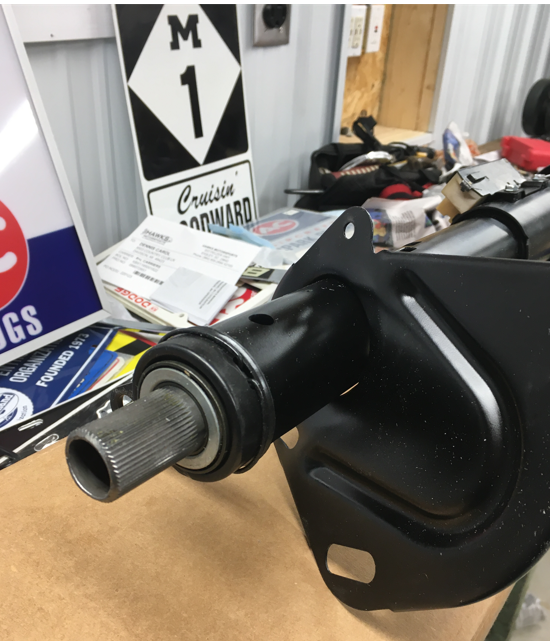

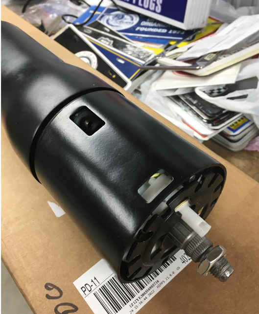

This past weekend was perfect wrenching weather. I got some time on Lucy. It took both days to get the steering column out. Getting to the transmission shift linkage cotter pin was a huge pain in the arse. Also disconnecting the steering shaft required jacking the car up and loosing the bolt from under the car with ever 3/8" extension I had at the garage. I am still not sure who the genius was who thought the foot plate at the firewall should include a grommet with a vacuum line and the speedometer cable going through it was a good idea.
Also, I will tell you know that the A-body and F-body columns are not identical!
I got to looking at the pin layouts between the new and old ignition switches between the columns. They are not the same, so I moved the old switch to the new column.
The shafts to engage the transmission linkage is different. The A-body is Z-shaped, the F-body is straight. Also the F-body has this metal footplate welded on that I am going to remove. I've started to drill out the spot welds.
I also moved the neutral safety switch from the old column to the new column along with the hazard flasher button.
At this point I need to rent a special tool to remove the face plates on both columns to get to the turn signal lever. I need to move the original cruise control/turn signal lever and move it to the new column. That is a $20 rental at Autozone.

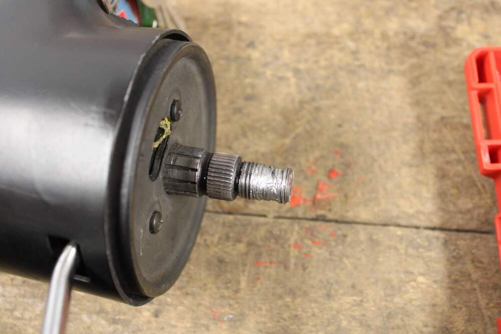

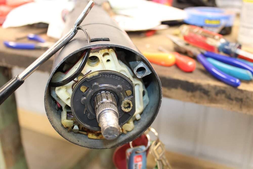

I spent yesterday wasting almost 4 hours getting two fricking retaining clips off two different steering columns. I started by buying a $20 steering column lock plate removal tool. Getting the lock plate off the new tilt column - no problem. It took nearly an hour to get the retaining clip off.
Remember those mucked up threads on the old column? Guess what threads into those threads? Yup the steering column lock plate removal tool. There are only 2 good threads left at the beginning, so the tool kept flying off into me under too much pressure. That was fun! Getting the retaining clip off the old column - what a royal pain in the ass. However I prevailed after well over 2 hours working on it. I finally got it off!
Beer time....or at least in my dreams!

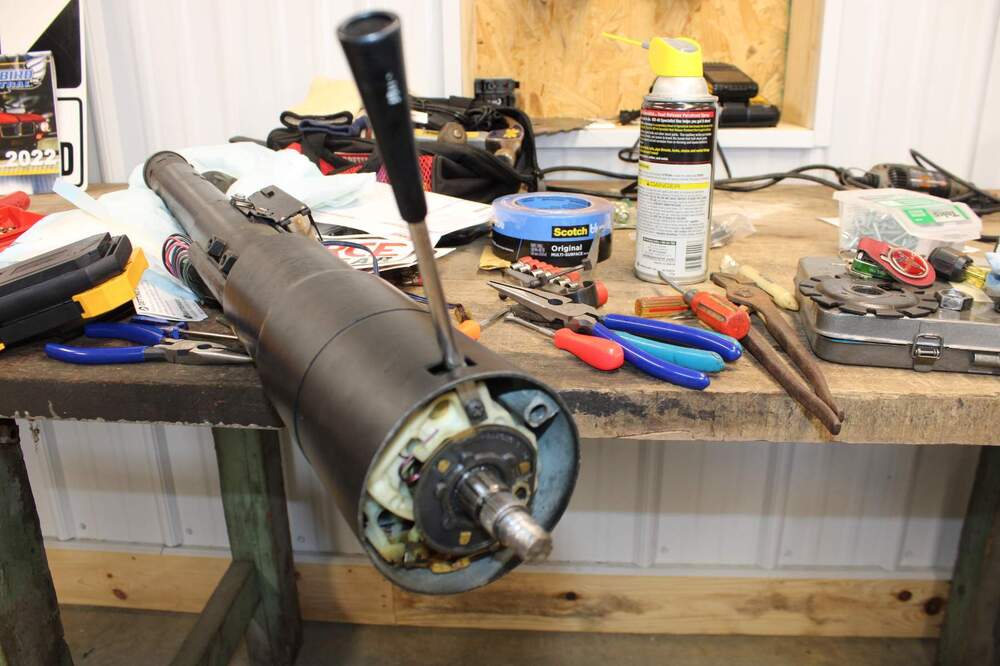

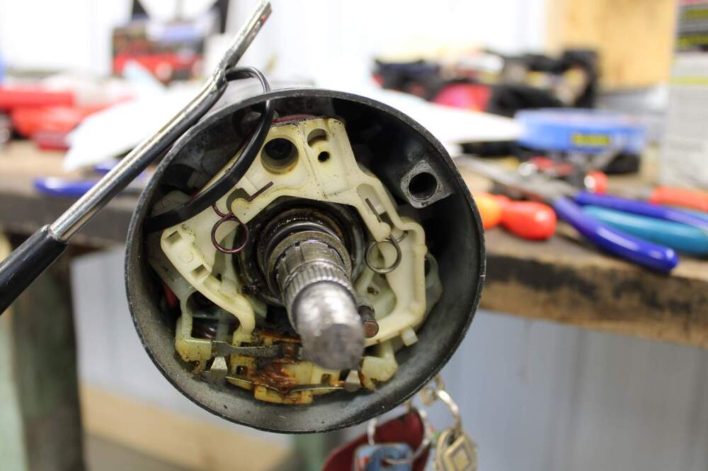

I was able loosen and slid out the turn signal cancel cam assembly so I can remove the turn signal/cruise control lever and wiring. Right now I am swearing trying to get the ignition cylinder lock assembly out. Turns out I have the same problem this guy has in the video.....and similar cussing problem too. Therefore I need to punch a similar hole on my column in order to get to the cylinder lock retainer spring. In fact, the service manual talks about this casting flash....so why is it there????? Poor casting quality? Probably.
Here are the gacked threads on the old column before I remove the plate. Yeah JUSTA - this is an epic fail on my part!
Here is the new column, protected by painters tape to prevent me from scratching the paint any further (yes I did scratch it already - dang it!). See how nice and pretty those threads are?
Retainng plate and clip is FINALLY off the old column! What a struggle! Cruise control turn signal is still in place. I still have to slide off the black collar and the spring behind it.
I tried to remove and slid out the turn signal and it's wiring. No dice. I have dig further.
I removed the collar, pressure spring, removed the 3 screws hold the cancel turn signal cam assembly and slid the whole thing as forward as possible in order to get the turn signal out and get access to the release spring for the cylinder lock assembly.
