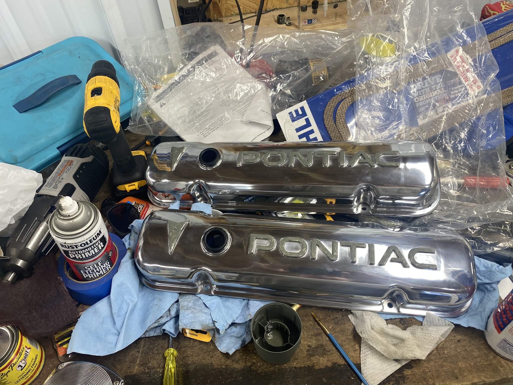

I spent some time this weekend doing "arts and crafts" work. I've had this set of chrome valve covers for quite awhile now. I never installed them since Lucy wasn't running. However, now that she is, I can work on other things. I dragged out my 10-year old, never opened, One Shot pinstripers paint. First I took a Scotch Brite pad to the letters and arrowhead on both covers. Next I sprayed some self etching primer into a cup and hand painted the primer over everything. I let that dry over night. On Sunday, I mixed some paint and hardener into a Dixie cup and hand lettered both valve covers in Fire Red and Process Blue. I will probably need to do a second coat but I am letting it set for 24 hours first.

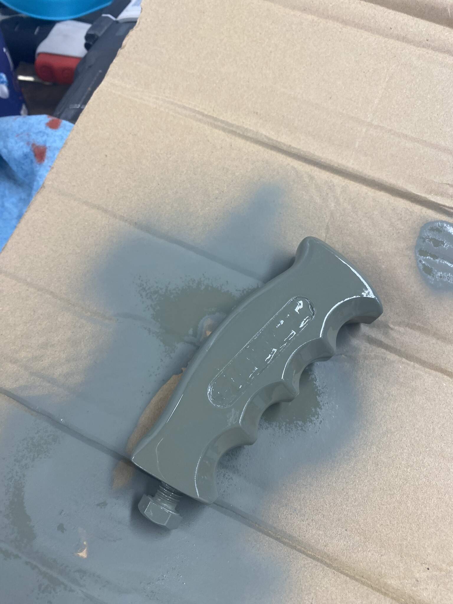

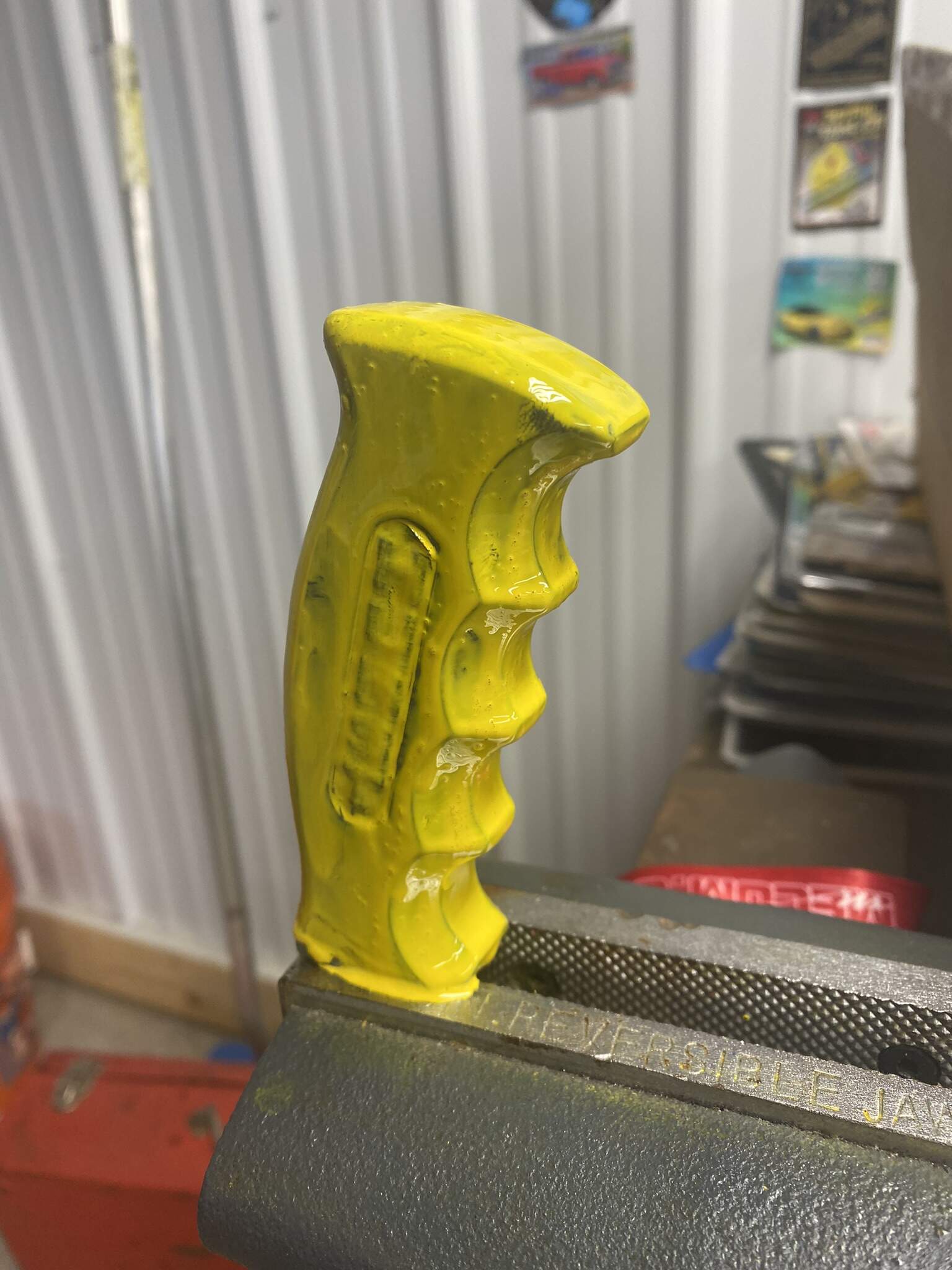

This was not the only art project I started either. I decided to create a faux wood on my aluminum Hurst pistol grip shifter. I have started with the Scotch Brite bad, some self etch primer and a first coat of yellow.

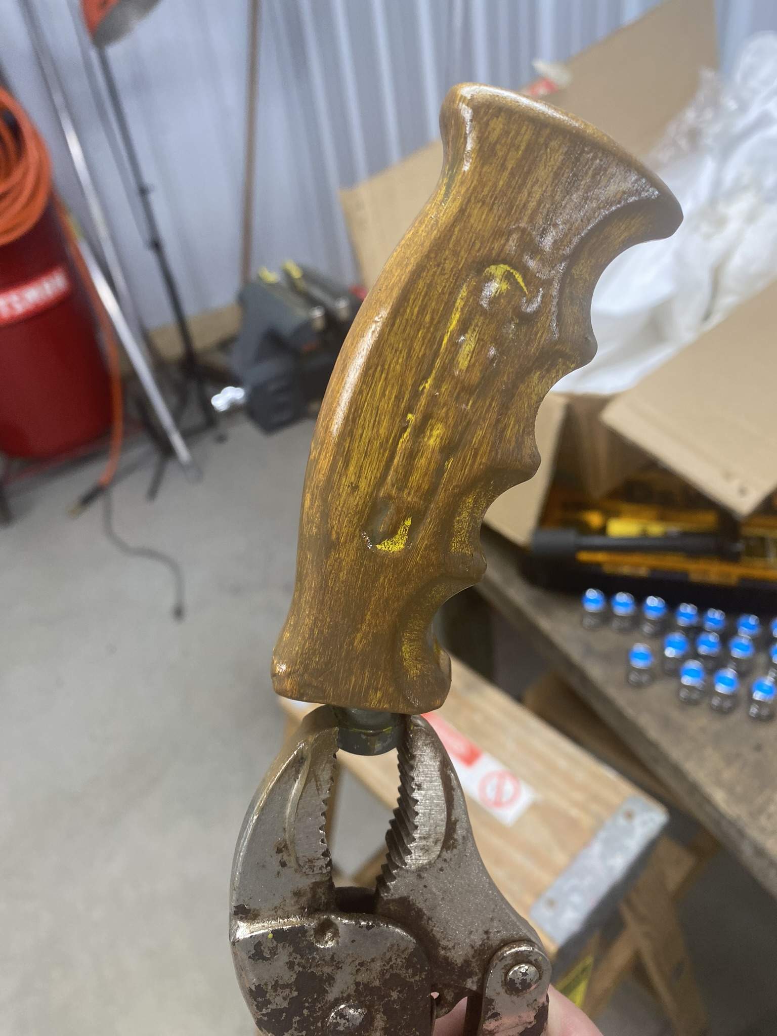

Here is the shifter when I started the night.
Here it is after I finished making some brown paint
IMG_1013.thumb.JPEG.8dd6001c5e3491cec2c826e43086fb00.JPEGIMG_1014.thumb.JPEG.28a854b8605e39a25dadd4f4db3f6141.JPEGIMG_1015.thumb.JPEG.45c28a6d78ce14103305f94cc5fb3471.JPEG
I still need one or two more shades before I am happy with it.

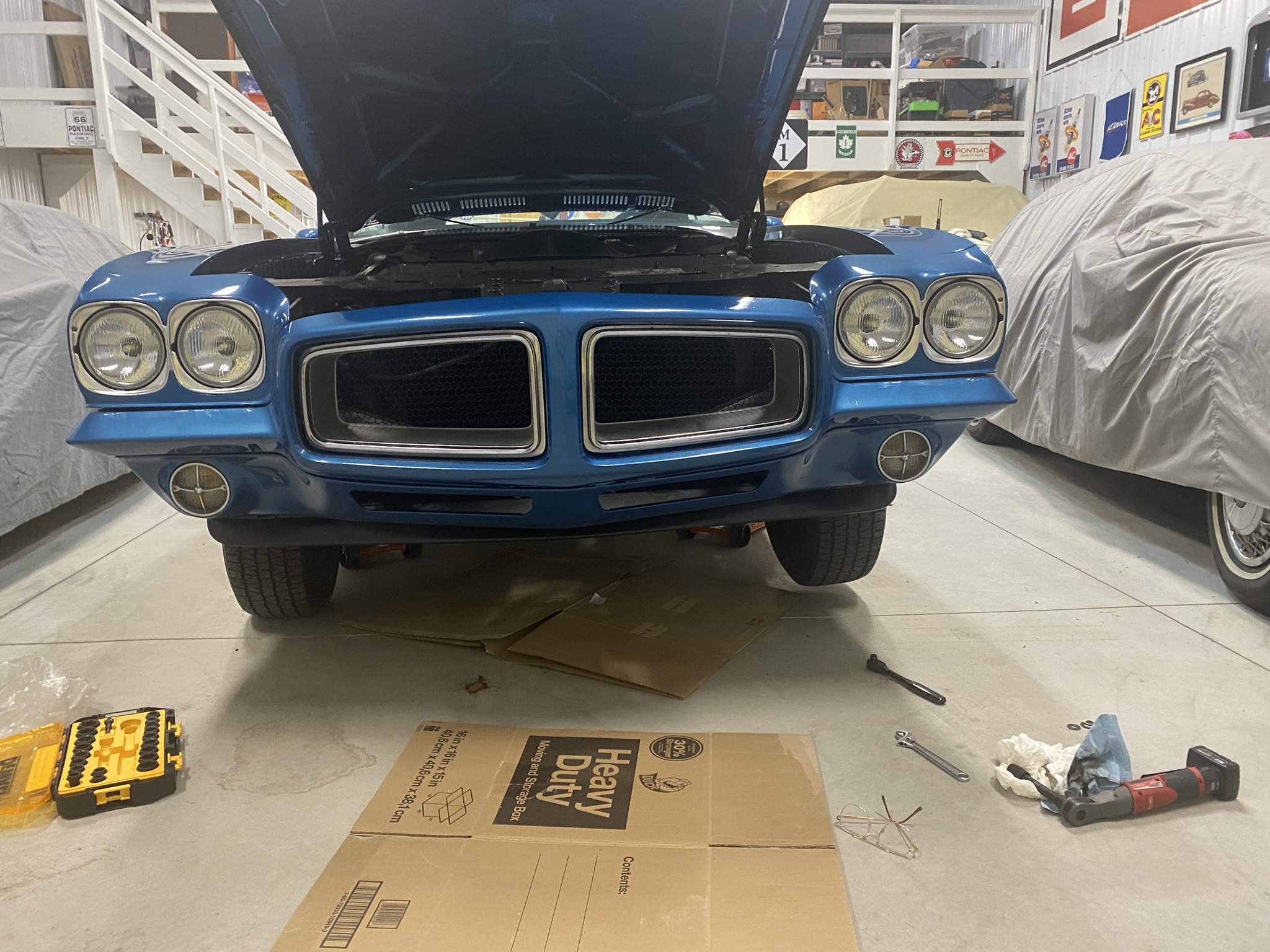

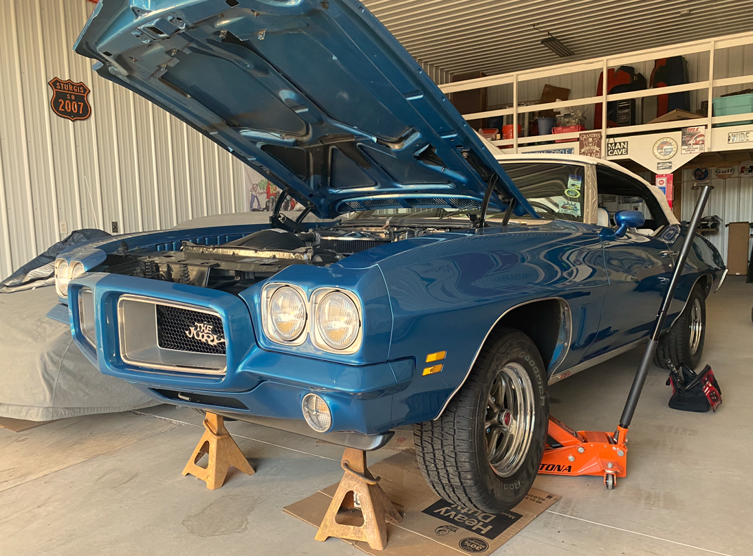

I also installed my Judge front air damn on Lucy! Indyman Joe inspired me to install mine.

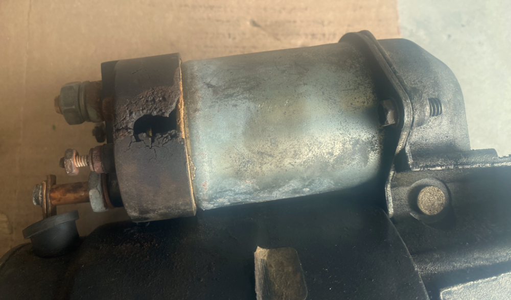

Well this Memorial Day weekend is NOT going the way I had expected it to. Lucy throw me a curve ball on Friday night. I went to my local cruise, where I volunteer as the cruise's photograph. It is less than 1/2 mile from the Garage Mahal. I ran Lucy down there but when it came to leave, she was a no start, no crank. Just click. Lights work, radio and headlights work. I get her towed back to the garage by AAA.

Saturday I tried replacing the ignition cylinder since the guy that got Lucy running had some issues with it (original key cylinder) into a new column. New cylinder lock did not change anything, still no start no click.
I spent the rest of Saturday jacking up the car and slowly removing the starter so it wouldn't crush my skull while on my back. I got it down but not disconnected before I decided to call it quits. It was almost 10 pm when I quit.

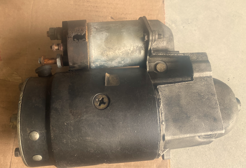

Today I got up, finished my household chores and went back to work on Lucy.  I got the starter disconnected. I am no ace mechanic but I am pretty sure that a starter solenoid is NOT supposed to look like Apollo 13.
I went to three different parts stores. Do you think any of them had a working starter bench tester. Nope. I replaced the solenoid but without a working bench tester I couldn't validate if it works on not. I also ended up buying a replacement starter too. Before the evening was out, I was able to hook up some jumper cables to the old starter/new solenoid and used a screwdriver to jump it and it ran! I hooked up the old starter to the wiring without bolting it back to the block. I hit the key - nothing.
In the morning, I will get up and try to troubleshoot the ignition switch on the steering column. Other than wiring, that is all that is left to troubleshoot.
I also checked the positive cable to the battery for any burned insulation. The positive cable was not mounted correctly since I got the car back and the oil plan had been changed. In 2002 I had the positive cable rub against the exhaust manifold, melt the insulation, and ground itself against the hot exhaust manifold. Thus causing a hot engine, no crank situation. Once it cooled off, things contracted, the wire didn't touch to allow the car to start. Since then, I insure there is correct routing to avoid rubbing.
I have finished painting the Hurst shifter knob in a faux wood (like the original pistol grips use to be). I don't have a photo of the final product yet since I've applied 3 coats of clear coat to it today and it was drying when I left. Here is what I have thus far. The Hurst outline will be black and the HURST lettering will be the original aluminum silver.

The starter is earthed on the car, isn't it? This was an oversight I endured when my freshly rebuilt engine wouldn't turn over. You got the right smaller wires on the right spots on the solenoid? A mechanic wired mine back to front. 'S' for start and 'R' for...something else.
Do the dash lights dim when you hit START? If so, starter issue. If not, wiring issue.
I know you already know all this - I'm just thinking out aloud.
Correct Fitzy. I have not noticed any dimming when I hit start.
Thanks for doing the mental checklist though. I appreciate it.
R for run.
justA check your power from ignition switch at the teminal for the starter Frosty, if its no power, i would be pulling your ignition switch and replaceing it ... is yours the type mounted down the coloum and the ignition barrel operates a rod to the switch its self like a f body does ?
