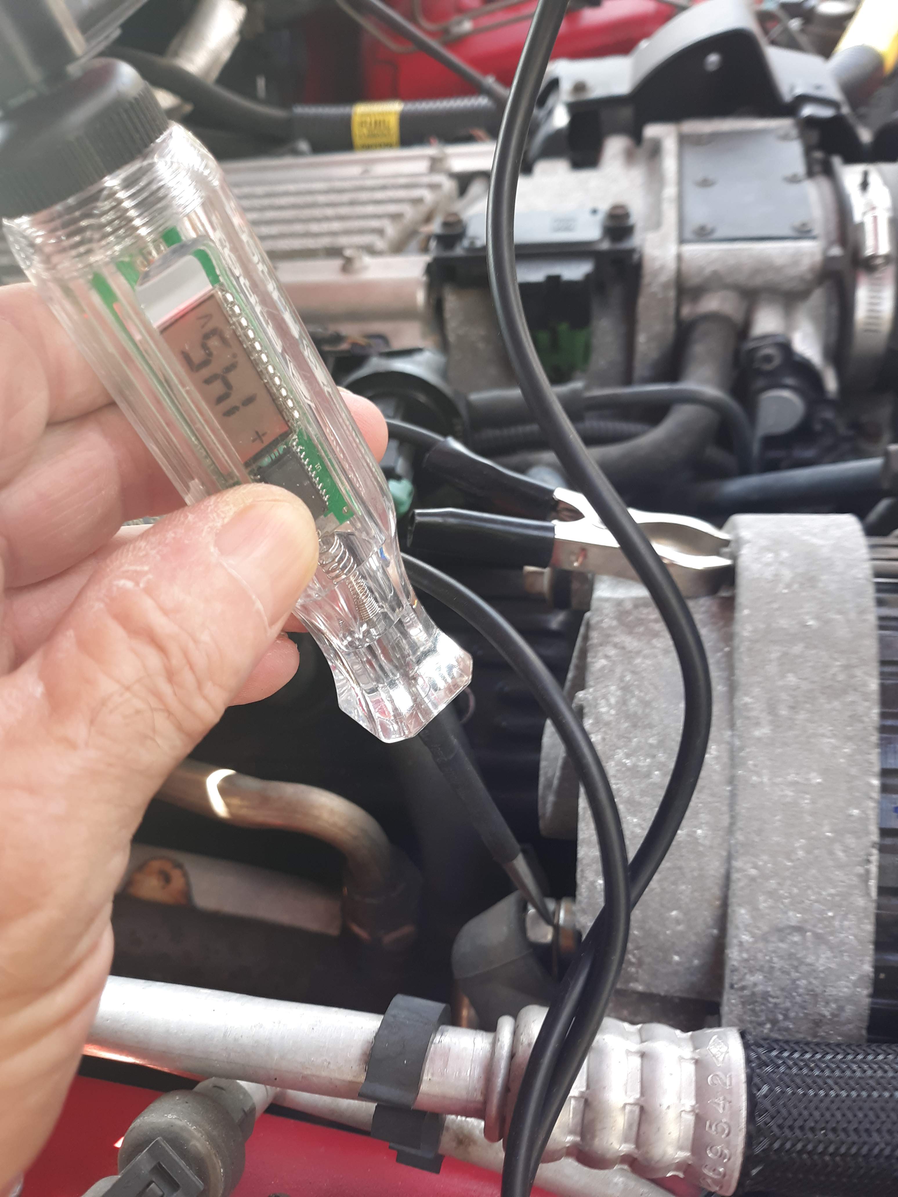

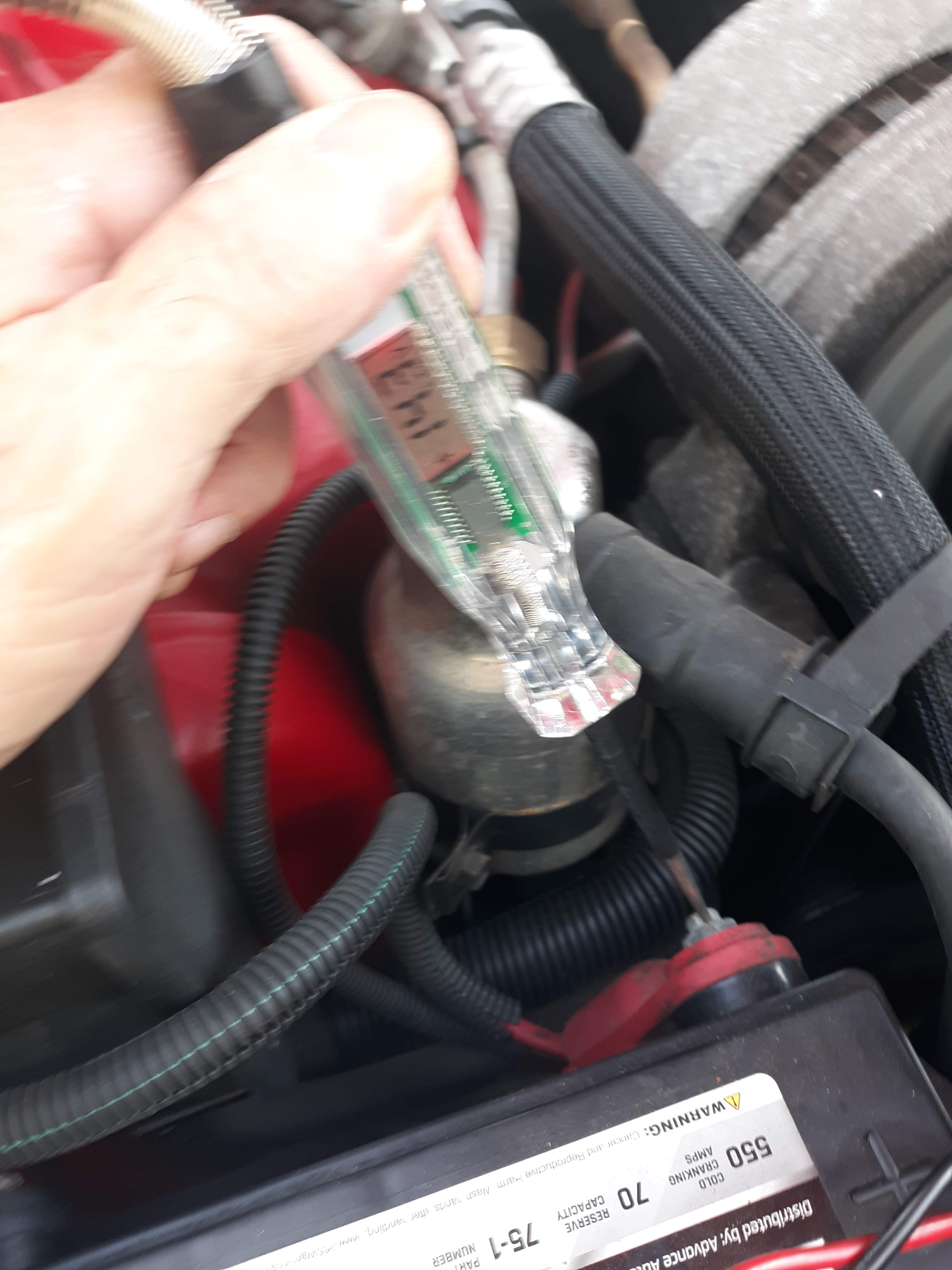

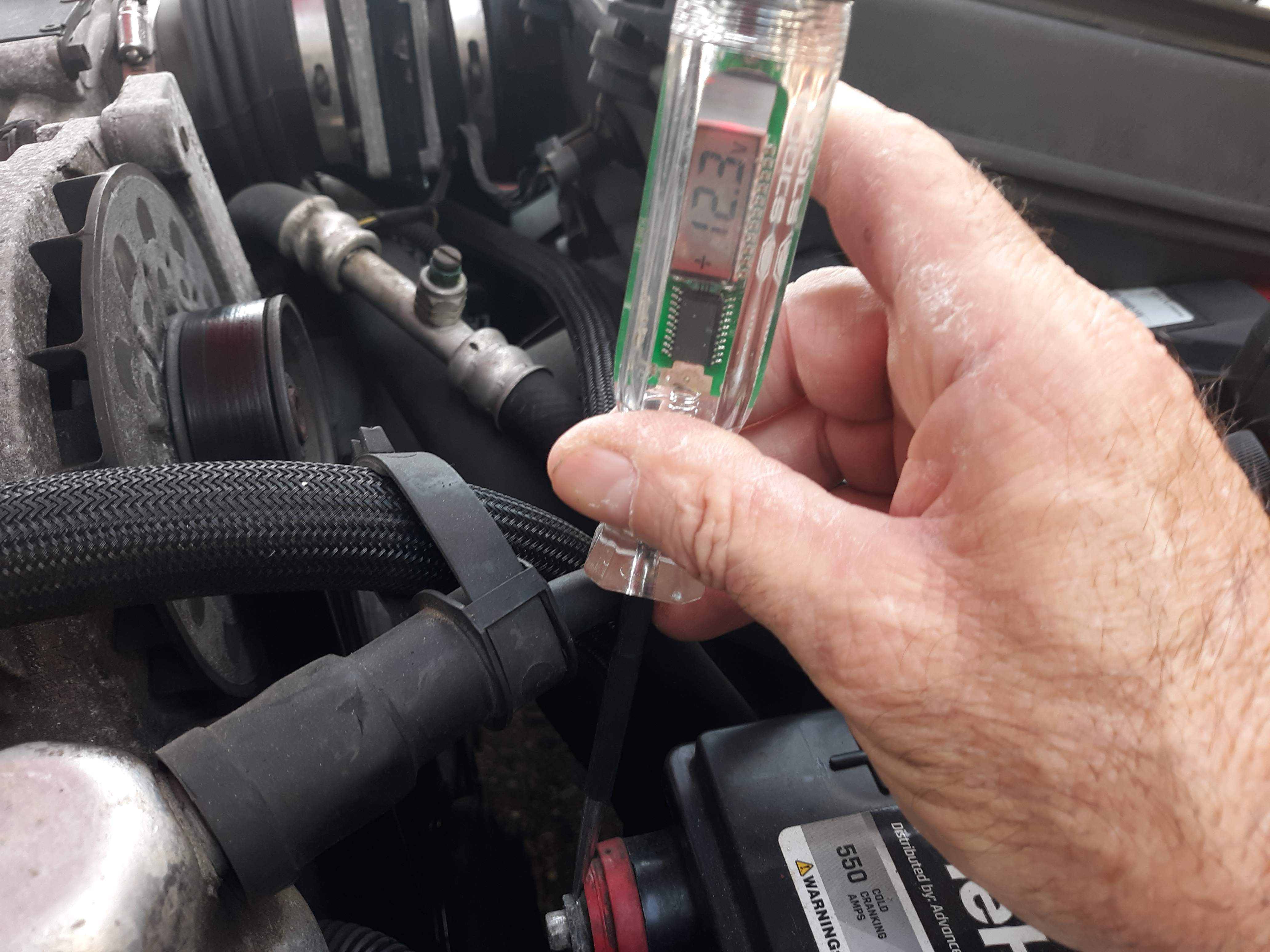

17233869772643822642007883902275.thumb.jpg.30133761db9e021b31cc95c148af6743.jpgA really good/easy way to check the health of the Battery...First thing...Make sure that the battery is fully charged...Using a Multi Meter check the battery at the terminals...If it shows a 12 volt surface charge that is good...Then have someone turn the key and try to start the engine (loads up the battery)...With the MultiMeter still on the battery terminals...If the battery voltage drops off significantly (10 volts or less) while starting the engine...That is a very good indicator that the battery is on the way out/Done For...
17233872572866394439986060244987.thumb.jpg.46f845f4c29c8d74ee9028c30e8a93a9.jpgIf you suspect an Alternator issue...With the engine running...Using the multimeter check the alternator output right at the alternator itself..Place the positive lead of the meter right to the stud where the main red wire hooks to the alternator from the battery...Then simply put the ground lead right to the outer case of the alternator....It should indicate somewhere between 13.2 and 13.5 and 15.1 or 15.2 volts...Any less and the alternator will have a hard time keeping the battery charged...If it shows anymore than around 15.1 or 15.2 volts indicates that the internal voltage regulator is letting the alternator overcharge and will eventually cause the battery to boil over...If the alternator checks out OK...Then check the voltage at the battery 17233873679587654739824077855927.thumb.jpg.6285348e7a252286bb8fc76a4f39c0f0.jpg17233875150292063742171767125262.thumb.jpg.61485a8411982b66e9c5ef352d37a3a1.jpgIt should be reading really close to the same voltage as the Alternator is putting out...If not...That indicates an issue in the wiring between the alternator and the battery...(high resistance/loose or corroded connections... ETC..)
Finally....Another check to perform on the alternator (diodes)...Is to disconnect the ground cable at the battery...Then put a 12 volt test light between the ground post on the battery and the end of the ground cable...if the light is brightly lit that indicates a parasitic draw on the system...If that is the case...Unhook the plug from the (top/side) of the alternator if the light goes out when the alternator is unplugged that can indicate that there is a bad diode in the alternator...
Was unable to photograph the load test....Because I have No one to start the car...

One other thing that I forgot to mention...If everything checks out electrically...Taking out a degree or two of timing...Could very well help/eliminate your slow starting issue...Especially in Hot weather....

nice explaination two lane :bowdown:
and a nice easy way of load testing that optma !

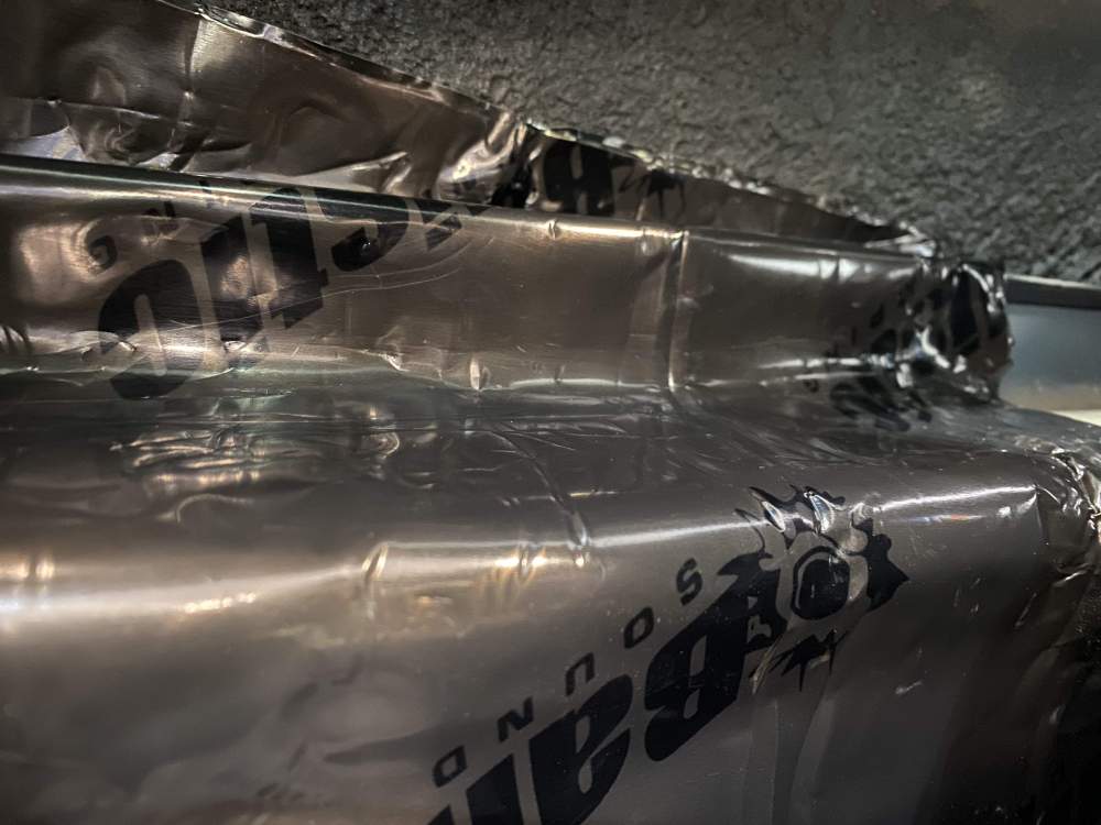

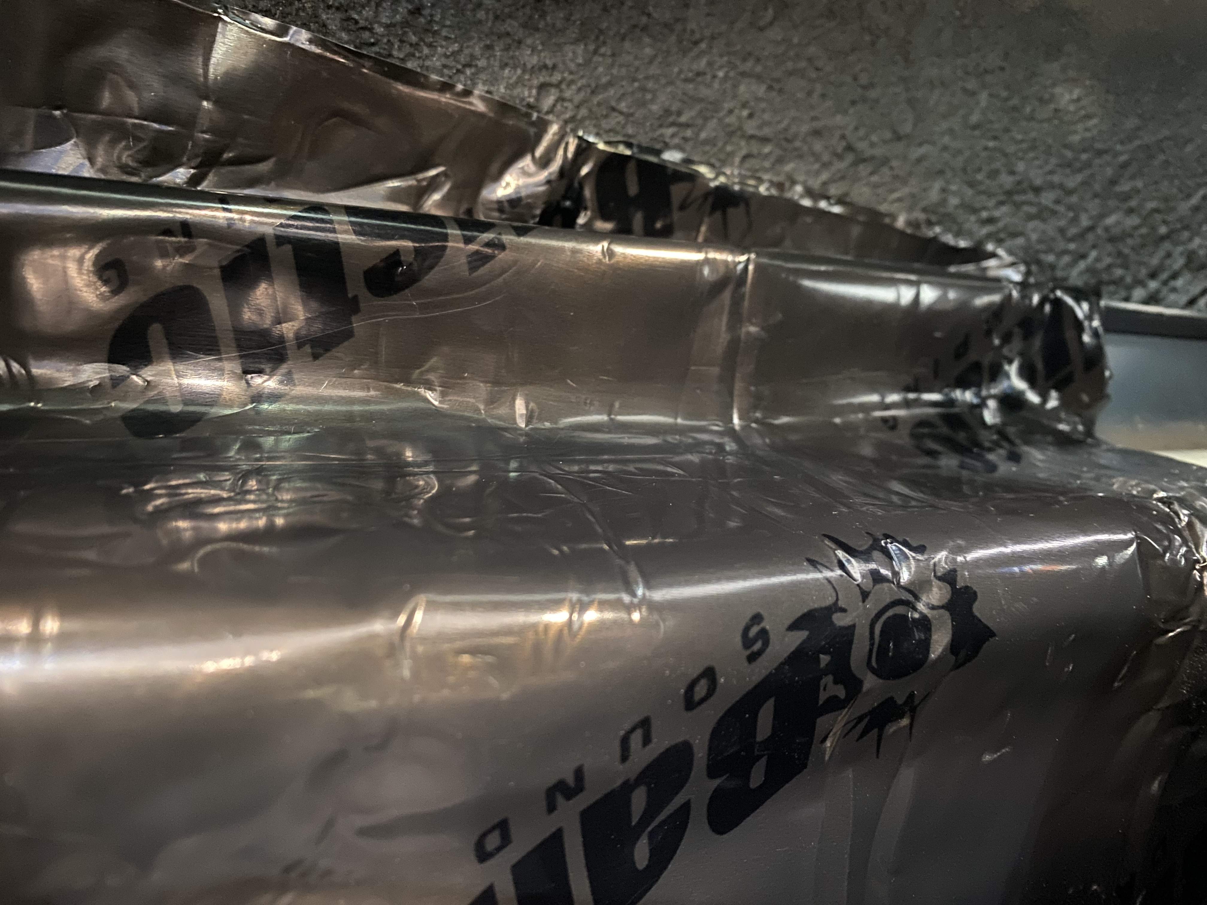

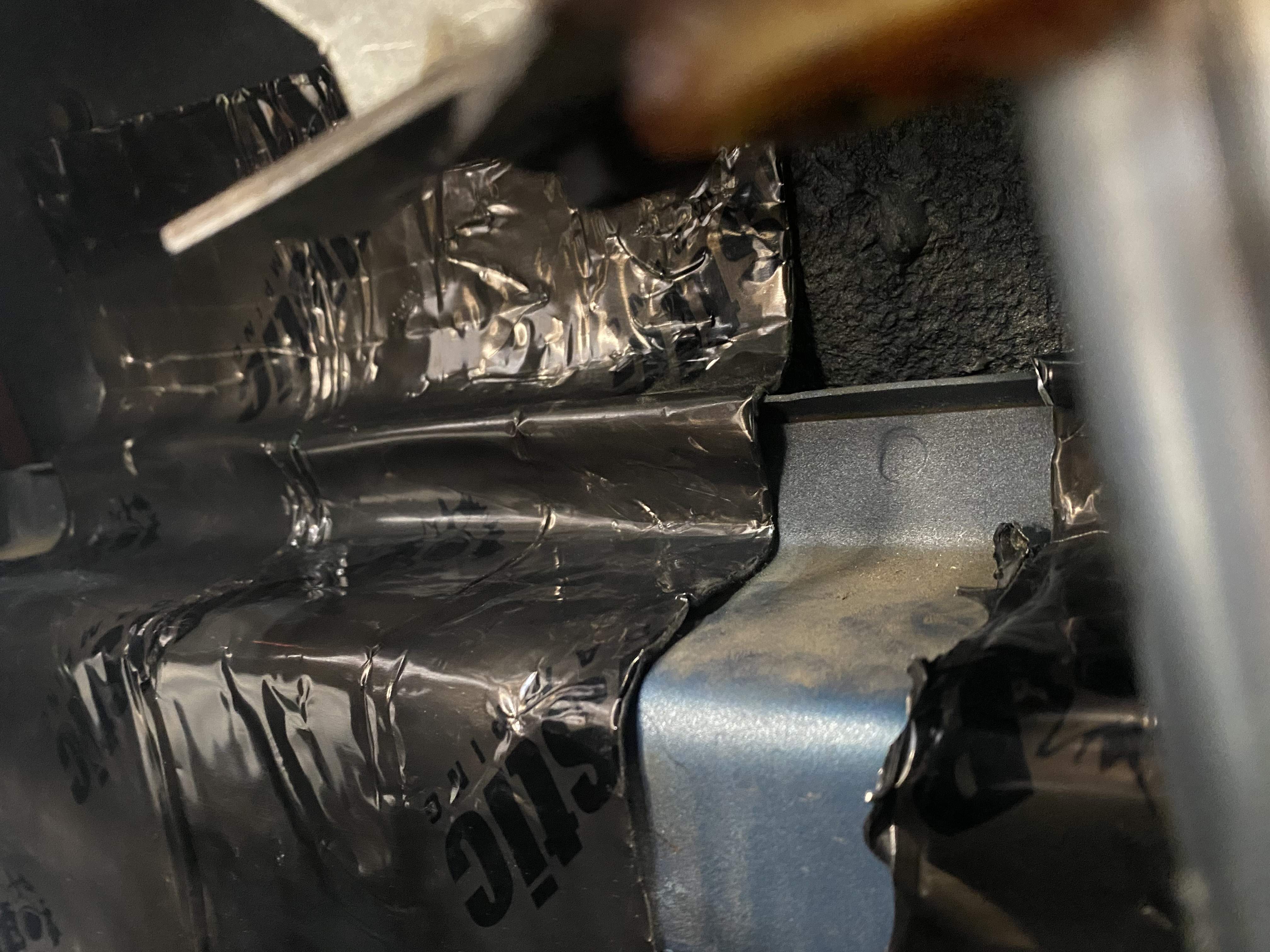

First thing I did was I disassembled the driver door. I installed dynomat inside the door. While the door card was off, I used Gorilla glue to put the carpet that was coming loose back on. Once the glue was dry, I used some black touch up paint from BB to clean up the door card.

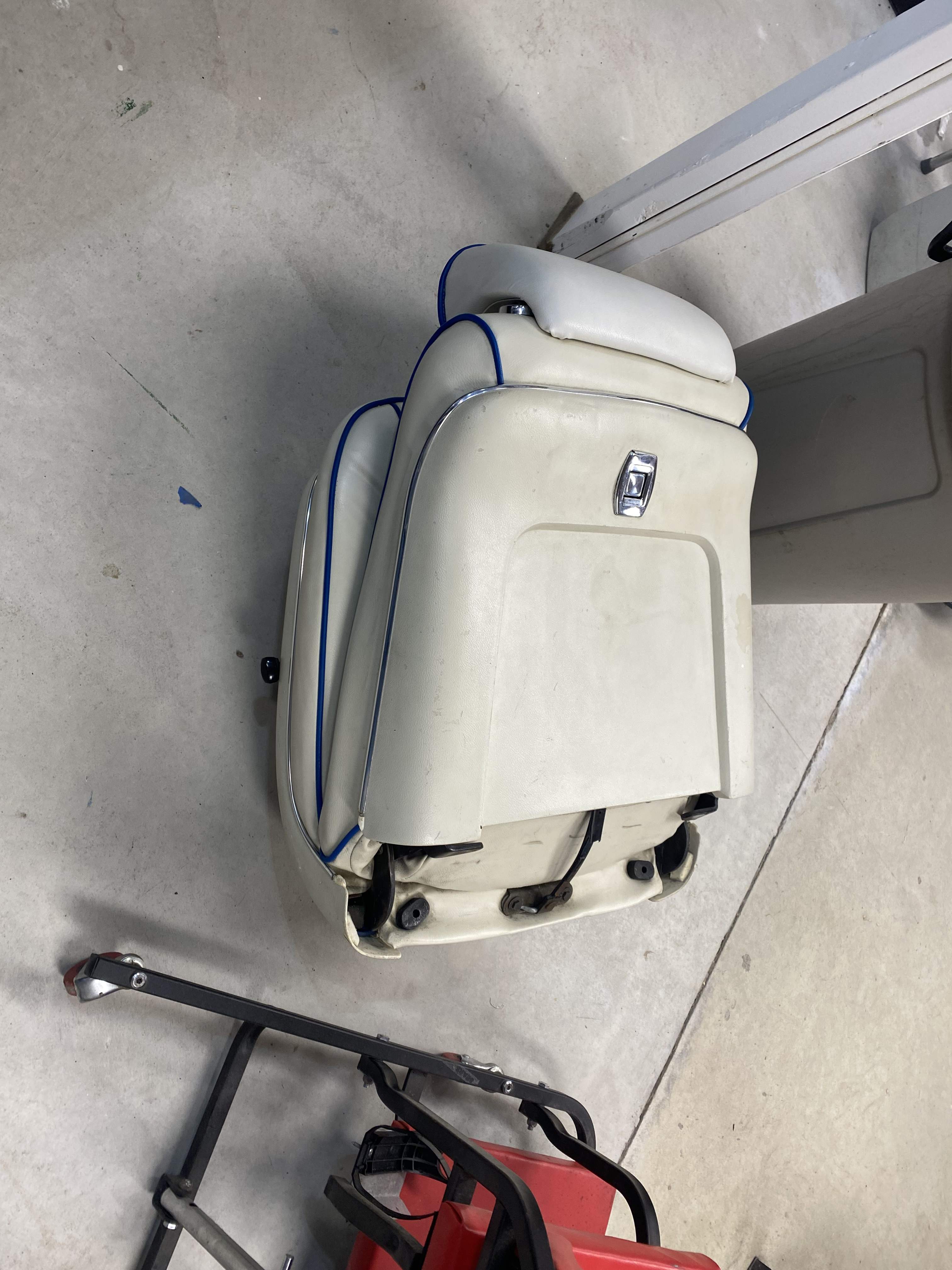

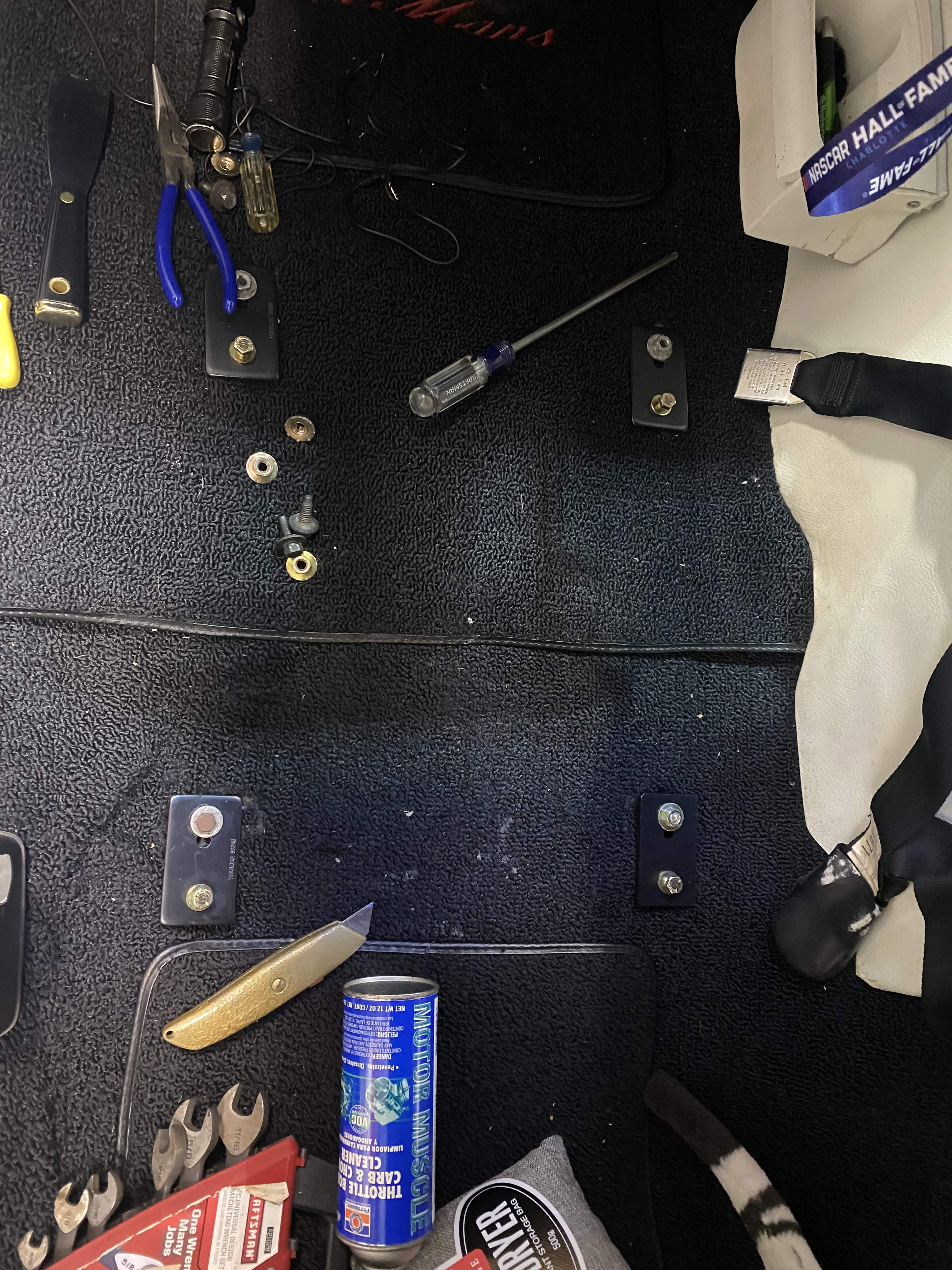

Once the door was back together, I removed the driver seat and I installed a two inch seat set back plates to move thecseat rearward two inches. I got this kit from YEAR IMG_3077.thumb.jpeg.e25f7c74847978d17091f0dfd40131d2.jpegIMG_3076.thumb.jpeg.6e7702de347ab031d77e093d05c75cc6.jpeg

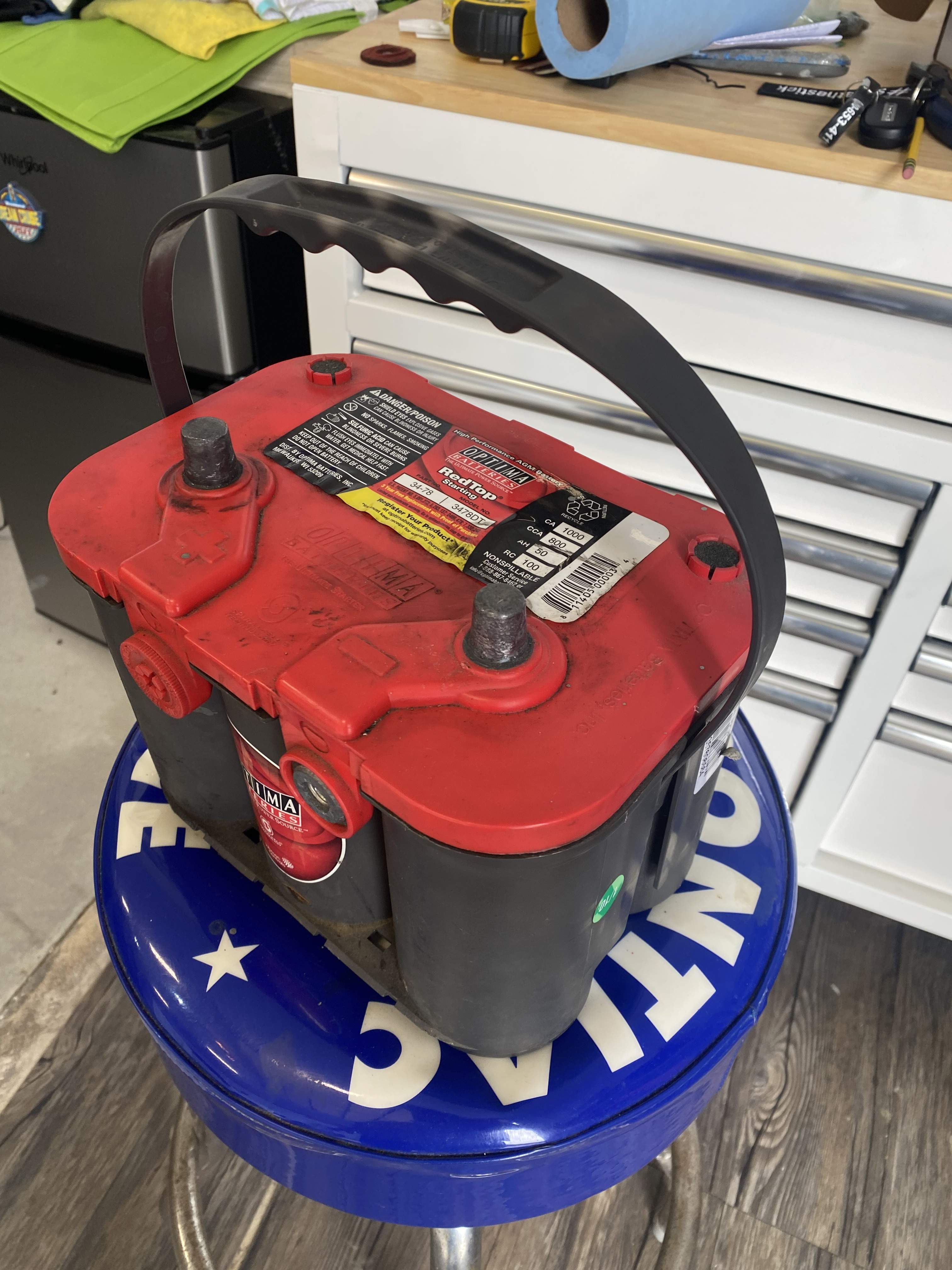

Well today was another unmitigated disaster. I jumped in Lucy and she would barely turn over. She’d weakly turn over and then stopped cranking completely. Ugh!

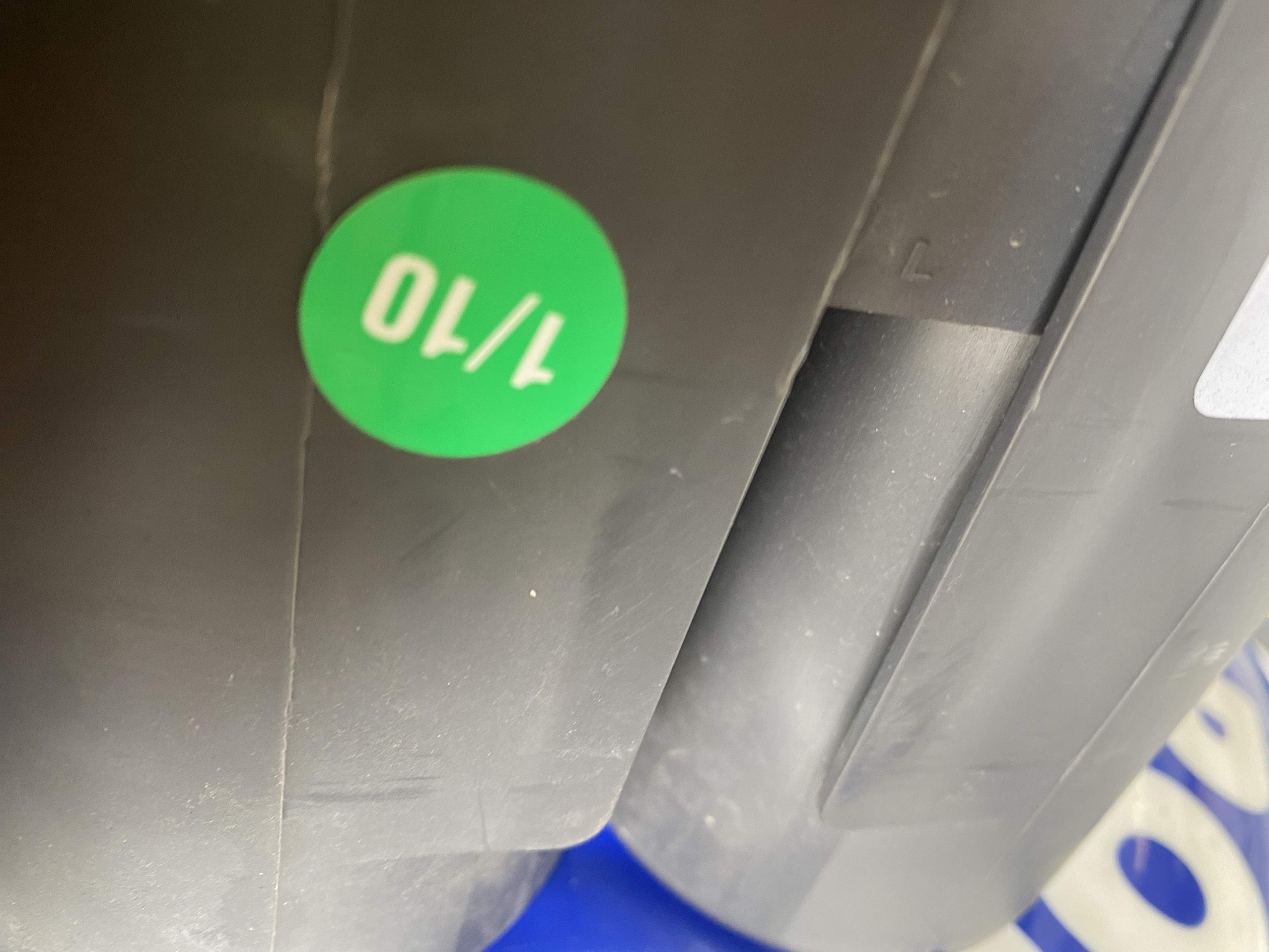

Now I have a cold start AND a hot start issue. F’ me! However I think I might know what the problem is……
Notice anything?
Yeah nothing like a 15 year-old Optima battery! They just don’t make them like that anymore!!!!!
Obviously I bought another battery and installed it. Vrroom! She starts right up. Imagine that!!!! So now I am wondering if my hot start issue is battery related too. I am going to drive the car some before I tweak the timing, justa to be sure.
