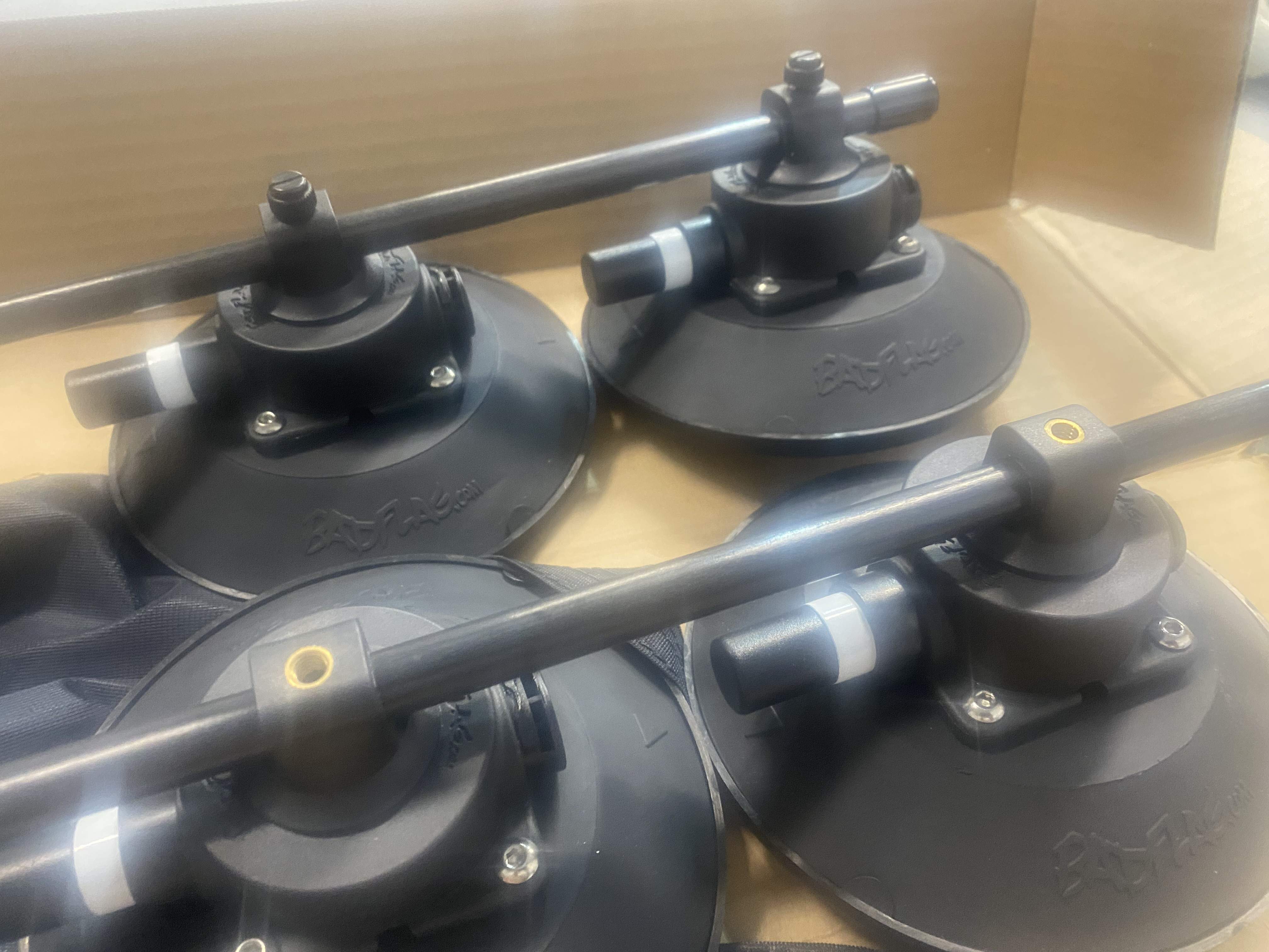

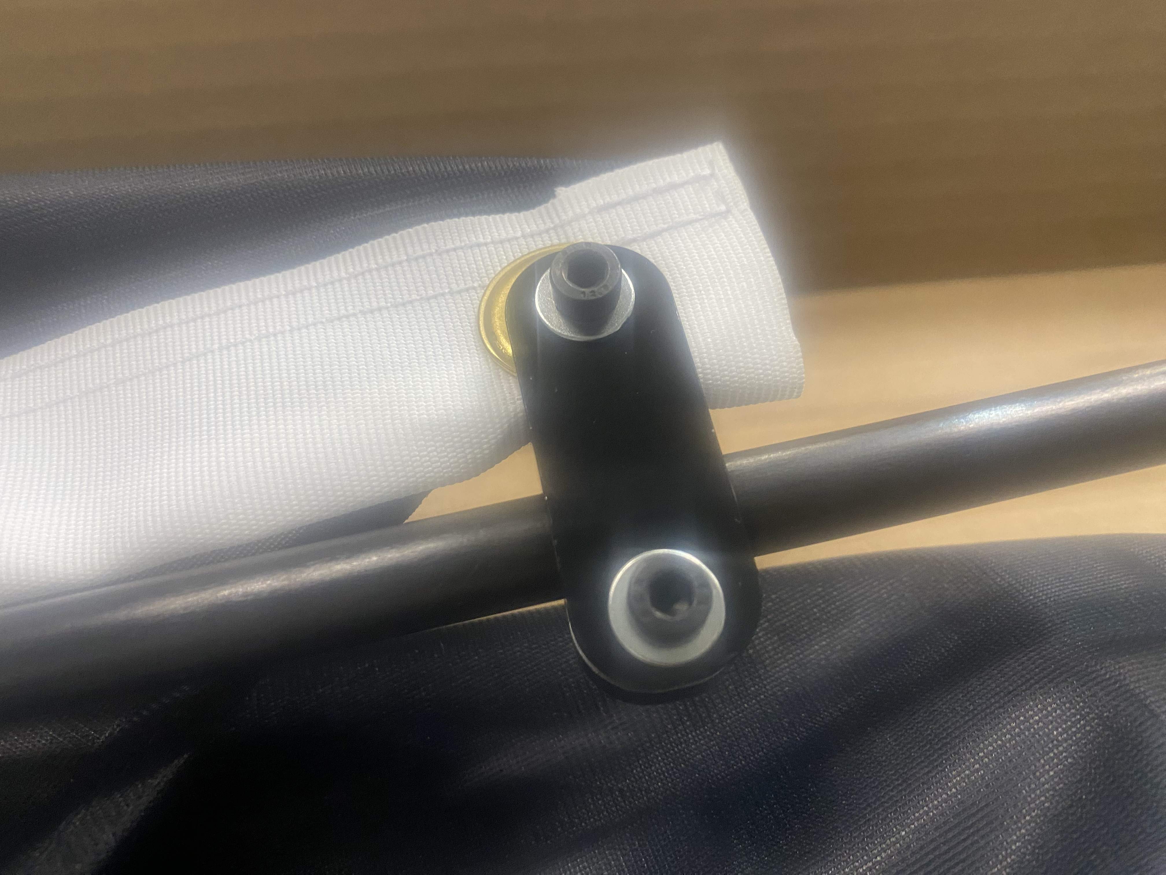

Here is the Badflag.com flag kit. Its suction cups which mounts a carbon fiber flag pole. The flag is held with aluminum clips snugged up with an allen wrench.
Those look awesome Frosty, and look really well made bro.

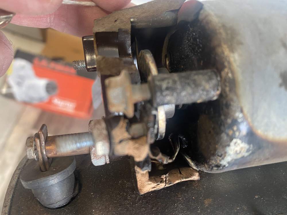

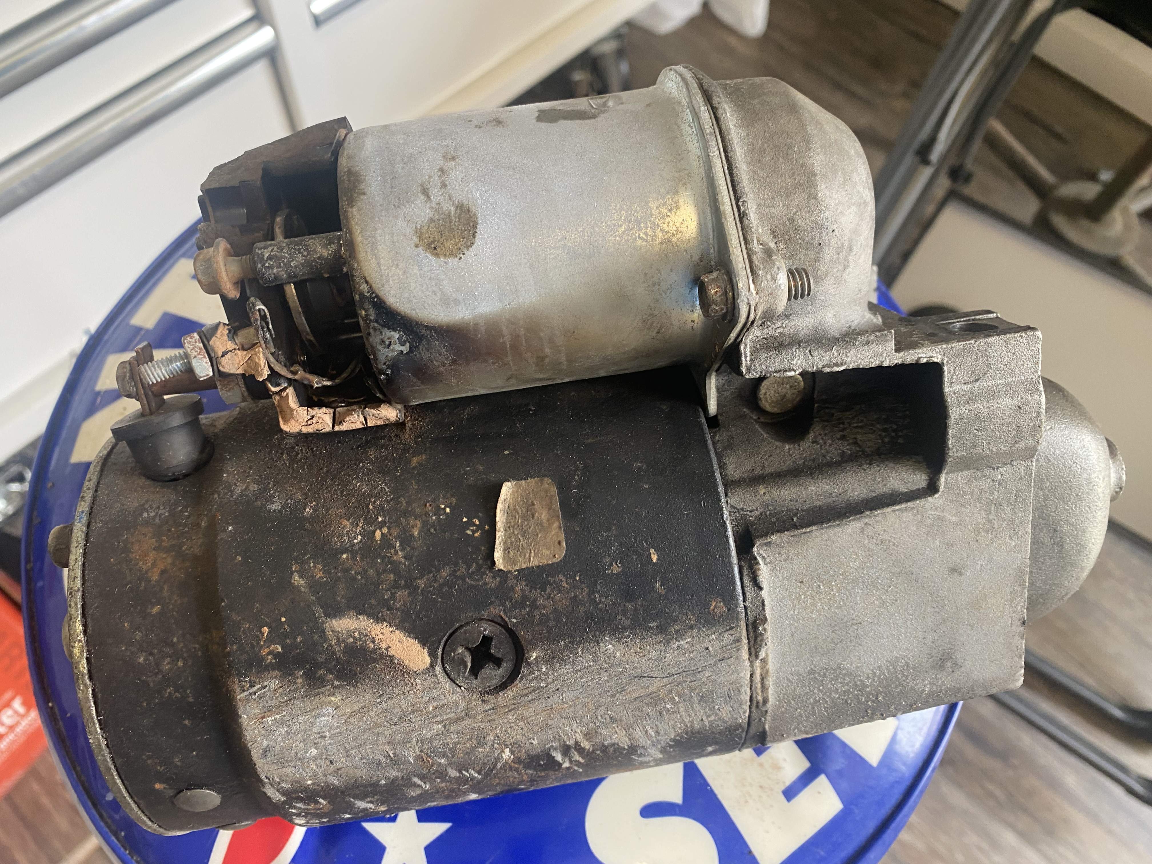

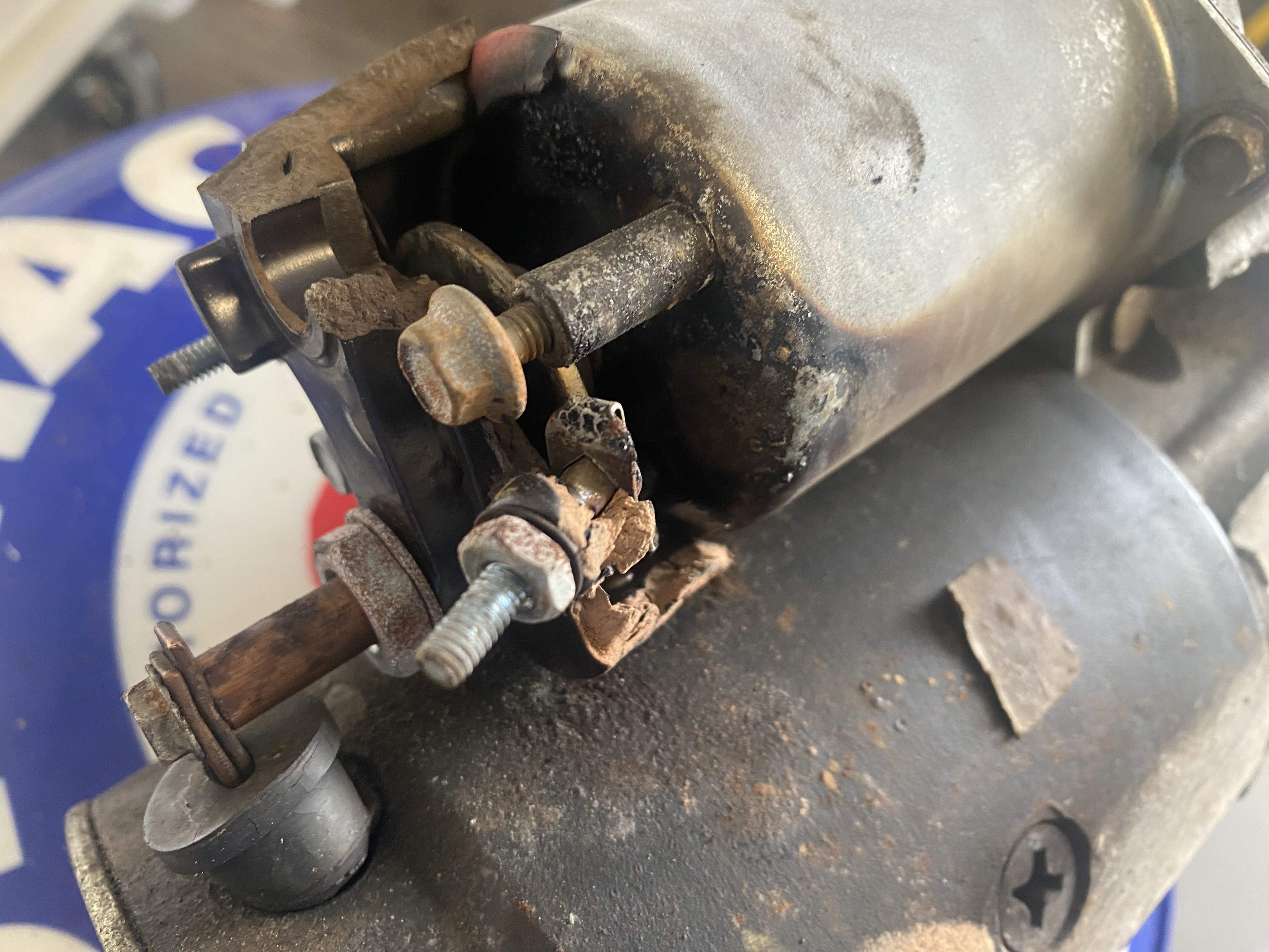

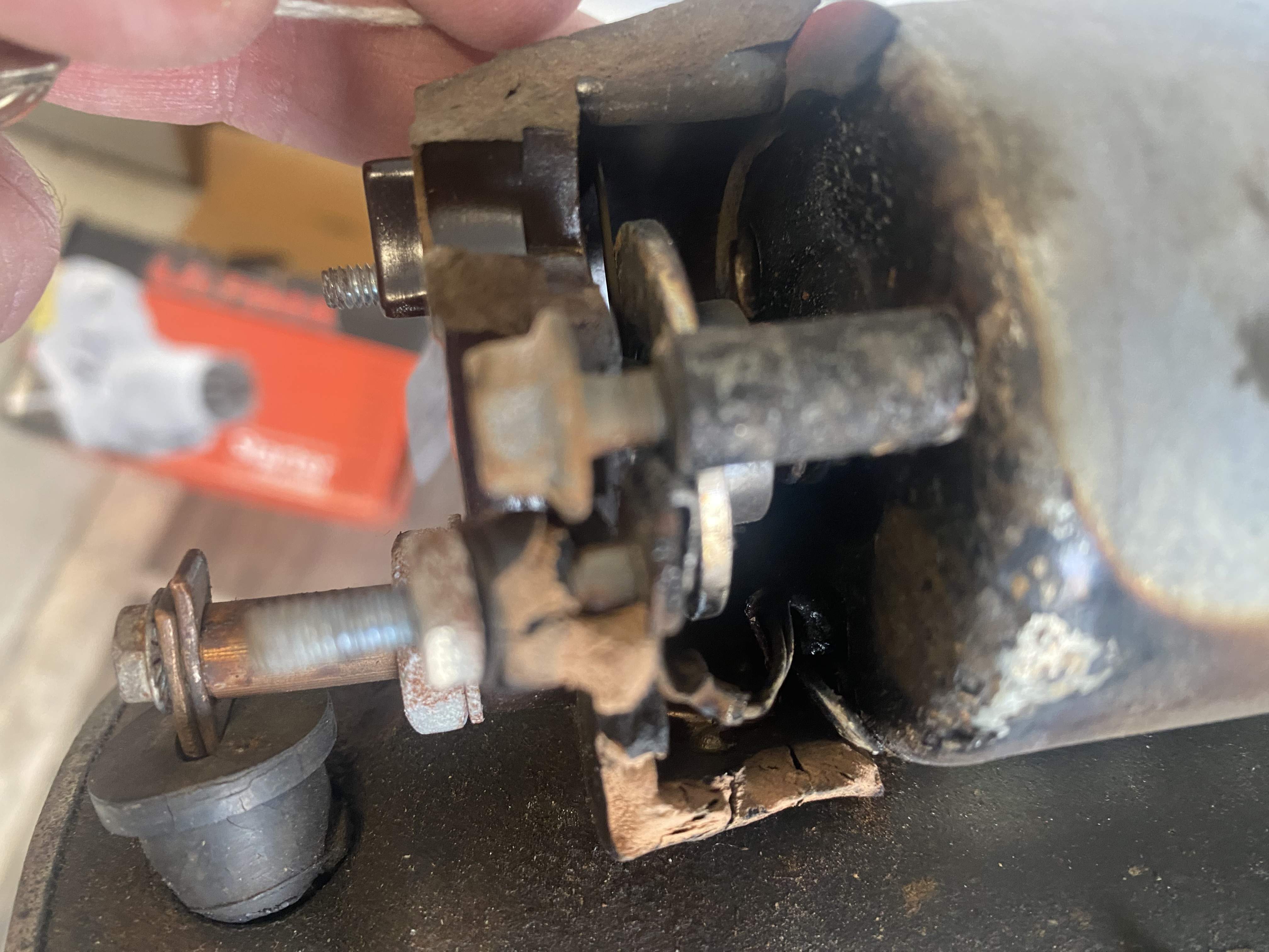

Lucy got another visit by the hook today at the garage mahal. She is back to misbehaving with another no start-no crank situation. I had her towed back to Flint Ignition, the same place that last year found the burned up wire between the neutral safety switch and the fuse block.
The mechanic/owner of the shop called me within 2 hours. "I think I found your problem....".

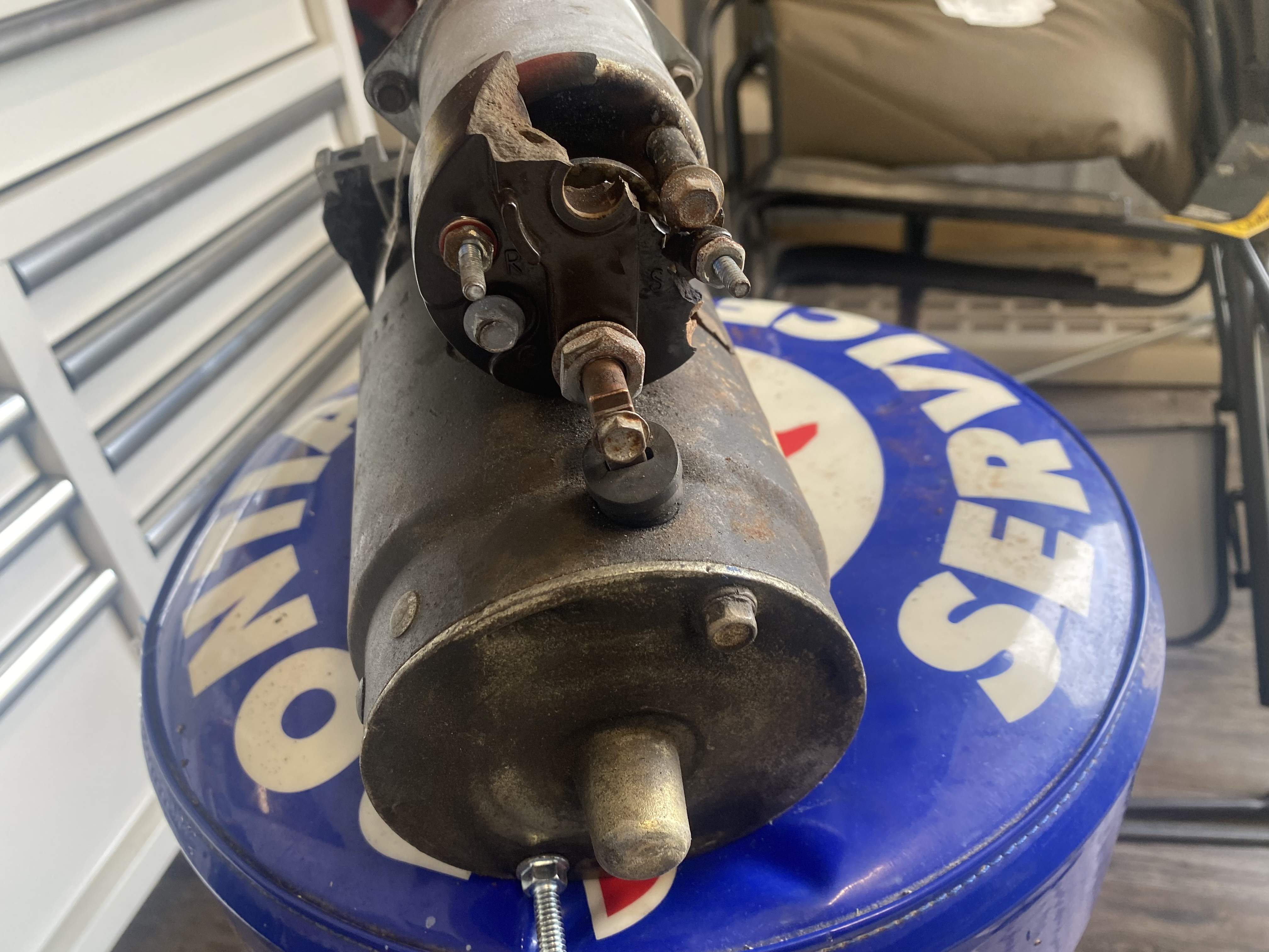

I am not a great mechanic but I am pretty sure this solenoid is not suppose to look like that. In fact, this is the same solenoid that I replaced 2 years ago because of a hole in the solenoid that looked like Apollo 13.
Here is the same starter 2 years ago.....
Clearly nothing is protecting the solenoid/starter from the engine heat - either from the underside of the exhaust manifold or the block. I am not sure why, after over 20 years, this first solenoid went bad.
I had purchased a spare replacement starter and solenoid 2 years ago. That new starter was installed along with a DEI starter heat shield wrap and metal zip ties. So hopefully this will be prevent this from happening again. I also hope this will also help my slow crank - hot start issue too. Otherwise I will have to switch to a mini torque starter.
The mechanic theorizes this is happening due to the inferior materials that this Asian knock off replacements are made of. Nothing matches an original AC Delco solenoid for longevity in his opinion. The problem is there aren't any NOS solenoids for these starters anymore, according to him. They practically don't exist. I am going to research AC Delco replacement solenoids and see where they are made.
One last thing....the timing is off. The engine dieseled and pop for a second once I got it back to the garage mahal this evening. I will need to check it tomorrow.
