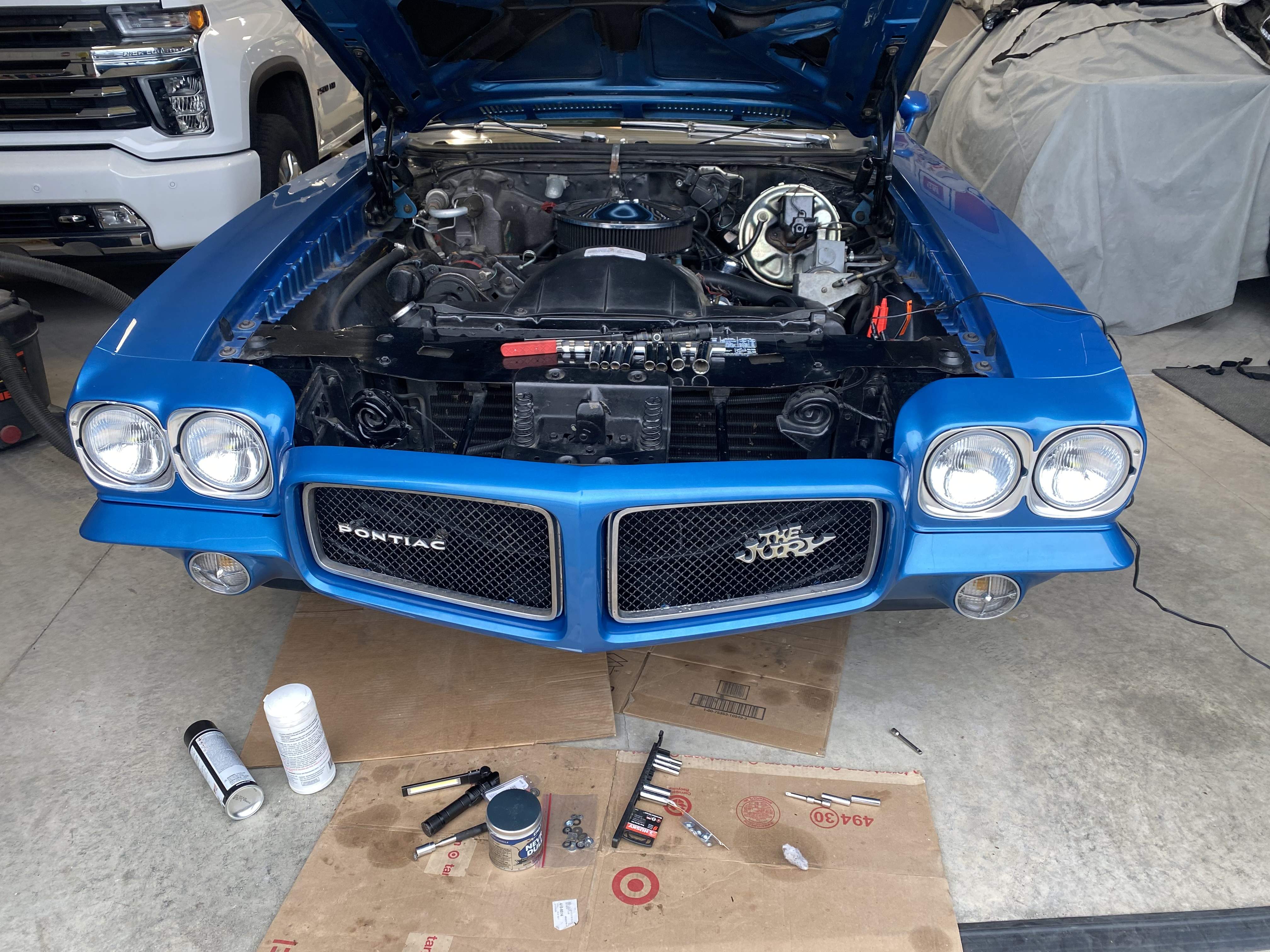

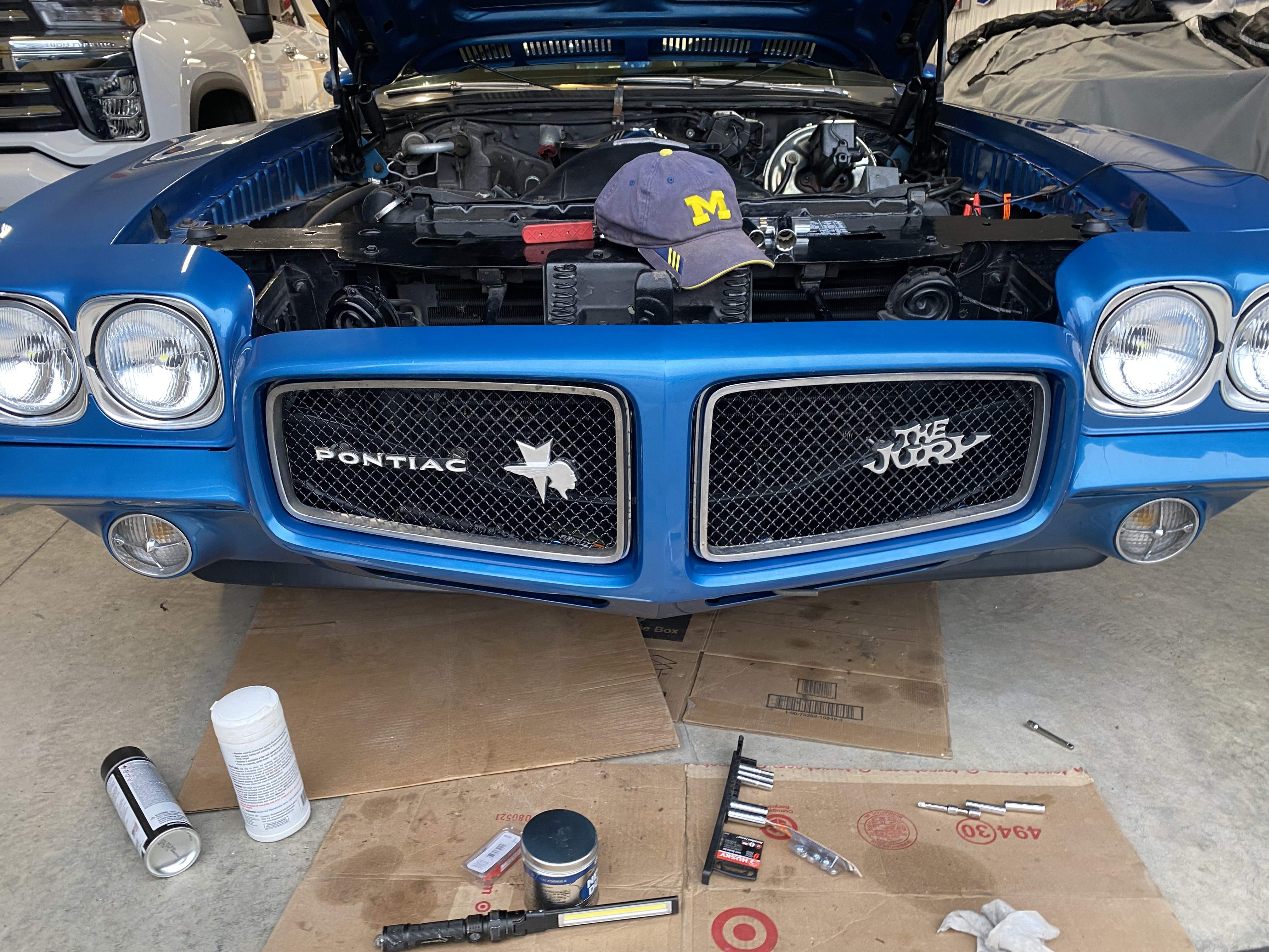

Getting the new battery took some time to drive around town to get a new Optima. By the time I got the new battery and installed into Lucy, it was about time for my boss to come home from her weekend long scrapbooking session.
After coming home and unloading her Hummer, the boss decided to see her parents. I grabbed the opportunity and went back to the garage. I decided to remove the stock ‘72 recessed grilles and put in the ‘71 Judge style grilles. Once I got them in, I added some of Last Indian’s jewelry to set it off!
IMG_3080.thumb.jpeg.10c00505cbed17e16d7fa39075ba2a8d.jpegIMG_3081.thumb.jpeg.87b360242d17586271919beaa9af57f9.jpeg
Next Saturday is the first A&W cruise in. I hope to take Lucy out as a shakedown run for my upcoming trip to WV in two weeks!

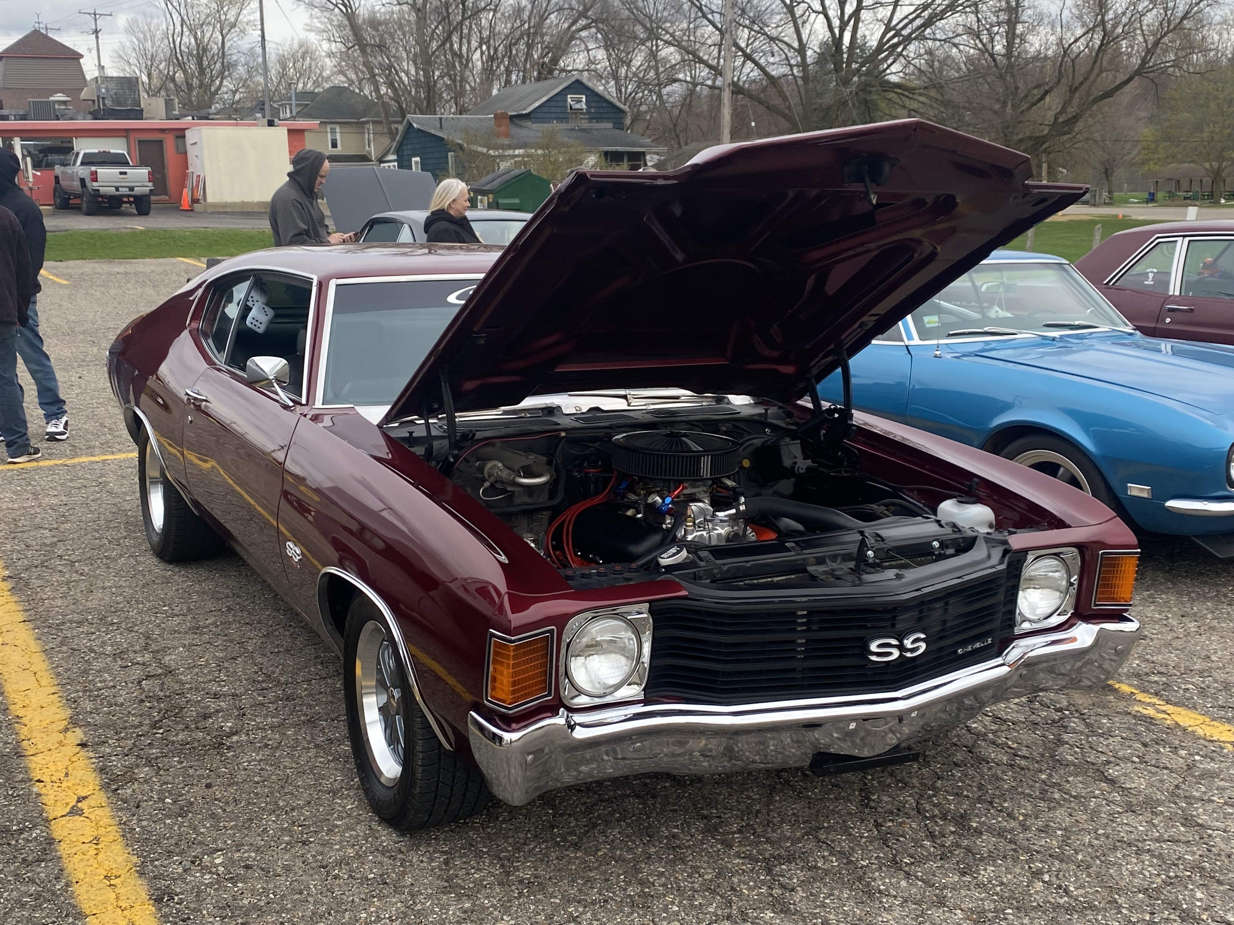

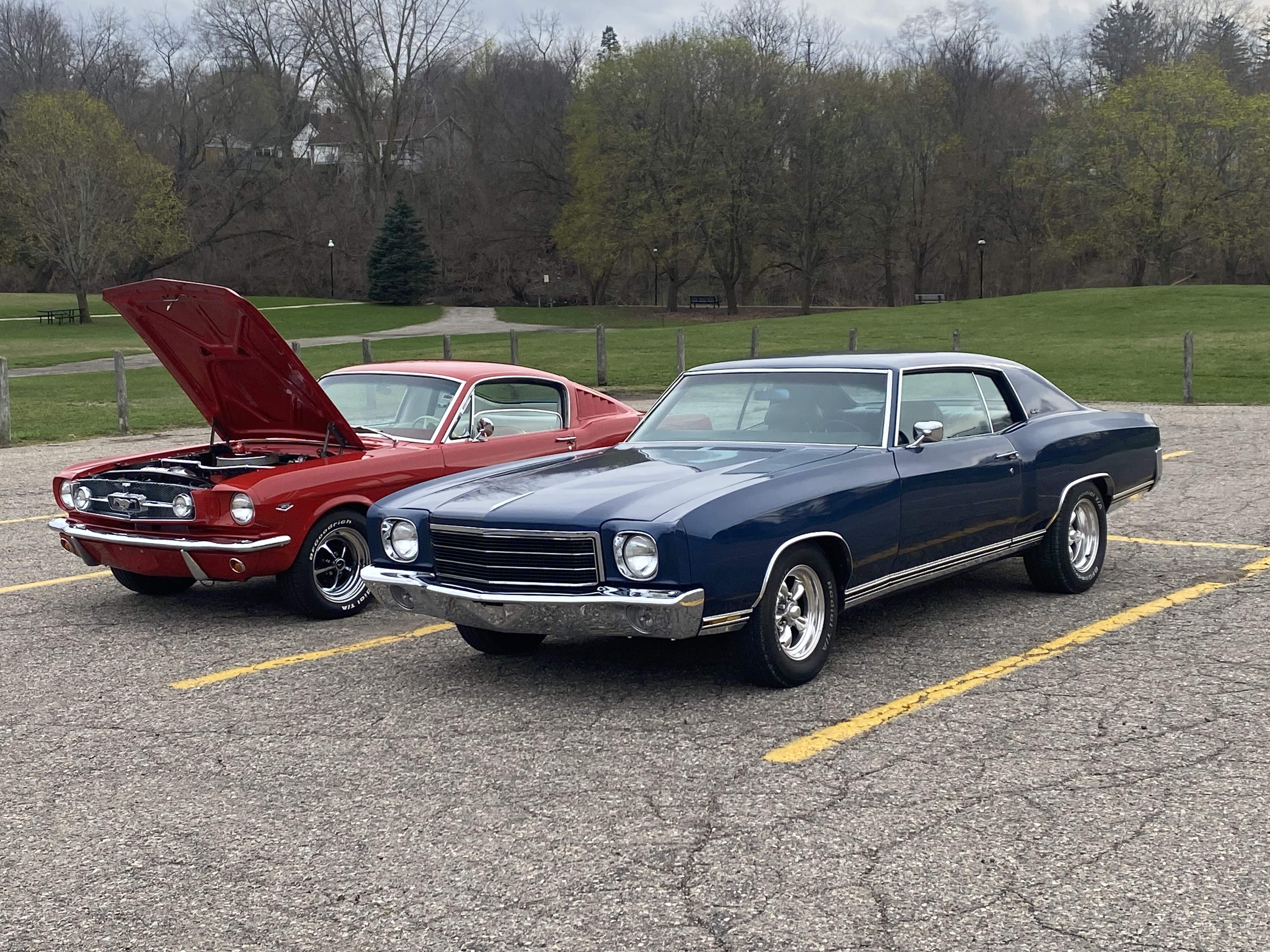

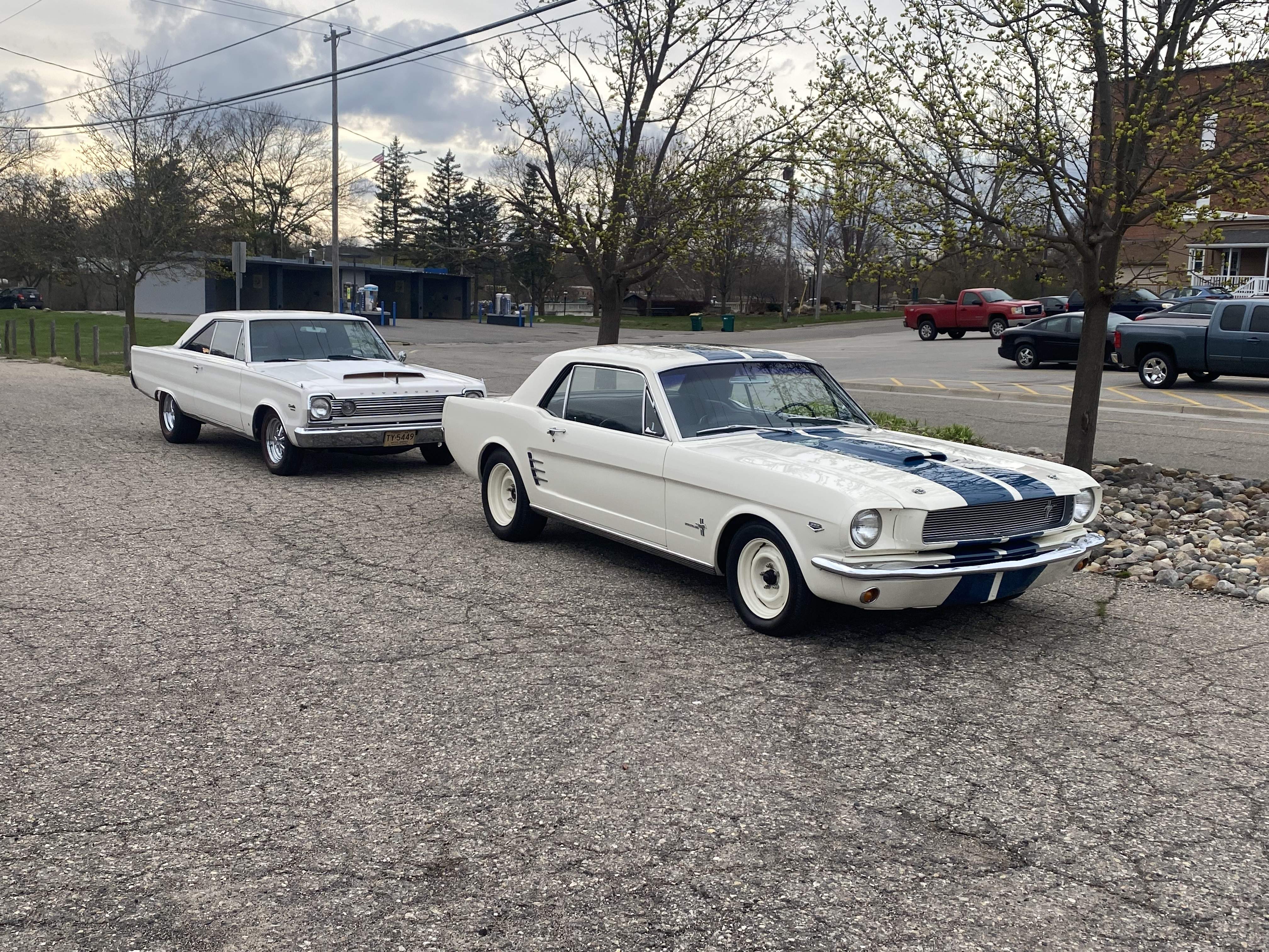

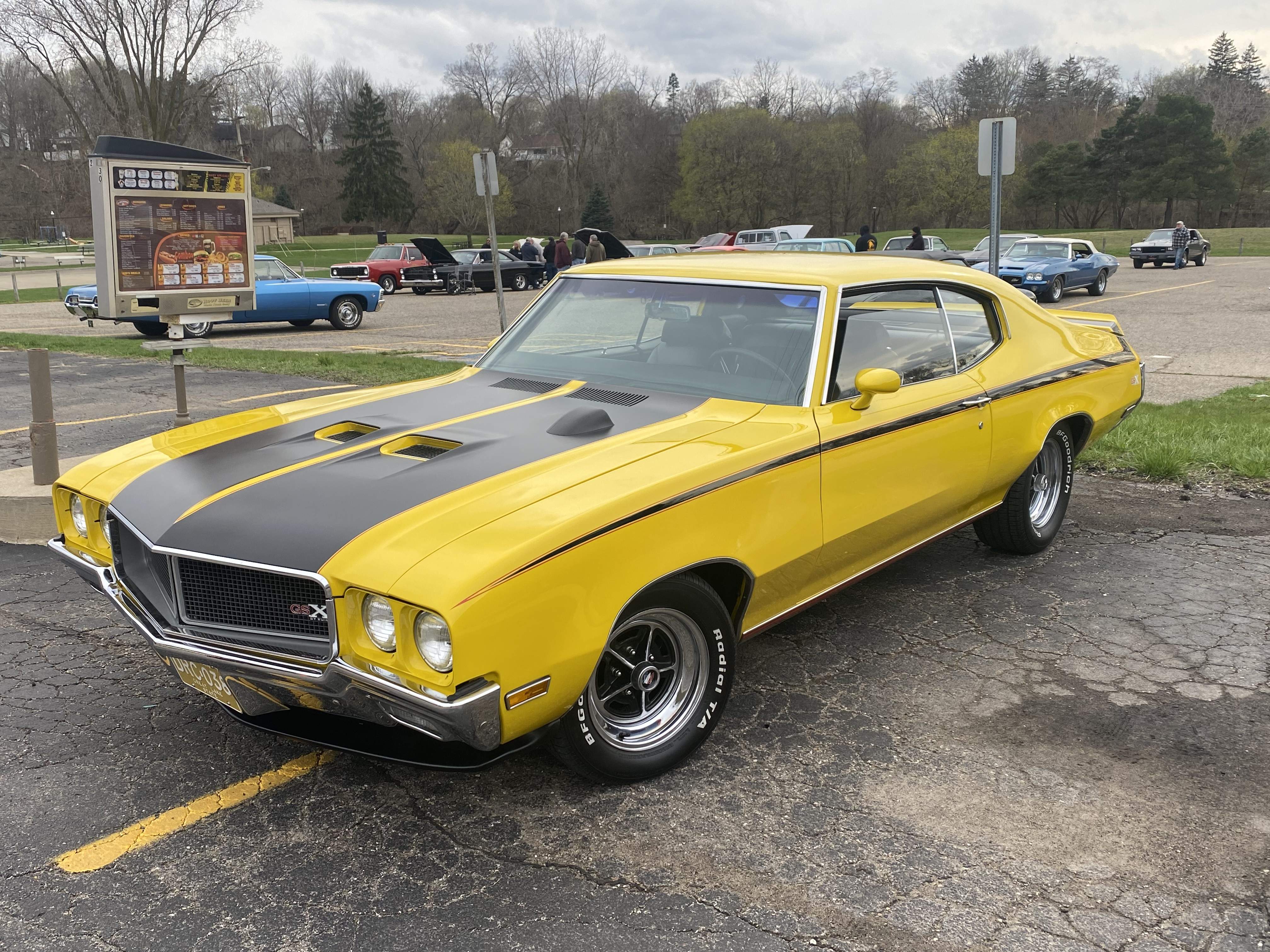

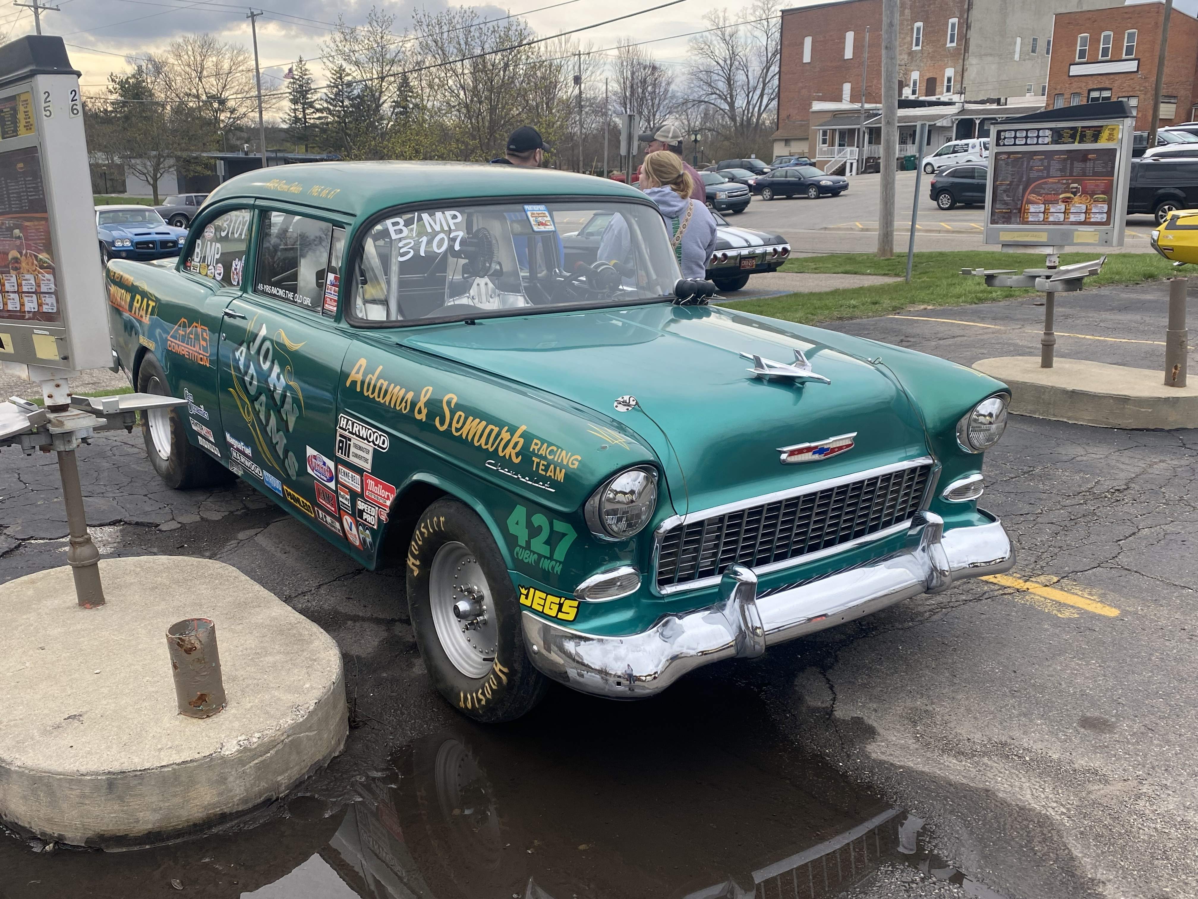

I did grab some photos of the handful of cars that were still at the cruise. Enjoy!
IMG_3099.thumb.jpeg.e471b50d8d6e8af5fabf81ada2a74545.jpegIMG_3103.thumb.jpeg.03f052db0923518327dcc867008dbc2f.jpegIMG_3102.thumb.jpeg.78bcf393a34910841e8069c04a40fd46.jpegIMG_3101.thumb.jpeg.e05f65c816bfb59375f71d82b895ff21.jpegIMG_3100.thumb.jpeg.cba2eaf806bde7822dbf4635ea3167f6.jpegIMG_3099.thumb.jpeg.e471b50d8d6e8af5fabf81ada2a74545.jpegIMG_3086.thumb.jpeg.a3d9f093ee20d706ceb1b5145d436410.jpegIMG_3097.thumb.jpeg.2b0adb9bb08913bdc7b3de13550a8ef9.jpeg
well done mate ! great pics :cheers:
the 56 delivery is a bit of me :driving:

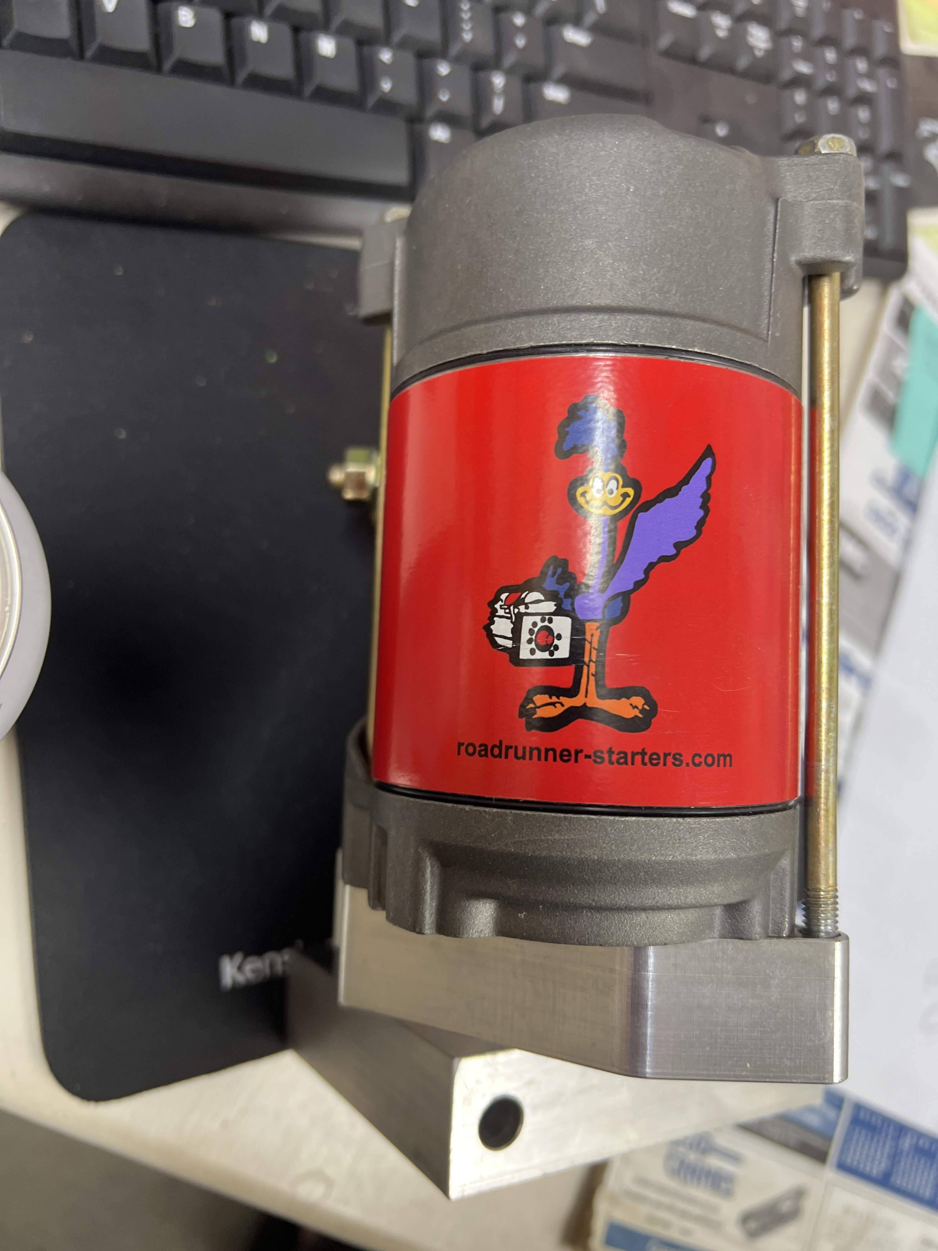

I gave up on stock gm starters years ago
I now have 4 of the road runner brand mini starters and my oldest one is on the Camaro and it’s been there for near 23 years untouched and never missed a beat ..
one thing that does get over looked is having good quality positive lead and clamp on the battery along with a good heavy earth back from the motor to the battery with crimped or soldered ends !
I hear you Kiwi. While my starter is a heavy OEM starter, I have had it since 2003 with no issue until the Apollo 13 solenoid occurred. I put it back once I replaced the damaged solenoid. It cranks like always cold..
The mini-starter in Indyman’s dirty girl I gave him years ago since it was collecting dust on my shelf. He loves it especially since he is running headers!

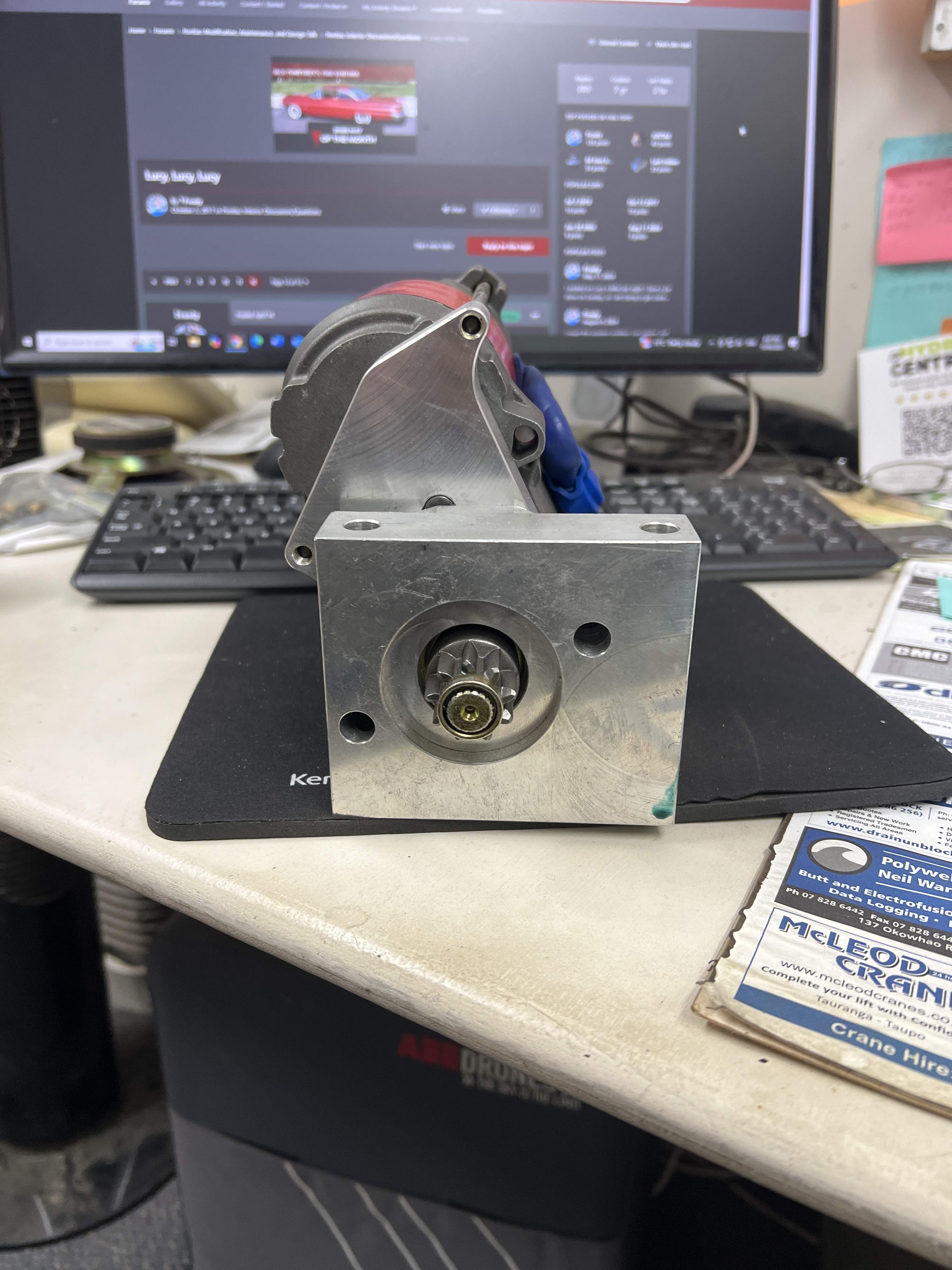

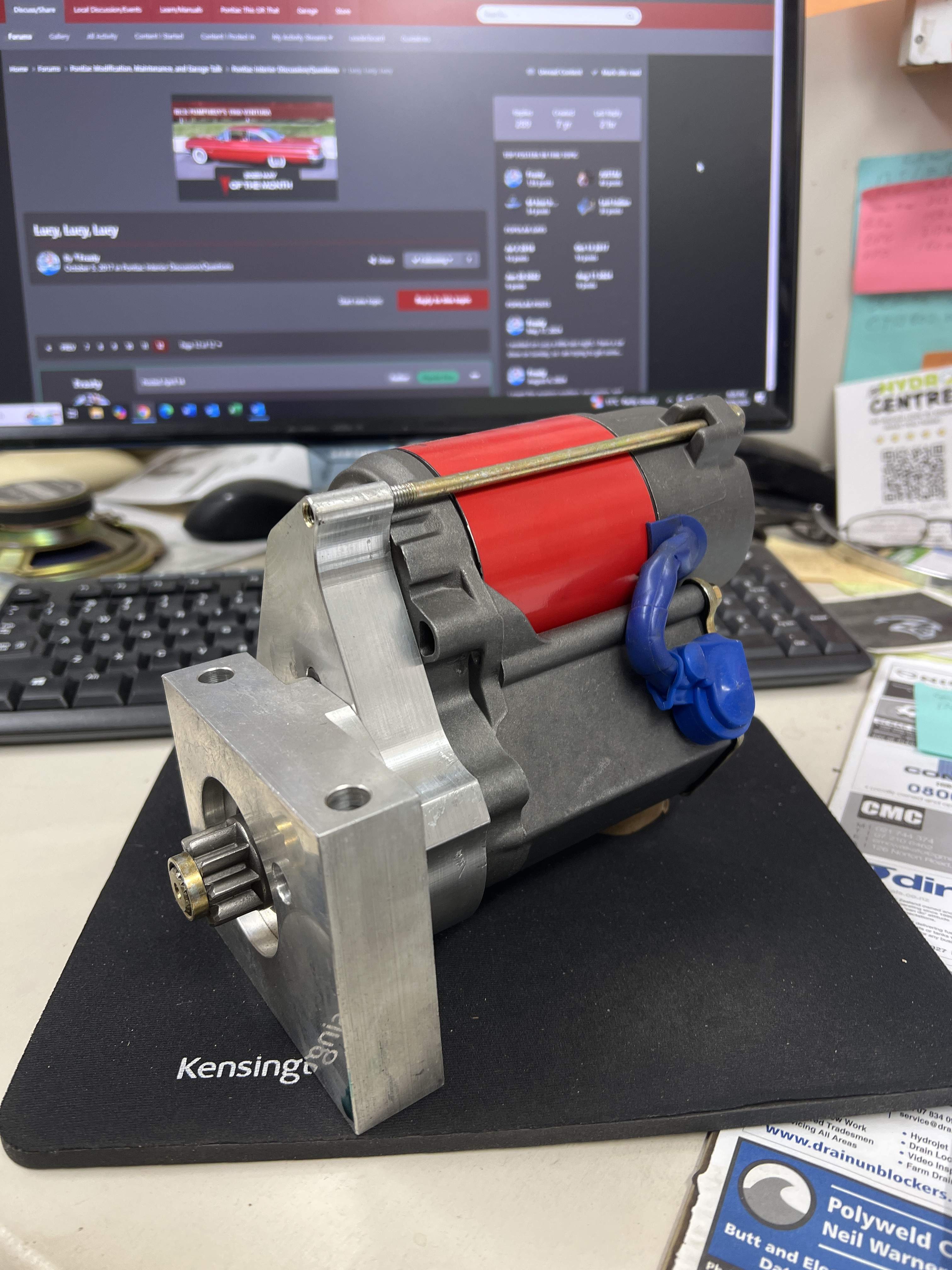

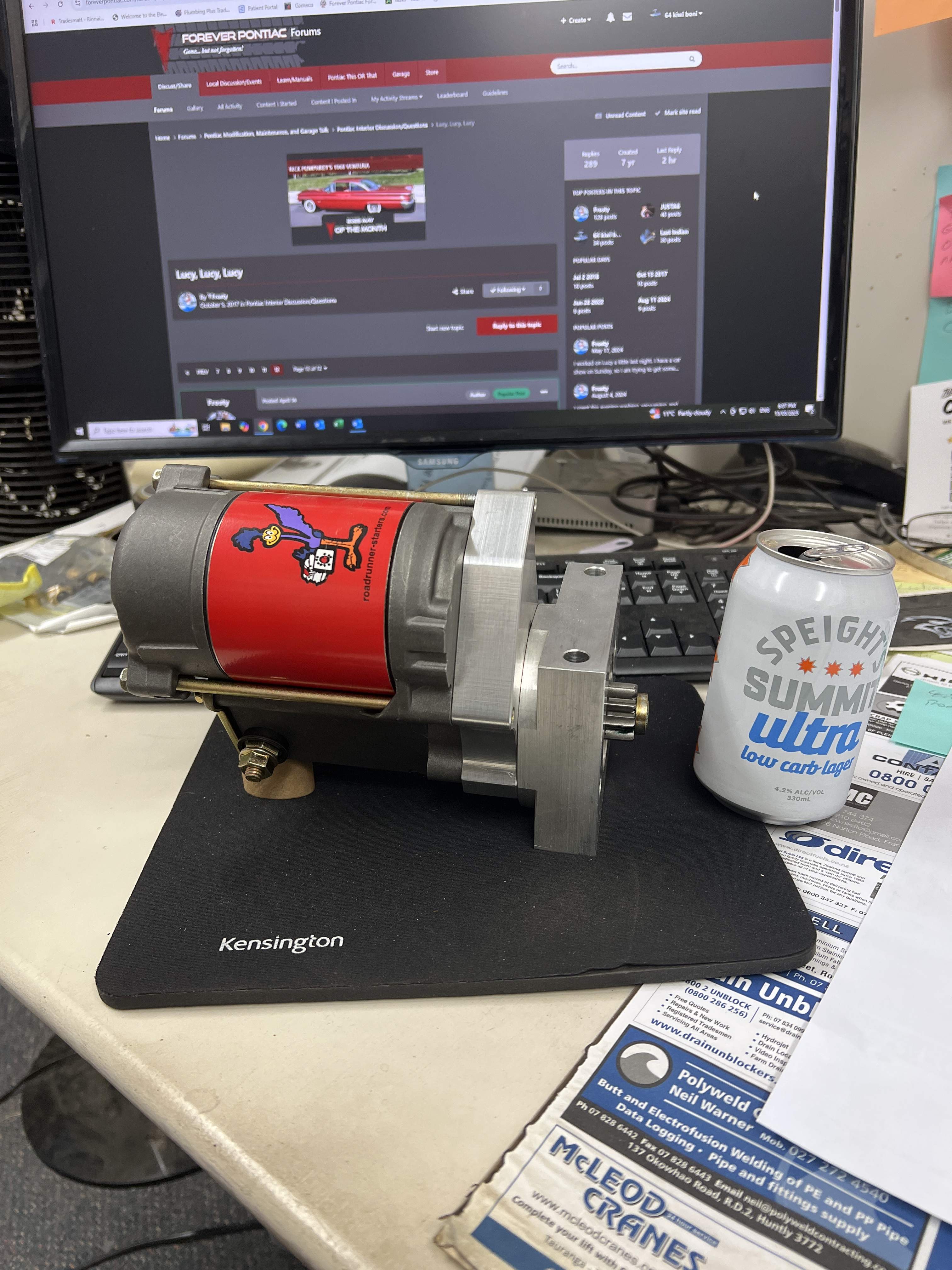

the cool thing now frosty is you can buy a higher powered mini starter
this is my 1.4 kilowatt one for the 68 build …
When these starter flick , people turn and look as they have a very distintive zip to there tune
The 72 camaro one still sounds like its starting Apollo 13 !!!, :driving:🚀
The only caveat I can think of when using a hi torque starter is that they can strip teeth off a flywheel or ring gear. Now, having said that, Kiwi's Camaro still has all it's teeth so unless you are trying to turn a high compression monster over you should be fine. I vividly remember Kiwi spruiking these things and have never forgotten the recommendation. When mine bites the dust, holiday in NZ and returning with a Roadrunner is defo on the cards.
The guys at Road runner starters are bloody good guys
they build there starters with good gear !
I did check my ring gear on the Camaro a few months back and I see no real wear on it .
I do love how when I flick the key it does the zip sound not some grinding nasty crap sound
Thanks for the recommendation Kiwi. $375 is a bit pricey at the moment, but I am sure it's worth it if you 20+ years of useful life out of it. Like I said, I still have a brand new re-manufactured OEM starter sitting on the shelf plus my 20 plus year old starter in the car. If both of those fail to solve the hot start issue, then I will turn to the mini torque starter.
