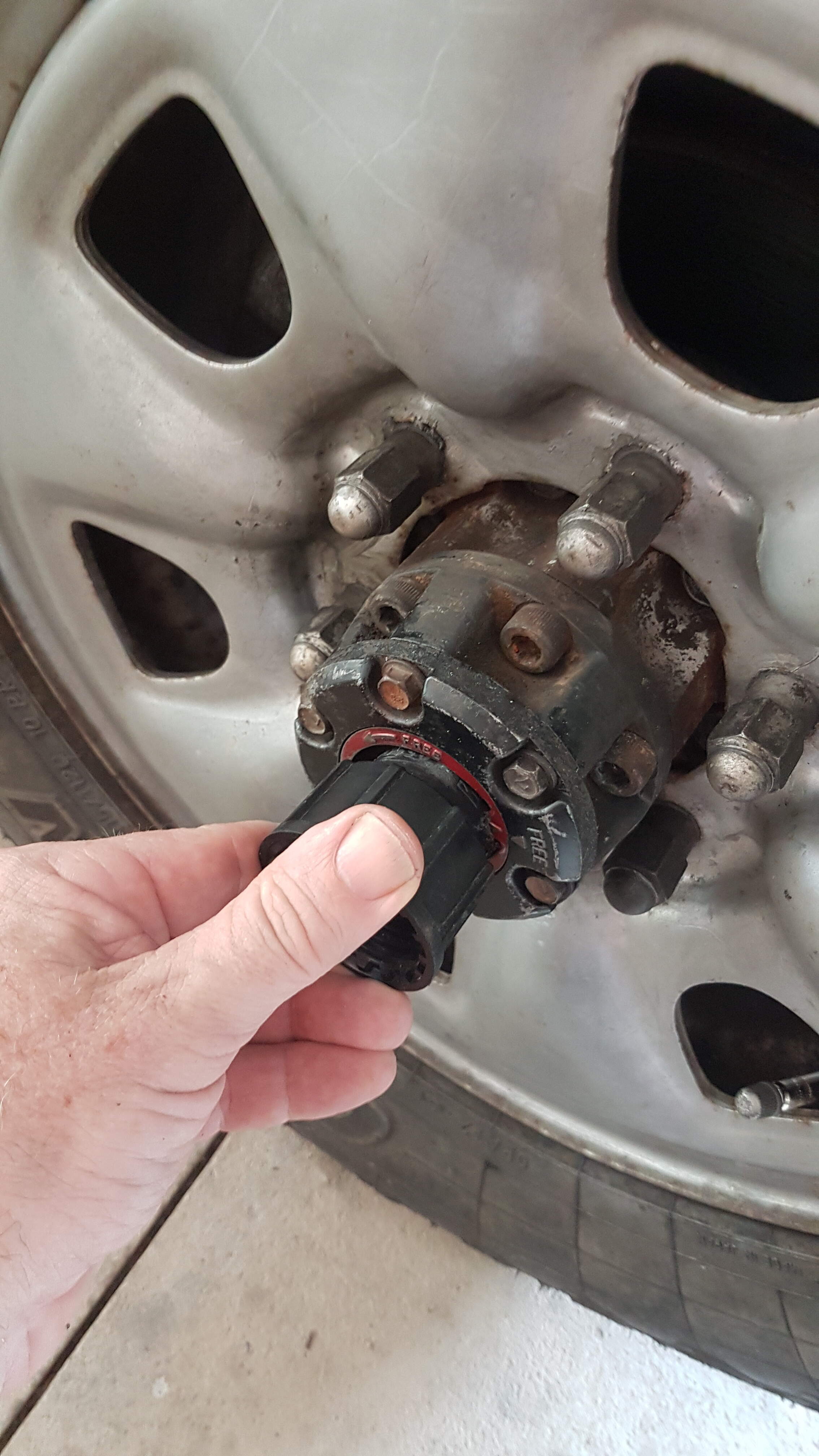

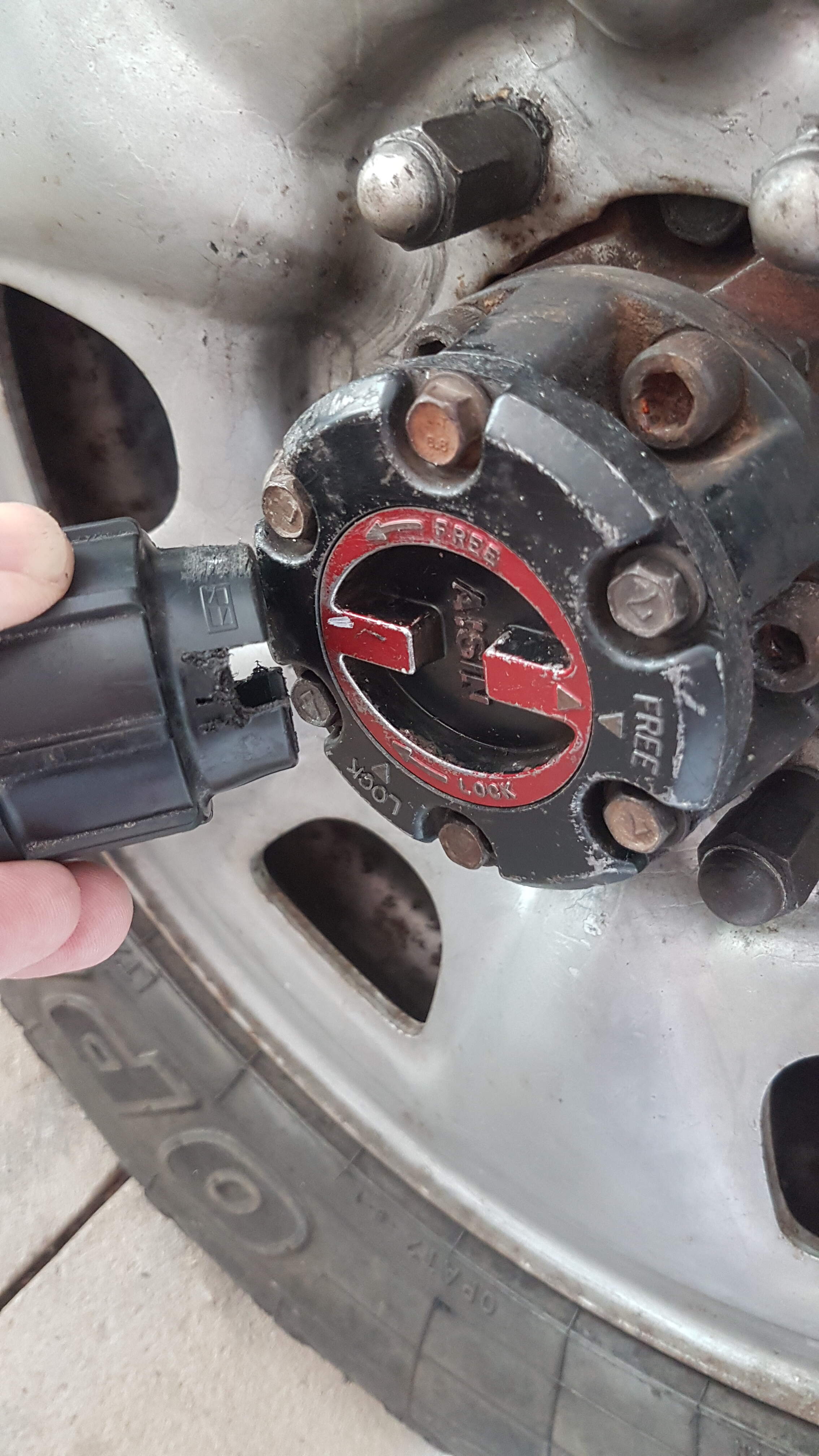

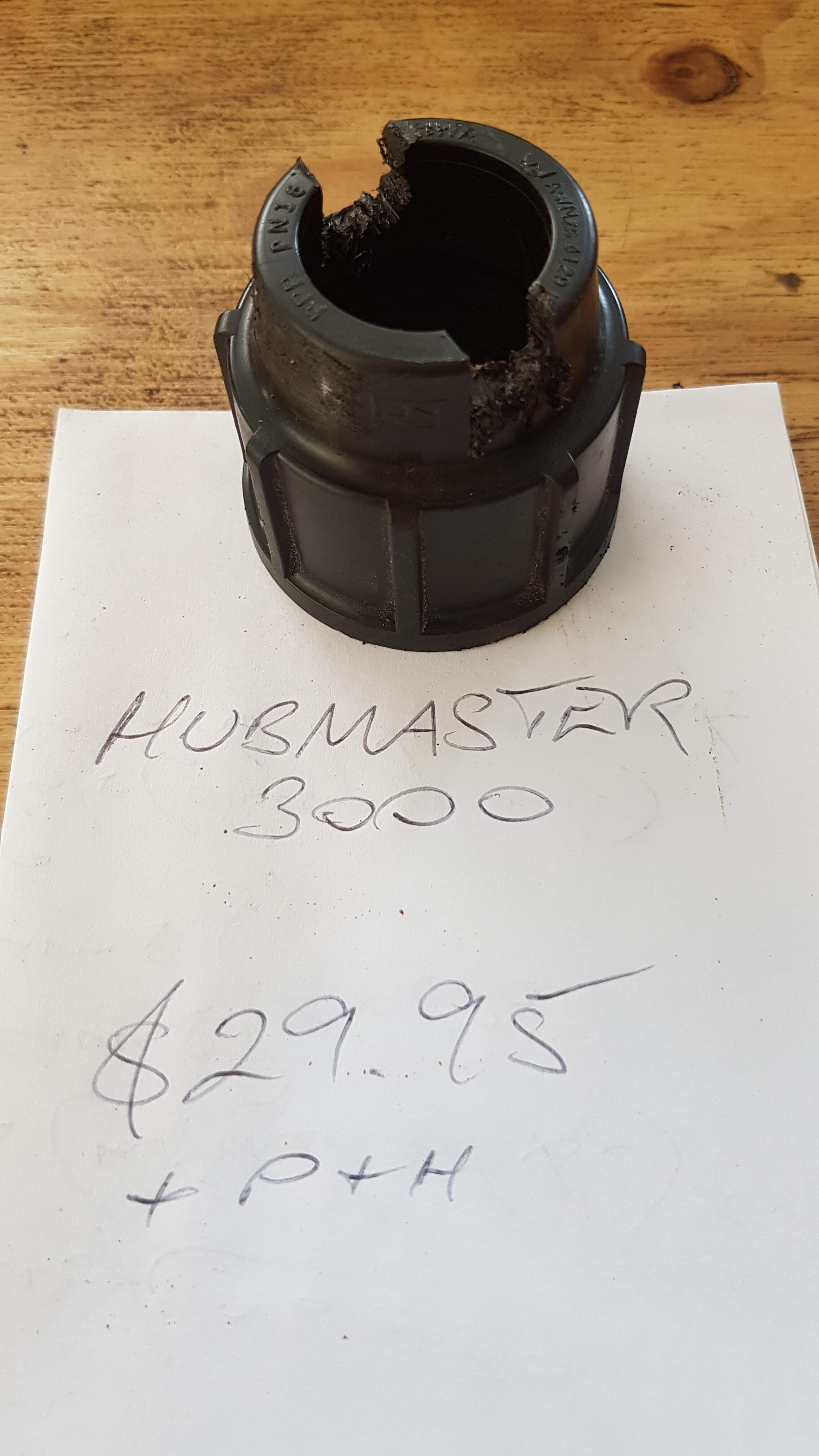

So - 2 things to report. My 4WD Holden Rodeo ute (Isuzu Trooper in the US) has manual freewheeling hubs and they were really tight, in fact impossible to engage with your fingers so I disassembled them, cleaned and lubed everything up and now they work fine but you're gonna get sore fingers if you need to engage and disengage more than once a day. I looked online and they sell a special little tool that sits over the slots and allows you to easily turn the tool with your hand via a large knurled handgrip. $60??? I knew I could make one - check the pics. Total cost: zero. I am happy to sell the Hubmaster 3000 for $29.95. Be quick - stocks are low. The item is a poly pipe joiner ring and I hacksawed a coupla slots into it. Works a treat!

Fitzy - I've always believed that laziness/sloth should be on Maslow's Hierarchy of Needs. The invention of TV dinners, the remote control, cruise control, satellite radio, fast food, all can be attributed to laziness/sloth! I applaud your genius for the Hubmaster 3000.
Now if you hook it up to a 12-20V power tool, some schmuck will pay $300 for it!
Good to hear from you Fitzy.
So the Hub gave you fits, so you made a tool! So maybe you should think about the name, NOmofitzhubbababba! Or not!

ah a plumbing fix for a automotive problem!!!!!:rofl:
The Hubbagrabba? Hubbabaloo? The Hubble Hubbascope? I'll think about it.
How about Hub-A-Bubba?

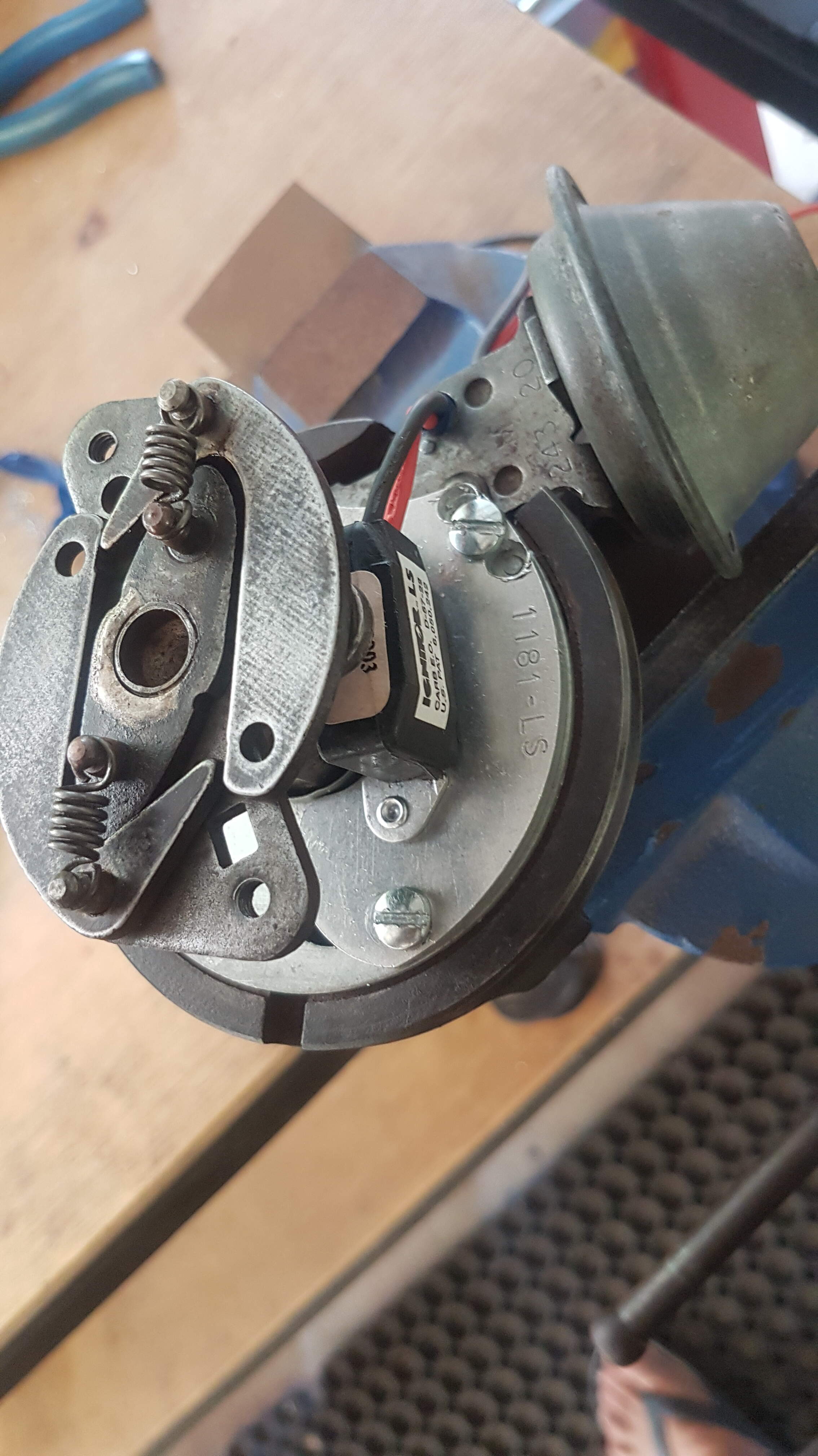

As predicted, took GP out for a blast and it started to miss & stumble. This car has new fuel pump, new filter and rebuilt carb. Every ignition component is new. Timing is correct, no vacuum leaks. I am now suspecting dodgy Pertronix ignition module. I am going to remove distributor, reinstall points, get back to 6V when running and see what happens. If it still plays up, surely it's gotta be the carb - there's nothing left. Yes - all wires are well connected, clean & tight. Homestly, when does this shit stop? Retrospectively, I'm now sure a modern factory injected Chev crate motor would have been the better option. There's a LOT of discussion re Pertronix on the net. It seems that as the decades have passed,  QC may have lagged due to the sheer production numbers. I do not want to talk bad about my Pertronix module as it hasn't been proven faulty but I am left scratching my head. Any home mechanic can sort a stumbling old skool engine equipped with points and a carb. Mystery electronic doodads just add that extra dimension of 'what if?' I'm back to work on Thursday due to chronic staff shortages (hello overtime - ka-ching!) so won't get a chance to look at it this week. If you have any suggestion gems, let me know. Points and condenser are now antiques, but they powered millions of cars for almost a hundred years.

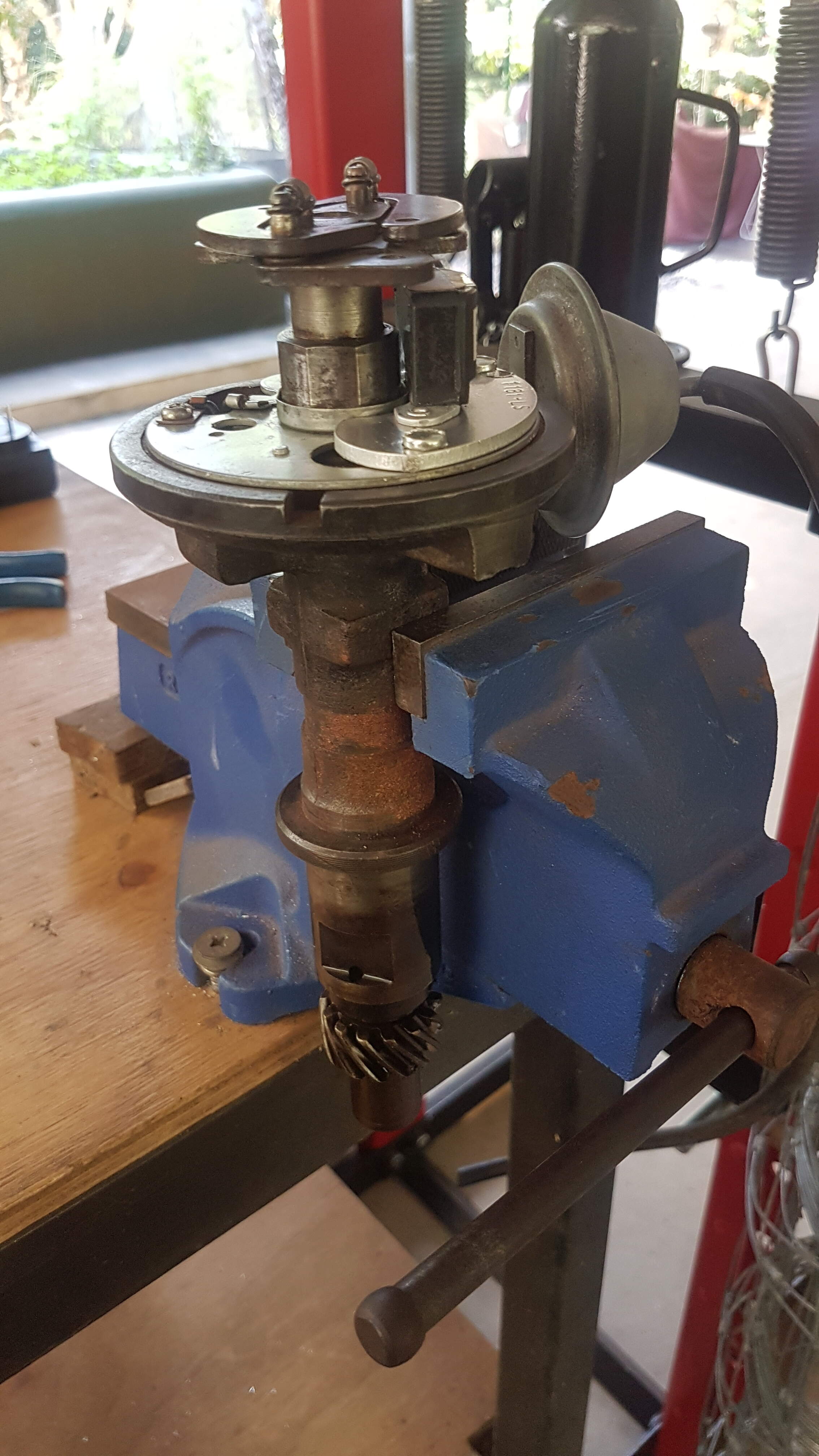

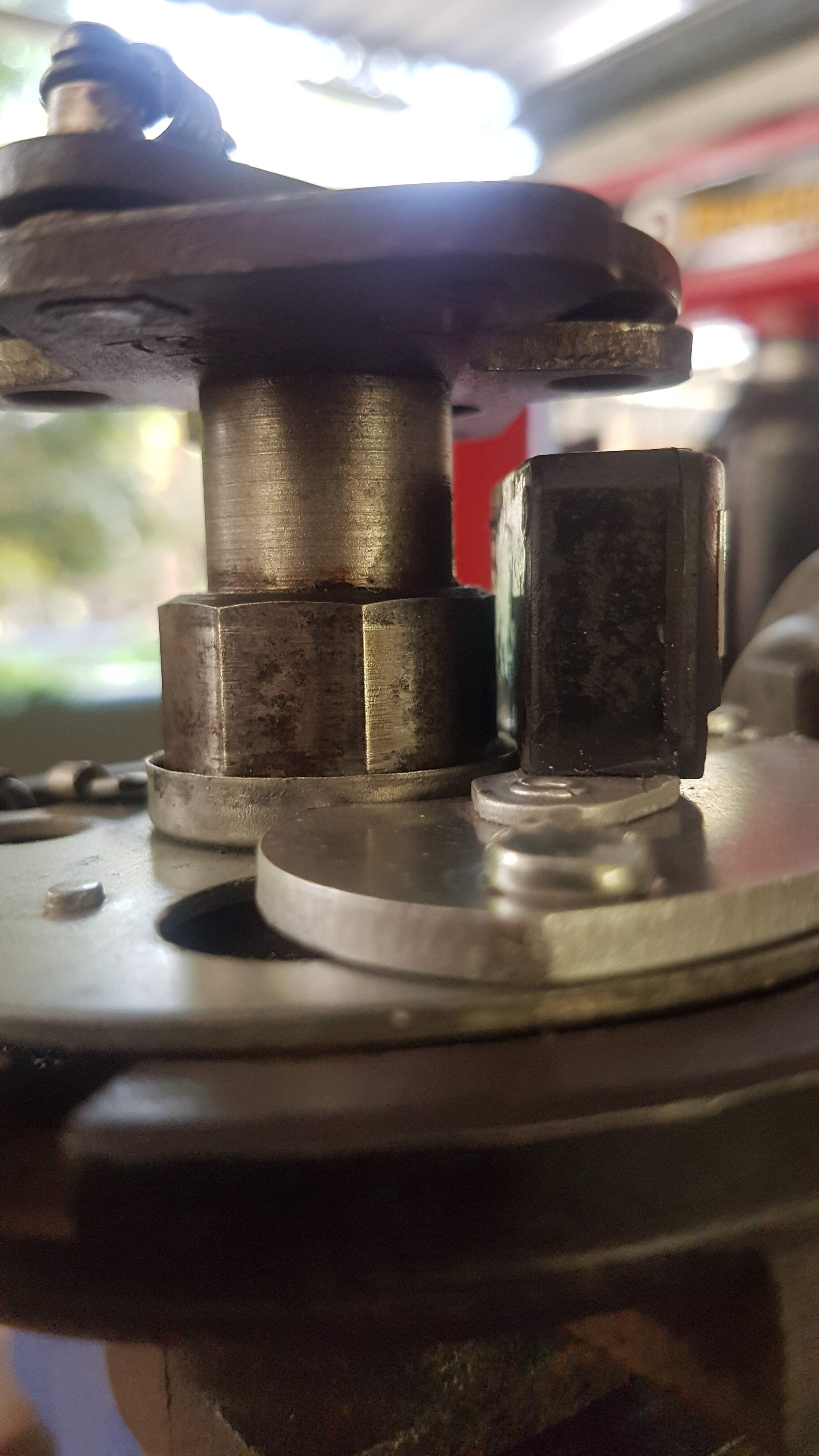

Okay - I said I wouldn't have time, so I made time. Took distributor out and found a couple of things wrong. First of all, the dickhead who restored the distributor (me) didn't earth the old condenser wire to the points plate. Apparently, that should be connected even though I couldn't see why, so I reconnected that. Then I noticed a small screw was missing. This anchors the vacuum can to the distributor body. There are 2 screws that are required, so I reinstalled that. Then I noticed that the Ignitor module was nowhere near as close to the distributor shaft as it needs to be. Not my fault this time: as the unit comes out of the box, it sits too far out from the shaft lobes. Pertronix reckons the air gap should be 10 thou at the lobe high point and about 60 thou at it's lowest point. There is no way that was going to happen in it's 'out of the box' state. So, out came the Dremel and I carefully clearanced the Ignitor base plate and then elongated the screw holes so I could move the entire module closer to the lobes. Eventually, I got to that point. Put the dizzy back in and now it was time to statically time the engine so it will fire up before timing it correctly. I have always hated doing this because I always get bitten by the coil. Sure enough, as I'm gingerly turning the dizzy, 40000 of Pertronix' finest volts go through me. It felt like my right arm was gonna drop off. Started the engine, checked the timing with a gun and it was spot on (always disconnect & plug the dizzy vac line.) I gave thanks to whatever entity was watching me and having a good old laugh as I got zapped, and took her for a drive. It's better but still not perfect. I now suspect carby. Will install yet another new inline fuel filter and some fresh petrol next time I'm home and will see what happens. If I have to, I'll take carby off and dismantle and check it's internals against a factory diagram. Should have bought a Corolla.😁
