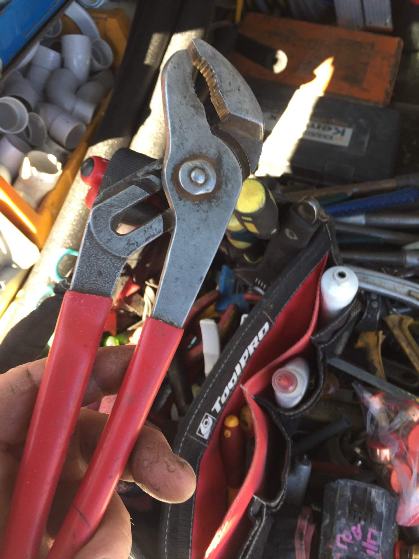

Oil pressure sender sits in amongst header pipes, so precious little room. I tried sockets, wrenches, a shifter, visegrips & long handle pliers. I JUSTA need the right socket, which when asked, Wrongway responded with.

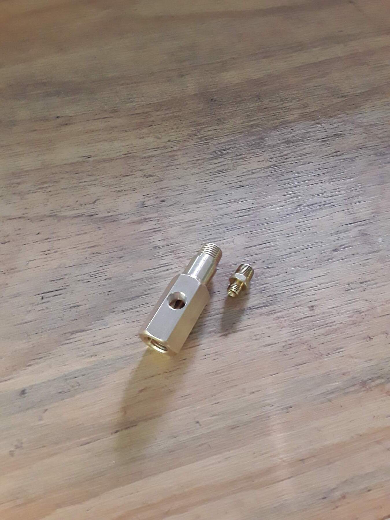

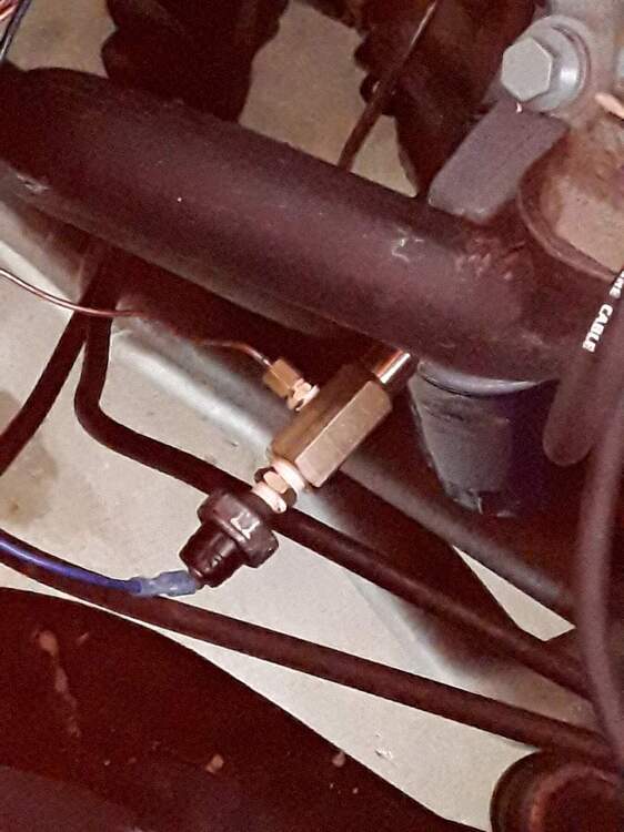

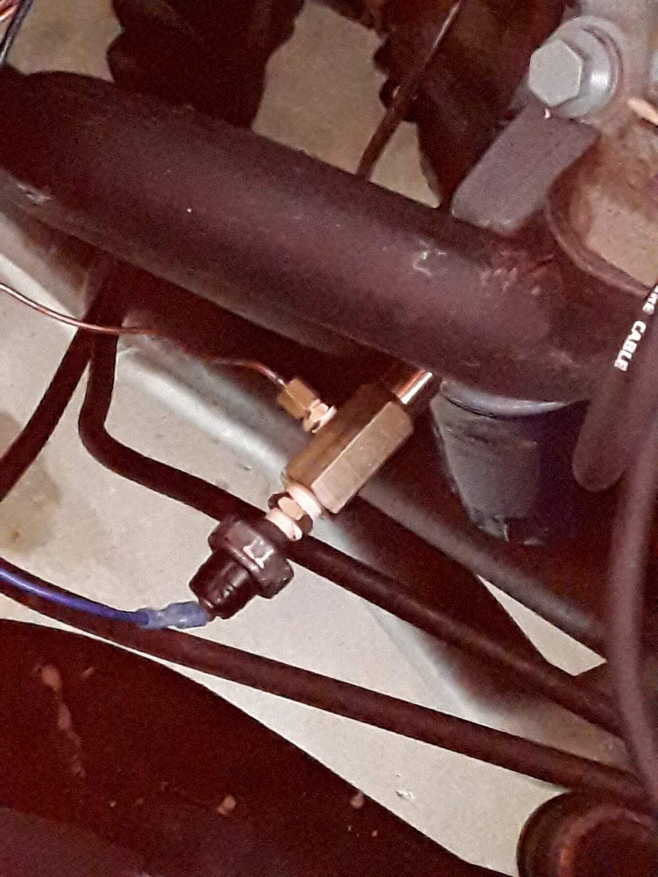

First up, friggin' oil pressure adapter is an entirely different thread size to the actual sender, so off to the Big Smoke tomorrow to try and cobble together an adapter arrangement for the adapter (there's a joke there somewhere.) See pic, Kiwi.

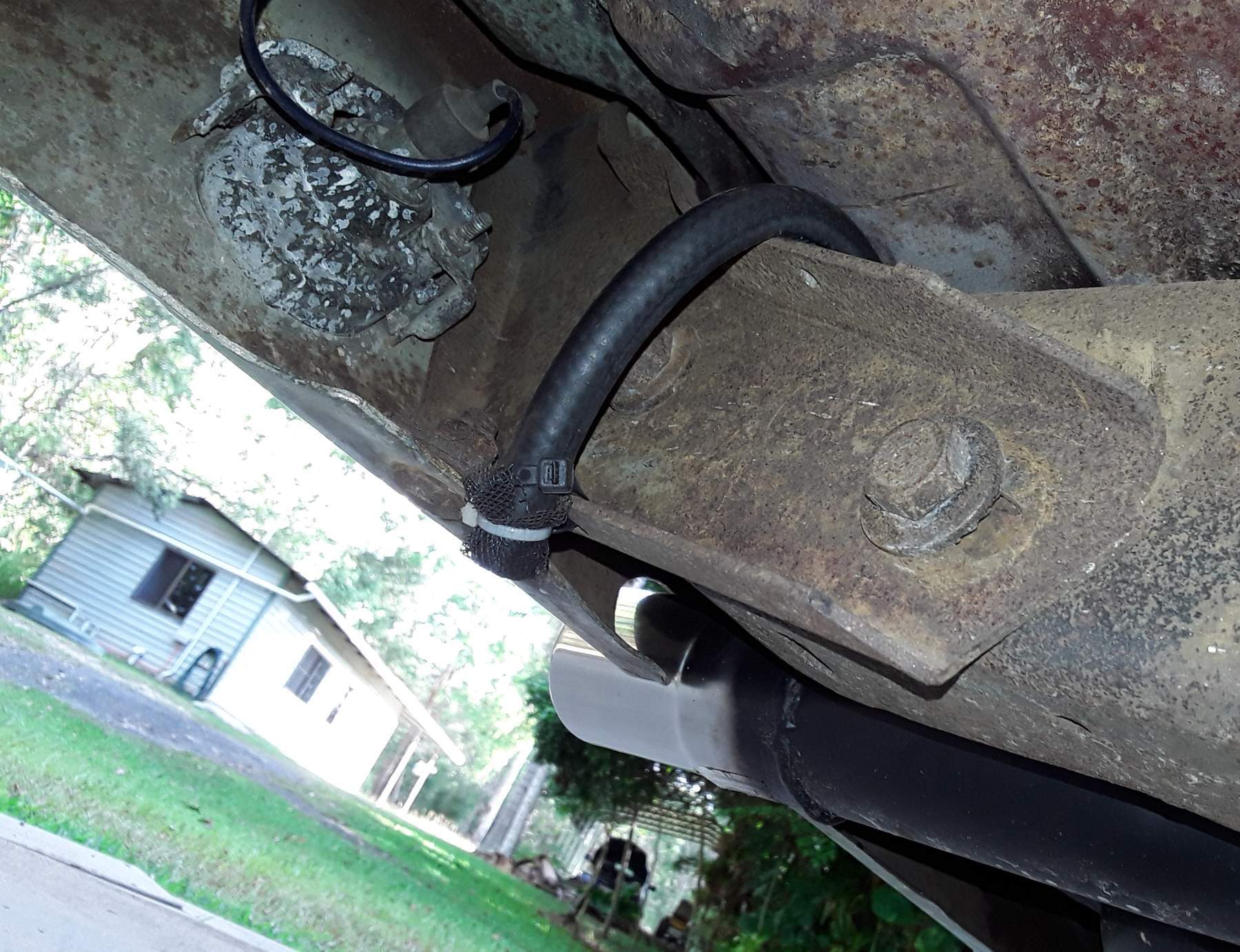

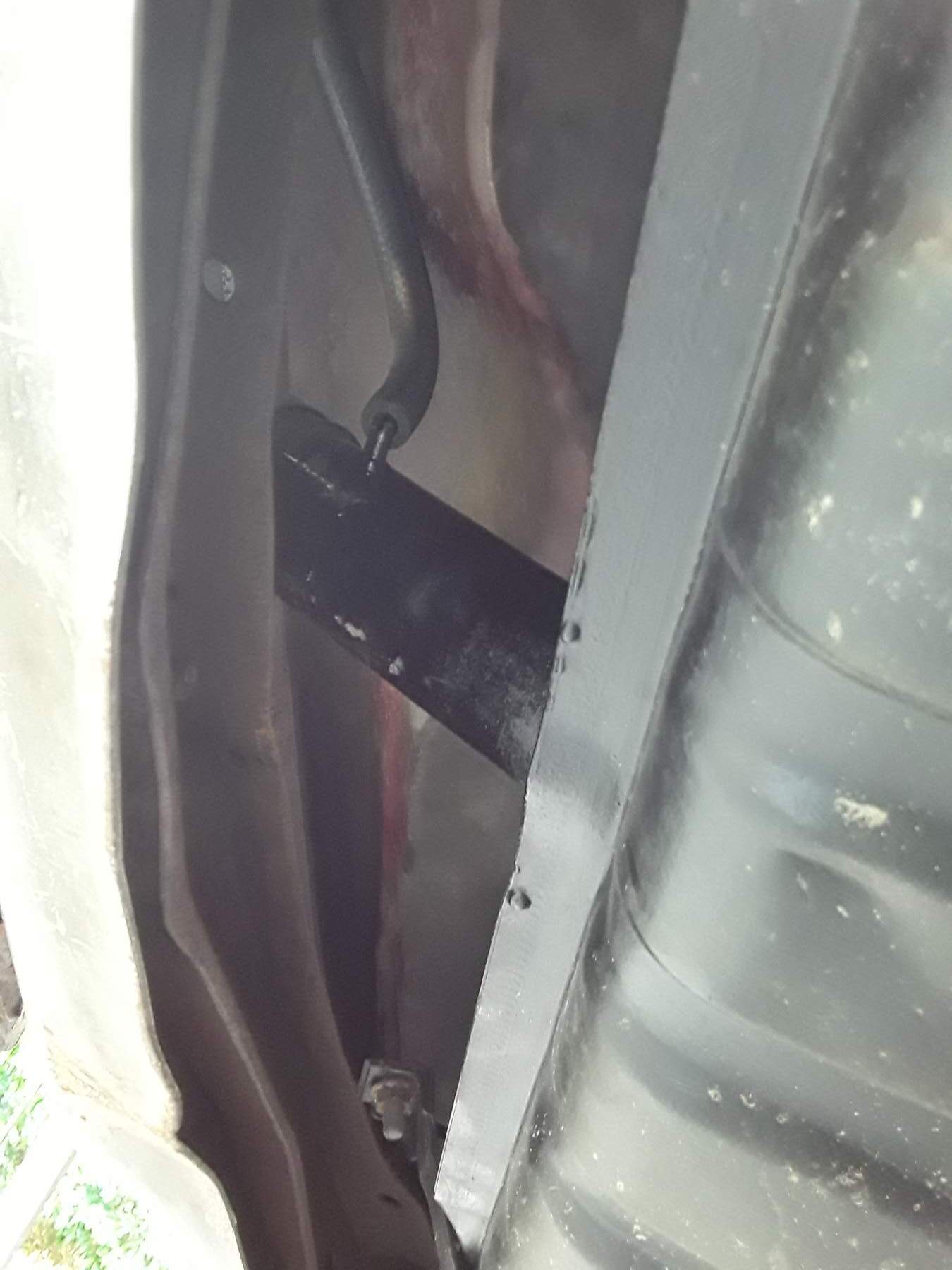

Last time I was home I could no longer ignore the smell of petrol in the car as I was driving. I remembered that the factory vent tube simply runs from the tank filler neck vent pipe to a funny little bent tube that sits behind the rear fascia between the tail lights. Every time I opened the trunk, I could smell fuel and of course the fumes got sucked into the car as I drove. I rerouted the hose from the vent pipe to behind the back wheel, angled it so as to not take in any water or debris and covered the end of the hose with some flyscreen mesh. No more smell and the fumes get sucked out of the way by the car's forward motion. See pics, Kiwi.

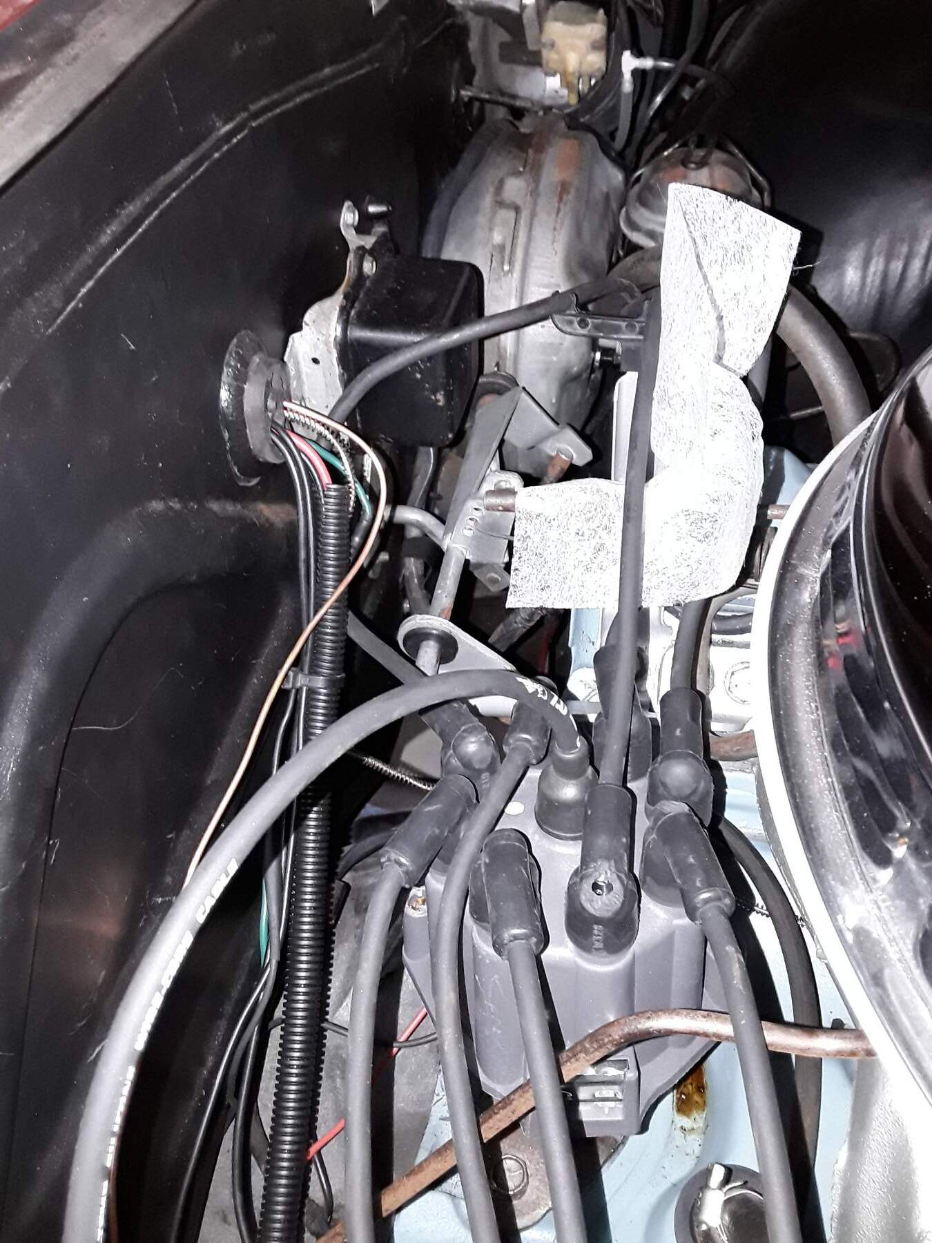

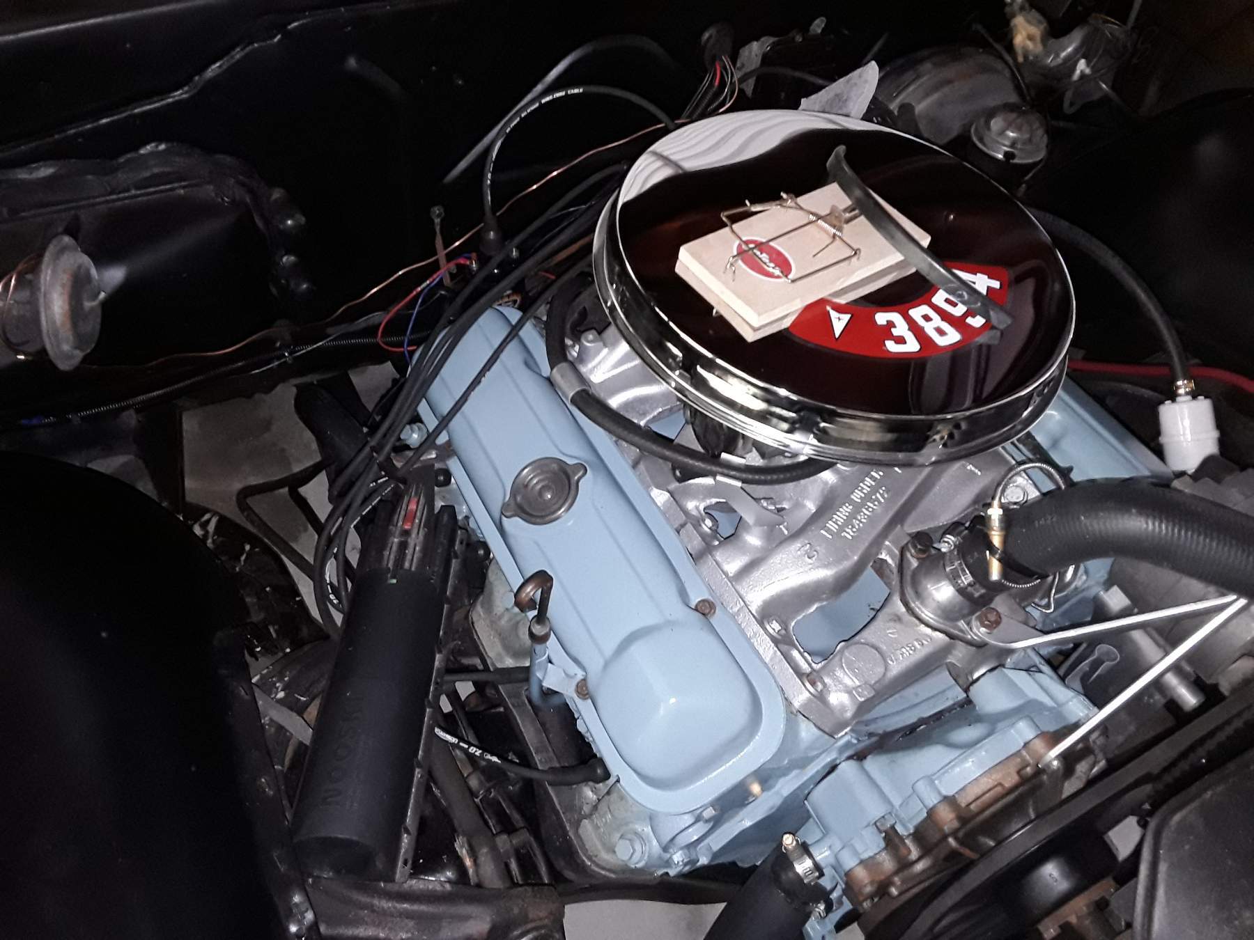

Last thing. I open the hood today and the first thing I see is a series of tiny muddy paw prints across my shiny air cleaner. The rodent is back and sure enough, that little prick had once again chewed through my bitchin' 7mm solid core HT leads. I have set a rat trap on the air cleaner and baited it with a piece of rubber (they like wires because they resemble roots) and another NZ 'Nooski' trap (down near the RHS head) and covered the HT leads with dryer softener sheets which have such a strong odour, I myself already feel repelled. That sucker had better get it's neck broken tonight. Kiwi...you know the drill. See pics!20220406_163732_001.thumb.jpg.4065fc159164240c409433ad758b995c.jpg
peanut butter mate!!! they love it.... the f-cker needs to die!!!
if the trap on top of the air cleaner doesnt work tonight, get a box, cut a 30mm hole in it put your wire trap inside with peanut butter on it and stick it in the fender well . close the hood and see if that works,,,,, rats dont like anything out in the open.
ps. rat love silicon !!!! hence him chewing your leads

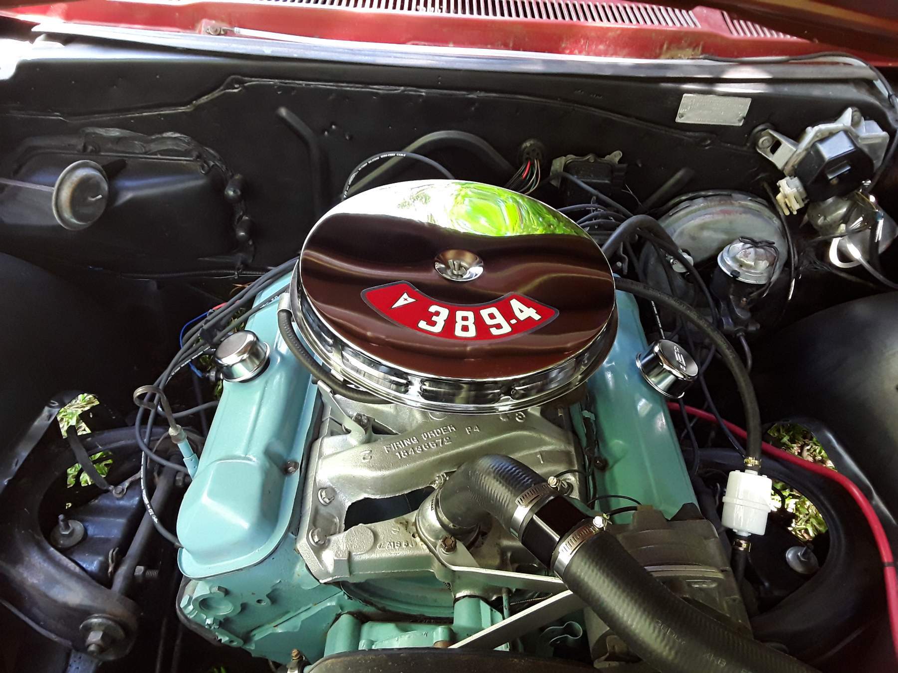

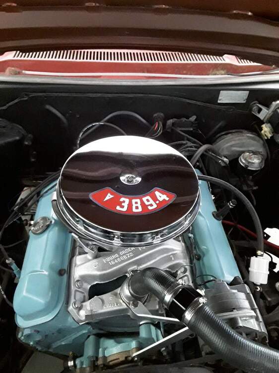

mate! your engine looks sooooo clean!!!!:cheers:

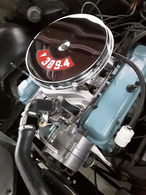

I remembered your trap set up and I shall do the same. Thanks for engine compliment. I'm totally pleased with the result. I think I nailed it with the silver painted inlet contrasting with that lovely blue Pontiac paint. The air cleaner is the icing on the cake. Engine still has only about 100 miles on it but is enormously responsive. It will jump from 60 to 70 in a coupla seconds on light throttle and sounds really good. Still have that annoying misfire under heavier acceleration. I'm convinced it's fuel related.
Engine Looks so good.  Sorry bout your critter problem.  Bust his A$$
Thanks JustA. I was always adamant about being able to open the hood and gaze into a clean uncluttered engine bay. I will be tidying up all the extra wires and tubes that were recently installed to take care of registration and gauge requirements.
Speaking of gauges, the saga continues. I bought an adapter to enable the fitting of my oil pressure gauge/idiot light adapter and she works a treat. A little teflon tape on all the threads, don't overtighten and the gauge reads 60psi straight off the mark.

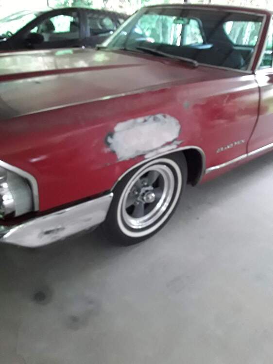

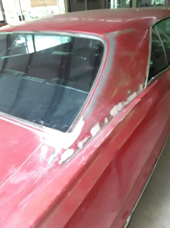

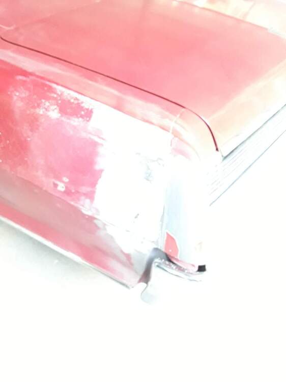

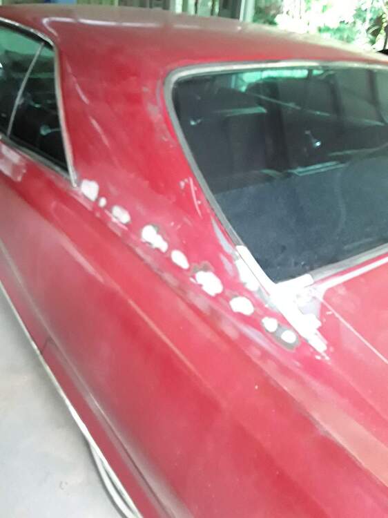

Thanks boys. Now you can see why I like to bang on about mowers sometimes - without a mower, we are in the jungle. I must say, car looks good as it's going past you or from a distance but there are now patches of as yet unresolved body filler and primer and crappy old paint so I need to make a decision and get serious about getting rid of the plethora of little dings all around the car and prep it for painting. A definite work in progress. You mightn't hear much about my car for some time, but that's probably a good thing! I'm gonna pull the tacho and take it to an auto sparky to see if there's a fault within it. The instruments mob in Brisbane guessed about $300 to fix it. I'll try the local guys first.

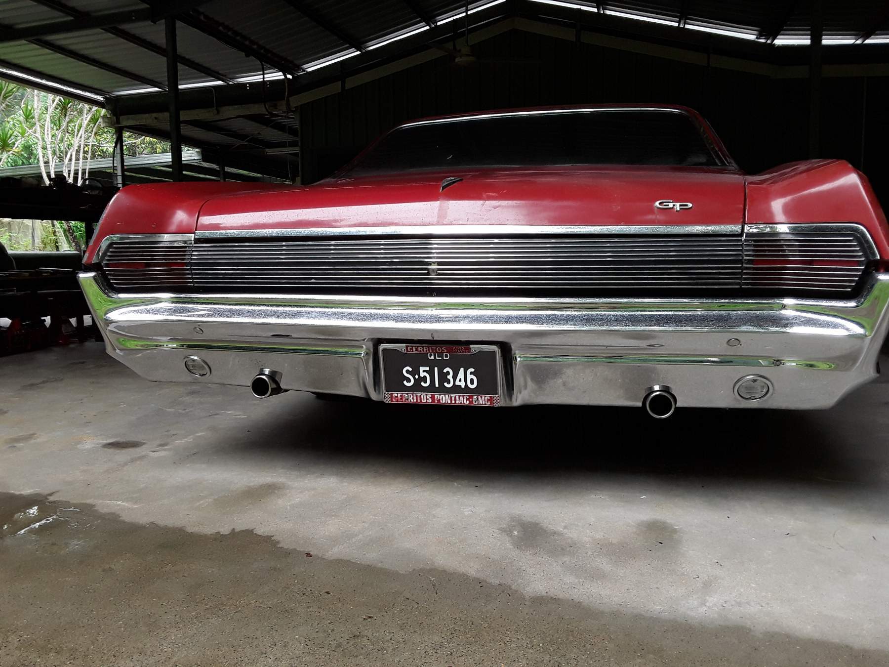

Okay, this is much longer than I planned but we're almost there. My vintage licence plate frame arrived today. It required me to 'modify' (read 'butcher') my nice new licence plate in order for it to fit the frame but I really like it. I think it finishes off the back of the car. It looks like I drove it onto a ship in California and then drove it off here in Oz. I had to modify the plate because even though they are a 'US size,' they're not quite right and the pre drilled holes are all wrong. Honestly, what did they use as a template?
