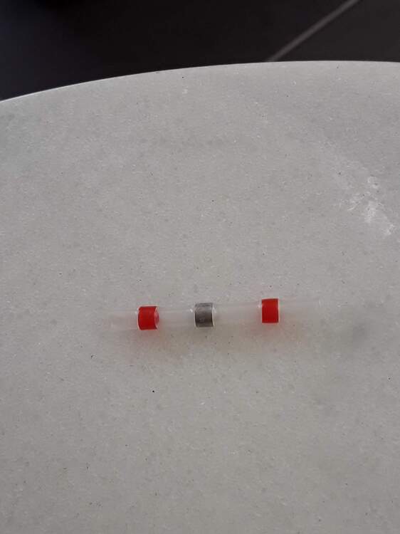

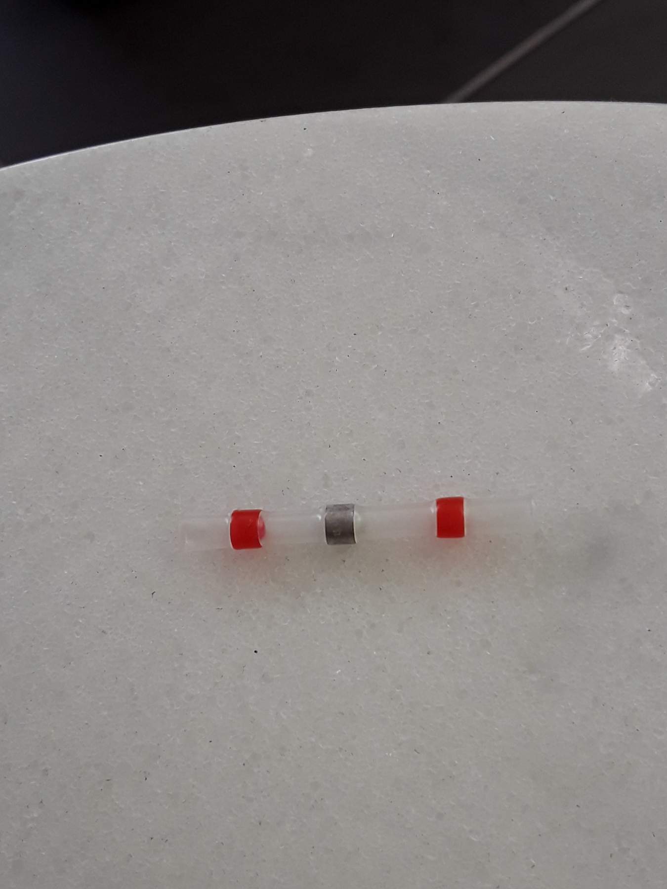

One more thing. I'm probably late to the party once more but I went to my local electrical wholesaler some time ago and told him I wanted to know the best way to join 2 auto electrical wires. He showed me these heatshrink connectors complete with a low temp melting point solder connector in the middle. These things are great and I'm never using anything ever again when joining wires. Once heated & cooled, they are never coming apart and are fully insulated. Gold.
I've used a couple of packs of these from Amazon and used them on the speaker and radio wiring for Lucy when I yanked out the dash last summer. I love them. No more soldering, flux, burning yourself on excess solder, etc. :cheers:
That's right, Frosty. For an inept klutz like me, these things are a cinch and give a great result.
sorry but i want to see that solder interpenetration of the 2 wires and i KNOW its 100%
then heat shrink over it. but thats because i am a plumber and have been soldering all my life .
No need to fret. Due to it's transparency, you can insert each wire in and watch where they meet. Once happy with the positioning, a small amount of good heat and the solder melts completely - you can see it. A quick check with a multimeter and you're done.
