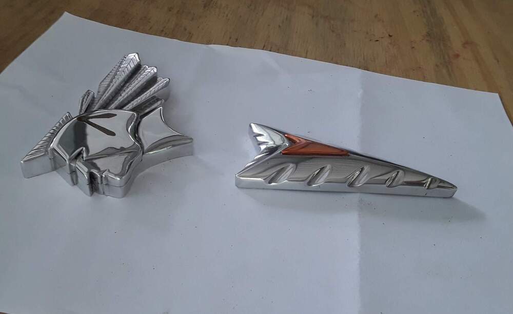

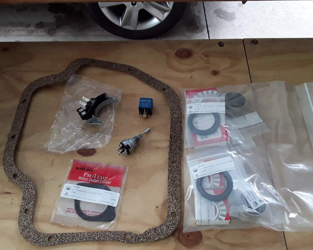

Anyway, I came home to an unexpected treasure trove of purchases and gifts. All my  car crap turned up (wheel bearings, neutral safety switch, TH400 pan gasket, thermostat gasket, wiper switch) and there's more stuff coming BUT look what Frosty sent me. He sent me a coupla beautifully crafted emblems (courtesy of Gary aka Last Indian) which will adorn my GP one day - just gotta find a good spot! Look at the depth of material and the fine workmanship. I can only dream of doing things like that.
Frosty Man, once again thank you so much. Kiwi & I are defo coming over there once the politicians and big pharma have all taken their cut from this covid crap and we're going to buy you a beer. ONE beer, but it's gonna be a big one. Then we'll go to the nearest lobster shack and probably finish up at Hooters. That'll be Day One.
I have been trying to think of some suitable Aussie paraphernalia for your Garage Mahal but am struggling. I'm afraid when it comes to cool cars, the Yanks beat us to it, but I shall continue to ponder the conundrum.
Many thanks once again. I am not a man who openly weeps but came pretty close when I opened that satchel! Excuse me, there's something in my eye...

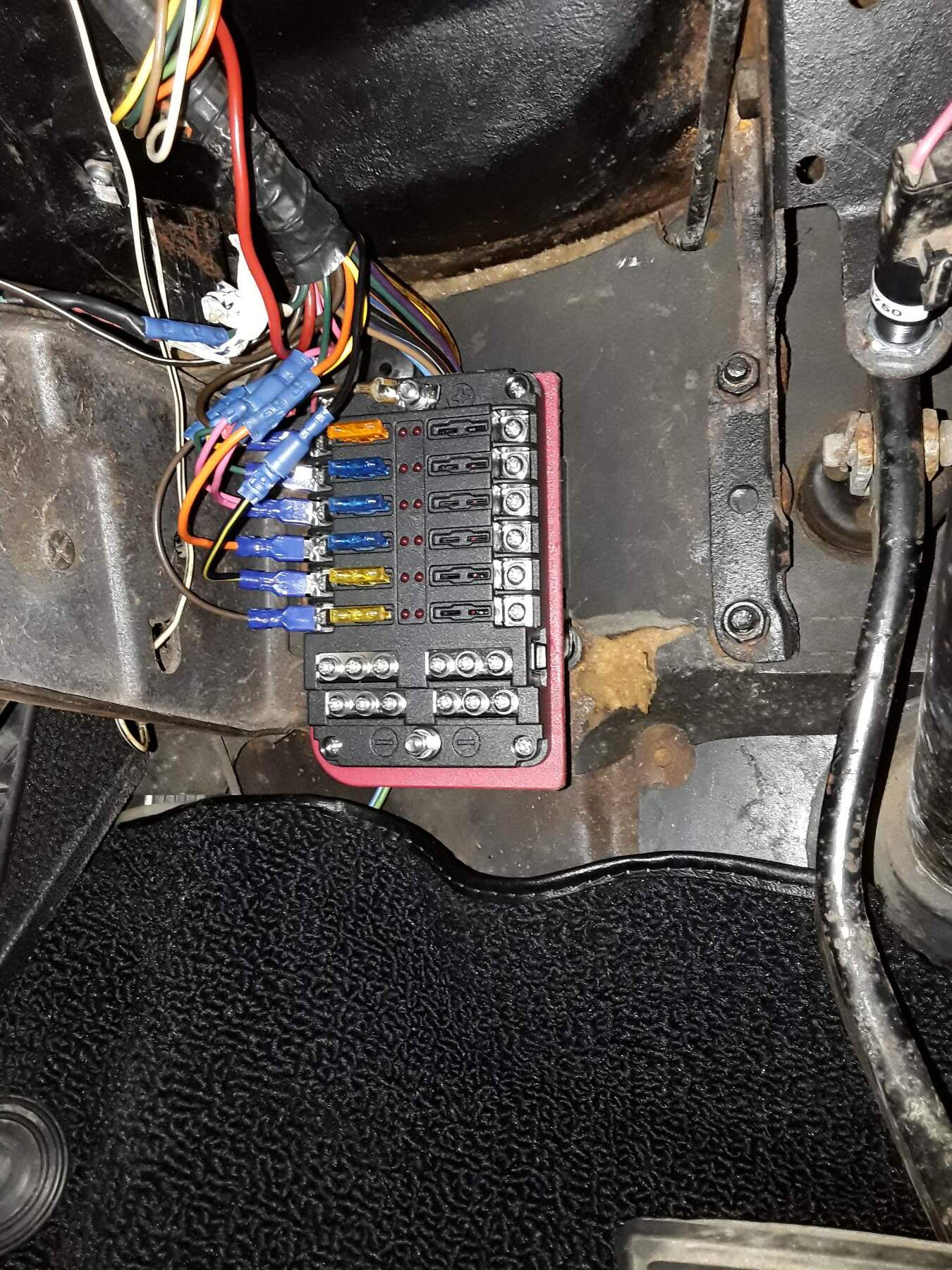

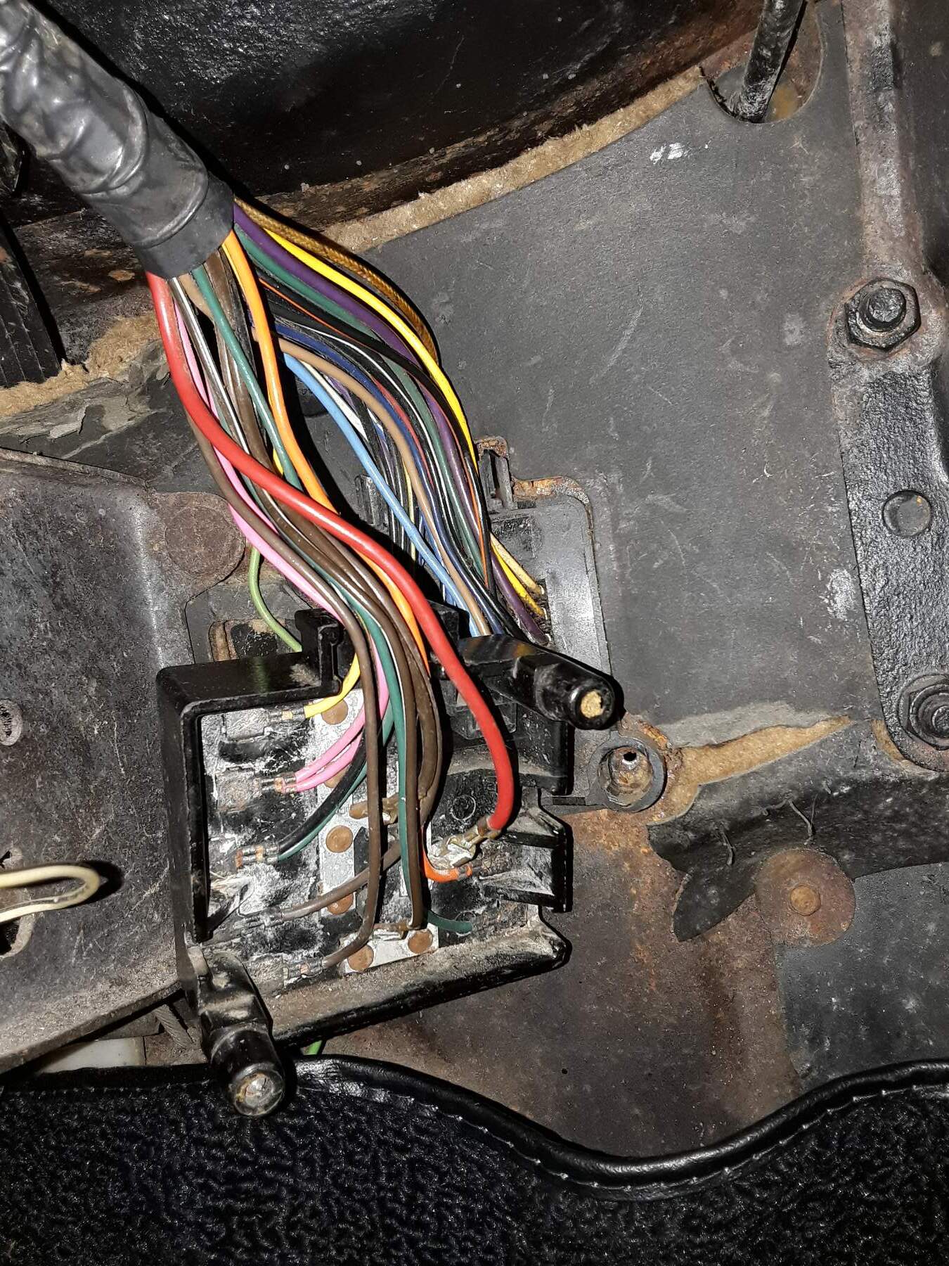

Then I looked at my cruddy old fuse box. I unbolted it from the firewall, took some pics, made some notes and then did the unthinkable: I cut the wires that feed into it. There's no other way to get that sucker out. Once out, I totally dismantled it and laboriously used the Dremel, emery cloth and a collection of wire brushes to get all that rust & crap off everything. I then tested every contact and every fuse with a multimeter and it's all good. All the bits are now fizzing away in a cup full of rust converter and by the time I reassemble everything and reattach all the wires (I'm gonna use spade connectors to make potential future removal simple) everything should work reliably and the heat issus might disappear.

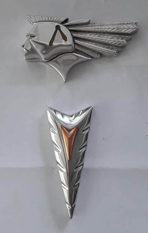

Fitzy, I recommend mounting Last Indian's Indian Head through your grille, mate. You will note that there are provisions on the back to put threaded rod or bolts through it. So at a car show you can always point out you have a unique, hand made piece from your mate Last Indian in Ohio!

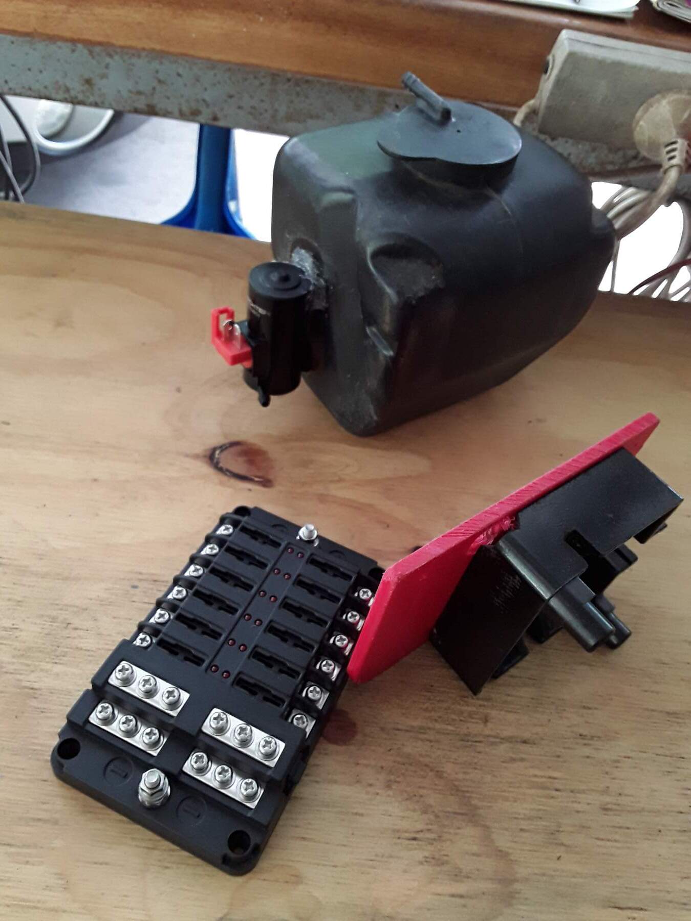

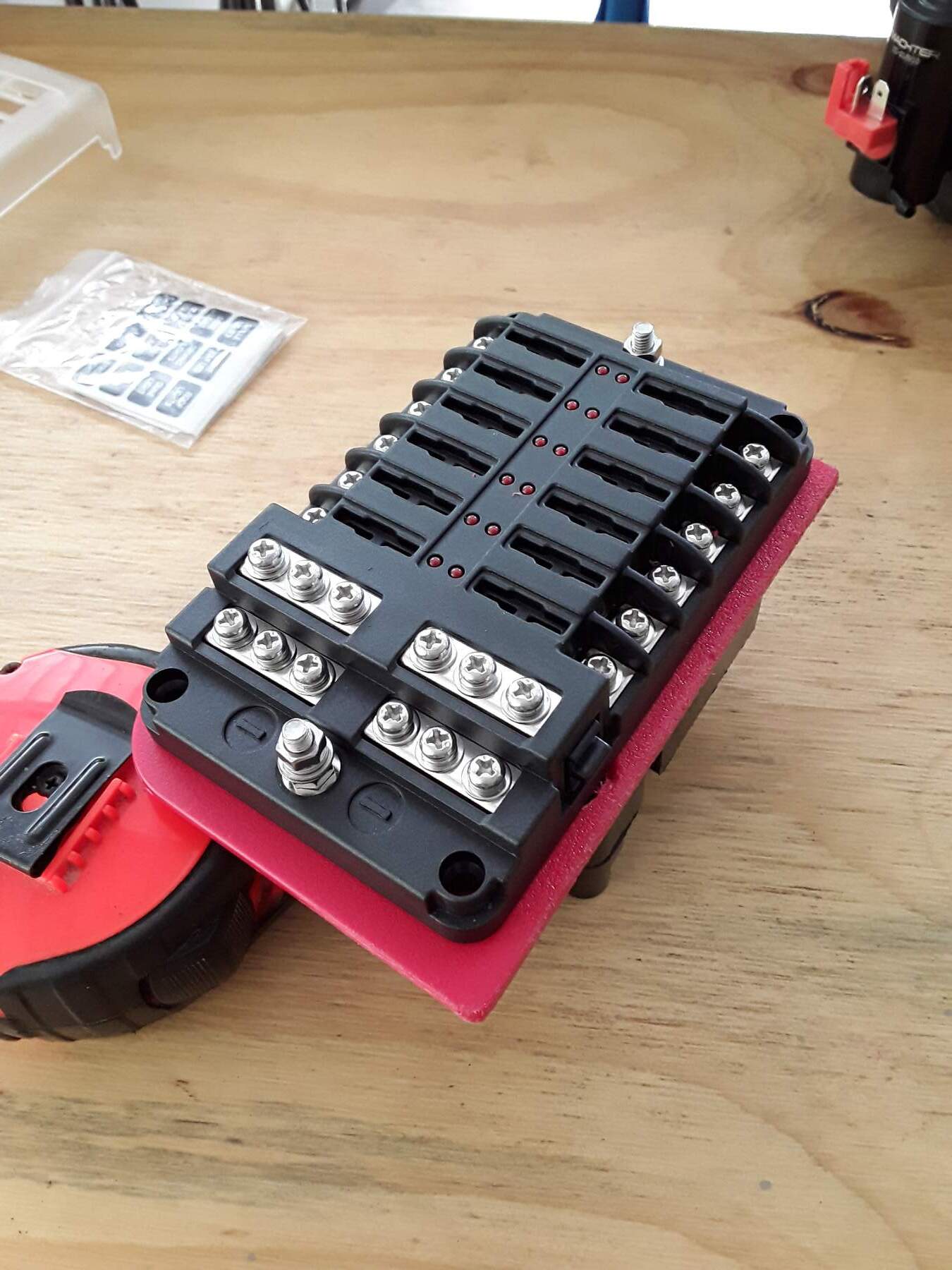

At 2:30 this morning I had an epiphany, but she was asleep so instead I had a brainwave regarding the fuse box nightmare. In my bleary sleep deprived state I could finally see how I was going to fix everything. I used the guts of the original fuse box, bought a cheap nylon chopping board and cut myself a piece out of it and used it to marry the new modern fuse box onto the old one, thereby preserving it's original location and mounting points. I then added spade connectors to all wires and terminals and for the first time ever EVERYTHING works. No histrionics, no maybe, maybe not - it all works. No more hot wires either!
I also added a modern washer pump to the original Pontiac reservoir and voila! 2 speed wipers & washers now working.

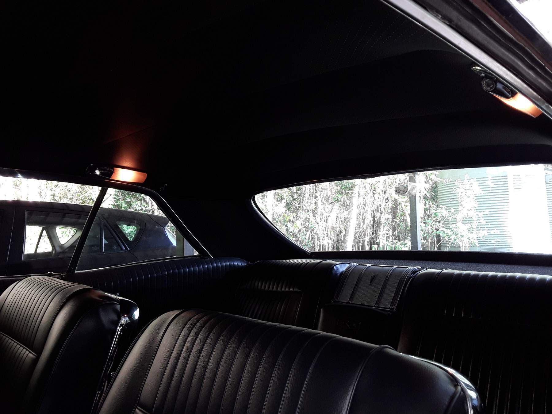

Interior lights work! They are SO cool. And I added a video of how she sounds.

Thanks Wrongway. I gotta admit, I'm sitting here chugging a beer and feeling pretty damn proud. I HEARTILY recommend anyone else to upgrade their fuse box as I have done, if you're having problems. The days I wasted on that old one trying to resurrect it... The new one (about $20 on ebay) uses blade fuses AND if a fuse blows, there's a little red LED indicator to tell you which one. It's a well made quality unit and unbeatable value. Shop around though, coz the same box is available thru many suppliers at wildly fluctuating prices.
Does anyone need spare glass fuses, coz all of sudden I got heaps!
Sounding very nice mate 👍👍👍👍
good move with the fuse board 👍👍
that solves all those little issues in one hit 👍
Whatever happened to blade fuses with legacy fuse ends? They sold them for a very brief period of time back in the 80s or 90s, but they weren't popular and they've disappeared completely. I wish I recall who sold them. We could certain use them instead of these cheap glass POS or having to re-wire the whole car with a new harness justa to get modern blade fuses.
About 6 months ago I searched for them, Frosty. In my case they wouldn't have made any difference but what a great idea. Wiring in the new board wasn't that hard - just gotta be methodical and take your time. The worst aspect was being contorted under the dash with a head lamp & glasses and trying to crimp spades onto wires. I guess also the fact that my car will get by with only 7 fuses DID help.

Yup, that was one reason I rewired my whole car. It was a pain in the a$$ but it should be good till i'm gone lol. I love that your panel lights up to show which fuse is blown! Thats justa awesome bro!!!

i really like your upgraded fuse board.... i should to the same with my girl.
