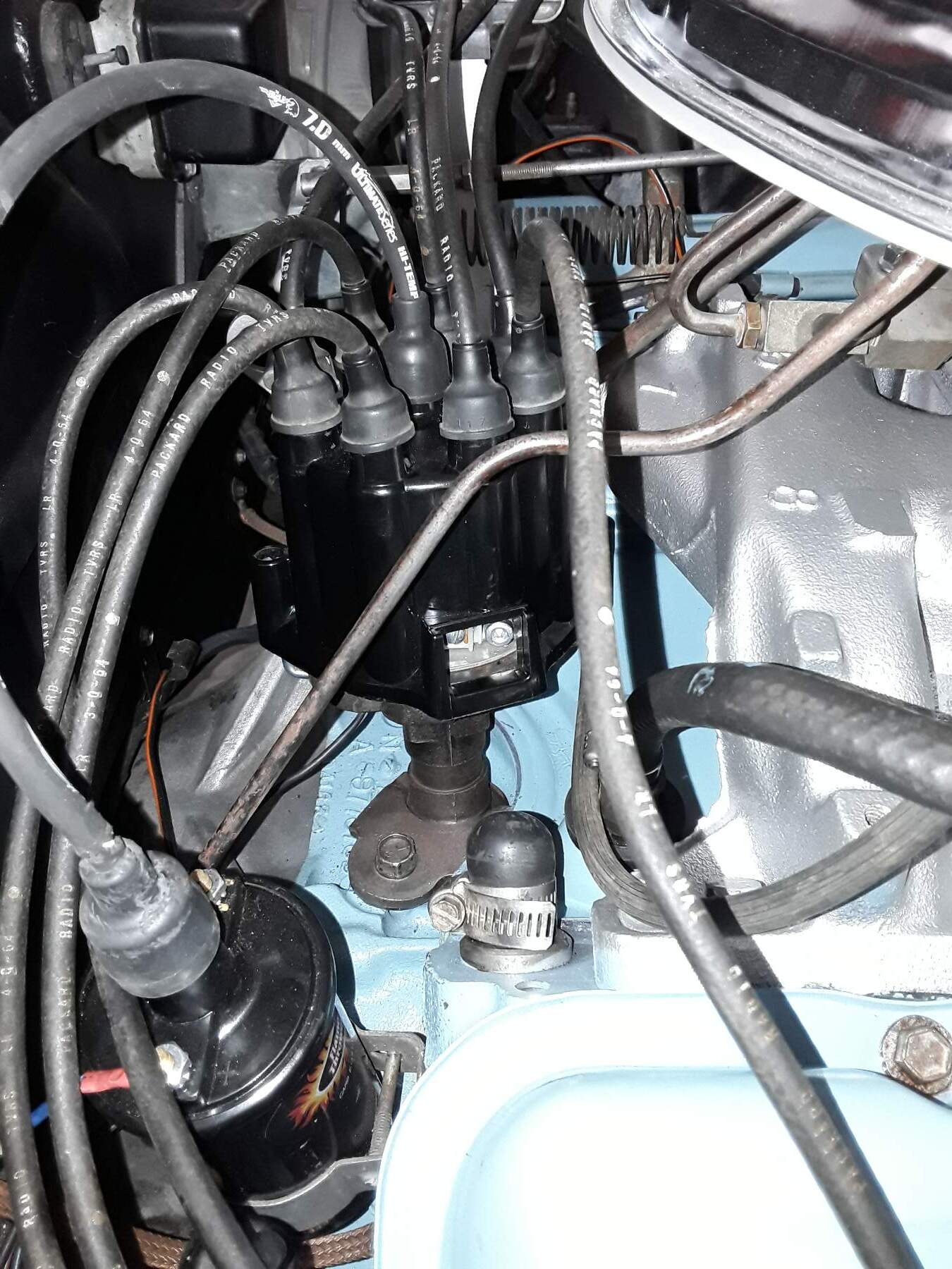

I turn the engine and wait, but nothing. After much fiddling with points and double checking everything AGAIN I'm starting to doubt myself about how I positioned the distributor, but I KNOW I did it right coz I checked it over & over. I have a closer look at my nice new 7mm solid core ignition leads. I was never happy with the way they just don't seem to snap onto the plugs correctly. After much fumbling & screwing around I decide I don't have time for this and shall modify them at a later date, so I dig out my crusty filthy 55 year old factory leads, plug them in and think "oh well, let's see what happens." That baby fired up in less than a second. Once tuned and sorted I'll attempt to post a video. It sounds awesome. I have attached a very quick video of me fumbling with the phone wondering how to take a video! The smoke is a mixture of exhaust (now fixed) and paint & gasket sealer curing fumes.

First of all, pulled dizzy vac hose off manifold port and engine died, so it's working. Plugged both ends, timing was waaay out. Readjusted, reconnected vac hose, engine sounds happy again. Regapped the plugs, modified my HT leads and started her up. Took it up the driveway and no hint of hesitation or histrionics: strong straight off the mark. Now I REALLY wanna take it for a test drive. Seems to have a very low diff ratio (numerically) coz it almost idled up and down the drive even though I gave it a squirt both times. So, for all you peeps with a similar vintage Poncho, for the 65 389s at least, it is imperative that dizzy vacuum is ported directly to manifold and that you set the timing with that hose disconnected and plugged.
I wired up the Frosty Memorial Tach to appropriate coil - and a + point and tried to start engine. No dice - seems that tach was robbing power from both contacts - engine would only run when both wires were removed from the coil, but tach needs coil - in order to get a signal. Even with + straight to battery, engine would not start.
Someone must know what's going on. Your thoughts, please.

mate you get your signal from the - only, at the coil to the tac.... the + goes to switched ignition
the tach reads pulses from the points to earth 👍
so somethings not right....i think you hooking to the + is where your going wrongway, but thats JustA my kiwi 10 cents :driving:

mate if your tach has 3 wires the ground and the signal from the coil are combined .
but dont justA run a wire from the coil negative, do a good ground to that same wire
