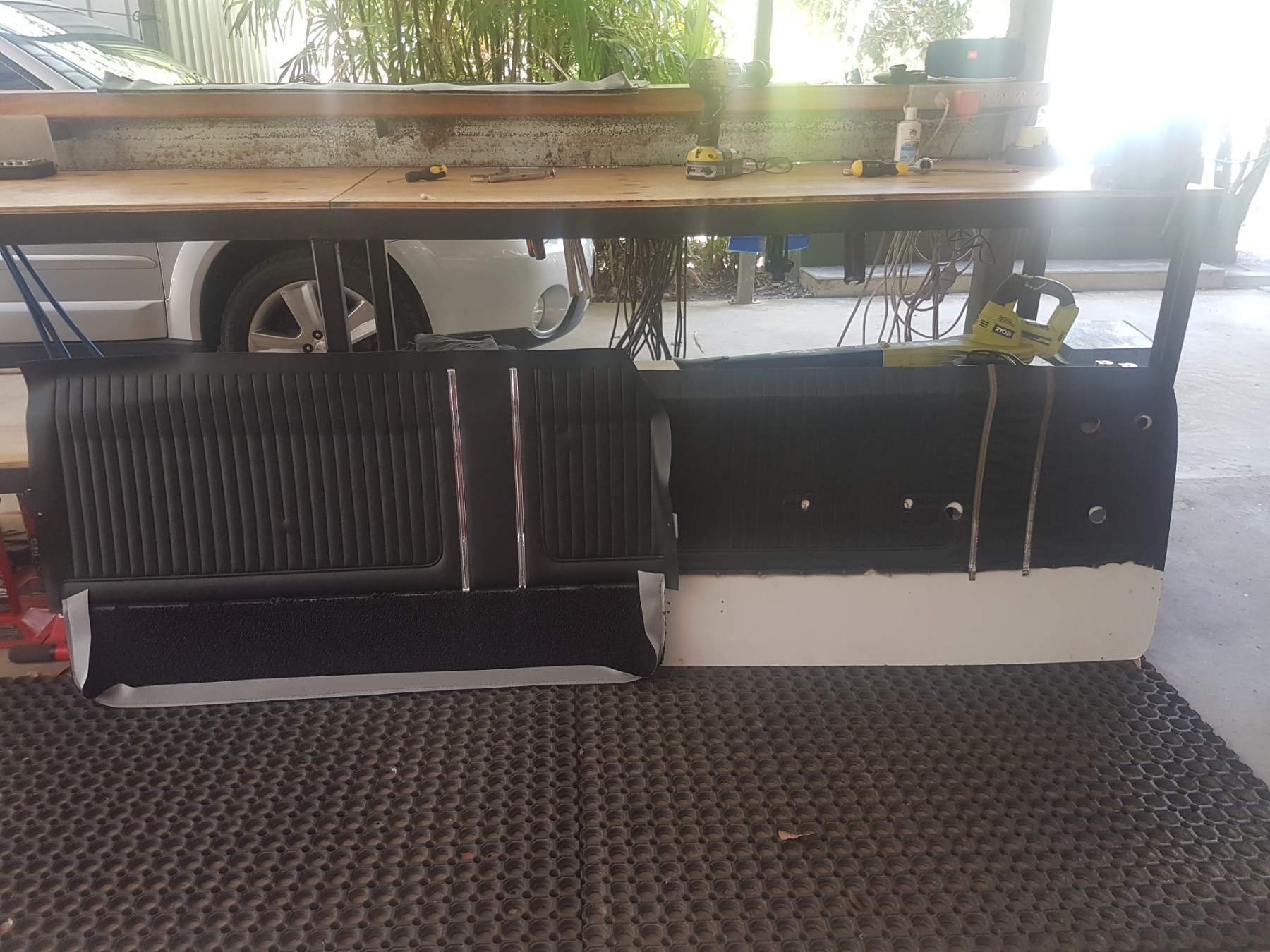

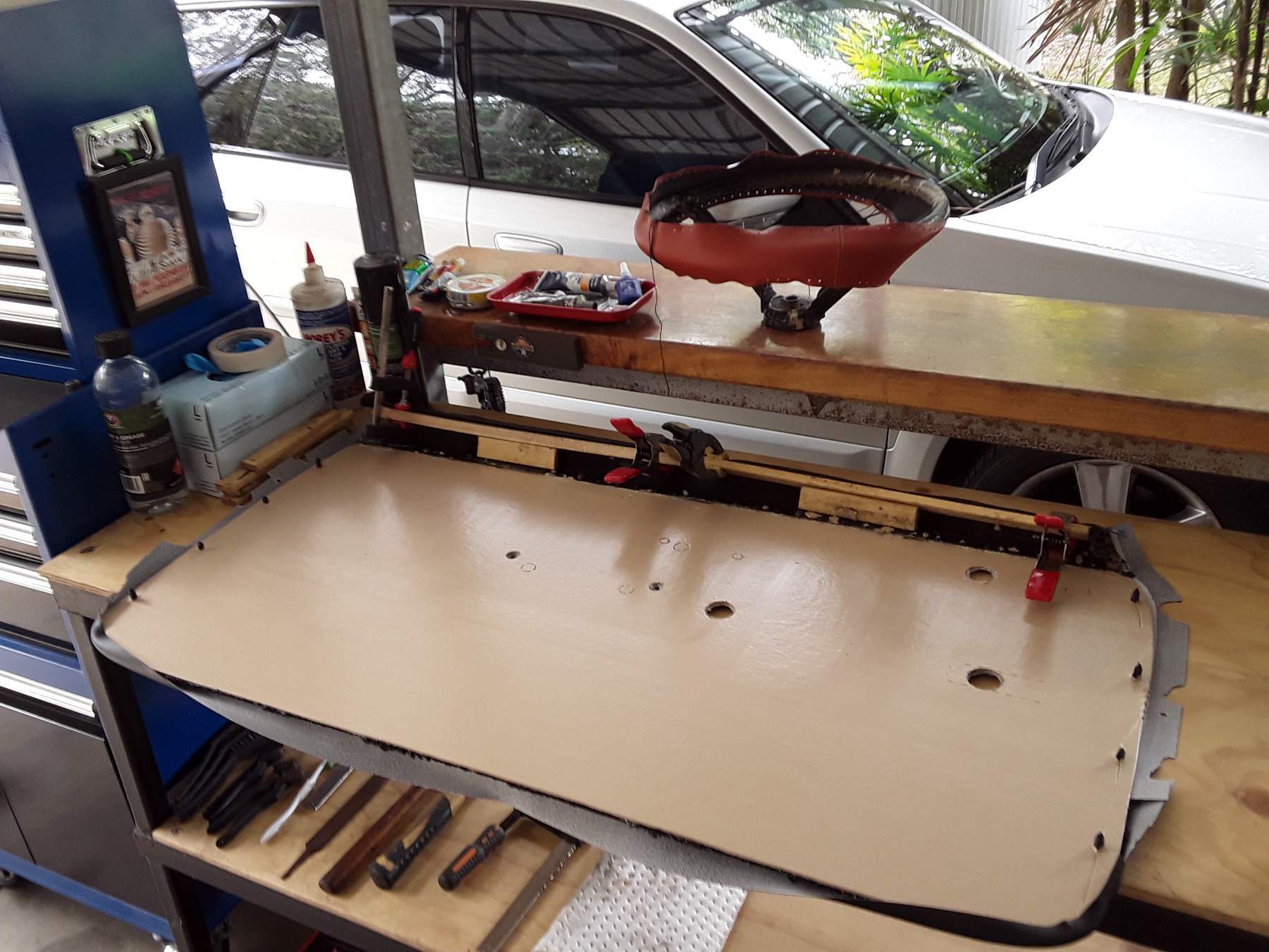

The front door trim panels that I ordered earlier this year (like 8 months ago) finally got manufactured and they arrived last week. Today was a day of fiddling about having to remove and then reattach the curved piece of sheetmetal that is stapled to the top of the door trim and is covered in vinyl so as to upholster the door right up and over the top of the door. When I ordered the new panels I had the option of unassembled or fully assembled (includes new top plate and is basically ready to install except for the mouldings and badges.) I baulked at the cost and assured myself I could do that. So, instead of spending an extra 100 bucks or so, I spent the day swearing, measuring, cutting, swearing, fiddling about, swearing...you get the picture. Phase One of door trim trauma is complete. I shall commence Phase Two next time I'm home. I shall lay awake at 3am tomorrow wondering how I'm going to get the little nylon pins that allow the panel to snap into the little matching nylon recess plugs that are pressed into the door frame. I'll need to attach them to the panel somehow without disturbing the  glued vinyl of the trim panel.

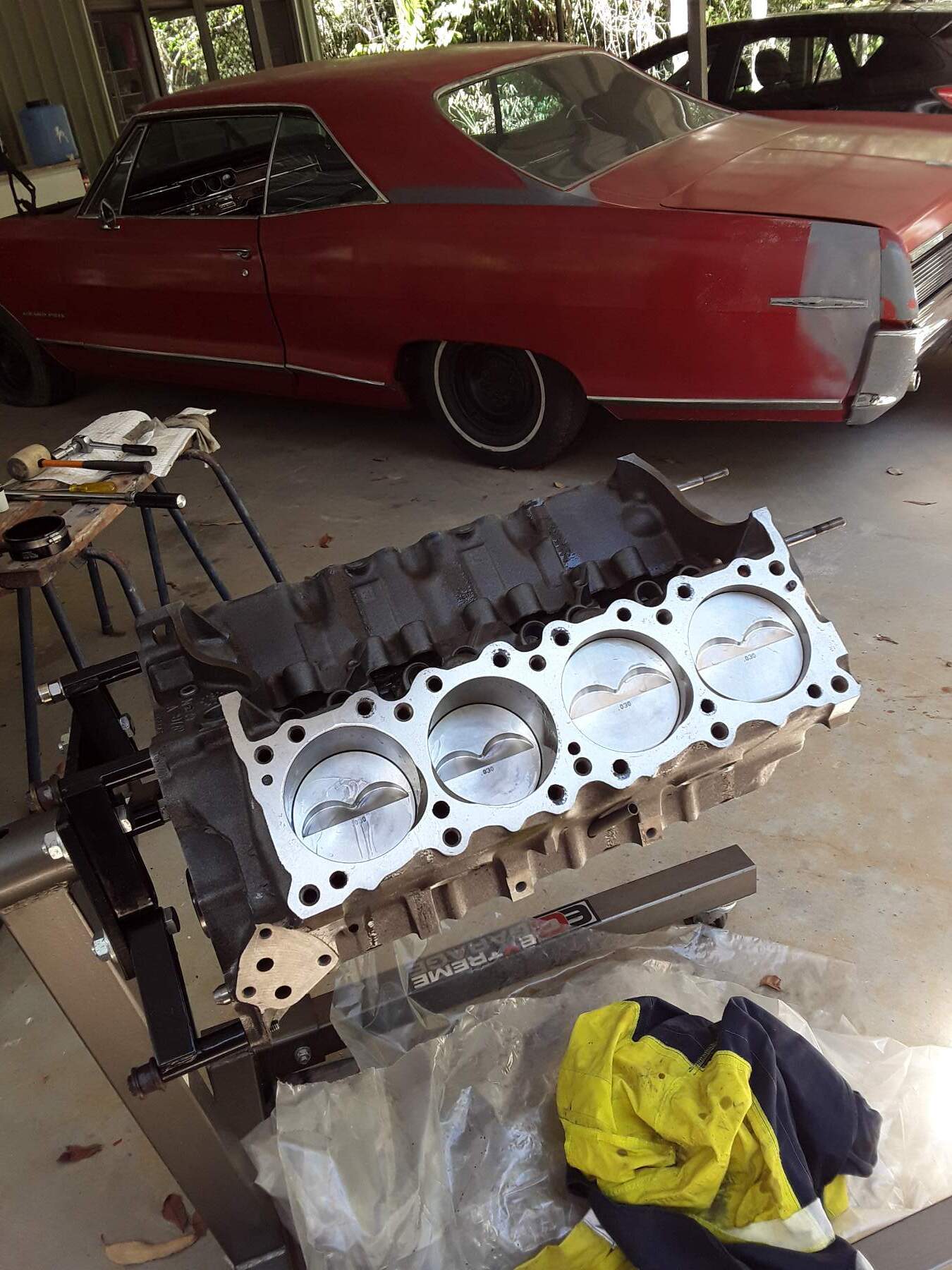

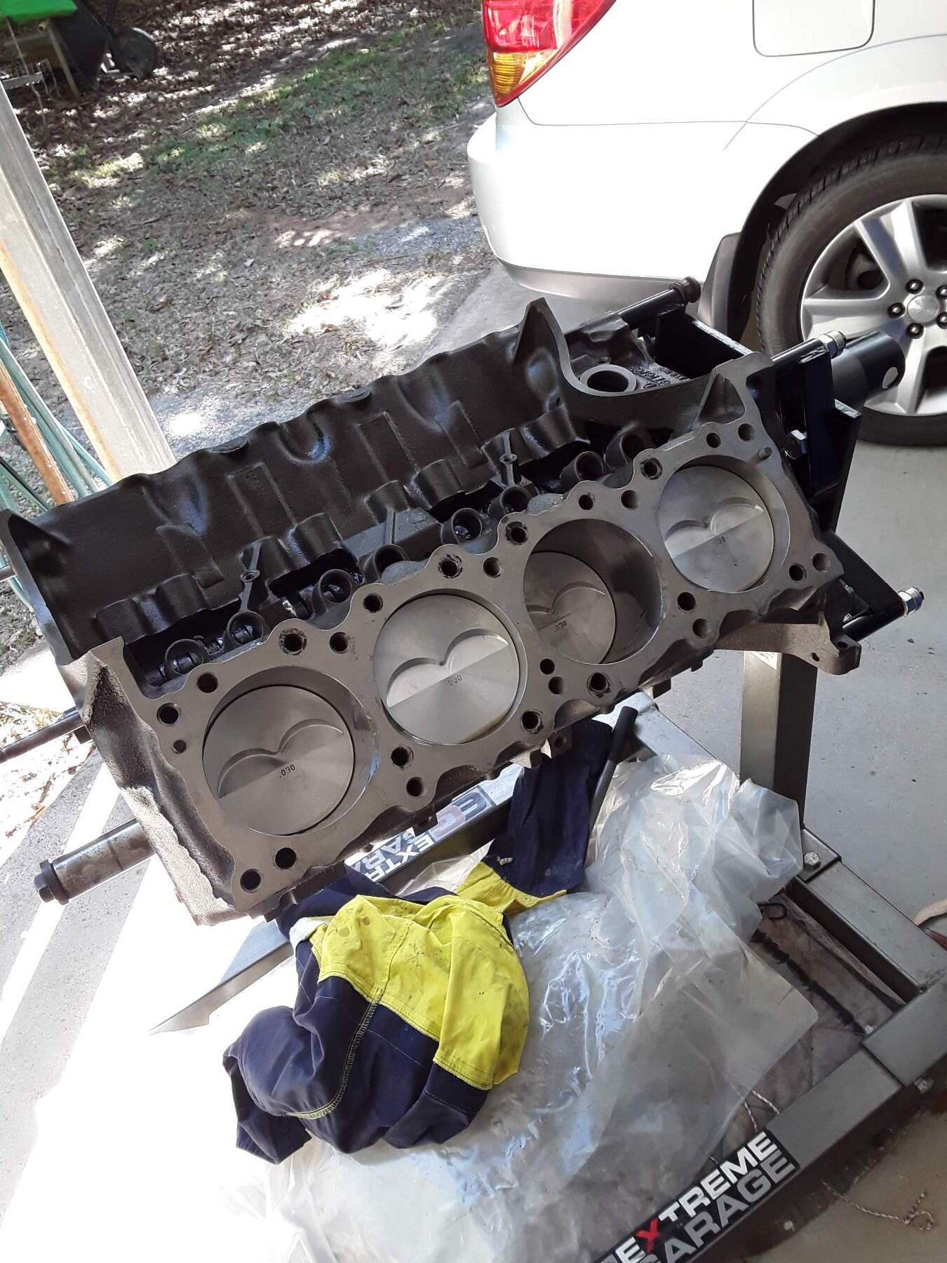

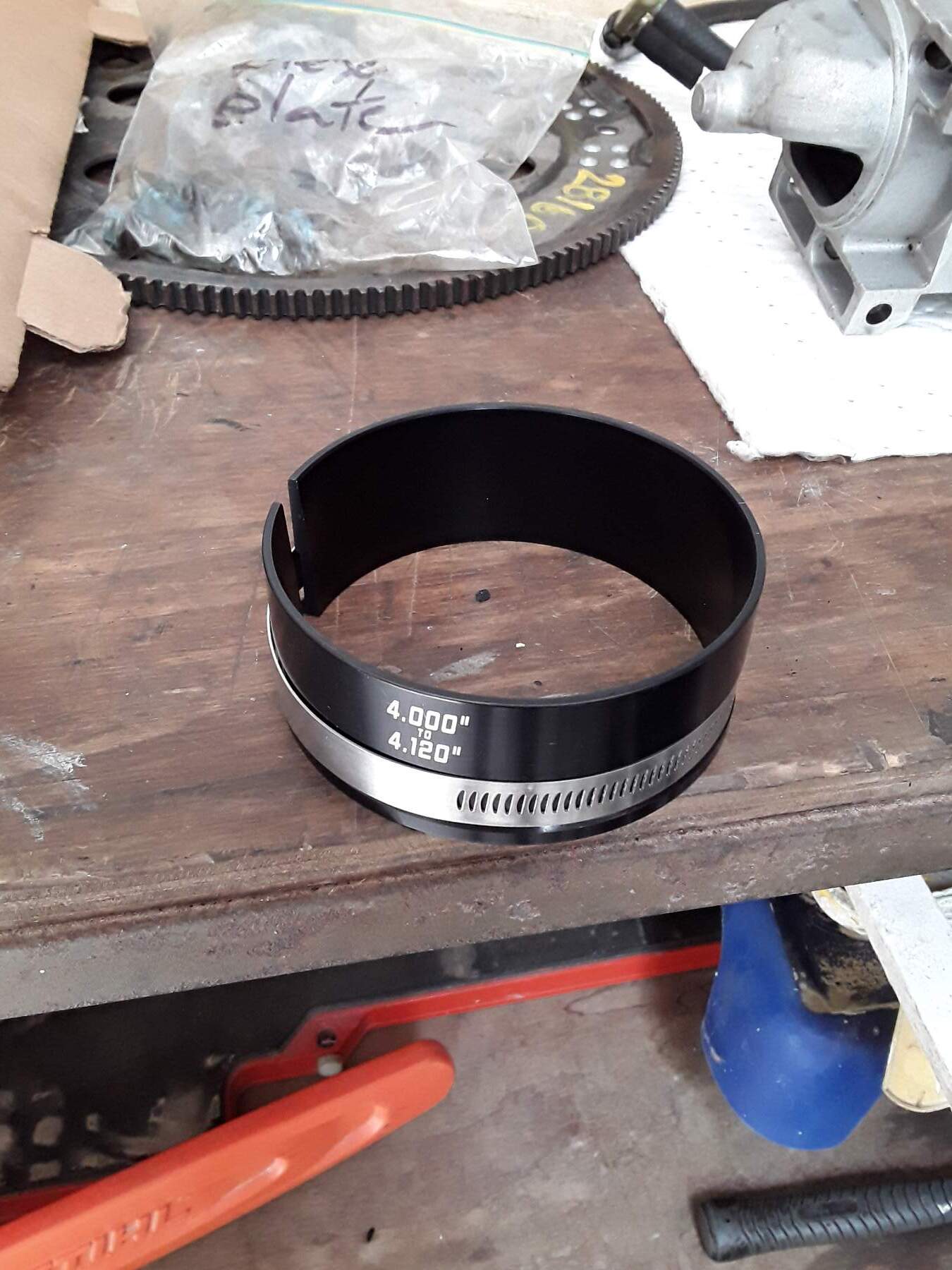

On a happier note, my 'tapered piston ring compressor' from Butler also turned up and what a pleasant experience it was to tap the remaining pistons into their bores. Mark my words: if you're silly enough to embark on an engine rebuild, purchase one of these babies. The time I wasted trying to jam that one piston in last time using my El Cheapo compressor equated to the time it took me to install the remaining 6 pistons today and that's THE TRUTH! 50 bucks from Butler.

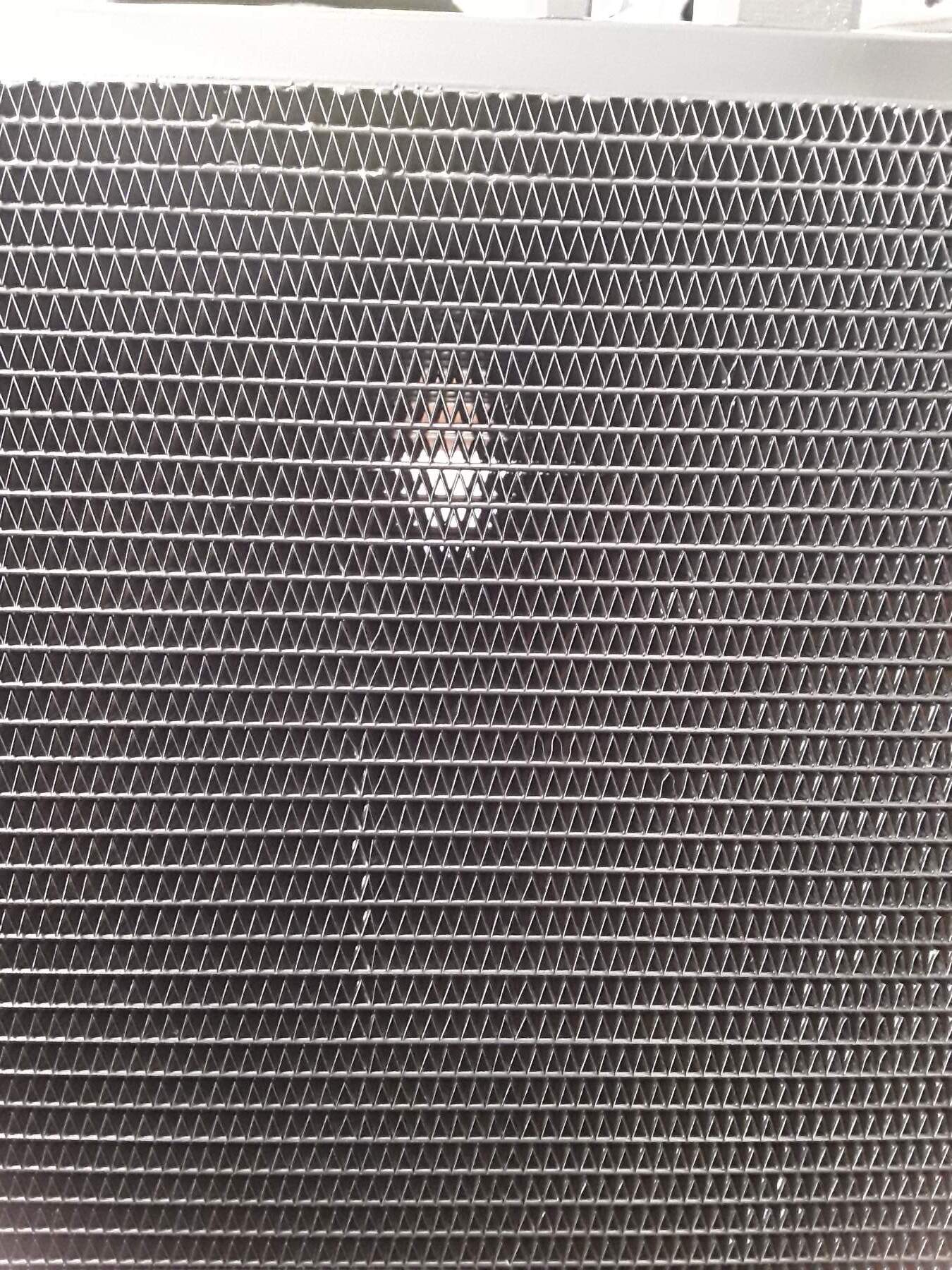

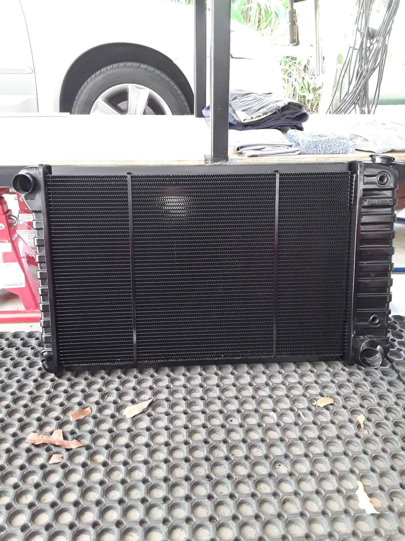

One last thing: I got fed up waiting to hear from the dude from the aluminium radiator place, so got my old one overhauled - will pick it up tomorrow. The chap must be 70 years old and has been building radiators for decades. He educated then advised me as to the various nuances of tube size, number of tubes, amount of fins, tube spacing, blah blah blah and I said "look mate - Pontiacs run hot. Just make me something that's gonna do the job here in the tropics." I'll post a pic when I get it home.

Another day spent throwing buckets of money into the GP, aka The Money Pit. I picked up my newly rebuilt radiator today and it looks great. The cooling tubes are a coupla sizes bigger, still 3 rows and the cooling fin count has been ramped up. I have been assured it will flow and cool considerably better than the factory one. Combined with the FlowKooler water pump, it might just be the coolest running Pontiac in Australia, not just the coolest looking!
Ah, the interior door panels. What can I say? After considerable engineering, I attached the original metal top plates to the new cards. Before I secure the remaining vinyl trim to the panel edges, I need to figure out a way to ensure the panel clips in to the nylon grommets embedded in the doors. Now, GM supplied tiny threaded studs that would push into the TINY aperture in the nylon grommet. Do you think I can find anything that comes close? We're talking a maximum width of 2mm and it has to be threaded so that once it's pushed in, it doesn't pop out. I am thinking to completely rethink the entire scenario and might prise out the nylon grommets and use 'christmas tree' plugs that will screw into the door card and will then push into the apertures left behind by the grommets' departure. It doesn't have to be secured like Fort Knox because the card is anchored at the top, screwed in at the bottom and has the armrest and window regulators to help hold it in place. Thankfully, the door cards have been presliced in the appropriate places in order to be able to install the retaining clip of your choice. It would have been a nice touch if they supplied the correct fasteners - for 329 bucks, I'd expect that.

The best thing about the radiator is it is based on your original, so it will fit and look like the original and work much better and no one but you will be the wiser.

Anyway, I got skin cancers getting cut out tomorrow (woop woop!) and a list of crappy jobs to complete around the place before I can even look at the car. Just quickly, at 3am this morning I finally figured out how I was going to get those door panels to affix to the doorskins. After much scouring of various websites (got too much time on your hands? Google 'car interior fasteners' and sit back and marvel at what is available) I decided on Xmas tree clips. I then carefully dummy fitted the panels and marked where the clips should go so as to line up with the now bare holes where the nylon grommets used to live. I drilled holes through the new cards and pushed the clips through. I now need to glue all remaining vinyl upholstery around those clips, fit the GP badge, red reflector, door lock ferrule and chrome strip above the carpet and eventually snap that baby into place. I'll post pics tomorrow - too damn hot right now.

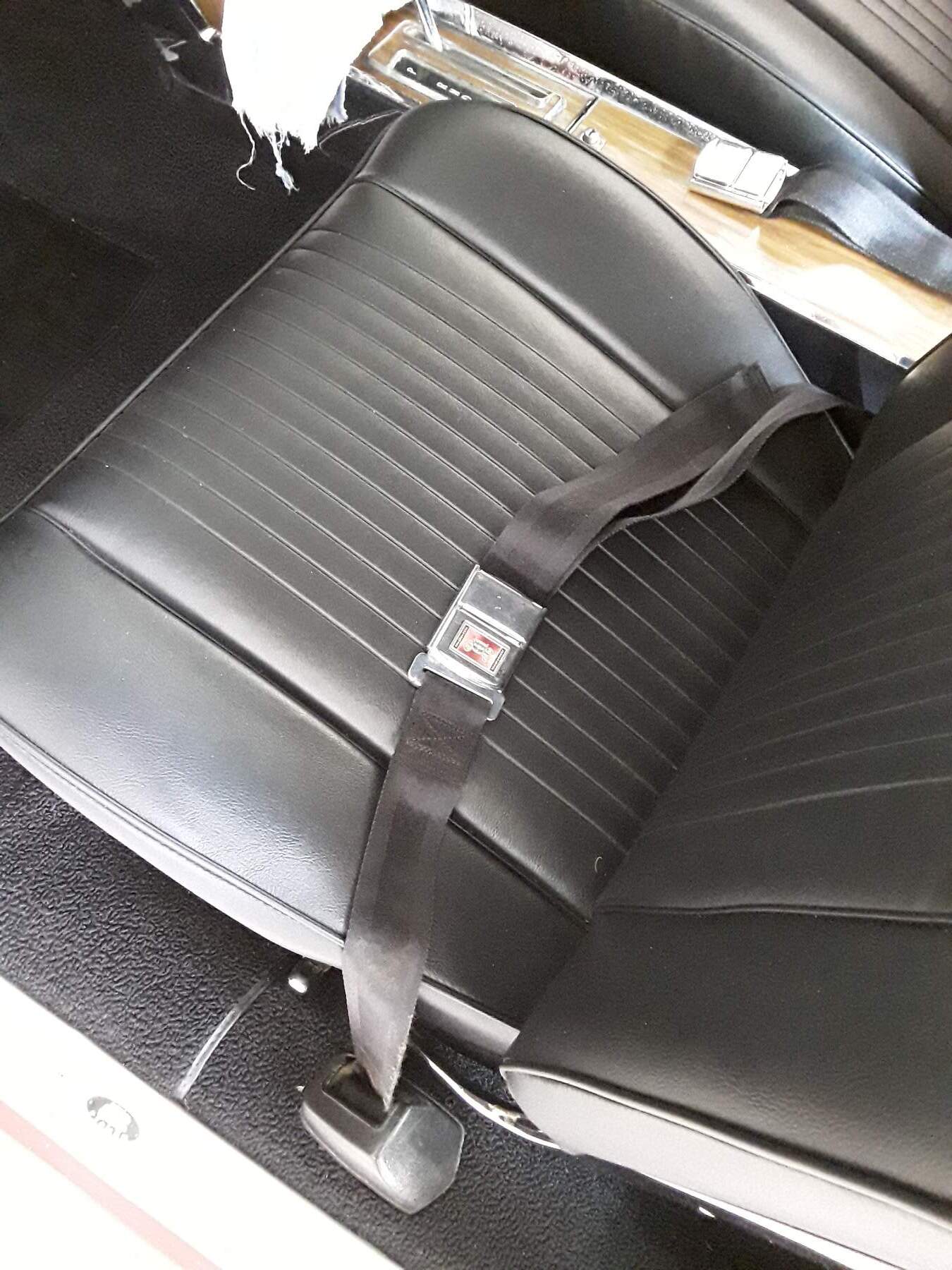

Here's a pic of my original seat belts and my progress on the door trims. Some more vinyl glueing and attachment of interior jewellery and I reckon I'm so close. It's kinda a big deal for me to attach those trims, coz that signifies the conclusion of the interior fitout. You gotta remember, the car's interior was shot when I got it - 2 years ago.

wow! how did your car get retract lap belts !!!
thats so cool! :cheers:
and you have done a great job of that interior !🙏 image.png.fbabb09e59ea829f11912c1f861801ad.png!
According to the ID plate, it's factory fitted options were 2 speed washer/wipers, retractor belts and a vinyl roof.

No - the belts are black, to match the factory black interior I guess.
