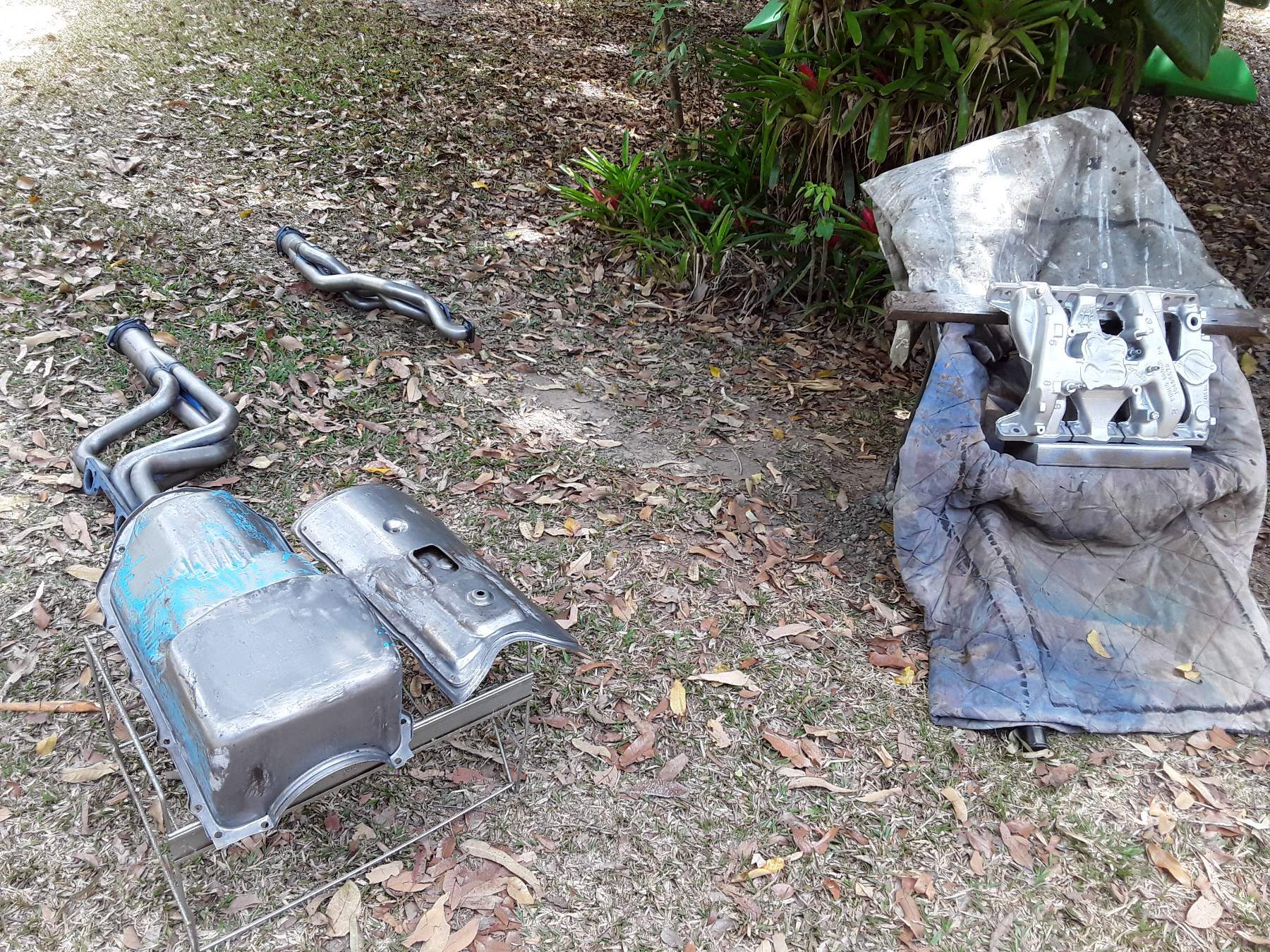

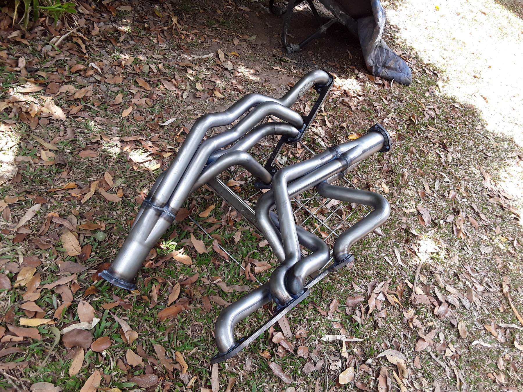

Another fruitful day's toil comes to an end. I clear coated the headers to retain that nice raw steel look they have - far better than my prior horrible blue paint job. Note to self: work on car, THEN take heroin, not the other way around. I also cleaned up the windage tray (no need to paint it, obviously) and chucked some primer on the valley cover & oil pan. I also prepped, primered & painted the inlet manifold but chose silver to finish it off, and I'll tell you why. Yes, I know it should be Pontiac blue but I'll bet back in the 60s, once they assembled the engine, the whole thing got painted. I want to break it up a bit and the silver will look cohesive with the carby and just gives it that point of difference. I think the Pontiac blue block, heads & rocker covers will contrast nicely with the shiny steel headers, silver manifold, nice clean aluminium carby and chrome air cleaner. All the ancillaries will be either blue, black or polished steel for that nice 'hand built' look. I also started on the engine bay by coating a few bits with chassis black.
Hillbilly Paint Shop. Yee - haa!!!

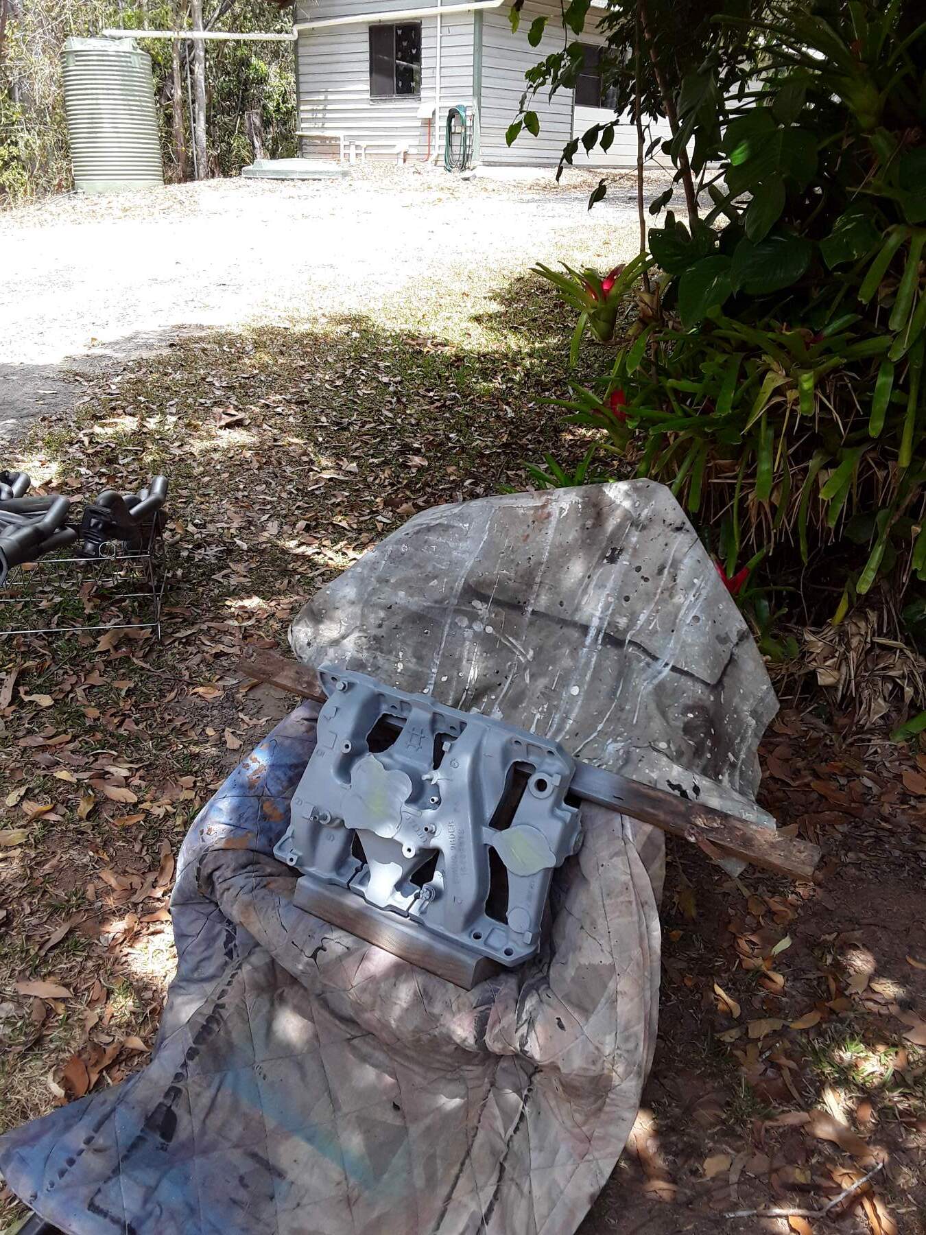

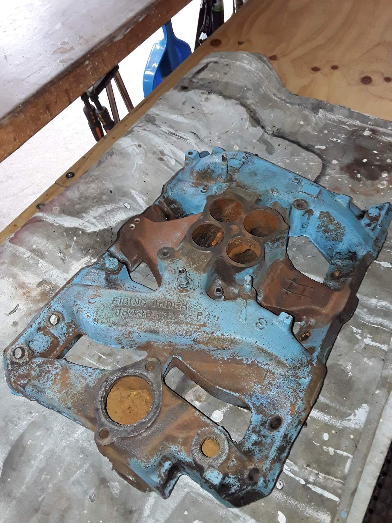

Whoops! I forgot to mention that I ground out the little stove pipes on the inlet manifold that feed the auto choke and filled the holes before painting.

nice work mate,:cheers: tell me, what did you use to clear coat your headers? i am looking for something that will take the heat when i redo my 8 lugger drums
Was wondering the same thing.  Never seen Hot paint clearcoat.
It's just VHT Flame Proof in a spray can. Obviously, you can't primer it first, so I am a little doubtful regarding it's durability but it's better than nothing. I used a pot scrubber scouring pad to try and key the surface before cleaning it down with wax & grease remover.

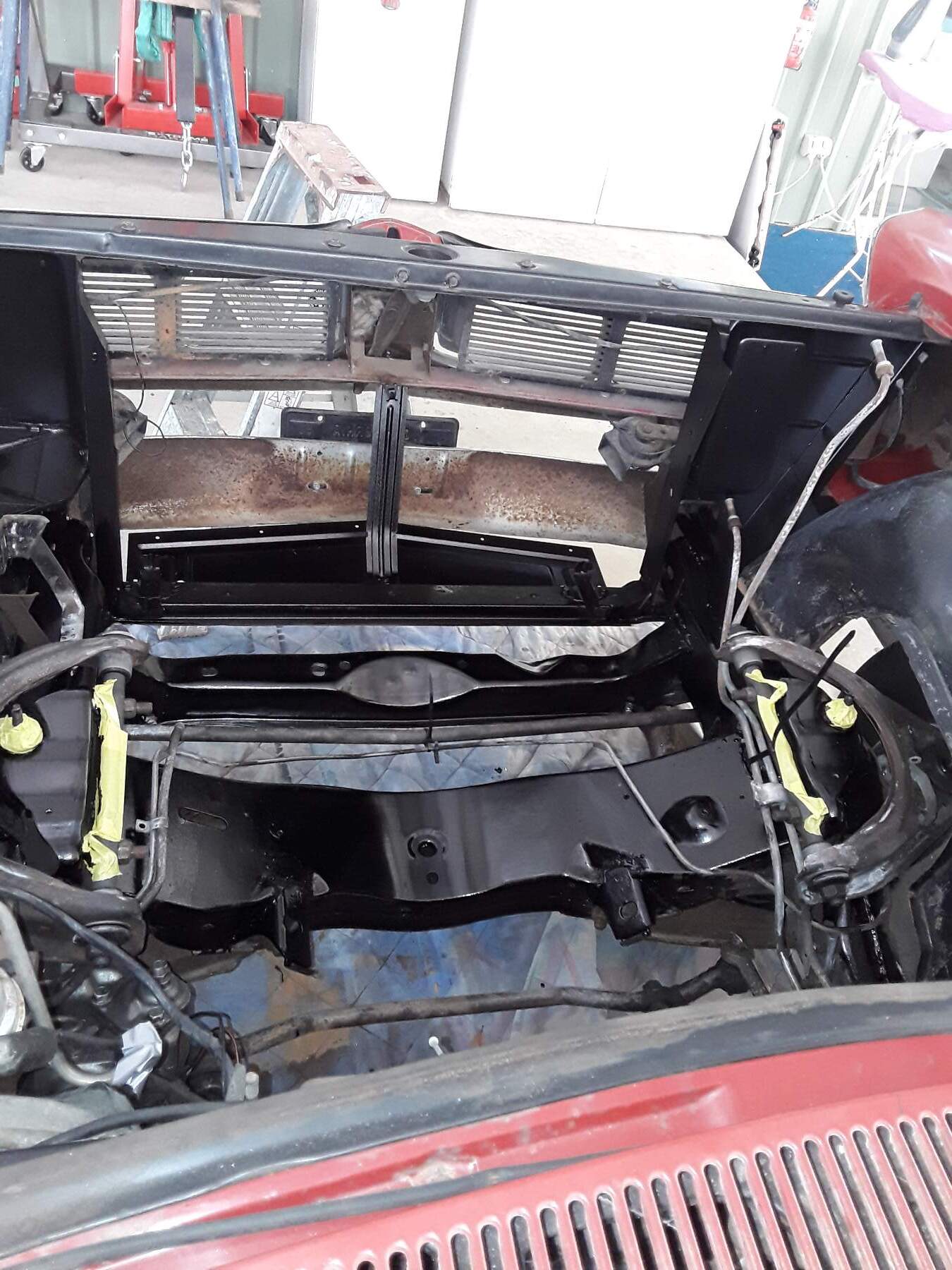

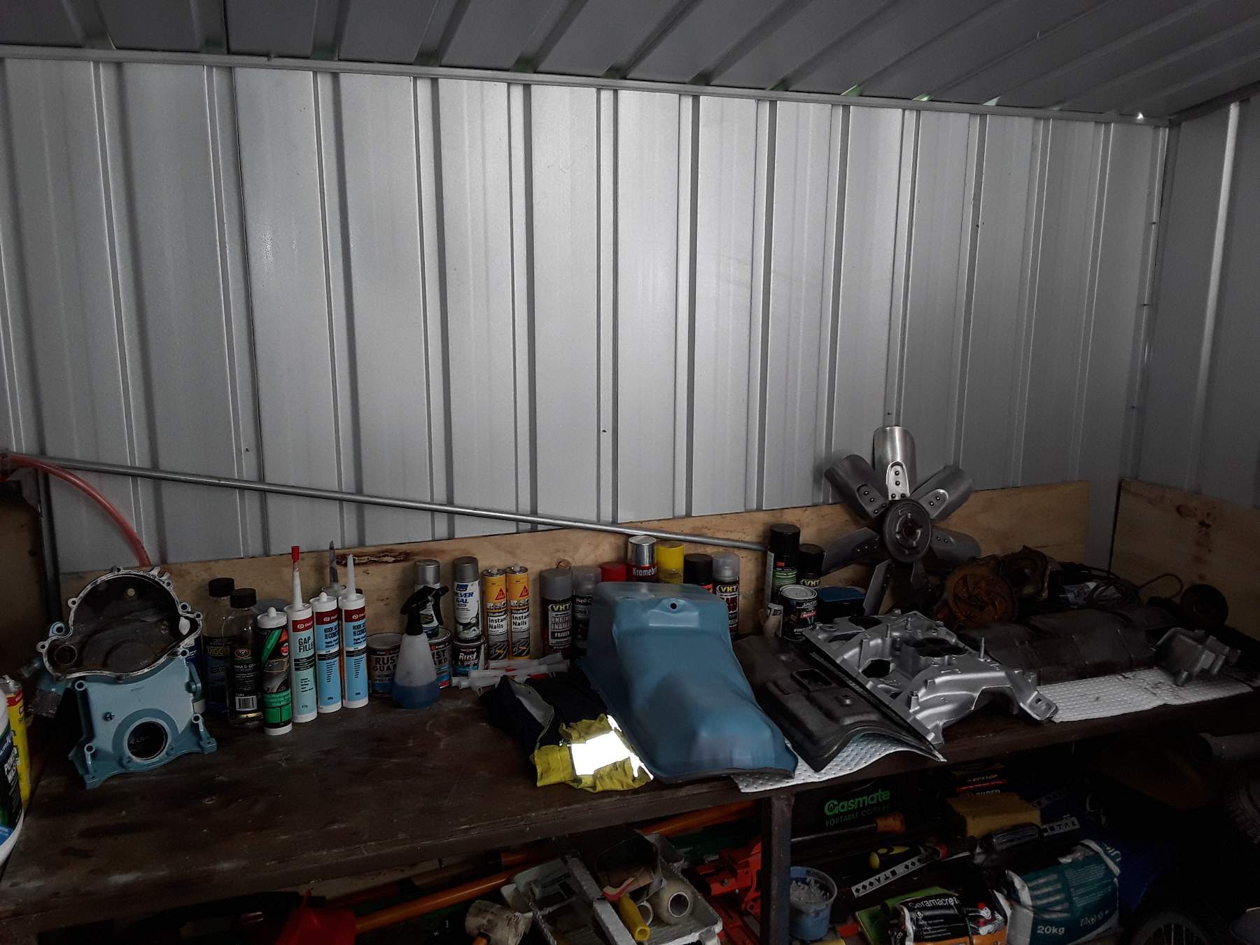

Another day of cleaning, priming, masking & painting. I painted the oil pan & timing cover, polished the alloy alternator mounting bracket and did a bit more in the engine bay. I am carefully brush painting various bits & pieces which will either never be seen or will only be seen if you are actually carefully inspecting stuff in there. I will go over the finished surface with the lightest wet sandpaper to be rid of any telltale brushstrokes, but with careful application, you can pretty much get away with it. I'll be sure to spray the larger more visible areas.

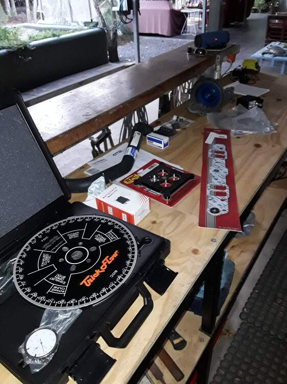

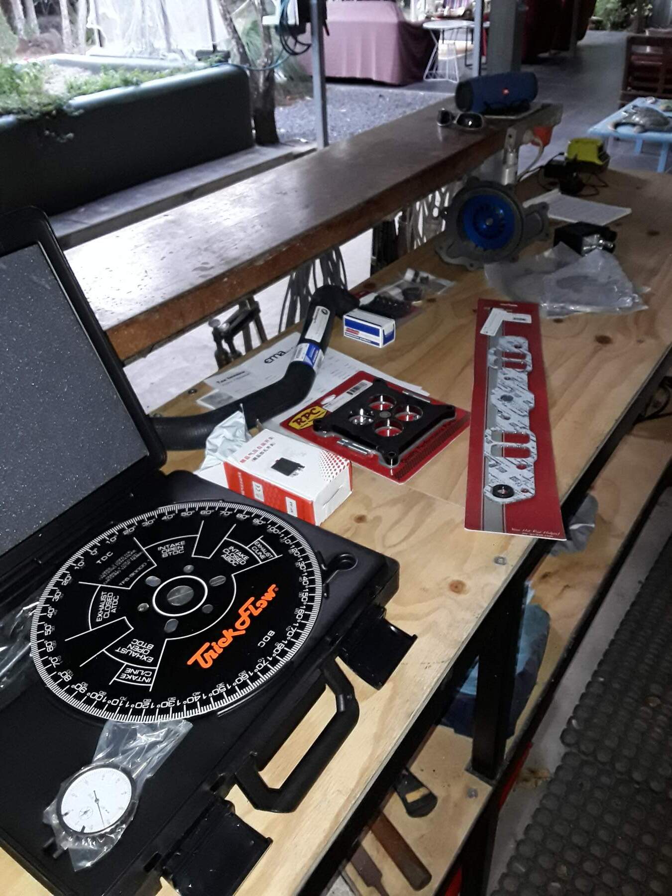

Also, after much deliberation (at 3am, my favourite deliberating time) I went balls out and ordered a cam degreeing kit. Those damn things are expensive. I might hire myself out as a 'cam degreeing service' once I learn how to do mine. All the El Cheapos were out of stock so I sold my soul and bought a Trick Flow here in Australia. I was fussy because I wanted the 11 inch degree wheel, whereas the cheaper Proform kits come with a 9 inch wheel.
Sorry about the crappy photos - even with the flash active there wasn't enough light.

thanks for the clear coat info,,, i will go grab a can and test it out.
Kiwi - I get my VHT stuff from Autobarn, coz Supercheap doesn't sell VHT.  Just be sure to do what you can to mildly roughen the surface if you're going on to raw steel. Remember when I was so proud of my repainted rocker covers? Well, whatever rust I thought I had neutralised is just starting to come through again, so I might have to take 'em back down and chuck on an extra coat but I never clear coated them last time. Because they're a high visibility item, I want them to look their very best, so shall finish them with a clear and I'll post the result.

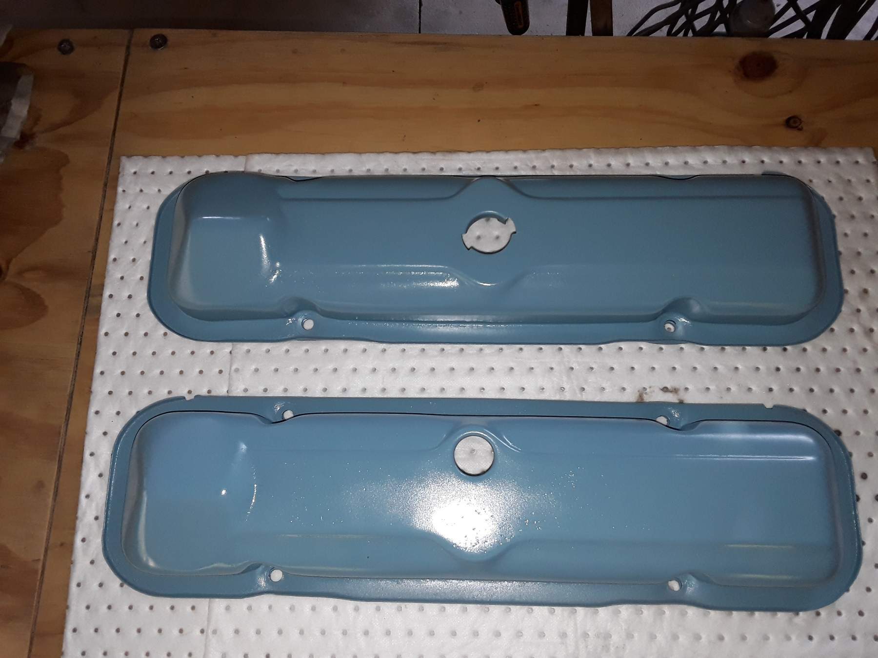

mate i feel your pain!!! nothing worse than having to do things twice!!!

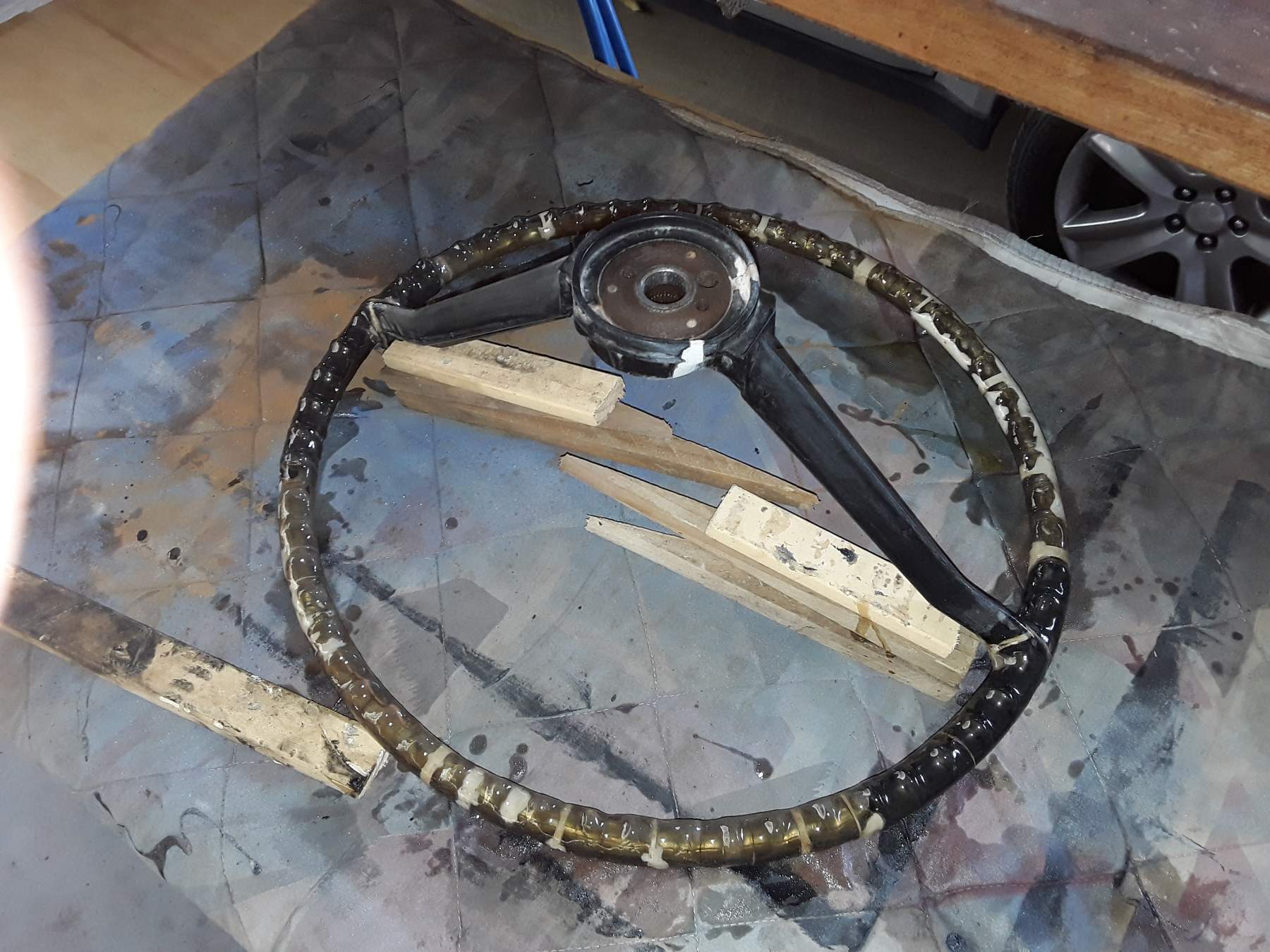

Back to work tomorrow for another 7 days, but it has been a productive week. Today, I did some more in the engine bay, reprepped & repainted the rocker covers (clear coat will go on when I get back) and had another go at the steering wheel - I did some more shaping and then liberally poured fibreglass resin over the structure and will gradually build it up in layers until the rim thickness is uniform. Next time I'm back, I'll want to at least start prepping underneath the hood for repainting, to complement the refreshed engine bay.

Hey y'all, home again after 7 days at work. I came home to a sack of presents and am now waiting on engine internals to turn up so's I can get the thing back together. Will visit machinist tomorrow to see how they're going. Should have engine bay mostly sorted by end of my R and R.
Will catch up on all your activities tomorrow morning.20211005_175559.thumb.jpg.bd49e44d90037bf8916b746d0d460517.jpg
Okay you guys, come on - that's enough about Kiwi's funny pink chair. Time to get back to Pontiacs.
I visited the machinist today. Crank is all nicely linished, block all cleaned up. Heads cleaned up, a light milling on the intake faces, all the valves are good, new valve springs and locknuts are on order, new freeze plugs installed in heads and don't those castings look nice all shiny & new. I'm thinking I might just clear coat them so as to match the silver intake manifold and they'll contrast with the blue block.

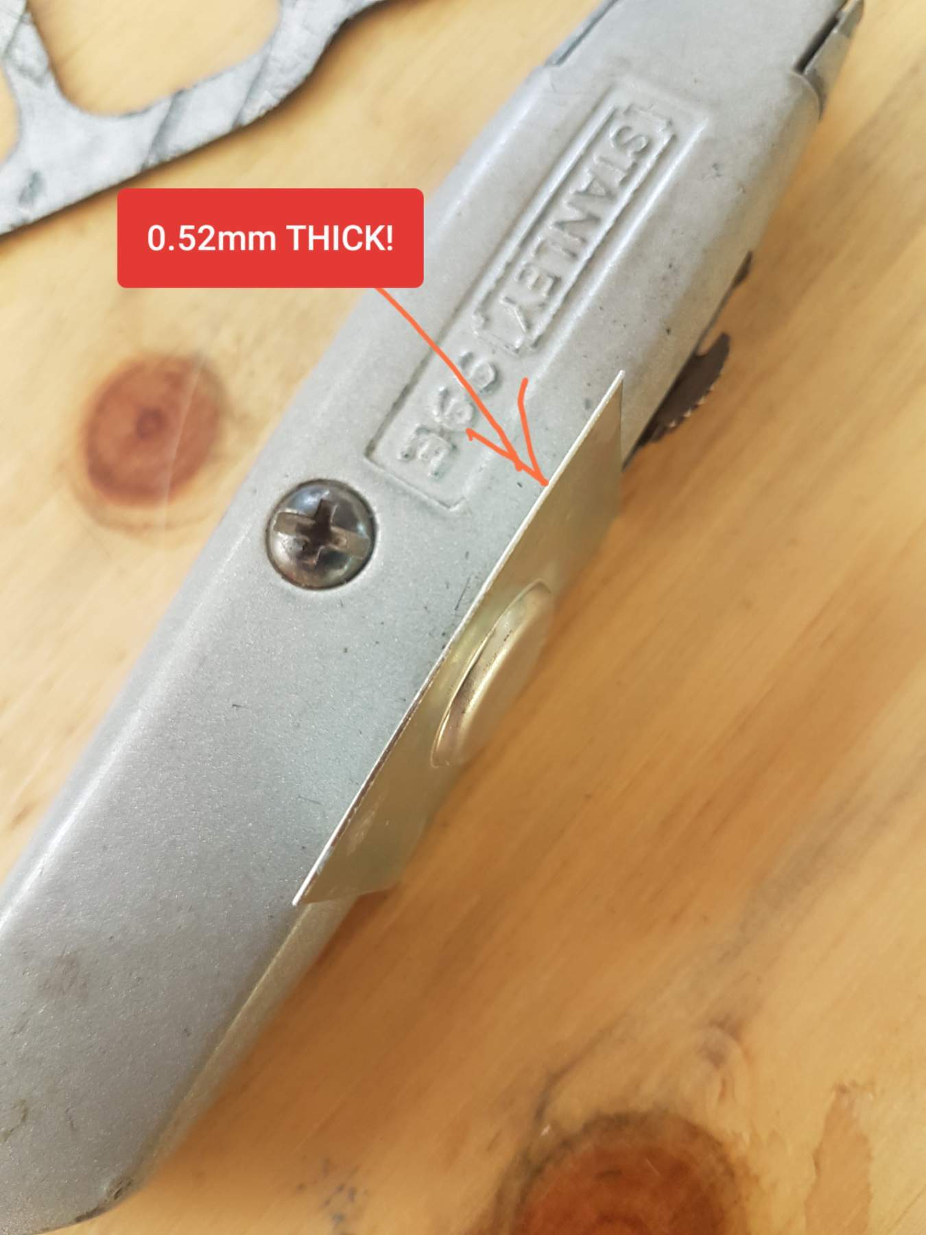

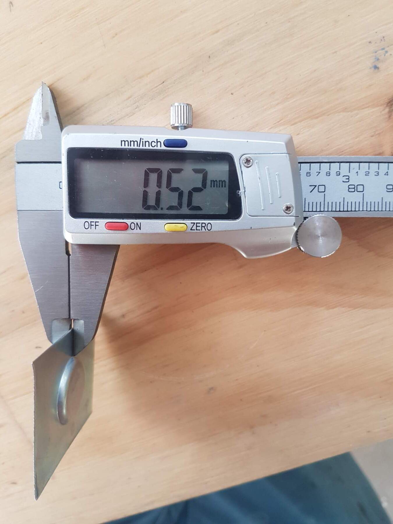

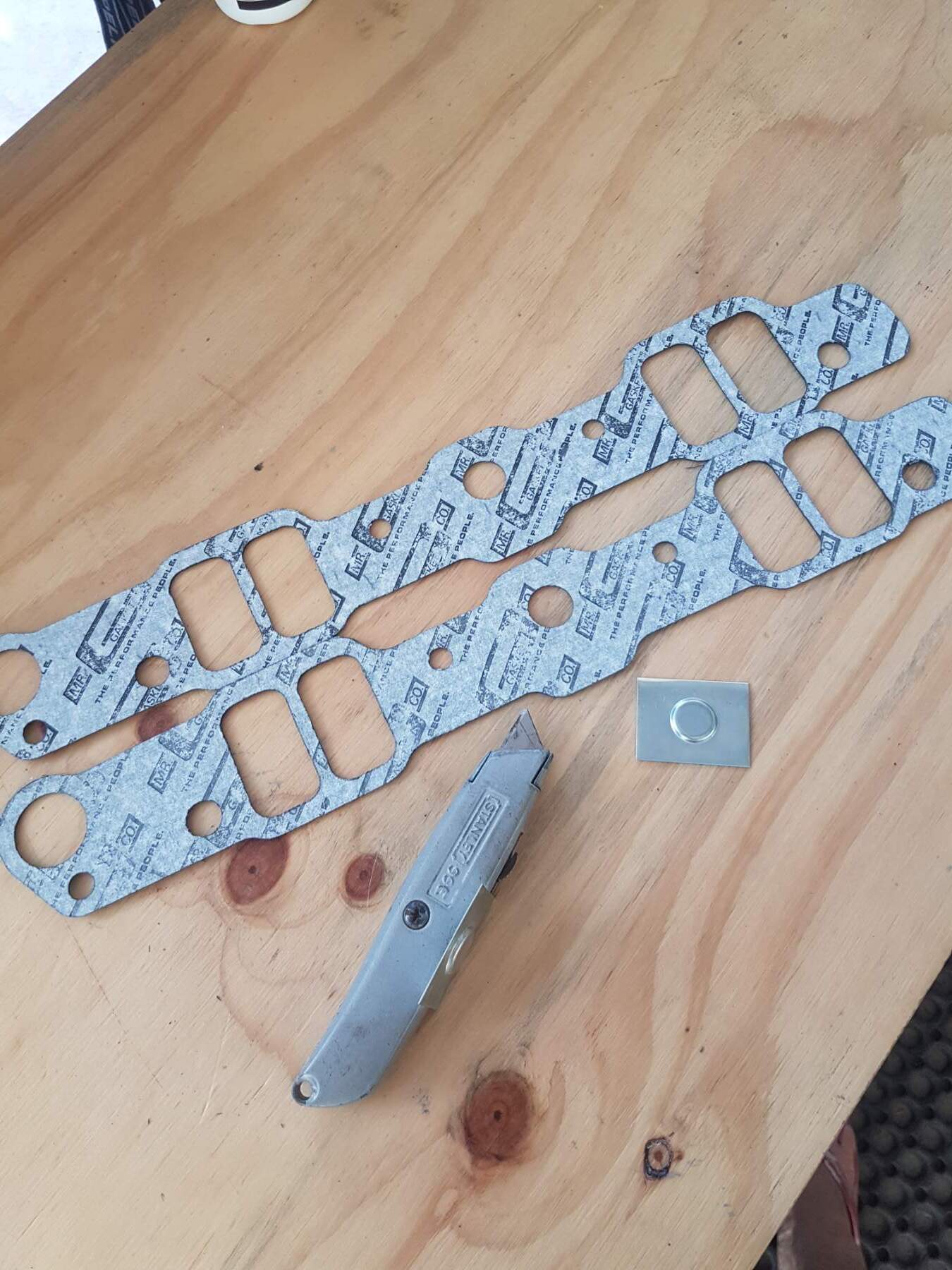

I inspected all my goodies today - FlowKooler and new divider plates are a good fit but there are a couple of minor issues with some other stuff. First off, Kiwi, did you ever get around to purchasing a phenolic spacer? Mine turned up (to suit Holley & AFB it said) but it doesn't. As usual, I can modify it but will contact the supplier first to see what might be done with it. And my 'exhaust crossover block' intake gaskets turned up but have a look at what they expect will put up with endless hot exhaust gases. Those little bits of stainless steel are 0.52mm thick - that's 20 thou. I'm thinking of getting some thick stainless plate made up and shoving those in the crossover ports. For our US readers, the last thing we need down here in the Southern Hemisphere is extra heat under the carby. Anyway, these are minor problems that I can sort. Oh, and the new pressure switch for my El Cheapo compressor turned up and now it works like it's supposed to. Happy days.
fitzy i reused my base gasket under my afb,,, it was super thick and in good nick and i recon it will help stop heat soak into the carter... i didnt have my intake manifold off to plug the exhaust cross overs and i would leave them open... i dont live in super hot northern Queensland!! and it does help cold start , to vaporize the fuel in side the intake runners under the carb.
gota show us a picture of what turned up
Wouldn't think you could go any thicker on that blockoff.  How do you expect your head to seal to the block if you went any thicker?   Hate to see ya blow the gasket N have to tear it down all over again.
