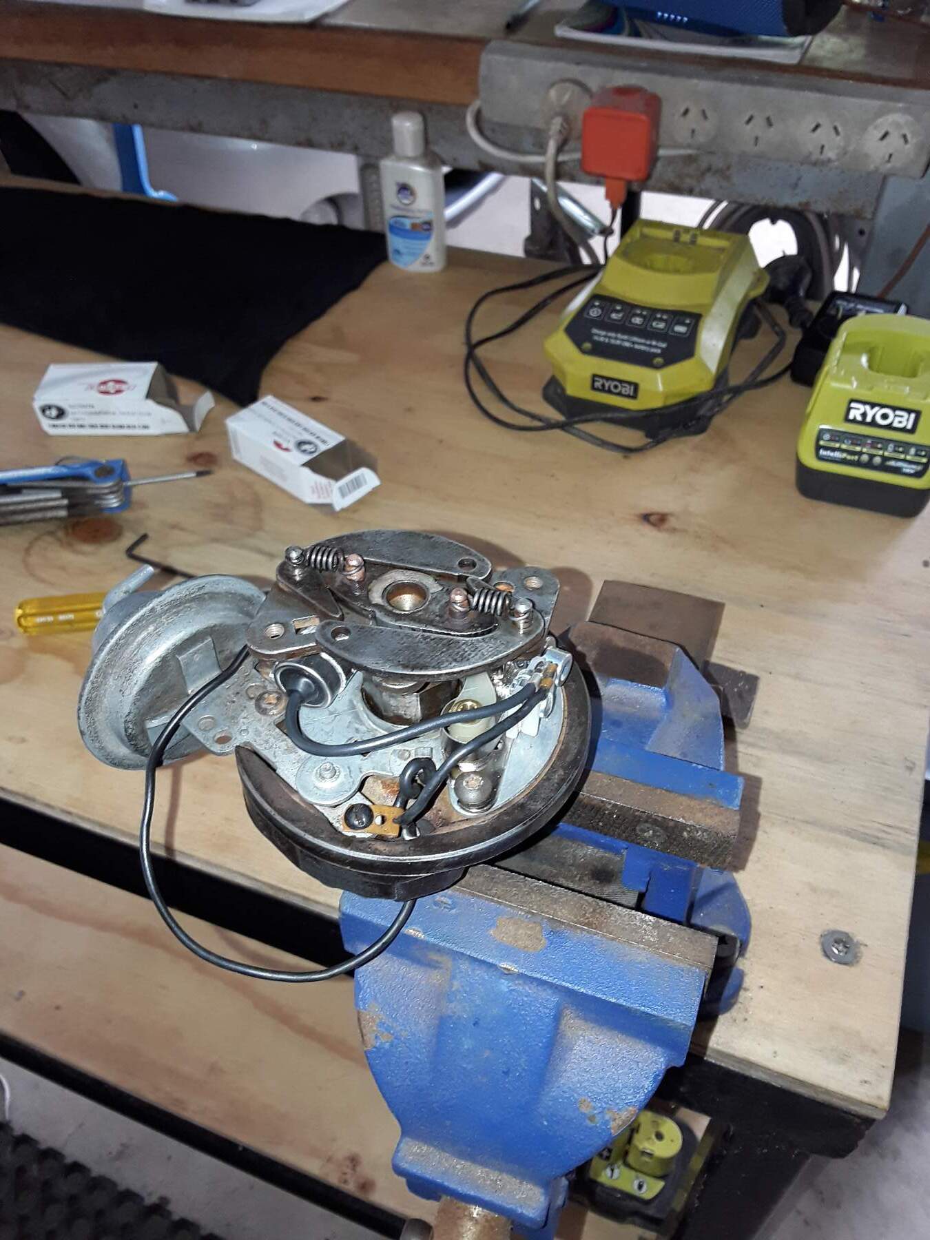

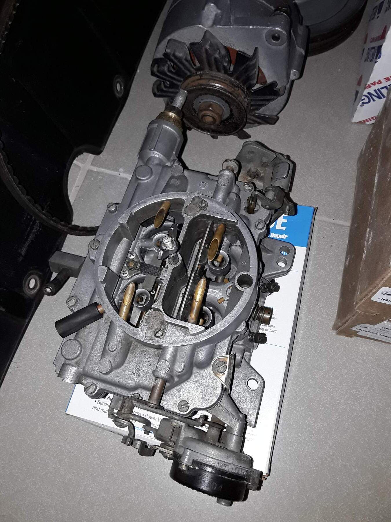

Today was significant because I managed to put the distributor and carby back together with no bits left over!
The carby looks new (now) and to be honest, apart from the encrusted crap in the float bowls, seemed to be just fine. I wirebrushed and lubed the distributor internals and I guarantee those weights have never been so eager to move. New points & condenser, everything sparkling clean, good to go.

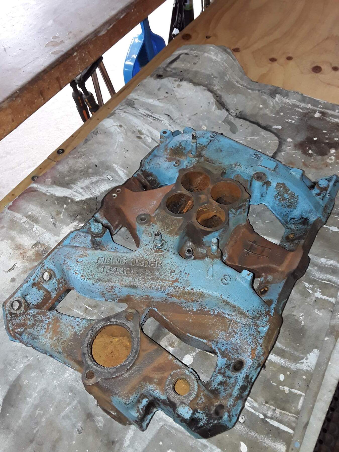

Tomorrow's task is to clean up the inlet manifold prior to fresh paint. Remember that pic when I post another post clean up.

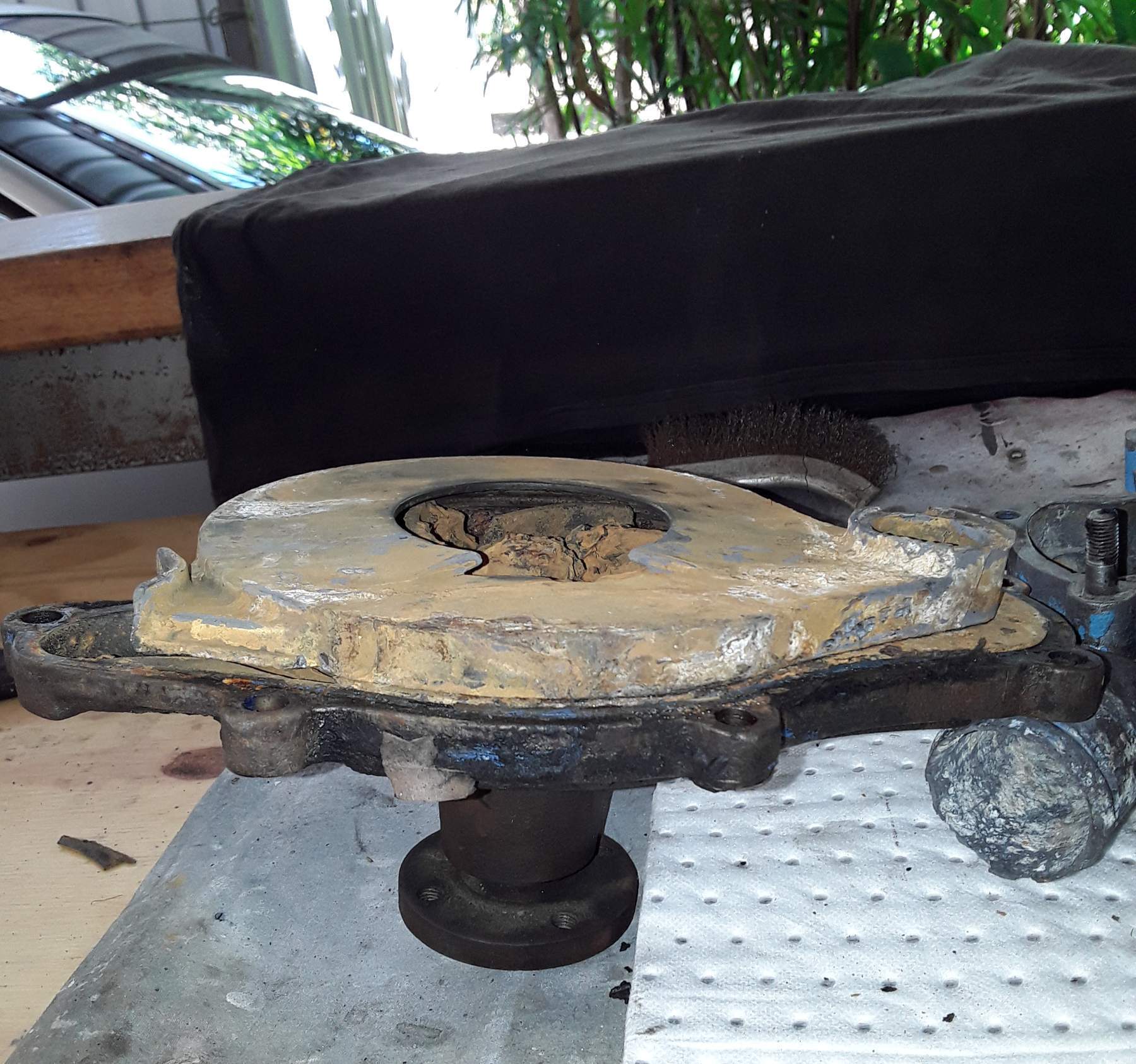

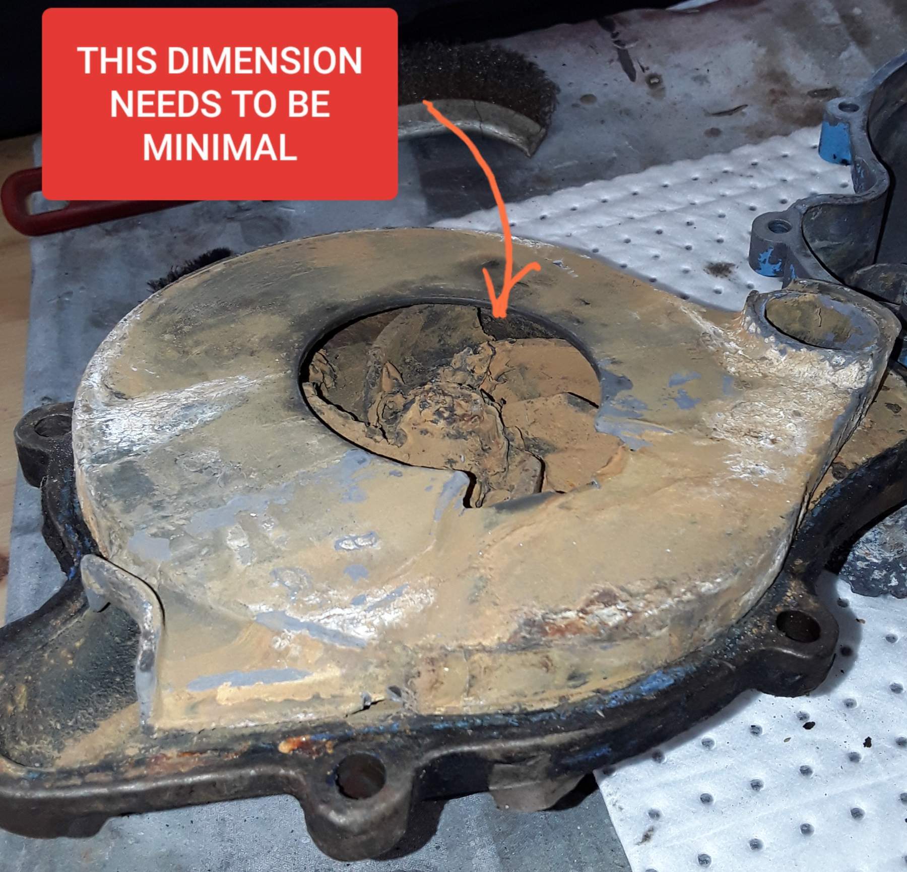

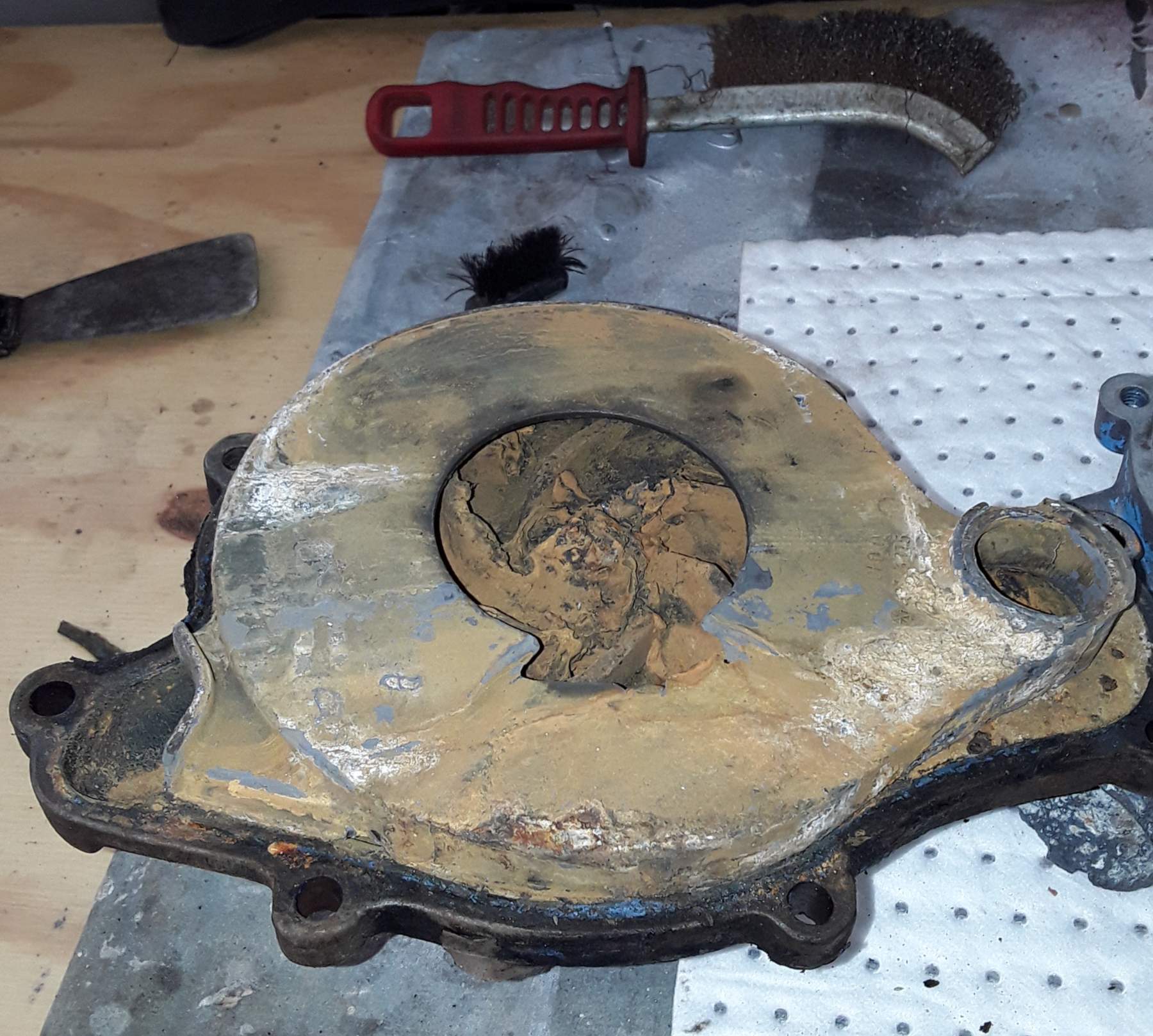

Water Pump 101: I read that clearance between the standard water pump impeller and the dividing plate needs to be minimal (like, a few mm) in order for the pump to do it's thing with any sort of efficiency. As you may remember, when I tore down the engine it's thermostat was missing and the water pump was crudded up with what I can only assume was a stop leak product. Combined with blocked coolant passages in the engine block, I'd say it all got too much for it's final US owner and was given up on until fate delivered it into my hands. See pics for huge clearance between impeller blades and divider! The FlowKooler I ordered may need the same minimal clearance but I'm not sure yet.
The solution is to gently hammer the divider closer to the impeller. I said GENTLY!
Edited by Fitzy
yip i agree mate, it will flow way more water if that clearance is minimal , but that one you have is toast!!!
