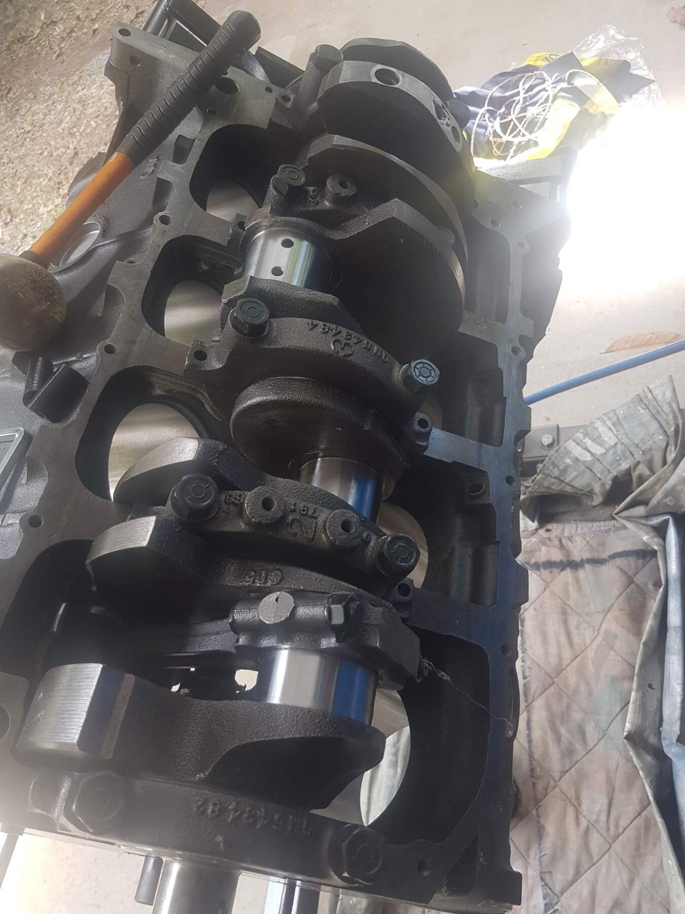

You gonna plastic gauge those Mains N rod bearings before moving on?  Cheap insurance everythings OK.
7 hours ago, Fitzy said:
Like sex & vegetables: you can't overdose.
But Willie will die of malnutrition and neglect.....sad really when you think about it.
oh you have to show us how thats done!!!
Here you go.
And there you go! i justA learnt Another trick!,,, thanks Frosty :cheers:
It's a whole lot cheaper than shelling out for a huge set of micrometers, feeler gauges, etc.
No need for plastigage. I quizzed the machinist and everything has been honed, checked & micrometered. Honestly, crank is a perfect fit. Those guys actually fitted everything and I said you might as well assemble the bottom end whilst you're there anyway, but they don't assemble engines. For the money I shelled out, I expect a perfect fit too!

Hate to say it, but the engine on my stand with all my blower parts ran all of 5 min and had to be pulled right back out to sit on that stand for the next 20 yrs. (that'll teach it a lesson!!!!)  Need to figure out what bearing is wrong.  Thinkin it'sa cam, but could be a wrist pin as he installed my new forged pistons as well.

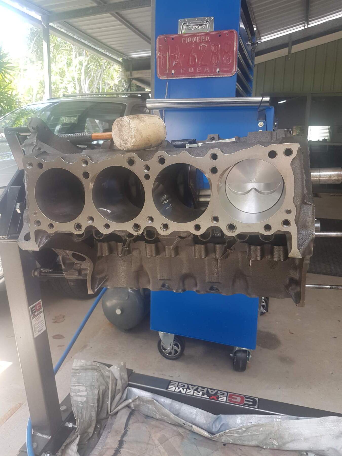

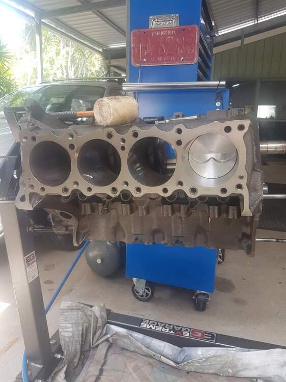

Thanks for giving me extra stuff to worry about - 3am is getting quite busy: I'll need to start making appointments so that I can worry about things in some sort of order. Okay, so crank is bolted in and just feels perfect. Cam is also a perfect fit. I made sure that cam bearing oil holes are where they're supposed to be and that the mains and rod bearings are all squeaky clean. I managed to install 2 pistons today and after torquing up the ARP bolts, they also feel perfect. I measured piston ring gaps and they are perfect. Each time I rotate the crank to line up the next rod journal, it turns beautifully with no binding, tightness nor anything other than perfect motion. Y'all can remind me of these words when I fire it up and the thing explodes into a million hot oily expensive pieces.20211105_150717.thumb.jpg.5bd71dc1873d17dc001d70d668fd6dbe.jpg
Ah looking good mate
did you set the rings in the correct location to each other 👍
Great. Give him more things to worry about! He will be starking raving mad when he gets done with this thing....no wait. Never mind. Too late.
At this point I would like to point out that I'm using How To Rebuild Pontiac V8s by Rocky Rotella as my guide, so yes, yes & yes. I positioned all rings as per the manufacturer's instructions. Pistons were installed onto rods in the correct orientation, pistons were then installed into block pointing in the right direction, everything is lubed with either assembly lube or engine oil. It sounds like you think I'm standing here with a box of shiny parts and I'm just stuffing them into the block willy nilly! Believe me, I read that Pontiac book and the service manual like novels, several times.
Here's a tip for anyone else wanting to descend into the yawning abyss of mental torture that is engine building: don't waste time with one of those generic band style ring compressors: get a tapered compressor that suits your particular bore. I can't proceed any further coz my ebay special compressor just ain't up to the task. I am now ordering a tapered one from Butler. Heed my words.

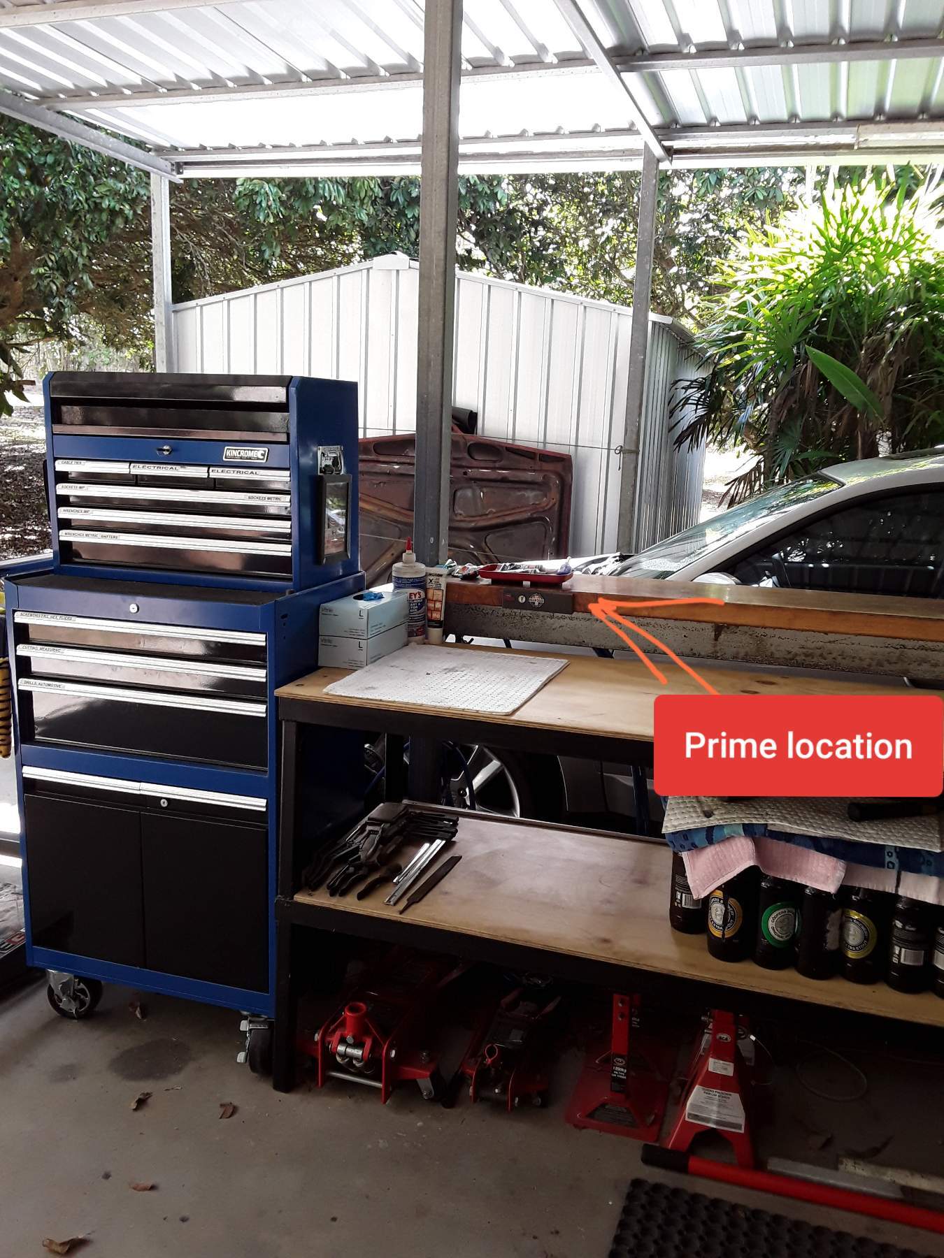

I positioned two of Frosty's latest gifts in what I consider to be prime locations: one is on my beer fridge (hallowed ground) and the other above my workbench. In fact, with the tacho, tiger tail, baseball caps, pins & decals, he's just about moved in! I hope you like short, cranky women Frosty: taming the beast I call my missus will surely be your greatest challenge. No, of course she hasn't read this: I wanna live a bit longer.

I just wanted to give a shout out to Ringo who appears to have fixed my connection problem.  Can you believe that this was the only site on the Internet that I couldn't access? Wait a minute...have you guys done something...? Anyway, I'm back, so stand by for much hilarity as I continue to jam engine components into places they're not supposed to go. Having said that, I can't do anything more until the tapered ring compressor turns up, so a coupla weeks.
