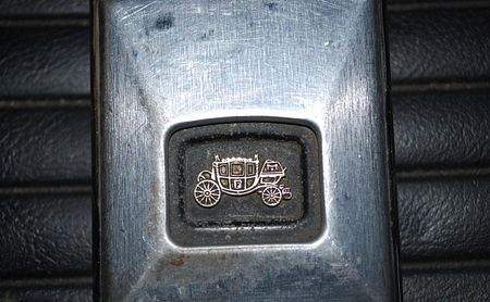

Glad everything went well.  This will will keep your nose outta places it shouldn't be. 😎  What logo is on those belts?  Hard to see.

My belts have the Fisher carriage symbol on them: that pic was a bit blurry. I never thought of those retractors being out of the ordinary. I'll look at them with a little more reverance in future. As JustA said, I also had to pry the buckle apart and derust everything - works like a new one now.

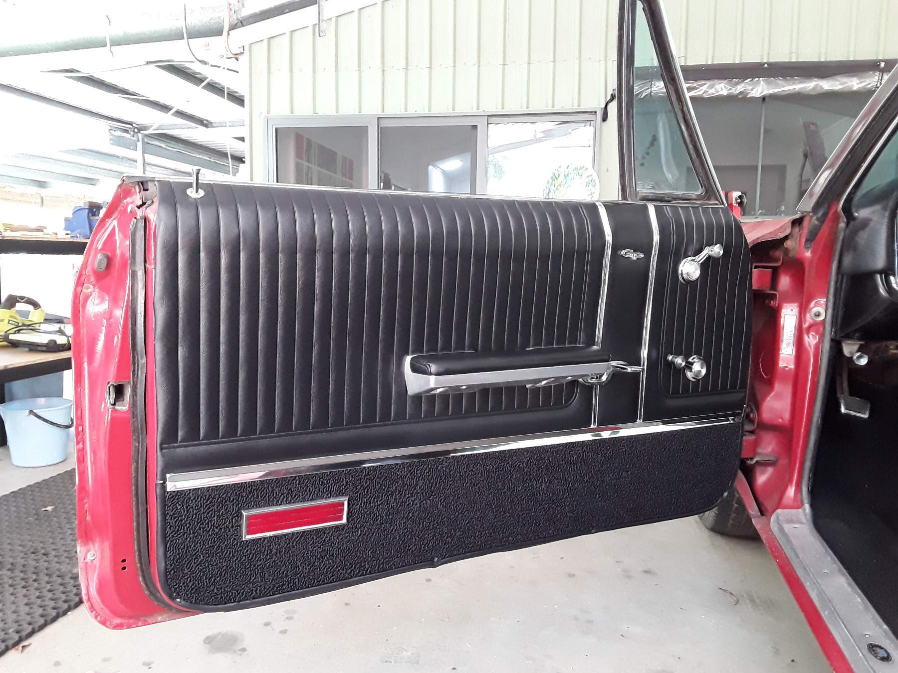

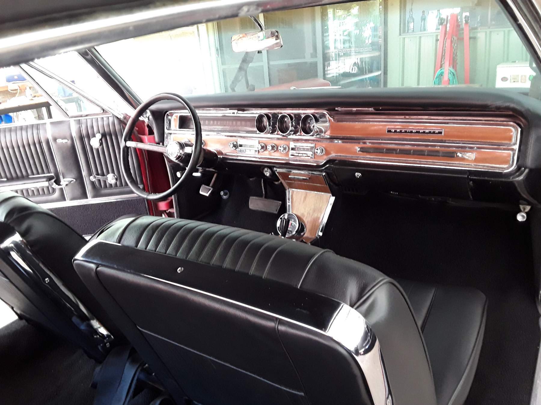

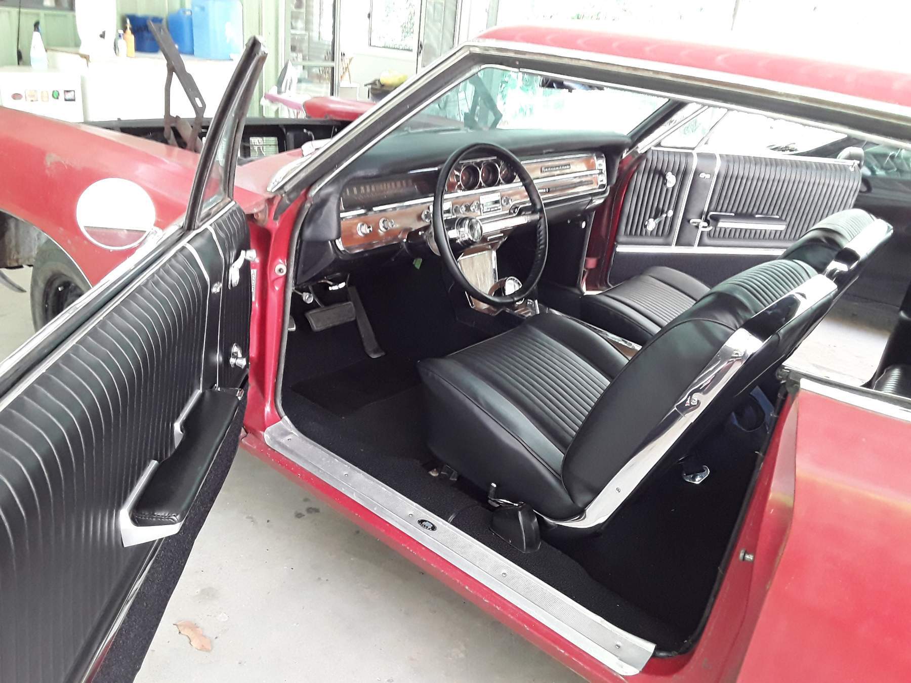

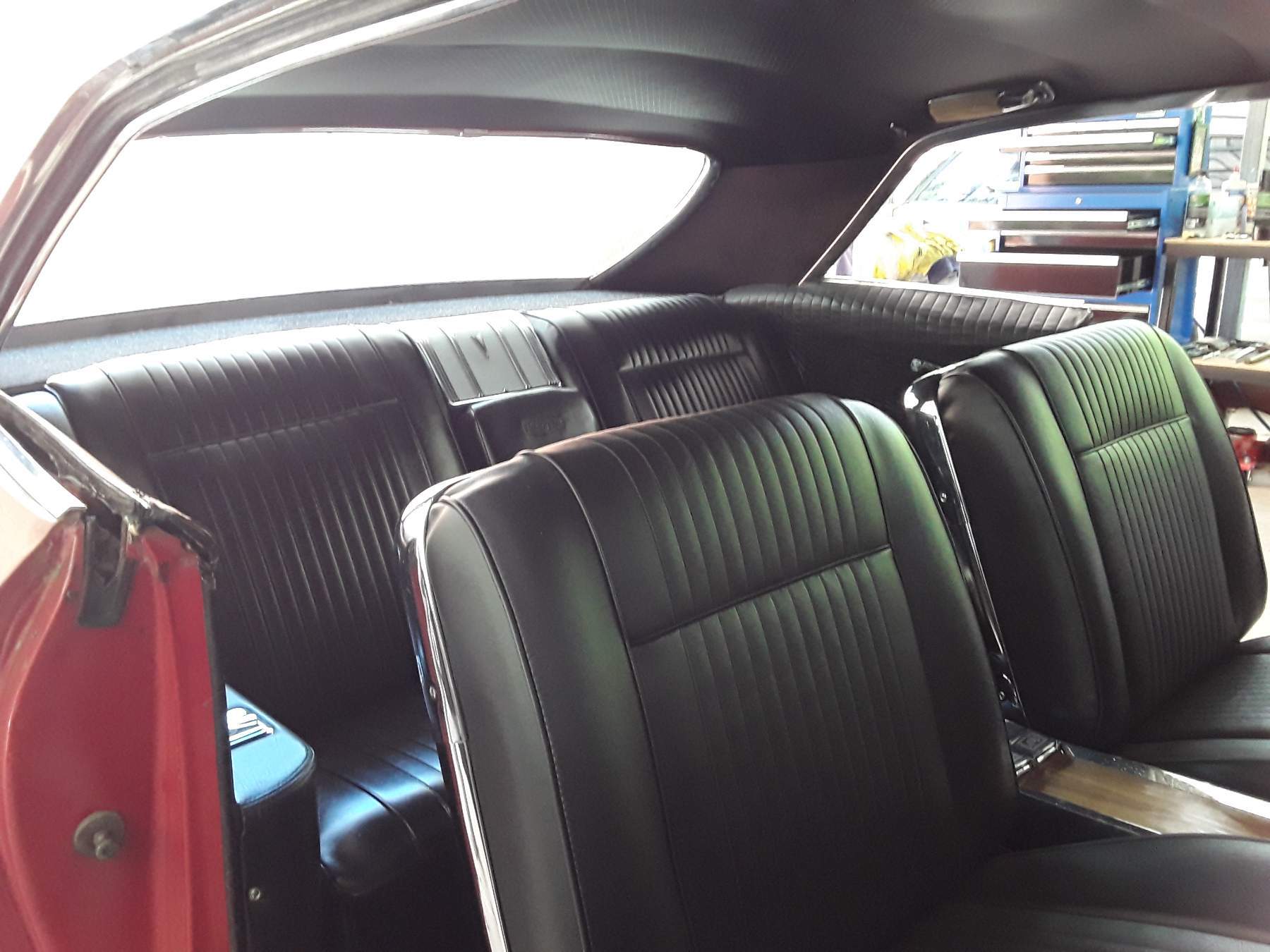

What a day. Heed my words: when it's your turn to order new door trim panels, get the assembled ones for a few bucks more. I had to practically re-engineer every facet of making mine go back together and fitting on the car. If anyone wants any tips, just ask me. It was a journey I wish to never repeat! Anyway, they're fitted and everything looks really good. It was never going to be perfect, but that's old cars for you.
As an experiment, I found a cheap but surprisingly good quality leather lace on steering wheel cover which I sewed on to my original wheel. It was tan colour (no black available) but some vinyl spray took care of that. It looks okay - I'll see what I think as time goes by. I can't help thinking an original or Grant wood rimmed wheel would really match the walnut veneer GP interior. Perhaps the boys will find one at a swap meet.

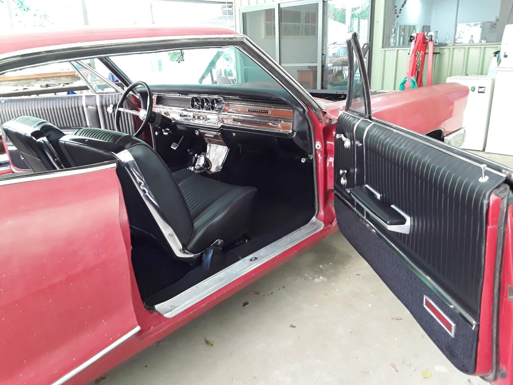

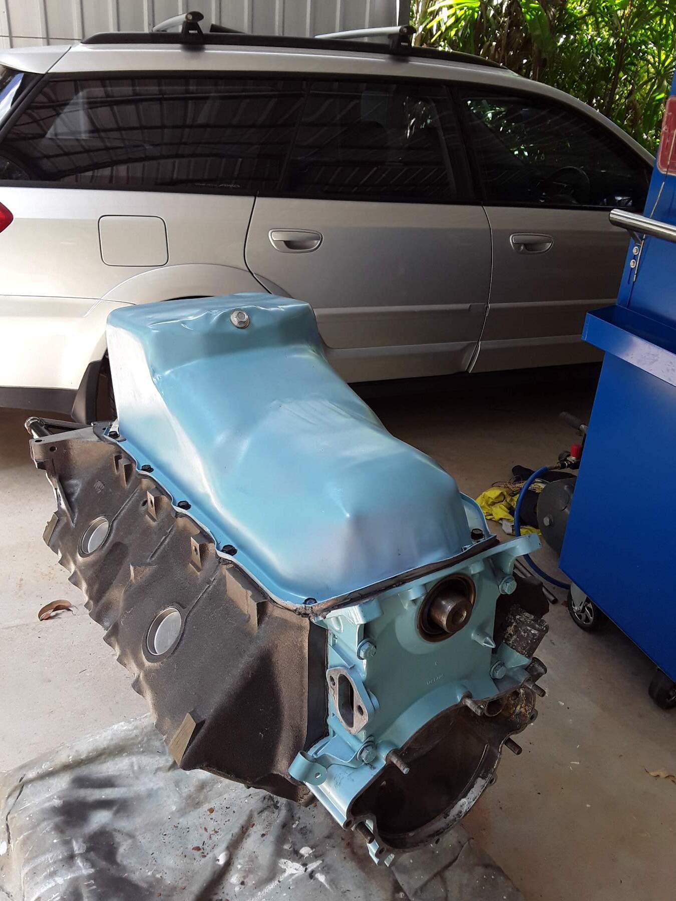

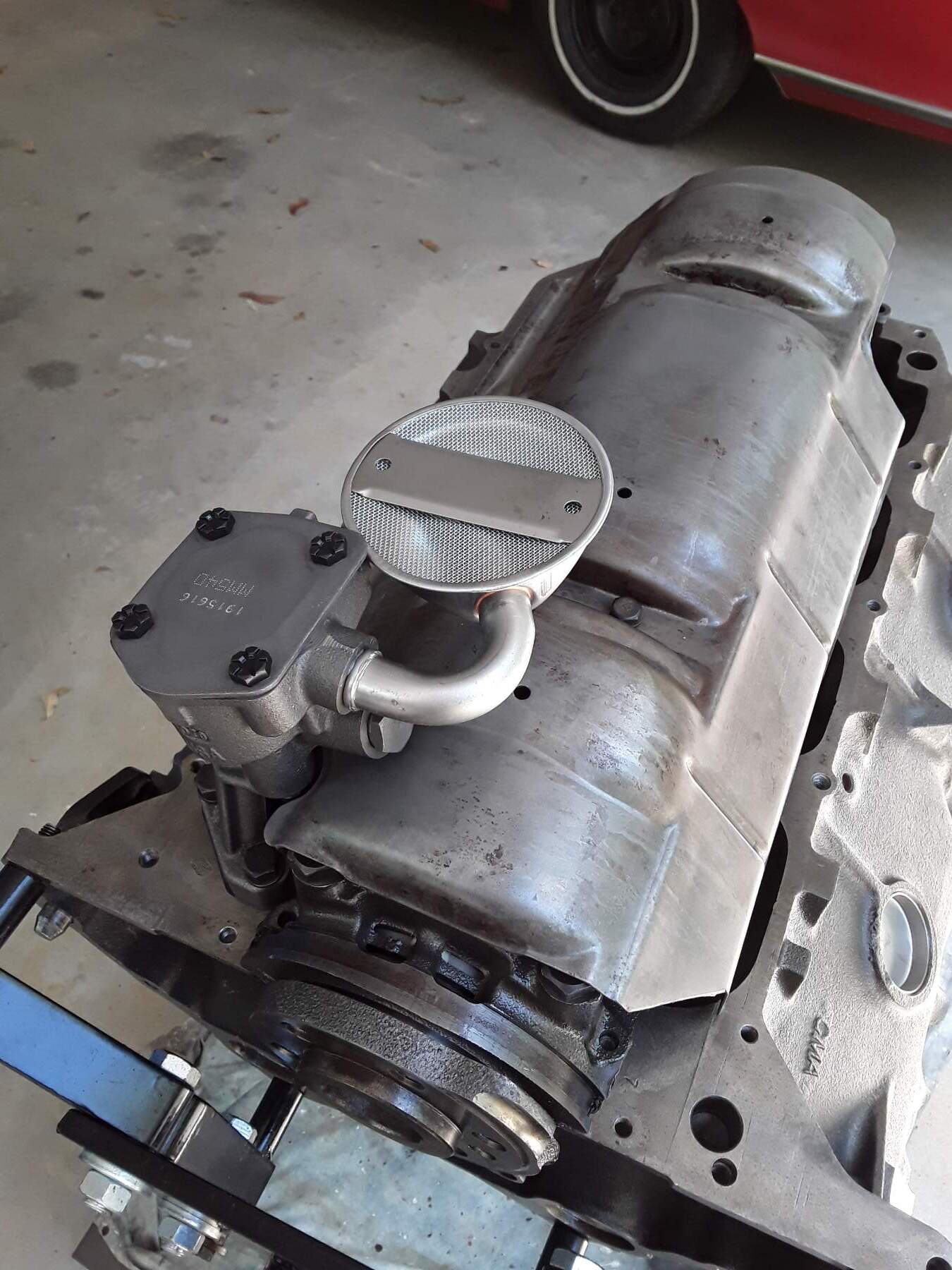

So, with the interior finished to a point that I'm happy with, it's now time to get stuck into the engine rebuild. First drama: fitting the new oil pickup to the new oil pump. Rocky Rotella sez to put the pickup in the freezer then essentially drive it in. Uh, sure Rocky. Pickup is in the freezer as we speak. My missus (being a Kiwi) will probably think it's some exotic ingredient to add to the curry. That'll be a pick me up. Didja see what I did there? Comedy gold. Whilst that is happening I thought I could get the timing gear fitted. Ha! My original cam still had it's woodruff key installed. New cam didn't come with one. Surely for $200 they could have chucked in a 2 cent woodruff key. No they didn't. I tried to find one locally and no dice. So I drove the 55 year old key out of the old cam. I then checked the corresponding slot in the new cam gear and several tenths of a millimetre had to come off the sides, so in the vice and file it down.  Easy - new cam gear will now just slide on to the cam. No it won't coz the friggin cam snout is like 0.2 mm larger than new cam gear. So now I gotta figure out how to either reduce the cam snout diameter or enlarge new billet timing gear. This is what happens when you mix up aftermarket parts. Melling cam and JP Performance timing gear. I guess I'll be using emery cloth until the bits fit.

Your interior is amazing.  Fantastic job.  Much to be proud of there. :pontiac:

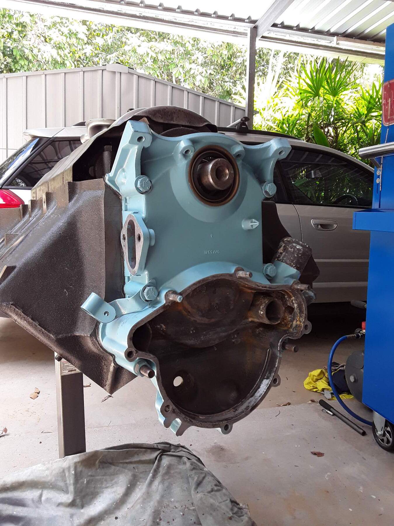

Hi Everyone and welcome to Engine Rebuild Nightmares. First of all, you gotta spend months laying awake at 3am wondering how everything that you pulled apart will go back together. When the big day comes, you're broke, you're hungry but you're surrounded by a squiilion shiny new bits to stuff back into your expensive new machined block. After shoving the crank, rods & pistons in, chuck the cam in and then prepare thyself for timing gear replacement. Crank mounted gear slid right on - easy. Cam mounted gear was never gonna fit, so out with the Dremel and a grinding stone and smooth that sucker down. Eventually, new gear slid right on. Sweet. Then, just press oil pickup into oil pump. Hmm. Won't go. Rocky Rotella sez chuck it in the freezer. This morning I retrieved it from the freezer, ran outside and hammered that sucker in. When I had it almost in, it was then I realised that the rim of the pickup screen has to sit in a little recess in the pump housing to ensure it's located properly. Hammer, push, pull, lever...I eventually got it to sit right and proceeded to hammer it home. Why not make it a tiny bit smaller and instruct the rebuilder to hold it in place with some Loctite? No, you gotta hammer the bejesus out of it instead. Timing cover went on with no dramas, oil pan also went on fine but Ames sells little reinforcing plates for the rear corners to prevent leaks - apparently they were a Pontiac after service item made avaiable for dealers to retrofit. Did mine fit? No, at the critical moment when the Permatex was starting to set, I discover that one of those little plates hadn't been shaped right and needed some of it's internal curve cut out. Ran to the vise and once again with the Dremel, ground out the requisite material in order for it to fit. Valvetrain components now fitted as well, but time to clean up and rest.

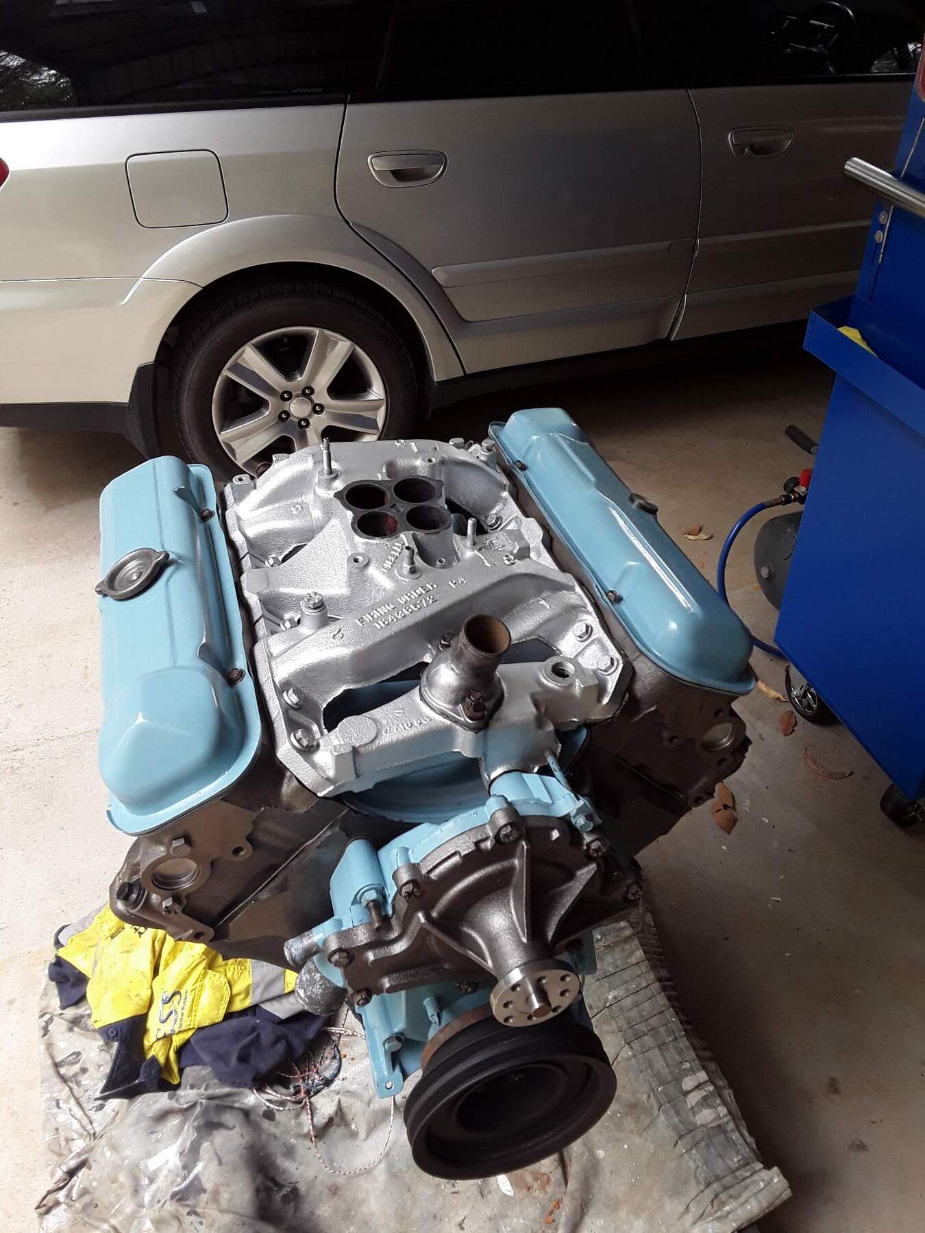

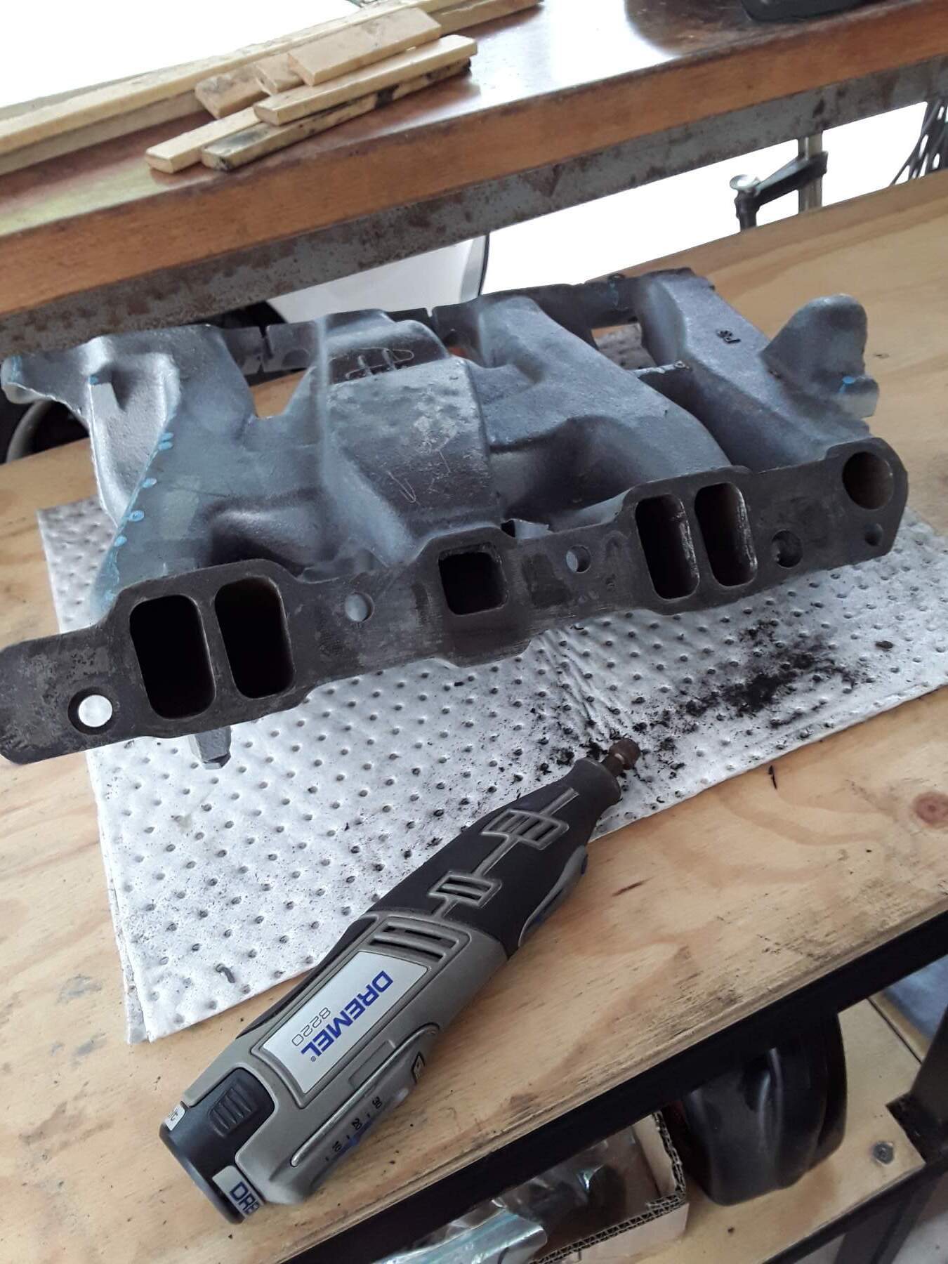

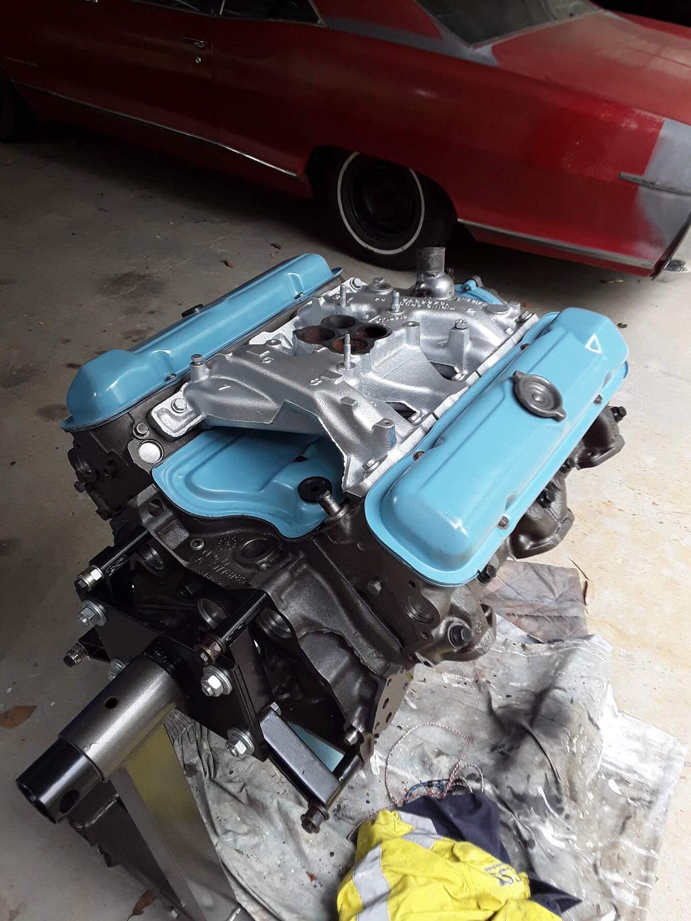

I got the week off work coz my face looks like I've been beaten up, so it's full speed ahead with engine assembly. After seeing a YT clip of Uncle Tony's Garage, I thought I might clean up the ports on my inlet manifold. He showed an example of some Chrysler heads and boy, were the castings rough - he could easily grind away plenty of material in order to restore correct port shape. By contrast, my Pontiac heads have beautiful clean ports which I never touched and I could only find the slightest amount of material to grind away from my inlet manifold ports, so I did. I set my inlet manifold gaskets in place with the exhaust crossover ports blocked off and am almost there. Tomorrow I'll paint the block & heads, add the last bits & pieces and will eventually whack that baby back where it belongs.
very nice mate :cheers:

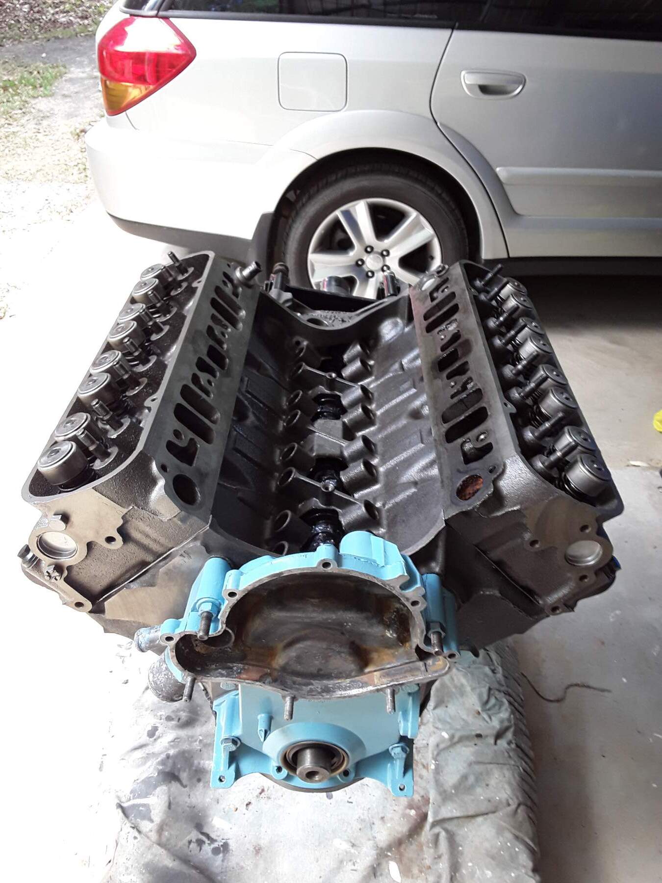

This morning as I'm making coffee, for some reason the word 'thermostat' popped into my head. Guess who forgot to put the thermostat in yesterday? I'm now wondering what else I forgot to stuff inside the block, now that it's all sealed up.
When I tore the engine down, I noted that the thermostat was missing altogether so I guess that's why I didn't think about it. Oh well, it's only 2 bolts. Better than forgetting the camshaft. Wait a minute...why is that lumpy steel rod still sitting in the Pontiac room???
Bearings, freeze plugs, water tubes between the block and water pump, lifters, henway?

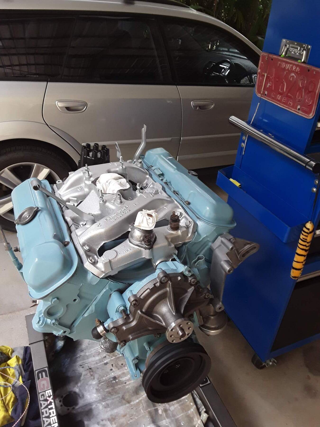

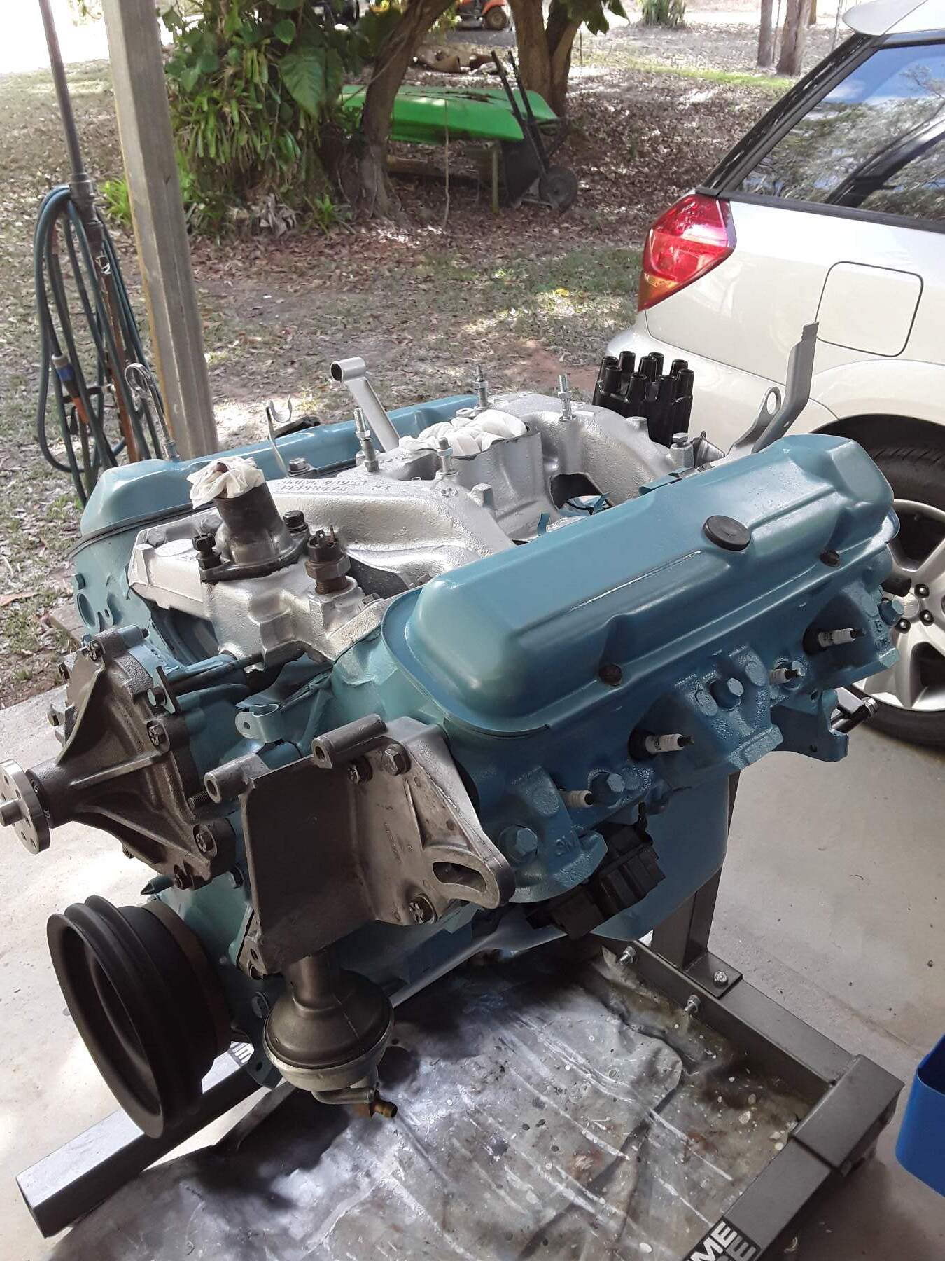

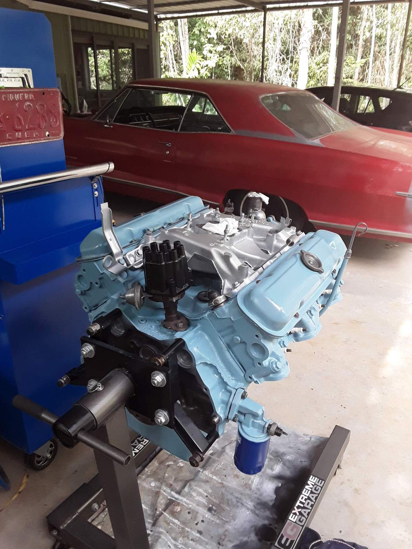

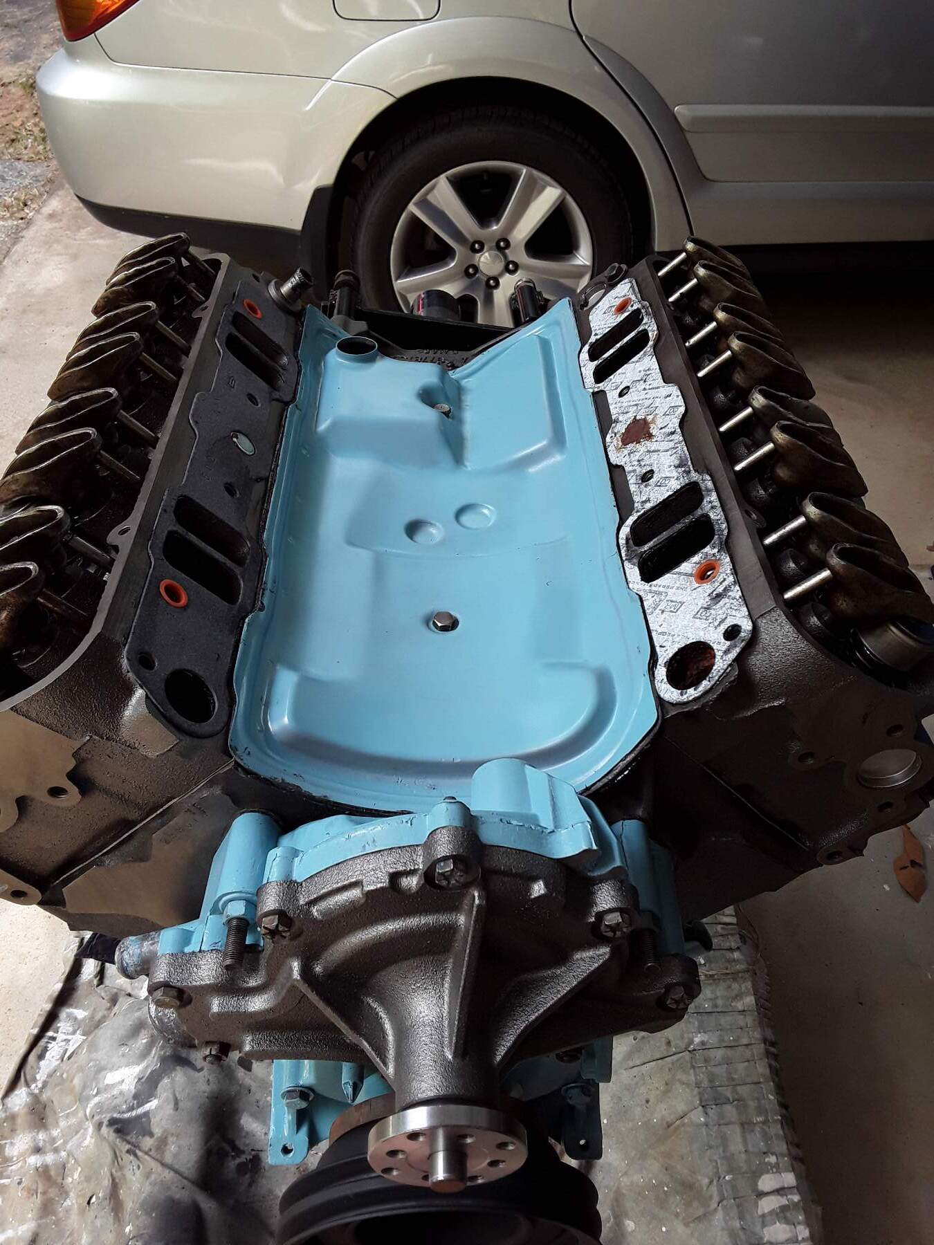

Finished painting it and attached most of the little doodads that drive you crazy IF you didn't take pics as you were tearing it down. My #1 tip for anyone about to pull their engine. Take endless pics, from every angle and make sure you get everything in frame. Those little ziptie plastic bags and a permanent marker are invaluable for nuts, bolts, clips, etc. Clearly mark what they are and where they go. Believe me, as you're undoing stuff you're thinking "I'll remember where that goes." You bloody won't - especially if the rebuild takes a few months, which it will unless you have a bottomless bank account and an army of engine builders to do the job for you. I did all these things on my last engine and was SO grateful I took the time to be methodical. You don't want to be staring into a box of rusty, greasy bits wondering what goes where 6 months down the track!
I filled it with oil (and zinc additive to give the new cam & lifters a chance to live longer than 10 minutes) and used my electric drill and you beaut oil pump drive tool to pressurise all the internals, fitted the distributor and everything is now set so that it should fire up. Bolt on the flex plate & starter tomorrow and maybe lower it into the engine bay.

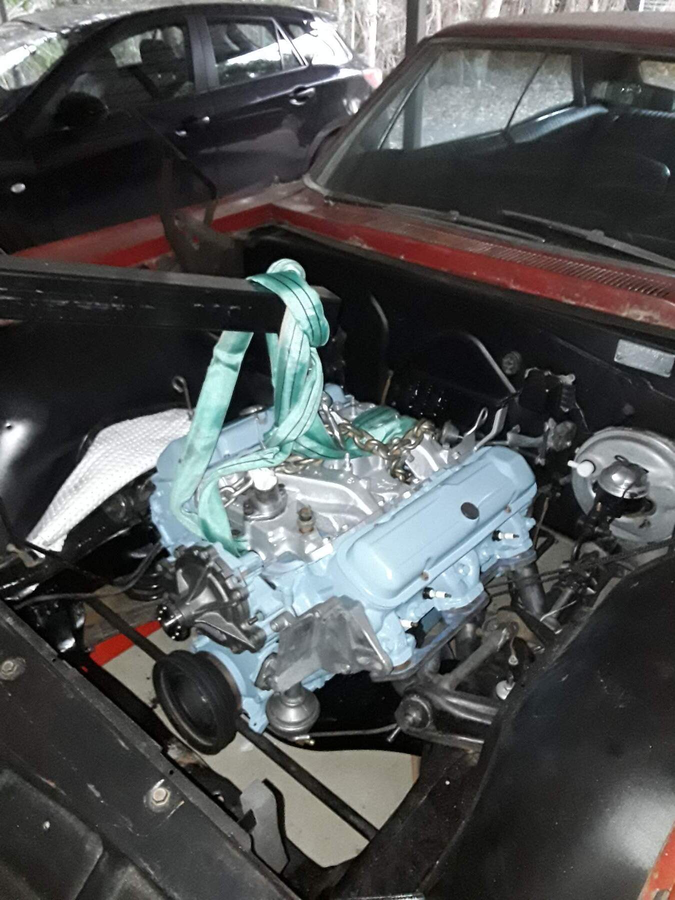

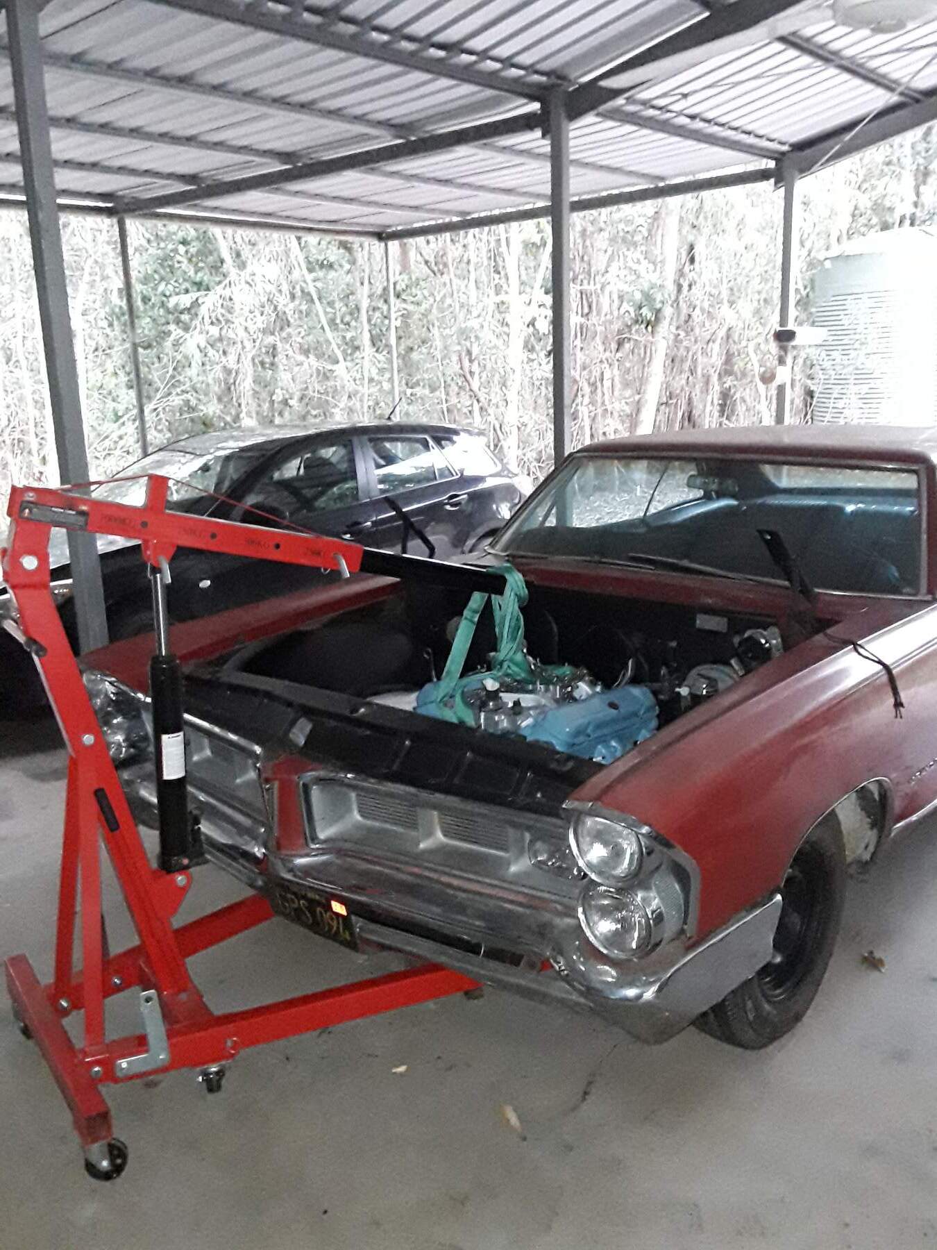

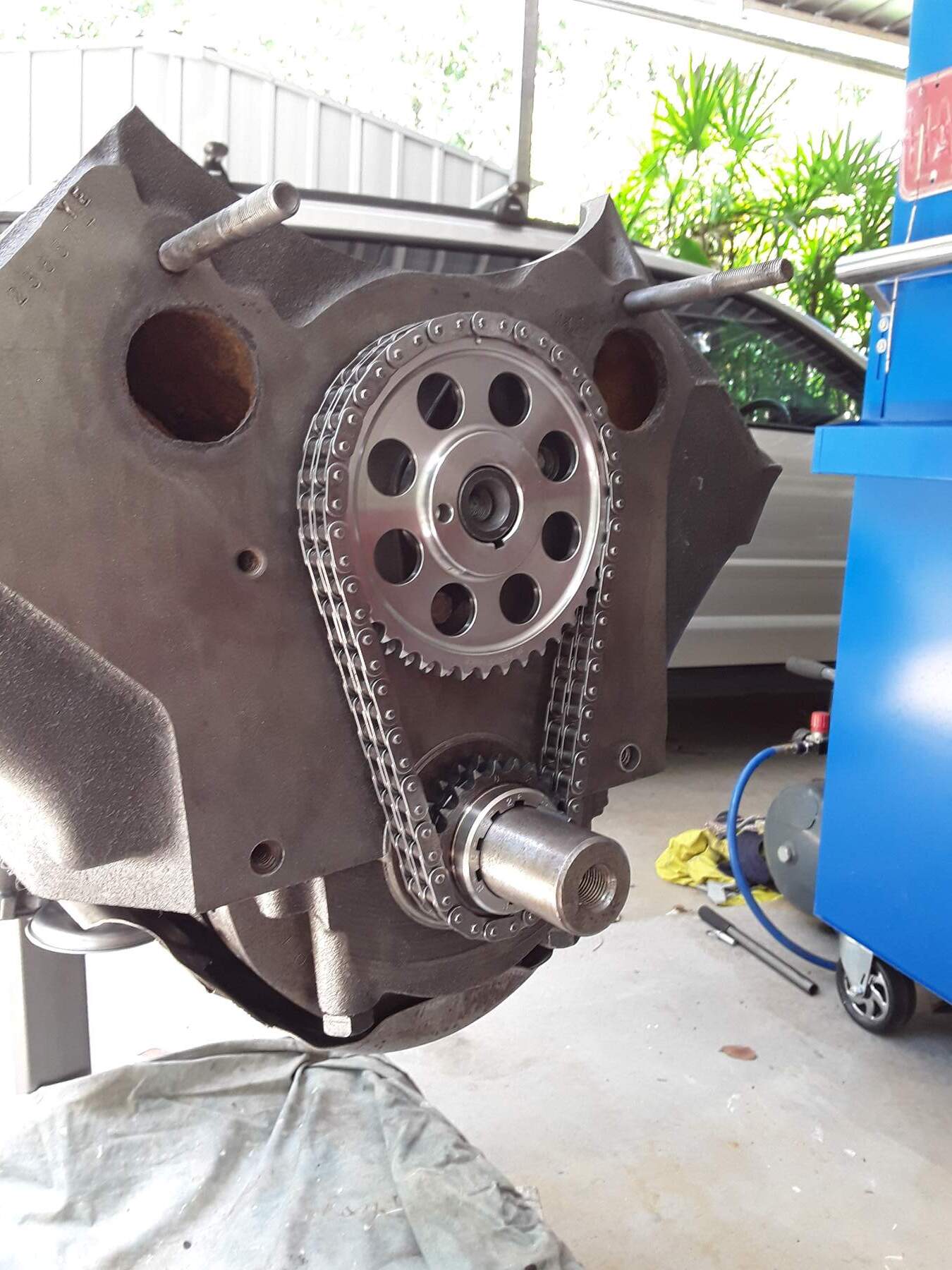

What a day. Hot, humid as f@#k, bandaged face but hey - I'm not at work and I get to play with the car all day. I couldn't sleep last night because I wasn't happy with the way the cam sat in relation to the lifters, so after much grumbling & deliberation I removed the harmonic balancer, fuel pump, distributor and timing cover and looked again at the timing gear and thrust plate. Everything seemed fine but this time I really drove the cam gear on nice & tight to give me the endplay I wanted. I even cheated a bit and used the harmonic balancer big ass washer and threaded it behind the cam gear bolt and wound that baby on good & tight, thereby ensuring cam gear sat on the cam snout so that it's front face was 100% flush with the face of the snout. Removed the washer and replaced everything the way it's supposed to go. Here's a tip for other engine building lunatics: if you use an adjustable timing gear set, be aware that there are 2 sets of inscribed degree numbers on the crank gear: inexplicably, there are numbers on the bit that slides onto the keyway, and then on the outer ring are the degree numbers. You need to line up your desired degree number on the outer crank ring with the dot on the cam gear. Oh, and because my timing set was aftermarket JP Performance, they want you to line up the cam gear dot at the 6 o'clock position, rather than the factory Pontiac 12 o'clock position. Being a cam gear it doesnt matter which one you use as the cam gear spins only half of what the crank does, but I wanted to do it right.
Bolted on the flex plate and then saw no reason to not try and bolt engine back into car. I was on my own and after hours of grunting, sweating, swearing, jacking up the trans, fiddling with the engine, using pry bars and pieces of timber, as it's getting dark I FINALLY manage to get one of the bellhousing bolts in. Yes! After that, it's just a process of fiddling, jacking up & down and manoeuvring until all the other bolt holes line up. Three bolts are currently locating it and holding it in position. I'm getting my stitches out tomorrow morning so hopefully will have that baby bolted back in where it belongs tomorrow afternoon.
