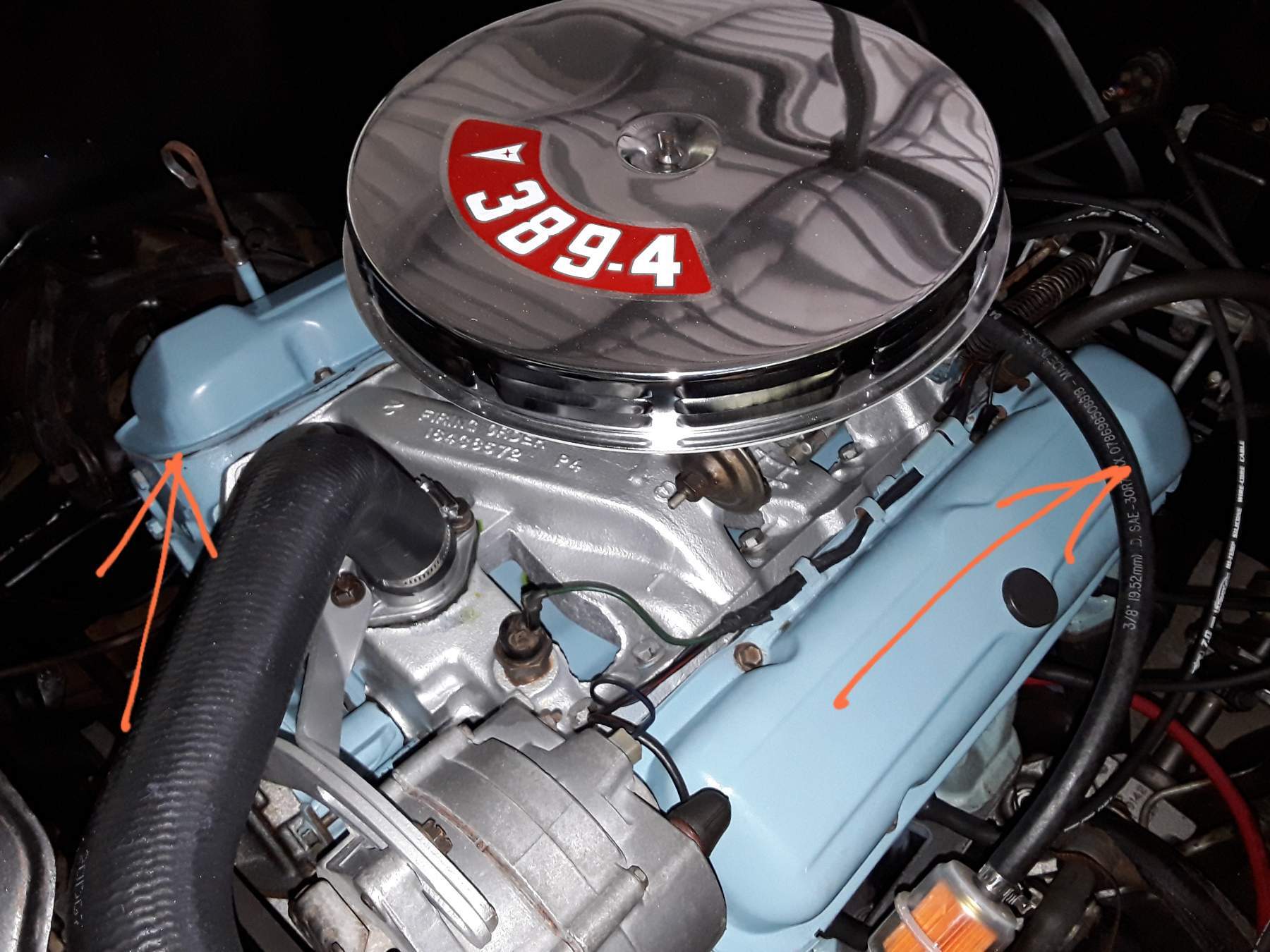

Boy, this is embarrassing. Remember, this is the guy who rebuilt his engine from scratch starting with a bunch of parts.
I'm at home playing with the car because it's raining and I have no friends and it's time to replace the rocker covers. I'm about to position the first one when I notice that one edge has a lip that faces up and the other side is down. It is then that I wonder if there's a specific orientation coz they look dimensionally equal where they abut the head. I figure that the lip that faces down goes downwards (based on no evidence whatsoever) so I place it on the head and then notice the 'bump' that's pressed into the top. For the first time ever, I wonder if the bump should face forwards or backwards. In desperation, I search for images of a 1965 389 but all the pictured engines have aftermarket covers. I see ONE authentic looking engine with the bumps oriented opposite to each other! I check the pics I took from my rebuild and I did indeed place the driver's side cover with the bump facing back and the passenger side facing forward. Am I losing it? Is this what old age is gonna be like every day?
Can someone have a look at their donk and give me a clue? Anyone know the reason why there's a bump? Is it too early for a beer and a lie down?
Don't listen to him next time!!!!
No your not going mad ! On my girl both lumps are to the front
oil filler cap is in passenger side and  breather hole is in the upper section on the drivers side
that pic you posted shows the breather hole blanked off and on the lower side of the cover which I think would be wrongway 👍👍👍....

Why I say the picture is wrongway is all the condensate is trapped in the upper section of that cover !!!
hows it going to get out ? ..... it can’t
4 minutes ago, JUSTA6 said:
Same covers, factory chrome for the 421
I see your breather hole is too the bottom too justA ! Wtf
I appreciate the response but you guys didn't help much! Kiwi's engine has both bumps at the front and JustA's is one of each, like mine. So, any idea what the bump is for? There's nuthin' under there except for rockers.
Bloody hell...for the sake of presentation, I shall turn the driver's side around and will have to be happy with a 'Two Bumps Forward Special Edition.' I'll tell anyone peering under the hood that it's a factory performance upgrade, unlike the garden variety Grand Prix.
I sorta thought perhaps they should both be at the back to provide a little 'hump' for the HT leads to pass over, because some dickhead thought that putting the distributor at the BACK of the engine as a good idea. If I ever meet that guy, his health insurance had better be up to date.

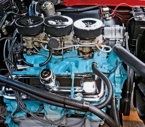

Fitzy - you've installed them correctly. I managed to find a color tri-power photo from back in the day of a 389. See for yourself.
As to their purpose, the "pent-roof" valve cover does not appear to be a clear answer. This valve cover appeared from '64 to '66 (maybe earlier for California cars). Some speculate that this coincided with the then "new" emissions laws (e.g. a PCV valve) and these covers help trap oil vapor. However, there is no printed material from Pontiac as to why they did it.
Thanks Frosty. So, is the other side the same, ie. do both bumps go to the front on that particular engine? I'm assuming there's another pic that shows the other side. I'm pretty sure I'm overthinking things again. Damn you, strong morning coffee!
I'm just gonna turn the other around and have them both at the front, for presentation puropses.
I'm glad we had this little talk.

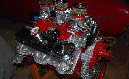

As you can see from my pic's, my bump is in the back on the DR side. Oil fill/breather is always Pass side.  I have a rubber plug in the breather hole (always on DR side) as with most I've seen and it's usually down low with the bump in the back from cars I have seen.  Thats WHY at least I put mine together the way I did.  I've never seen both bumps up front, but as I said before....If it leaks your doing something wrong.😁 If not, who's to say your wrong.
So maybe there is NO wrongway :rofl:
Justa's install is correct. Passenger side hump to the front, driver side to the rear of the motor. That's how Pontiac installed them.
Since the reason for the humps seem to be lost to time in the first place, do what you want. I don't blame you for wanting symmetry.
