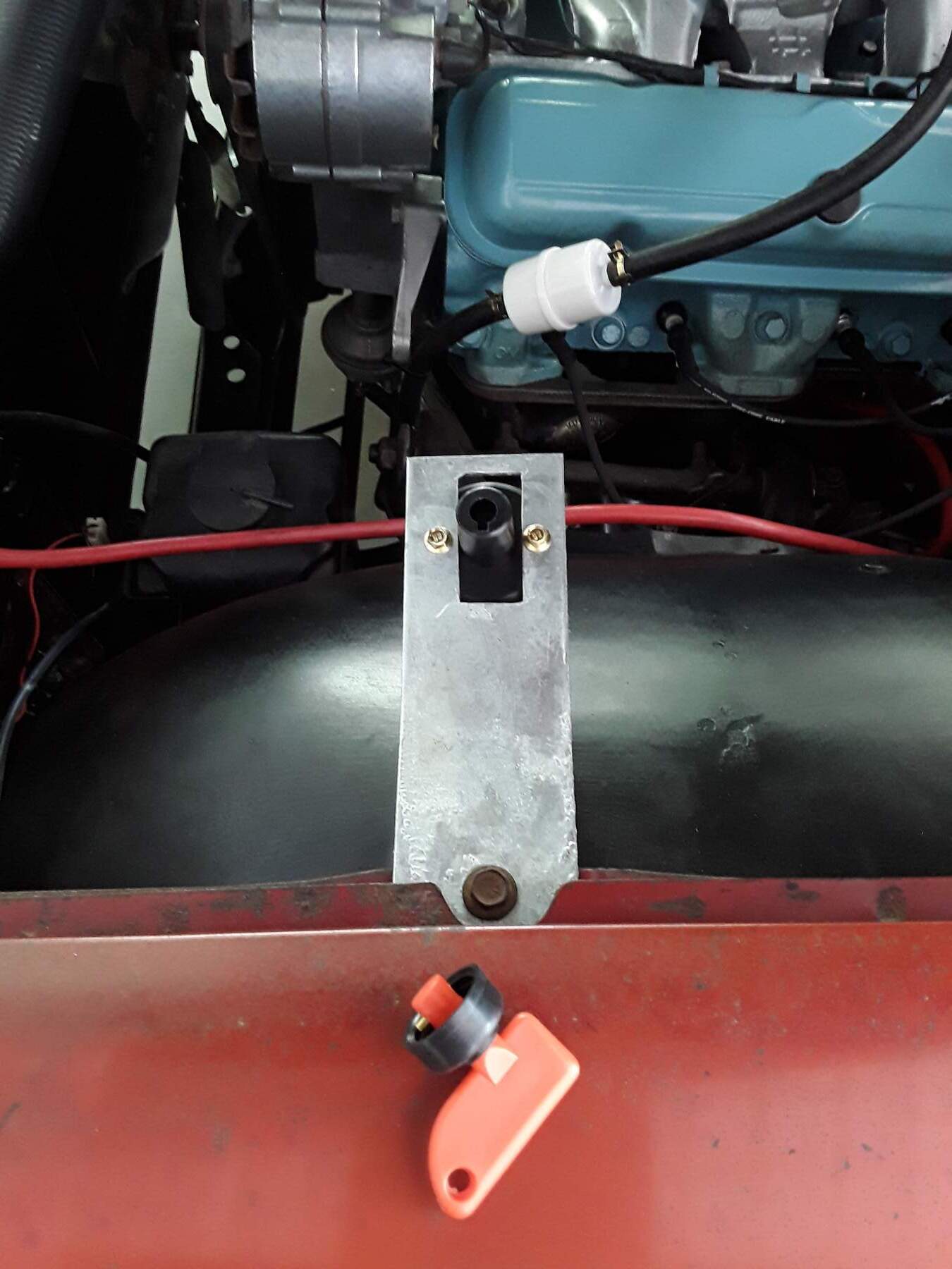

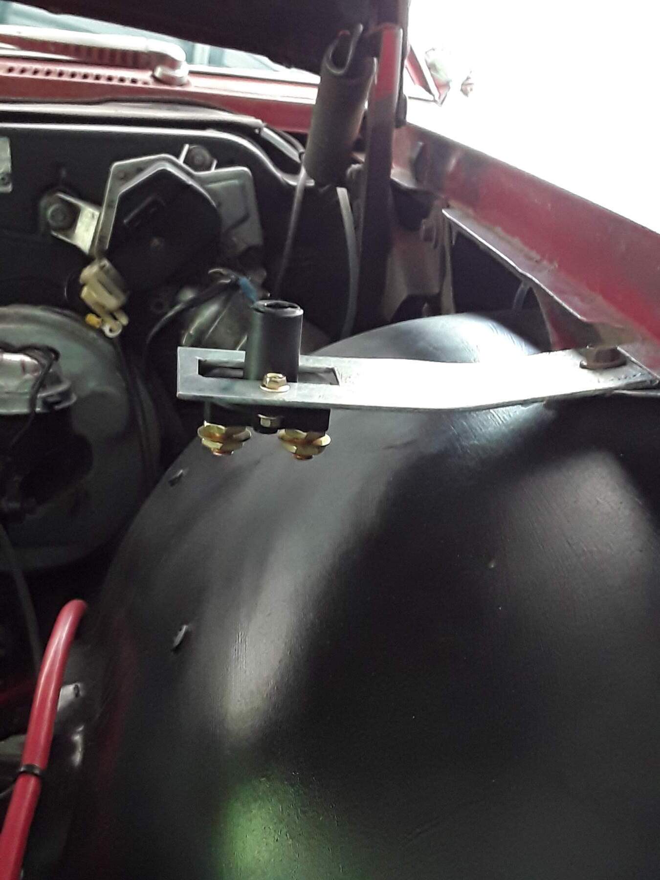

One last thing, I wanted to install a battery isolater so that I can isolate the battery whilst I'm away for 7 days every fortnight, or so that I can isolate the car if I park it somewhere and want to have lunch or something and don't have to worry about someone hot wiring it within 3 minutes. I'm also going to route the wire that goes to negative coil through the car's interior and wire up a discreet simple off/on toggle switch to further thwart any thieves. This is my proposed set up. The red key can be removed once the switch is isolated. This way, I'm not drilling any holes and it can be removed without any evidence of butchering. Yeah, it looks kinda ugly but I'm gonna paint it black and will neatly route the battery cable under it.

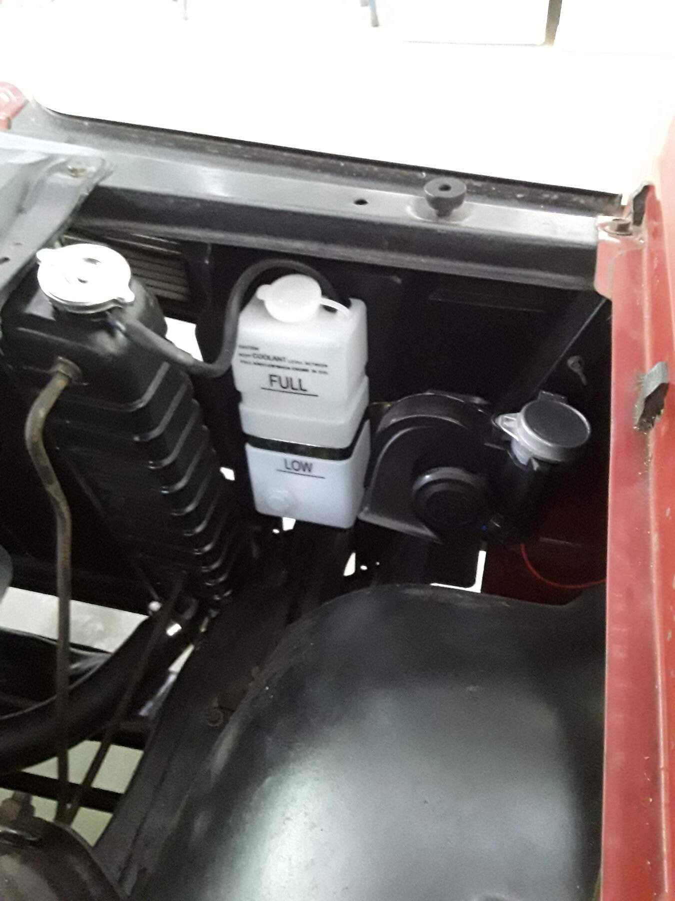

And here we are again. FINALLY got the horn working. After carefully routing the required wiring thru the engine bay and firewall and into and out of the fuse box, after a couple of hiccups that baby shrieked away. Believe me, if I ever have to use it, the car in front will be in no doubt whatsoever that the big red car behind them honked them. The ebay ad said it was a 'deep tone.' Ah, no - it sounds like a Ferrari honking some shitbox Lamborghini to get out of the way. The compressor and horn are a combined unit - made in Italy (the traditional home of shrieking air horns) and it seems to be a pretty robust unit. They take their horns seriously in Italy. And then with an unusual burst of energy, I decided I would check each brake assembly one last time and refit my mags. To my horror and disappointment, one of my rear wheel cylinders has decided to start leaking. Bloody hell - smash out an order to Rockauto and I guess it'll be here next week whilst I'm at work. And THAT my friends, SHOULD be the last thing to fix.
Let's all remember those words and laugh: THE LAST THING TO FIX!
The pic is of my new coolant recovery bottle and horn assembly.  Unlike Kiwi, my car has a crossflow radiator, so I didn't have the space he had to fit everything, but it'll do.

looks good mate!! well done, nice n tidy, tucked away there👍

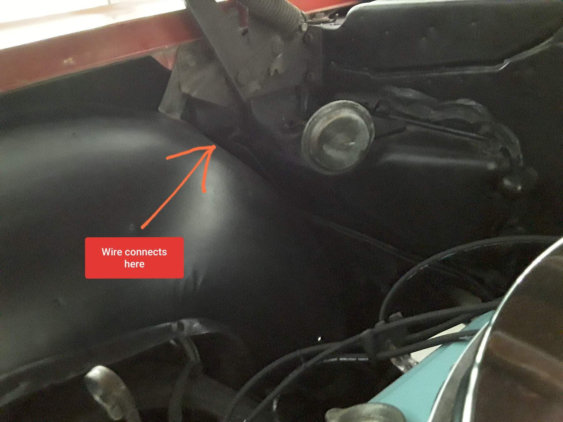

Hungover as f@#k yesterday, so I hobbled about like the broken down old wreck that I am and decided to work on the other broken down old wreck. I fitted my new 'Australian' sealed beams.  Hmm...they look suspiciously EXACTLY the same as the US ones. Never mind: I kept their packaging and the receipt to prove to God (& the Inspector) that I changed them out. Today I want to see if I can get the blower motor to work - there's 12 volts at the switch so that's a start. There's a black wire in the engine bay that runs to a connector at the back of the blower motor. Does anyone know what that does?
i will have a look at my one when i get home tomorrow mate, not sure what that wire does either

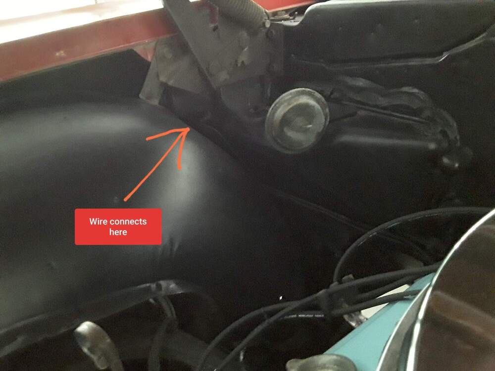

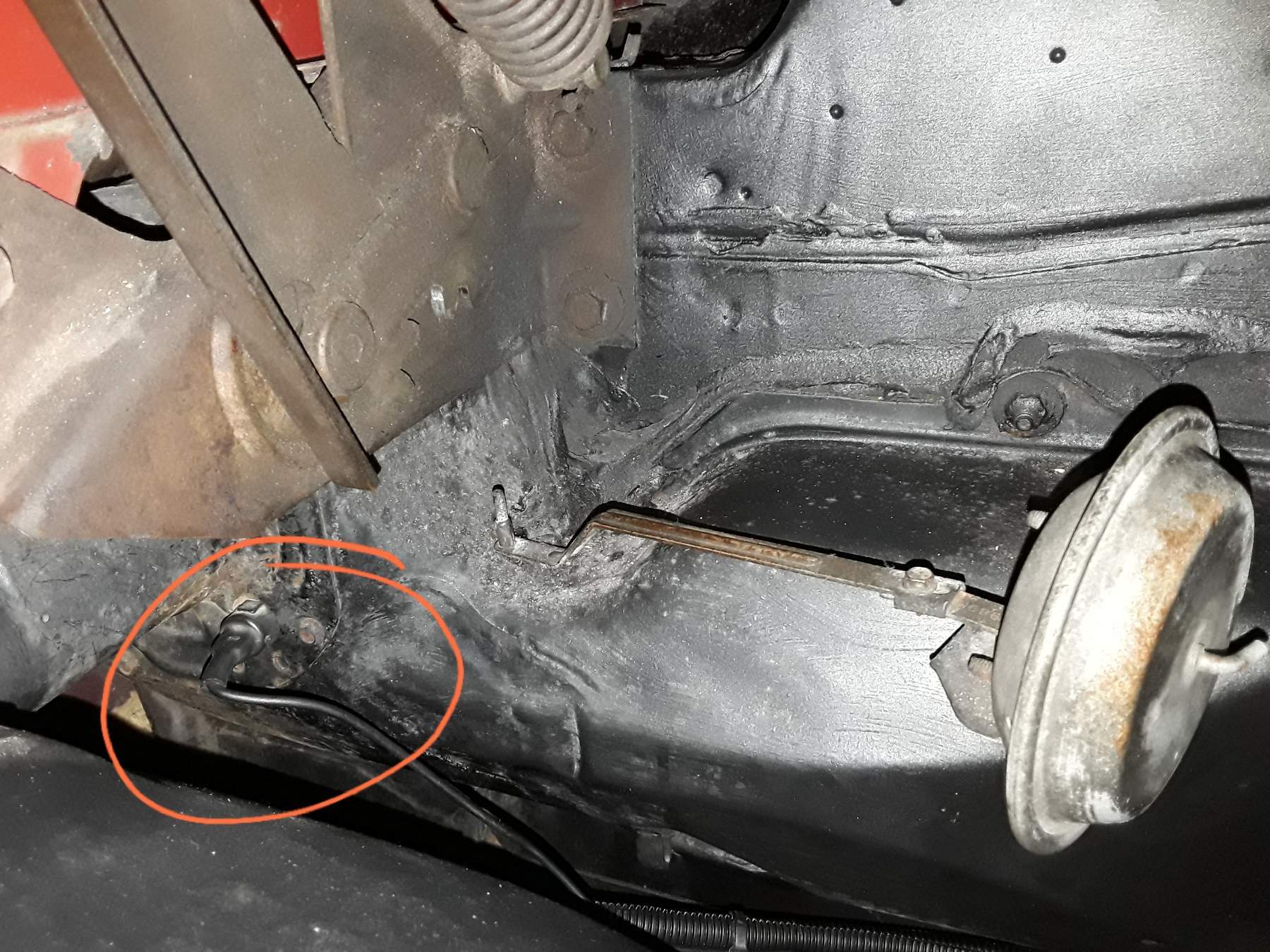

Today was productive. Frustrating as hell, but I got a result in the end. That black wire that feeds into the blower motor was actually live, but the connector wouldn't sit securely in place. I cobbled together a jump wire and turned the ignition on - blower motor hums away contentedly but without me activating the blower control knob! It's simply live when it gets juice. The obvious easy fix is to route that wire into the cabin through a toggle switch and then back out to the blower which was what I did. The blower motor connector had snapped off at some point in the last 56 years and I had precious little room to work in. No amount of tinkering with various connectors worked, so I soldered a new wire onto the remains of the old connector, then heat shrinked the connection to keep it safe. In order for the car to pass it's Safety Inspection, the blower motor has to be able to direct air onto the windscreen. The Inspector dude said he wasn't too worried about that aspect, but would be happier if it worked. Because all the vacuum lines that control airflow disappeared years ago, I simply removed the floor vent and glued a plastic wall of a milk bottle on top, so that when the blower operates, the air has no choice but to go straight to the windscreen. It will never be used - it's just for the inspection.
